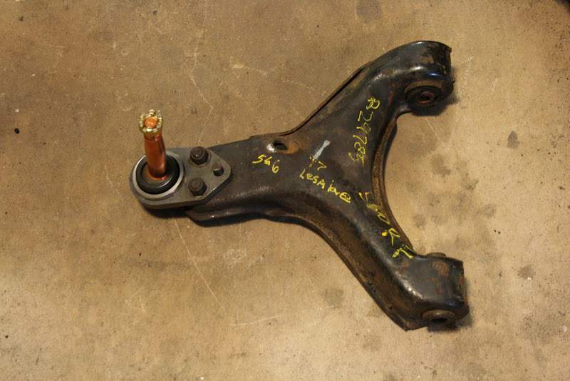

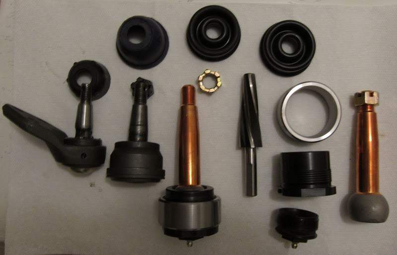

The monster truck ball joints came in..
From left to right.

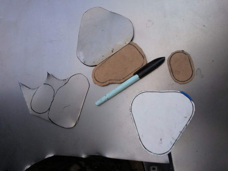

Aftermarket replacement front 92-99, Aftermarket replacement 1960-66 Chrysler, Howe Extended stud ball joint with threaded sleeve, 10* reamer for the knuckle, Howe ball joint disassembled. The dust boots are across the top in the same order.
I should have the adapter/carrier for the threaded ball joint sleeve if not next week, the following.

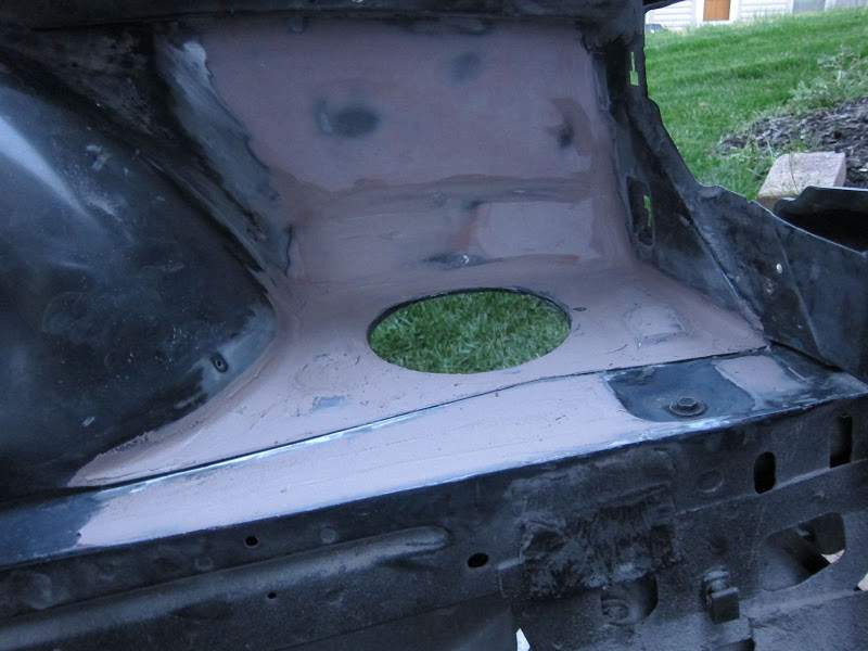

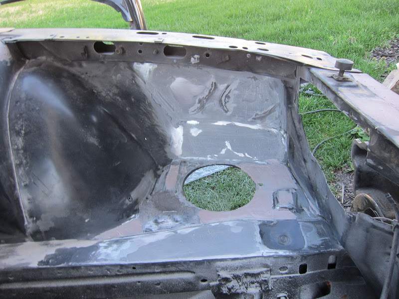

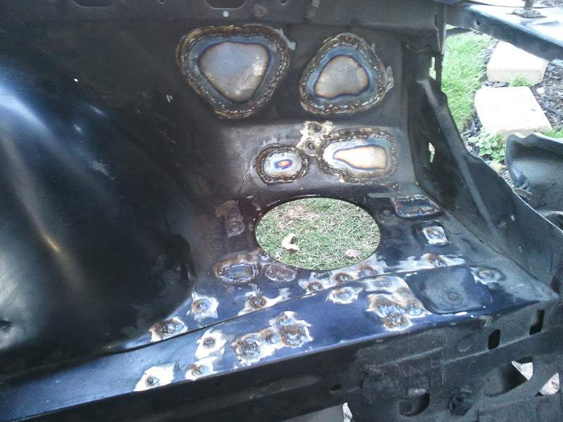

Today I:

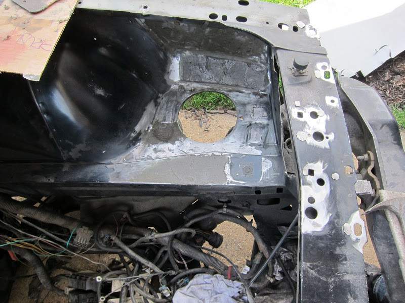

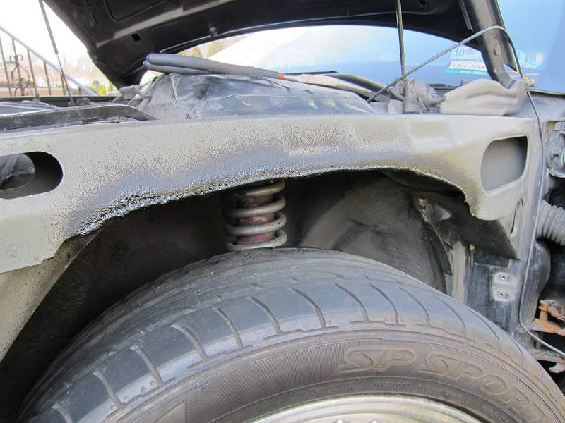

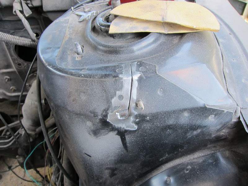

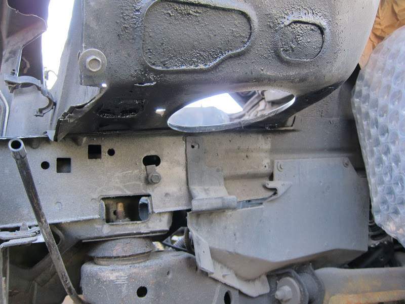

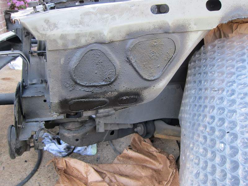

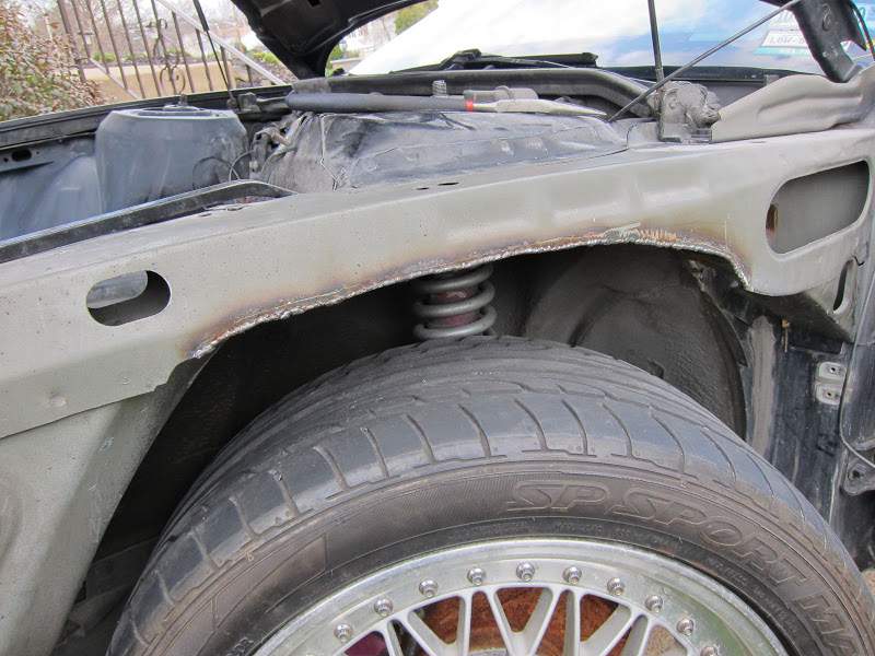

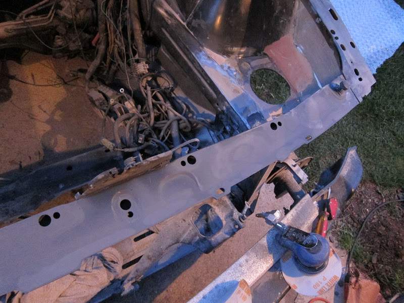

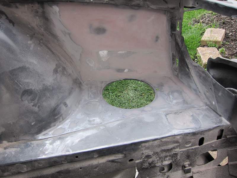

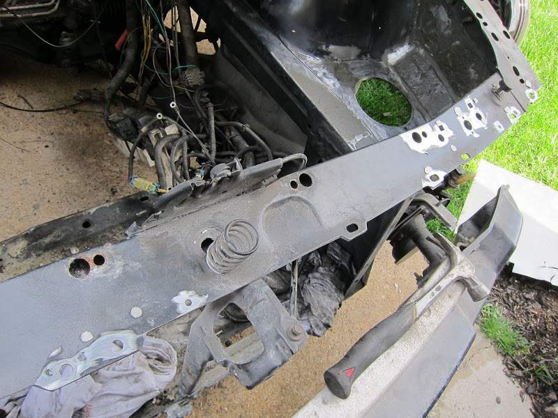

Cut out the upper wheel well pinched seam, welded it shut, and underbodied it.

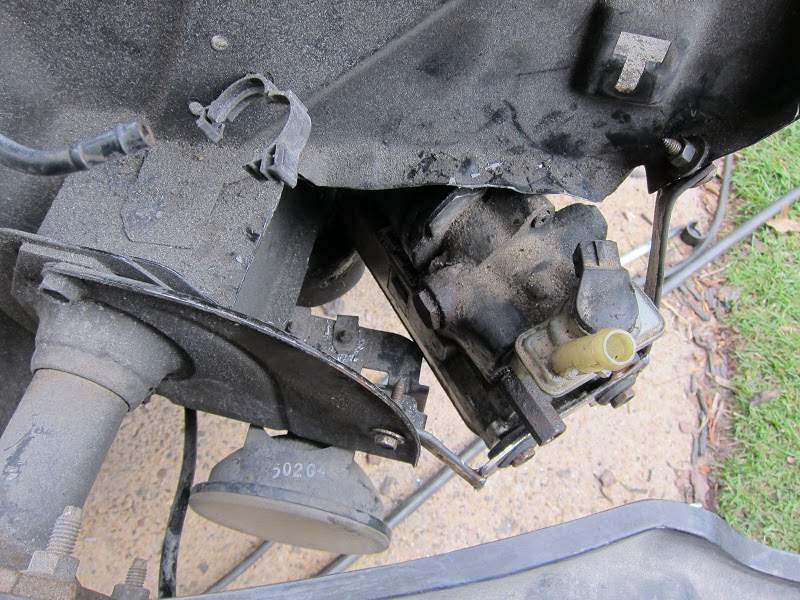

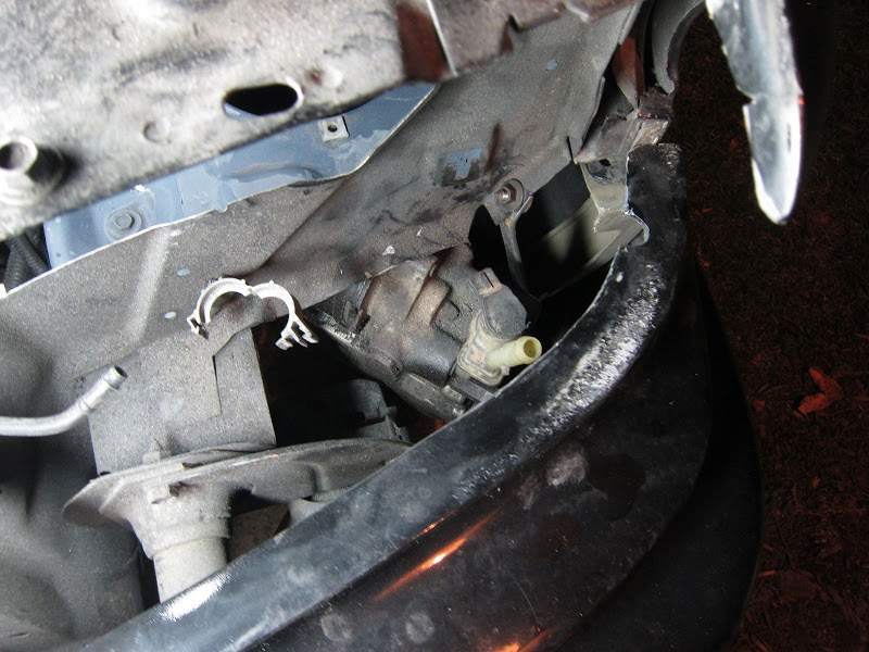

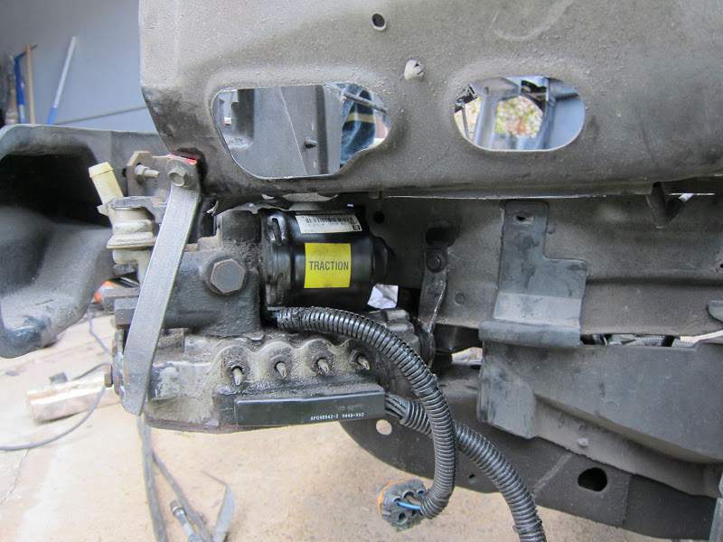

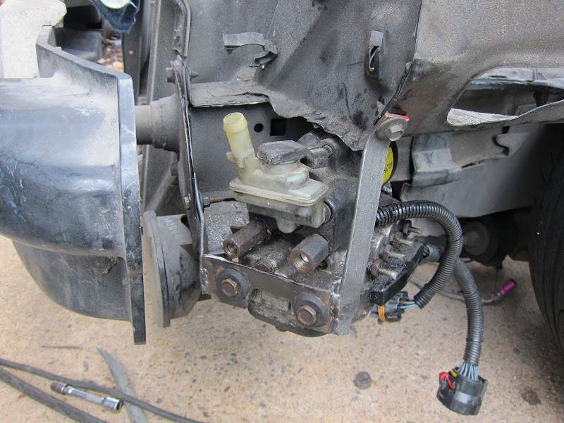

Modified the ABS unit front mounts to have it sit a little higher, bolted them in, made the third mount and used one of those sandwiching threaded metal clips in an OEM hole which made things clean and easy. I'm pretty happy with how the mounting turned out. Everything bolts up, it's solid, there's plenty of room for routing the lines, and it even still uses the OEM rubber bushings.

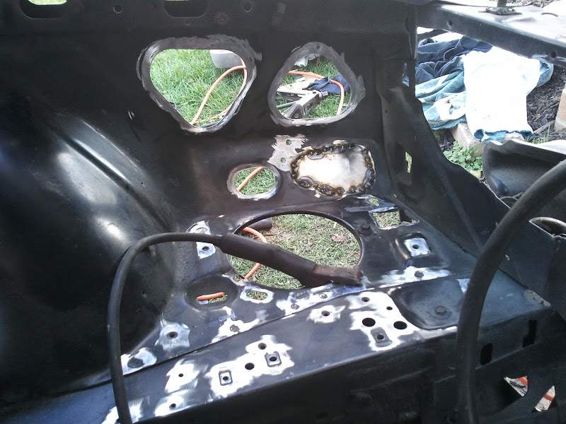

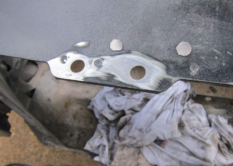

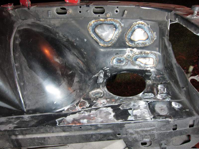

I welded plates and filled in all the unneeded holes in the front of the engine bay on the driver's side. I got about half way through grinding it all down before I had to call it quits.
I still have to do some welding on the upper rad support and strut tower, then comes the filler.. my favorite part. :lol2:

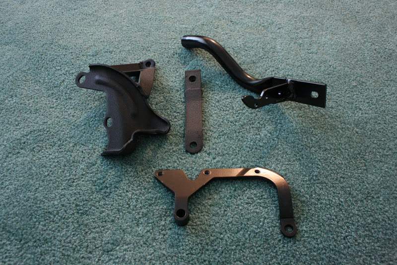

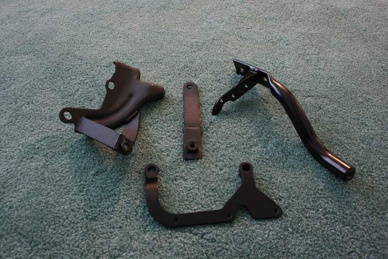

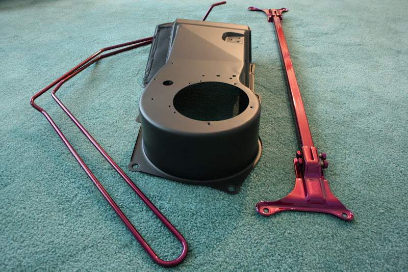

I picked up some stuff from the powder coater today after work.

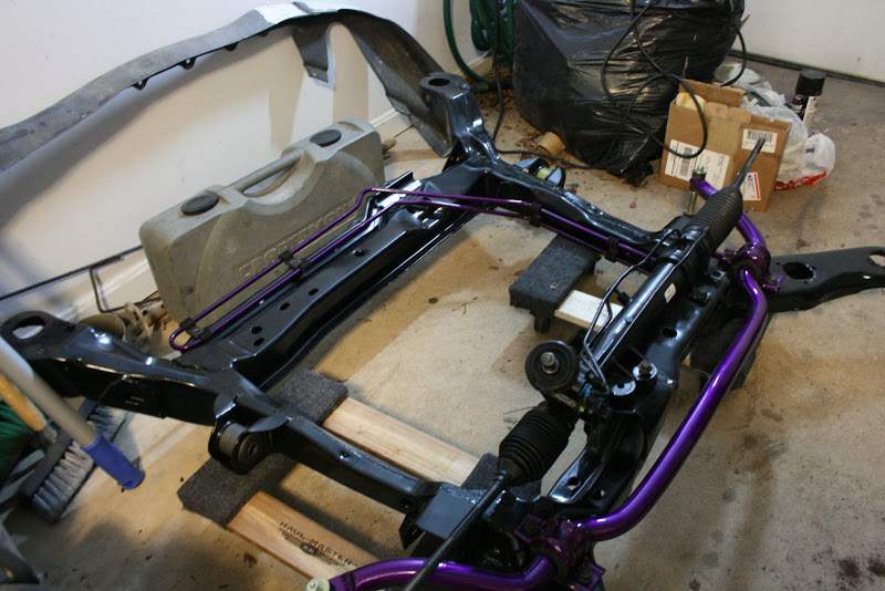

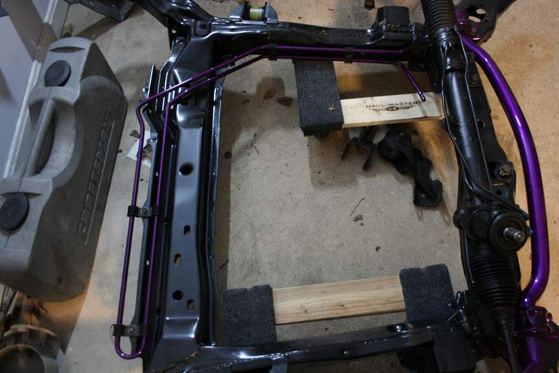

Power steering subframe line in purple.. I probably shouldn't have done this since it's not going to cool as well but I couldn't not.. I'll add a mini cooler later.
Then STB in purple and the heater box is ceramic coated to make up for the disintegrated firewall insulation.

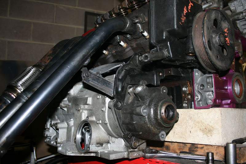

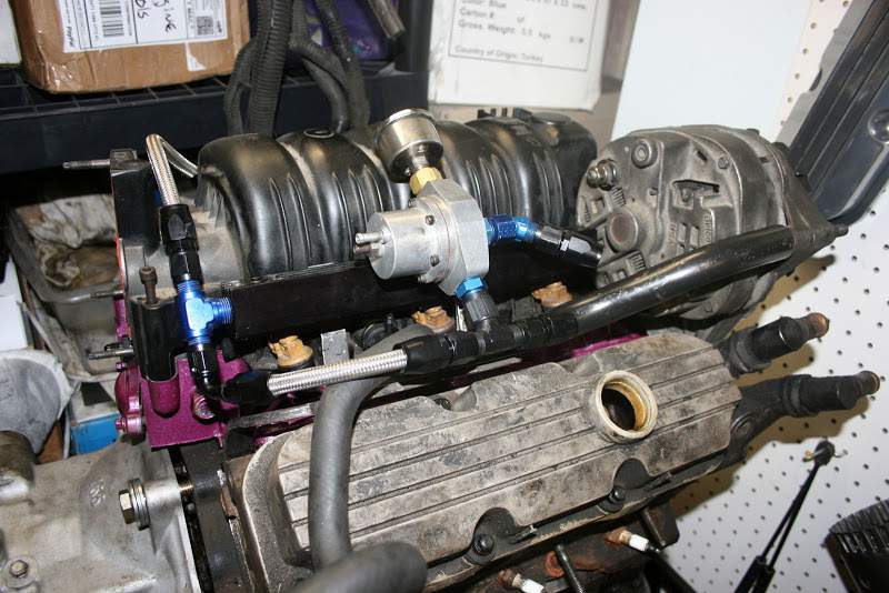

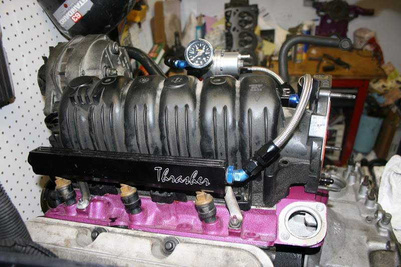

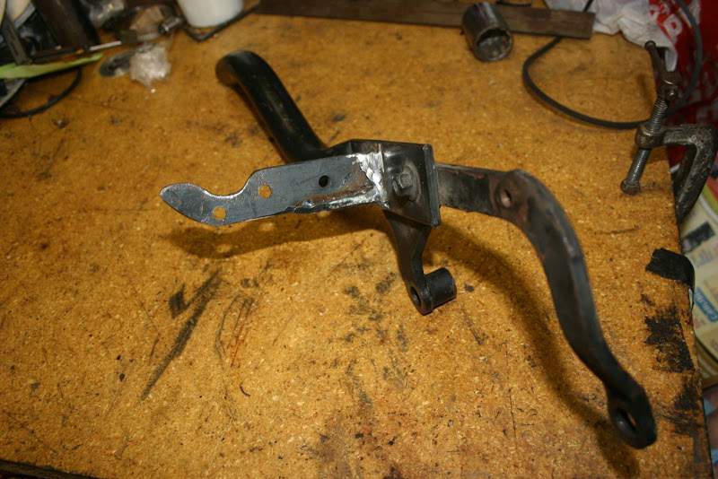

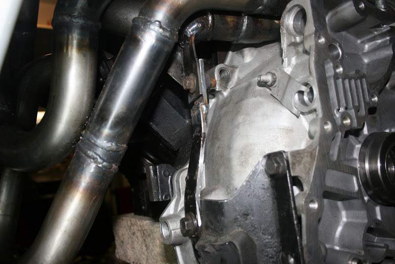

Below are a modified tail shaft to block bracket, and a front support bracket for my headers (wrinkle to match jet-hot 2000), and modified alt bracket for my FPR/fuel setup (satin).
Pics of before and where they go:
Hopefully I'll pick up the anodized fuel stuff this weekend.

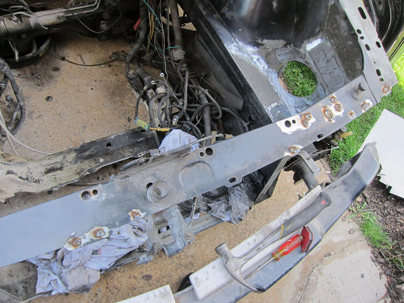

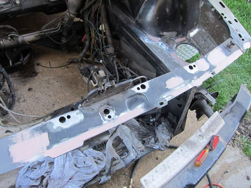

Nothing exciting but some more progress nun the less. The bottom has to be knocked down and I still have to grind and fill in all the strut tower spot weld b.s.

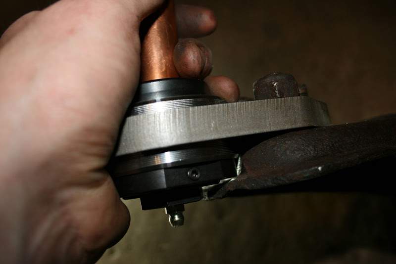

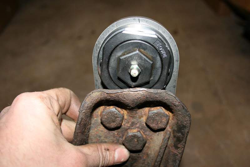

My ball joint adapters I had waterjetted came in and I pressed the threaded sleeves into them. They fit a lot better than I thought they would and I only had to do a very minimal grinding on the control arm to clear the sleeve and ball joint housing. They still have to be welded and coated.
I bolted up the power steering line to the subframe to remind myself why I had it powder coated, looks legit.
