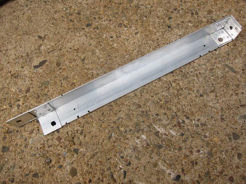

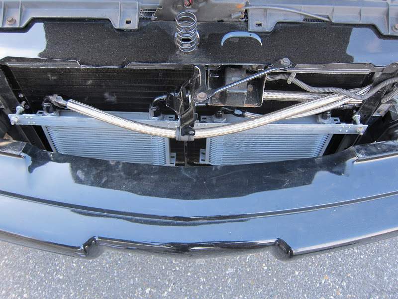

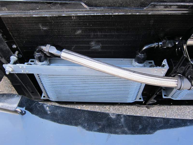

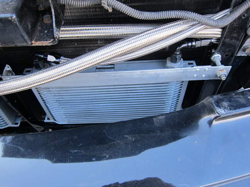

My oil coolers were temporarily ghetto rigged where I want them with zip ties.. I picked up some aluminum angle stock and put something together with rivets. The placement tuned out pretty good. I have them up behind the bumper support and out of view of the lower air damn. They'll still see enough flow but this way it'll be more subtle. And even though the coolers are just hanging, they don't move at all.

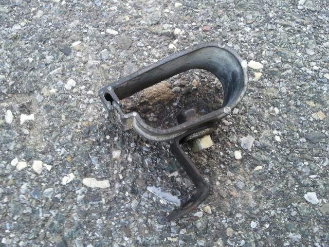

One of the harnesses to my fuse block was too close to the exhaust crossover so I made this and used a stud on the firewall to hold it out of place:
nice! hey how do you make these parts? do you have a machine shop or something?
Thanks. I just used a chop saw, bench grinder, hand drill, and pop rivet gun.

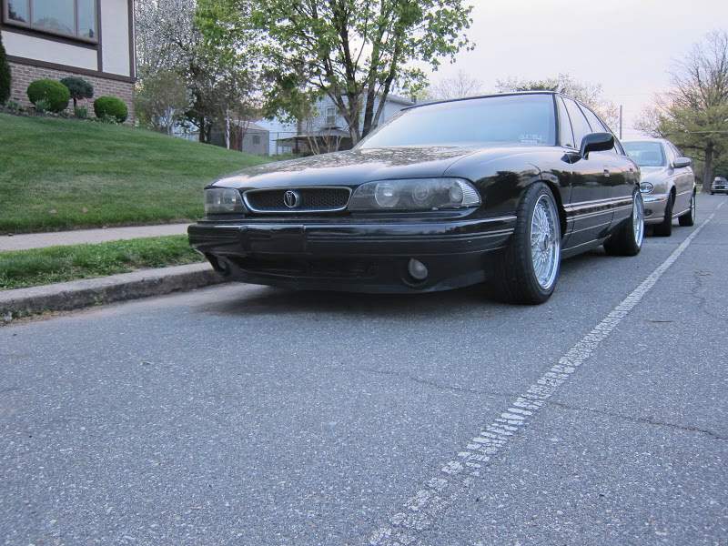

The RSs look amazingly good on there.
