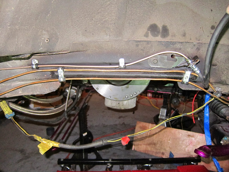

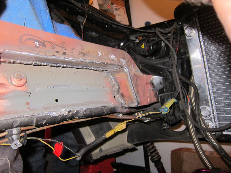

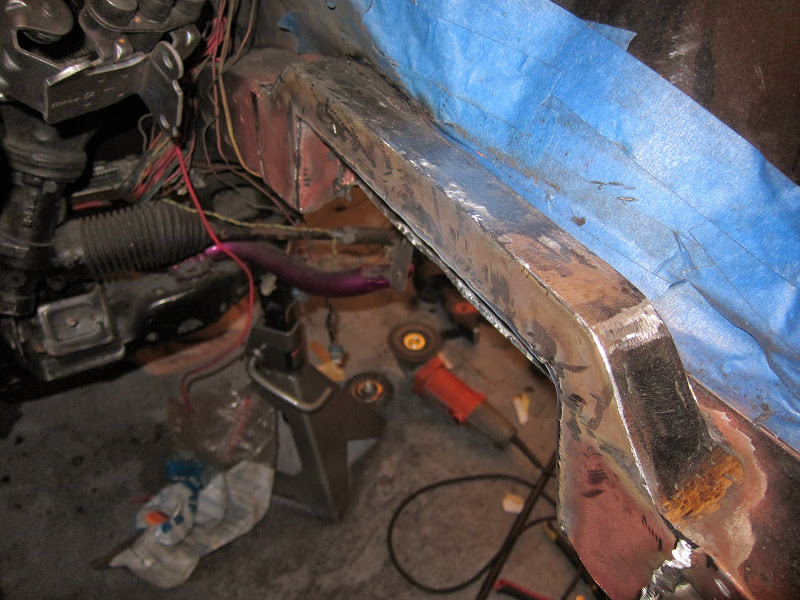

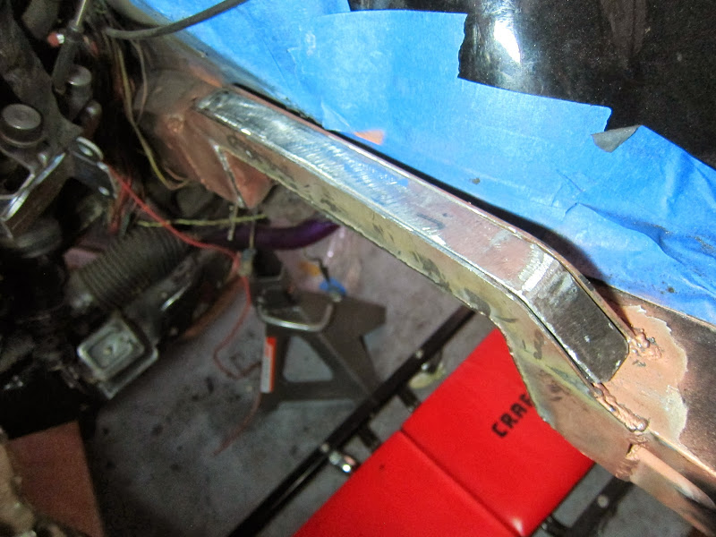

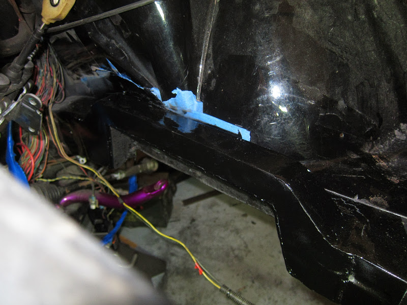

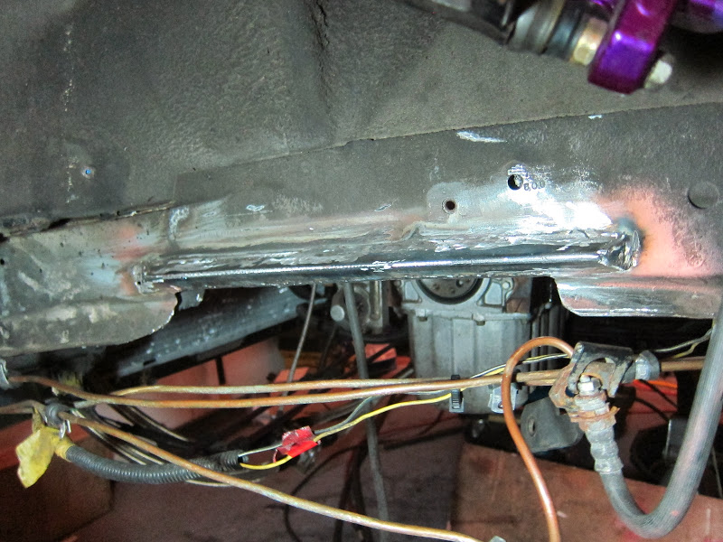

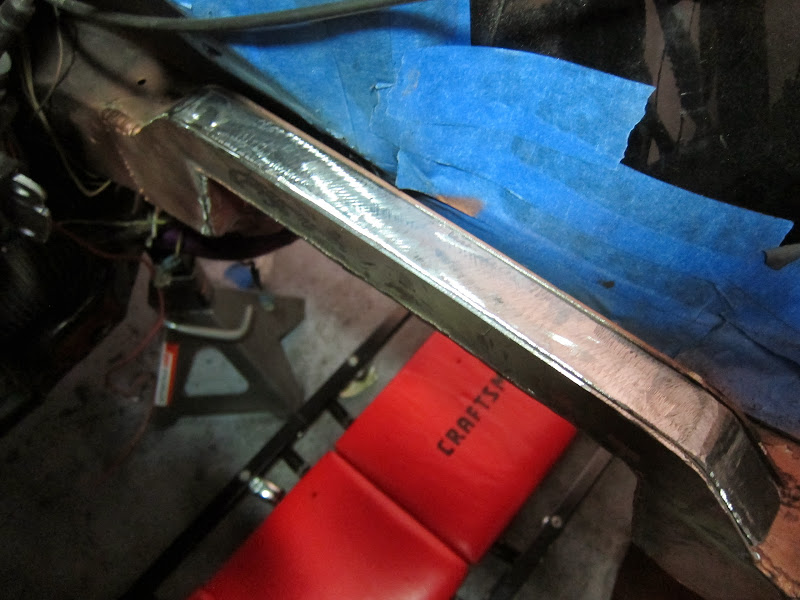

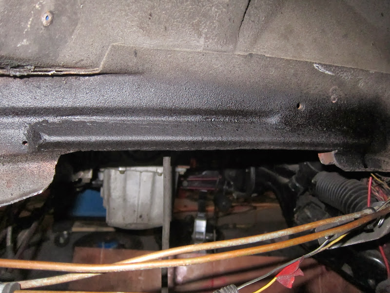

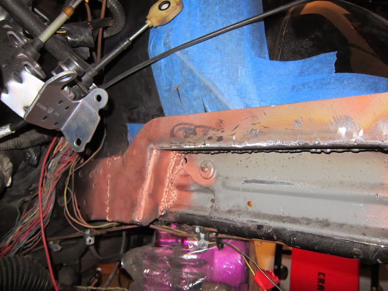

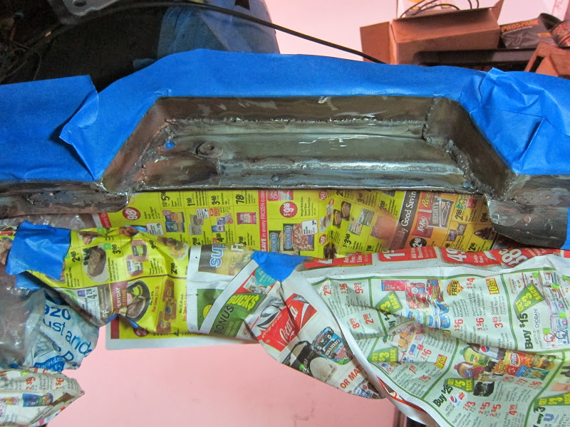

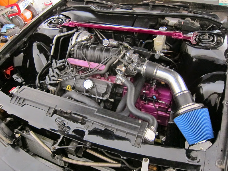

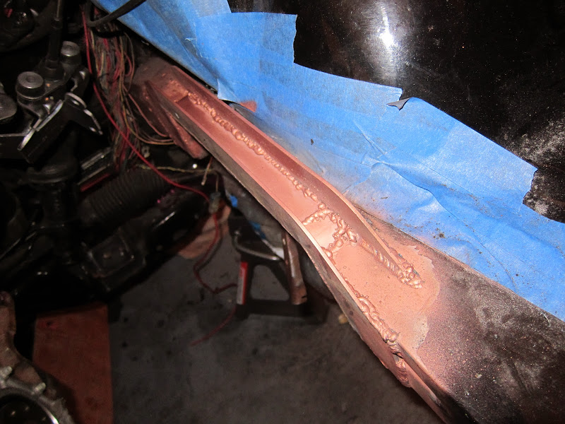

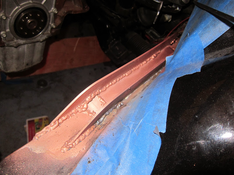

I finished boxing in the unibody work with 1/4" steel and added another rail in the wheel well area. The bottom of the vertical sheet metal that I left was curved inward and closest to the trans when mocking things up. I opted to cut that out and add that wheel well rail right above it. This gave plenty of clearance when installing the trans. I underbodied in the void where the trans sits and I primed and rattle canned the top. I'll revisit the top with some more smoothing and real paint later.

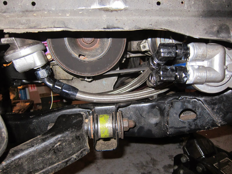

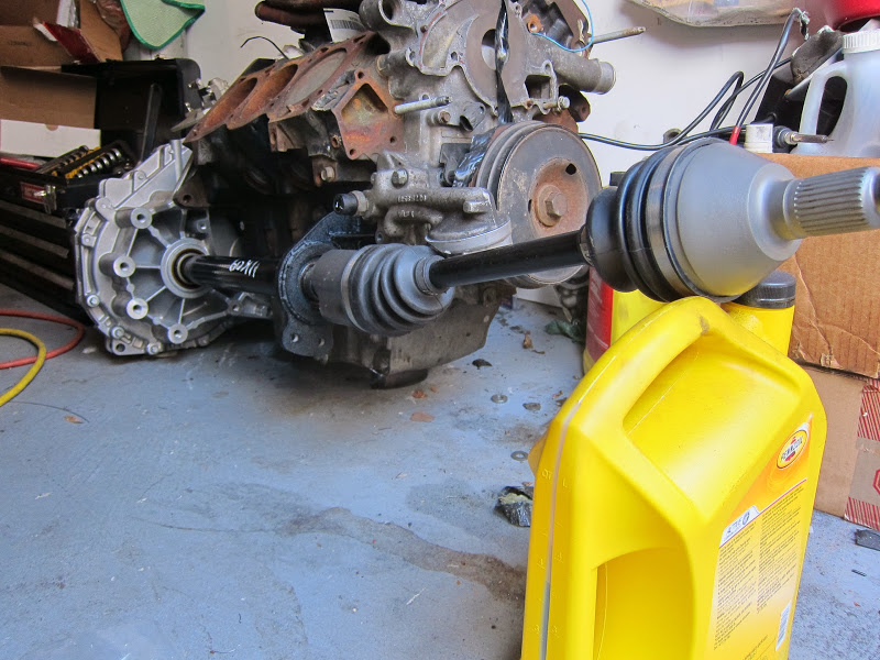

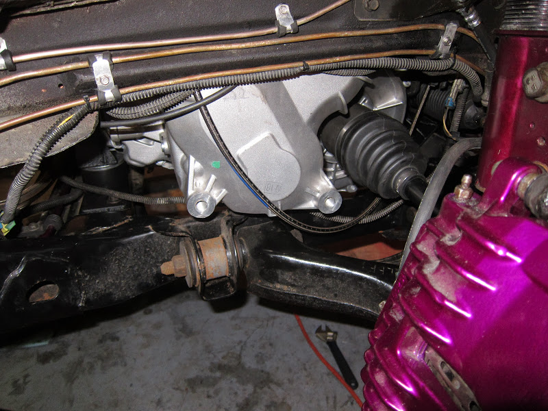

Clearancing the oil Jegs universal oil adapter and stock filter housing for the axle.

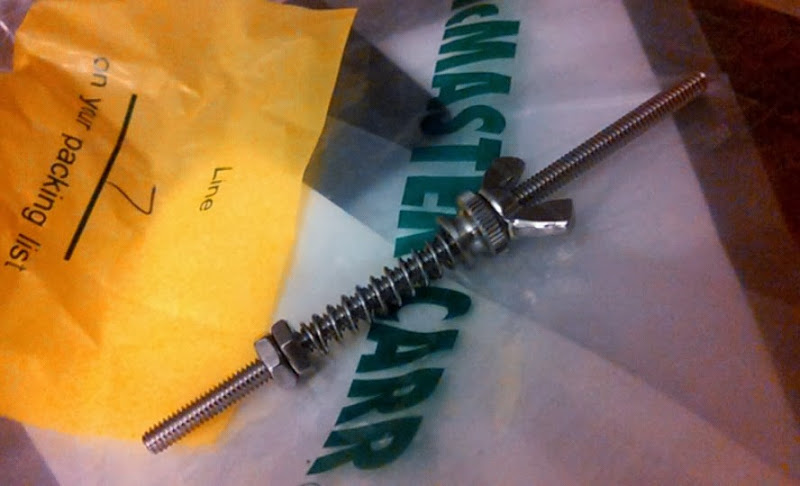

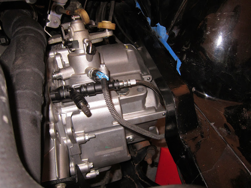

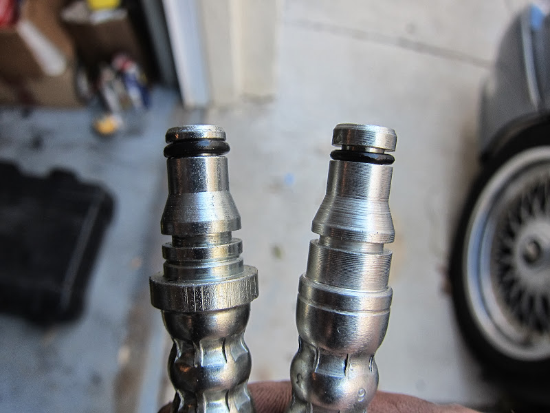

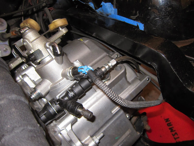

For the custom length clutch line, I called up Rogue Engineering in NJ. They sell a DOT approved SS braided line for BMWs that have the same quick connect fitting on one end. The G6 has this fitting on both sides.. I was thinking I may have to run 2 of their lines with a double male adapter connecting the 2. I asked them if they can make a custom length line and they said 'We can do anything you want'. I LOVE hearing that.. 2 days later I had a custom line in my hand for $85 plus shipping.
The only thing I was a little weary about was the size of the O-rings vs. larger stock G6, so I just swapped those over.

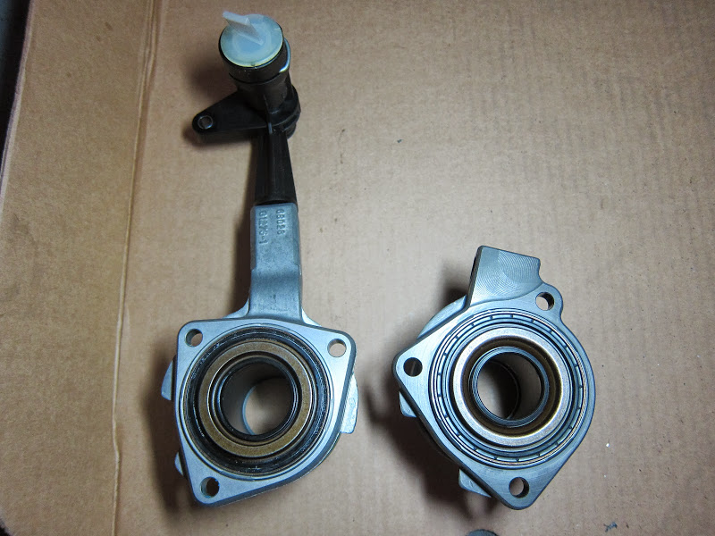

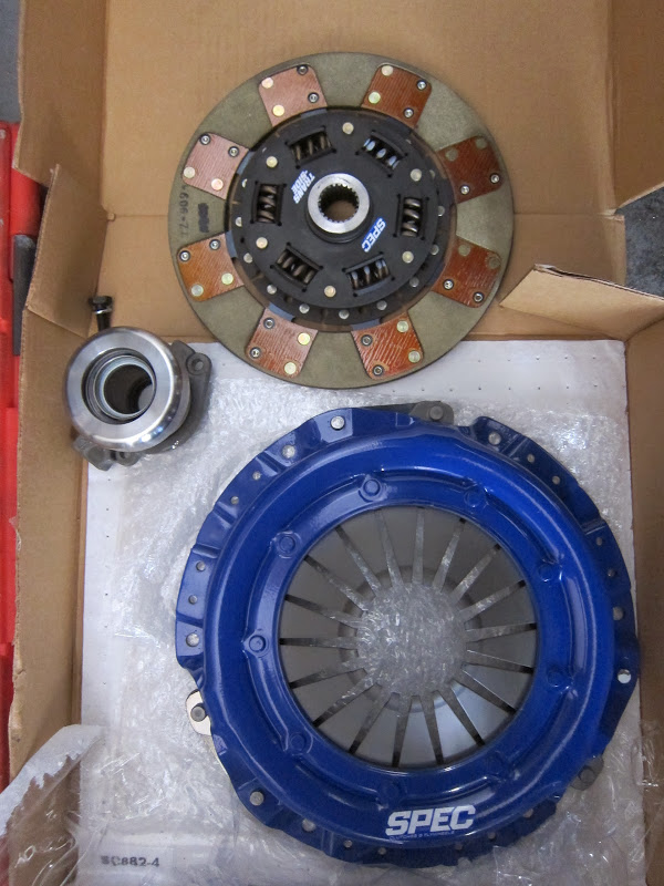

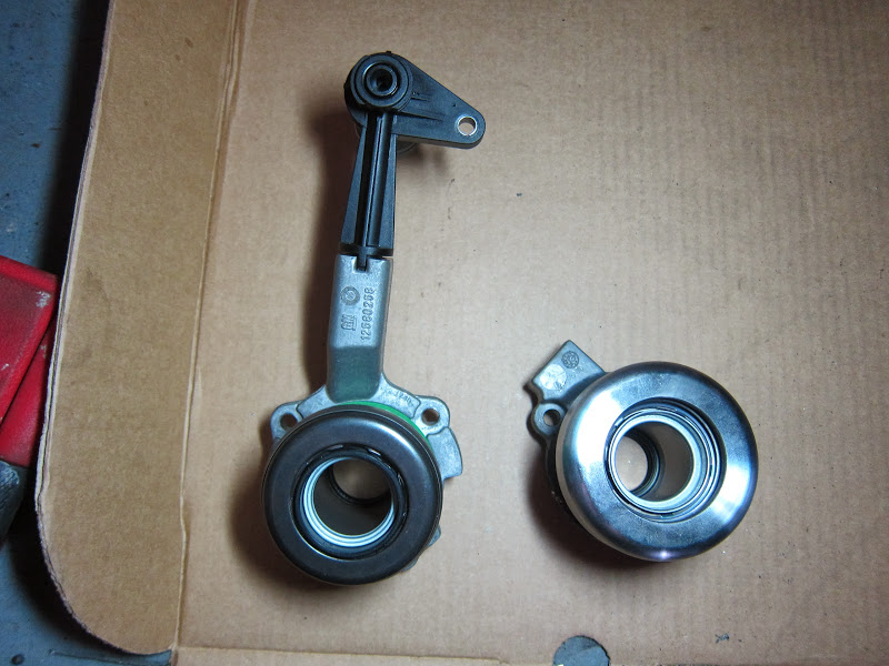

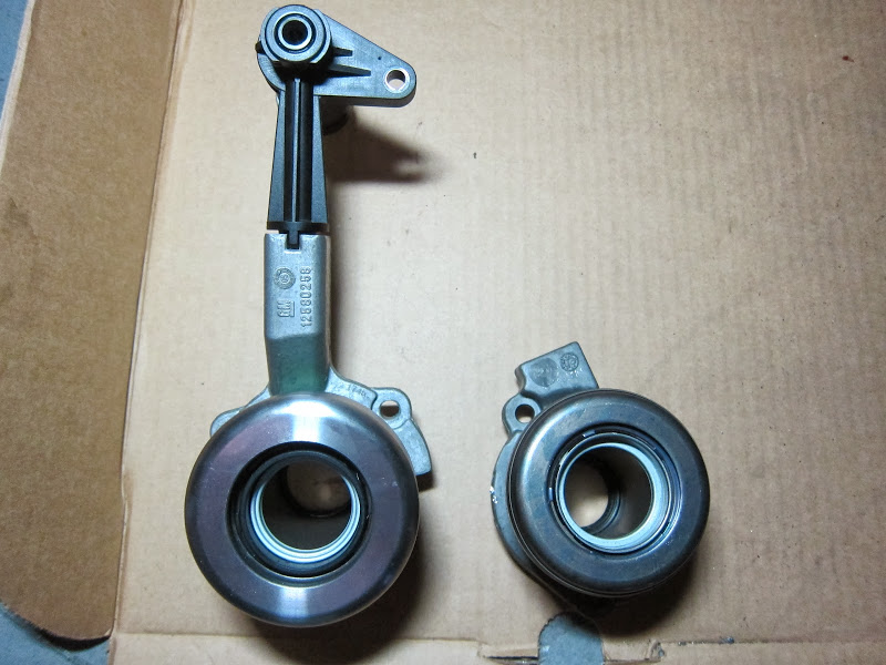

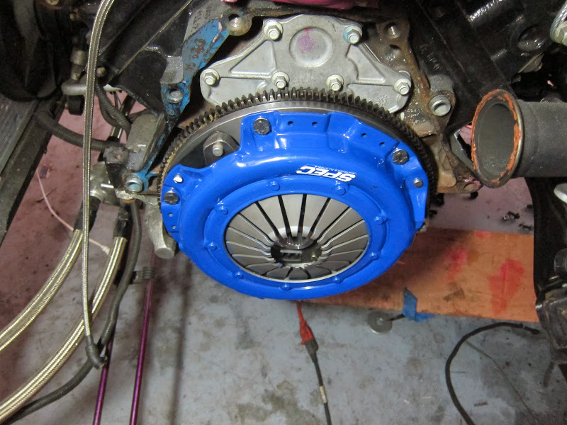

Spec clutch kit for a S2 3800 and F40:

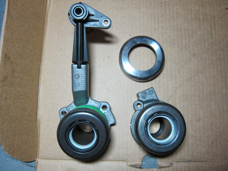

The Hydraulic Throw Out Bearing spacer in the kit came on another HTOB that isn't the same as the G6. So, I just swapped the spacer on the one that came on my trans. The point of the spacer is to keep the HTOB from over extending when pressing into the pressure plate. The stock dual mass G6 setup has a higher stack height.
G6 on left
Clutch installed:

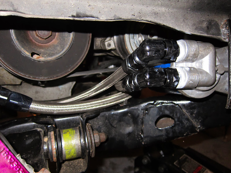

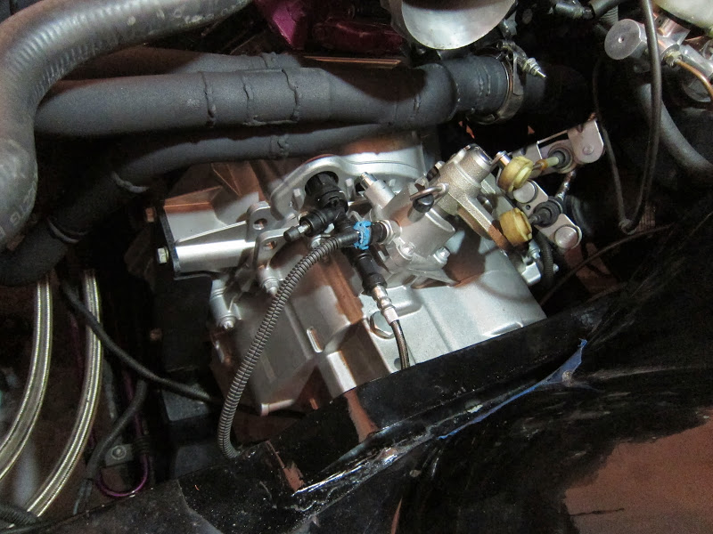

Bracket for the relocated oil housing and re worked -10AN oil cooler routing:
Bracket holds oil housing on the left.

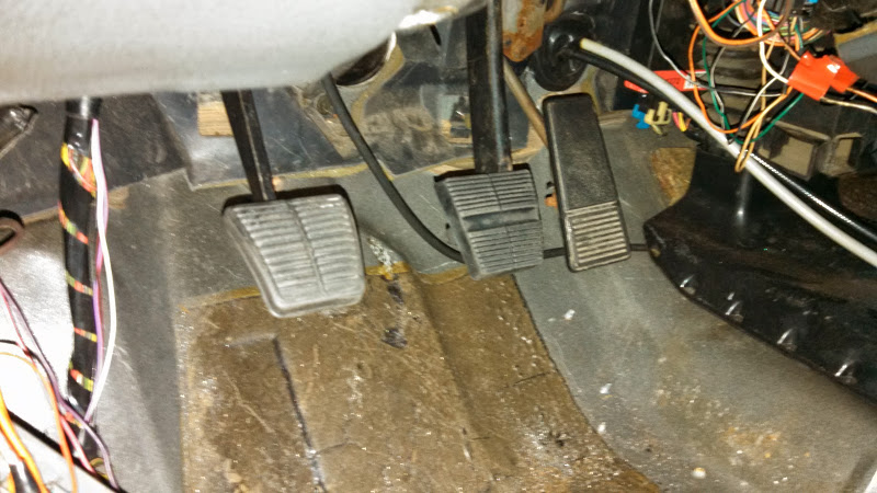

G6 brake pedal:

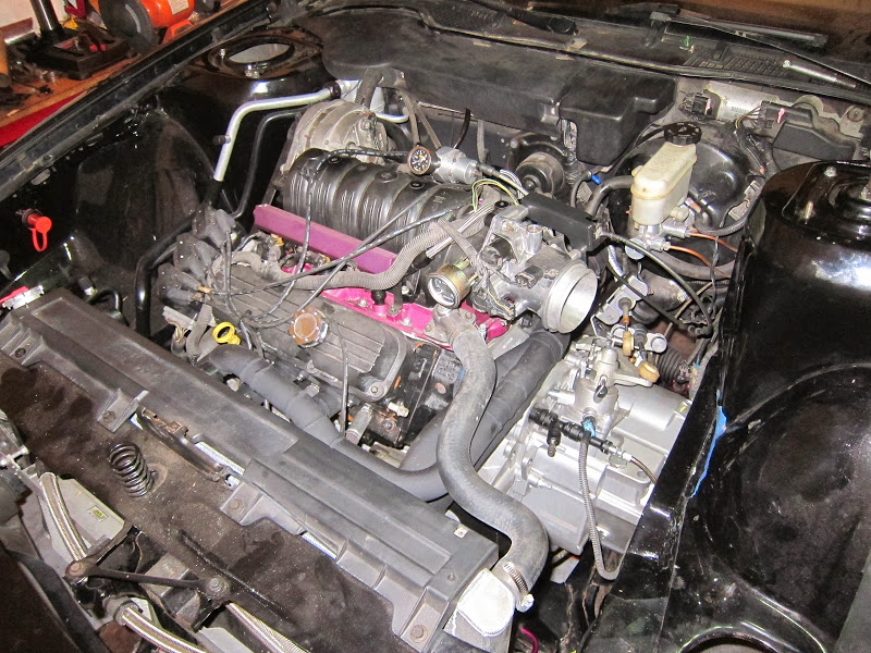

More or less together:
The electrical side of things was made easier by Ryan at Sinister Performance and Micky Moose on Fiero.nl:
http://www.gmtuners.com/fiero/transbypass.htm
http://www.fiero.nl/forum/Archives/Archive-000001/HTML/20130314-2-116755.html

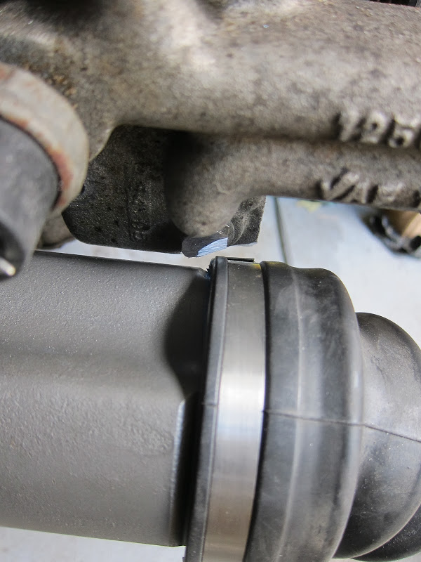

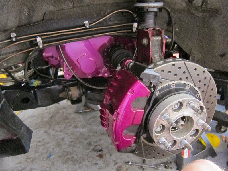

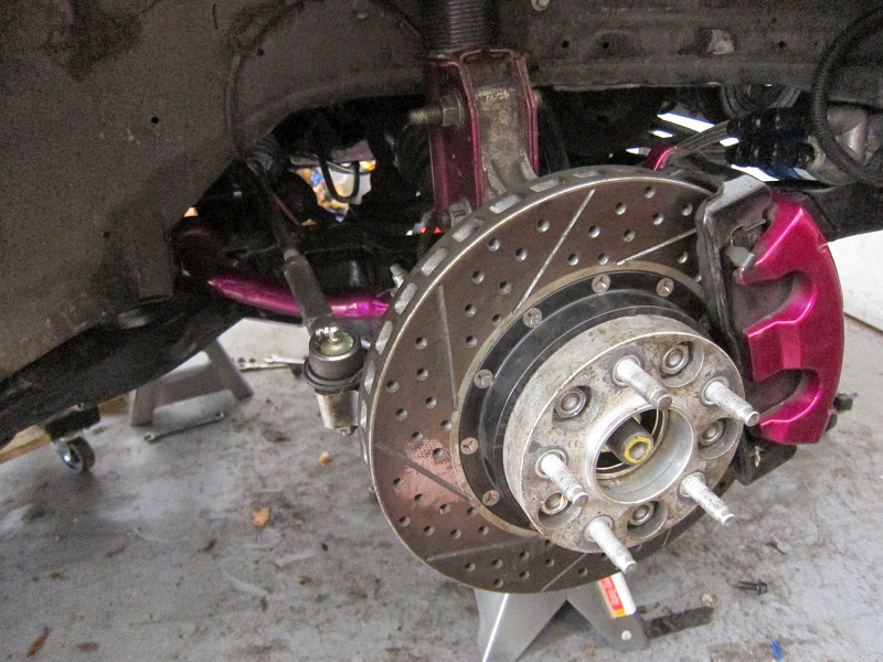

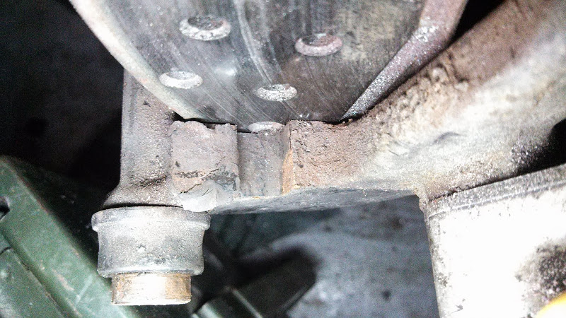

And when I figured out that the Malibu hubs are 5-6mm shallower than 00+ H body:
^^ that kinda sucked and required a 5mm spacer behind the brake rotor to space it correctly in the caliper bracket.
I drove it around the block last night and back and fourth down my street.. damn that felt good.

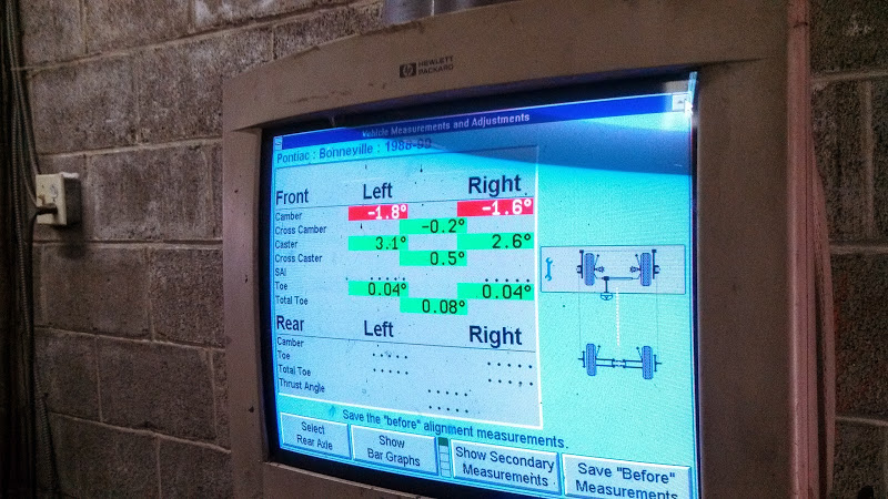

I was able to get over to my buddy's shop last week to get on a lift and the alignment rack.
On the lift I installed real 5mm wheel spacers behind the rotors to space them correctly, did an oil change, clearanced a p/s line from the header, tied up the aft O2s, and bled the p/s a bit more.
On the alignment rack I added a little more camber than I had before up front and got the toe in check. I'm about -1.6* camber all around. When they're not slammed with jobs they let me have free reign over their alignment rack. So I can go back and tweak whenever.

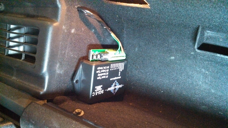

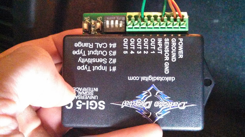

Ryan suggested a Dakota Digital SGI-5. And since I know the internal ppm is correct, I decided to just manipulate the signal going to the cluster.

The SGI-5 came in so I got that installed. I took the Bonnie grocery shopping today.. lol.. but speedometer wasn't working.. Luckily it comes with diagnostic blinking lights to narrow down the problem. Wrong output type. I had it hooked up as 4k square wave out but it needed to be 4k AC. Simple fix. When verifying via GPS, the speedo seems spot on up to 50. I`ll verify further when I take it back on the highway.
I routed the wiring into the glove box through a hole the PO had for a kill switch.

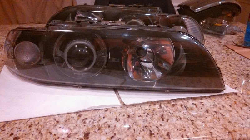

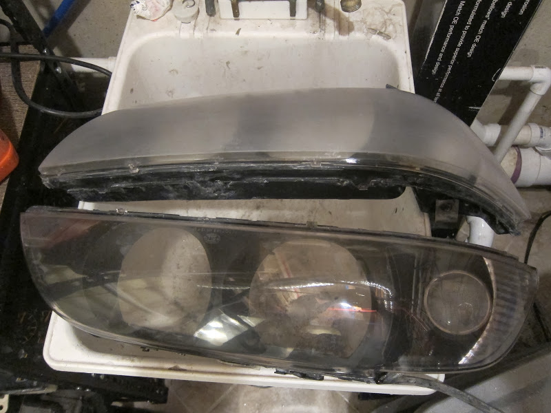

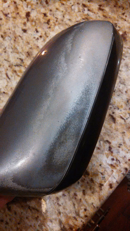

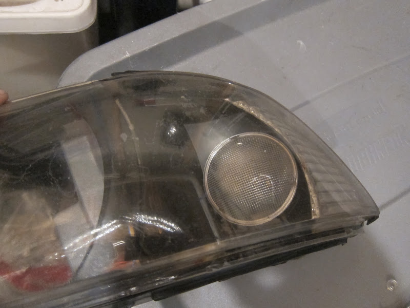

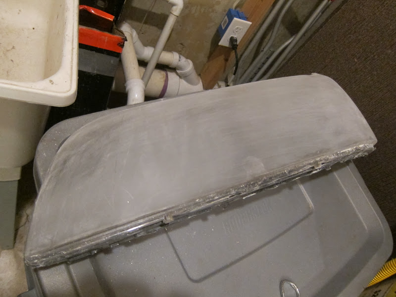

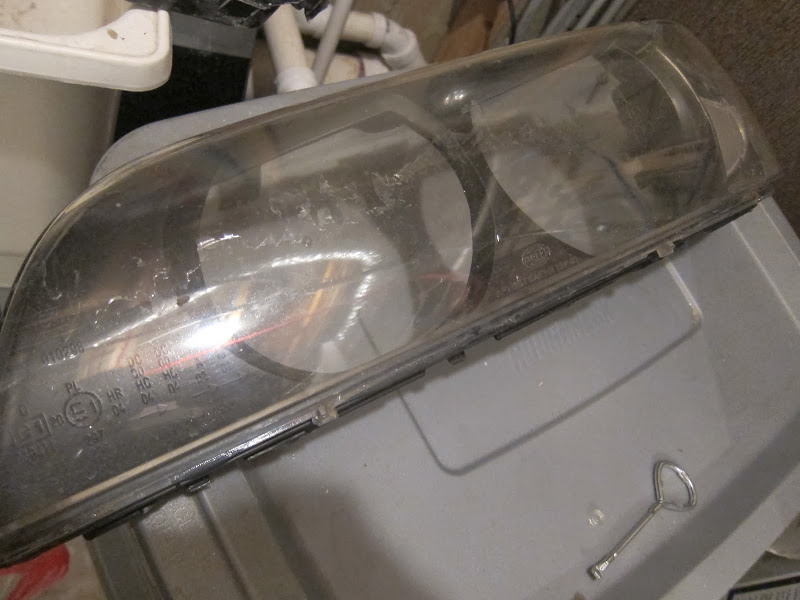

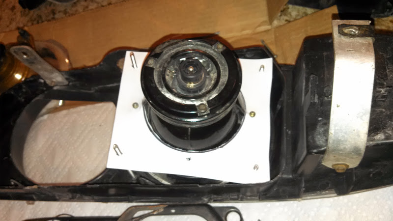

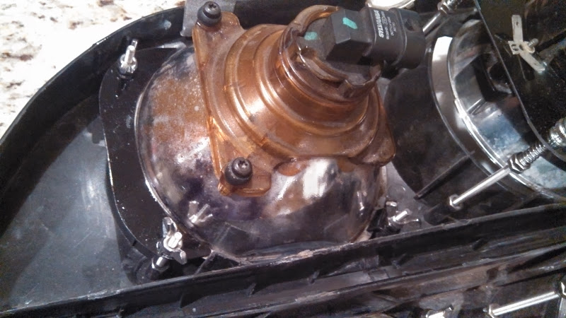

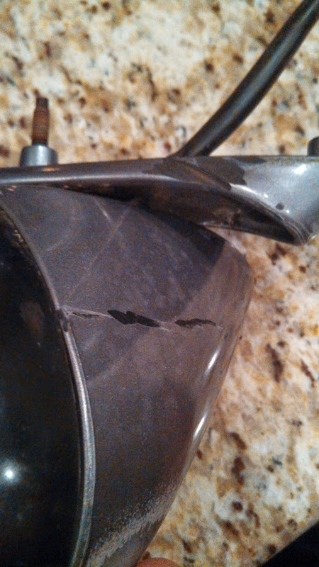

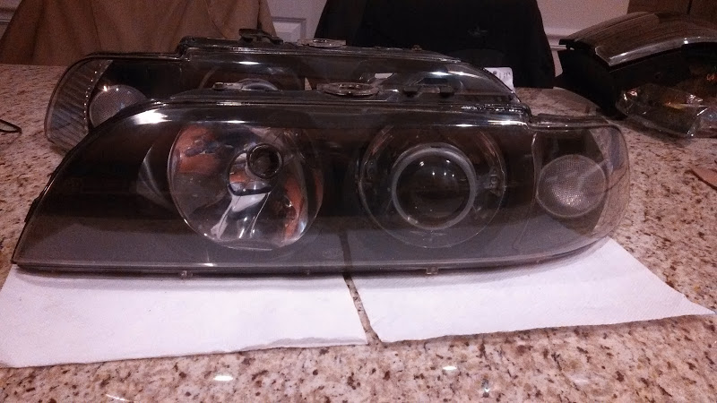

So, I decided to restore both headlight lenses and remount the projectors and highs. The clear on the outside was pealing and the mounts for the projectors and high beams were broke.. It's been something I've been putting off for a while..
I used a headlight restoration without tools method on the lenses.
Before:
Took them down to 400 grit:
After 500, 600, 800, 1000, 1200 dry and 1500 and 2000 wet. Top is pre 50/50 urethane and mineral spirits and bottom after.

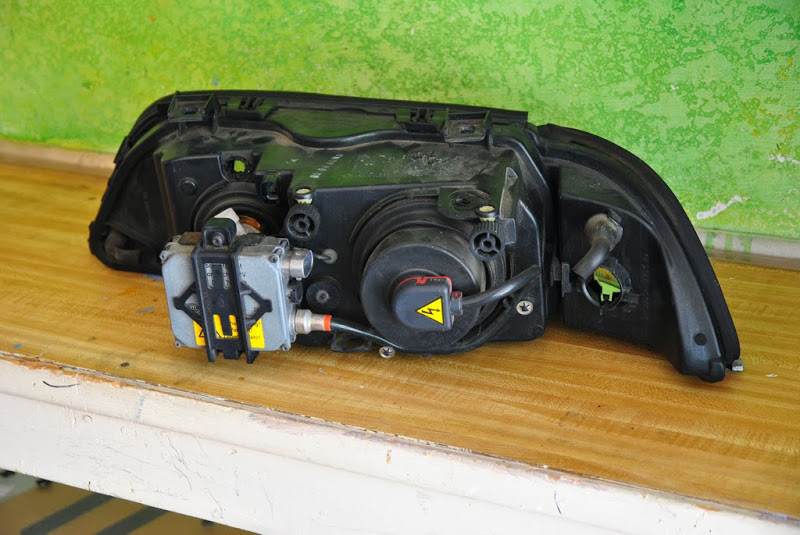

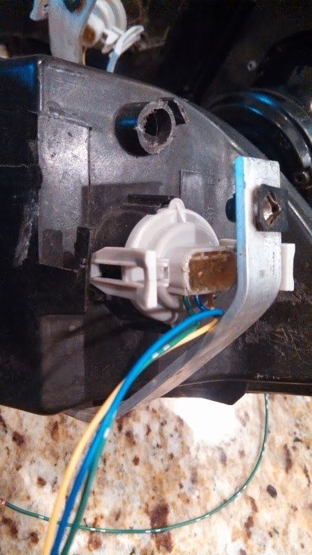

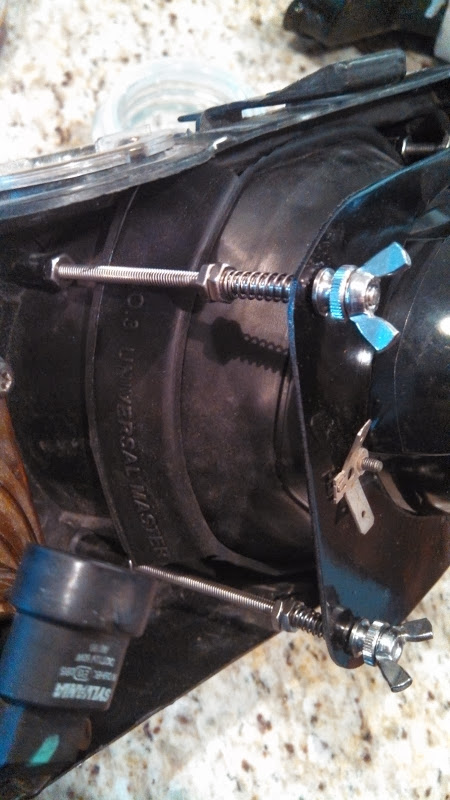

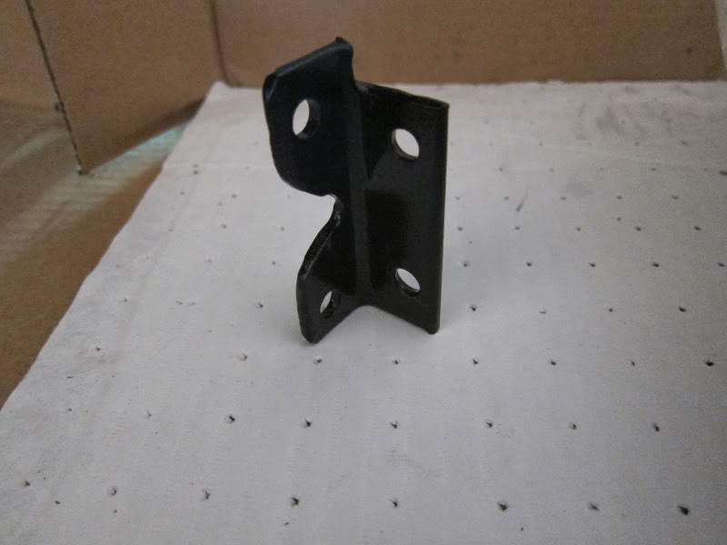

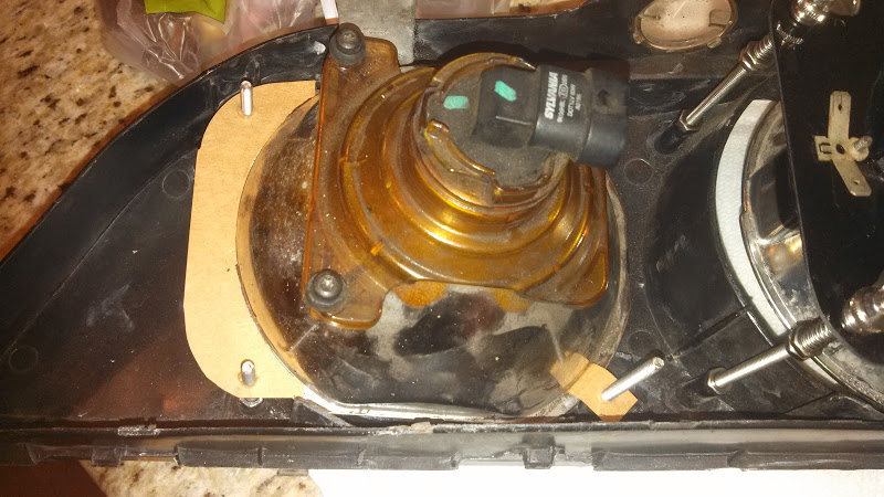

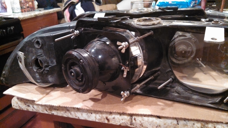

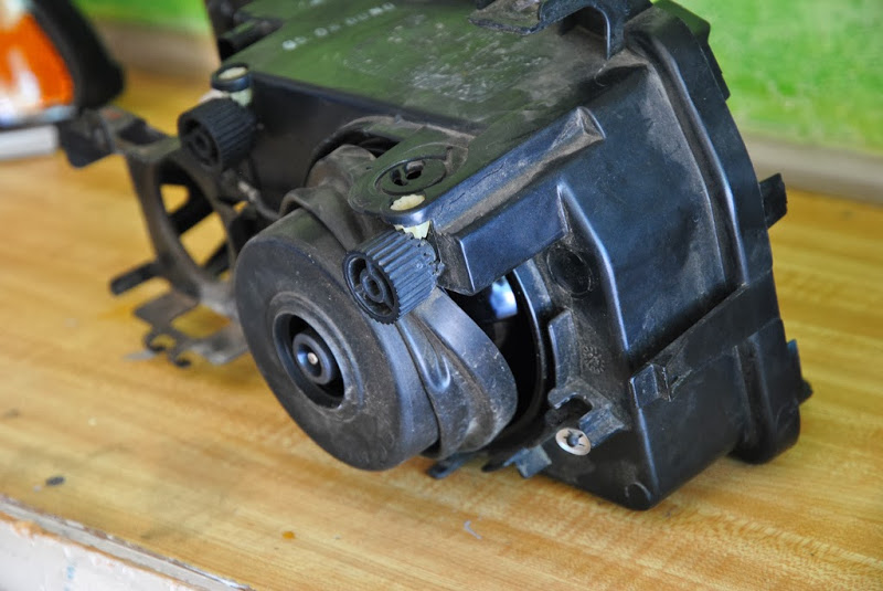

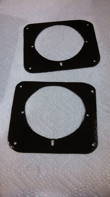

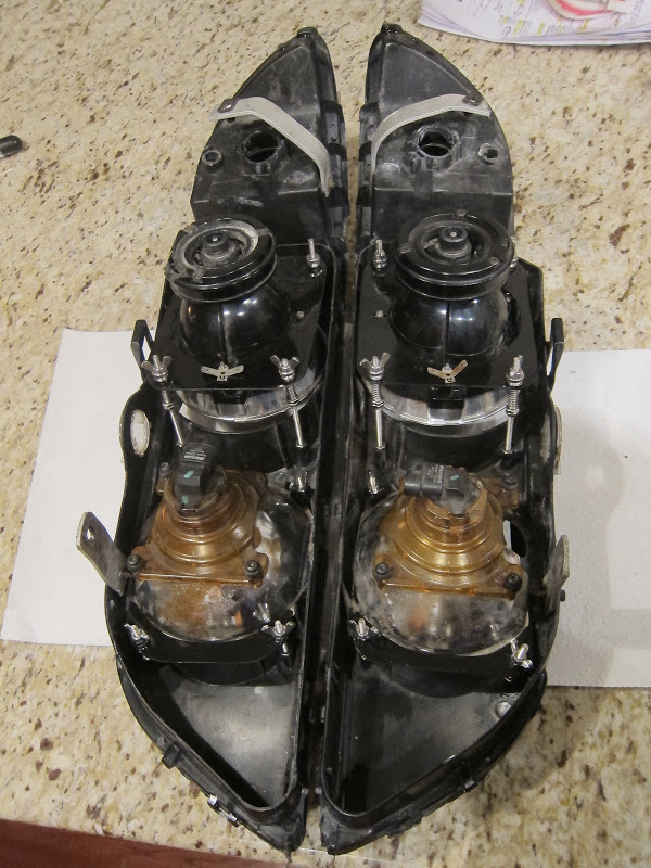

Stock, the E39 headlights are mounted and adjusted from the rear of the headlight assembly. Both the projector and high beam lens are mounted together on one metal bracket and adjusted simultaneously. The assembly didn't fit so I had to figure out a way to mount the projector and high to the rear of the headlight lens. There were hollow shafts sticking out of the back of the lens around each of the two light holes. Four on the projector side and 3 on the high side. Originally, I epoxied threaded shafts into these holes and mounted the stock metal bracket on these. Over time the threaded shafts got loose and oxidized.. There were some clearancing issues since resolved that also contributed.. The assembly was never sealed either. The back was opened to the elements and dirt often made it's way in there.
Stock:
This time around I used slightly larger threaded shafts, tapped the holes and installed them with epoxy. They're also secured with a nut at the base. I separated the high and projector and made individual mounting brackets for each. The projectors are adjustable against 8lb springs and all hardware is stainless. I never use the high beams so I didn't make those adjustable. The highs are at least sealed against the lens except for the rear top hole. The projector shroud still needs to be sealed against the back of the lens.
Everything is looking amazing on this car. It sounds gnarly. I might need to borrow your brain when I start getting deep into my Fiero swap in a couple years :lol:
Killer job with the headlight resto. I like how you mounted the ballasts for the HIDs as well, also what did you use the seal the headlight lenses once you were done sanding? I need to do that to a set of JDM headlights I bought a few years ago for the Galant.
Thanks.
The one pic with the ballast mounted is a stock E39. I had to mount the ballasts elsewhere.
The headlights are sealed with a 50/50 clear urethane and mineral spirits mix applied with a foam brush. Click the link in the last post for more info and results. This method seems to hold up great.

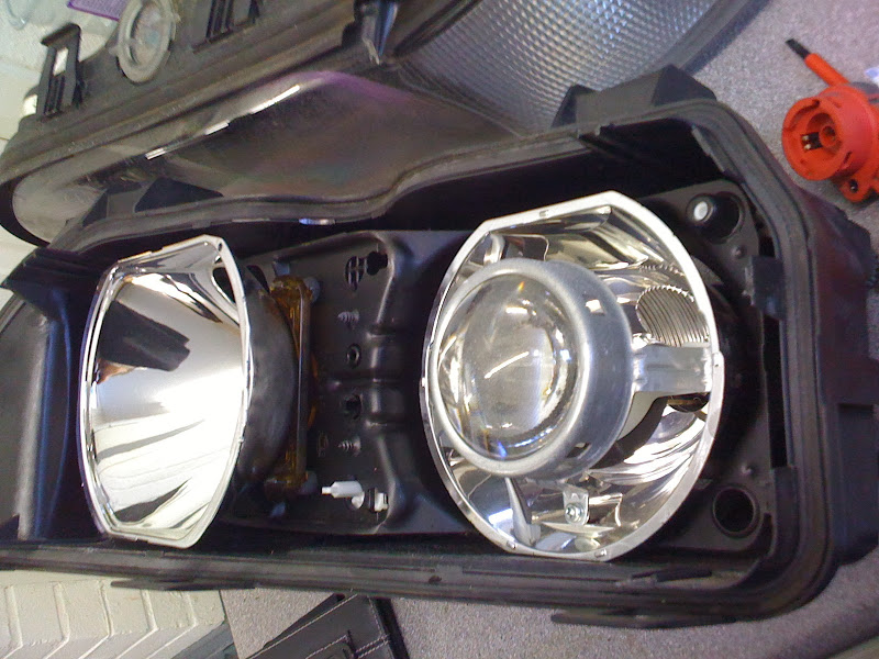

The headlights are finally finished.

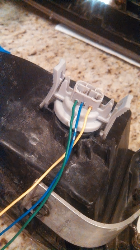

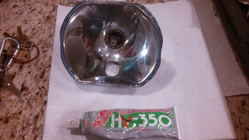

I picked up the BMW style corner bulbs and sockets to replace the stock Bonneville ones that I had been just jamming into the headlight. They didn't clear the rear mount I made I chopped them down, soldered them in through the bottom, and filled the plugs with potting epoxy to seal them.

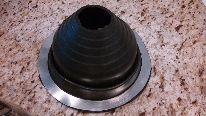

For sealing the projectors, I searched for a while and eventually came across roof flashing seals. I picked up the right size, cut them up accordingly, and it seals well.

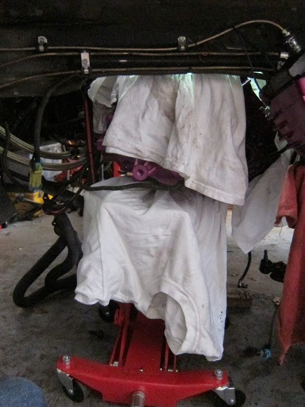

In May I finally got the car up on truck jack stands, transmission dropped, and took measurements to verify that the hydraulic throw out bearing was not over extending. The measurements checked out ok. (recap - HOTB was leaking from either over extension, bleeding incorrectly, or from the trans sitting in storage for a long period of time?)
With the Spec HTOB spacer installed on a new HTOB:
Fully extended: 2.51" to engine/trans mounting face
Fully compressed: 3.395" to the engine/trans mounting face
Both measurements above were taken with the bleeder screw portion of the clutch line installed and bleeder open.
Distance from the engine/trans mounting face to the pressure plate fingers: 3.26"
So, clutch disengagement happens almost immediately in the HTOB stroke. Or after 3.395-3.26= 0.135" into it's stroke.

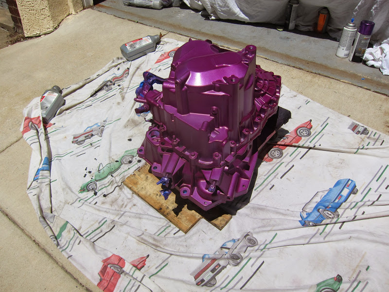

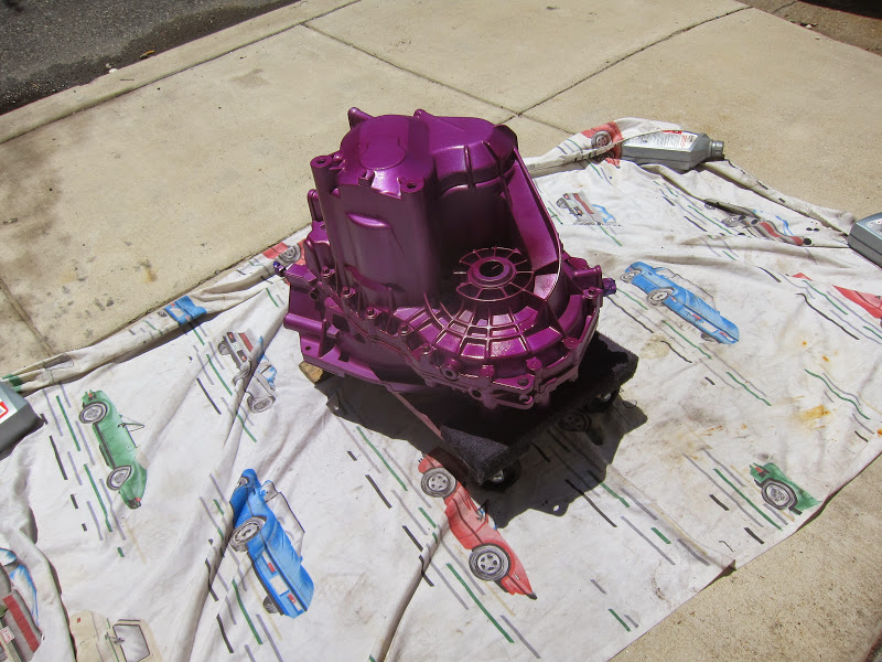

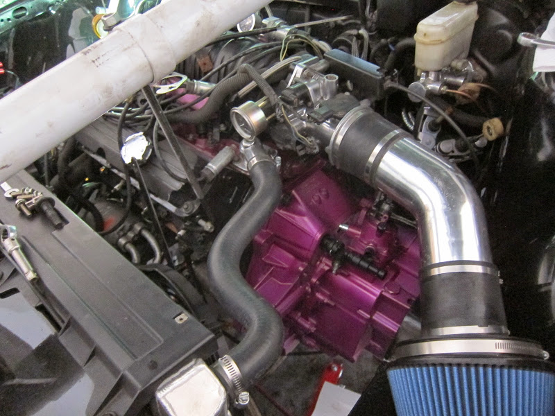

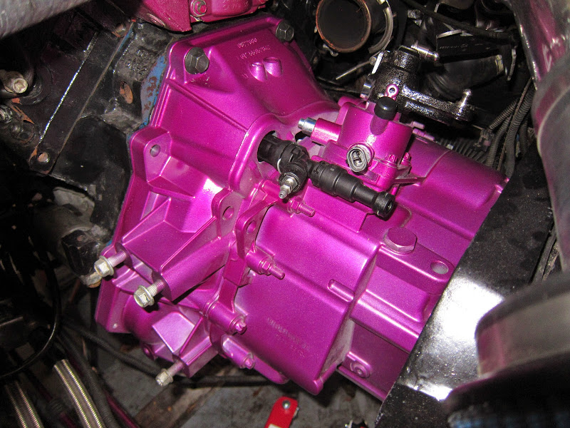

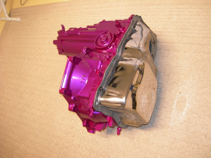

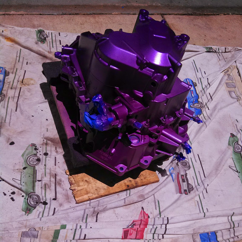

The plan always was to paint the trans similar to the auto trans I had previously:
Man, I miss having a shiny side cover..
With the trans out to replace the hydraulic throw out bearing, there was no excuse not to:
Like the first, the color is a bit odd to catch on camera. It doesn't flop and it's very close to anodized purple.
And it's back on the road!

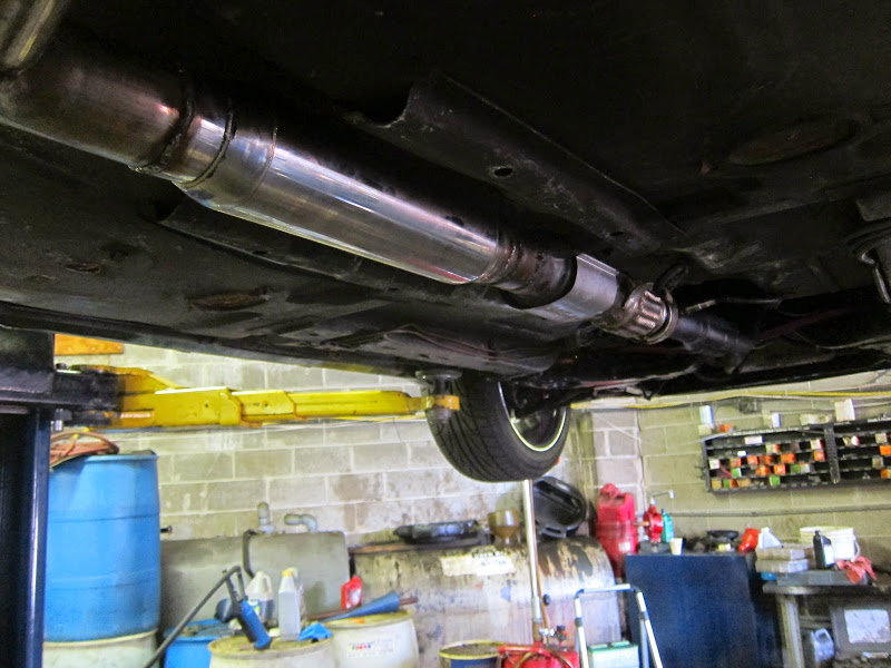

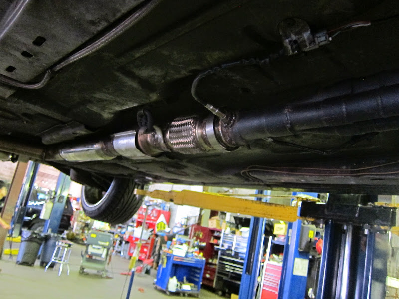

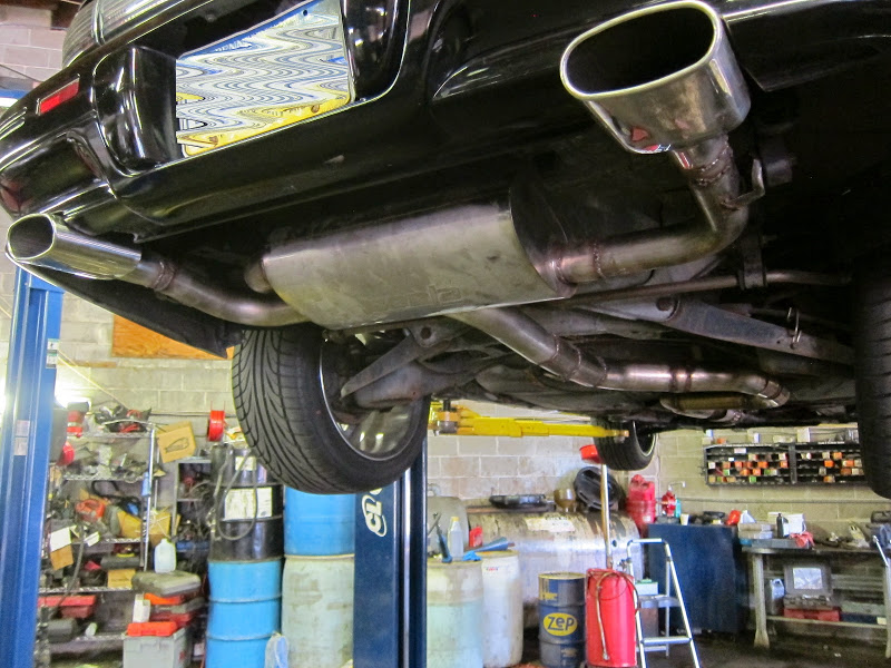

While there, I was able to weld in a resonator I bought last year. I needed to center the exhaust better in the rear tunnel to gain clearance for the the resonator. The tips also needed some clearancing and work to get them lined up perfect in the bumper cut outs. The tone is a bit tamer but there's still rasp at high load/rpm. At this point, I think I can live with it. lol..
At least there was some progress today. There were quite a few tuning heads while driving it too.

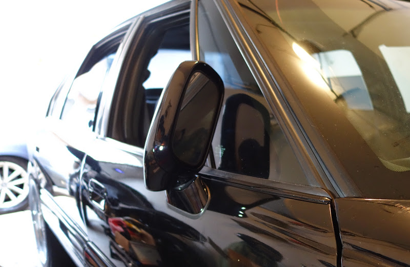

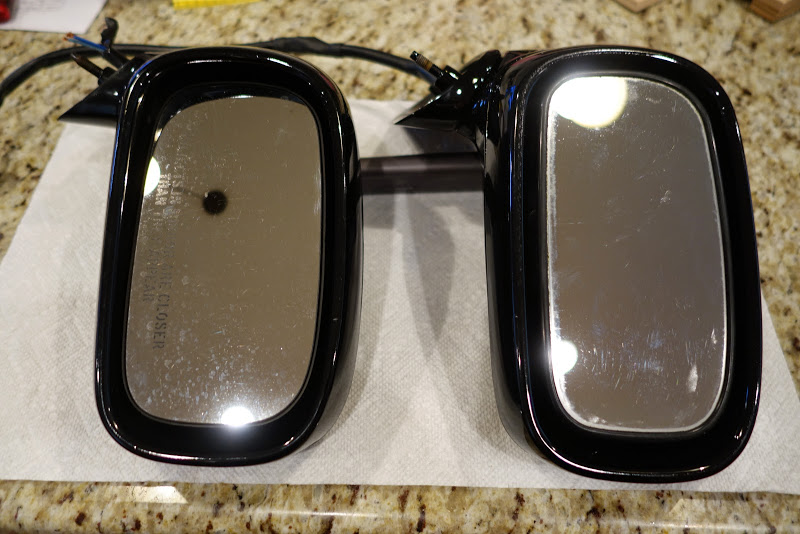

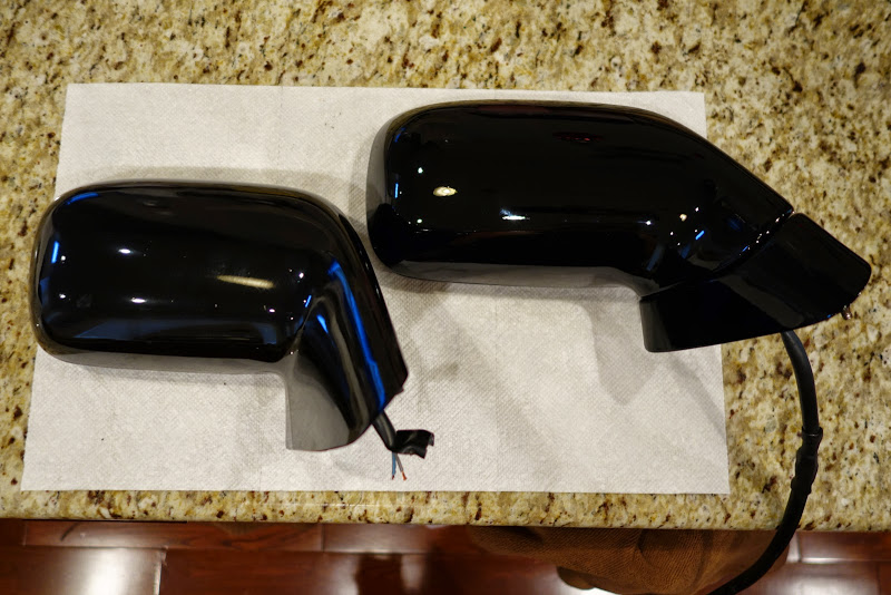

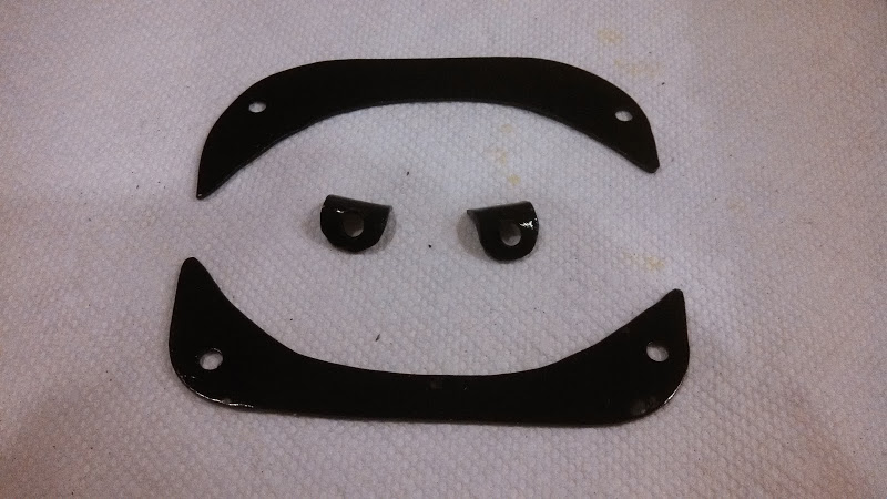

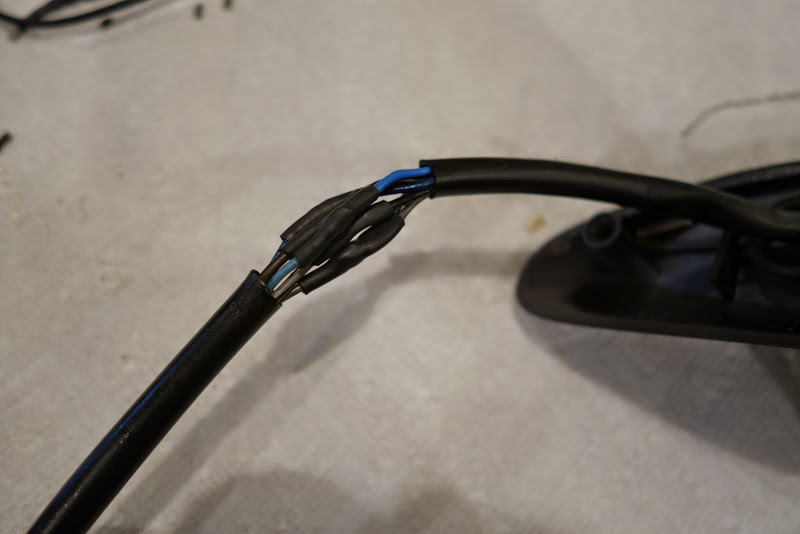

I haven't done as much as I would like the past few months but I was able to get a set of euro folding mirrors (RPO DD9) painted, wired, and installed.
A while back on another forum I saw an overseas member had bought a donor 92' SSE/i with the euro export package and was going to junk the car once the drivetrain was pulled. I immediately pm'd asking to buy the mirrors. I made an offer without any detailed pics of the condition figuring anything cosmetic could be fixed. The deal took a while to materialize but the mirrors arrived a few months ago.

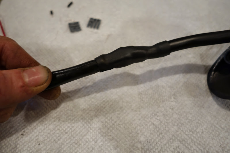

The connectors were cut, 3/4 studs were missing, there were dremel grinding marks, and the paint was faded past the clear. So, they weren't in the best shape but I was more concerned with seizing the opportunity vs. condition at time for purchase.
I had my painter buddy repair the dremel marks with plastic filler and paint them with the same Black Onyx 202 paint code as the body. Since they were off a SSE/i, I knew they were going to have a heater circuit but didn't know about the memory function. My non-heated, non-memory, power SLE mirrors have a 3 wire connector and the new DD9's come with a 6 wire connector. For whatever reason the wiring diagram for the power function was missing from my FSM.. Three of the 6 wires matched the colors on the SLE mirror (grey, dark blue, light blue), and there was continuity between 2 of the remaining wires (heater circuit).This only left one wire remaining (green). Next I used a 12v power supply to verify the heater circuit worked. Both did. Then I compared the power vs function of the 3 similarly colored wires between the DD9 and SLE mirrors. Some of the fuctions were the same between the two but not all worked on the DD9. I figured since theere was only one wire remaining on the DD9, it needed to be grounded/powered by at least 2 of the other 3. Turns out if I coupled the grey and the green wire, the DD9 functioned the same as the SLE's. I also decided to extended the heater wires down to the connector so I can add this function later without removing the mirrors. All wires were soldered and epoxy lined shrink tubed.
And here's the folding action:
>http://youtu.be/L2Auzc7rojU
As far as I know I'm the only one in North America with a set of these.
