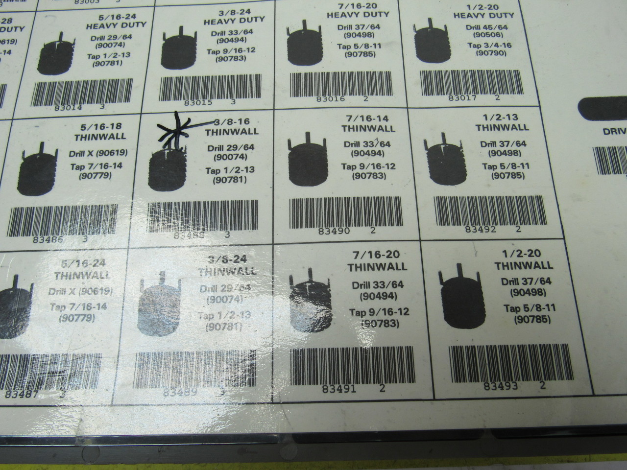

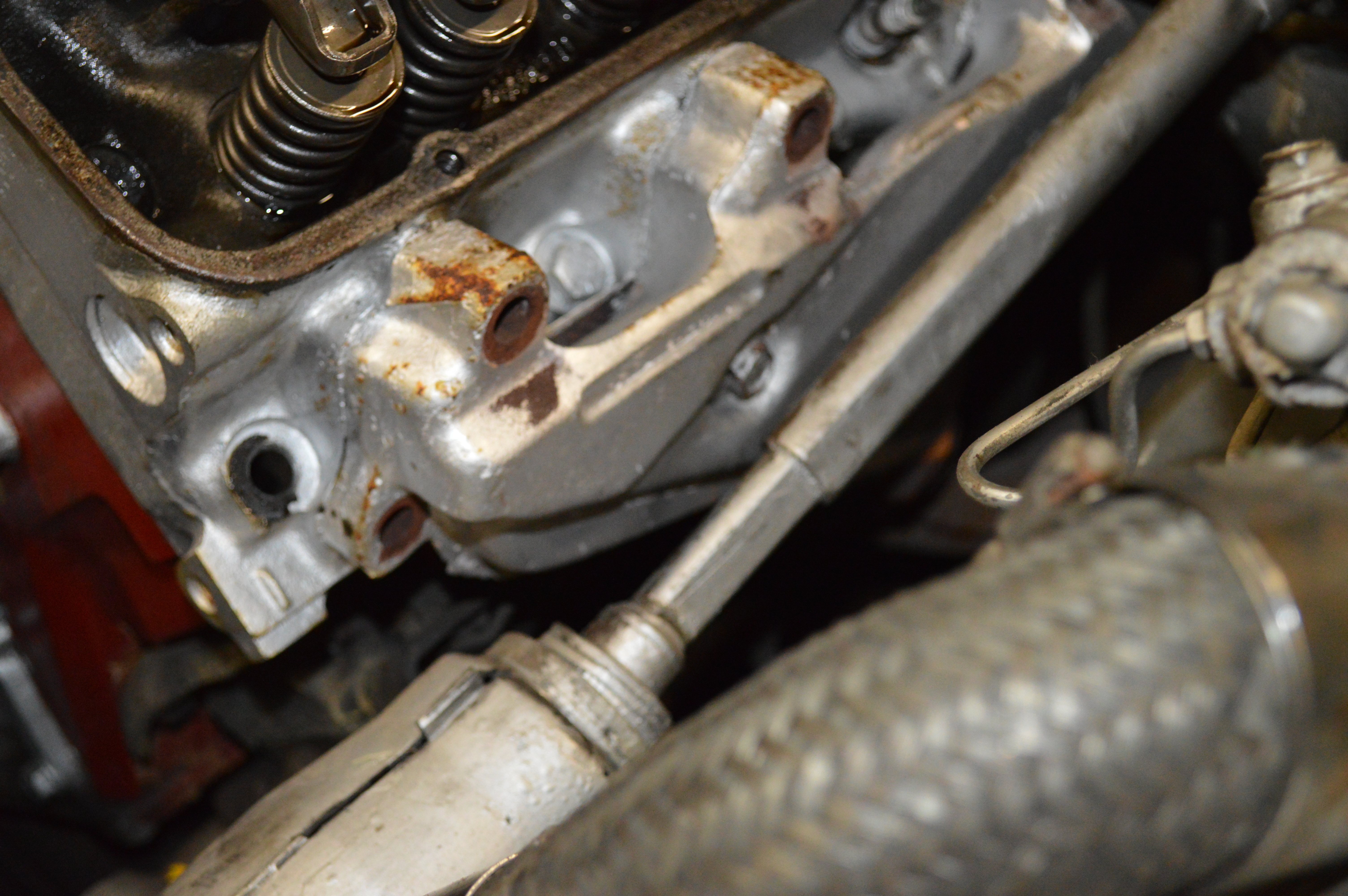

Ok, it’s the bottom pivot bolt that treads into the cylinder head, right? If so look at keensert. They will work better than a helicoil for your issue. Do you now have the broken bolt out of the head now. Let me know if this is right. If it is I’ll explain further.
Oh last Indian ! Your going to have to educate me on what a keensert is
i have never heard of them !!

Hole is now larger than the bolt that broke. It will drop right in. Picked up what I thought was the next size drill bit, but appears to be the same size.  Now the next size tap in my set will not drop in the hole, but as it's elongated, i don't know if the tap would cut in straight or not.  LMAO, I could always swap the heads from side to side putting the bad bolt hole in the back.  So much going on.  Daughters wedding is coming up,  we all meet up at the cabin for the 4th every year.  So was up for memorial day weekend cut the lawn (broke my riding mower)  then my generator gave up and to finish it all off, broke the chain on my chainsaw.  So funds went towards new generator.  Worked on the GTO for many hours N gave up.  Like you spreading myself too thin.  Got the boat out N had to do a bunch on that to get er to run.  Stuck to the house since Sunday waiting on a well service.  Need to make the week long stay N toys work.  Then home to Aho N elbo on the GTO for the next Pontiac show.  They have had my block for the Sunbird for 2 weeks now N haven't heard a word.  That needs to be on the road for the Dream cruise in Aug.
  Never heard of keensert?   Hell, never used a Heli coil.  Can my local shop order keensert?

https://www.mfsupply.com/Keenserts-for-Manufacturers-s/2062.htm
Keensert come in a lot of different sizes. Here’s a small example.
https://www.mfsupply.com/keenserts-metric-keylocking-inserts-s/2050.htm

Great news! There are a lot of different keensert, thin wall, heavy wall, metric, American std. etc.

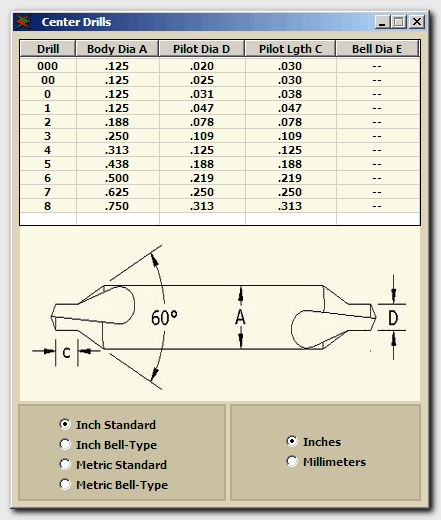

JustA, you know what a center drill is right? You might find a center drill that has a O.D. That won’t make the hole to big, but is big enough to straighten out the oblong hole. You will need to remove the small starter tip drill of the center drill though. Are you confused yet.

Have seen them when working at the Beechcraft dealer at Oakland Pontiac airport.  Thought they were cool til I heard the price waaay back when.  Have never seen them since.  Been thinkin of making a plate, using the other 2 bolt holes on the head,  then welding a nut to fit the tap, over the screwed up hole.  Run the tap down through the nut.  Thinkkin it Should hold it straight on N maybe counter the DRIFT from the oblong??? If I can tap the hole as it is, I can pull the spacer out of the alternator pivot hole and NOT have to drill the alt case any larger.  Actually the chrome alt is off the Sunbird N I really don't wanna screw it up.  Made the 421 look sooo much better than the old spare cast alt case.

JustA, center drills are cheap. Refresh my memory, what size is the stock bolt for the alternator pivot? 3/8-16?  If so you would need a #5 center drill. The body of that #5 center drill is 7/16 or .4375! You would need to install a 73061 Keysert not a keensert, while they are the same functionally Keyserts are cheaper & will work well enough for what you need. A #73061 keysert has a outside thread of 1/2-13 & needs a 29/64, .4531 tap drill which is close enough to a #5 center drill body size of .4375.
If you go to a machinery supply shop by you, one that sell end mills taps, lathe bits, etc, etc. they should sell both the center drill & keysert. You do not need the installation tool they use for the keysert, just a flat piece of metal will work.
https://www.howmet.com/fastening_systems/industrial/catalog/brochures/Keysert_and_Keenserts_Catalog.pdf
in the above picture, D is the portion of the center drill you need to remove, aka dried of, as you don’t need to drill any deeper into the cylinder head.
P.S. the plate idea might work, but if you go that route you might consider this. Tap the plate for the bolt, but instead of a bolt make it a stud. Align everything as you need, than when done, if you can & since I can’t see the setup maybe you can, take it apart leaving that stud in place & weld it in place to the plate. So you would actually slide the alternator over the stud, install a washer & nut. JustA though!

Got it buddy.  Tapped out to 7/16, had to destroy another tap N grind down the ramp to get to threads and go a lil deeper in the 1 in hole.  Worked perfect.   Seems the alternator had insert tubes.  Popped them out and it fits the 7/16 perfectly.  Made the show yesterday and had a blast with Frosty, Indy and my daughter (justaG6) and her fiancé.  She's gonna make a carguy outta him yet!!

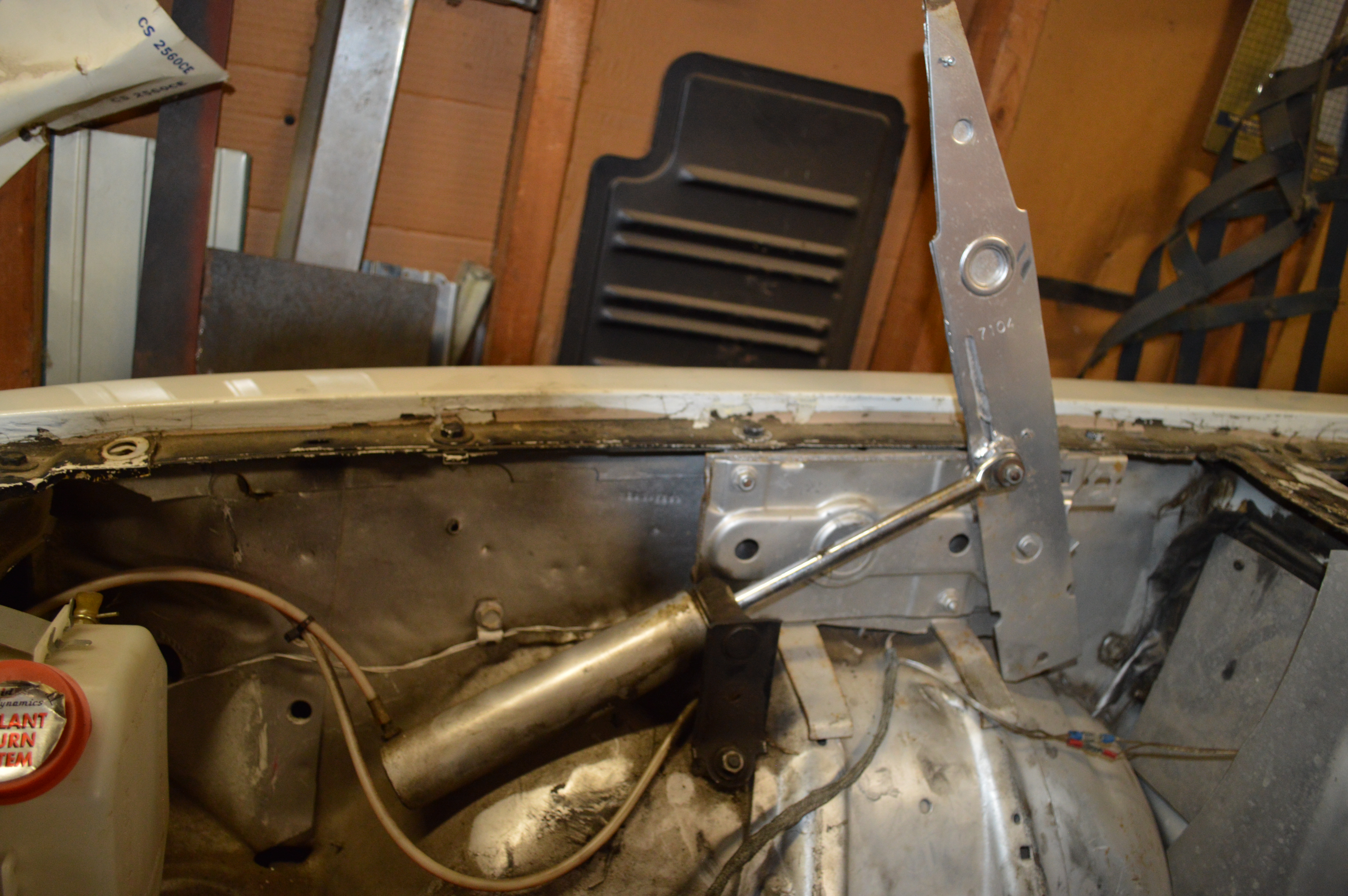

Went to adjust the rear view outside mirror on the GTO as I was leaving for the show yesterday and it broke off right in my hand.  Never realized how much I use that mirror.  I'm done for tonight, quit before I get real mad N do something stupid that will hurt my wallet.
haha, mate !!!! that reminds me of when i went to press the horn ring on my 59 caddy and it snapped clean off !!.. and they are $1500 bucks to replace ! AND thats usd ! not kiwi coins !:rofl:
Thats an epic parts fail......  I wanted mirrors on both sides so I ordered one years ago.  It didn't match so I sent it back.  It wasn't tall enough.  It's hard to see with one I have but sure miss it when it's gone.  They are now double the price.:badGT:
