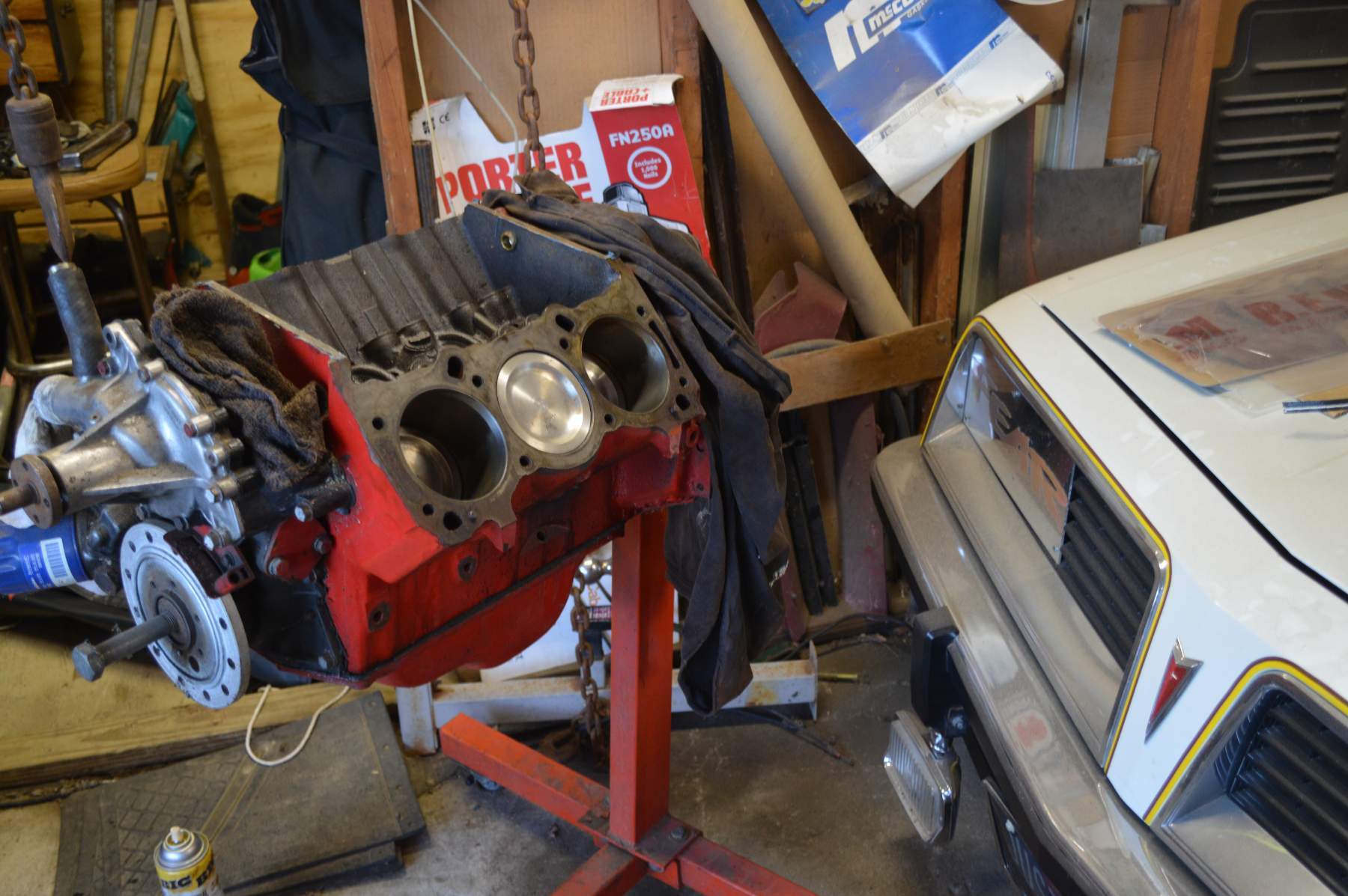

So waaay back in 96, I was building the spare motor for the Sunbird, (this one was on the stand)  putting all my performance parts into one 231 V6 and to run my 4:71 blower.  Motor in the car was using factory turbo parts that would hold up to the Blower boost.  My son's buddy opened his engine shop and offered to use his business discounts for the engine gasket kits, bearings, timing chain/gears, mounting my new forged slugs on my 252 turbo rods, 252 turbo crank and Mich Clevite bearing only go in this beast.  And he offered to degree the Kenne Bell cam and new hyd lifters. BIG discount on the work and parts if I advertized his business on my signage at shows...No Prob!   I wrote in the middle of the work order Mich engine bearings ONLY.
So I pick it up.....Engine gasket set is half there, (like he used 1/2 on another customer) He put TRW bearings in the damn thing, did not coat it and everything from cyls to the exposed parts of the crank were rusted.  Even the box of lifters were all open. Charged me more than the shop my son was working at.  Worst was I had no plans to let anyone touch my motor!

Sorry the saga continues.  Wasn't able to continue with the story last night.  Your not gonna believe what I found while tearing the motor down last night.  Busy til this afternoon and will update then.

continued....  So I finished assembly of the motor, painted and dropped er in the car as I'm now Justa hours away from our car clubs last show. 10 year run with Radical Rides.  Over 45 shows produced, waaay to many cruise nights put on for many different businesses.  Slightly over $118,000.00 raised for charity's.  Blew up the motor leaving our last club meeting. Blocked the road to let each one of us out for a LIL display of power.  Came home and pulled that junk and installed the new one.
So I fire it up, idles like a champ, set the distributor and clamp er down.  Went to pull the car out to the driveway and get a knock about 1500 rpm.  Back off and it's fine.  Rev it...knocks.  I'm angry.... thinkin it's maybe the cam bearings (not only being wrong brand that are proven to fail) installed without aligning the oil passage.  Shut it off and push it inside. It did clunk and dead stop. This block with all my power goodies has sat on a stand since July of 96.
At work the next day a buddy said he had a turbo motor he would sell me.  Was there that night to pick it up, we stripped all the turbo stuff, intake, exhaust, ect. This was a Friday night.  I spent that whole night cleaning, painting and dropped the block in the car.  Now my blower intake will NOT fit this engine...WTF?  I have a 79 N up even fire.  Heads have the wrong angle to the ports.  In desperation, I pulled the heads off the new knocking motor on the stand.  Water jackets will not line up, Head gaskets have the oil return blocked off.  Here is where I became the biggest fan of JB WELD.   Blocked the water jacket with JB and then reground to match the NEW heads.  Cut down the head gasket a bit for the oil return, then JB'ed tha passage and reground to what I needed. As a last desperate act.....yep I JB'ed the whole dam head gasket to the engine and the heads.  In the end, worked my ass off N my Sunbird did not make the last show and completely broke my heart.
Now got the JUNK motor to fire, scared shitless to jump on it at all, but after driving for a bit.  No heat issues,  wouldn't think of a burnout, BUT  sure still likes to light up 2nd and 3rd on the shifts.  Guys N gals  this motor lasted til Dream Cruise 2018  and it's demise came after a burnout (I knew better...BUT)  burned out a piston and the blowby smoke was terrible on the way home, esp when I had to stop for lights.  But cha know the Ol girl got me home and will still fire up now
Is this a progressive post?  or a cheap novel??
So the GTO has INS until the 1st of June so I can still get some seat time.  But any $$$ goes into the Bird to get er back on the road.  Had to move a bunch of stuff to dig out the ol broken motor with all my good parts, drag it over to a point where I could lift er up and get it on a stand.

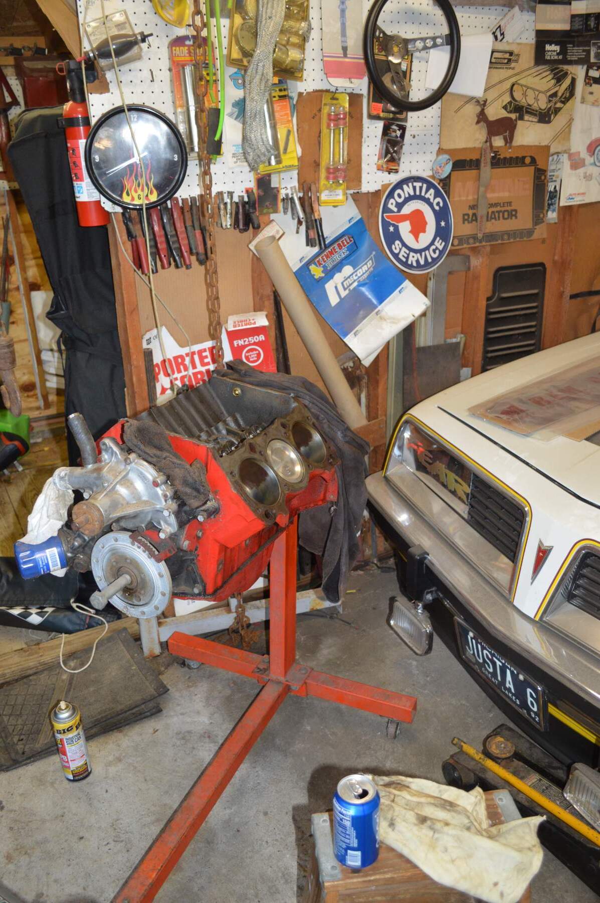

Pulled the junk heads N intake I used to protect my cyls only to realize they did not seal.  You can see the rust in the CYL.  SO I took PB BLASTER penetrating oil, hosed it down and then used 1500 colorsand With a LIL work, rust is coming off no problems and a quick hone when I get the slugs out will finish the restore.

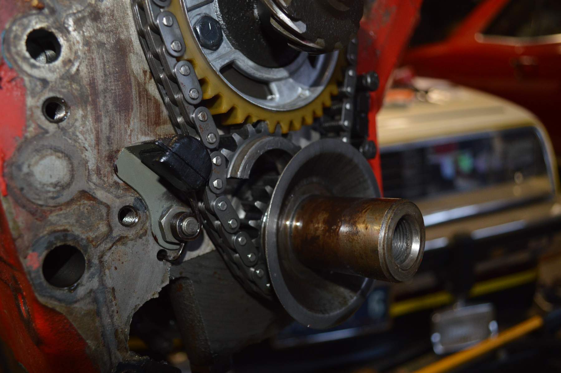

So yesterday, I drained the oil, dropped the pan, Pulled the harmonic balancer  Pulled the water pump, timing cover and WTF????  Never seen this before.
Snapped the brand new crank gear in HALF.   Good thing I never tried to start that thang again. Would have destroyed my new FORGED pistons.  Hoping the Kenne Bell custom cam is still OK, Kenne Bell is long gone but not forgotten and I still have to find the knock.    Ok  progression thread up to date.   OK really??  Like you had something else better to do than read this???  :pop_corn:

Actually it's ancient history.  Hate to be screwed, but that Ol half a$$, JB welded motor lasting all those years is simply priceless.   If I could stick another piston in from the bottom, who knows how much longer that thing would run. You will never get the heads off. 😎 Miles of smiles N black marks on Woodward. :driving:

That's a good story, JustA although gut wrenching. Never mind - gotta move forward. I didn't think you could ever snap a crank gear - a faulty casting (or forging) perhaps?

Ok, after cleaning up some of my mess, was wondering how N where to add the crank gear to my hall of fame, epic fail parts display.😎  So I've decided to share a couple.  Yes I will be starting a new thread for this one.

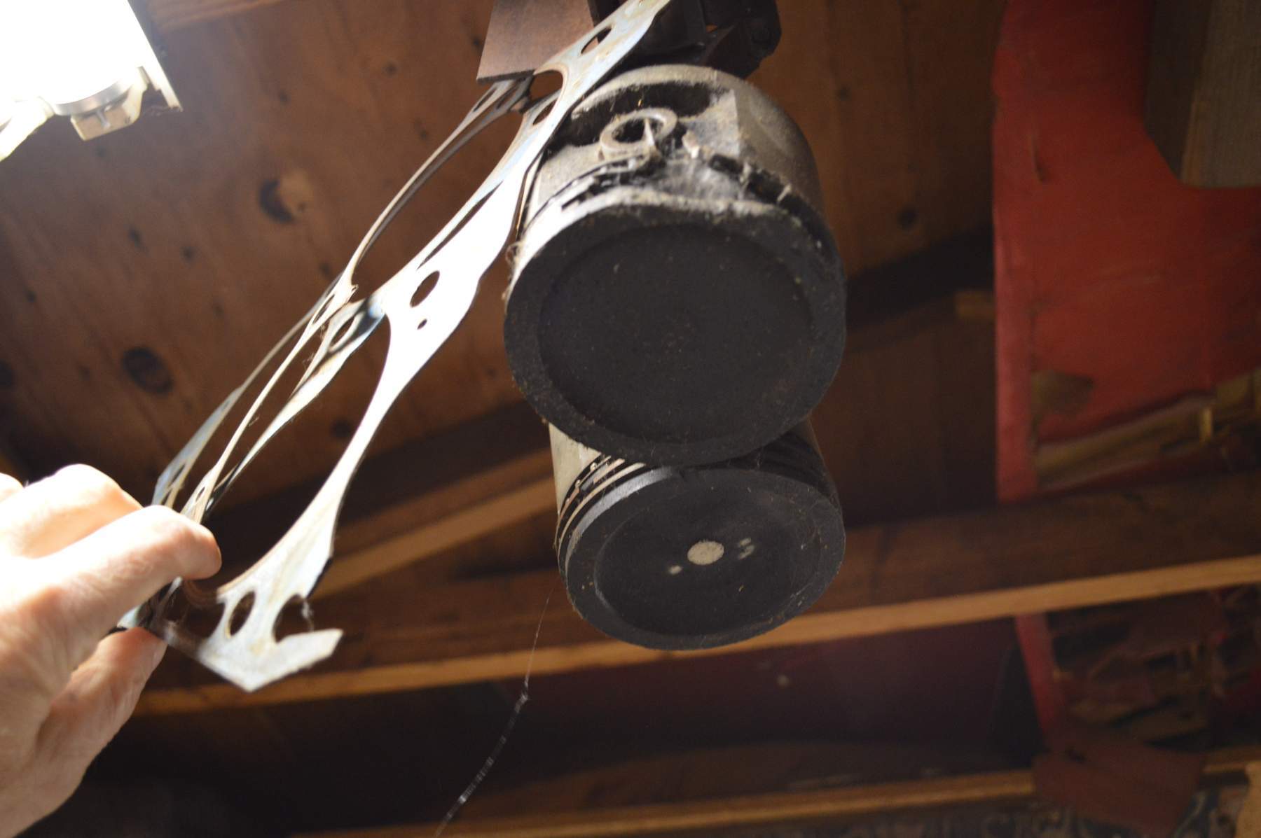

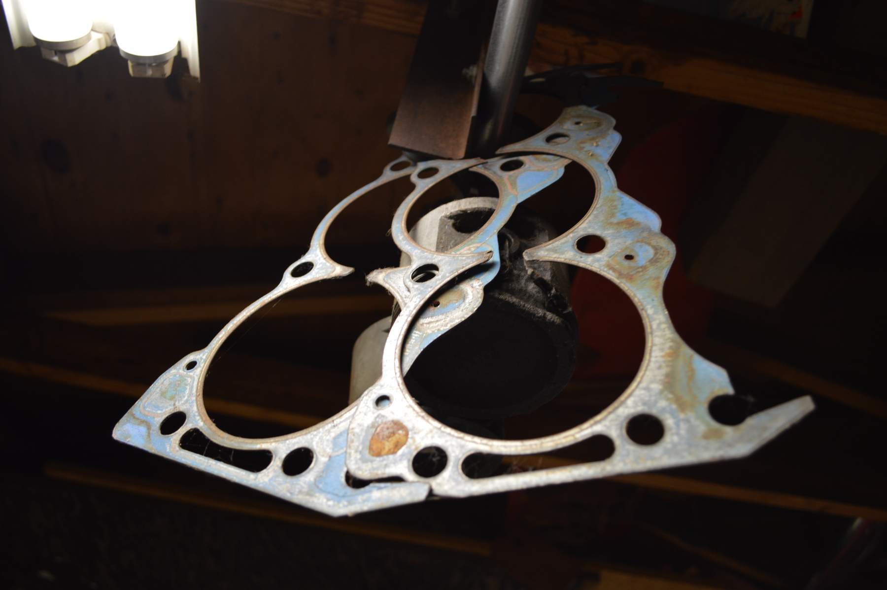

Hmmm an ol pair of head gaskets??  Look closer, I managed to equalize the pressure in all 6 cyls. burning out between them all.
Melted pistons anyone??

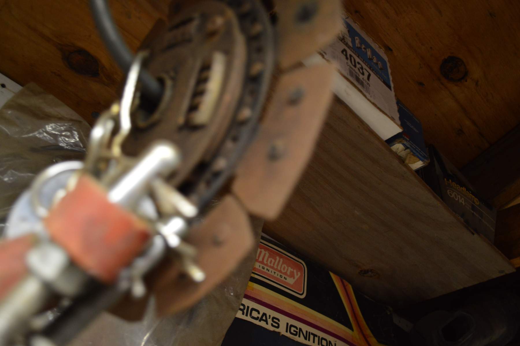

EPIC clutch disk, this is my wifes last stick shift.  Nothing left on the pad and I drove it in the garage to change!!!!!
Have not figured out how to display the crank gear yet.
So there are now only 4 engine shops anywhere near me.  All are swamped.  Was hoping to get my blocked tanked, cyl honed and clean all threaded holes with a tap before repainting and assembling my block.  NOBODY is even accepting new work.  One old friend will be on vacation for the 1st two weeks of June.  Said to be one of the 1st to contact him when he gets back.  At this pace, I might not have the car running for Woodward.  Want your numbers matching engine rebuilt???? Your on a 1 year waiting list.  On the plus side, they JUSTA graded my roads and finally put down cloride to keep the dust down.  Rained today and suppose to rain all day tomorrow.  Guess the GTO gets a reprieve and goes back on the road.
  • 4 weeks later...
Finally..... Dropped my block off 1st thing this AM when they opened for a hot tank, kiss the cyls with da hone and all new CORRECT bearings.  Ordered the whole engine gasket set and Blower rated head gaskets, and new timing chain N gear set.  Shop said they can have all parts in a couple days.  We will see.

Have no idea where I am in line.  Was happy they accepted the work at all.  I did ask for MICHIGAN Clevite bearings.  They are still out there, but are no longer produced.  Next choice is King bearings.  Racers choice usually speed shops can supply.  Learned from my son,  they may not make bearings for my V6.  Told the shop if all fails to use Clevite bearings (these are NOT Mich, but might have to do)  Worse case ....hand my parts back.  If they use TRW again,  they are buying the bearings NOT me.

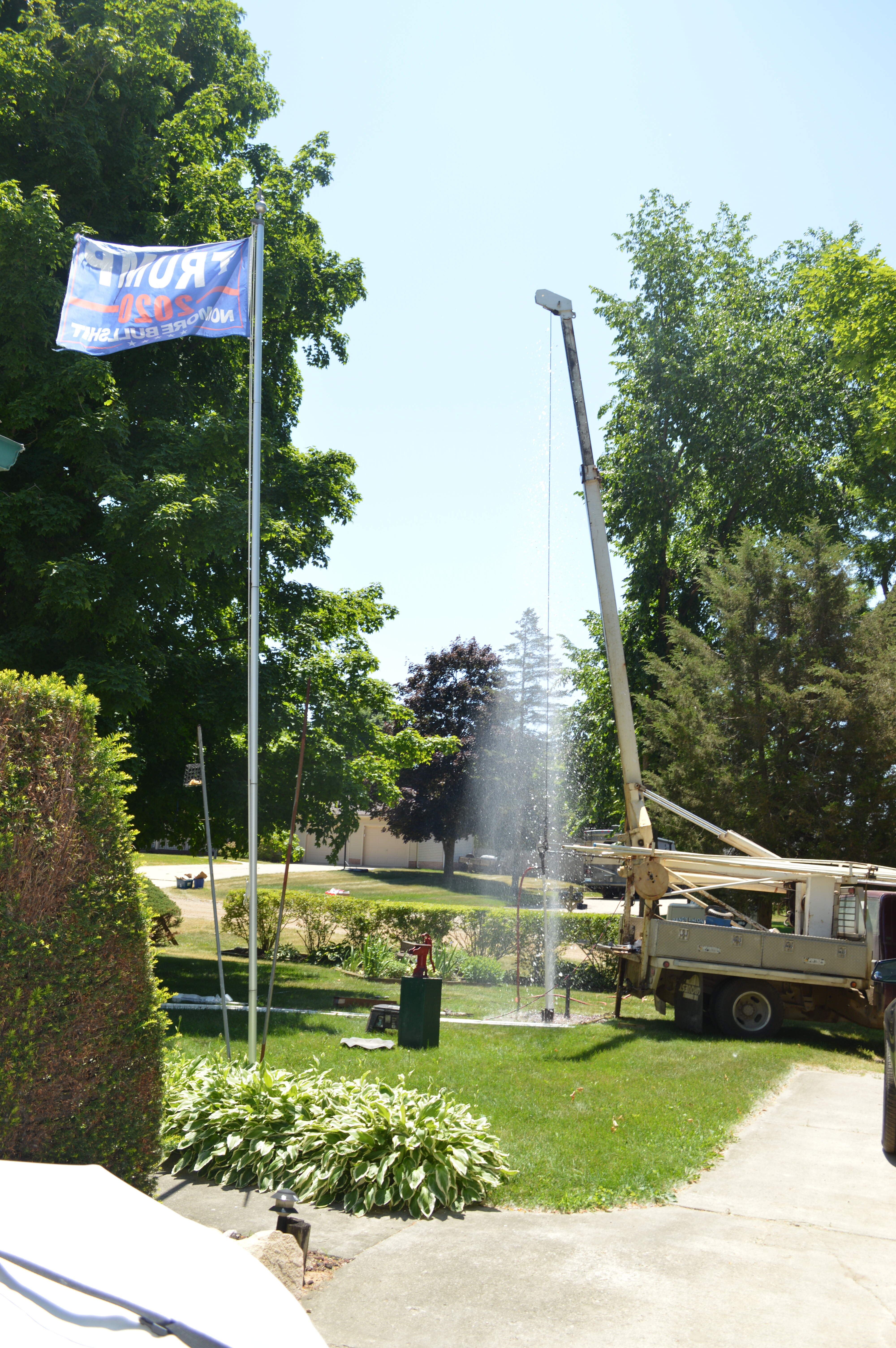

Well gave up Saturday evening.  Finally got a guy out today, New pump,  123 ft down, new pipe, new wiring, new pressure switch/gauge on the pressure tank.  Back flushed the well with his huge air compressor.  His boom was 35 ft tall.  Just left,  I need a freakin shower!!!  Have to run each faucet through the house 1st.
