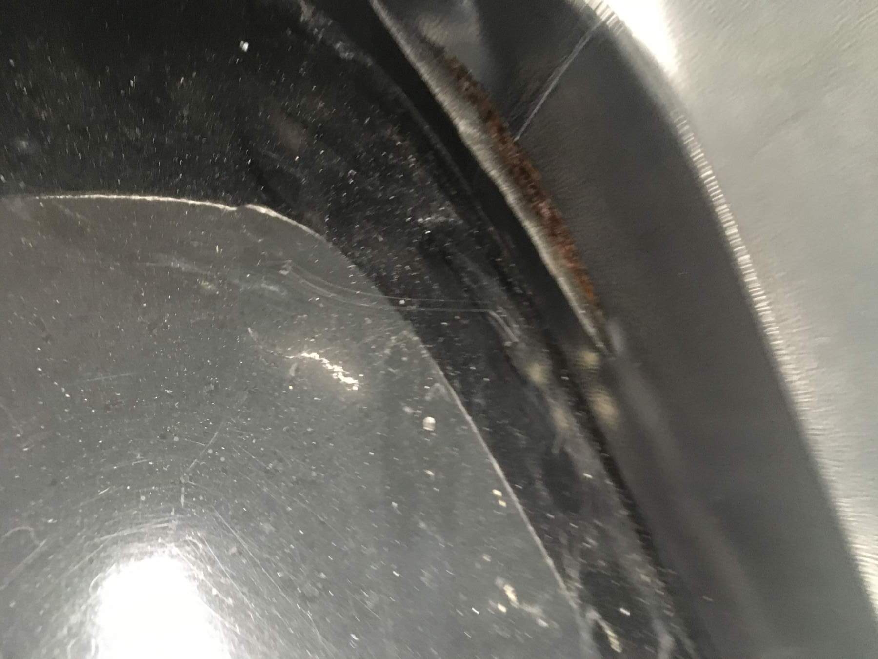

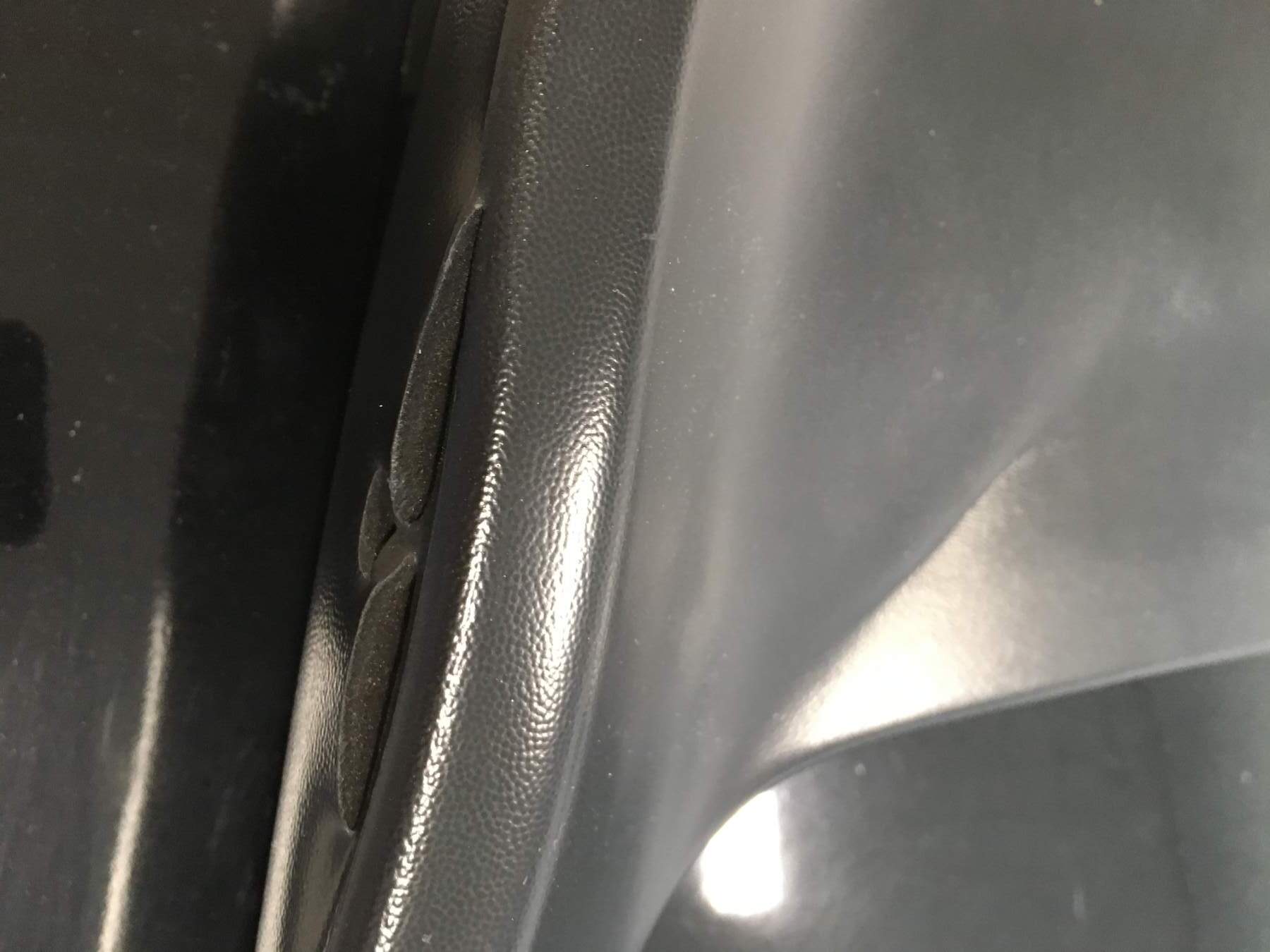

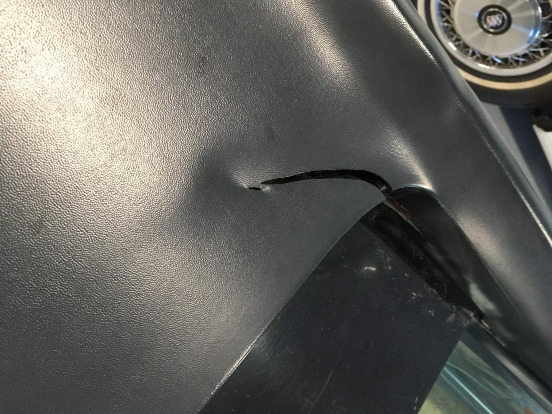

One of the first things that needs to be replaced on Black Beauty is the rear aero wing. For some silly reason, GM made these from a rubberised vinyl. Over time they are prone to spliting and cracking. Mine is no different. I purchased a fiberglass replacement from Hawk's Motorsports. It is suppose to be the best replacement on the market.
IMG_6981.thumb.JPG.9ccb773d416784b4ac2dea8b006664e0.JPGIMG_6982.thumb.JPG.206525c105af6f1b8240ef0c04ef5acd.JPGIMG_6983.thumb.JPG.fb155bb4a271177b551ffef3510bd9b3.JPG

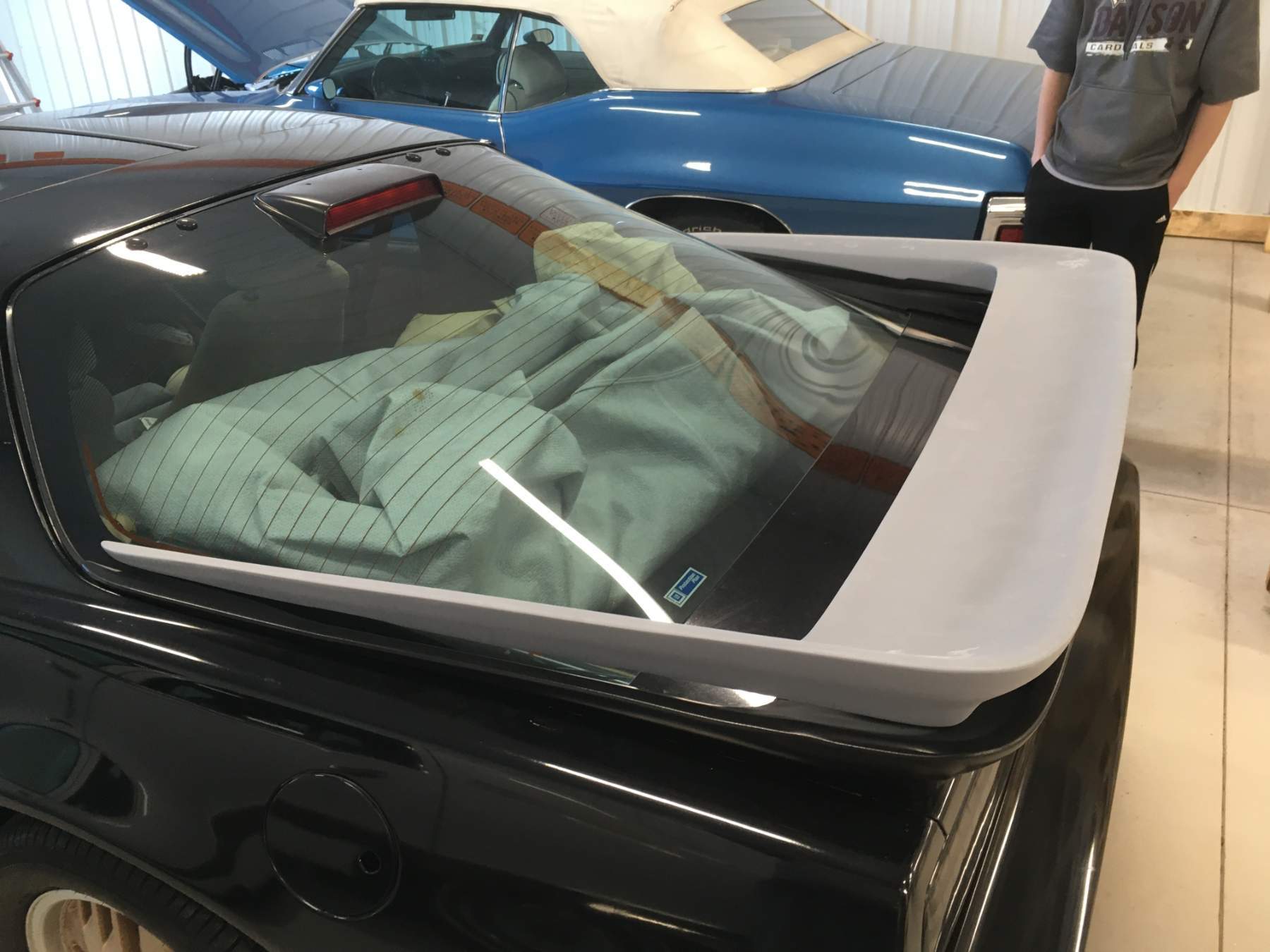

Here is the fiberglass lightly primered piece on top of the original.IMG_6980.thumb.JPG.13b69d4fd0ecd3d2c539c4c3ee9057fe.JPG

I would presume the selection of material for the spoiler was do to weight. The shear size of that piece on the hatch back could cause issues with staying up? You may need to upgrade the lift struts, time will tell.
