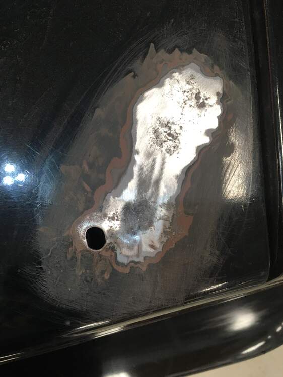

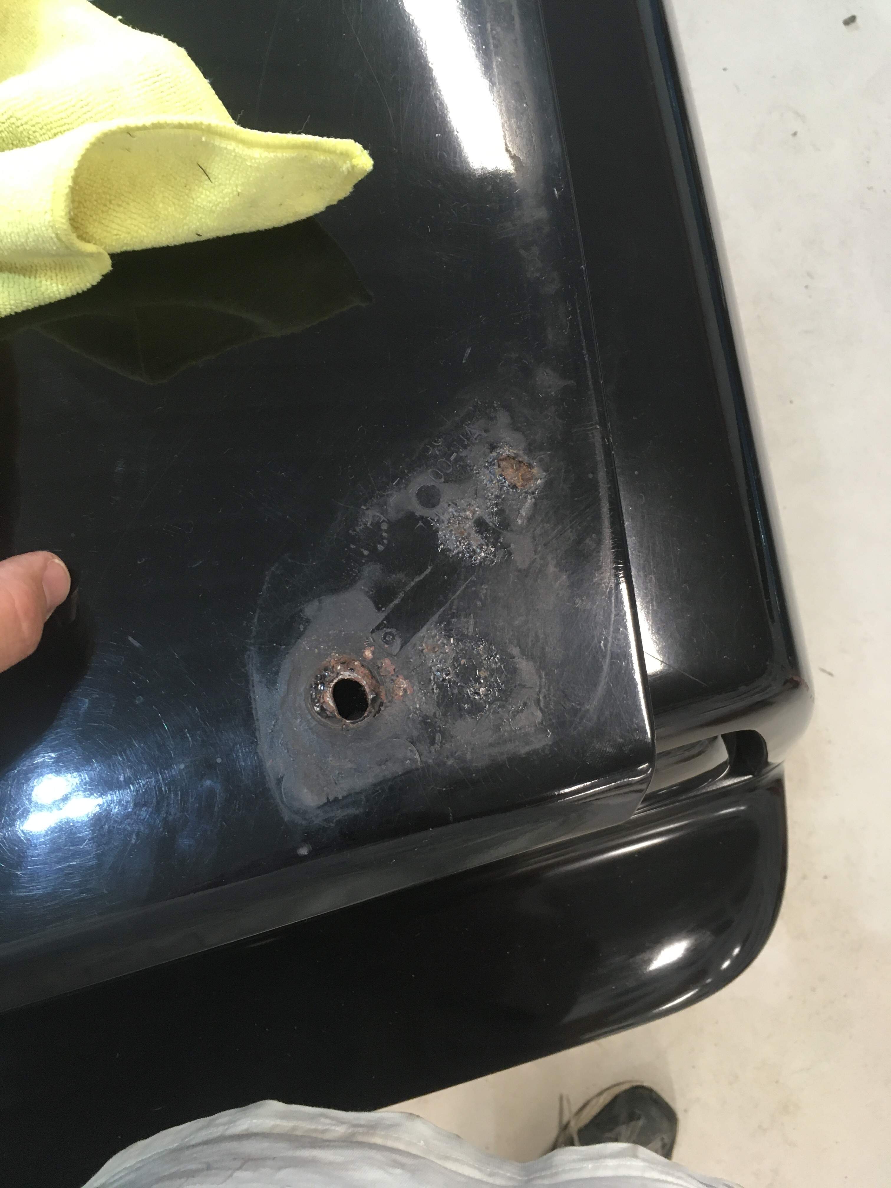

hmmm, i can see why it rusted, my though would be to make a gasket to go between the 2 surfaces to act as a seal ( out of a material like butynol sheet)
kind of like you would under a mirror on a fender, that way you can always remove it again, sealer will ceratinly work but it makes it really hard to ever remove again
 And maybe consider using stainless steel fixings :cheers:

Kiwi, at a minimum I was thinking of some sort of rubber gasket (old tire/bicycle inner tube).
Ah we are thinking the same thing mate 👍👍👍👍👍
But don’t use bike tube ! It will perish in no. Time ! Black roofing material will last better
kind of like you would under a mirror on a fender, that way you can always remove it again, sealer will certainly work but it makes it really hard to ever remove again

I would say this! You do need something that seals very well! I have installed a lot of spoilers over the years, both Camaros more than once, the Grand Prixs & the Lacrosses just to name a few. On the Camaros I used butyl rubber on top at the bolt hole & bolt, plus underneath at the bolt hole & around the nut. The Grand Prixs use a 3m double sided butyl sheet the shape of the pedestals & JustA is right! This stuff is a real headache to remove, but it’s really really almost impossible to get the damn spoiler off! I had to very carefully cut in between the spoiler & the deck lid to get it lose! All without harming the surface of either the spoiler or deck lid! But it really seals out the water, once the spoiler was of & everything was cleaned up it looked just like the day it was built! No rust, no dirt no nothing! Top or bottom! Silicone I never used so I can’t say. My two cents!

having said that,, frosty you can use neopreme too !
i justa like the fact your not bolting down something that can move around and dig into your paint, where as the gasket stops that :dancingpontiac:

Absolutely I forgot about the neoprene! I have this 1/16 thick neoprene sheet that I use for lots of part separation barrier on my cars! Especially like the old cars like my Camaros or your “64”. Anywhere body panels bolted together like lower quarter fender between the front fenders & the lower front valence panel or the upper header panel, etc… These panels usually start to rust or spew debris as time goes on because they actually start to rub back and forth because of body flex. This very thin neoprene I cut into a gasket to go in between stops that! And because it’s so thin you can’t see it. But you are right! It doesn’t stick & if you cut an accurate gasket it fits like a glove & seal out any water.

Neoprene is an interesting idea gents. I definitely want some sort of water resistant gasket between the new fiberglass spoiler and the painted trunked lid.
The problem with the stock spoiler is that it had some pre-punched holes in the gaskets, two for the bolt holes and two others on each side. Water got to the metal frame work of the spoiler through the vinyl rubber splitting and it rusted the frame work. It also allowed the water to seek the lowest point. So rusty water sat on top of the passenger side of the deck lid and eventually ate through the paint and metal. Any future gasket will will only have holes for the two bolt holes.

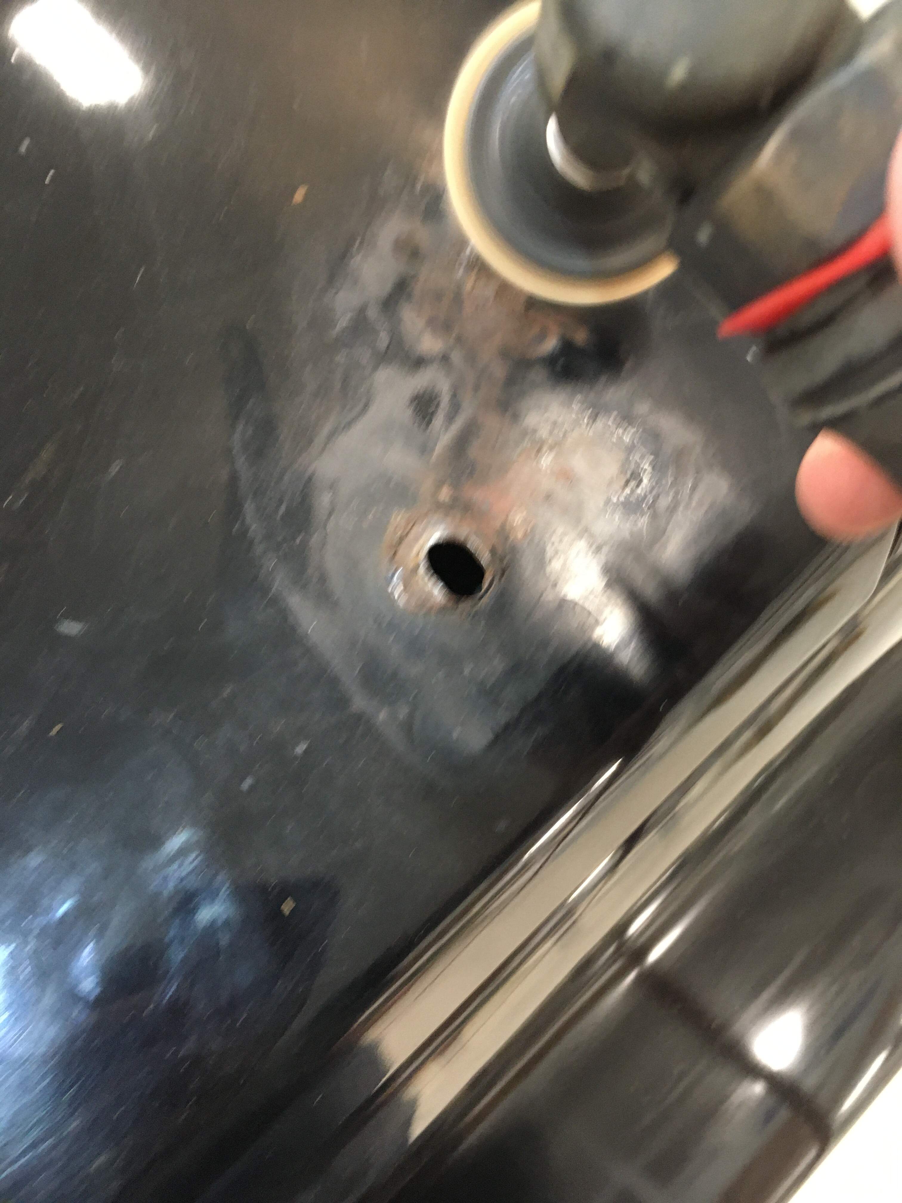

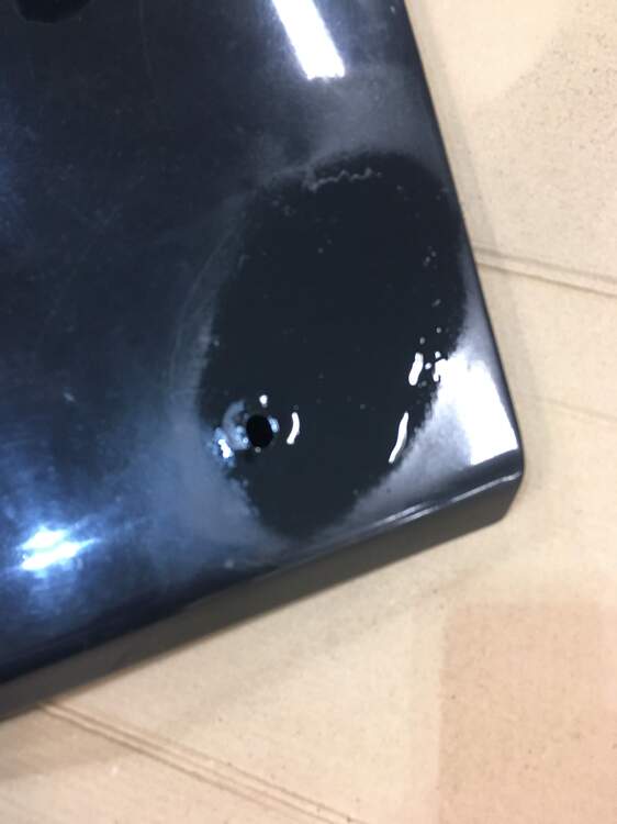

I spent some time yesterday grinding off the rust off the deck lid of Black Beauty. I used a compressed air grinder to strip off the rust and then some hand sandpaper to finer sand the bare metal. Lastly, once I was satisfied with bare metal, I sprayed some POR-15 direct-to-metal rust protection paint over the metal. I will let that stand for several days to let it dry completely before I start applying high build primer.
Here is the original surface rust once the spoiler was removed.
Starting to strip the paint and rust off with a grinding wheel.
Stripped to bare metal, you can see the pitting caused by the rust.
One coat of POR-15 direct-to-metal rust preventive paint later.
IMG_7807.thumb.JPG.e6faa6fbdb5b7fbe0a62538f06045f3e.JPGI
I will start building up with high build primer and blocking and sanding in a little while, once the POR-15 has thoroughly dried. It was a cold day when I applied this stuff, so I want to give plenty of time for it to cure.
