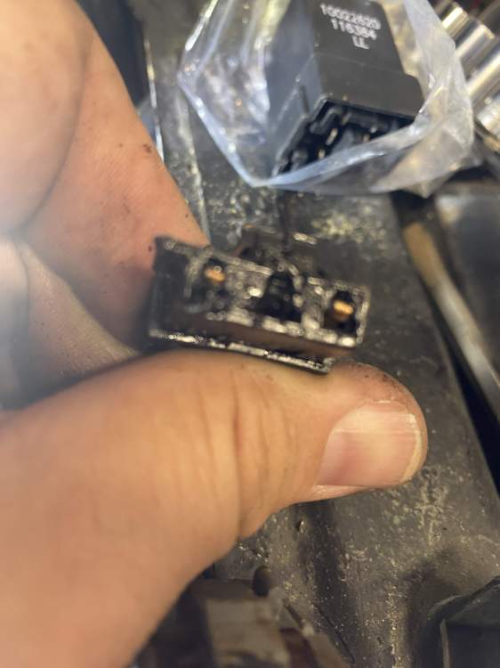

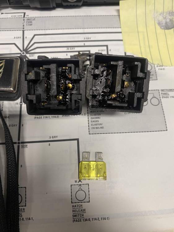

Today I made some progress. It’s the first free day I have had to even look at her. I started by pulling the headlight actuator relays. Thankfully I have a shop manual for BB, so it was easy to find them after looking in the book I pulled them both. Each one had a ton of black goo all over them and around the connections. I am hoping it is old dielectric grease and not something else. Regardless it was nasty cleaning up the relays and connections.
I swapped the two relays around and nothing improved. One won’t go up or down. The other comes up but won’t go down. So they are both bad for slightly different reasons.

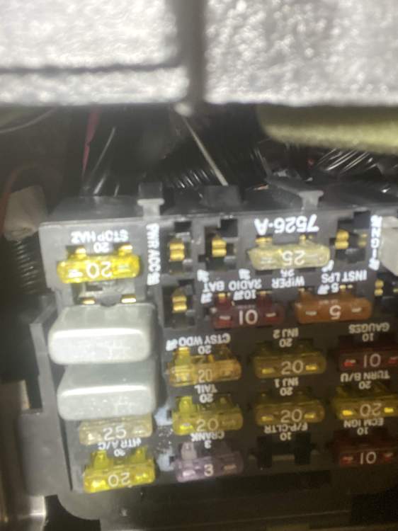

I turned my attention next to the fog/dash:running lights issue. I pulled off the fuse panel cover. If you think you need to be contortionist to look at your old A, B, or C body fuse panel, think again. On a 3rd gen Firebird, it is not on the firewall. Nope it’s under the dash face down. So now you have to be a full blown circus performer to get your head between the seat, dash and steering column, then turn onto your back and look up to see this…..
Fun huh? Yeah right…..

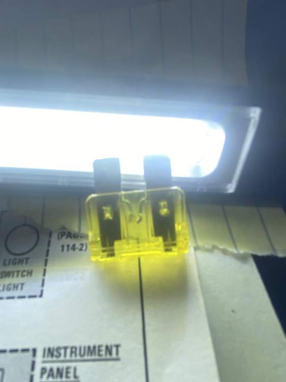

I took a chance and the first fuse I pulled was the 20 amp fuse for the tail lights. To my morbid delight, it was blown!

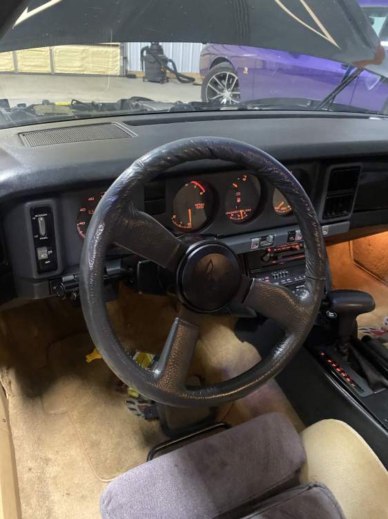

I grabbed a replacement fuse, put it in, reconnected the battery , and hit the light switch. My lights are back on!
Dash lights on!

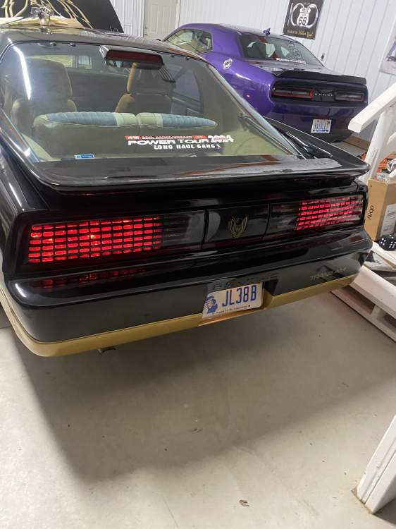

Fog lights on!

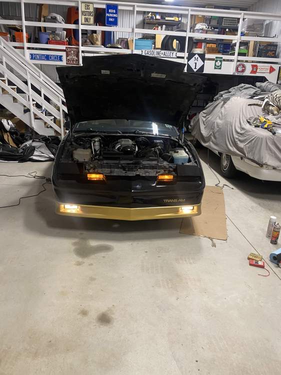

Good news and bad news. The new relays came today. I connected them and hit the light switch.
Both lights came up! Yeah!
I turned the lights off and only the driver side went down. Well sh*t!

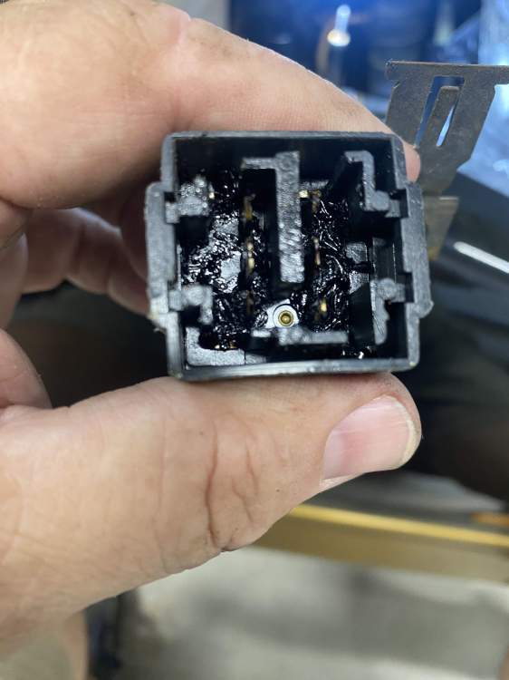

The isolation relay showed up on Monday. I finally got out to the garage mahal tonight. I found and pulled the isolation relay, cleaned out all the black gunk, plugged in the new relay and hit the switch. Nothing. Lights didn’t go up or down. Put the old one back in, they go up but not down! Well…..
I went home after that. I will do some more Google searching and reading the shop manual. It would an understatement to say that I am not happy.

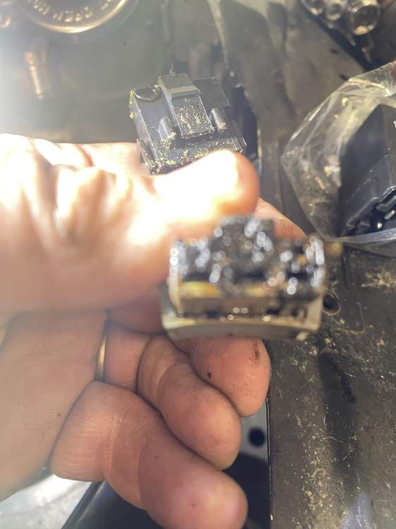

These are pictures of the isolation relay. I have started clean the black goo from the relay but the connectors still have it on there.
