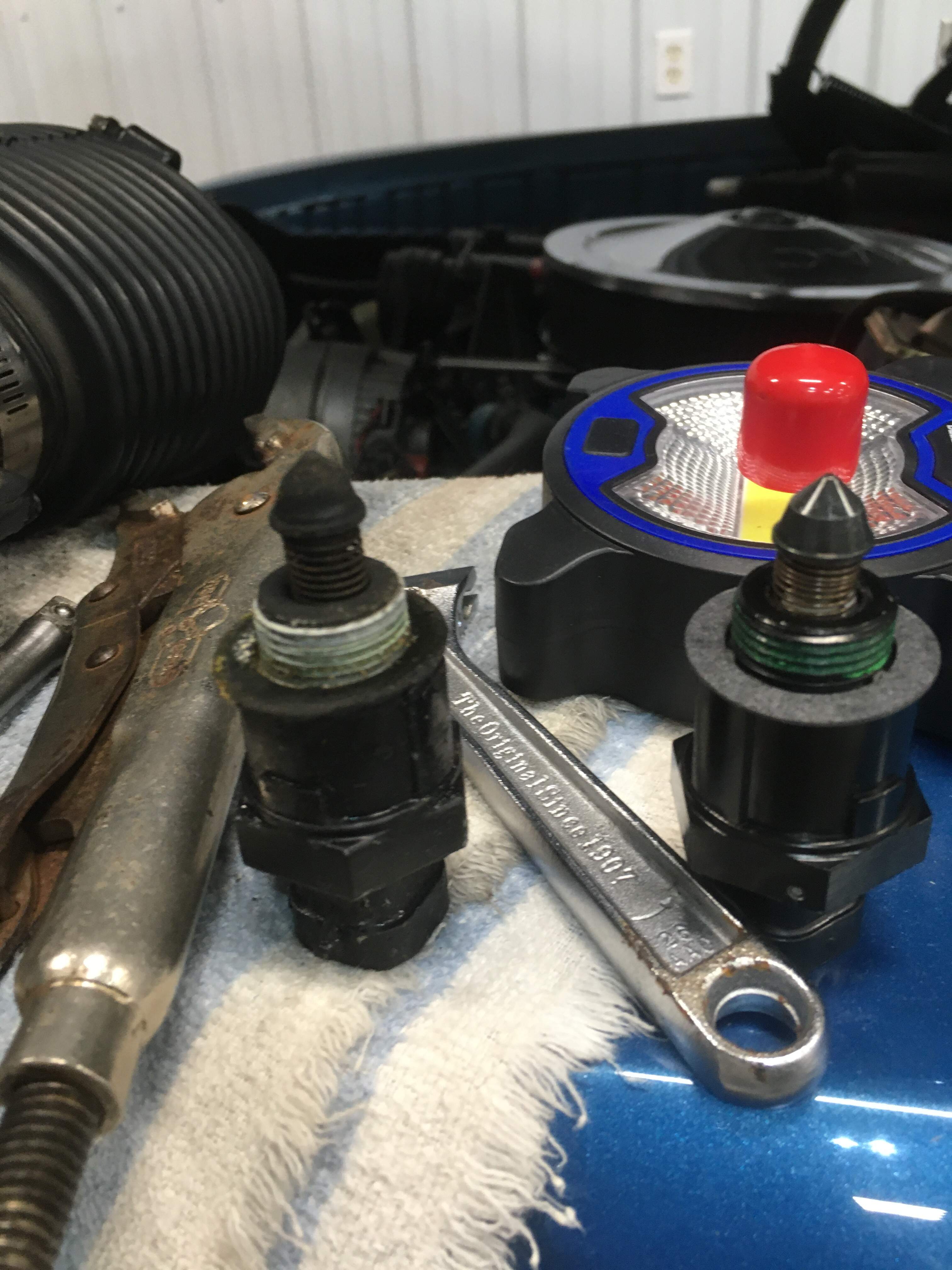

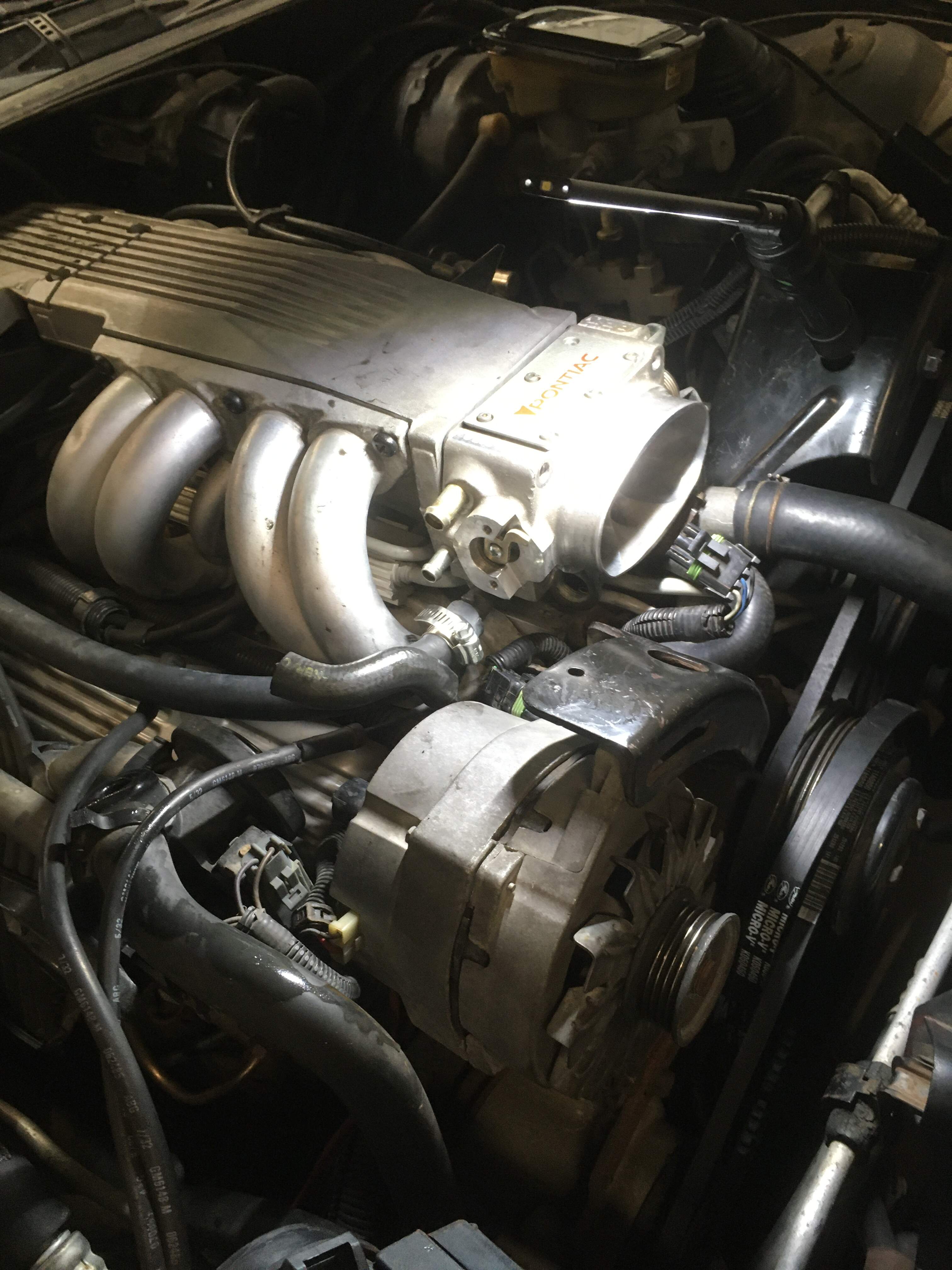

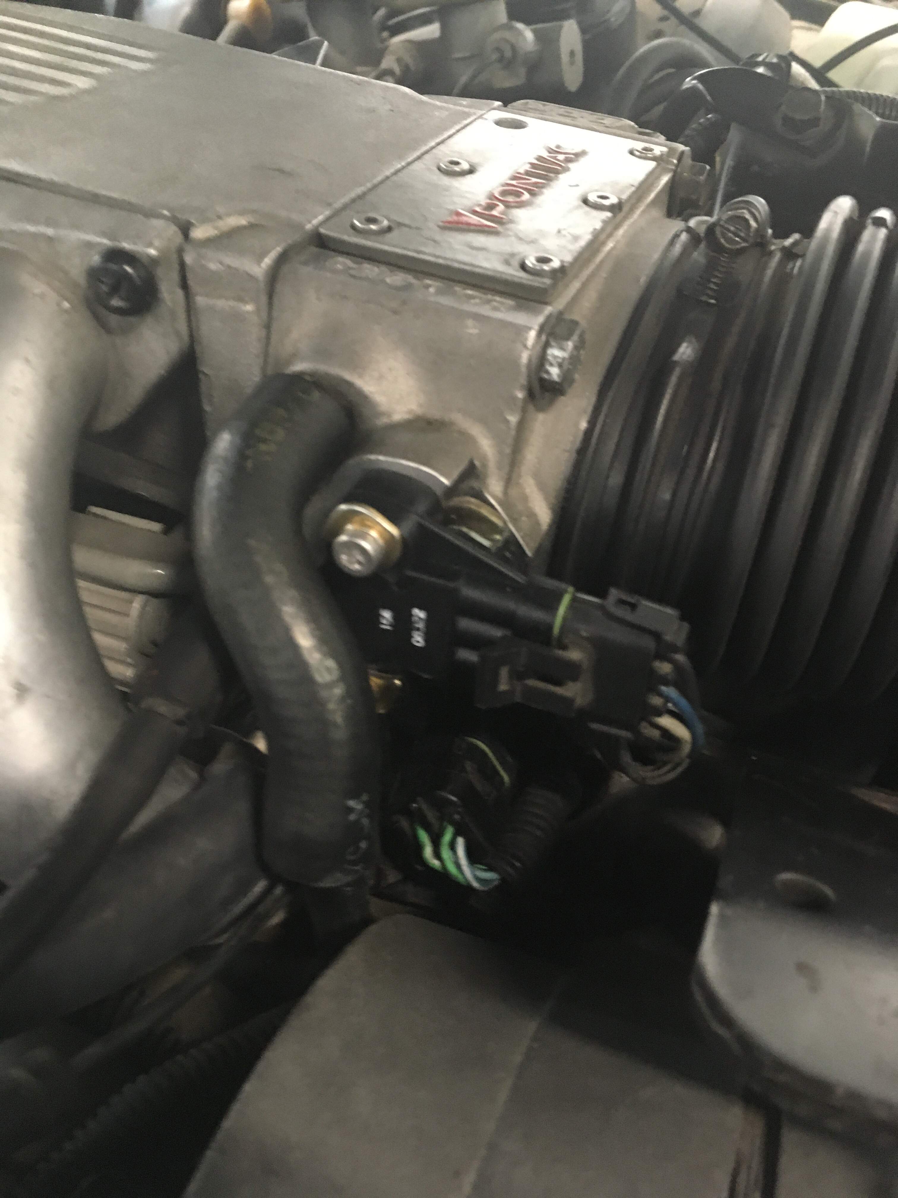

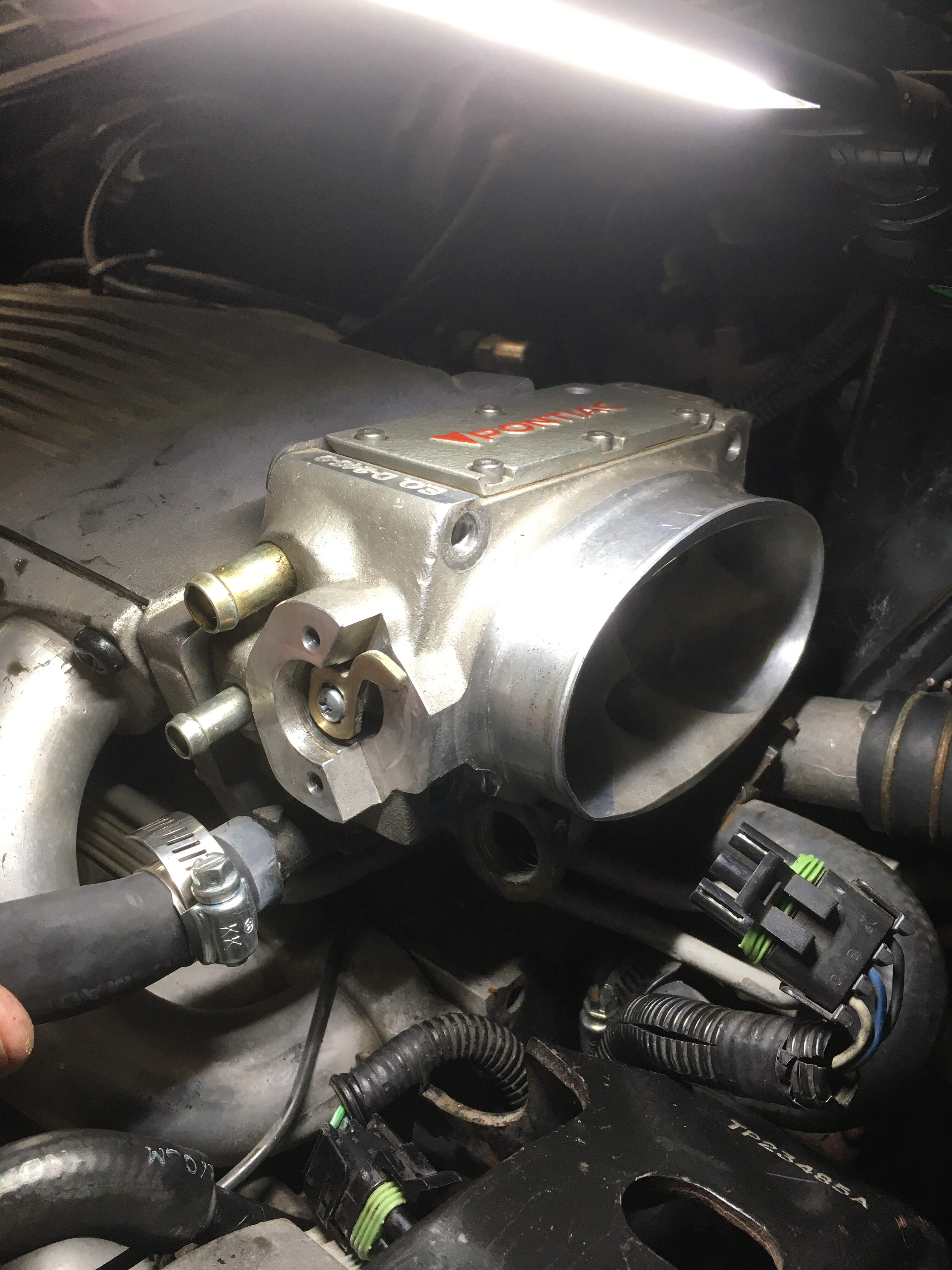

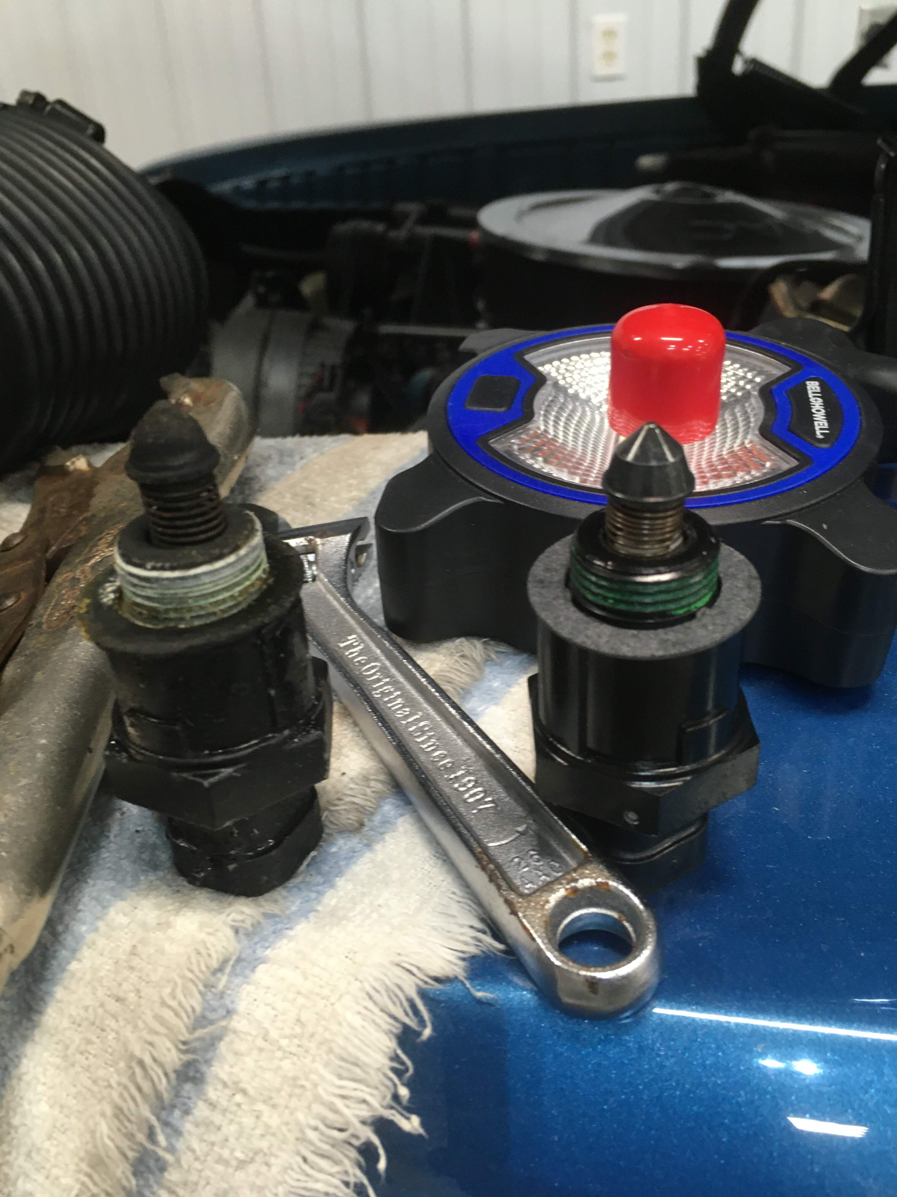

I've been wrenching on BB this week. I am trying to solve my cold start, terrible idle / stall problem. I picked up a new IAC control valve, a new throttle position sensor and a new engine coolant temperature sensor. Getting access to this craps is a roll pain in the arse except for the TPS.
The ECT sensor is mounted on the lower intake manifold, under the throttle body assembly. I managed to get the terminal clip off the sensor after much swearing and cursing between the alternator and fan belts. I finally got a socket on the sensor and got it out. I lost a small amount of coolant in the process but I had a bucket and cardboard under the engine for this contingency. I compared the old sensor to the new one. The old sensor was longer and the connections were different. I was able to get the correct pigtail for the new sensor from my local O'Reillys. Still I really didn't want to splice into the old wiring just yet. I noticed how corroded the old sensor was, so I took my 90-degree air power rotoary disk tool and a scotch brite pad and polish it up and reinstalled it and reconnected it.
Last night I had to complete remove the throttle body itself in order to get access to the IAC valve. There was no way to get a socket on it. I ended up using an adjustable spanner wrench to get the old IAC valve off one 1/4 turn at a time. You can see the difference between the old and new IAC valves.
IMG_7171.thumb.JPG.cd77401c2c491b67793ea136259f0cf8.JPGIMG_7172.thumb.JPG.1c146ce18f3f063e43c0e926b65850d5.JPG

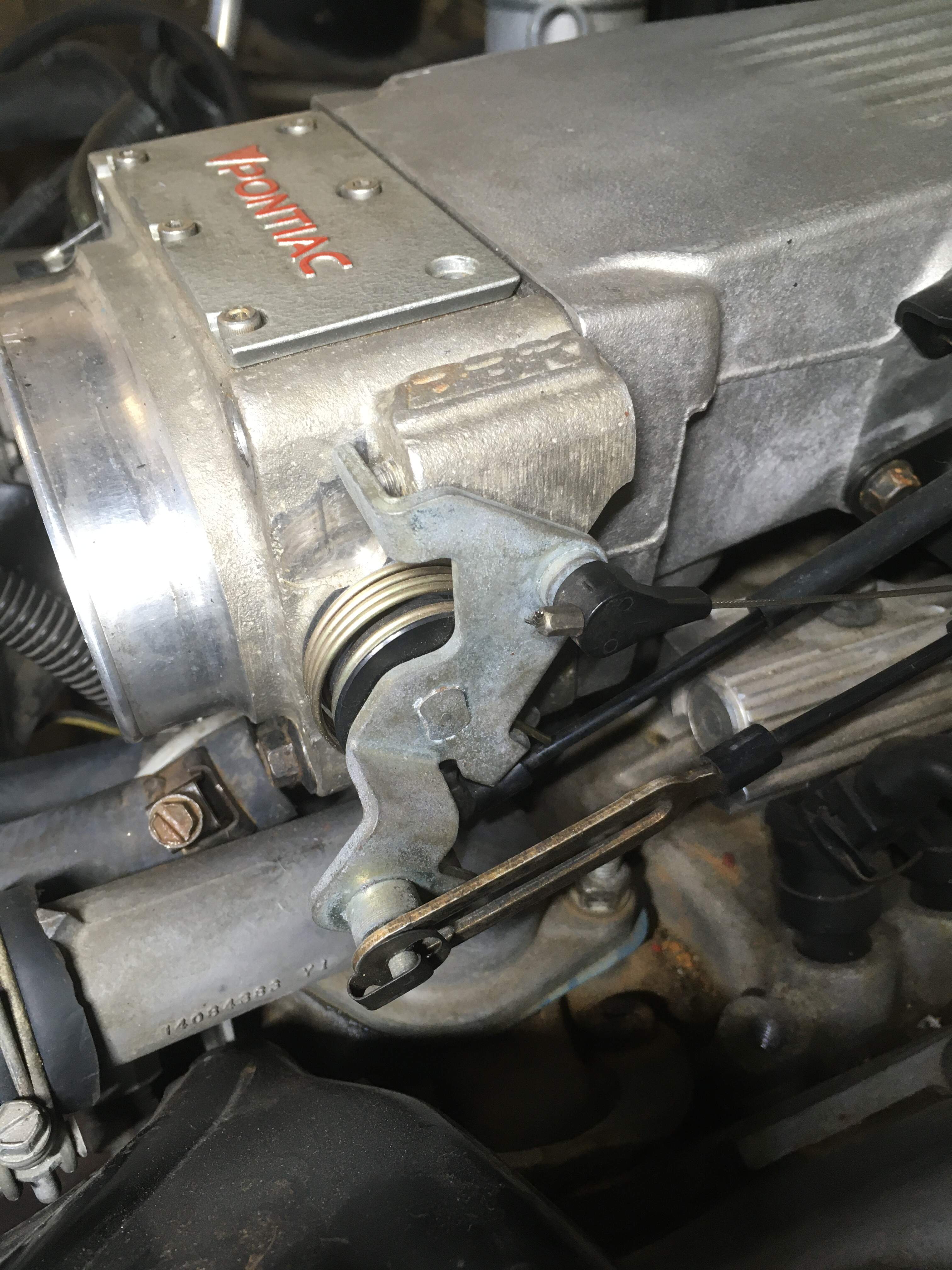

The IAC goes in that miserable little hole....grrrr....spanner wrench to put it back on too.

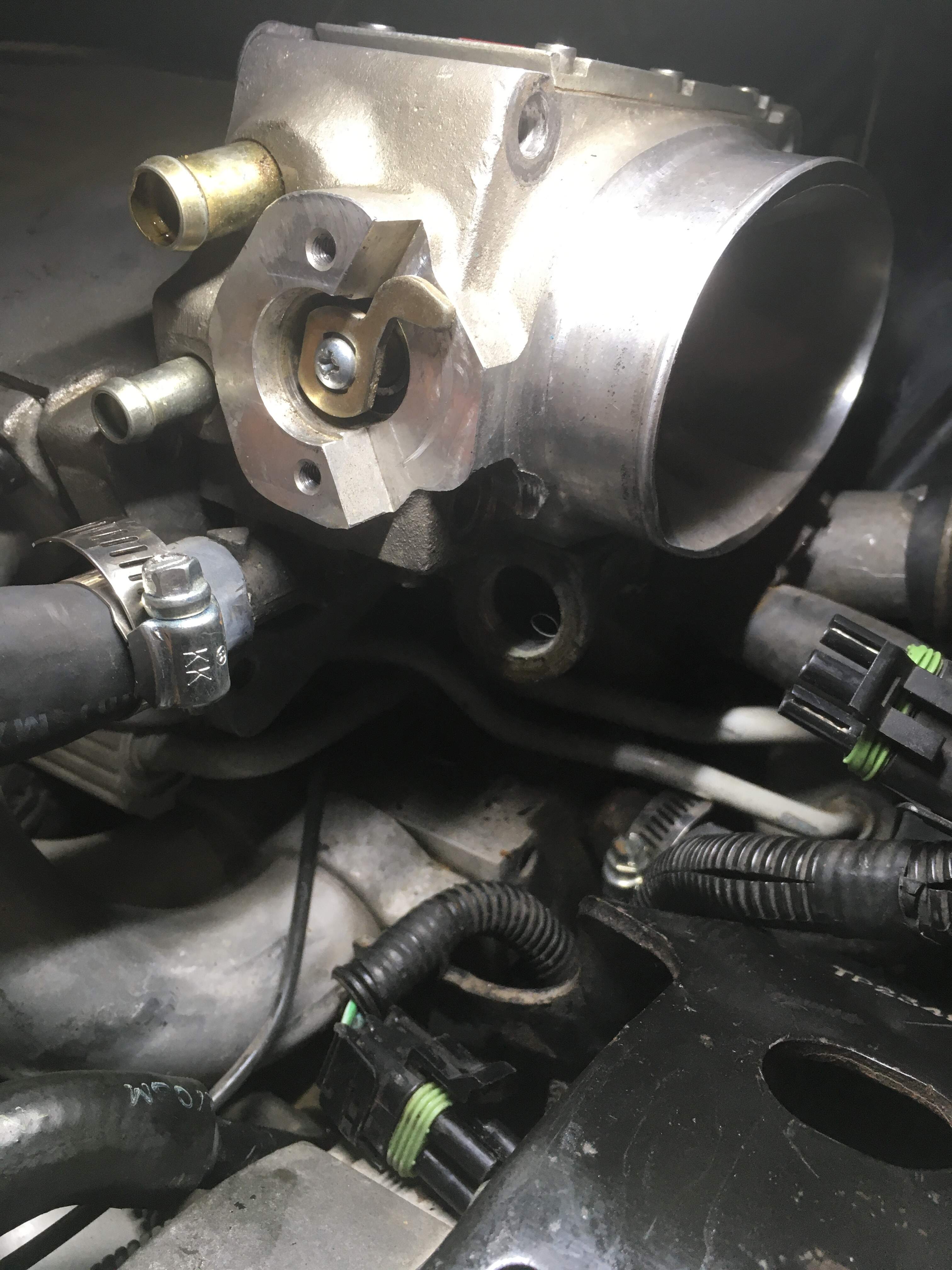

Throttle body bolted back down and throttle linkages reinstalled.

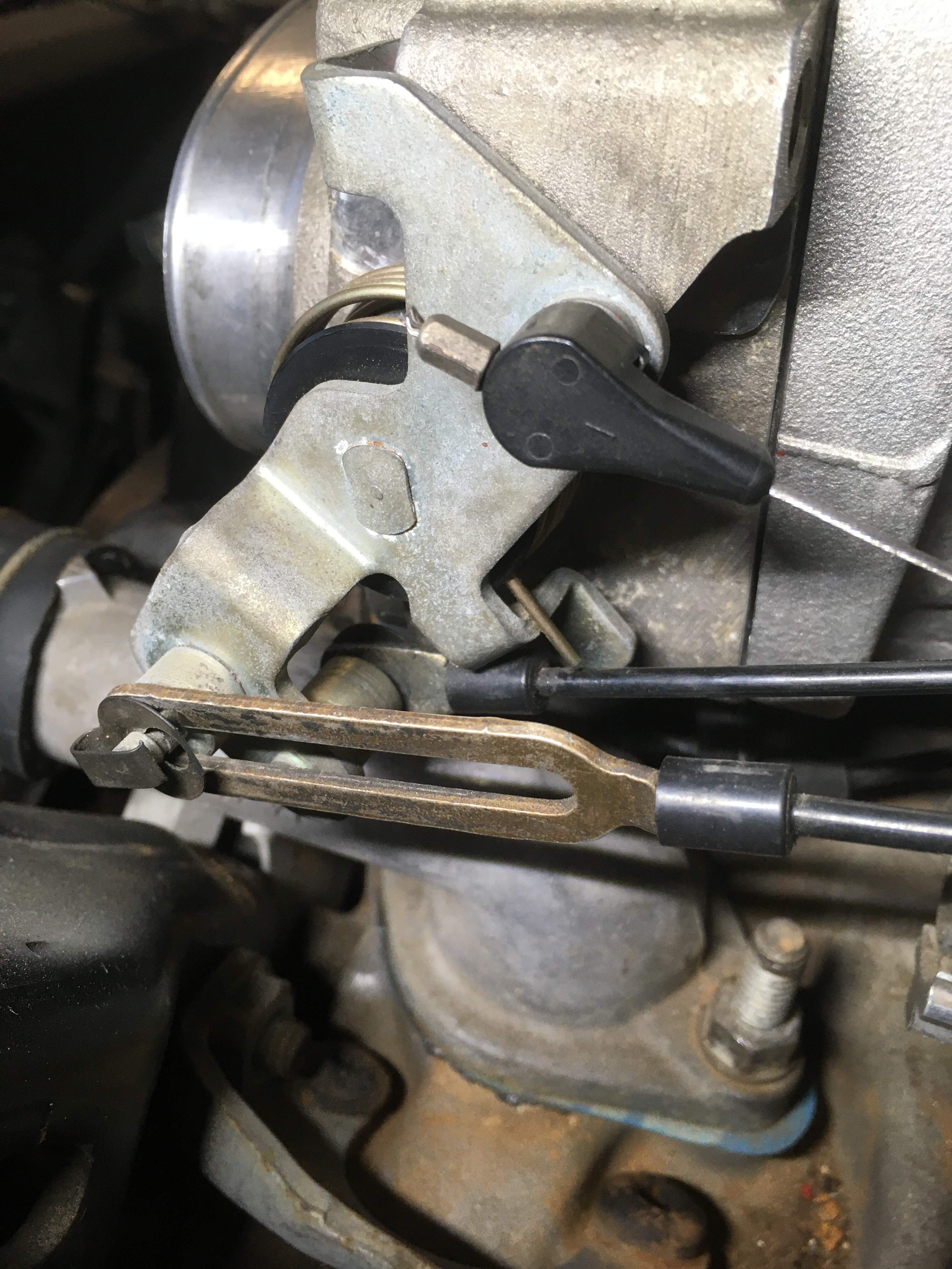

IMG_7173.thumb.JPG.21b97b698da96afbc67eec2d2c72c424.JPGIMG_7175.thumb.JPG.32de9b271f790ba5e33a8e68f46d233b.JPGIMG_7169.thumb.JPG.ae9b1387251e1a09cae18c343f5ab239.JPGIMG_7170.thumb.JPG.f76f957433627a0fd3919dfe6ac1552a.JPG

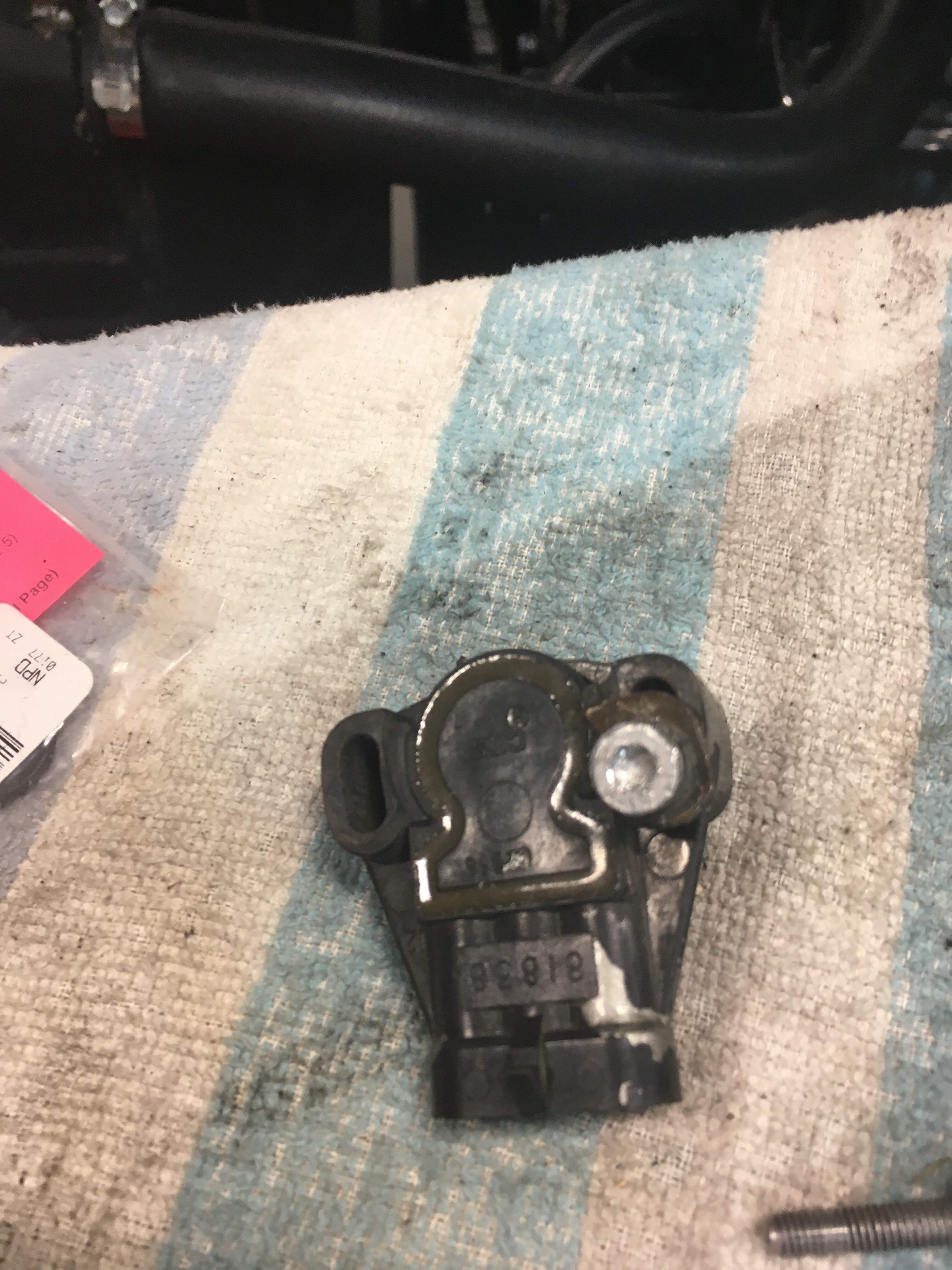

Next up is installed the new throttle position sensor and then calibrating both of them and reinstalling the air cleaner assemble and MAFS. Hopefully this will cure the cold start/low idle issue.
I had the mechanics do that back in late May / early June with the mega tune-up. I gave them a set of NOS AC plugs for the car. Did I validate the gaps before I gave them to them - no! So that one is on me.

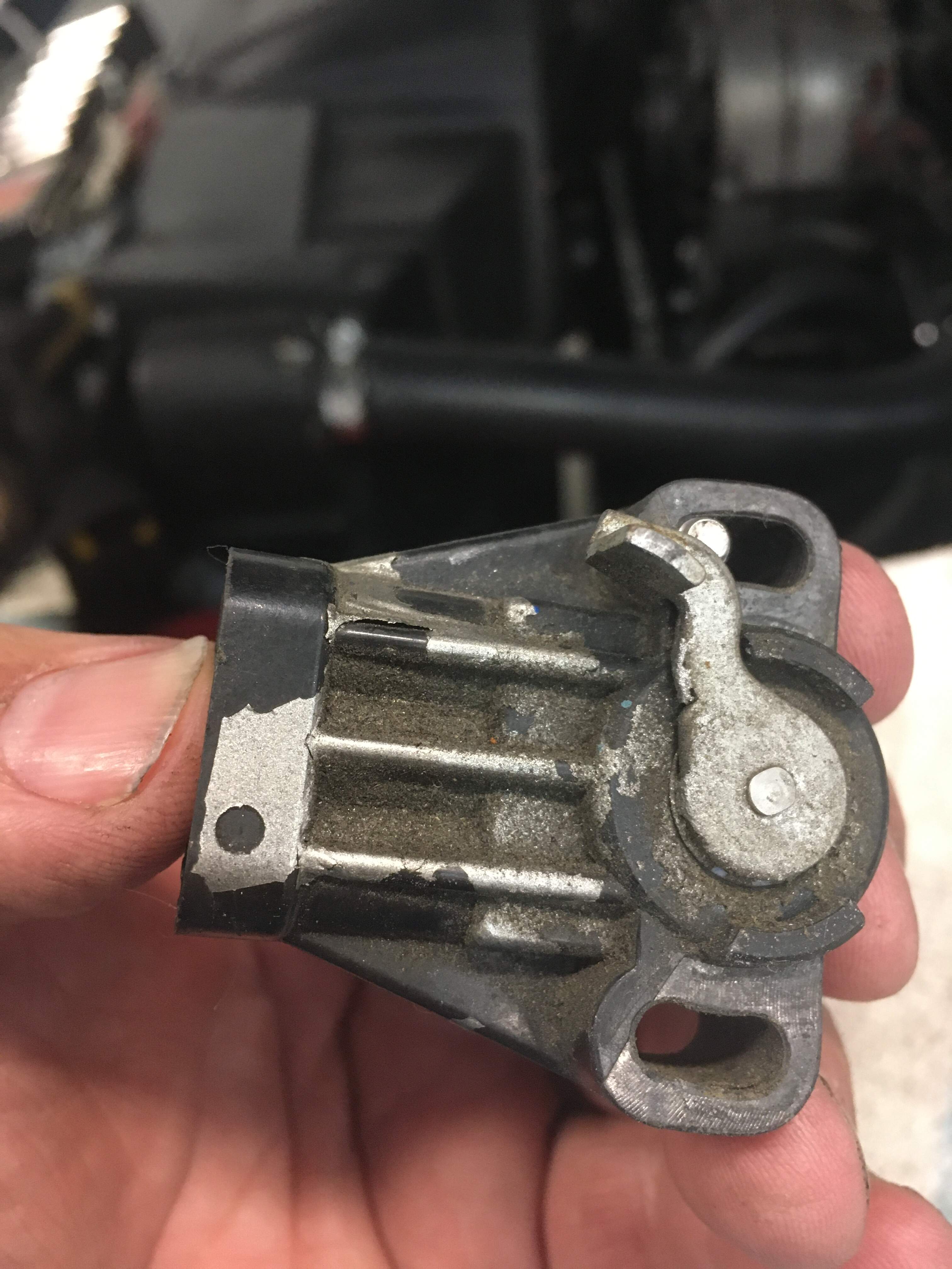

I finished putting the engine back together last night. I installed a new throttle position sensor (TPS) too. Once I got everything buttoned up, I went for a short test drive. I had to clean up the antifreeze from the ECT sensor removal. It spilled more than it caught (dang it!).
Here is the old TPS.
Here is the new one on the engine.
The car started up. I didn't have any stalling  or rough idle issues last night.  I checked for coolant leaks - none. I went for a short drive around the neighborhood. It drove fine. No snappy acceleration but rather a very slow smooth acceleration. I did get a SES light to come on so I will check / reset the code later this weekend.
I eventually want to work out the acceleration situation but I am taking baby steps and one thing at a time. If I've solved the stall/rough idle issue, that is a victory by itself. More test drives this weekend to be sure.

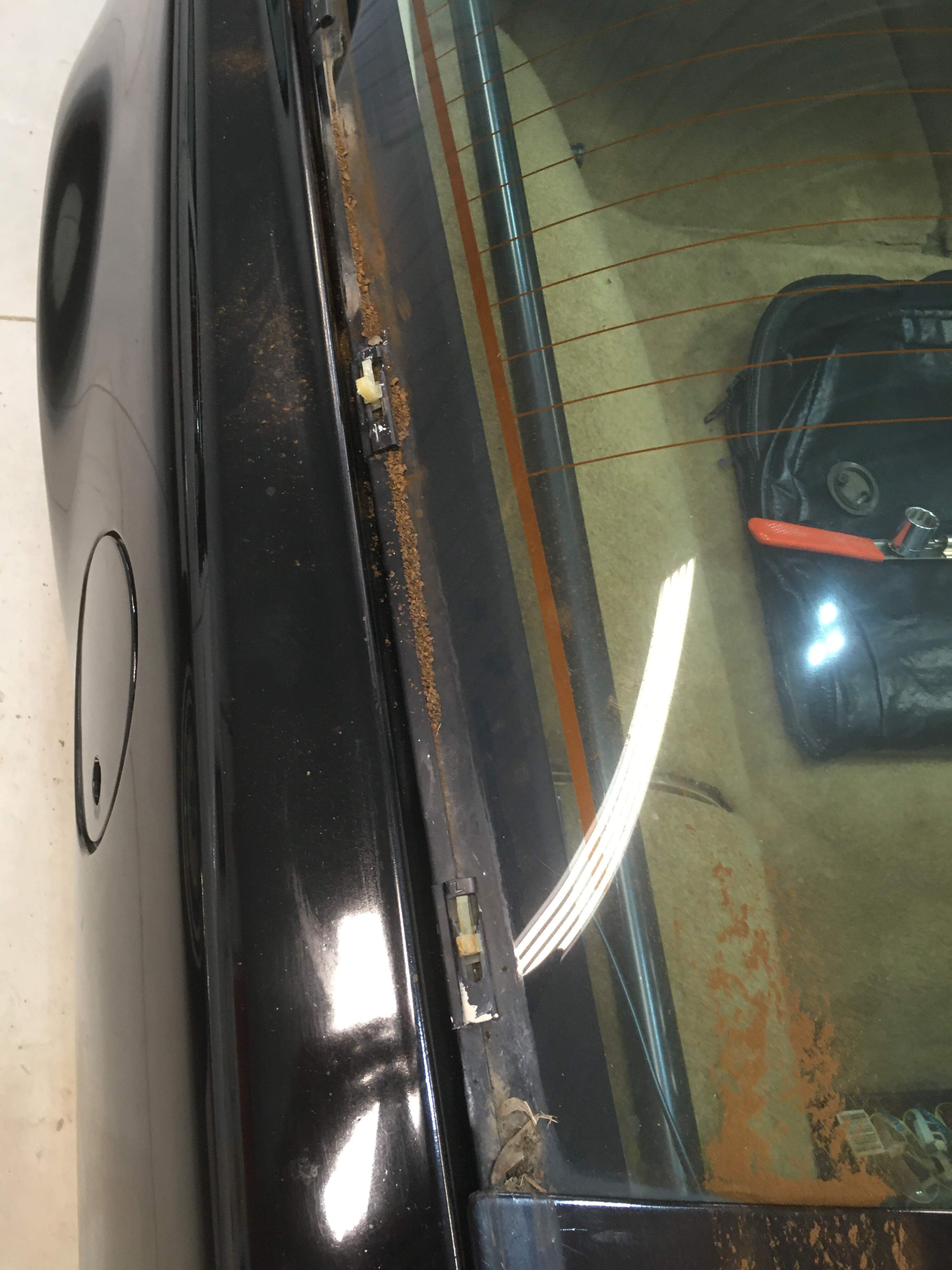

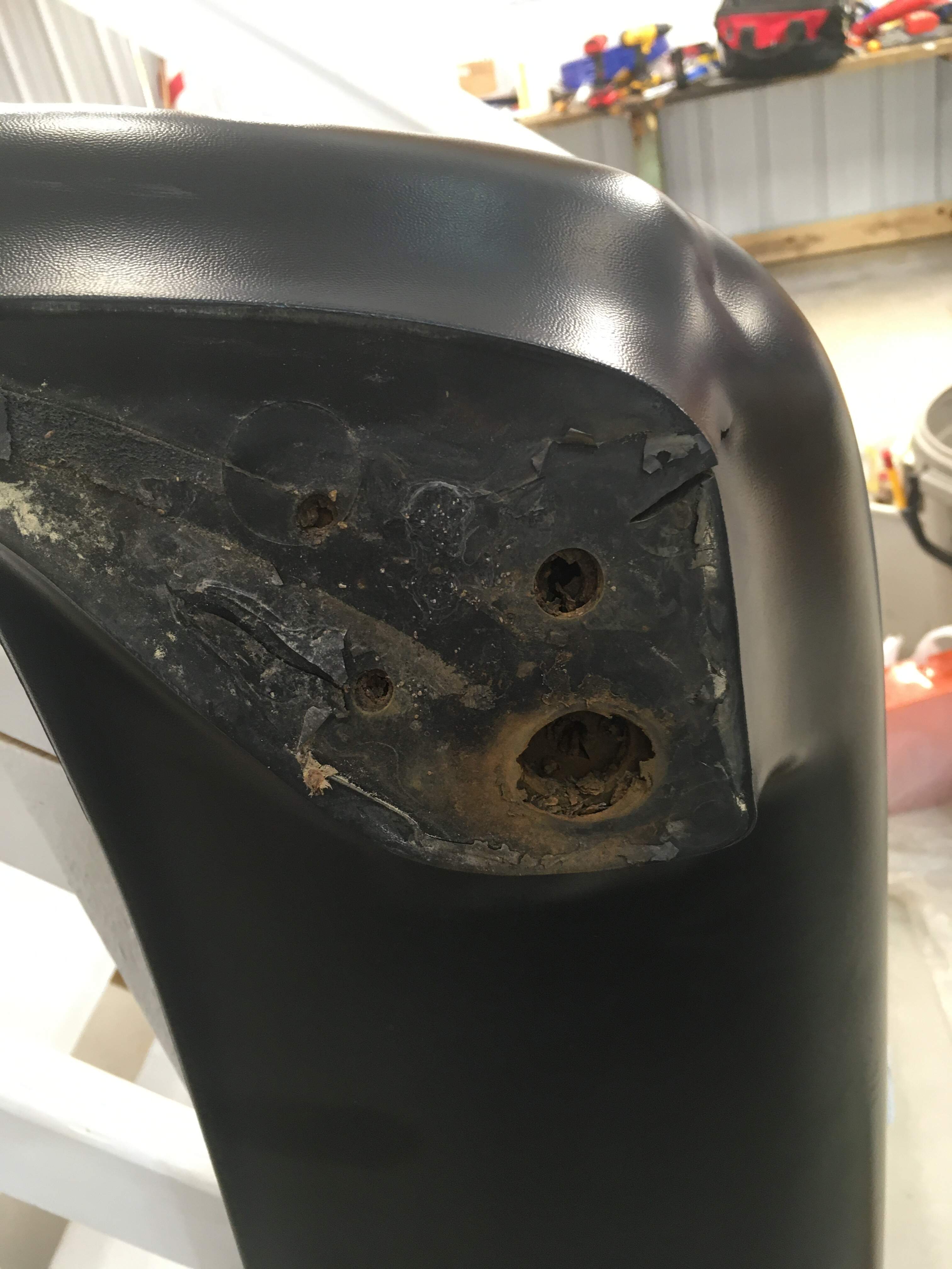

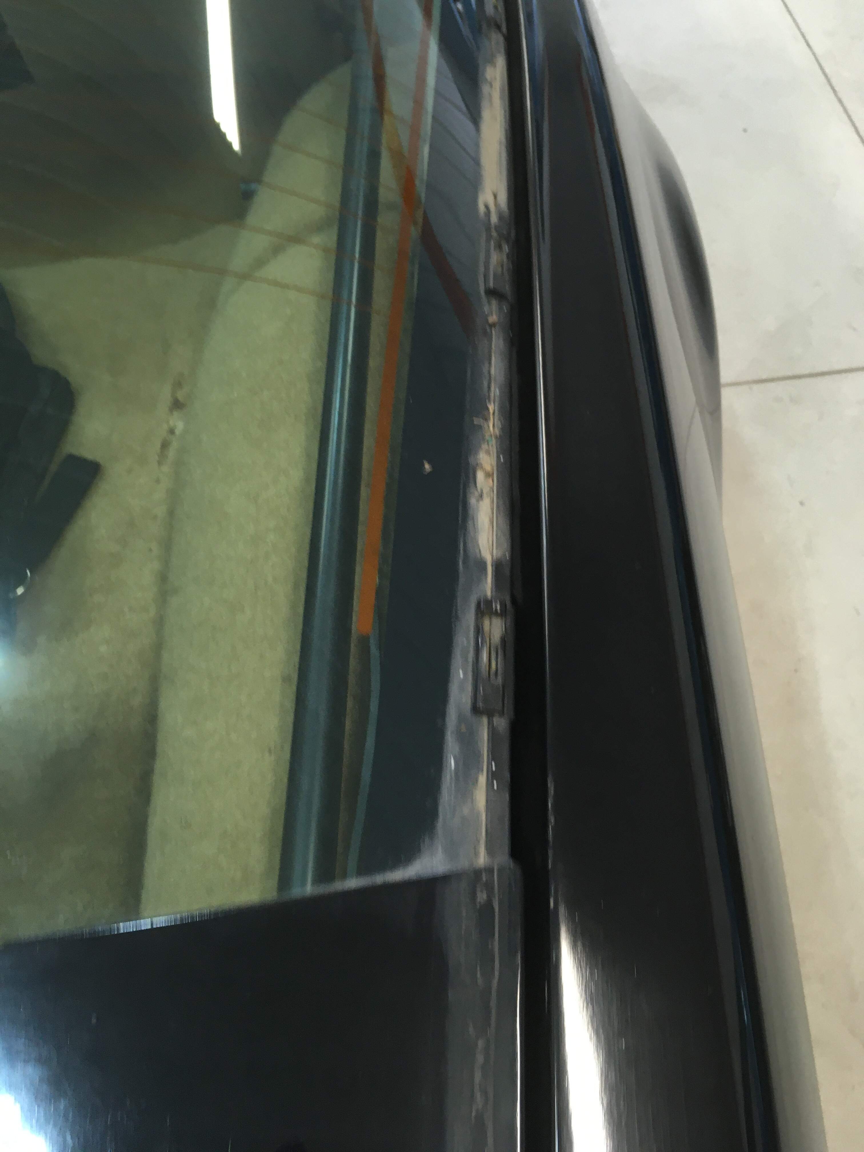

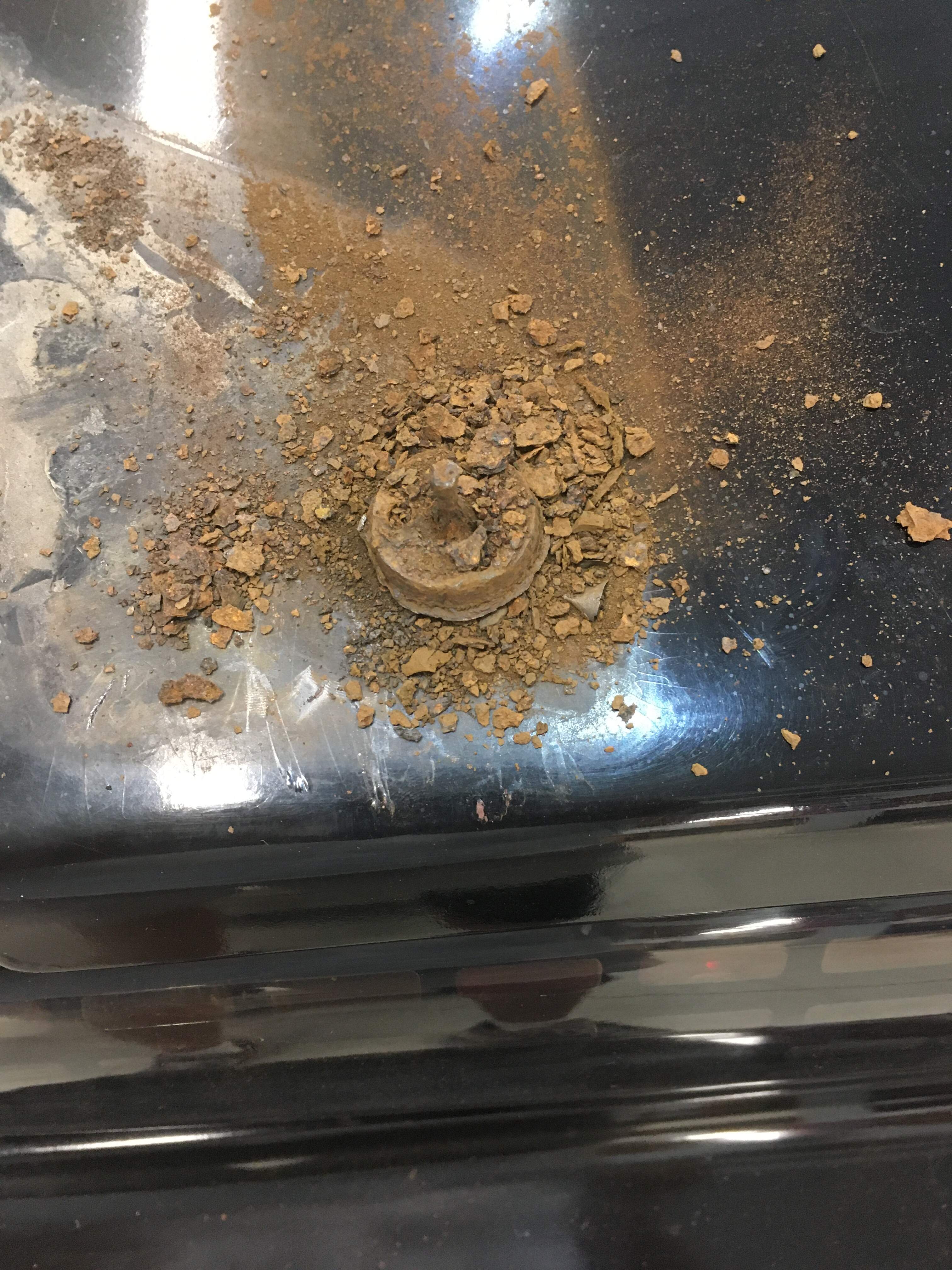

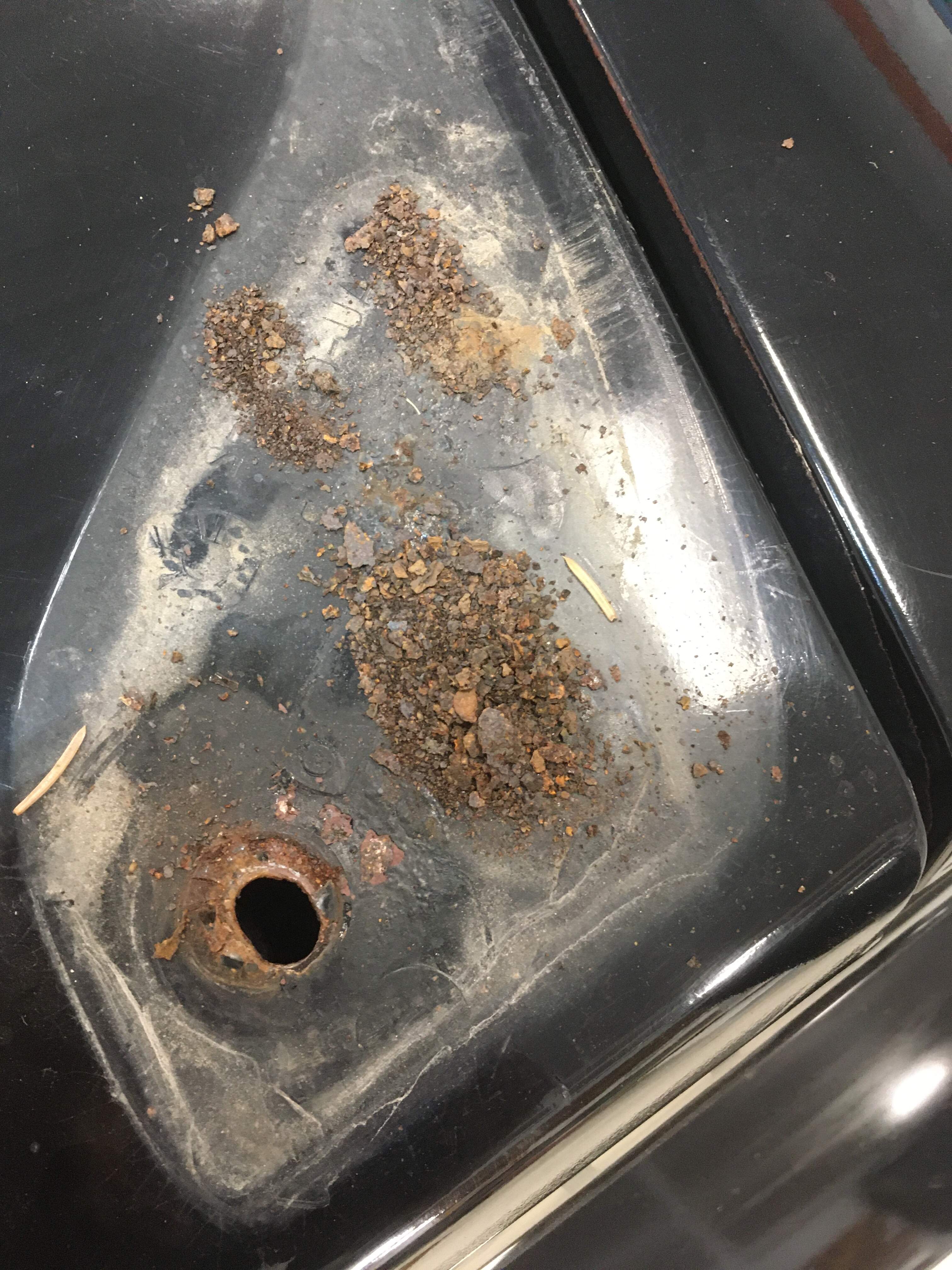

Now that the cars are put away for the winter I have time to do some wrenching. I started this weekend by removing the aero spoiler off of Black Beauty. I've already shown you guys the new replacement spoiler I have for it. I have a shop manual for my Bird. The manual says to remove the plastic covers under the trunk lid, unbolt the two bolts, lift up the spoiler and push it forward until the clips release. Sounds simple enough.....yeah right.
The driver side bolt was rusted through, it spun completely loose from the spoiler. The passenger side bolt snap off. Lifting the spoiler and pushing forward did release the clips and a shit ton of rust!
Notice how the bolt clip rust complete off the spoiler?
More rust and dust!
Passenger side rust debris

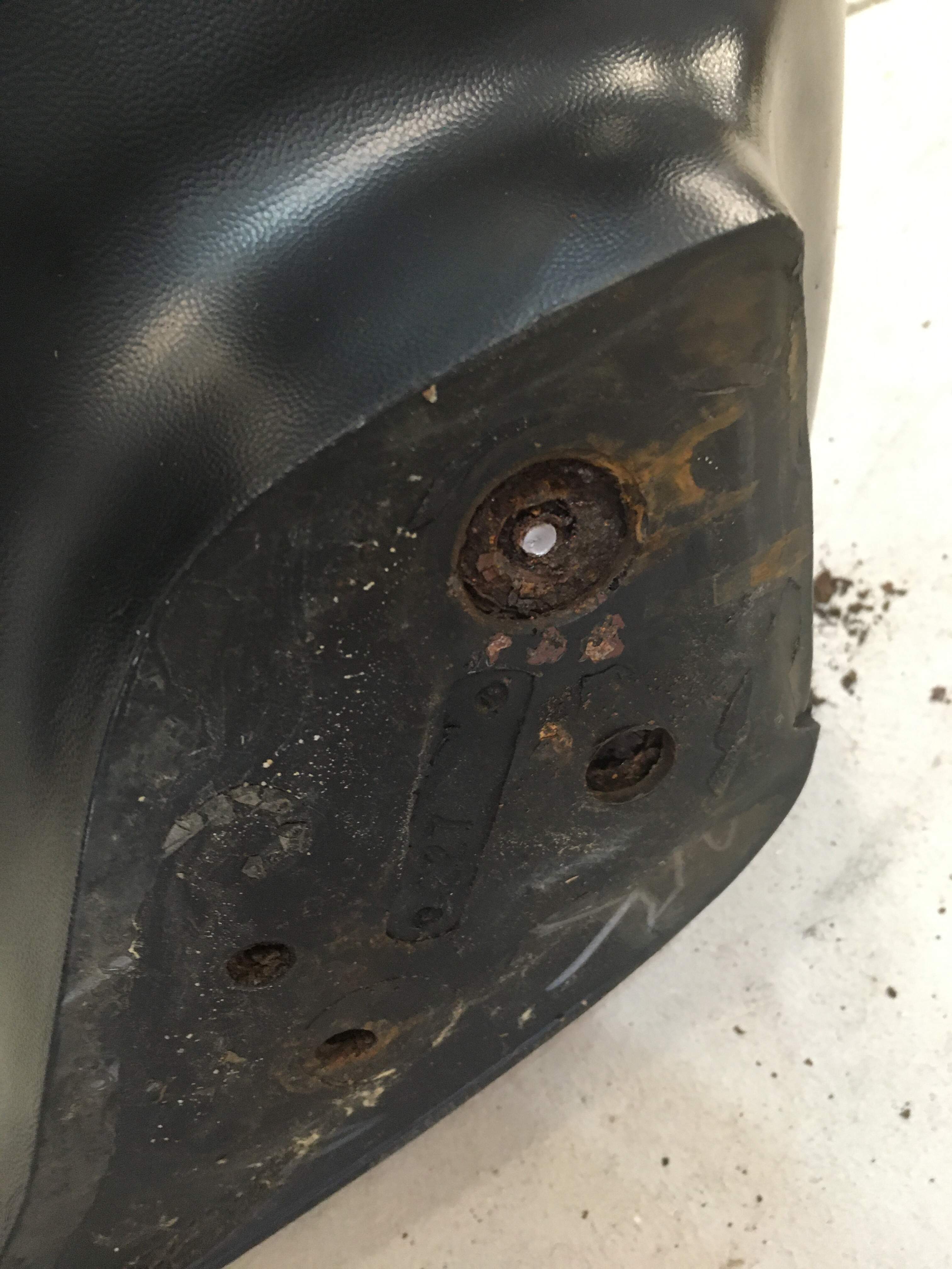

Now looking underneath the spoiler mounting areas.
Driver side first....
Passenger side.
You can clearly see the snapped bolt here.

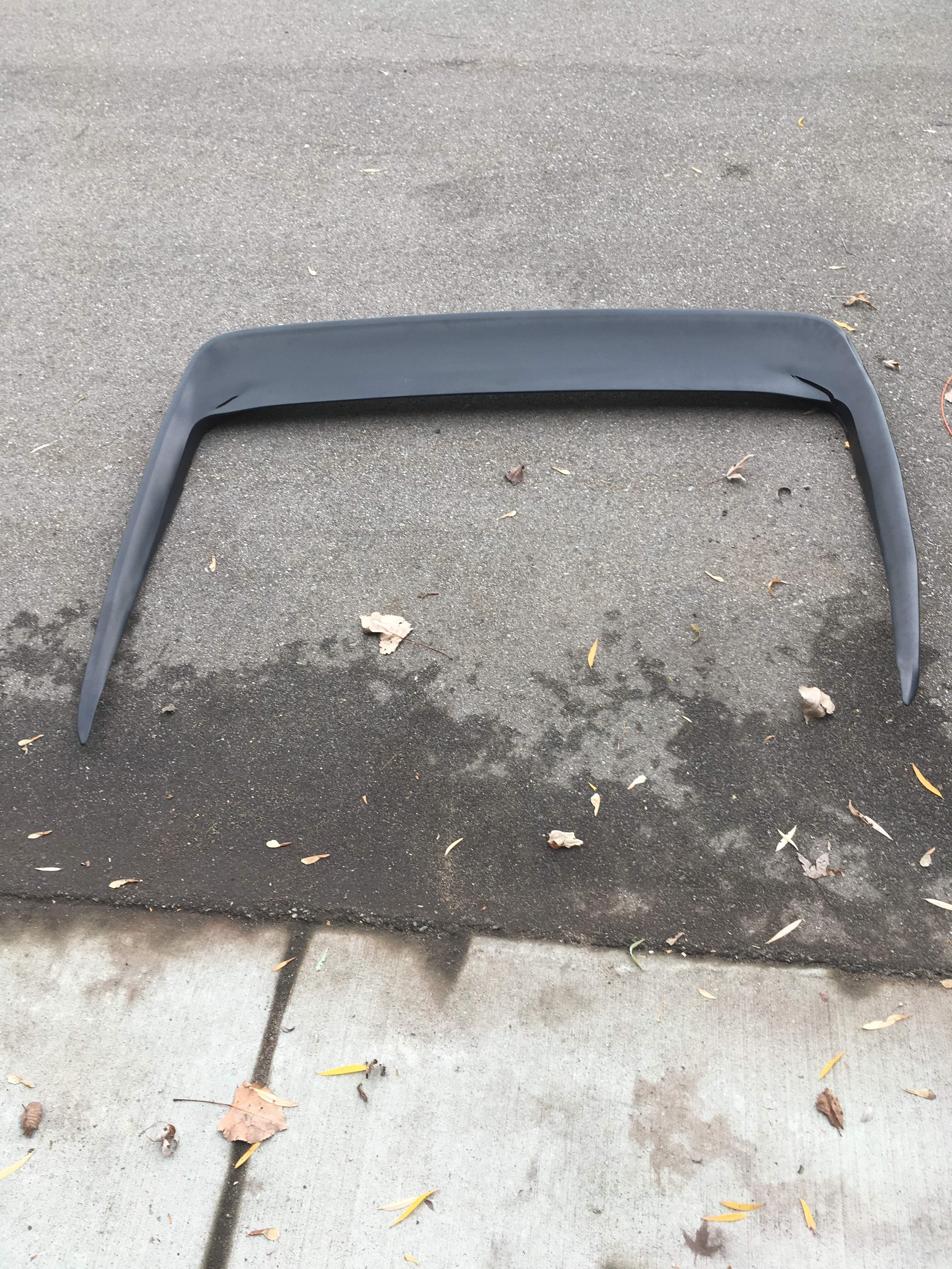

Old spoiler off the car and on the ground - still shaking out another 1/2 - 3/4 pound of rust!

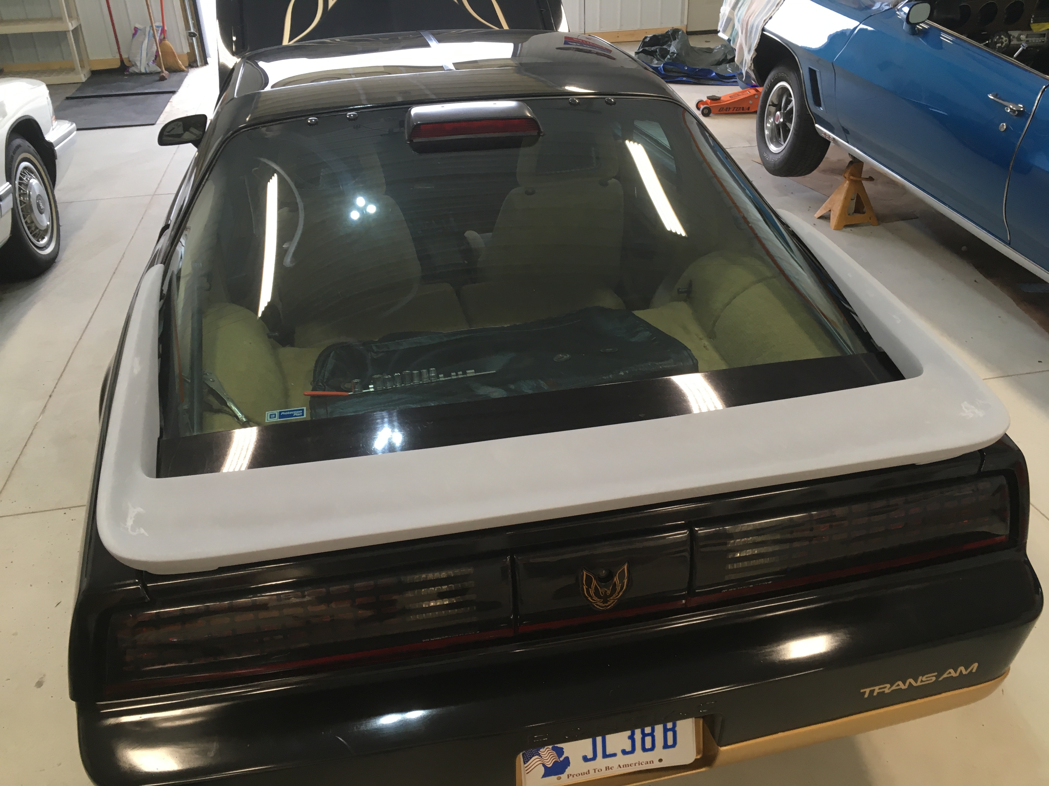

I just placed the new fiberglass spoiler in place - justa for looks. I still need to test fit it, primer, block sand and paint it body color.

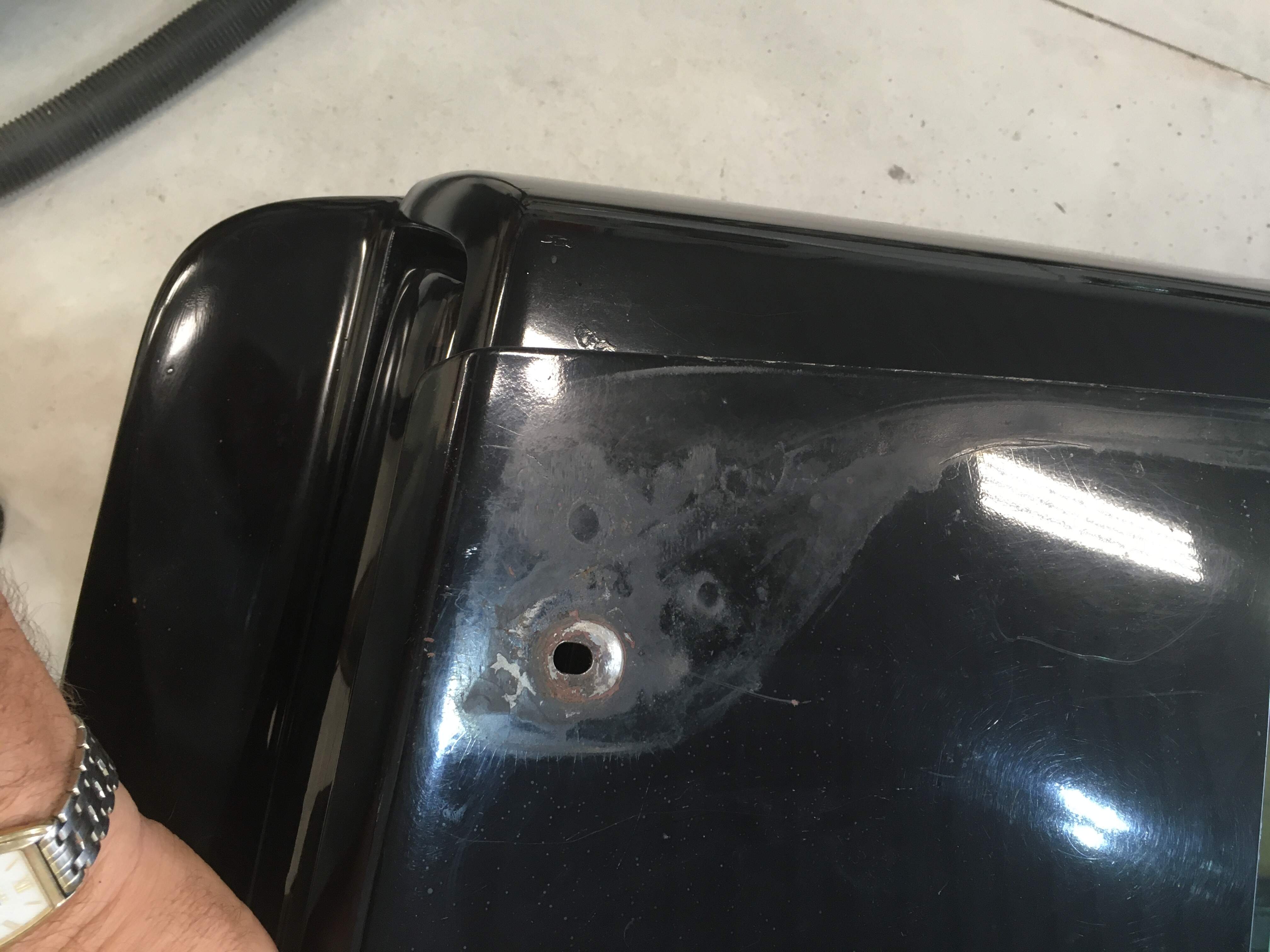

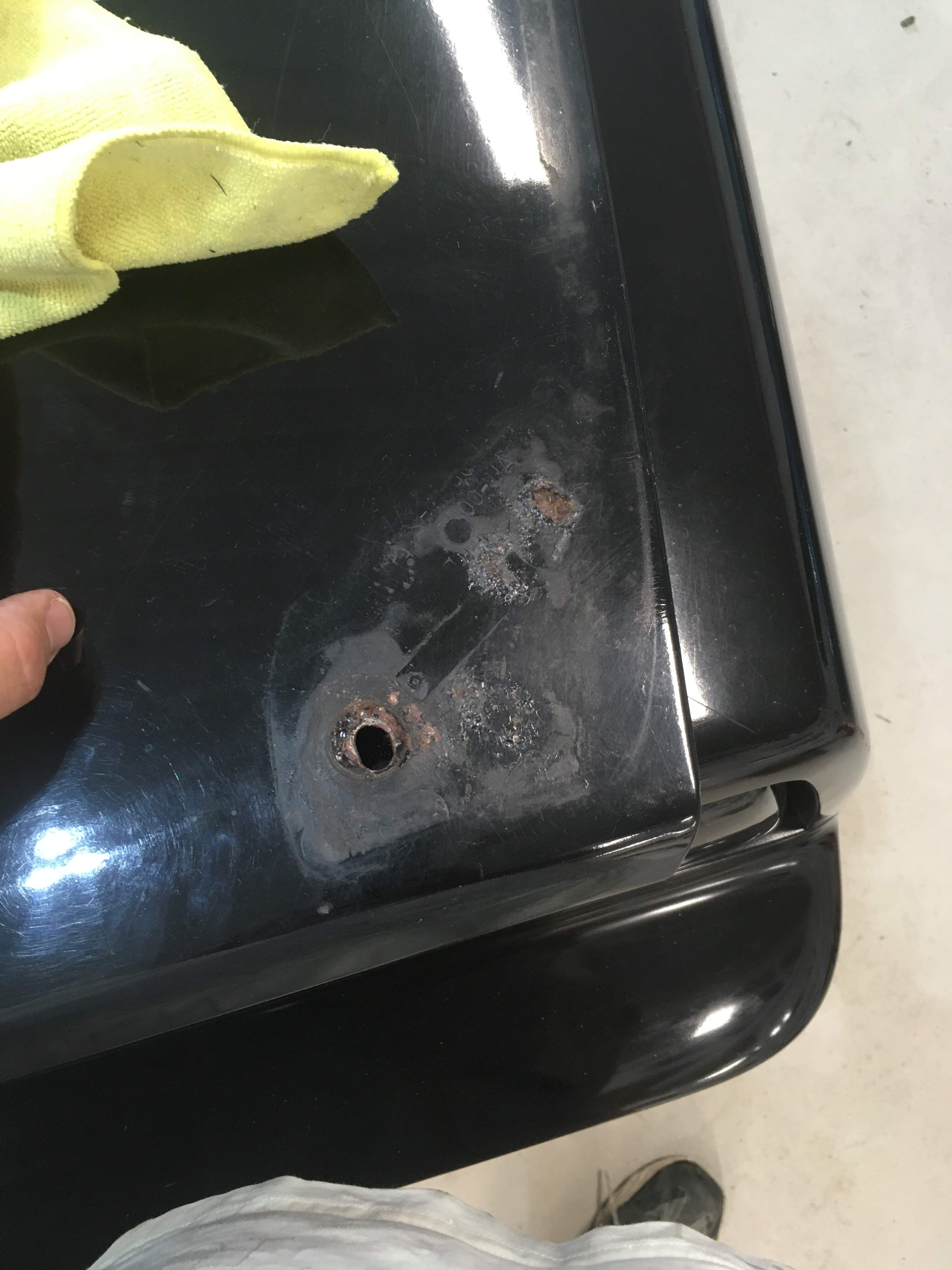

I'm glad I removed the spoiler. Not only did it discolor the paint, the standing water rusted through part of the trunk lid. Now I will need to get that repainted with fresh metal. Damn.
Passenger side has two rust holes, It will need to be repaired.
Drive side metal is clear but discolored.
When replacing, seal the edges with silicone "adhesive".  I used Clear on the Sunbird rear spoiler I made, it's the only thing holding the spoiler sides to the car.  Sealed the rest of the edges all around to keep water out.  It still holds water (no way to drain) and yet another reason the car never gets wet.  Kinda hard to see, but I'm talking about the thin tri angle sides and of course the perimeter of the spoiler.
In this case, the splits in the vinyl rubber allowed water to get to the metal frame underneath and let it rust and trap water, leading to the bolts snapping and rusting the trunk lid. I think things might have been worse if the car had not been garaged and out of the weather all these years.
