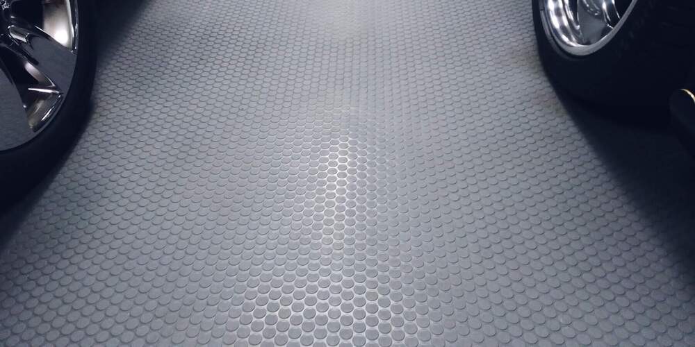

I have done and seen many floor coating! Stains, paints, epoxy, nature stone and the like! Ceramic tile, regular floor tile and linoleum! None had much longevity if you are actually going to do mechanical work! Like floor jacks, jack stands. Things to do suspension work, tranny work, etc… These floor applications are not rugged enough! The biggest headache with all of these applications is the cleanup to replacing them! All are pretty ugly and labor intensive.

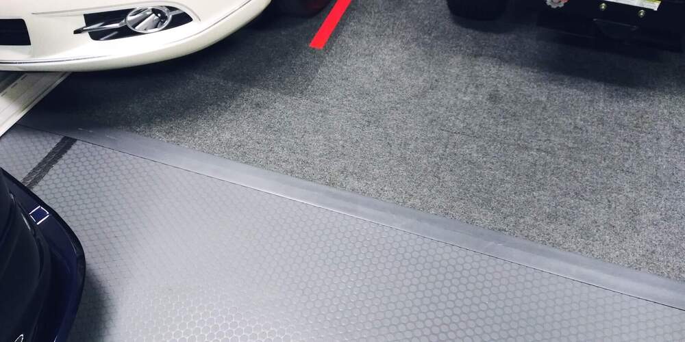

So what I finally arrived at, that has work for about 10 years now and show no sign of failing, was a blended floor of carpet and Gflooring! I park the Indian on the carpet. These are self stick indoor outdoor carpet tile, relatively inexpensive. Here I can do some moderate work and if I have an accident I can replace the damage tiles very easily, as I bought excess. Because this carpet has some slippage to it, when I jack up the car it doesn’t grab and pull the carpet. The carpet also gives a level of comfort to the feel of the garage, I.E. acts as a thermal barrier over the concrete and sound absorption. Also when I’m on the floor working it’s not cold because of the carpet! Now I see you plan on installing a lift so those issues may not be relevant for you.
The main part of the garage is done in Gflooring! I looked at all the different types of garage flooring tiles & rolls including Race Deck! All of them are going to need some form of protection when you use a floor jack, jack stands etc. if you don’t you will gouge, cut & dent these materials, but driving on them daily is no problem or just sitting there. Yet if you try to jack up a car that’s a problem! First off the floor jack will leave divots in the PVC tiles and sheet  PVC and jack stands do the same. Also because the adhesion between the tires and the PVC material is so good that as the car rises up the wheel pull inward! This pulls the material with the tires and when you set the car back down it pushes the material out. This will cause tiles to break tabs or unhook. Roll PVC flooring will end up puckering. Again this may not be a concern if you only use a lift, but the best form of car storage is jacked up, wheels hanging, I.E. no spring compression!
So the Gflooring I glued down, which takes some patience! When I got to the walls I rolled the sheet of Gflooring 4” up the walls and glued it there as well! Then put cove molding over it! This gives not only a clean look, but keep any water or liquid in on the floor where I can clean it up. It keeps debris in and it keep insects out! There is also a transition molding between the carpet and Gflooring. The Gflooring does offer some minimal insulation from the concrete, as will the tiles.

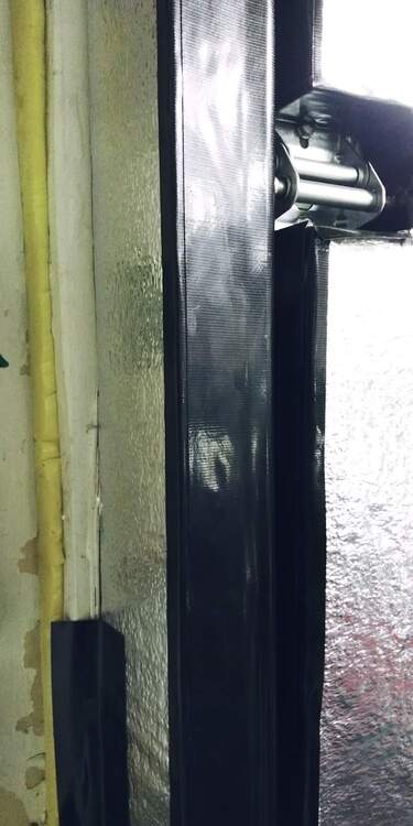

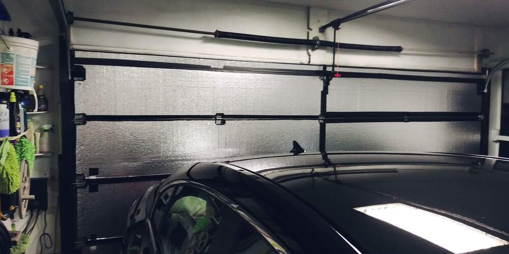

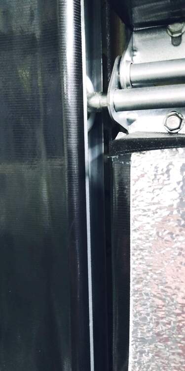

I presume you plan to heat the garage when you’re there working in the winter?! If so you might consider insulating and weather proof the garage door, as this will be a huge heat loss! So I will tell you what I did which made a huge impact on the comfort of the garage, both in hot and cold weather!
I bought 2” thick R-tech foam board insulation. This is a 7.7 r value board. This I cut and glued to each panel of the garage door, allowing for just enough clearance of each panels angle as articulates through its opening cycle! I also cover the ends of the exposed foam with a high quality tape to protect it! I than encased the side rails of the garage door in the foam as well attaching it to the rails with 3” wide Gorilla tape. The foam attachment to the rails runs from the wall to be even with the side rail. The outside of the garage door should have flexible seals that overlap onto the door, as this helps prevent wind and blowing from pushing into the gap around the door. I also used these seal on the inside of the door between the side rails and the side edge of the garage door. This all made for a very weather tight garage door! In my shop I also used a R-tech on my man door which made a big difference on temperature intrusion!
Here’s how the impact of those improvements effected garage temps. My garage, 2x4 construction. R-13 wall insulation, attic R-30, garage door is R-.9! On a 90 degree day, door never opened, no cars driven. The garage temperature would by mid afternoon reach 84-85 degrees! Same conditions in the winter with single digit temps the garage never when below 40 degrees, but the deeper we went into winter the less the day time temperature recovery would occur! This is because of the direct impact of the ground temperatures declining as we go deeper into winter. Because as you reduce the impact of above ground outside temperatures the more ground temperatures effect the air space of the garage, I.E. geothermal energy!
Now after insulating and weatherproofing the garage door! On a 95 degree day, yes 95 not 90, no door open no cars driven, 77 degrees is the hottest and that’s not till late afternoon. Winter, the coldest it ever has gotten in the garage period is 49 degrees! Most of the time it is in the 50’s and up until late December, or longer some years, lower 60’s! Most of the time I can keep the garage a 72 degrees when working in it, with just a 1500 watt electric heater after bringing it up to temperature with my big electric wall heater!
