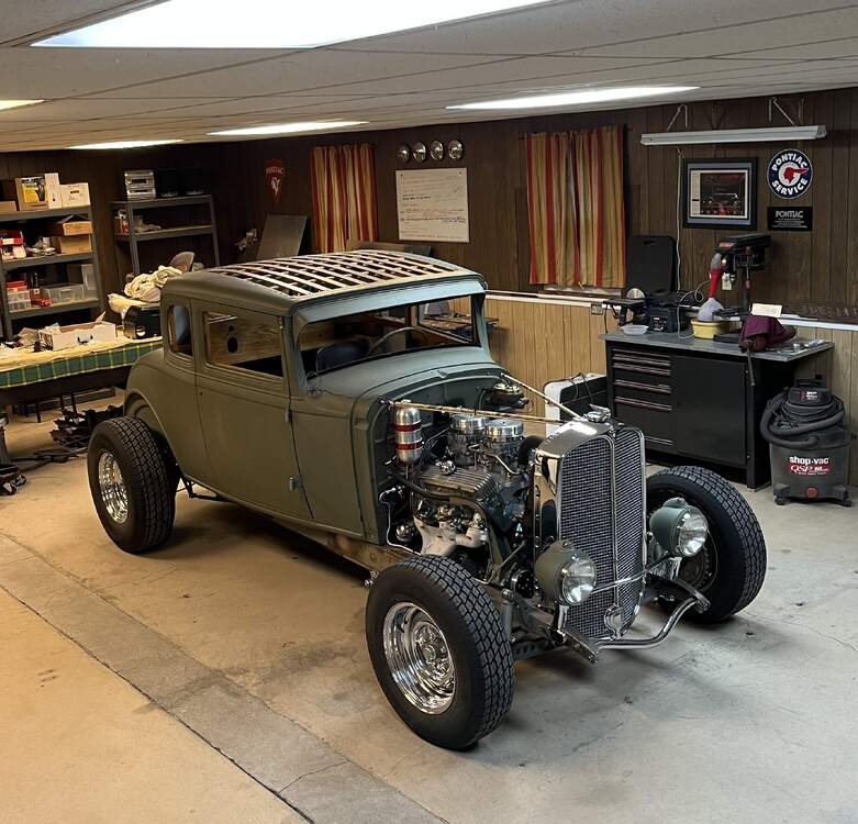

    We now have a rolling chassis. IMG_9342.mov

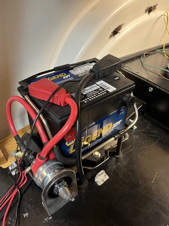

  • I didn’t think the battery area would be so complex with battery cables, main power switch and vent tubes. The smaller wires are preliminary and will be cleaned up.     Battery cover was designed so

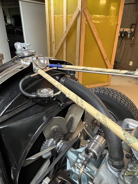

  • With the manifolds back on the engine, my brother and I spent 4 1/2 hours installing the rest of the exhaust system. It became a lot more challenging than either of us anticipated, but we finally got

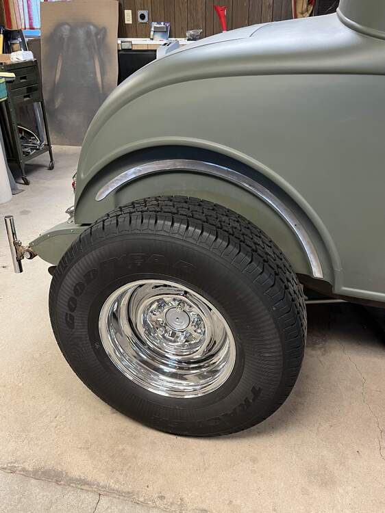

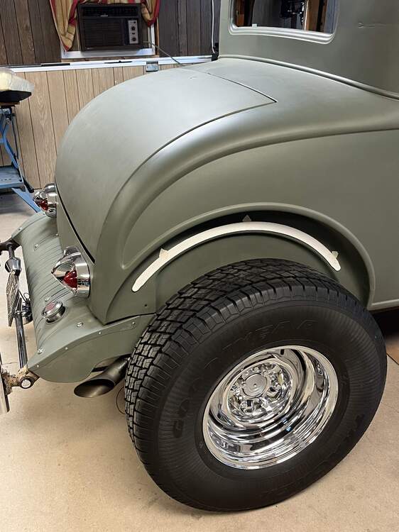

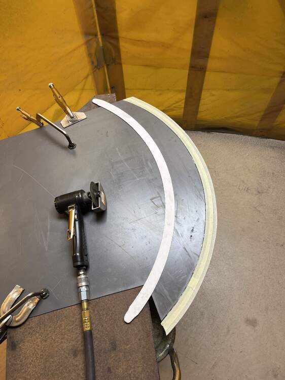

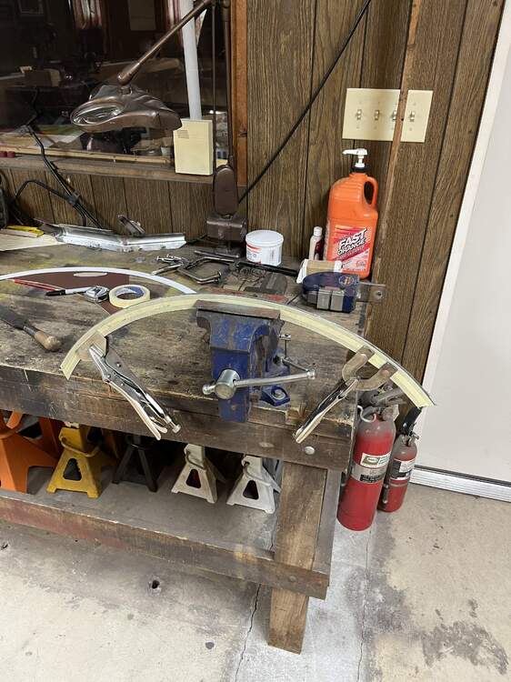

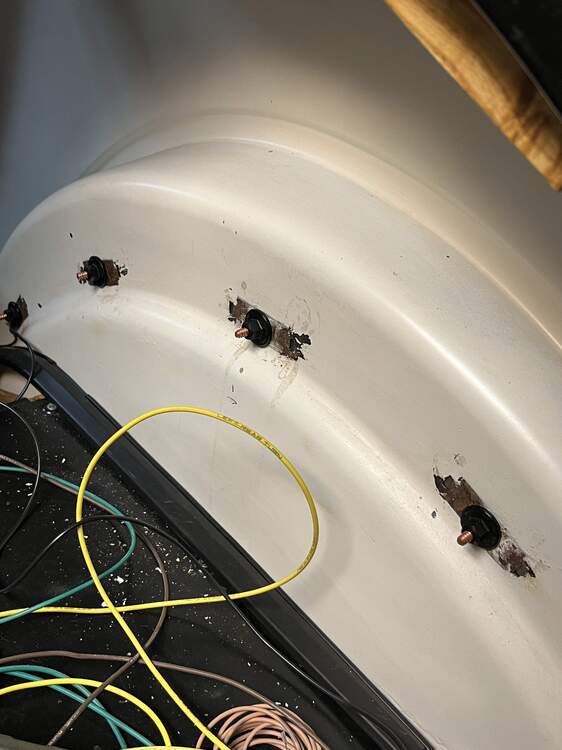

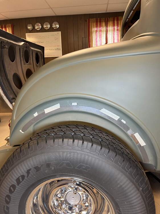

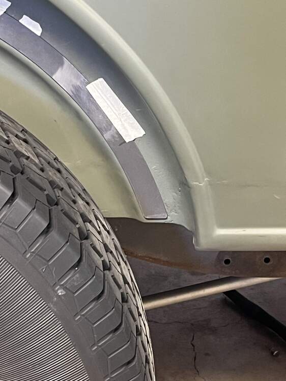

   I was looking for a way to close and weatherproof the unused holes used to bolt the rear fenders to the body without welding them shut, in case someone in the future wants to put them on. Using my CAD system ( cardboard aided design ) I developed a pattern and cut 2 pieces out of heavy gauge sheet metal.  My brother welded studs on the back of each curved strip to attach them to the body using the original holes.  They will be painted body color so they will almost disappear.
That is a thoughtful idea right there.  Thinkin ahead is always a good idea.

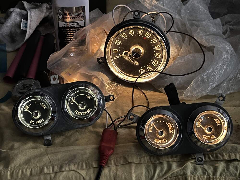

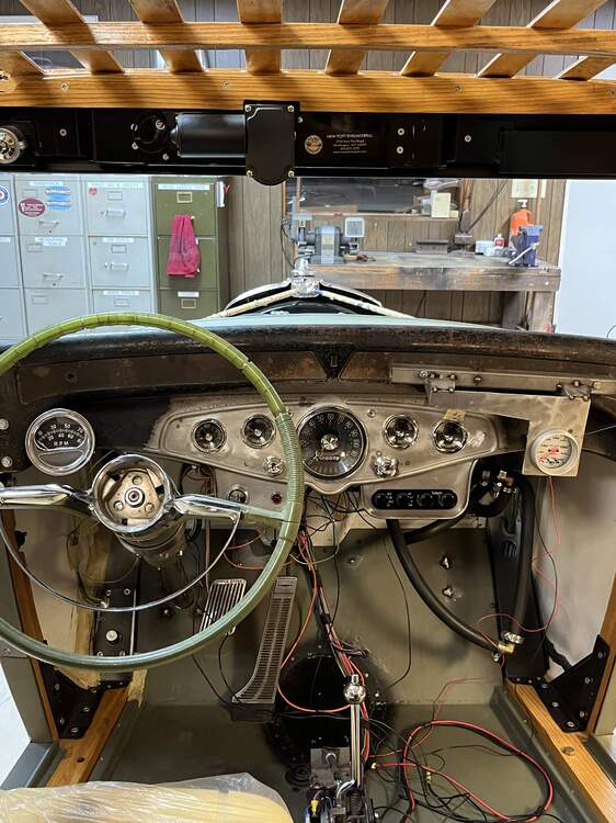

   I received the gauges from Williamsons Instruments after they rebuilt the speedometer and updated the others from 6 to 12 volts.  My son-in-law wired them and we installed them in the car. Everything functions as they should.  Still need to add lighting for the tach, ignition switch, and E-brake indicator.

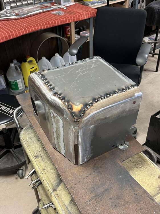

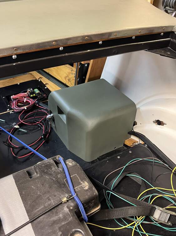

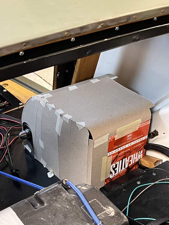

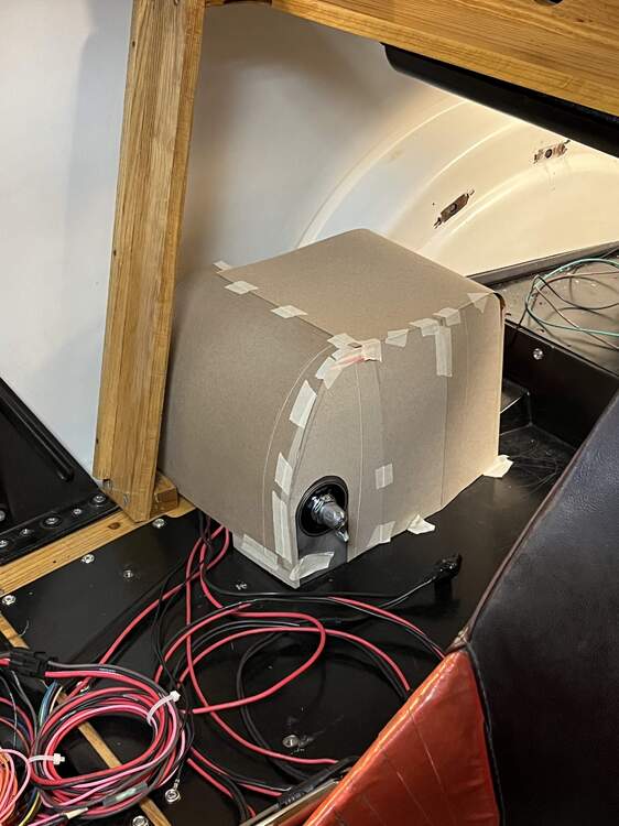

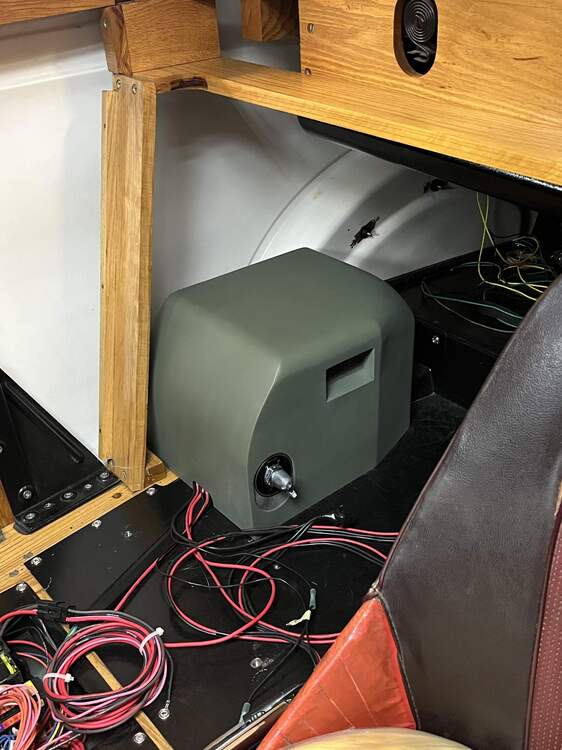

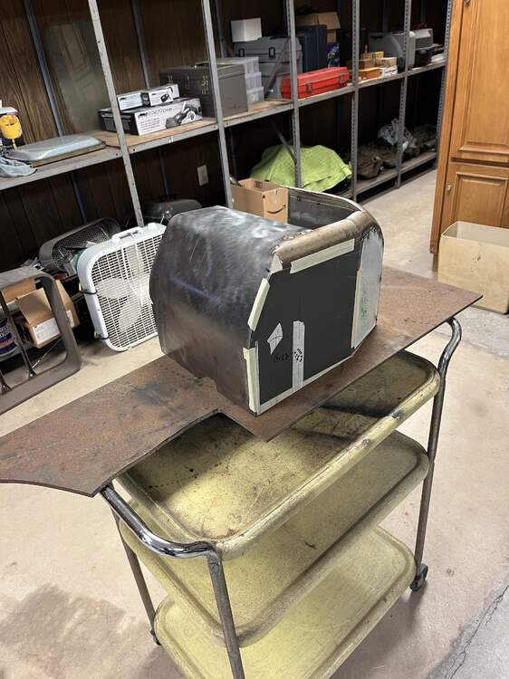

   Battery cover was designed so there would be no sharp edges for anyone riding in the rumble seat since it occupies part of that floor space.

Damn it man, when I seen the Wheaties box, I knew something custom was about to happen! Looks great bro! Keep the pictures coming!

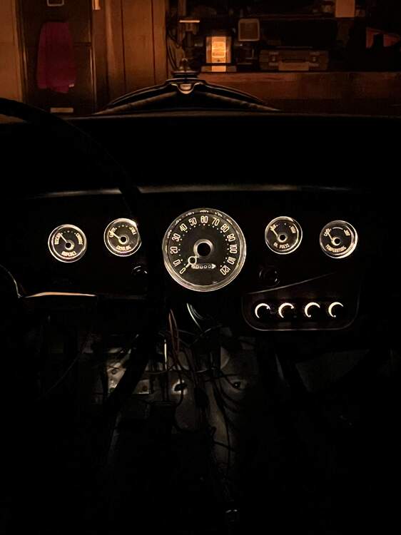

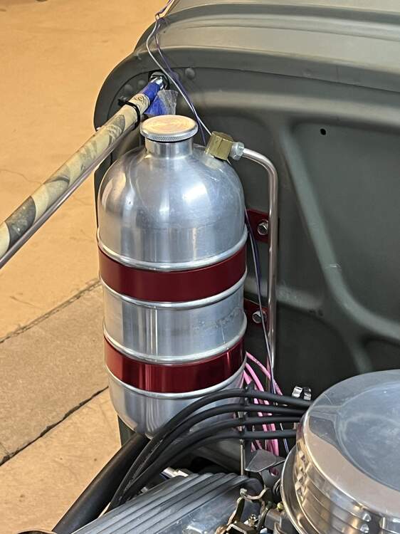

     Overflow bottle installed and gauges with lighting in place.  We experimented with color filters and LEDs for the gauges but decided that it didn’t look period appropriate so we stayed with the original incandescent bulbs.  Also we (my son-in-law and I) installed an NOS 1955 Pontiac parking brake light and flasher.  In the video, the blue/green ring to the left of the brake light is a 1961 Pontiac ignition switch that lights up as original.  Details matter.😉
