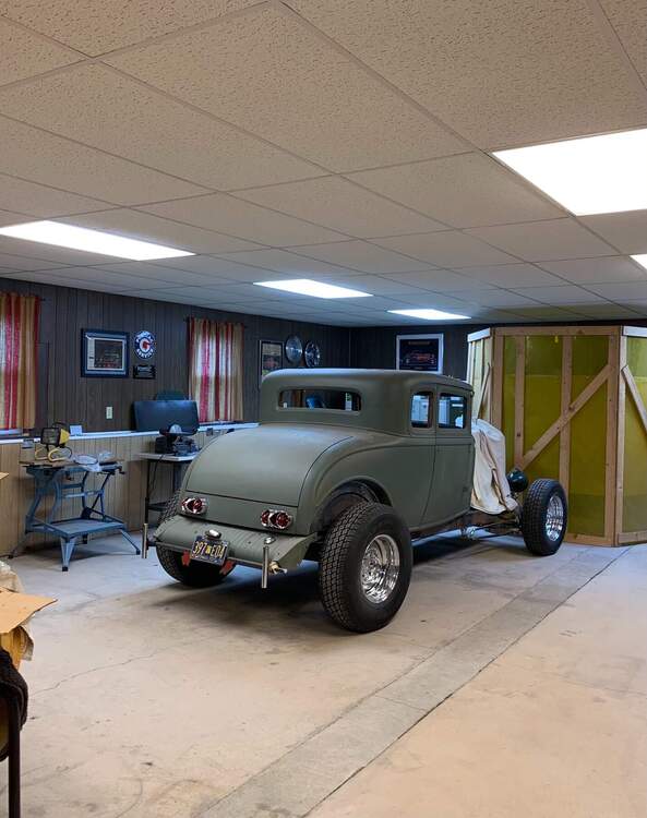

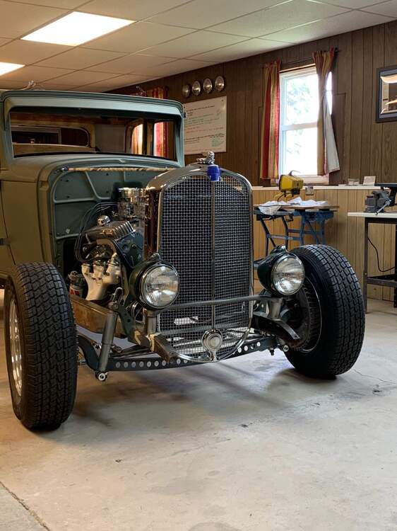

    We now have a rolling chassis. IMG_9342.mov

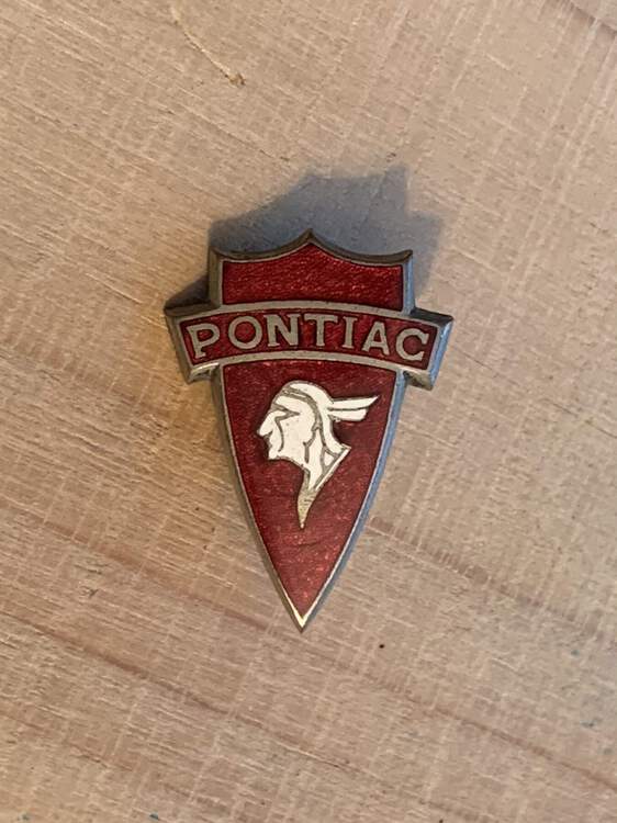

Wow that's what it will look like I can't wait to get mine done as well. I'm hoping I can take it to a jeweler to have restored.
Did you have the one that goes on your dash redone too?
   I sent my emblem to Maxwell Enamel in CA for restoration.  Not cheap, but excellent work!
   I was lucky, my dashboard emblem is good enough to use as is.

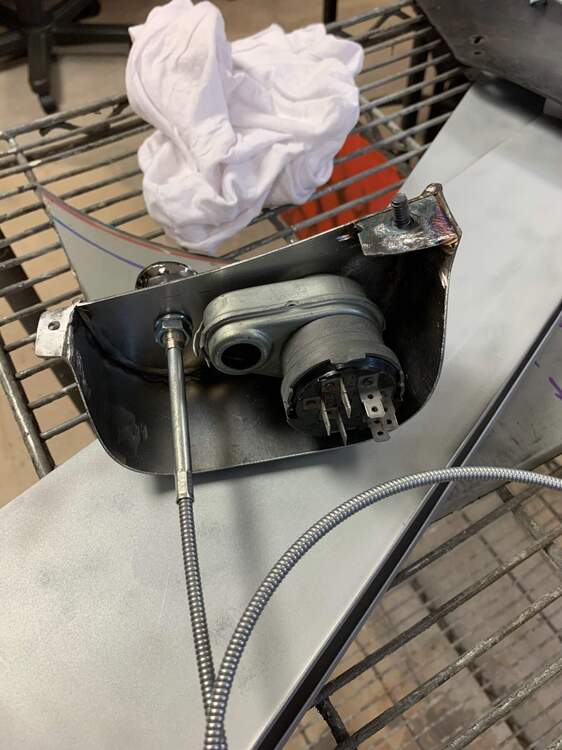

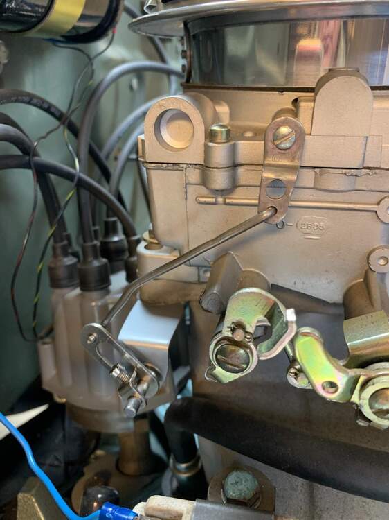

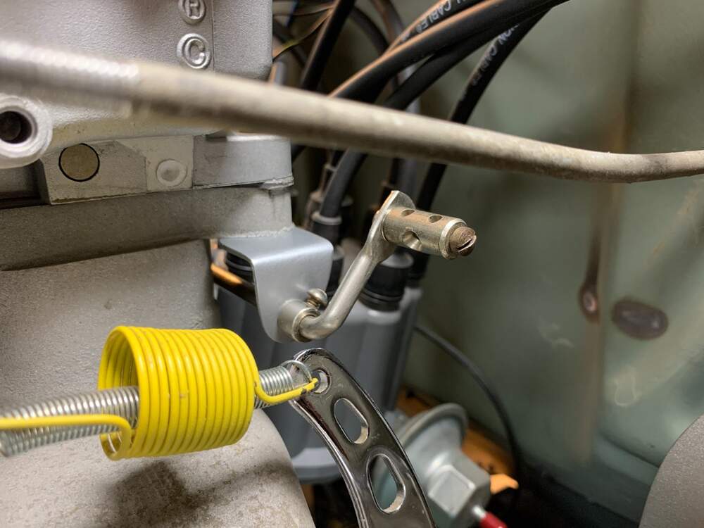

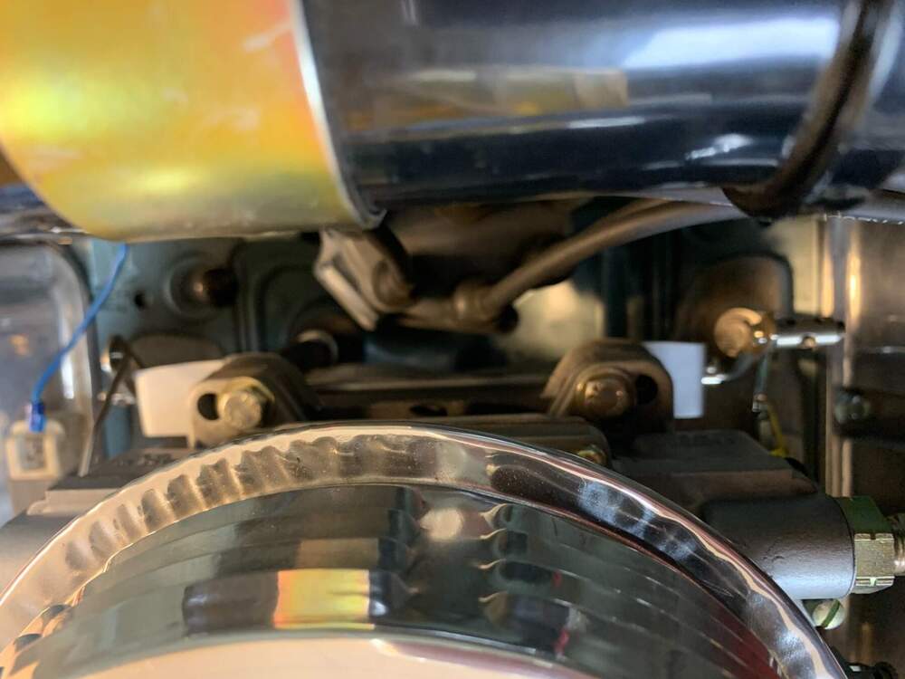

   The A/C  unit under the dash left no room for the manual choke cable to be routed to the right side of the rear carb to meet the choke lever so I designed a bellcrank assembly to fit under the rear edge of the carburetor to do the job.

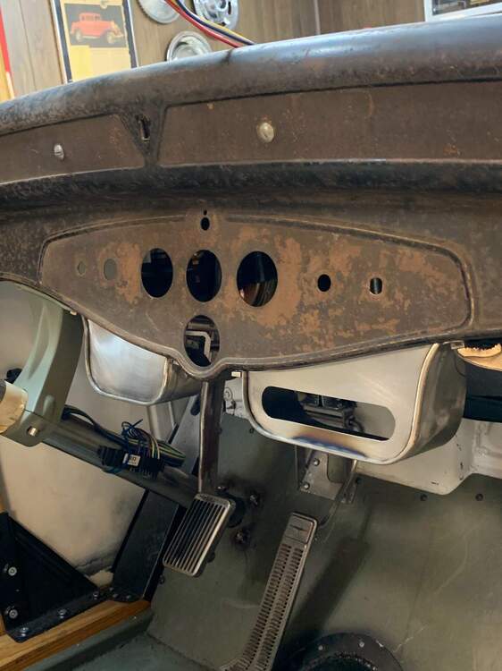

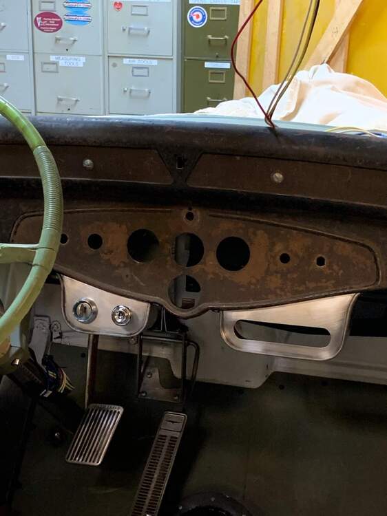

      Not enough room in the dash for all of the gauges and switches so I made 2 “accessory“     panels ,  one to house the choke and ‘61 Pontiac ignition switch and the other for the A/C controls.
Nice work 31, i like the way you have curved the extension, fits in really well👍, sexy as mate 👍 :dancingpontiac:
Nice job! Your additions blend right in.

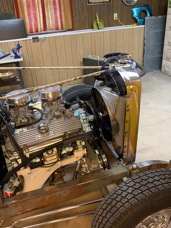

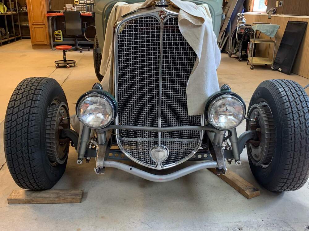

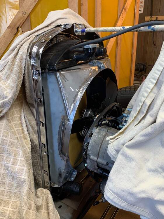

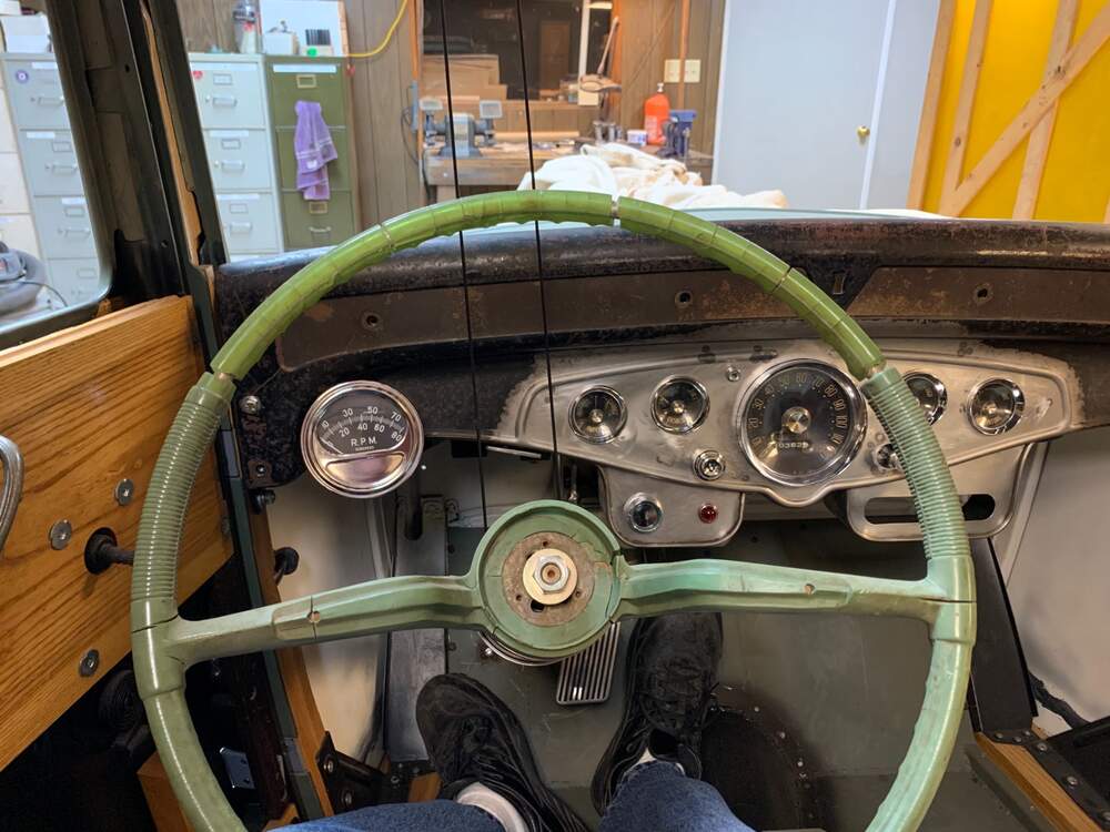

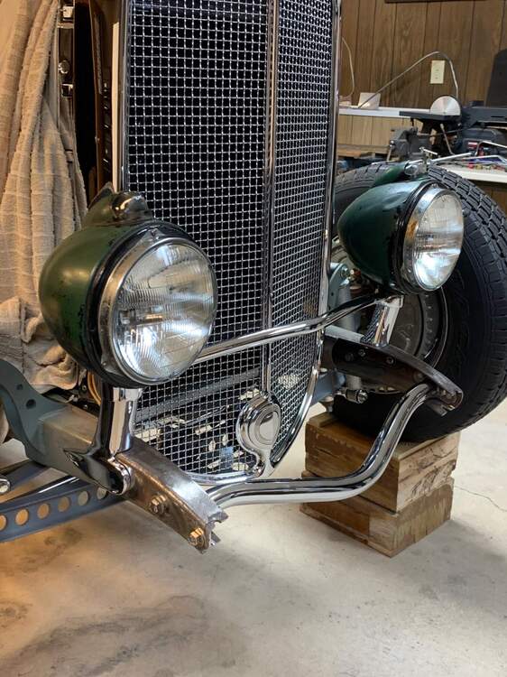

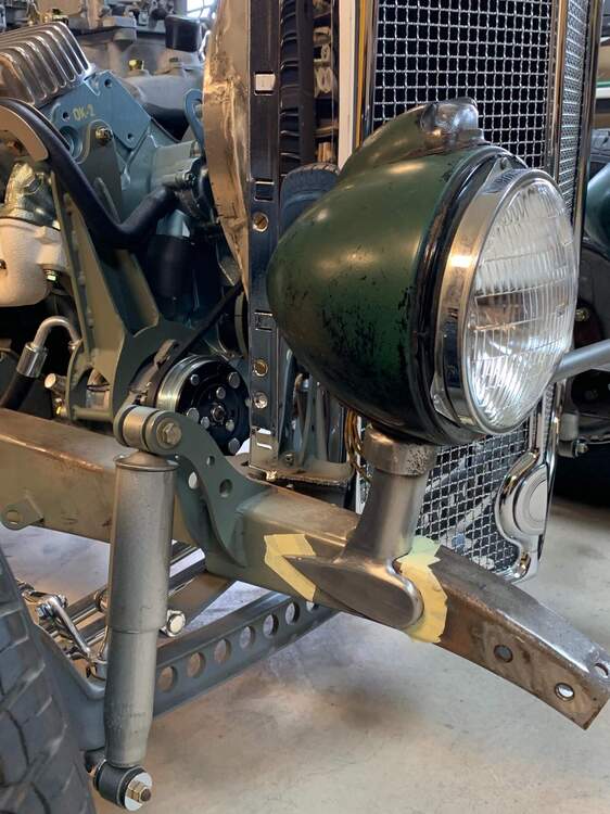

   A little more progress.  17” Derale clutch fan with a shroud made from old metal shelves. Modified the stock headlight bar and custom made the headlight stands to fit the Guide  682-C headlights.  Installed the tach and ‘55 DeSoto gauges.
oh wow mate its looking really good 👍
 love those long branch headers too 👍
Looks sooo good. The Master at work. Thankz for sharing the progress.

   Here are a couple of details I hadn’t posted yet.

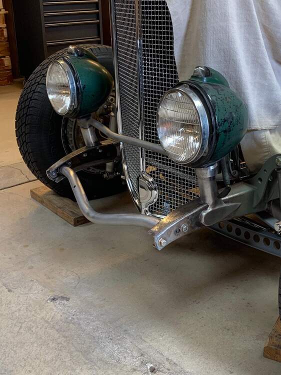

   The ‘58 Chevrolet Bel Air taillights were chosen due to their  ‘60’s showrod feel.  The push bars and rear spreader bar/ license plate plate bracket were fabricated from bar stock and an original NOS Hollywood license plate lamp was used to keep that vintage feel.
    The front spreader bar is a Model A brake bar trimmed to fit between the frame rails. It was chosen because it compliments the      “V”ed shape of the grille
     These parts and a few others were dropped off at the chrome shop at Hershey last week.
That looks soooo good!   Really nice job on the headlight brackets.:indian:
I agree with justA .... very cool and the 58 tail lights suit it 👍👍👍

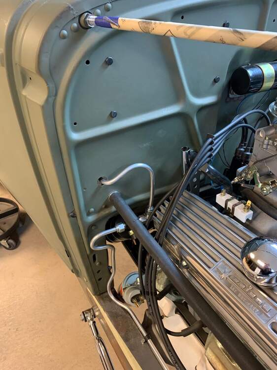

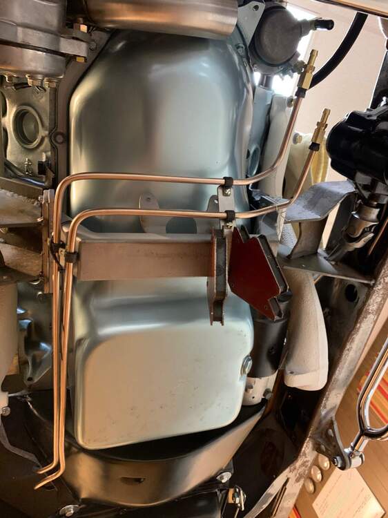

   Just a brief update.  My son-in-law helped bend some AC and trans cooler lines.
   Also picked up the chrome before Christmas.  Librandi’s does excellent work!
Nice and clean work. I can't wait to see more.

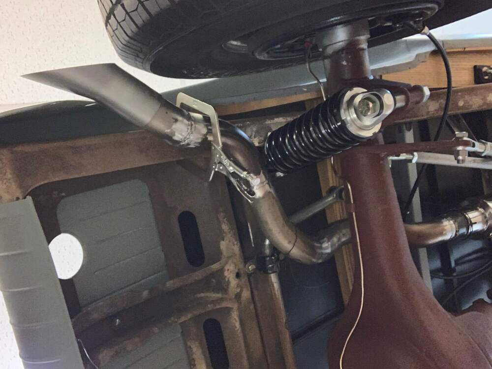

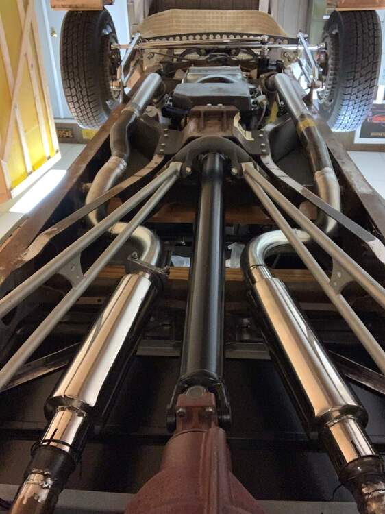

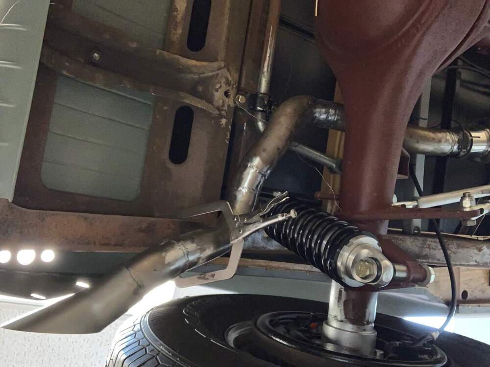

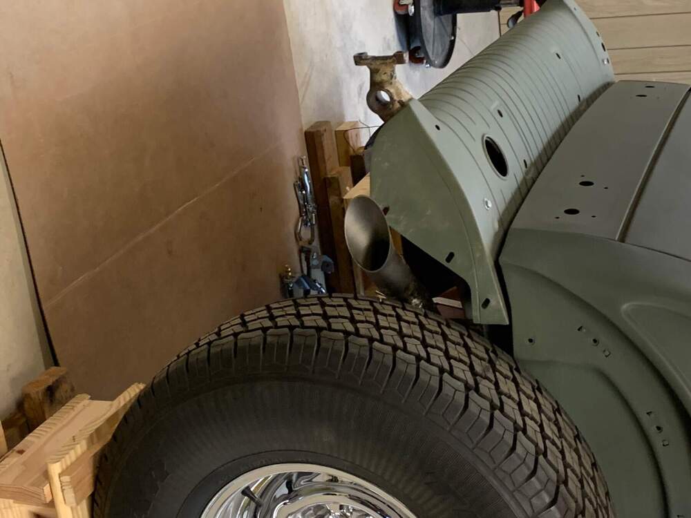

Routing exhaust was challenging. Mufflers are Pypes RacePro and tips are modified Olds 442 pieces.   Also could use some help rotating last pic.😬51E30CEE-3385-412F-B9A8-9CB6E1C7FA34.thumb.jpeg.0ebe820587f62009aec0290c976b6483.jpeg
Very cool update. Any particular reason for the Olds tips? The cool factor? I had them lying around the shop?
    Frosty, the exhaust on Mickey Thompson’s Challenger I was my inspiration.  Although not a direct copy, I tried to have a similar look with the hard slice cut pipe. The 442 tips ( flea market find) received a harder than original angle cut and I feel gives the end of the pipe a more finished look.
     The sides of the gas tank cover will eventually be modified to accommodate the tailpipes better.
That's a better story than I expected 31pontiac. Thanks for sharing that one. Inspired by history. I like it!
