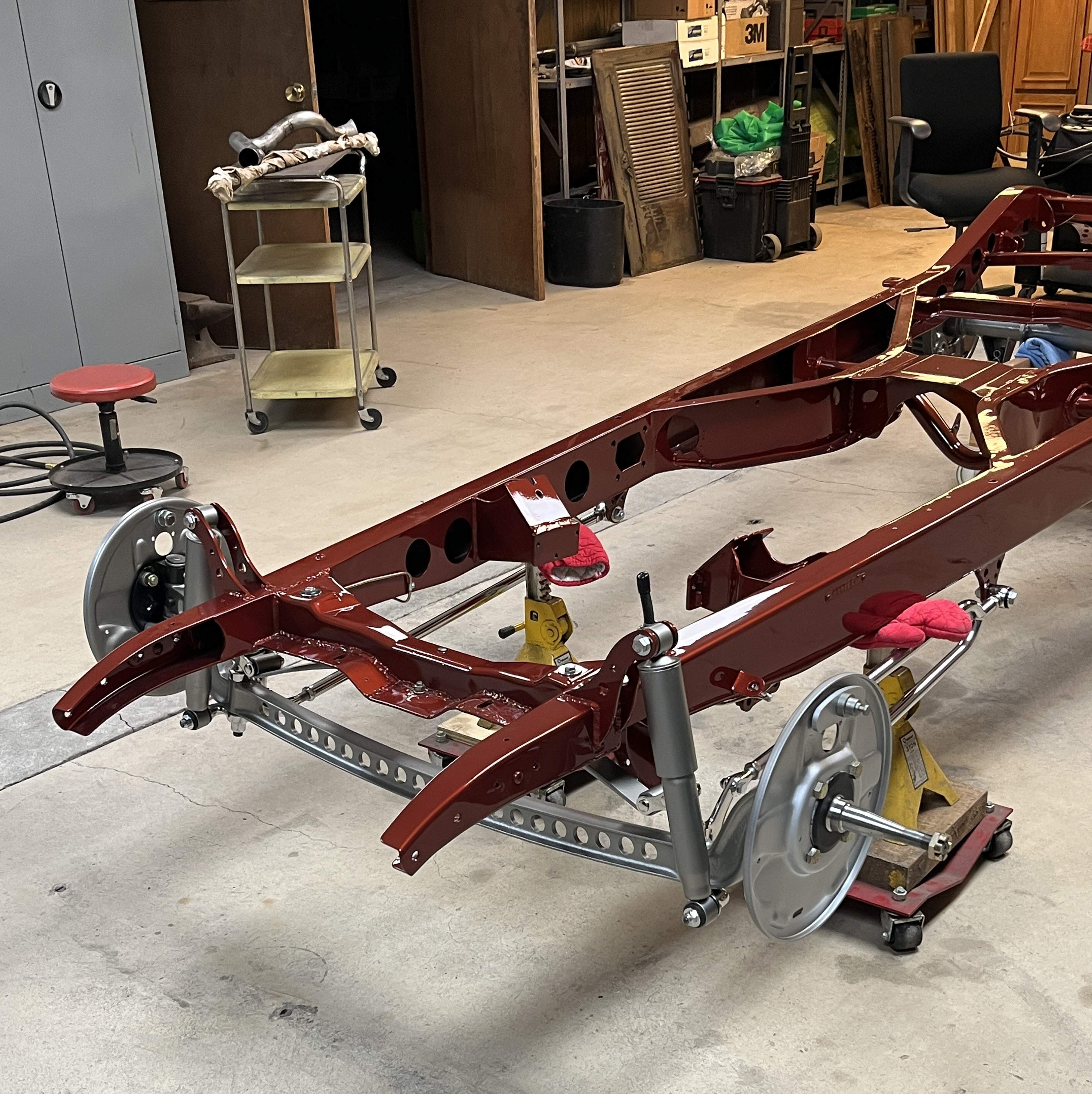

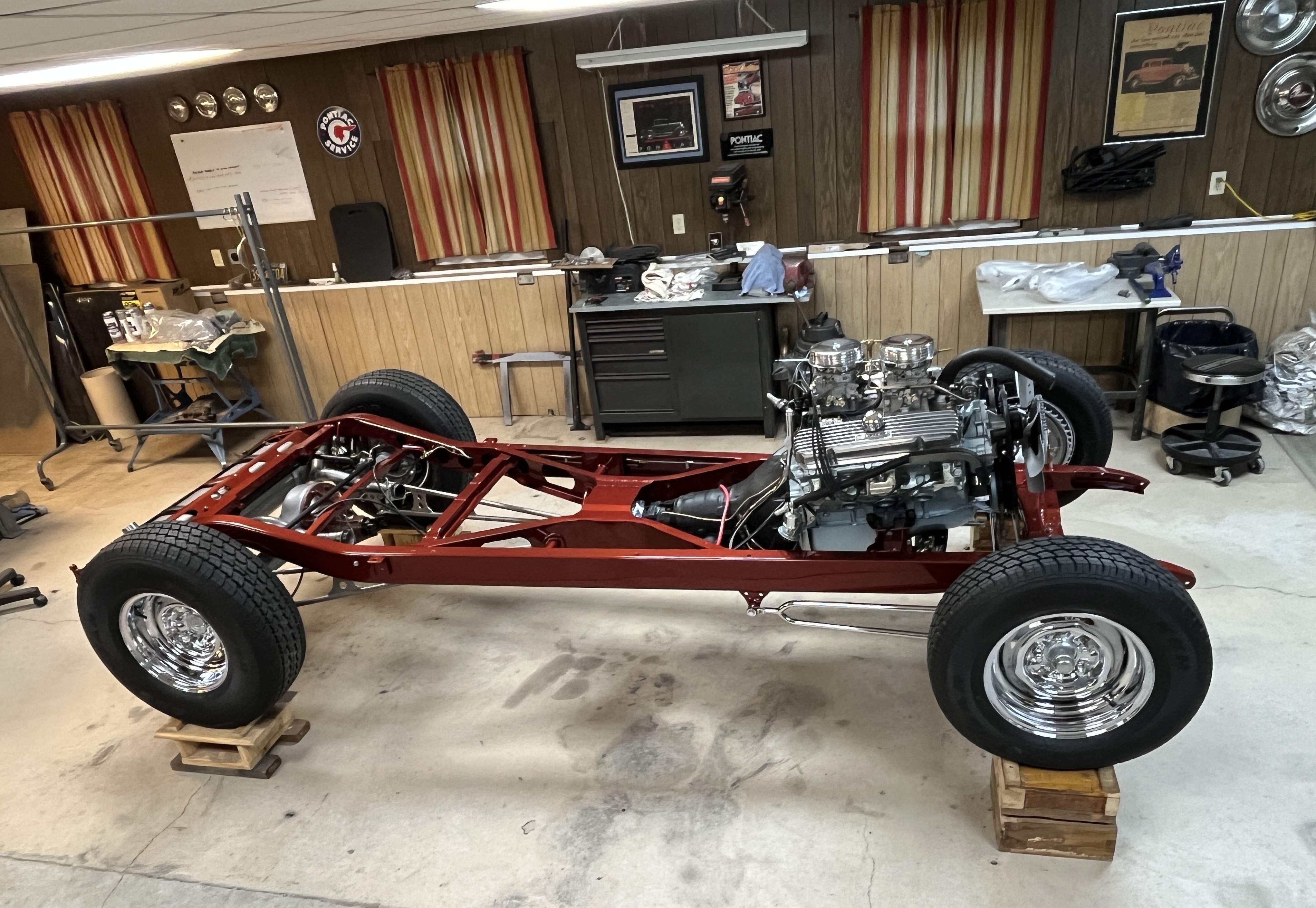

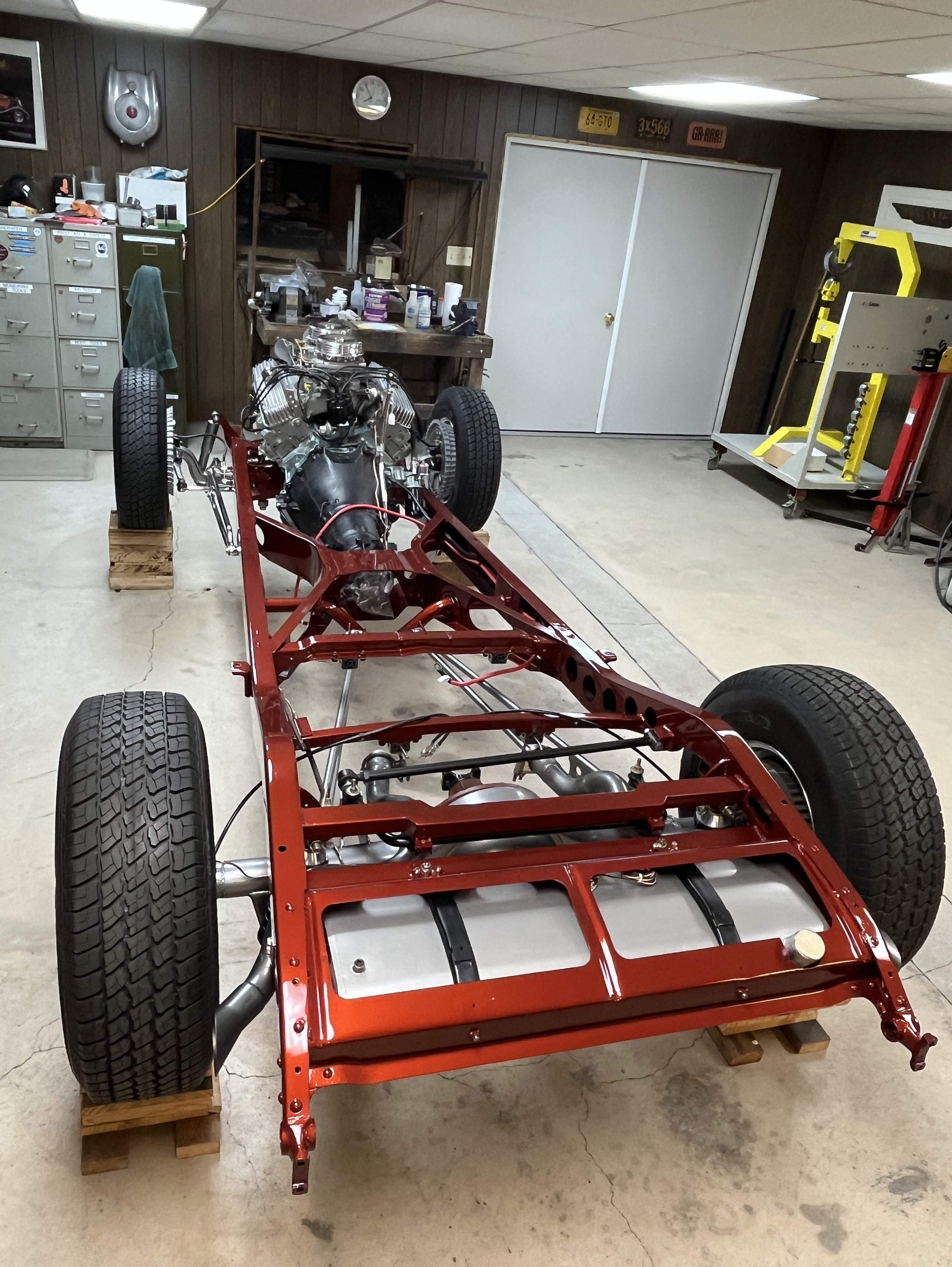

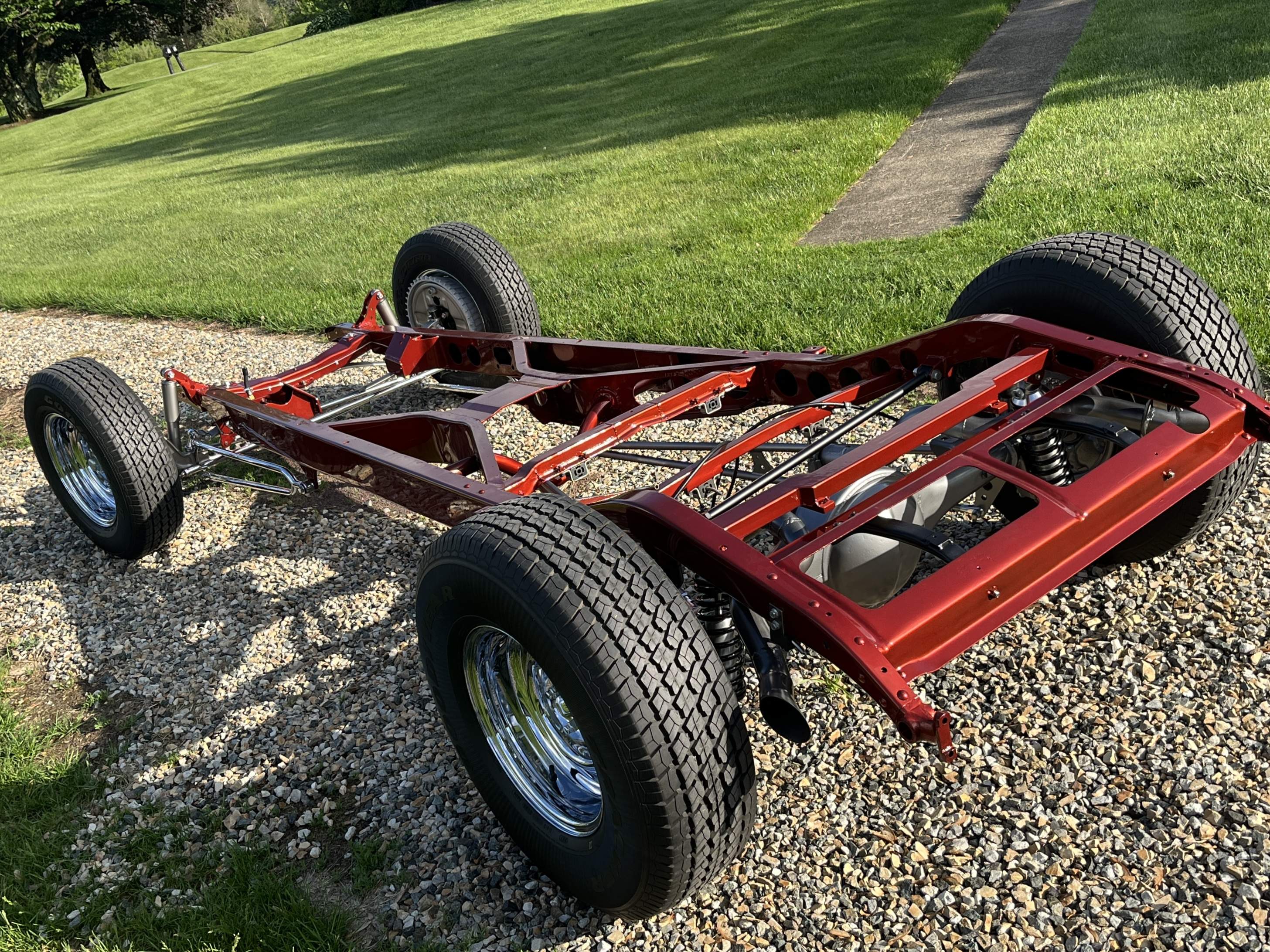

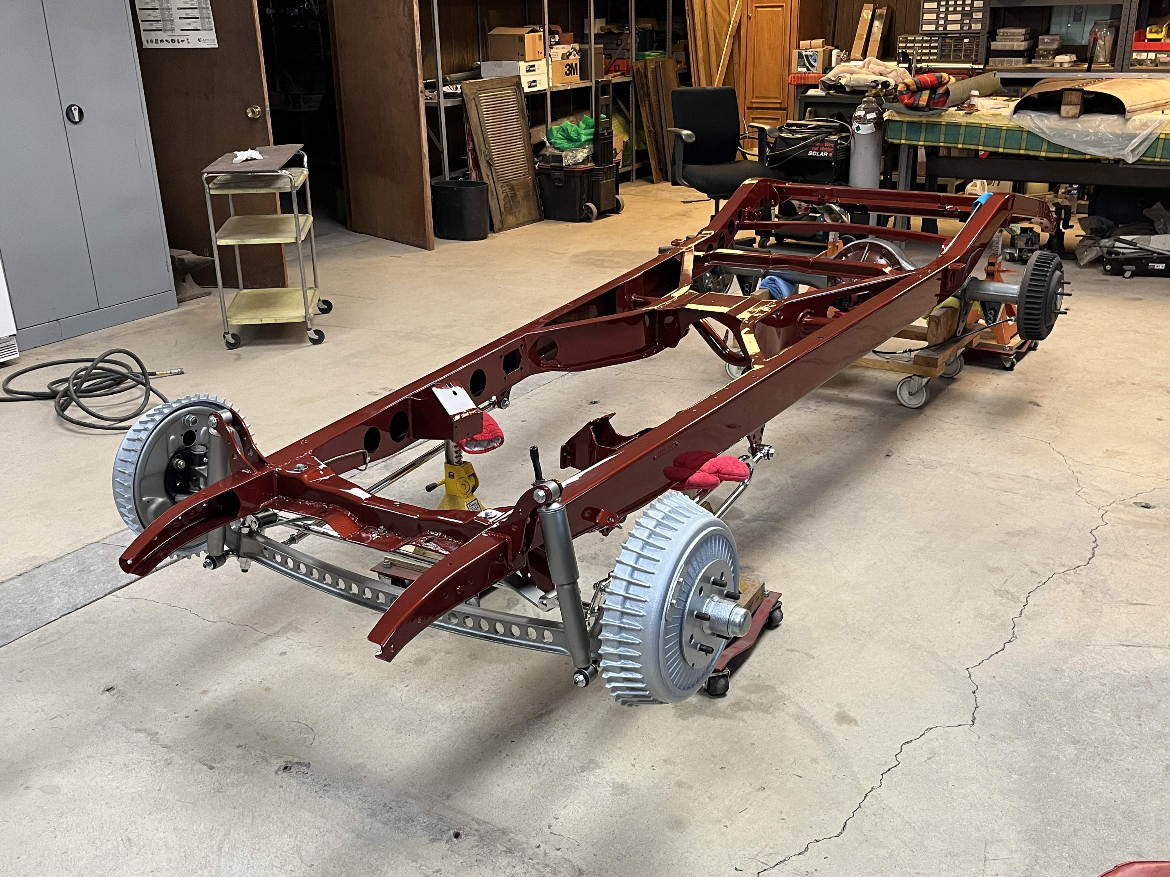

    We now have a rolling chassis. IMG_9342.mov
  • I didn’t think the battery area would be so complex with battery cables, main power switch and vent tubes. The smaller wires are preliminary and will be cleaned up.     Battery cover was designed so
  • With the manifolds back on the engine, my brother and I spent 4 1/2 hours installing the rest of the exhaust system. It became a lot more challenging than either of us anticipated, but we finally got

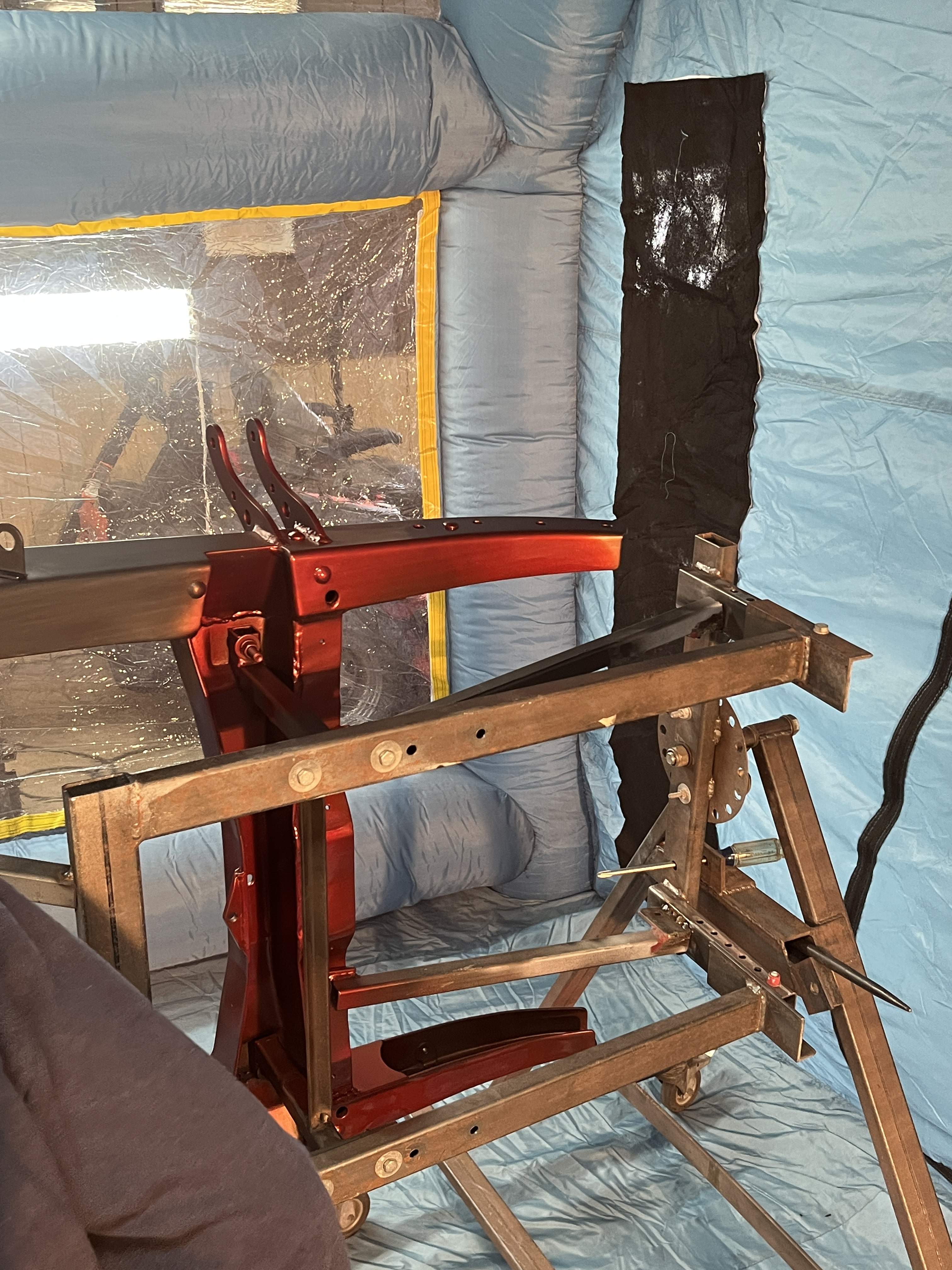

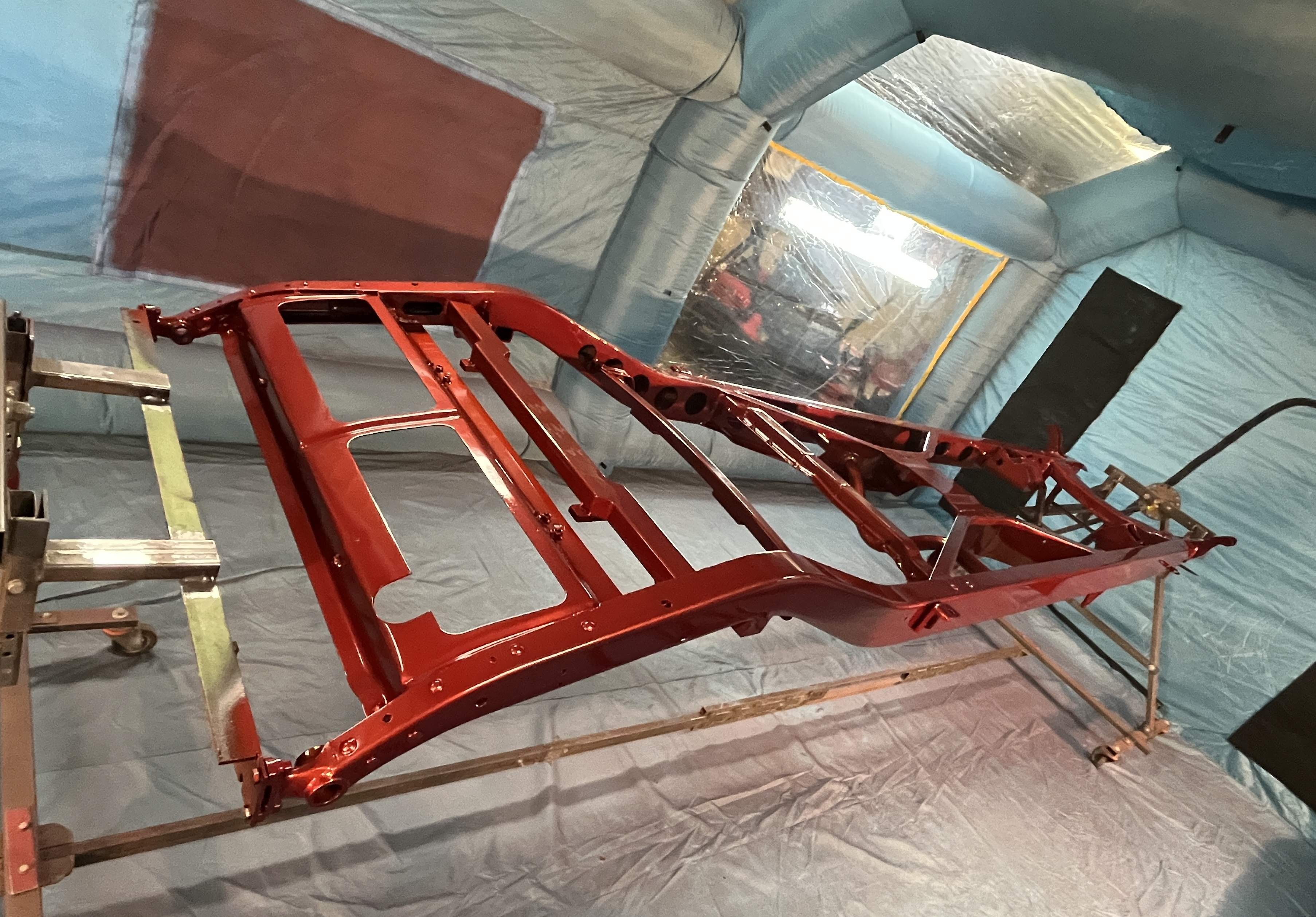

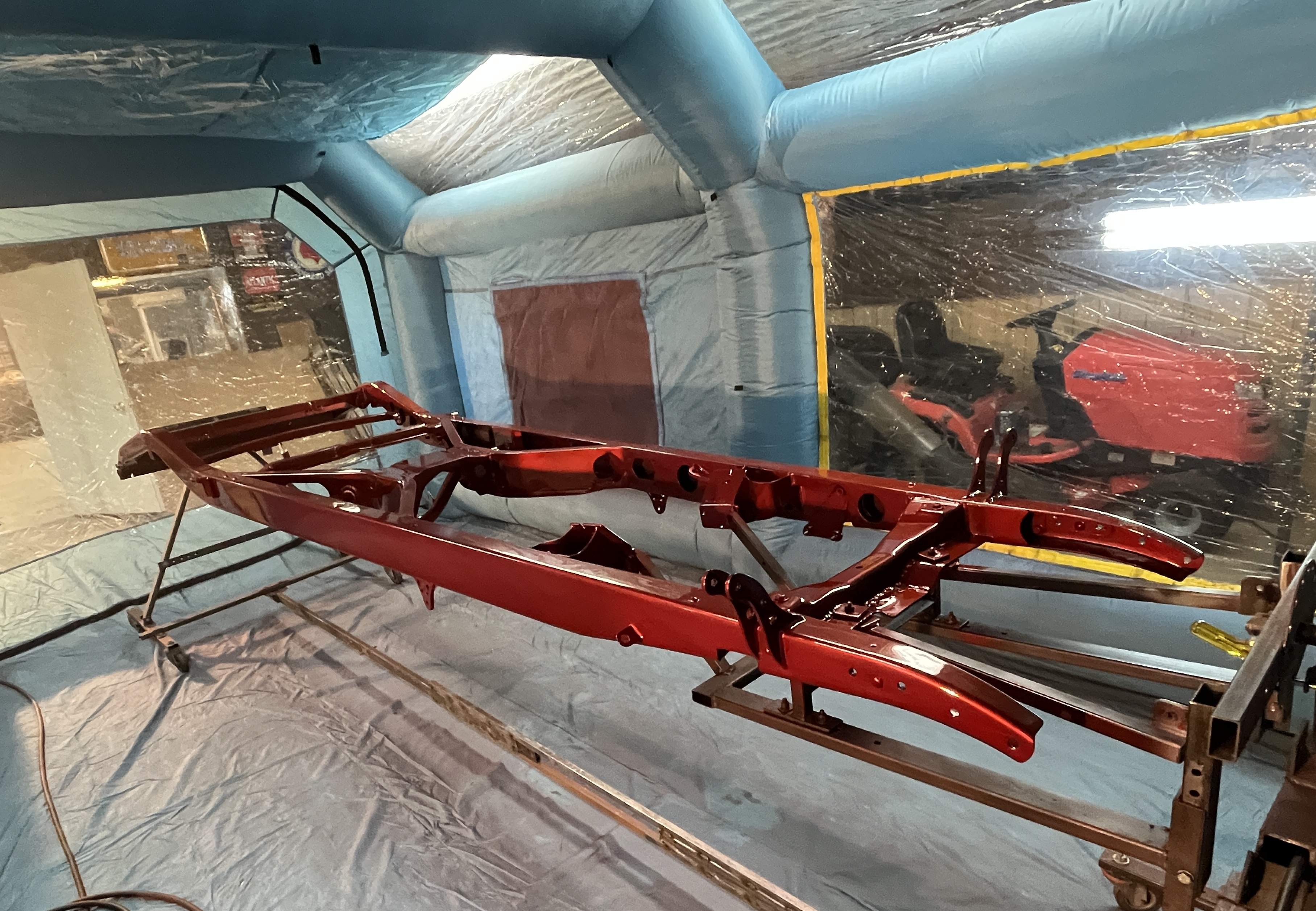

The booth was on sale at Home Depot online for $495 ( down from $720 ). It includes 2 fans, 1 to inflate the booth and 1 to pressurize it.  Also includes filters.
  It measures 23 feet long, 13 feet wide, and depending which spec you read 8.5 or 9 feet high.  I selected this size because it fit (just barely) in my building.
    I got it in 4 days with no shipping cost!

Drooling on key board.  Please don't short.
Jewlery....put a chain on it and I'd wear it round my neck.   Beautiful job!
Man that looks slick. Good job bro!

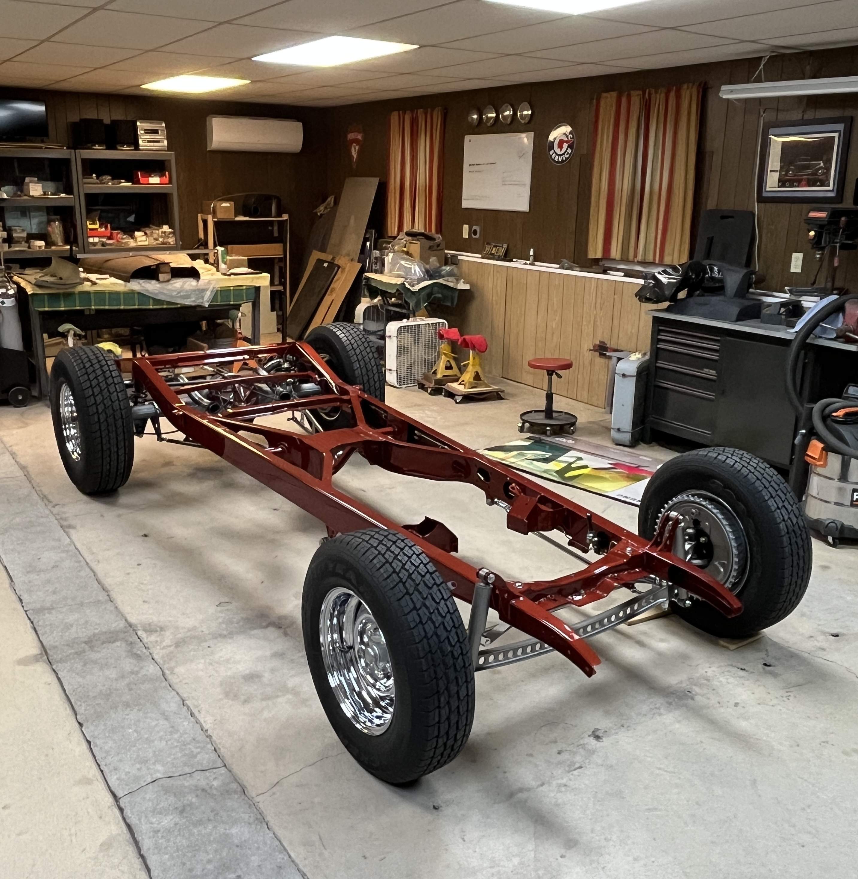

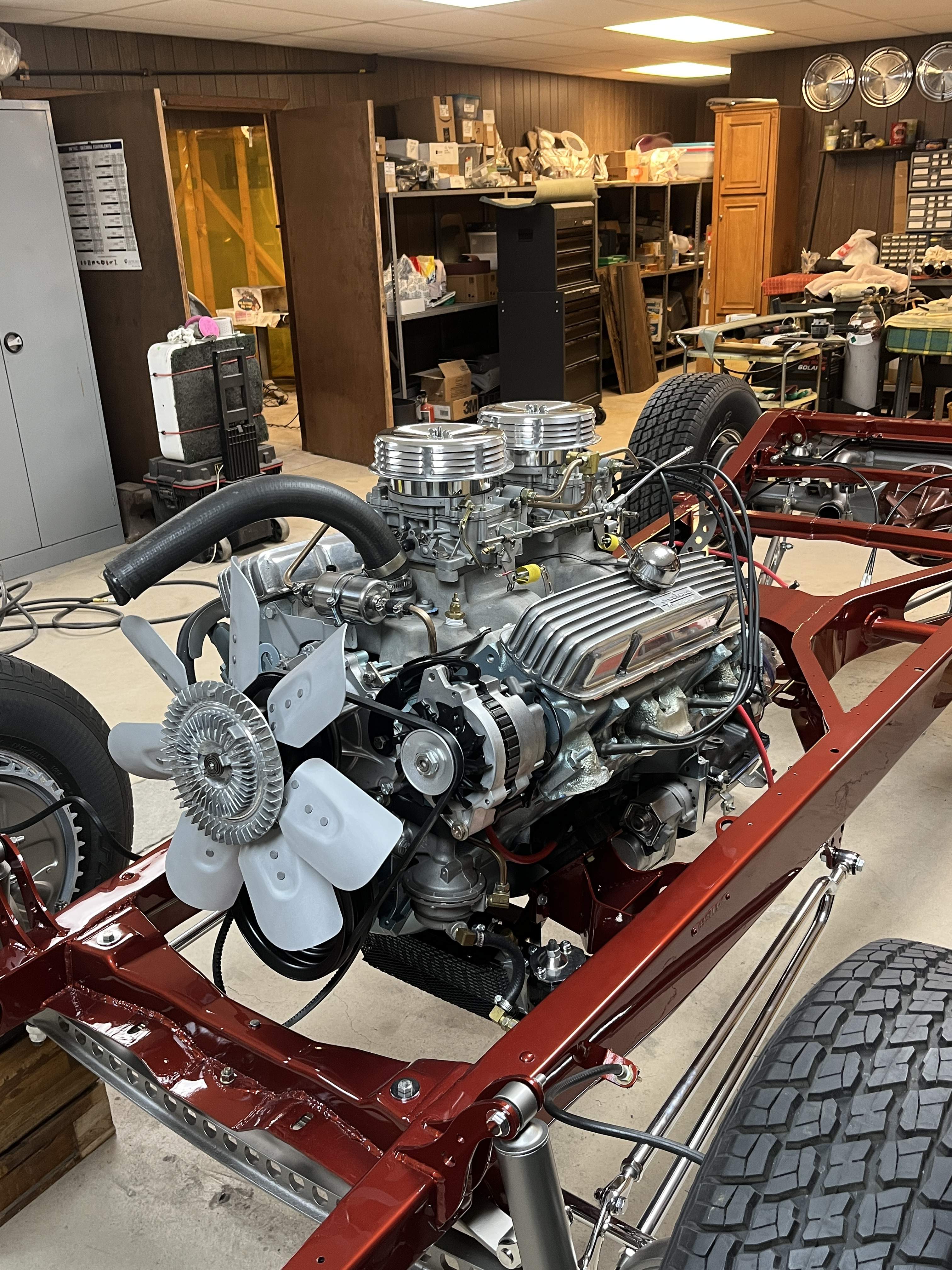

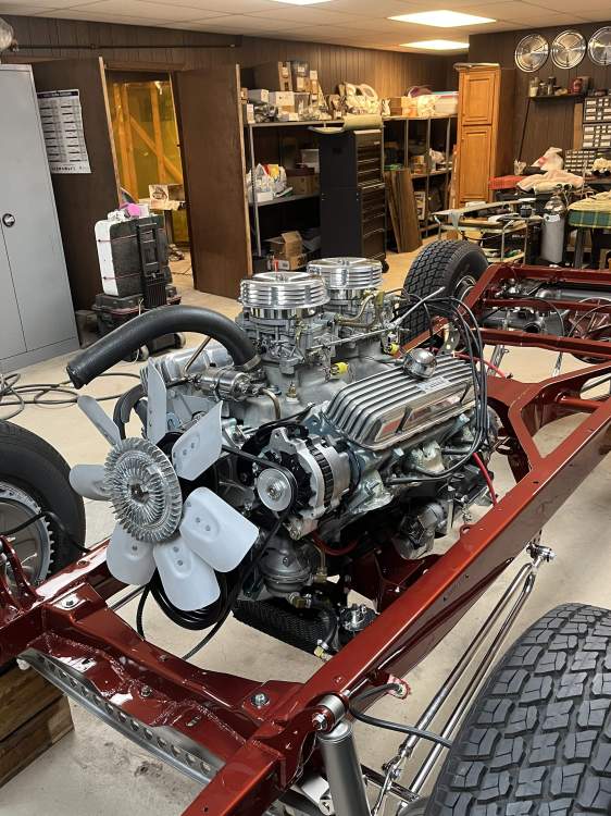

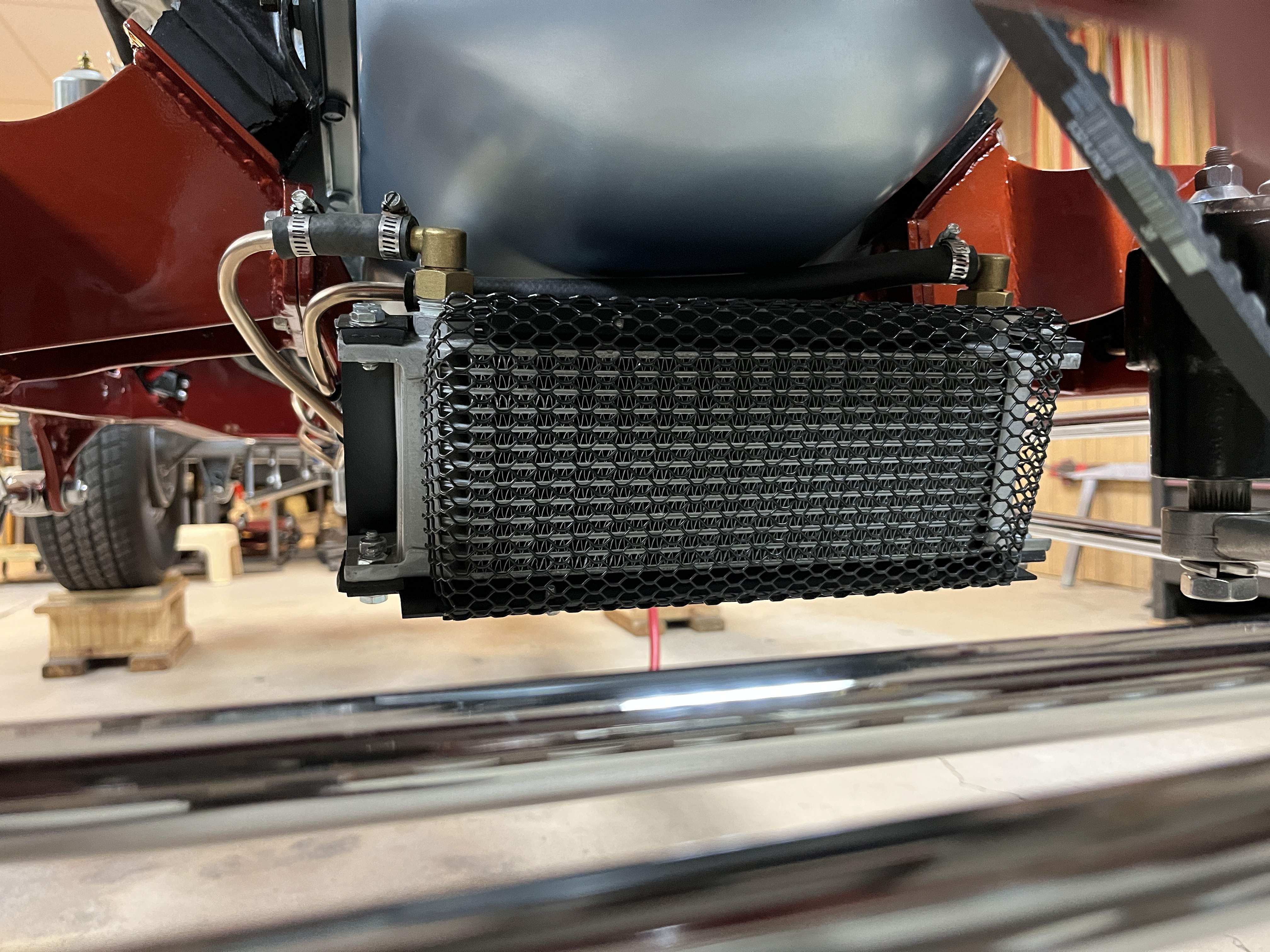

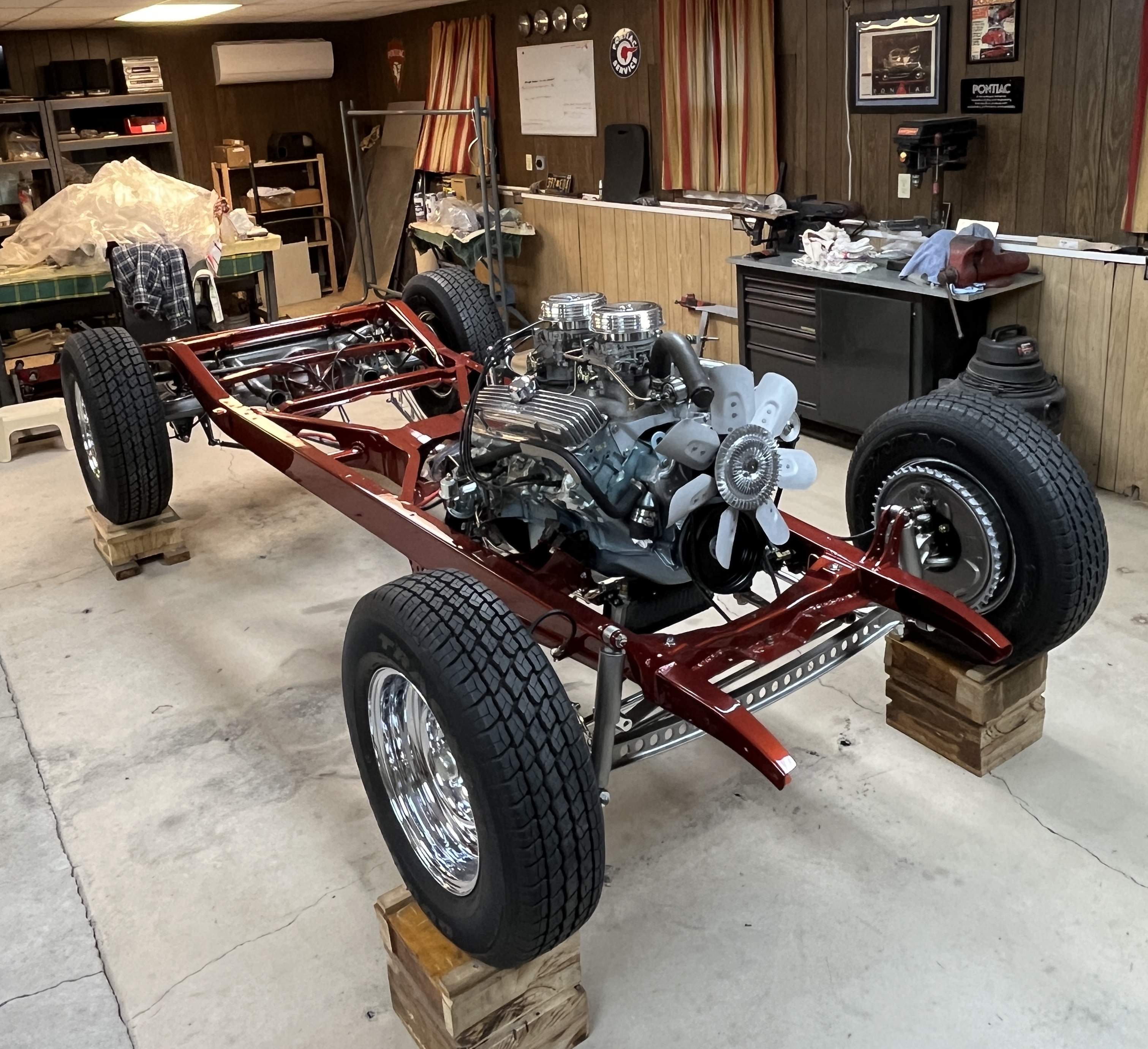

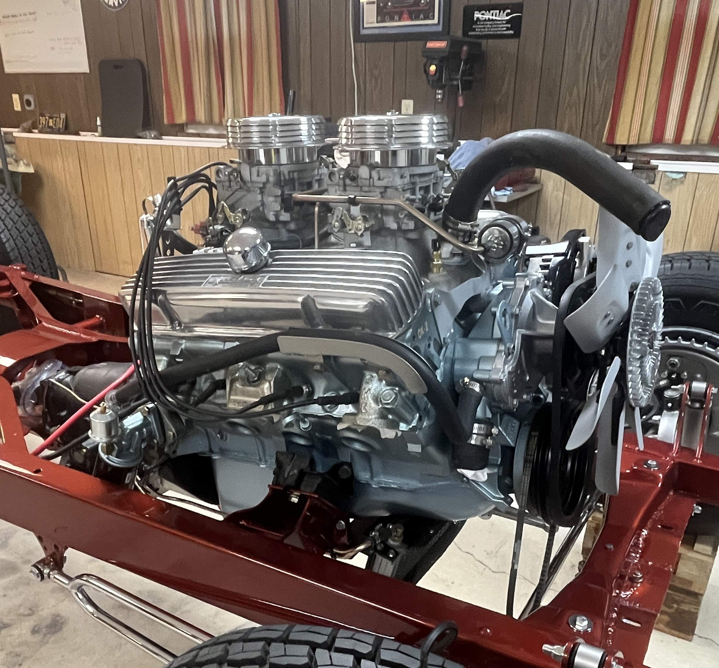

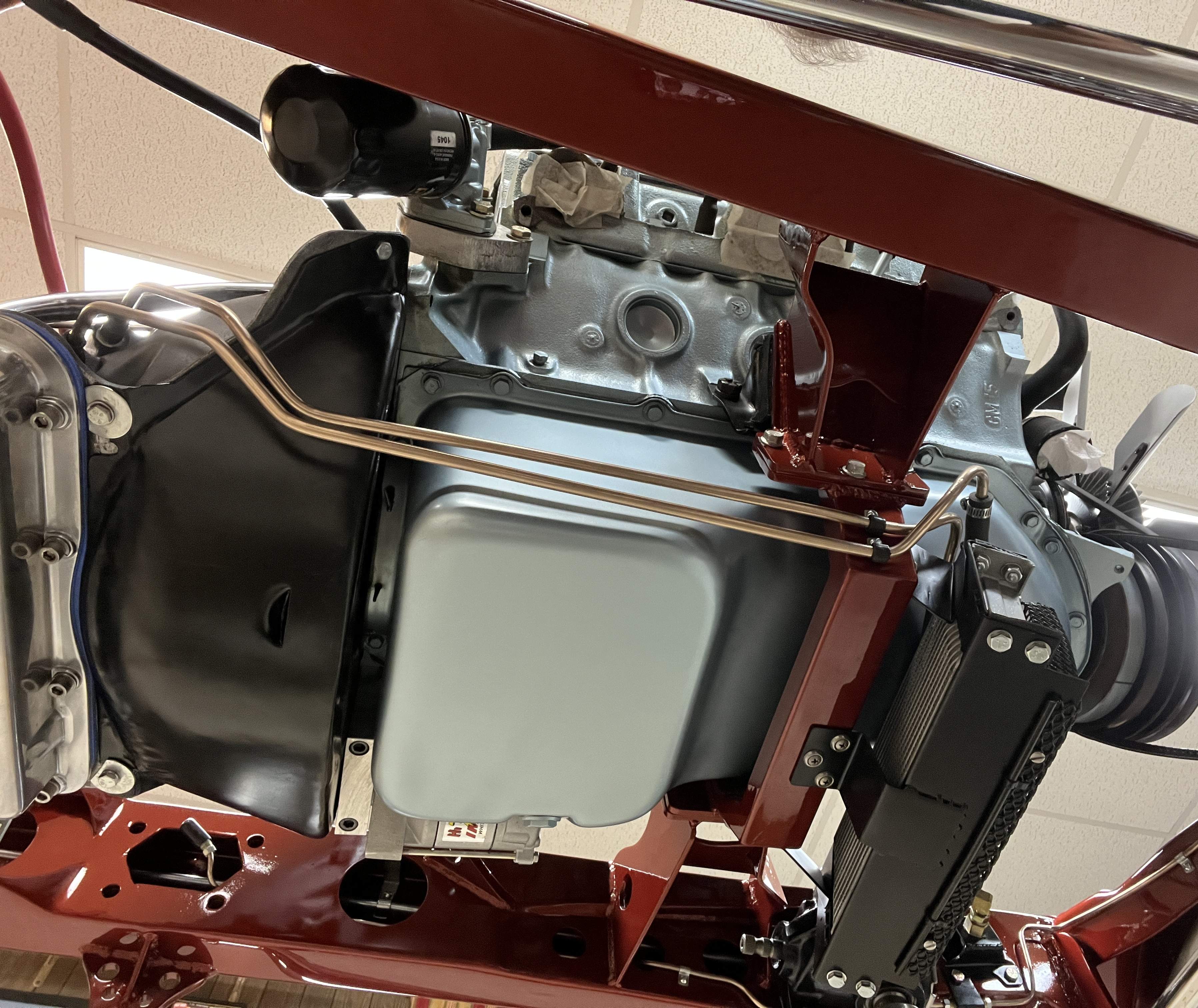

Been a few months so I figured it was time for another update. I sanded and repainted the oil pan to fix some self inflicted scratches before I installed the engine and transmission back in the frame. Fan, oil cooler, alternator, gas tank, fuel line, and most of the brake lines also added
Wow, that is a clean looking build.
Rick
That deserves to be hung on a wall, justa save space N stare at it. Beautiful job!

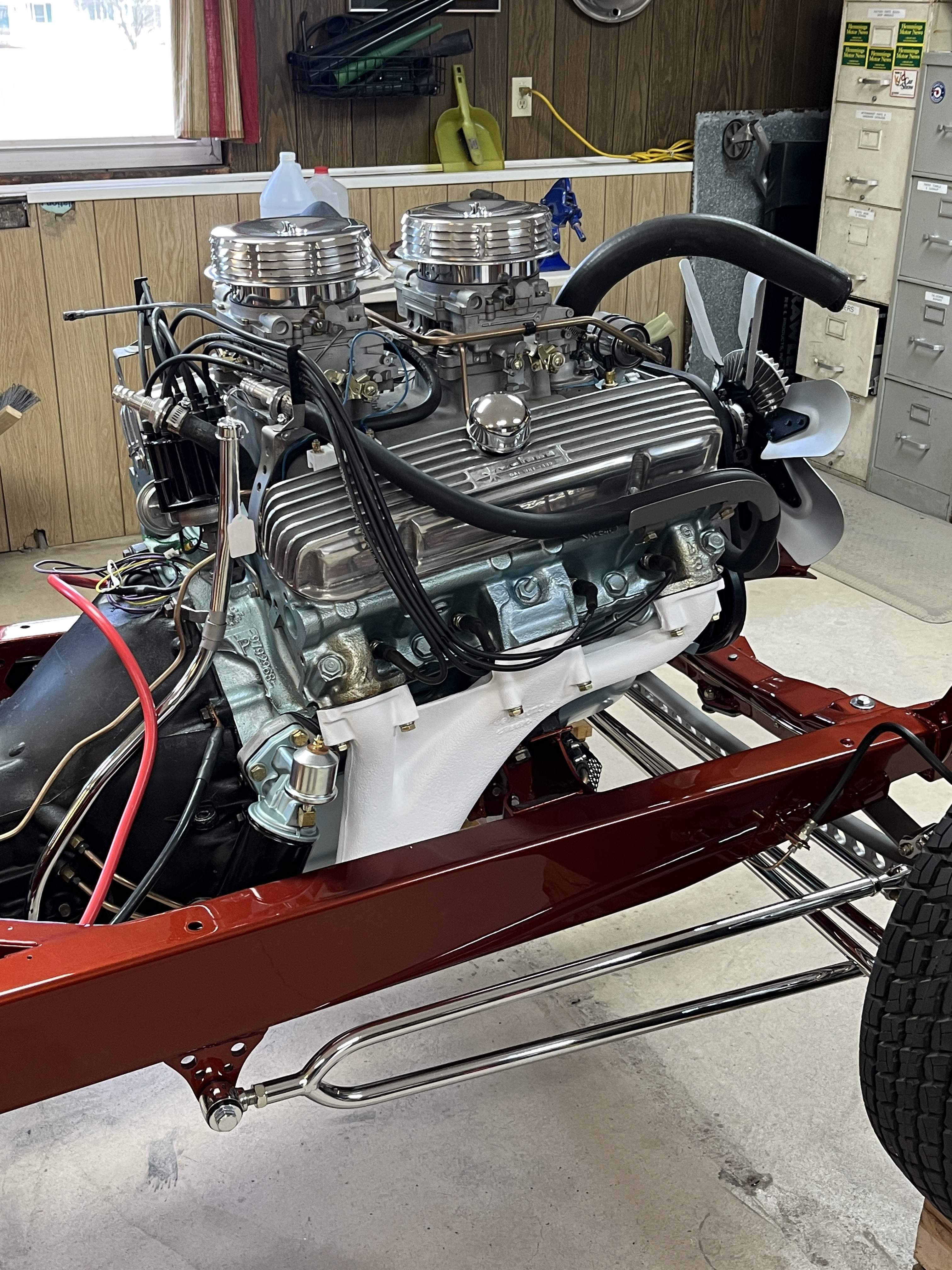

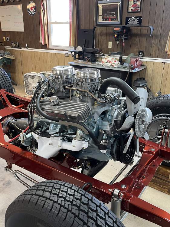

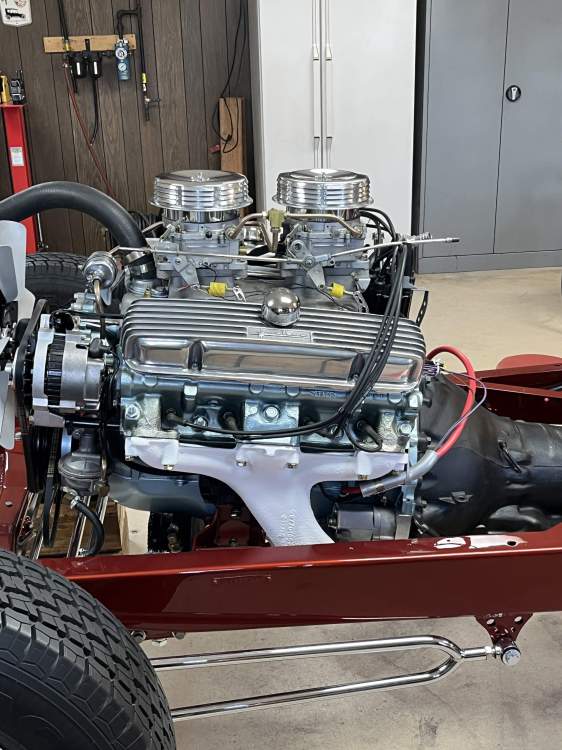

Just a little progress to share. White 1969 Firebird Ram Air III manifolds installed.
Bodywork is taking forever 😬.
Edited by 31pontiac
Fix words
i think those manifolds are sexy as !!! well done tim cheers
i cant see in the pic, did you have to use the oil filter spacer ?
They do look good, are they F-Body Ram Air II manifolds? Round Ports?
Thanks Kiwi!
Yes, I had to use the oil filter spacer to clear the manifold.
No, they are D-ports off of my ‘69 Trans Am RA III leftover from when I put a RA IV in that car.
Nice, I have the A-Body version of those on my 71 Catalina, but it is hard to see them, But they sound good! And on my car just the normal 90 degree oil filter adapter works with room to spare.
Edited by cammerjeff
It looks great. What transmission are you running? 350? 400 Turbo?
I agree, Pontiac cast iron performance manifolds work well and ( at least to my ear) have a much better sound than tube headers. I used these because: A. I already had them and B. They fit inside my narrow frame.
Turbo 350, with a 3:08 posi in a ‘57 Pontiac rear.
Free (or I already own them) are the best parts! I use the reproduction RA/HO exhaust manifolds on Lucy! I can totally appreciate you doing that!
Going with a ‘57 BOP Hotchkis style rear end is very old cool school! Me likey! pop_corn

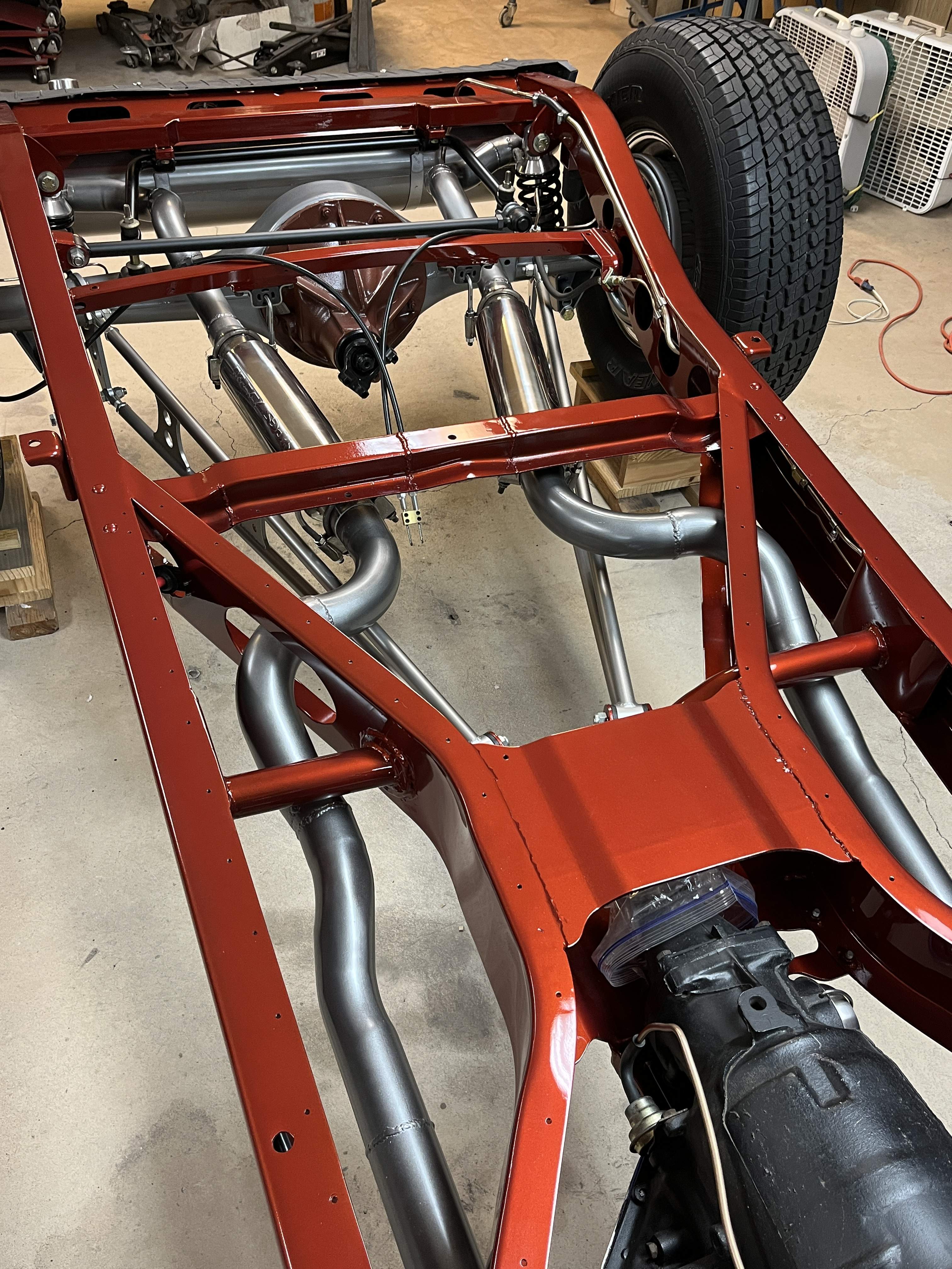

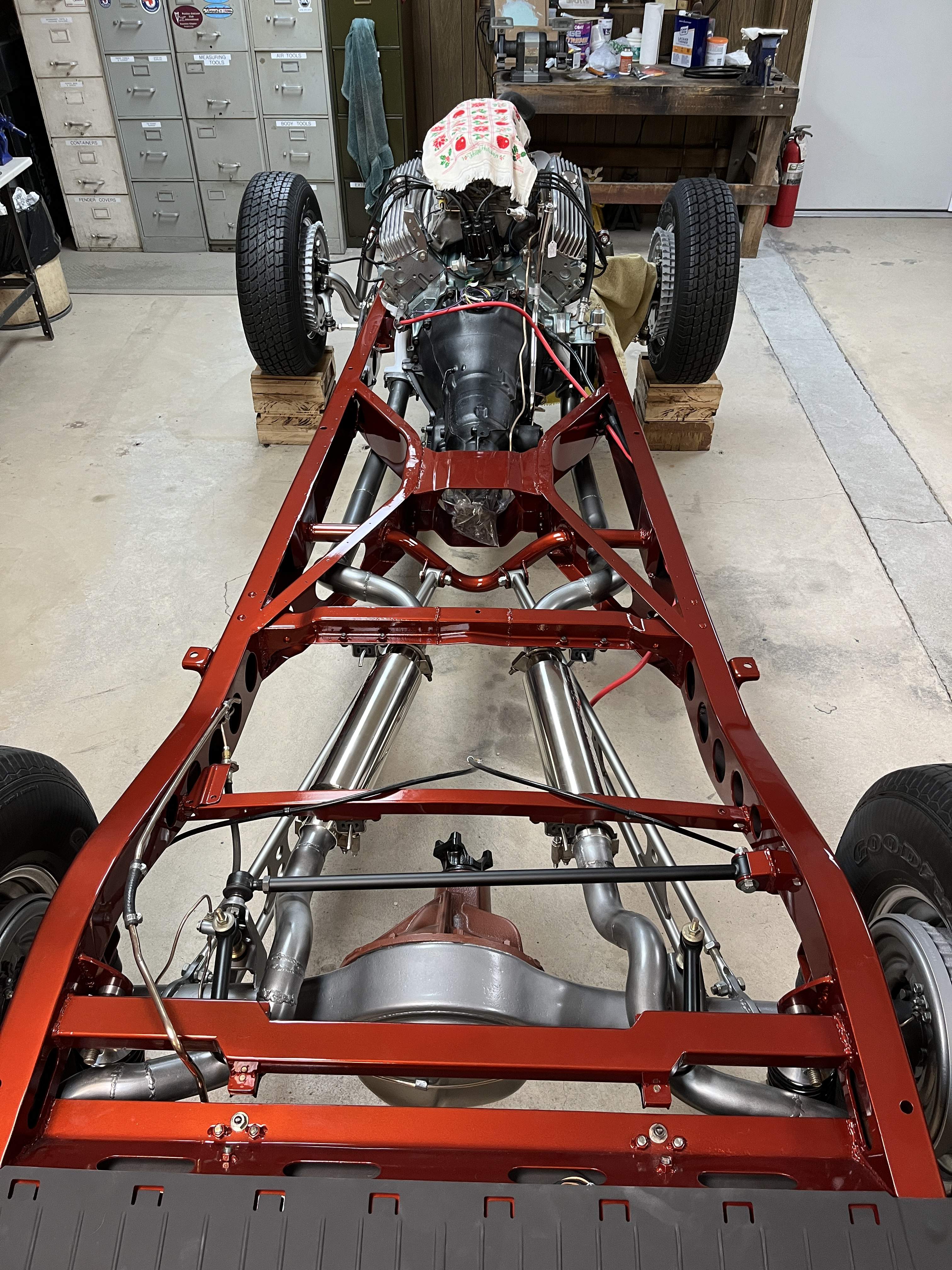

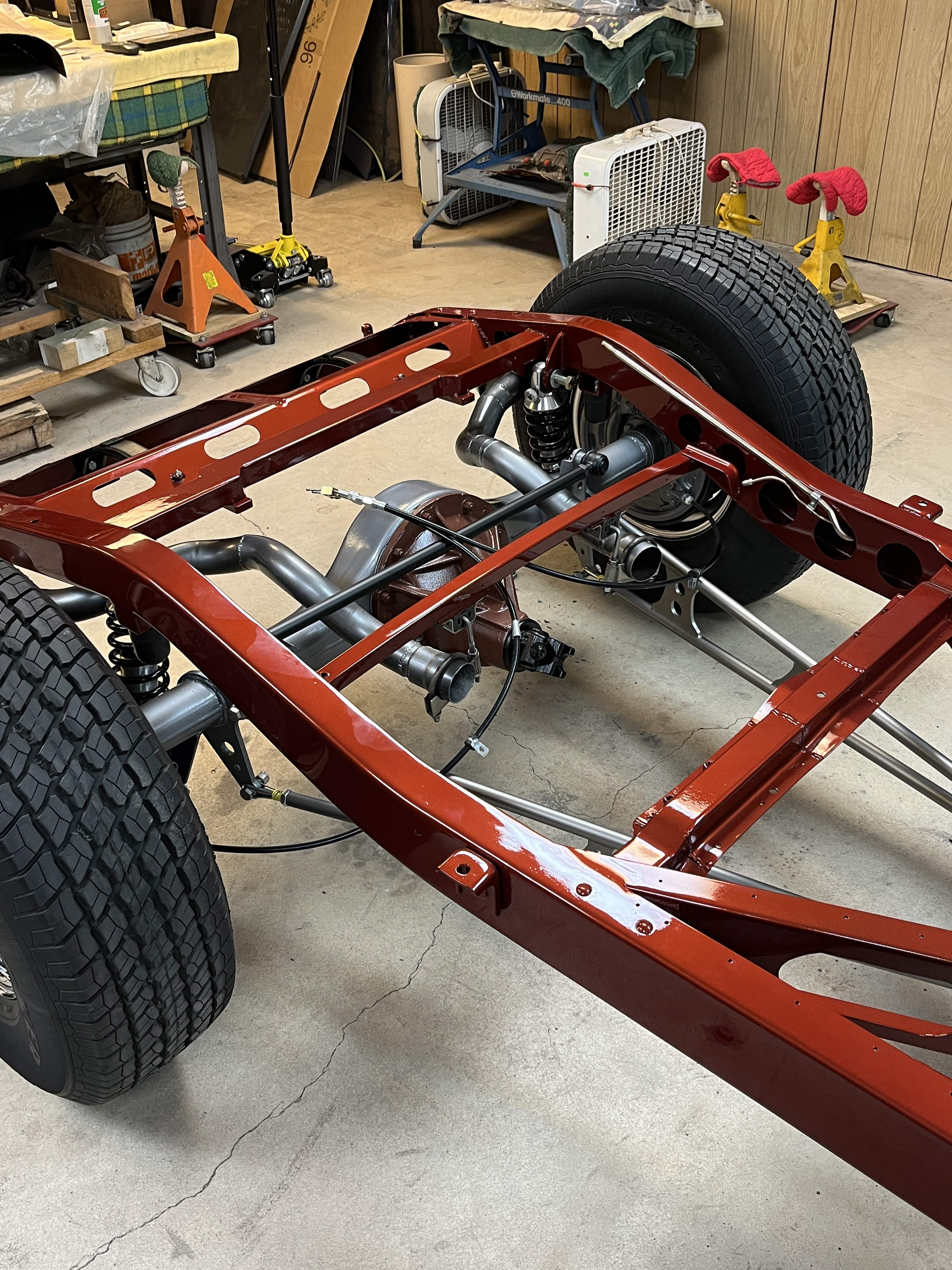

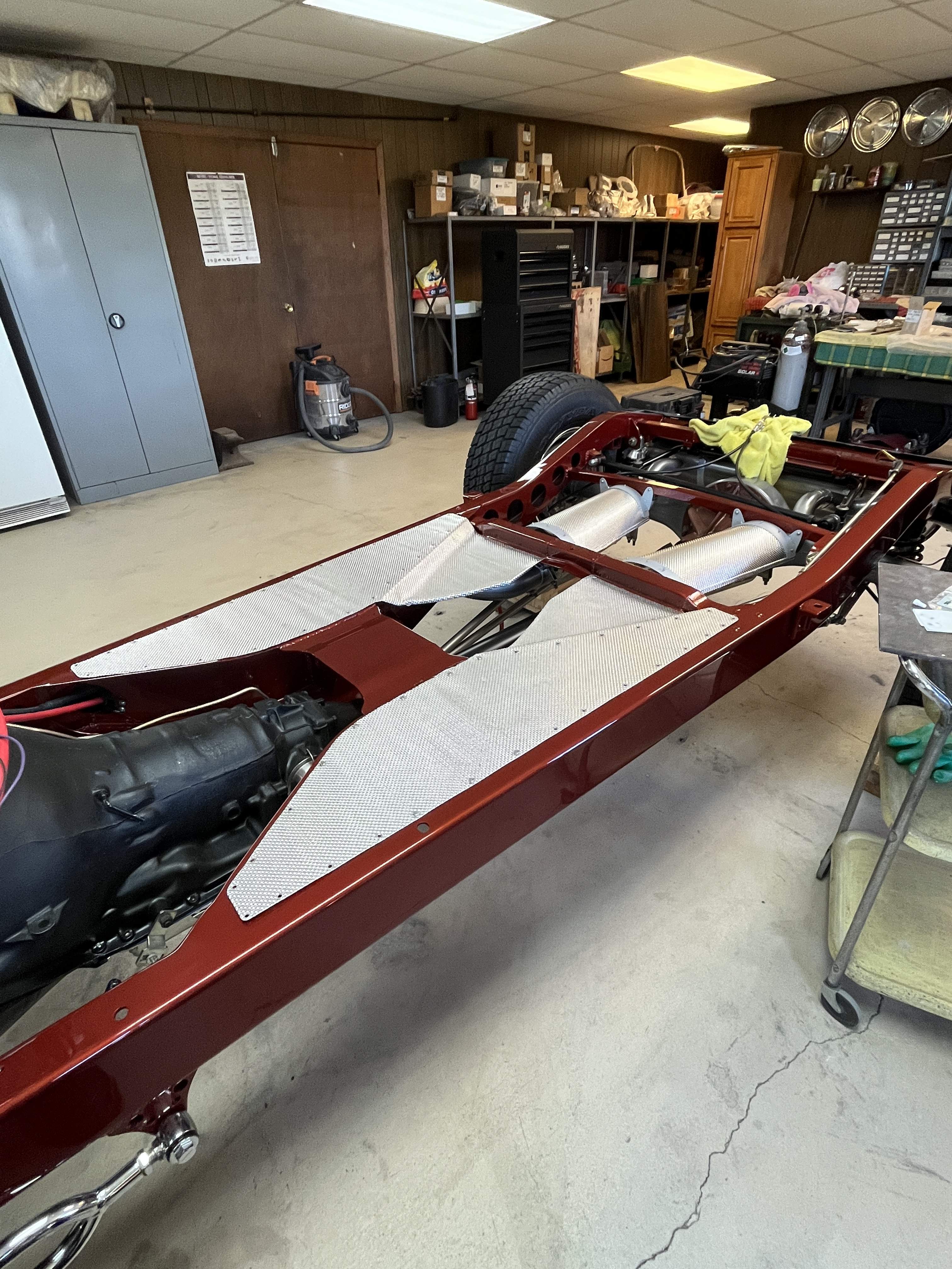

With the manifolds back on the engine, my brother and I spent 4 1/2 hours installing the rest of the exhaust system. It became a lot more challenging than either of us anticipated, but we finally got it clearanced and adjusted to our satisfaction.

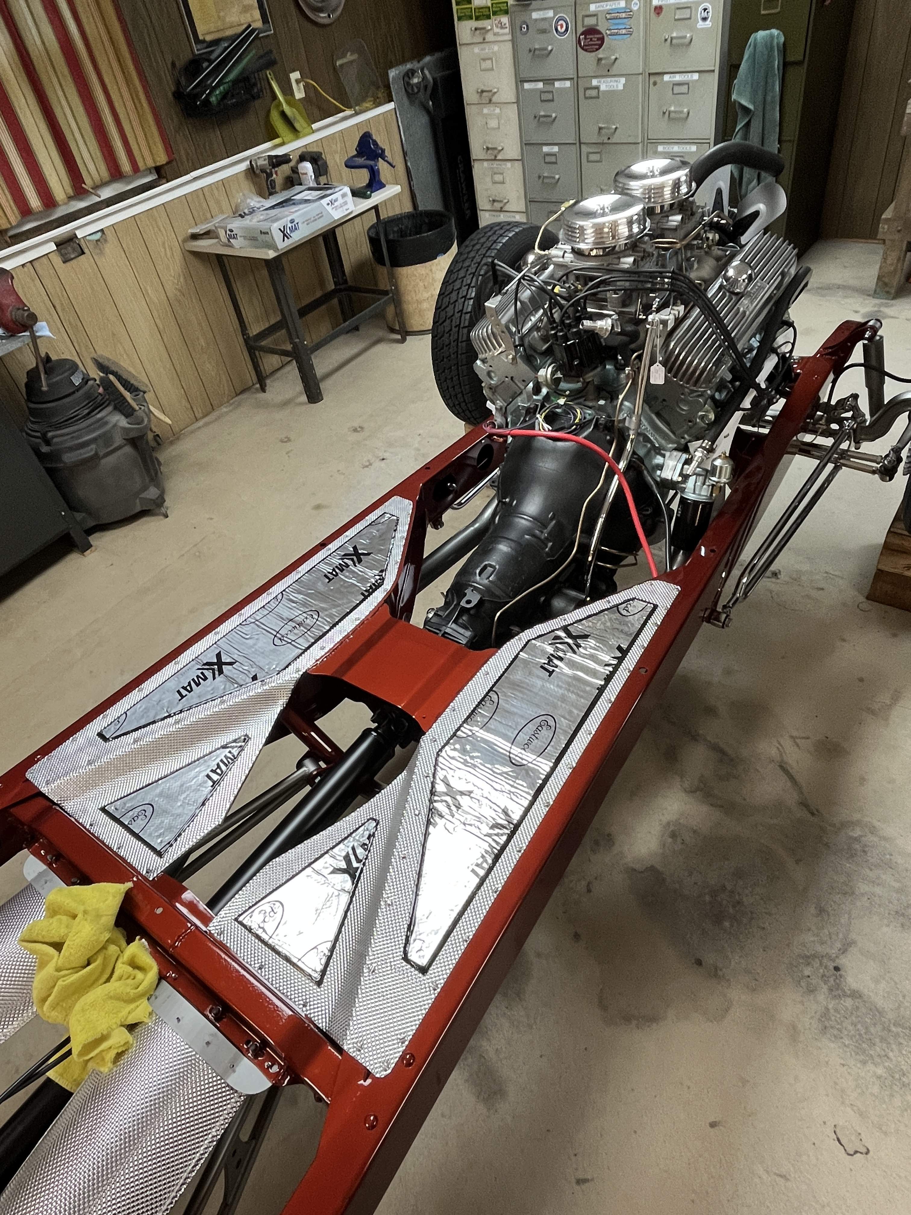

Heat shields on. I also added X-Mat from Eastwood to deaden any resonance or droning the aluminum may have from the exhaust. An edging of 3M Panel Bond was added to keep water from getting between the X-Mat and the aluminum.
