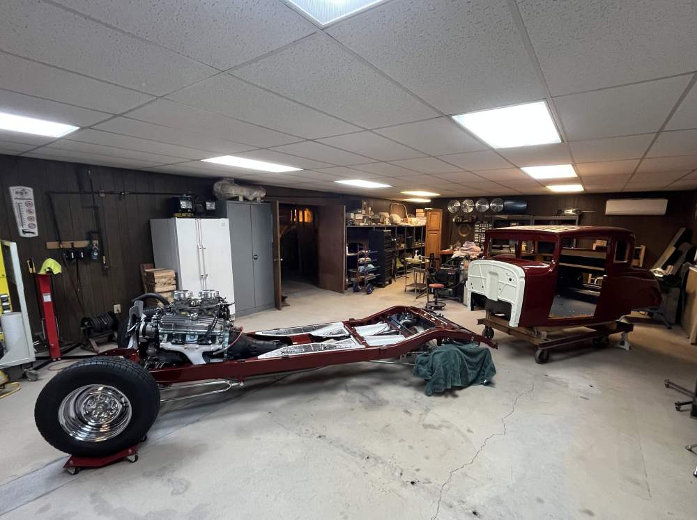

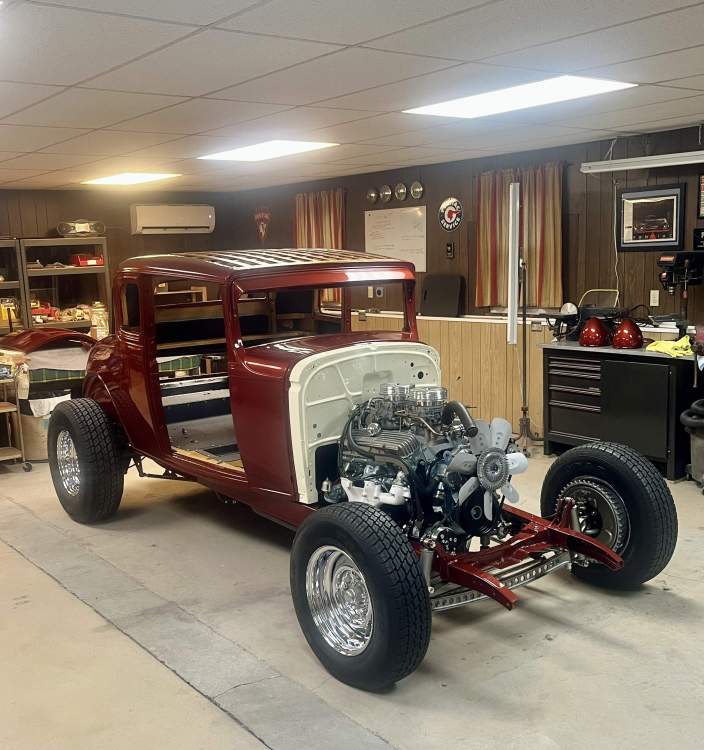

    We now have a rolling chassis. IMG_9342.mov
  • I didn’t think the battery area would be so complex with battery cables, main power switch and vent tubes. The smaller wires are preliminary and will be cleaned up.     Battery cover was designed so
  • With the manifolds back on the engine, my brother and I spent 4 1/2 hours installing the rest of the exhaust system. It became a lot more challenging than either of us anticipated, but we finally got

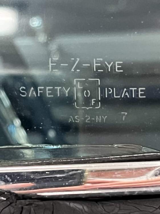

A little detail I wanted was the “E-Z-Eye” glass bug used on GM (and maybe other) cars of the ‘50s and early ‘60s with tinted glass. After a long unproductive search online for the stencil, my brother knew someone who said he’d try to make them. He only cuts them, I must apply the vinyl stickers to the glass, use an X-acto knife to remove the letters and then apply Armor-Etch to etch the glass. First picture is from my ‘59 Bonneville.
Most people probably won’t notice it or care, but I do. 😉
Like the idea, you brought back memories from mid 70's. P Wouldn't think of making the glass logo. Nice
I refer to my previous post! DETAIL!! Oh the memories!

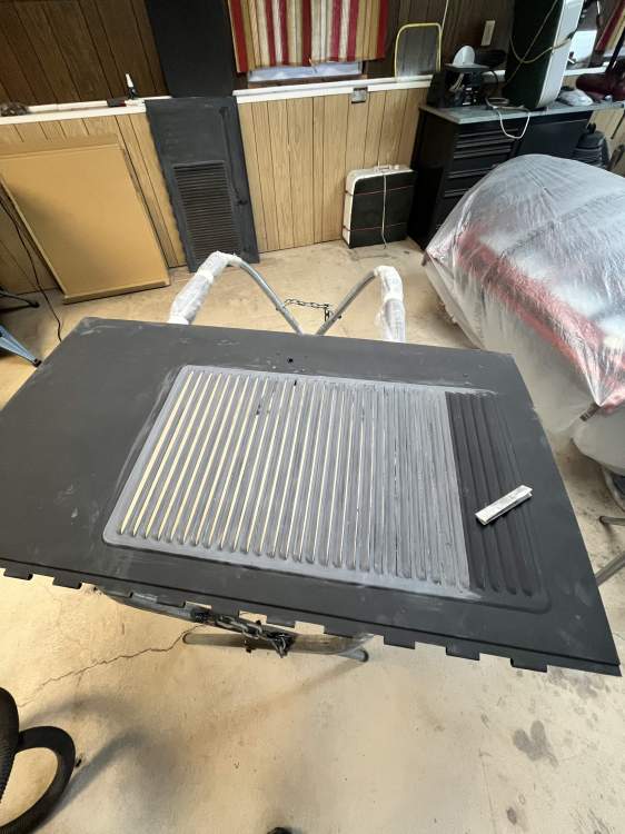

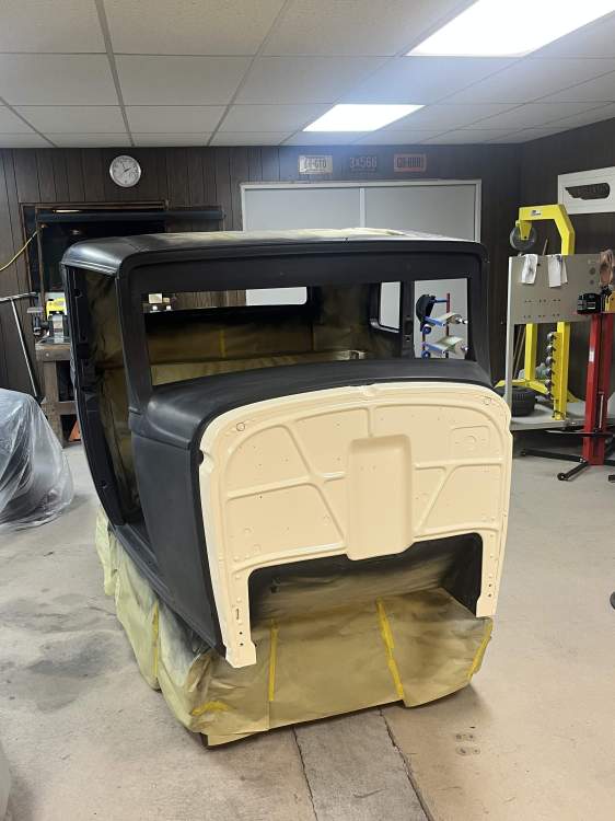

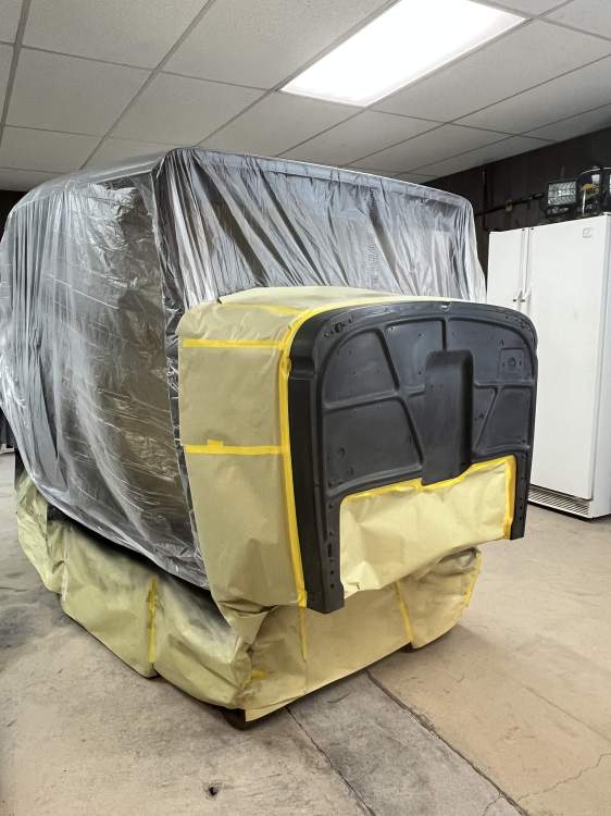

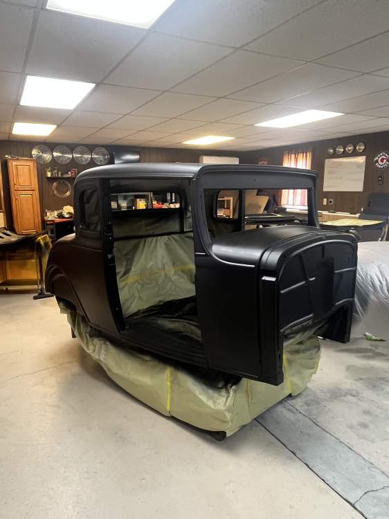

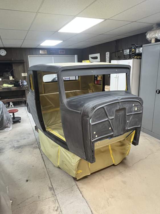

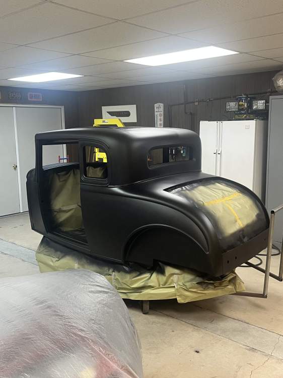

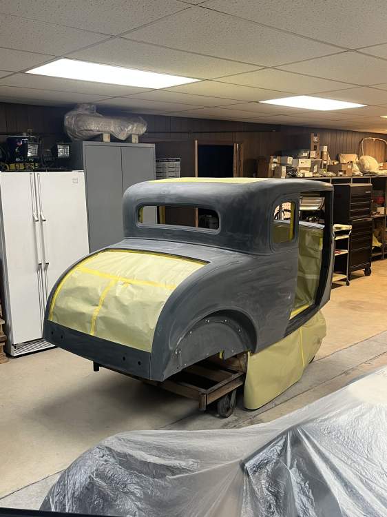

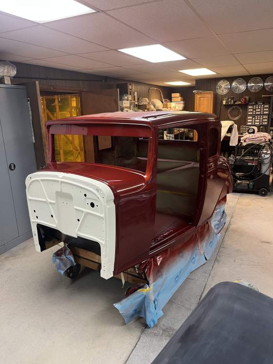

After the final bodywork was completed and 1 final coat of epoxy primer, everything was sanded and sprayed with 3 coats of 2K urethane primer. Then more sanding 😬. Still have doors and hood to sand, but the body was sanded, masked, and ready for the first color, Wimbledon White on the firewall.
Looks good 31pontiac! Progress Is progress!
It’s going to be KILLER!! We are all going to enjoy the show!pop_corn

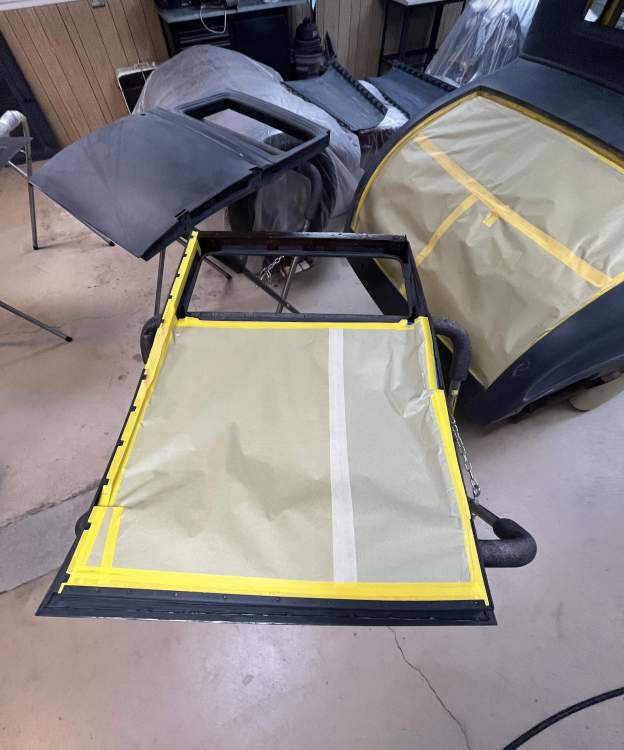

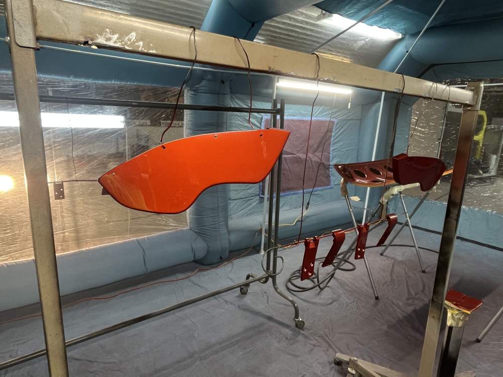

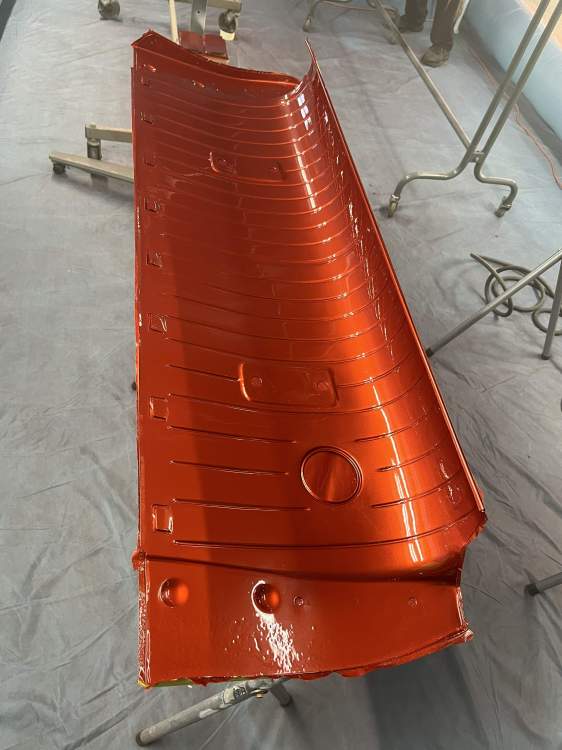

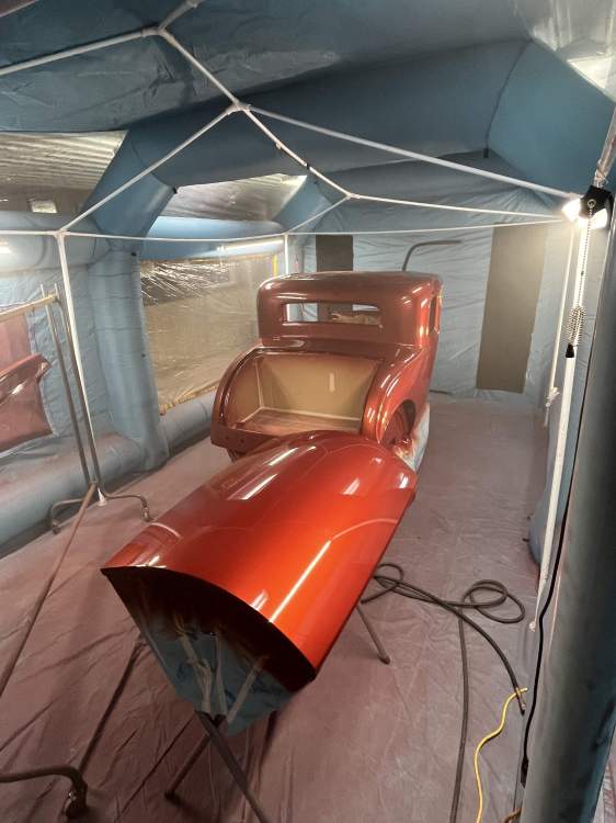

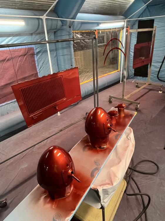

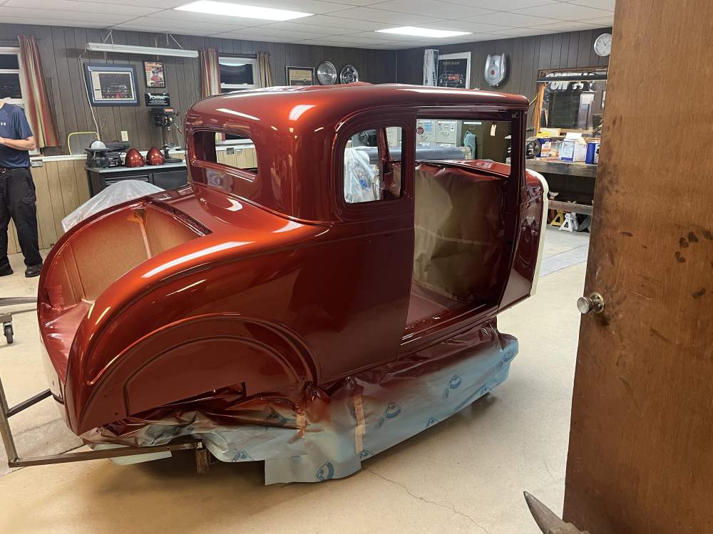

My brother and I spent most of Tuesday finally spraying some color. Planning on painting the body tomorrow. Here’s a few pics.
wow Tim ! your using one of those blow up spray booths !!! please tell us how you feel about it !!! i have looked at buying one , but cant find any thing big enough for the 63 !
Looks like candy, that's when ya know your doing it right!!!!! MMMMMM
https://www.vevor.com/inflatable-paint-booth-c_10313/vevor-39-4x16-4x13-1ft-inflatable-spray-booth-custom-tent-paint-booth-inflatable-p_010369467605
Check this one out Kiwi. Mine is considerably smaller, 23L x 13W x 8.5H. Has a 4 foot separate room at one end. Interior work space is 19L x 10.5W x 7.5H.
Certainly not commercial grade, but for hobbyist use it works. I needed one to fit in my building with low ceiling height. Can be used outside, but not in rain. I couldn’t use it outside where I live, it’s usually too windy. Filters seem to work well, I carefully sweep them and blow them out after each use, as they are kind of cheap and fragile. They are replaceable, but I have yet to find a source.
It comes with 2 blowers, 1 to inflate and 1 to pressurize the booth. Those worked for me, but I have read online that some have bought stronger ones for more pressure in the booth to help evacuate overspray better.
I also bought a cheap outdoor canopy and used the frame inside the booth just in case of a power outage.
Thats what i should get to paint the wagon !!! cheers

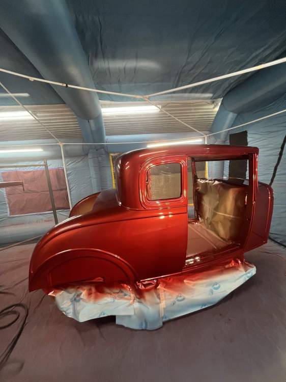

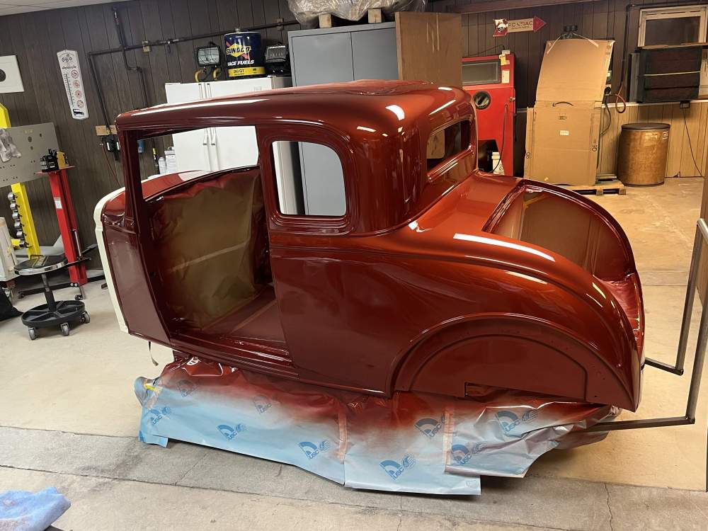

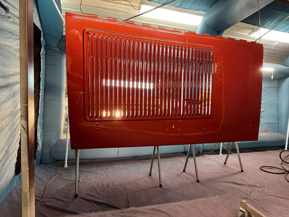

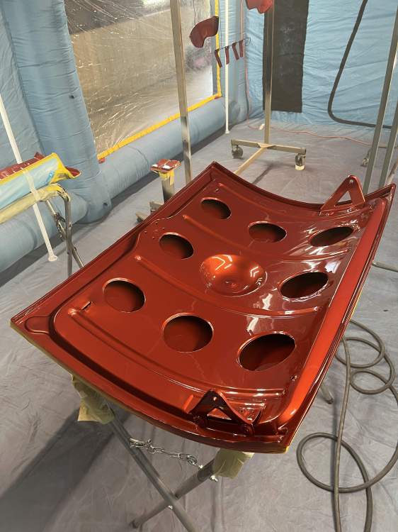

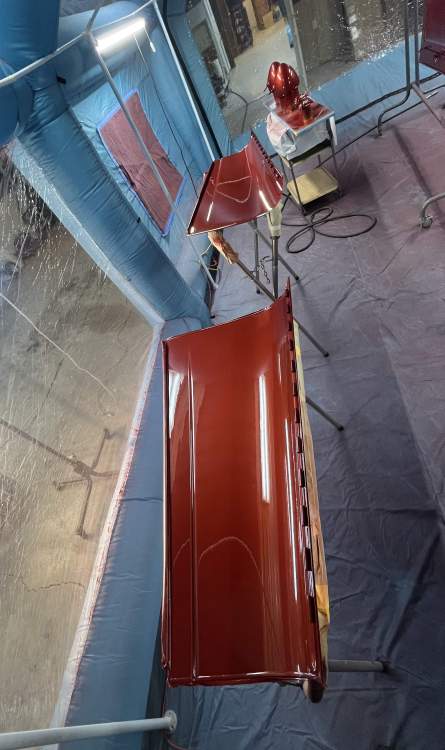

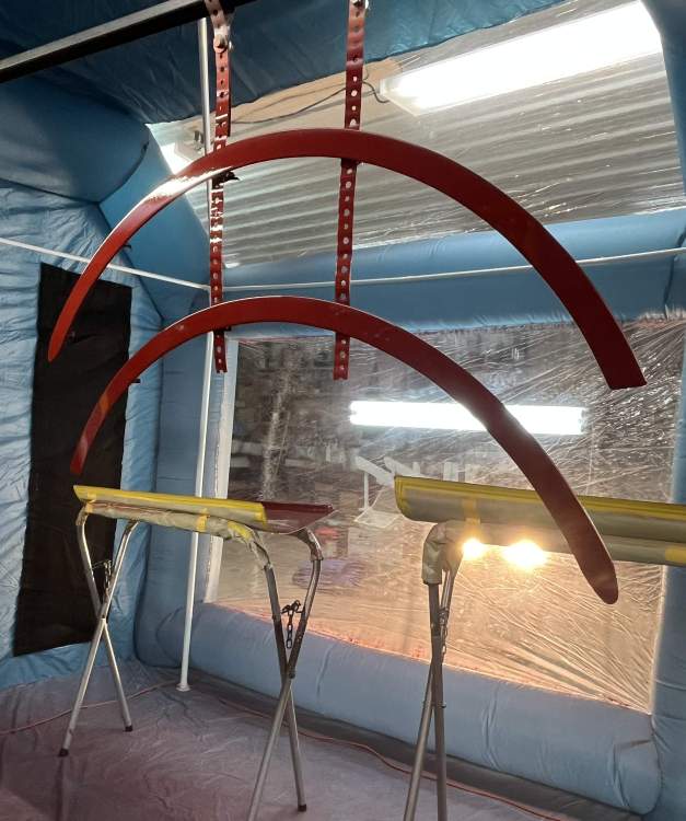

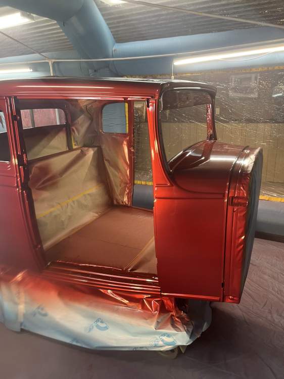

One more painting session today.

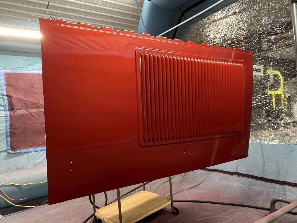

Here’s a few pictures from yesterday.
She looks great 31pontiac! Imagine how good she'll look once she is cut and buffed!
Thanks Frosty! It shines real good now, it’s almost a shame to cut and buff it. But it needs to be done as there are a few small sags and a little dirt here and there. Paint corrections and buffing after Hershey!
I said it was going to be killer, but I didn’t expect a massacre! rofl
I’m going to have to order some new sunglasses! Cause when she’s finished & goes in the sun I don’t want to go blind!
After using the booth for 3 full days I learned a little more about it. The filters are barely adequate for indoor use. The first day we sprayed it was pretty windy which helped tremendously to exhaust the building. Not much wind the other 2 days and the building slowly filled with clouds of overspray that we couldn’t get out fast enough even with fans in 3 windows. As a result, the 2 blowers sucked some overspray in and recycled it into the booth. Luckily it did not affect the paint job.
Probably not a problem if used outside, or possibly use better filters than the ones supplied.

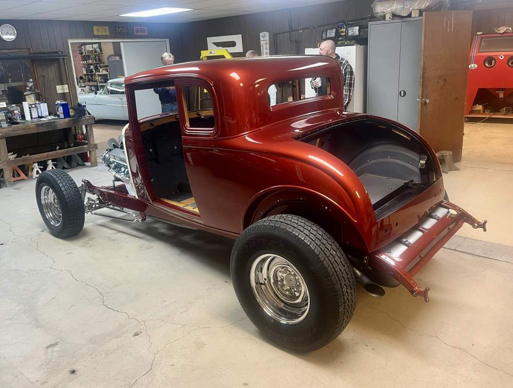

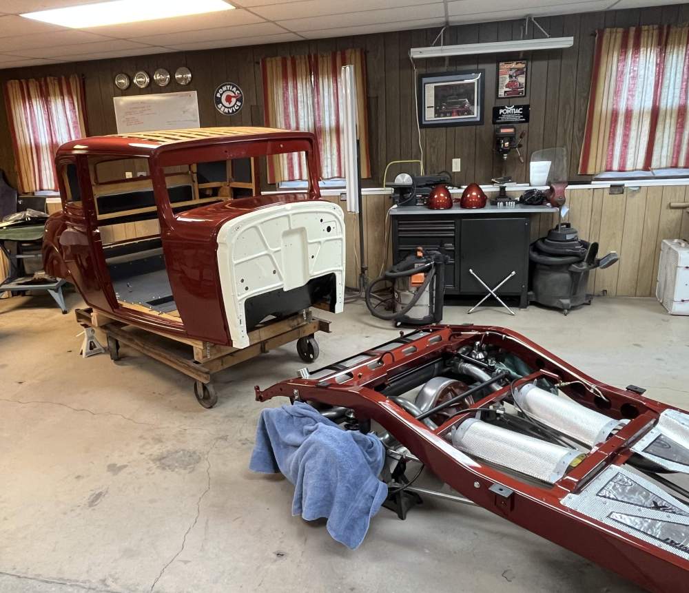

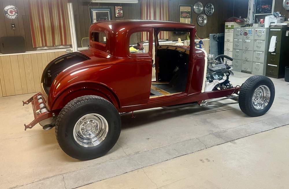

Tonight’s episode: Have a few car friends over and lift the body back onto the frame.
Tim, that is absolutely beautiful!! Really gorgeous! And just think, all you did was set the body on the frame! Wow! When it’s done; I won’t have any words! Well maybe five. Can I have it, please!!! drool
Edited by Last Indian
Thanks Indian! I must give a huge shoutout to my talented brother for spraying the car with a Harbor Freight purple spray gun in a decidedly nonprofessional spray booth, and then helping with some minor paint corrections and buffing to get the body this far. All of the other body parts must be cut and buffed yet, but I can begin assembling some other components to prepare for my son-in-law to wire it.
Wow Tim, she looks amazing bro! Great job.
nice work tim! this is where all that hard work starts to show !!!!
Gorgeous. Simply gorgeous!!
