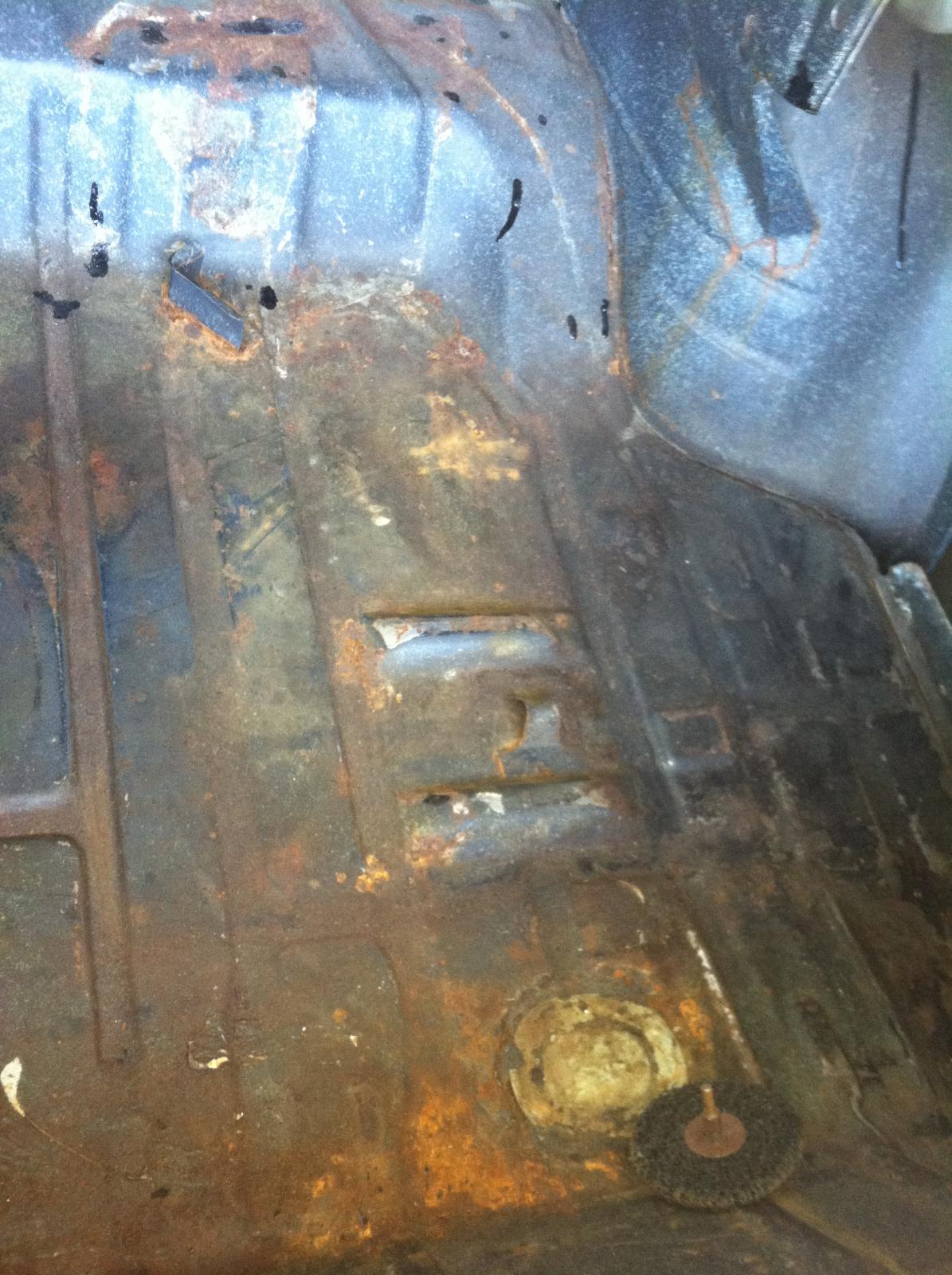

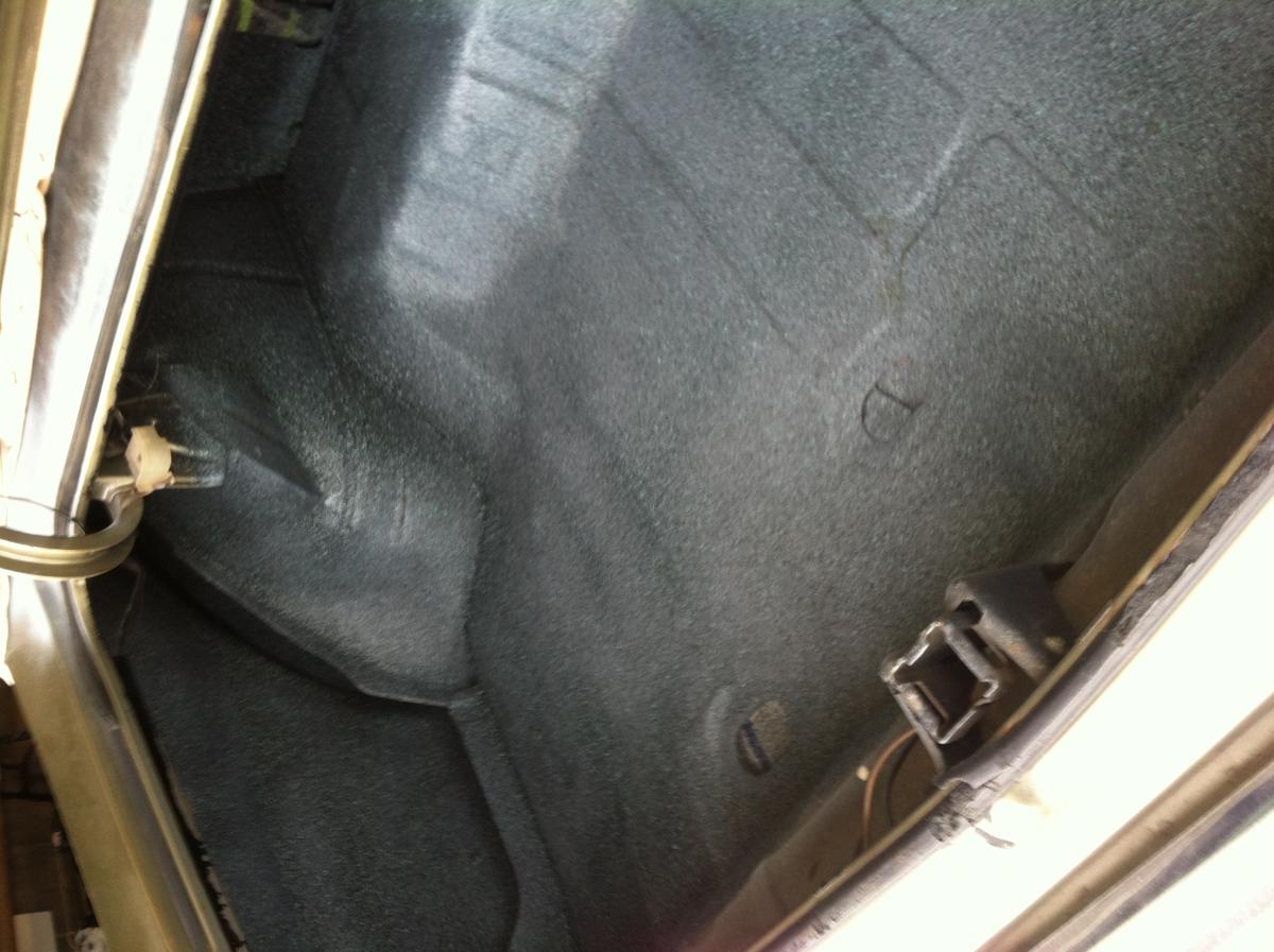

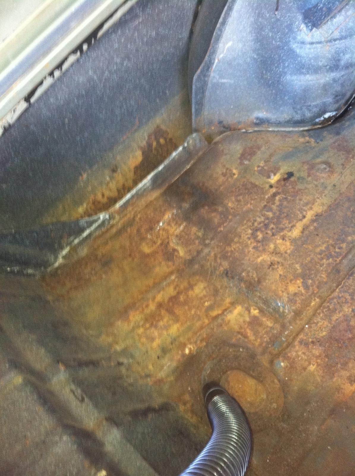

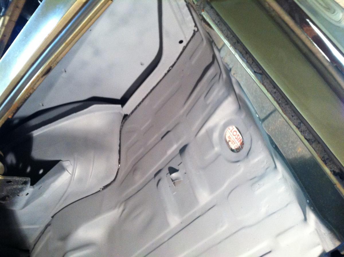

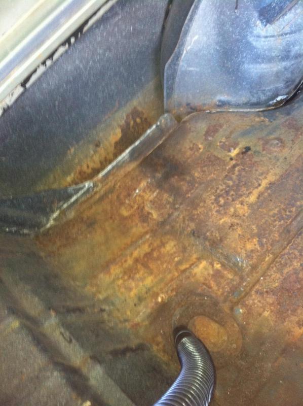

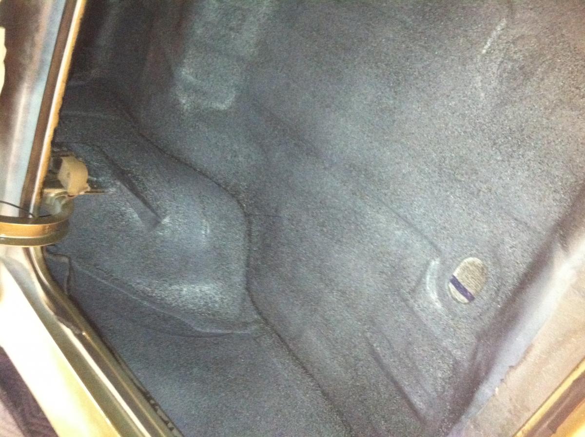

OK,Back to the car.Life got in the way for a bit but we push forward.Sooo with that outta the way,i finished the trunk in the last couple weeks.As i may have mentioned or not(i dont remember) someone at some point in this cars life stored (poorly) either gear lube or had a couple quarts of oil with a hole in the bottom of the container in the trunk.1st.... thanks,it didnt rust.2nd..seriously? No attempt to clean it?LOL anyways i spent quite a few days of spraying simple green then soaking it up,respray soak it up x's100.Then i did the Brakecleen spray, soak it up,watch the walls melt,respray soak it up x's abunch..dont remember much after that.Once i felt it was "oil free" i wire wheeled,sanded with 80grit then epoxy primed.sanded with 150grit and another coat of epoxy primer.I was going to use the same duplicolor bed liner as i did on the firewall.It wears great and looks good for me.However my buddy at the parts store recommended the duplicolor trunk spatter paint.Heck why not? i thought if i dont like it bed liner will cover it fine,all the prep has been done.well here are the results in pics

The last pic is for Frosty..i filled the hole finally LOL

Anyways I am real happy on the way the trunk turned out.Pics dont do justice to the final result The flash from my phone seems to distort the look.I used 4 cans of trunk spray.If you dont stay 12-14" from the panel it will build up real fast,lots of trial and error to get it right.The paint is very directional,meaning the build is from point of shoot.I shot this stuff from front to back,back to front,side to side etc..to get a uniform look.using very small bursts of paint you can fill the low spots and make it blend in to the surrounding areas.After a week of drying it lays flat and feels scuff resistant.time will tell on the last point but short of throwing in an engine block in the trunk i feel it will hold up well.
PS.. A grey primer under the trunk paint is paramount to a close to factory look as possible...
oh yea i did reseam seal the trunk..pics show that..

Joe - she looks great. I re-sprayed my trunk with spatter paint a few years too. I know what you've been through buddy. Did you put down a clear coat to seal it or do you plan to? I think they make a flat clear for the spatter paint. A couple of cans will do.
I approve of filling the hole too. It looks great.
I WAS THINKING ABOUT A CLEAR BUT MY BUDDY SAID IT DOESNT NEED IT? Sorry for yelling...lol
No worries Joe - depending on the spatter paint manufacturer, they may or may not recommend a clear to seal it with their paint "system". Check yours to be sure. The brand that I used did recommend a clear.
I remember mine being very rough to the touch when I finished with the spatter paint and the clear helped smooth it out a bit plus the benefits of sealing it.
Ouch! What does this say for Dupli-color except use a clear?
