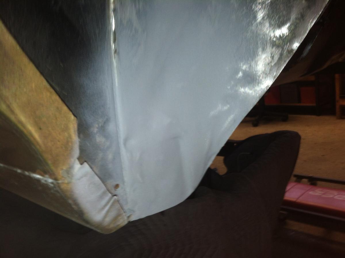

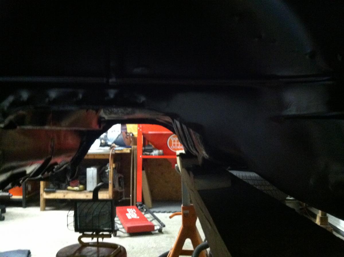

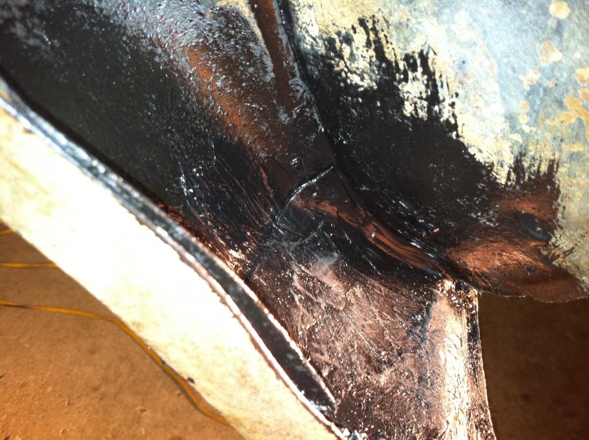

Tomorrow it will be Black! I shouldve taken pics of another area i fixed,but i got caught up and it was done before i realized it.I need a respirator LOL well here's a pic anyway.LOL

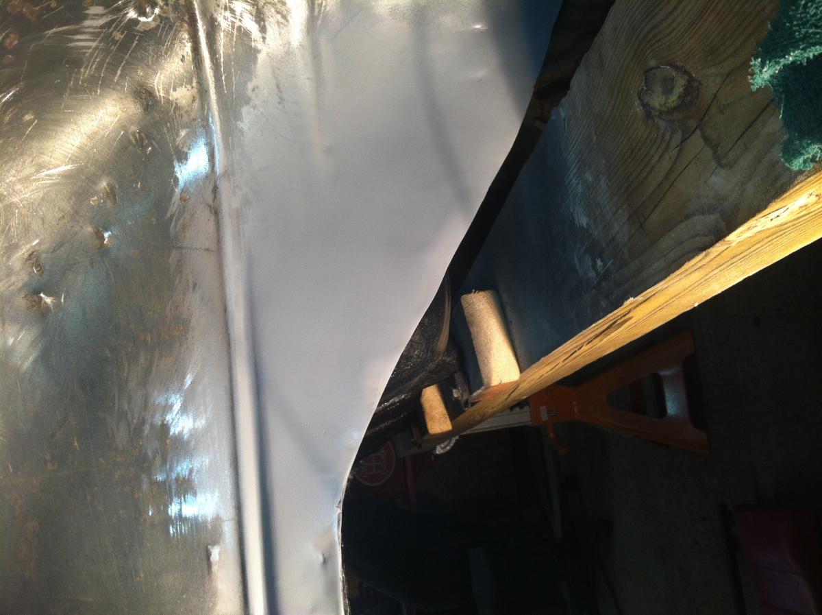

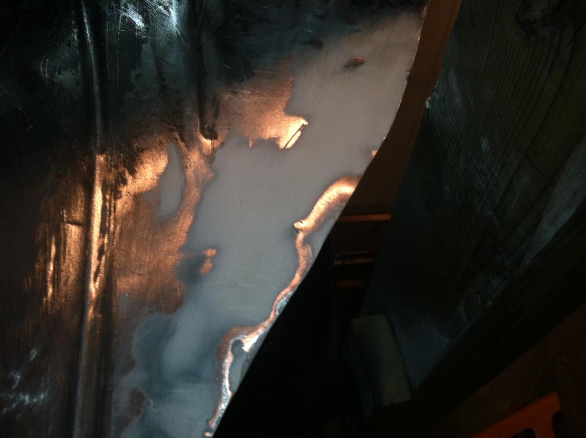

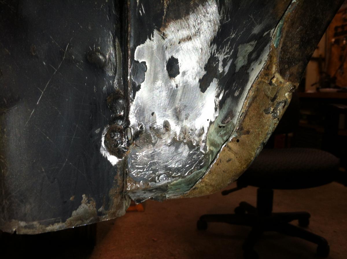

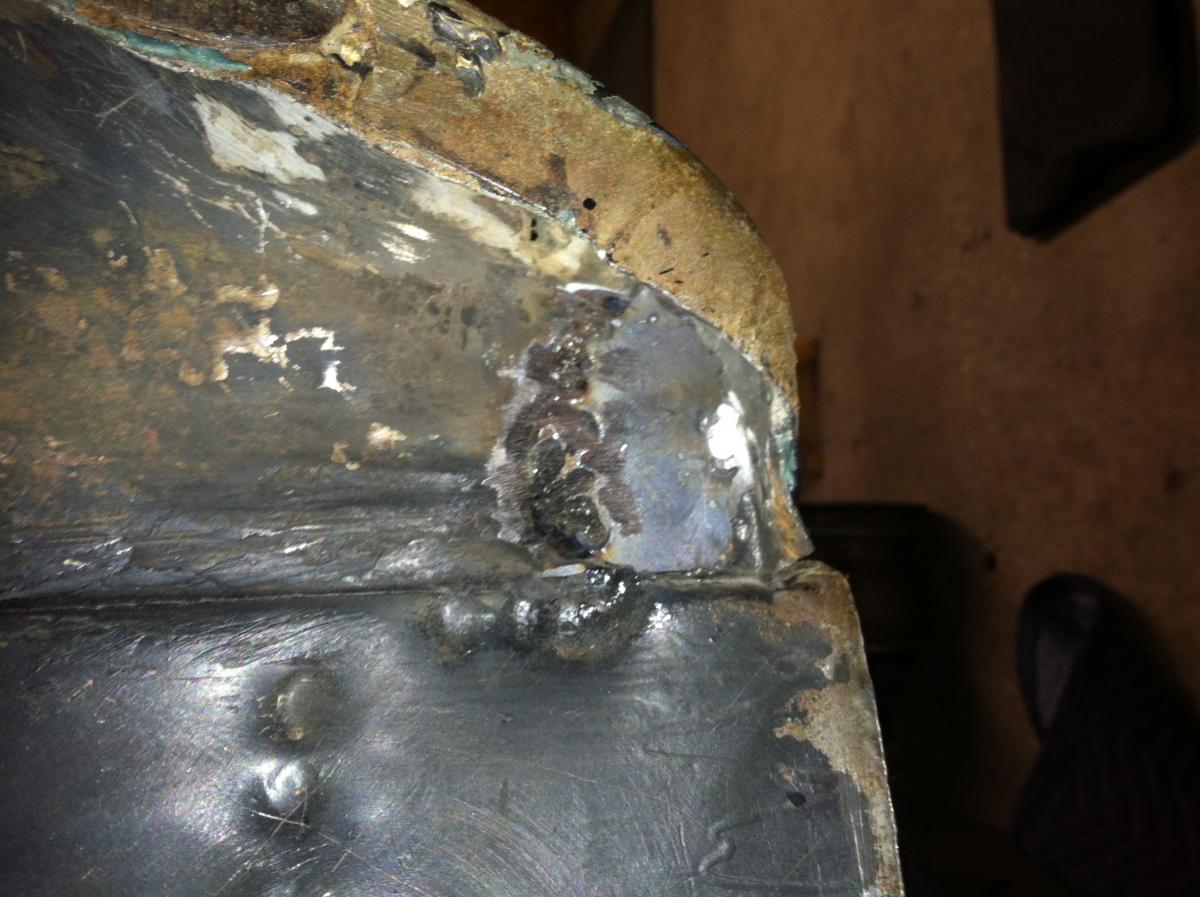

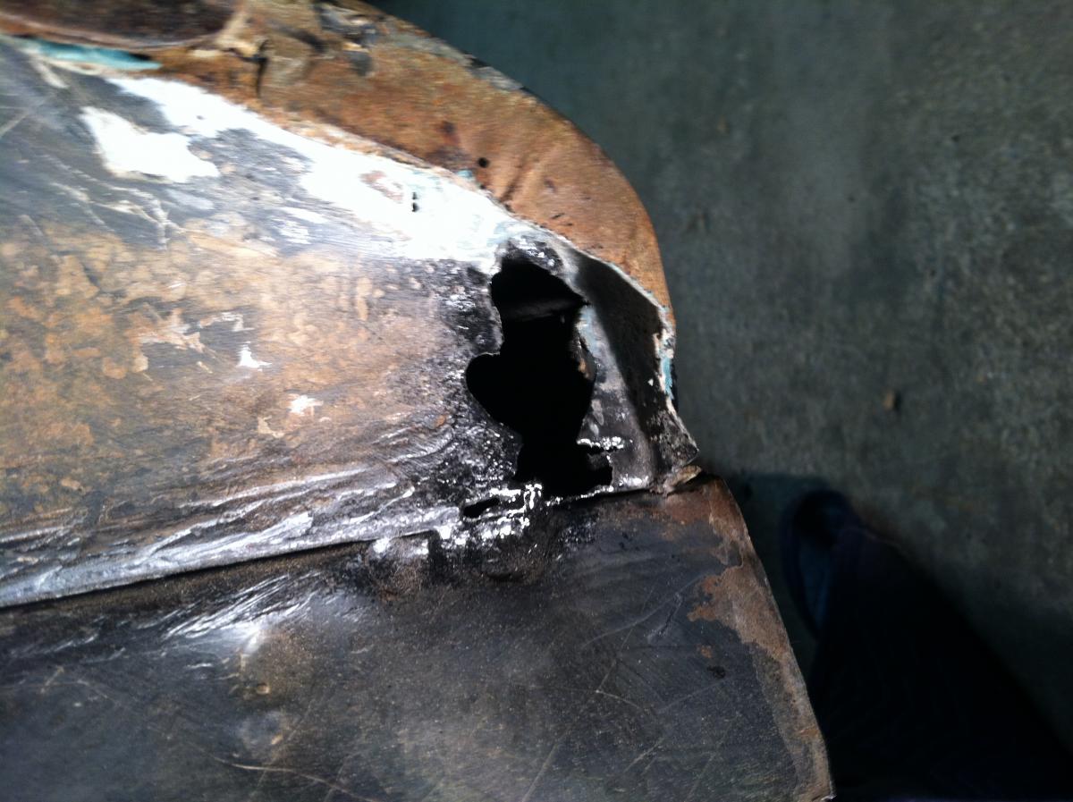

Welllllll i found another hole LOL actually 2 but this one is fixed tonight.I am trying to keep the factory weld divots and lines where the panels meet.And make it look factory,if i start smoothing the wheel wells this "project" will not get done in my time frame.Plus i dont care as long as it looks factory LOL

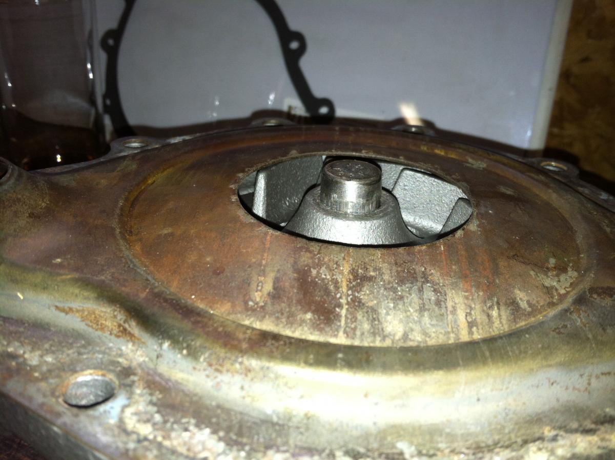

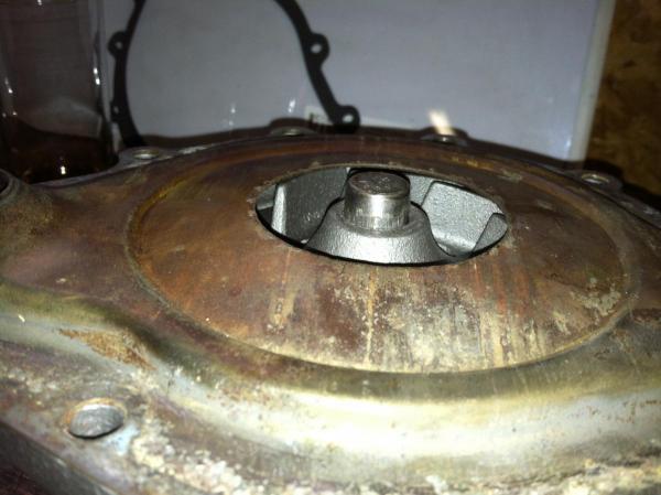

Hey Justa,this is a pic of my water pump,and divider plate.Notice the curvature of the impellar,which follows the same curves of the divider plate, and the distance between the impellars and the divider plate.
post-1672-0-92016500-1392774045_thumb.jp
Compare that to a stamped impellar,no curvature of the impellar vanes resulting in cavitation,lack of coolant moving and overheating is the result.On my divider plate i did "massage" the opening for a tighter clearance to the cast impellars.I believe it was .026 distance i was shooting for.

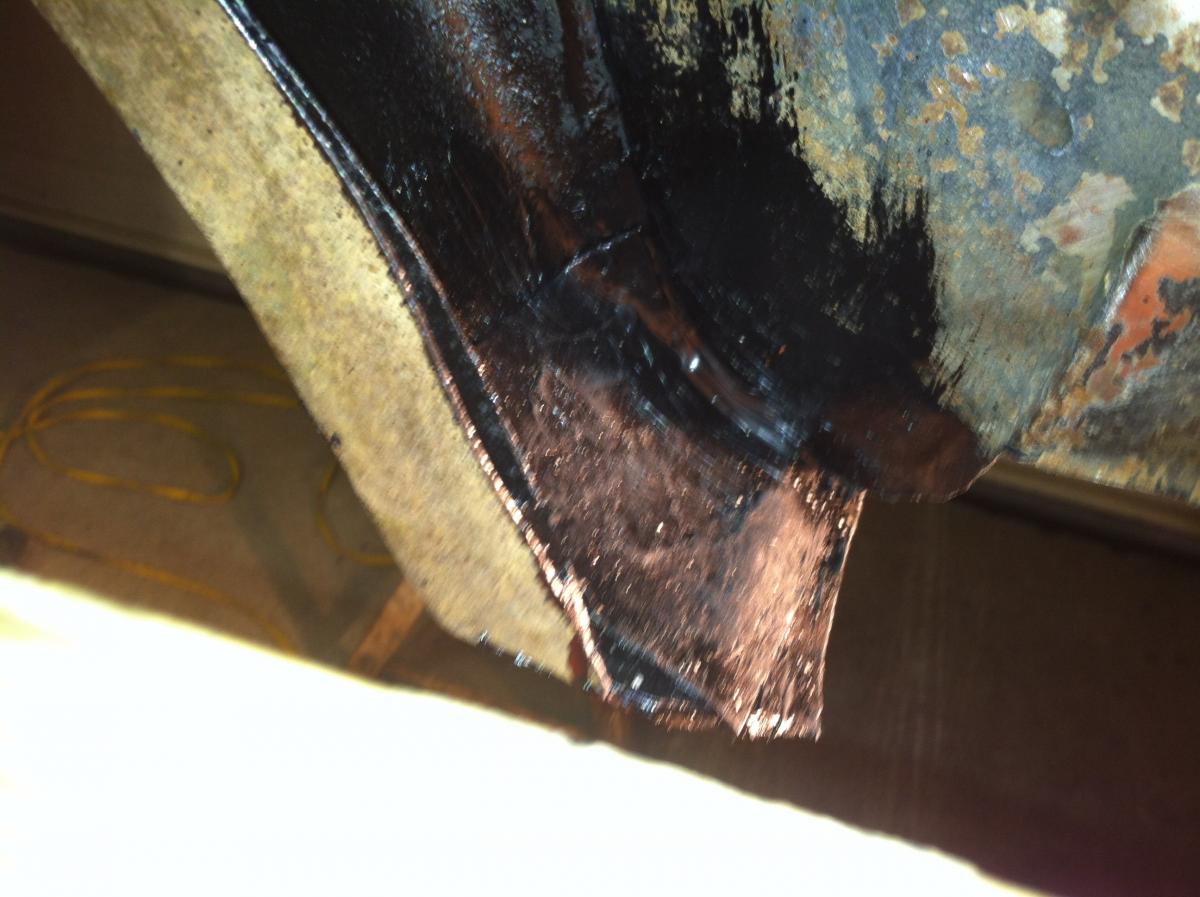

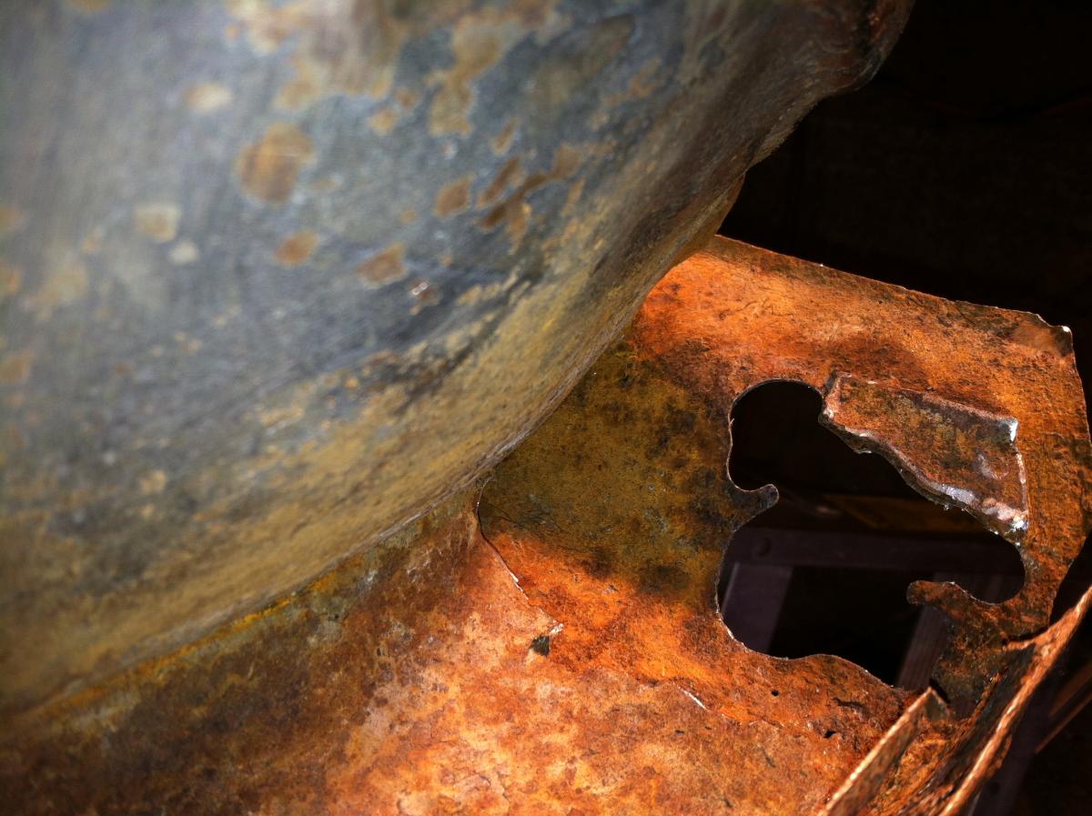

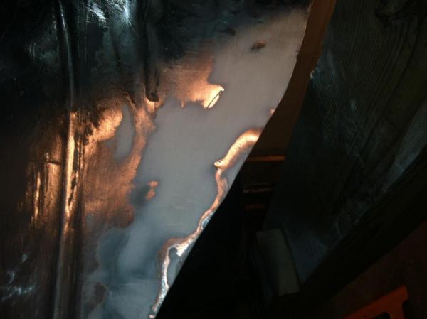

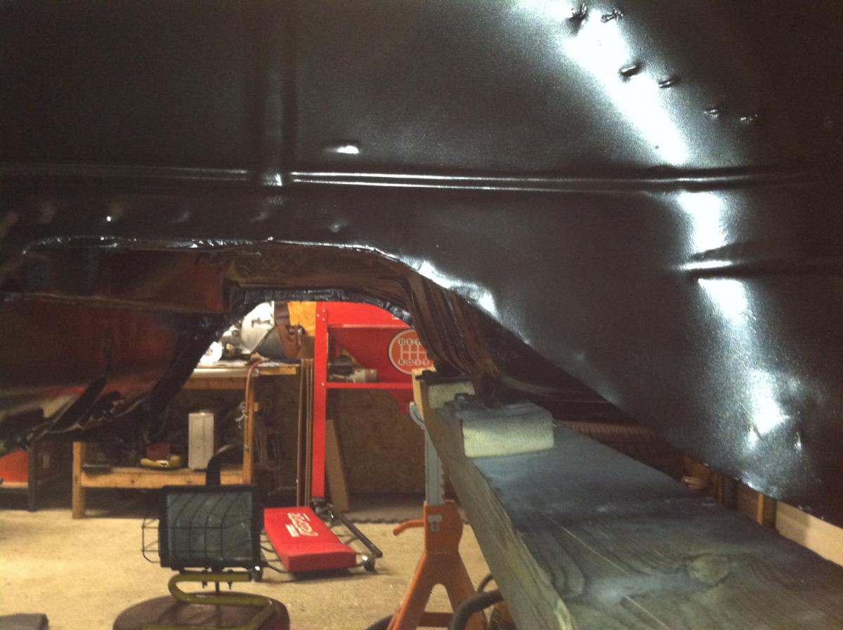

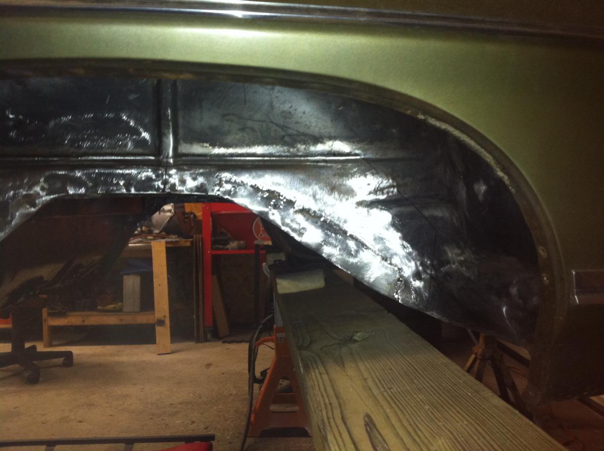

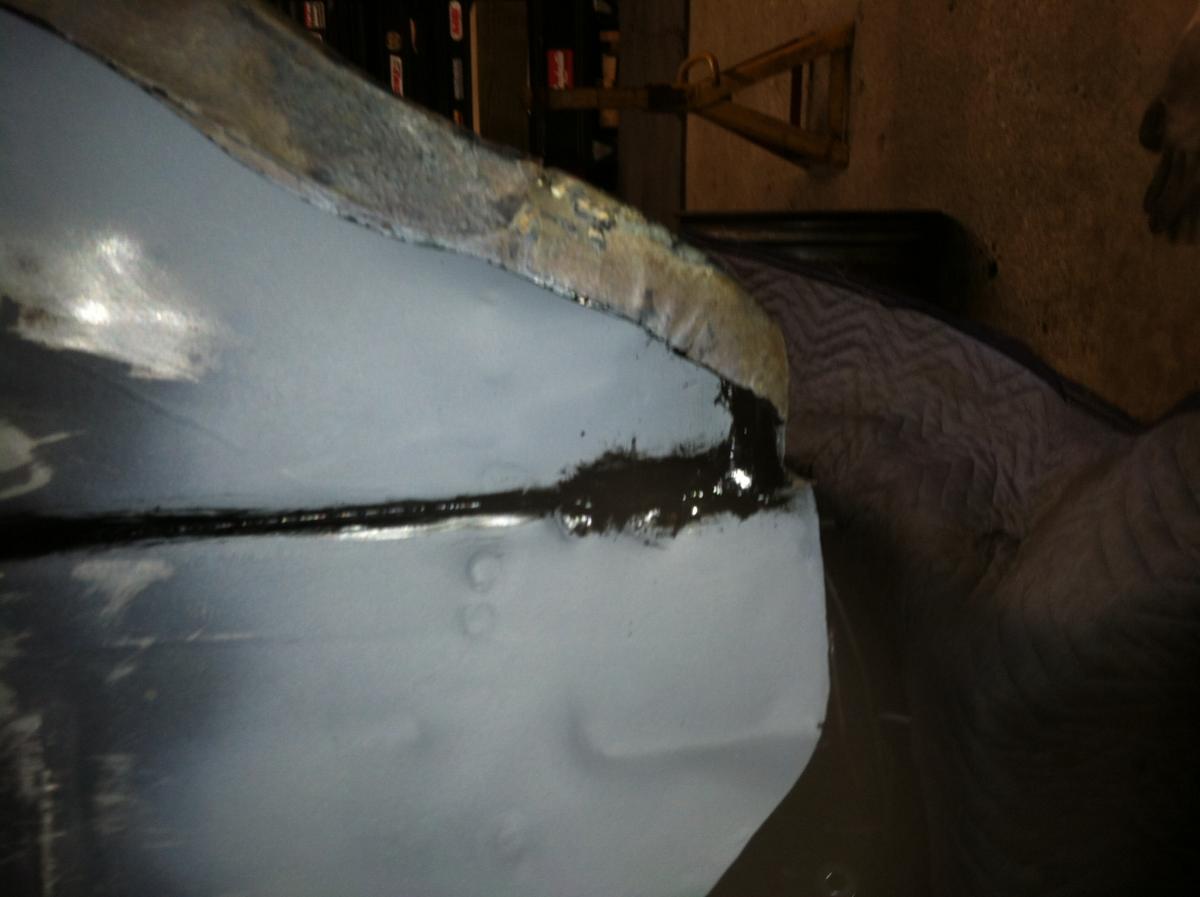

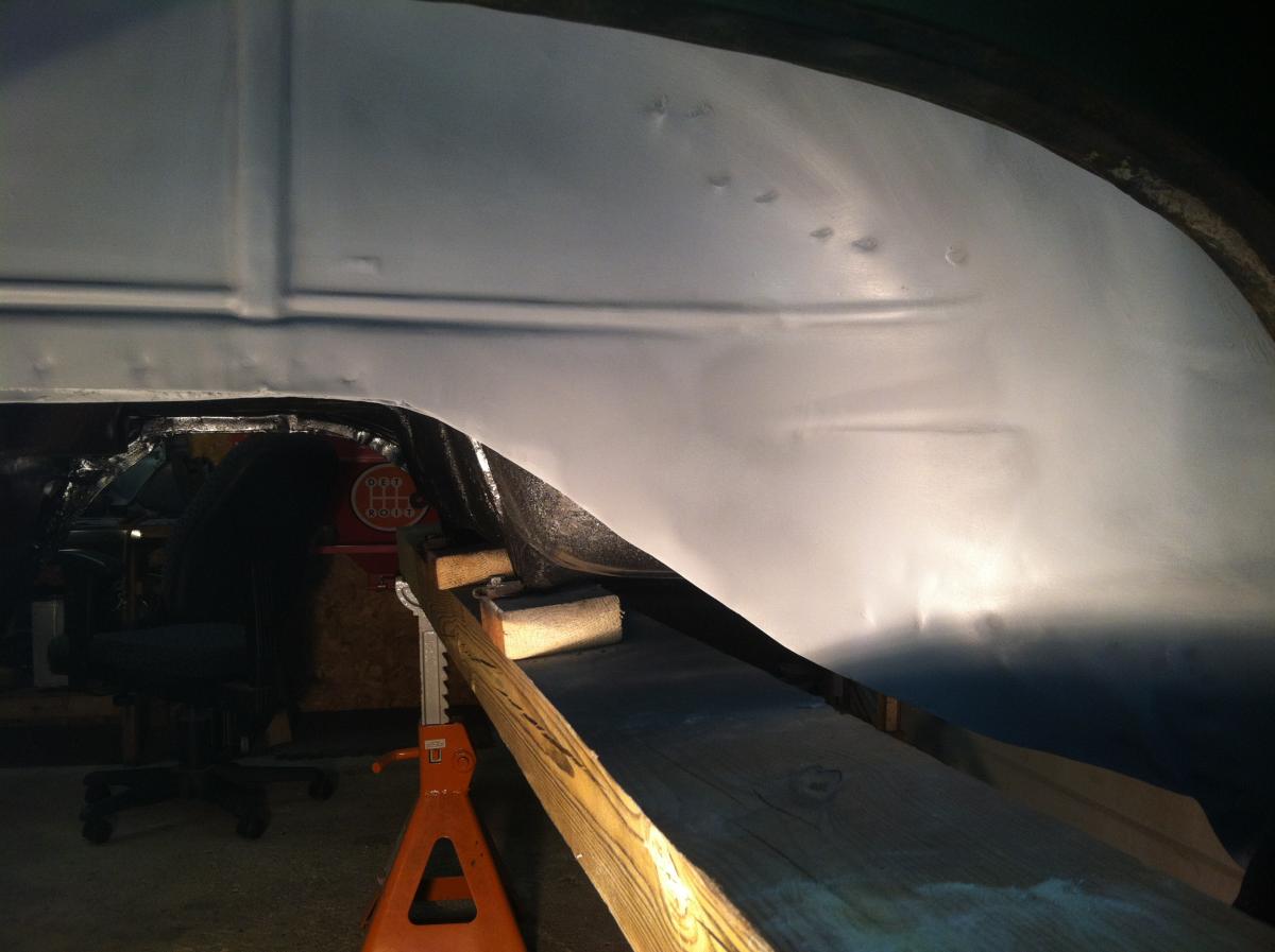

well i found a rust hole with a few different issues.1st it was the inner wheel well that was rusted bad.2nd was it was also the outer quarter panel skin which is welded to the inner wheel well skin.3rd it has a few corners,bends that needed to be fabbed so it didnt look like well like i did the work LOL so i cut the old rusty crap out,of both panel,s.leaving me with this mess.I wanted to weld in some new metal then fiberglass,bondo and finish with paint.A good friend of mine stopped by and recomended i use 3m windo weld to glue in my patches...why not?He builds Bricklands for a living and uses this product to glue the acrylic panels to the frame of his builds.Soooo reluctantly i did just that.heres the pics..Now this stuff does take some time to cure,i did this repair at about 11am this morning.its now 9pm and i took some sandpaper to smooth it out as i will still use some fiberglass to feather the repair out then a skin coat of bondo to finish.As of now it sands like fiberglass after a 1/2 hour of curing.time will tell if it holds up.However i plan on painting the whole car next winter so i will judge the repair at that time to see if it was a real repair or a crappy temp fix.
