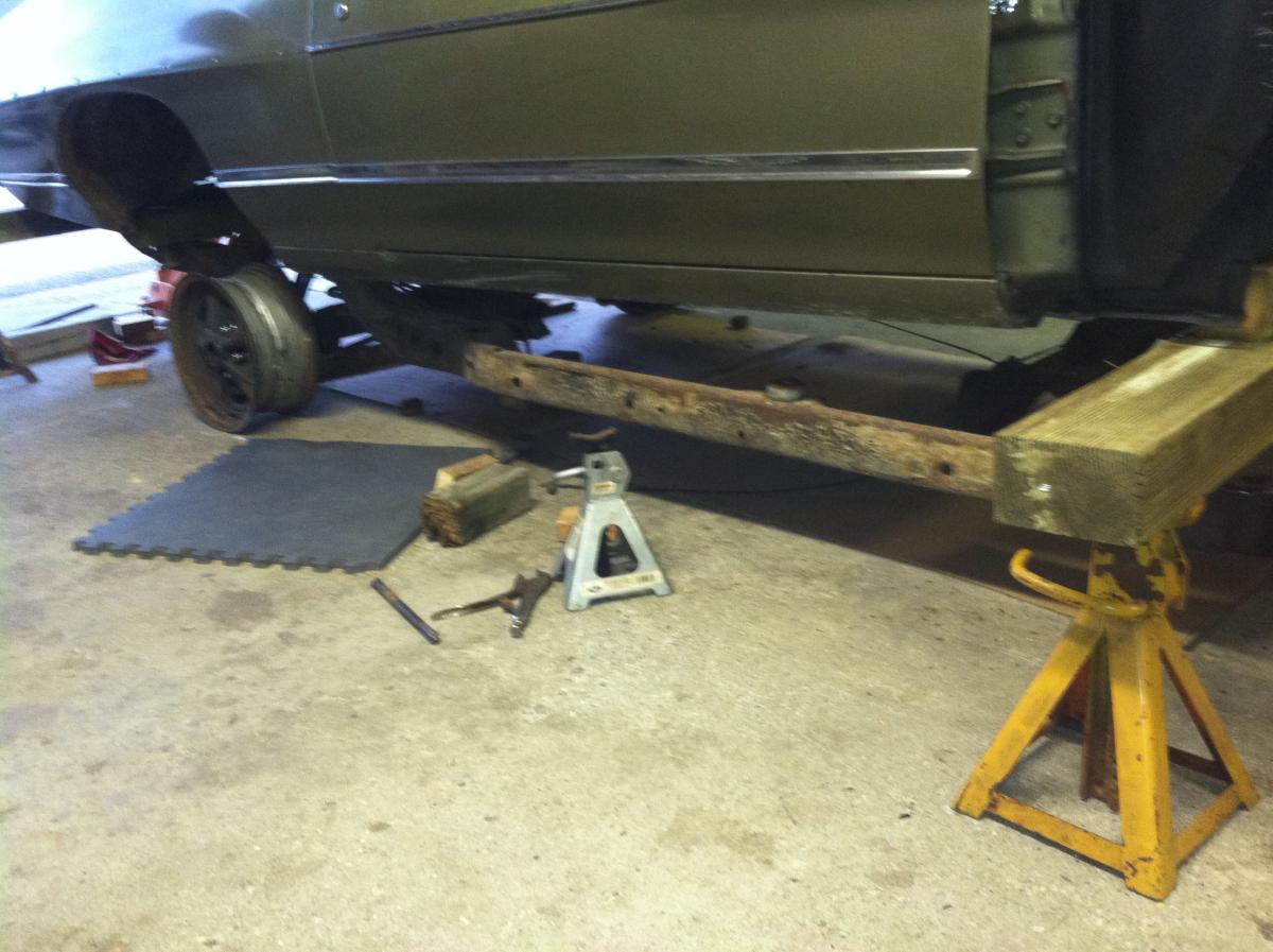

You need two 10ft 4X4's or nail 2 10ft 2X4s together. You will also need a 4ft 4X4 (Fits between the framerails) to lift the body. Spread the weight out as much as possable, or you will bend your floorpan. Then lift till you can fit the 4X4s between the frame and body. Can't see how your gonna get under it with a jack sittin on rims.?? Dropping the body back on will the hard part. Was easiest to get the back one lined up with new bushings. Didn't have pin point control lowering and the front ones were off about an inch. Screwed with it soooo many times, finally MIGHTY MOUSE grabs the fire wall and picked it up and moved it over by myself. Letting it down ripped out 4 tendons in my right shoulder. When I say I've put my heart N soul into my GTO...I'm not lying. Always have help N be careful BRO.

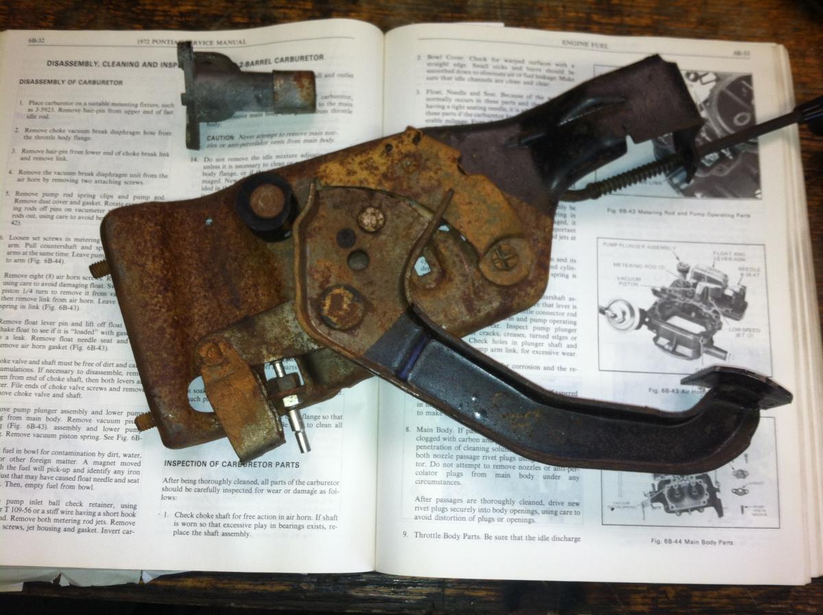

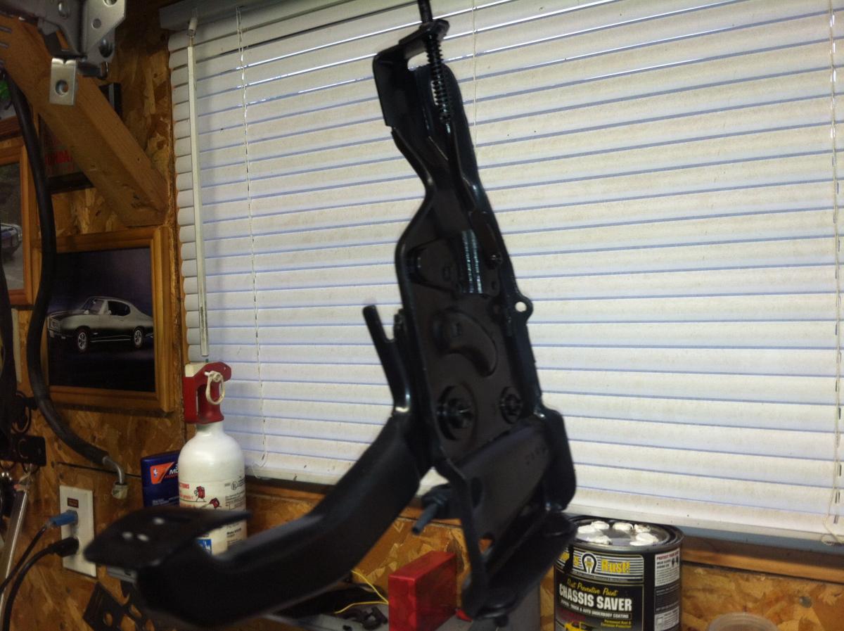

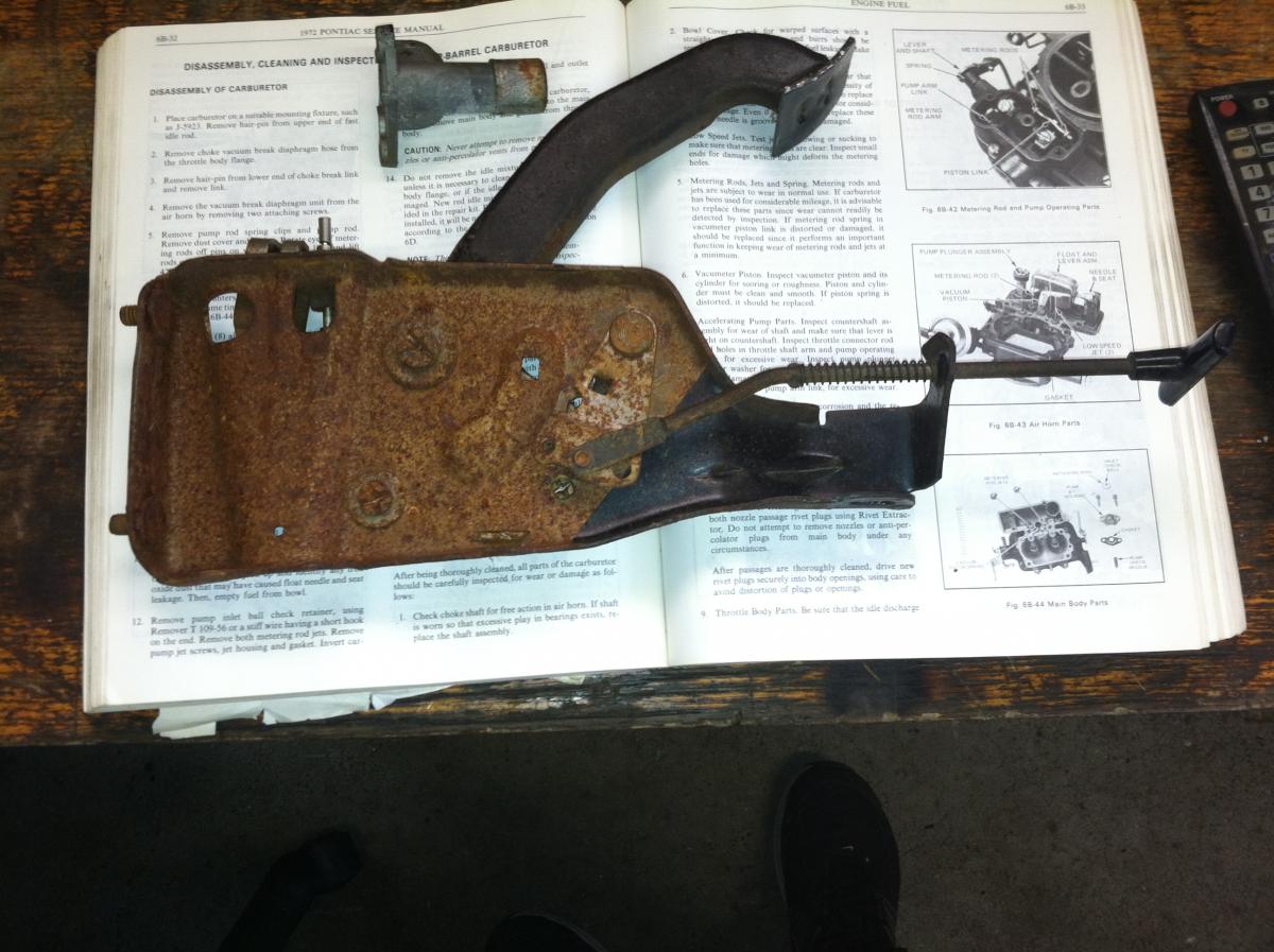

Well...i got the Parking brake disconnected,PITA! then i figuired since im scared and need to research the body pull alot more i would clean and paint stuff...LOL

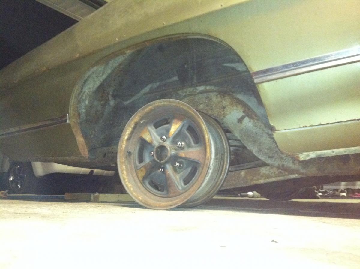

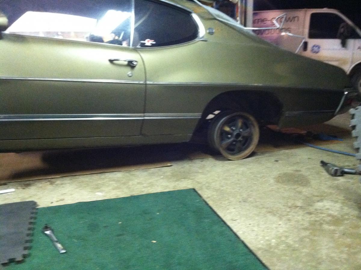

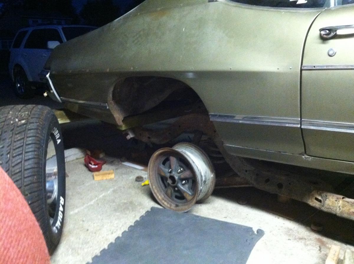

well i have it high enough to work on and all seems well so far...I did have it high enough to pull the chassis out but it seemed unstable.After seeing Steve's car on its side im happy where mine is at this point LOL

Calling inline tube in the AM and order the body mounts,2 vapor lines,brake line to the rear,rear controll arm bushings...I think thats it for now....Steve,i jacked the front frame high enough to slip the cherry picker under,If i wasnt such a P***y the frame would be out LOL
Joe, I am happy to see you are taking your time and thinking this through. Safety first. Yeah, I can see what JUSTA did and it goes to show that sometimes he can serve as a "bad example" too. LOL!!! Sorry JUSTA - you know I gotta' kid ya'. Just based on the the photo of the rear driver's side wheel well, I see a lot of POR-15 or Chassis Saver paint in your frame's near future.
