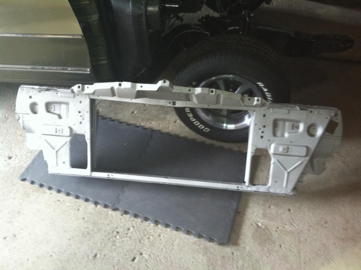

Just picked up the core support
No surprises
Excellent.

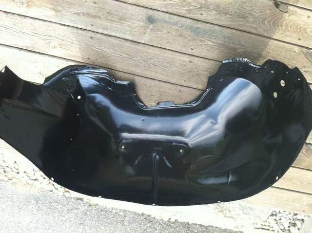

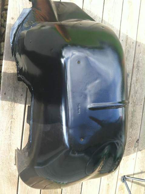

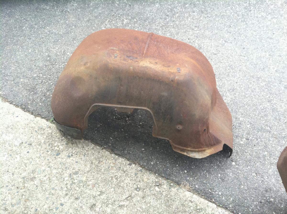

I really hate technology..LOL anyways i picked up the fender wells and as i was leaving i commented to the Sandblaster guy on some bike parts laying there,he has a powder coater that showed up as i was there.said he would do the fender wells and the core support in satin black for 60.00! Sooooo i dont have any before and after blasting pics of the wheel wells but i'll have some done ones in a day or 2 lol
found some lol
post-1672-0-11681900-1375824264_thumb.jp

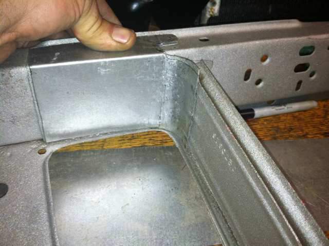

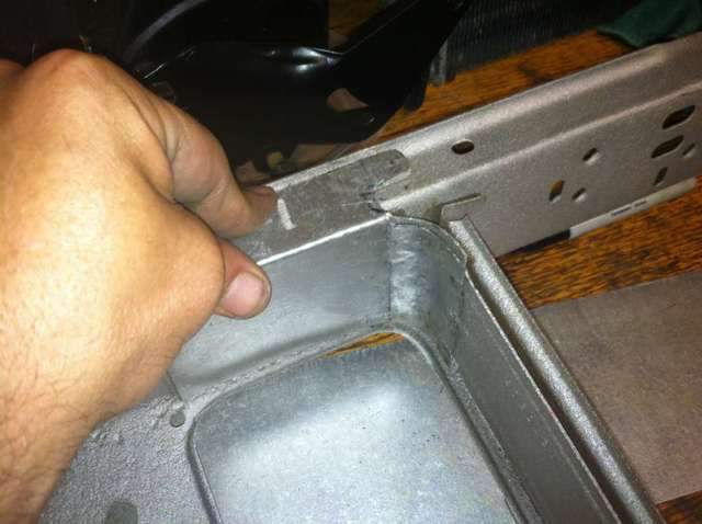

Do you need to weld up your mounting points before powdercoating the core? Guy did a great job and good price on the powdercoating.
You will definitely need to give me the names of these places for future references. I think JUSTA, notallthere, and I will want to know these vendors !
Yes i will have to fix the core support first,thats the plan.i can barely see a round circle where the old mounts sat.so when i get the new mounts i can line them up and patch accordingly.Frosty,The Sand blaster is Mark at masterblaster in New Hudson MI (248)437-6960 the powder coater is in Fenton Mi,superior powder coating 922 grant st (810)-433-3386

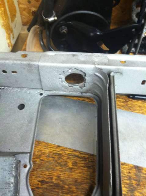

Nice work on the patch! Whats the other side look like? As long as you have one hole to line up correctly. I'd wait til your ready to assemble before cutting your hole. To make sure your in proper location. Since the rad is used I agree with frosty on taking it in. Even if you clean and rinse well, you might have plugged tubes. Sorry, extra money not counted on, but worth it in the long run. Condenser should be fine inside. Unless you have bent fins. They make a "comb" type tool that straightens these, Plug holes and spray with a good wheel cleaner, rinse to bring back shine. This is the one from the car and you know its good right?
would like this thread to be moved into the Progression area?

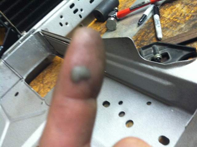

Steve,yea the condenser is fine.Ghost yea move this thread to the progression area.Thanks! Frosty,safety glasses wont help my finger LOL (i always wear those,and usually wear kevlar gloves as well)
