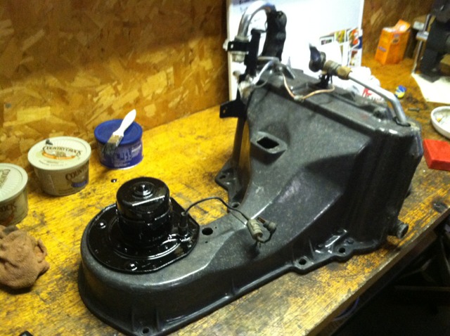

Going to leave the original color.

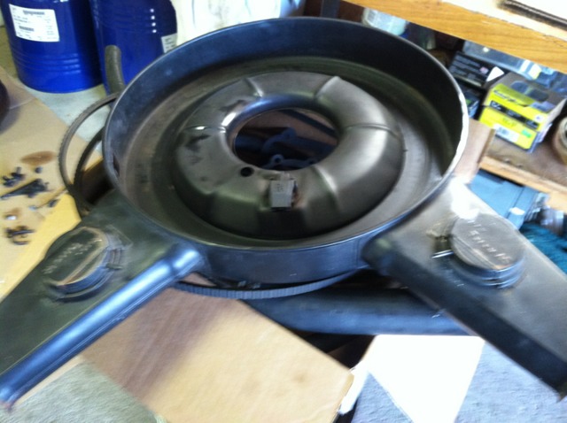

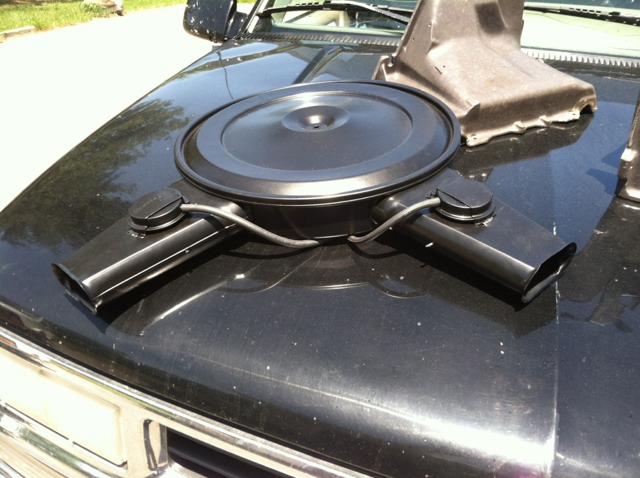

Air filter asm is back from powder coating
To this,yea it should be chrome top but..... Lol
post-1672-137036648923_thumb.jpg.

Lookin real good bro.

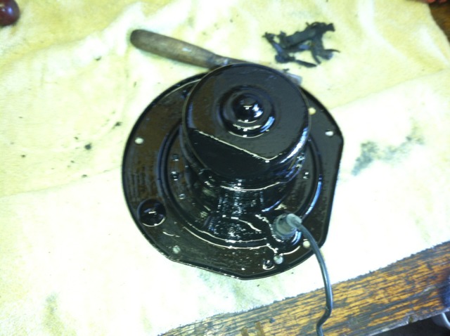

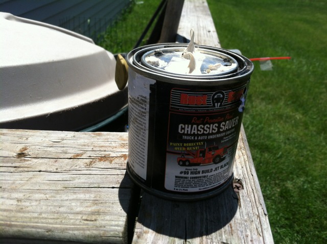

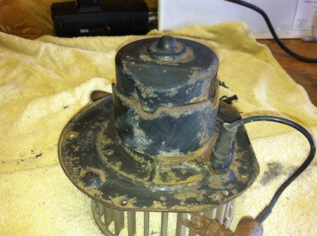

Blower motor worked fine,I don't trust reman units so some new part in a can
Some people call it chassis saver lol
9 monthrs I've had this can
Trick to keeping it is puncture 2 holes in top( I'm on to sides now) then pour what ya need then dab some silicone on the holes to seal it back up

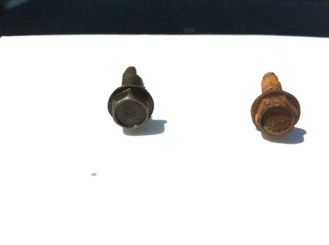

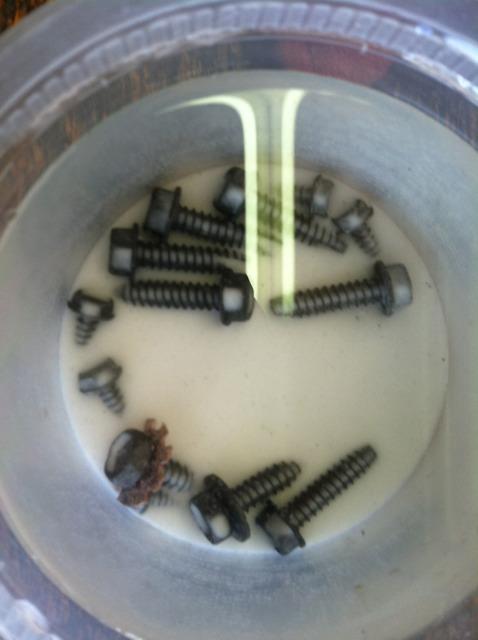

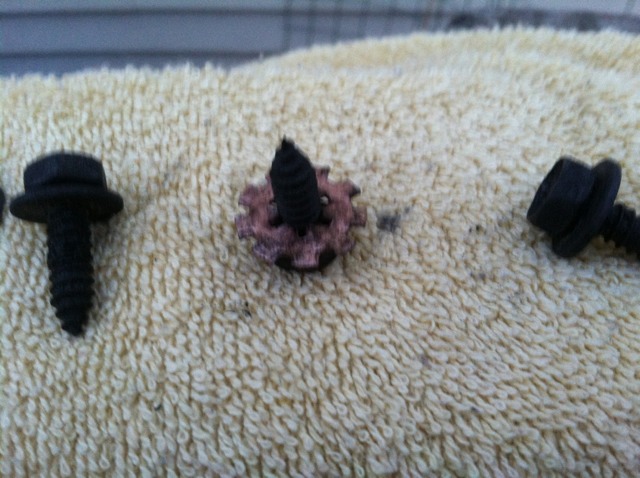

Ok I just tried something. A product called santeen.i put a rusty crappy bolt in a little jar.after 15 mins I pulled this out. I like it,rinse with water when done it has hydrochloric acid in it.post-1672-137037393881_thumb.jpg
You can see the head marking on the bolt now! And the bolt is blackened
Time will tell how it holds up but with a lite coat of oil it may last?
Sent from my ouiji board using black magic
Nice bath with baking soda will neutralize the acid
Thats awesome! Wish I would have known that one while building the GTO. Countless hours with nuts/bolts on the wire wheel. Didn't have fingerprints for most of the build. :lol2:

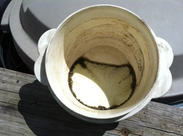

Did a batch in rustmort.this leaves a better finish I think

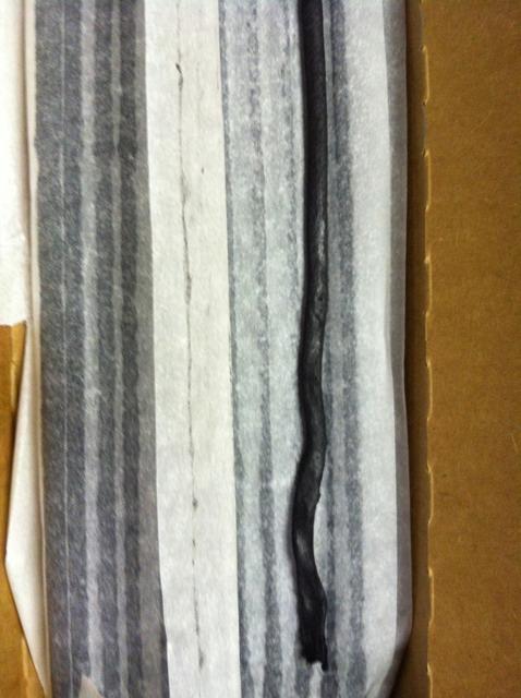

Used 3m strip calk to seal all together.

I'm sure you know it already, but when installing the heater core. Pack the outside edges of the core with foam to force all air through the heater core. Makes a huge difference in the heater when you need it this fall.
Joe - looking great. You are making great progress. The air cleaner looks good. You can get the chrome lid too BTW, they are re-poped - just not cheap. I was lucky with the Lemans. Mine came with the chrome lid and I turned around bought the black one so I could mount the engine decal on it. Meaning I have both now. I usually show the black so people know I have a 455 in it. They often don't pay attention to the rockers to tell them that.
I wouldn't mind finding another air cleaner assembly so I can air brush it. I have a set of Pontiac valve covers that I've painted to match the color of the car and I eventually want to true flame them in "blue flame". Since I moved, I don't have a shop to airbrush (or wrench) in right now. Makes things kinda tough.
