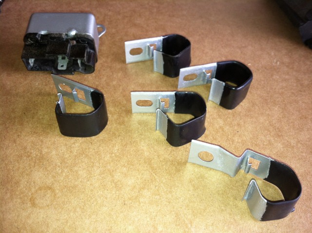

Nice job! The pride in restoring parts instead of shellin out $$$ = Priceless.

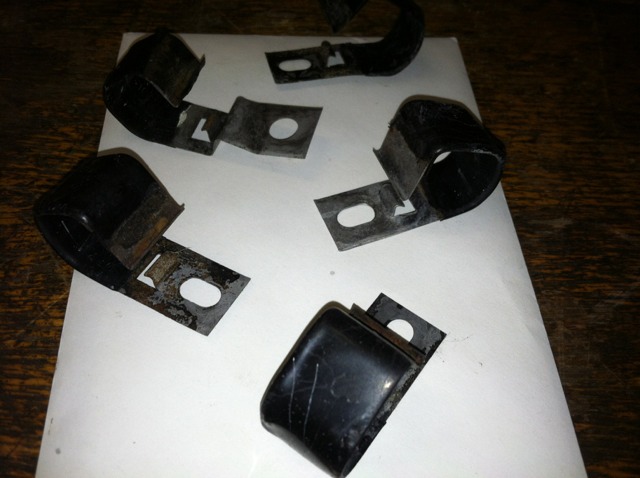

Stupid time I have into these dumb little parts lol

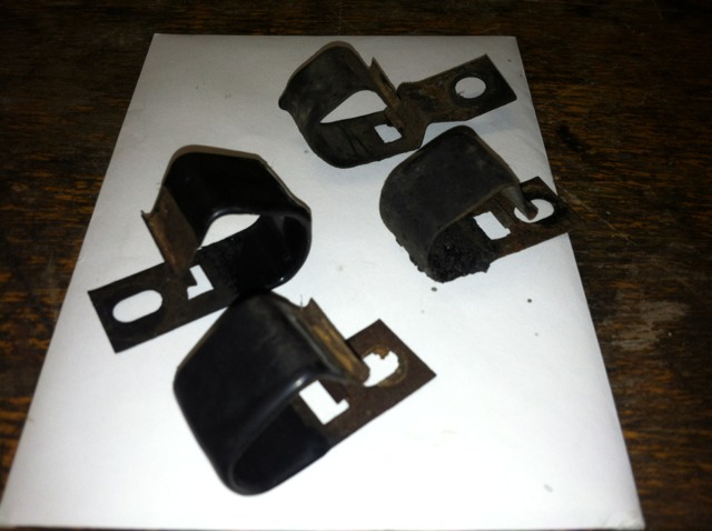

Underhood wire/hose retainer clips?
Always figured I have alot more time than $$$. So worth it if it can be restored instead of replaced. I'm so tired after today, tried to crash N JUSTA staring @ the ceiling.

Yea this things(clips)

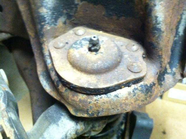

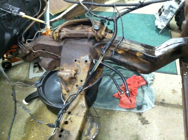

Hmmmmm if anyone knows a safe way to pull these springs please share lol
In the past I've had a motor in the frame,I'm worried if i attempt it now it may jump off the floor jacks....whatcha think ?

Inner spring compressor. Can use em free @ Oriellys or Zone. Put your rim/tire on the opposite side your working on. Removing shock, insert compressor. You don't need to wrench it down alot, Justa nuff to take some tension off. Put your jack under the lower A arm N remove upper ball joint, then lower the jack slowly. Hopefully your Ball joints have been changed from stock and just bolted in. Saving you some time and hassle. Originals are riveted in and you will have to grind em off.

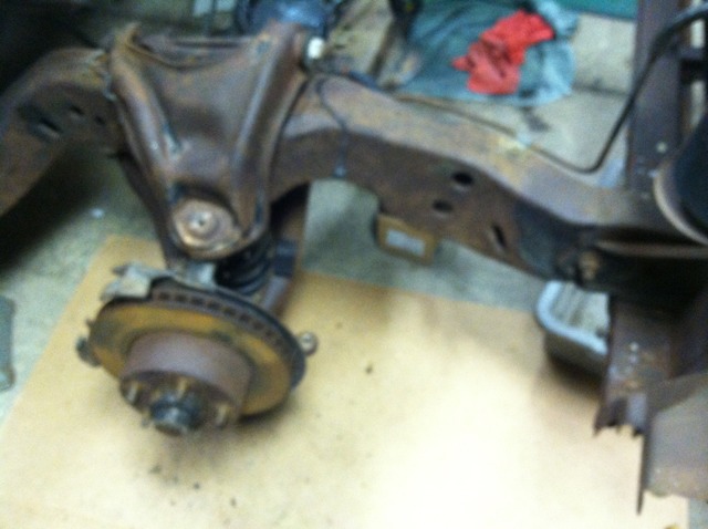

Ya mean like these lol

Let ya know tomorrow how it goes

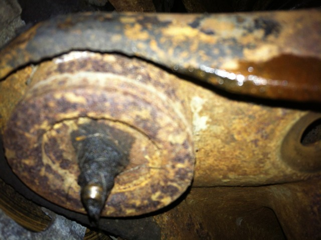

BUMMER..... Grind the tops off, heat em up N hopefully you can drive em out with a punch. Maybe look into Orielly's ball joint press with the compressor? You can beat on those forever N get extremely fustrated. Take an old one with you when replacing. Measure the hole against the new ones. The ones I recieved in my KIT purchased for the disk upgrade were the wrong size. Looked the same and are suppose to fit the hole snug. But too big will never go. I got MOOG's from Mazza's.
Yes I am getting moog
