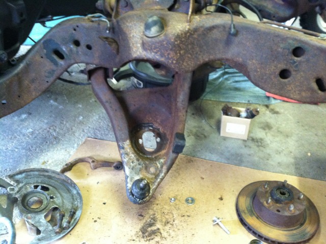

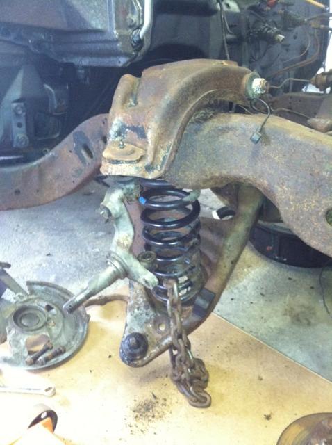

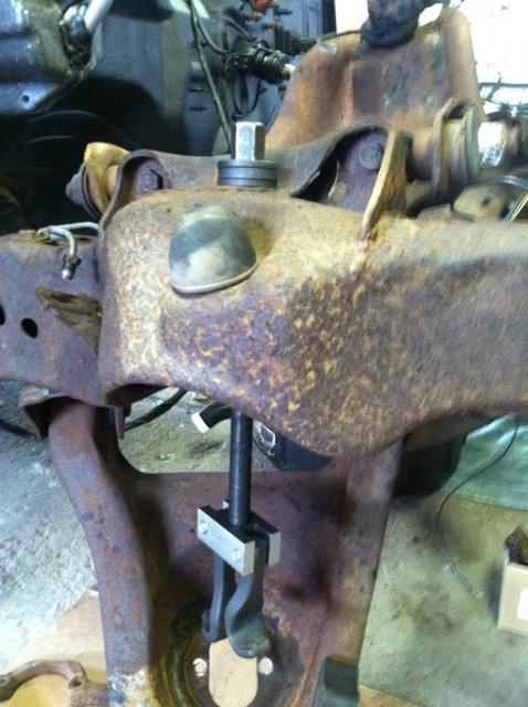

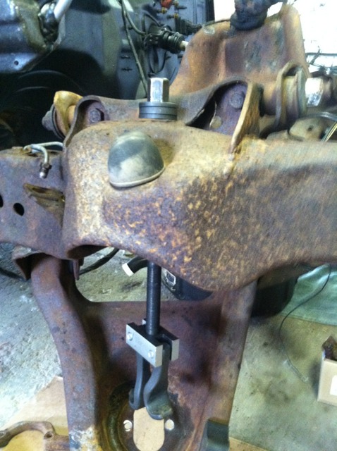

With the shock out,the jaws slip up through the bottom.the threaded shaft goes through the top shock mount.
Sent from my ouiji board using black magic
lmao, My antique set has 2 sets of arms on the threaded shaft, turn the nut and spread em apart, then insert throught the bottom and hook to the spring. turning the bolt compresses the two arms together. Be careful N good luck.
Joe, you scare the hell out of me sometimes! Call NPD in Livonia. They should have OER replacement ball joint if you can't find them elsewhere locally. In project Automotive Archeology, when we replaced the ball joints but we had to enlarge the holes since the original rivet holes were not the same size as the replacement bolts. This was not a big deal, but you might need to do that depending on the hardware you get. Grind off the tops of the rivets with a grinder (don't grind the A-arm in the process) and then use a power hammer or chisel to drive the rest of the rivet out. We used a step drill bit to enlarge the hole.
Like I said, my kit came with the wrong one. Mazza's had the right Moog replacement. Take your old one to match. Early 70's they made the change, but still have the same part# in some replacement brands. You might luck out anyway with the correct one because of your year. 66 A bod's take the small.
Good advice.
Joe, listen to the man. He should have a gold card from NPD by now!
I bought the complete front end rebuild kit for the Chevelle all at once from NPD. How is the rest of the bushings etc on the car?

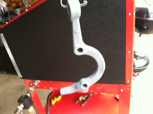

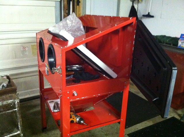

Spent alot of today assembling this thing lol
Had to take the neighbor boys dog to the crematorium this am,died in his arms last night.then drove to HF to pick this up

Nice blast cabinet. I hope you got some sleep.

He B the MASTER blaster now. :lol2: Wish I had room for one. Mine makes a Hell of a mess in the driveway. :lol2:
Someday I'll have one.
Borrow mine anytime guy's.
I'm going to wear out my compressor lol

Bummer about the neighbors dog. BIG of you to help em out. Blaster makes clean up so much easier :naughty:
