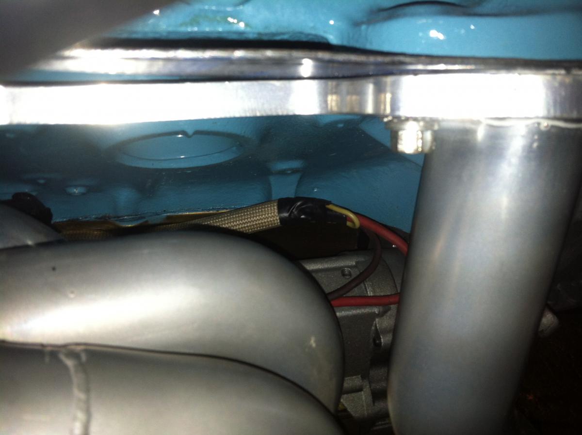

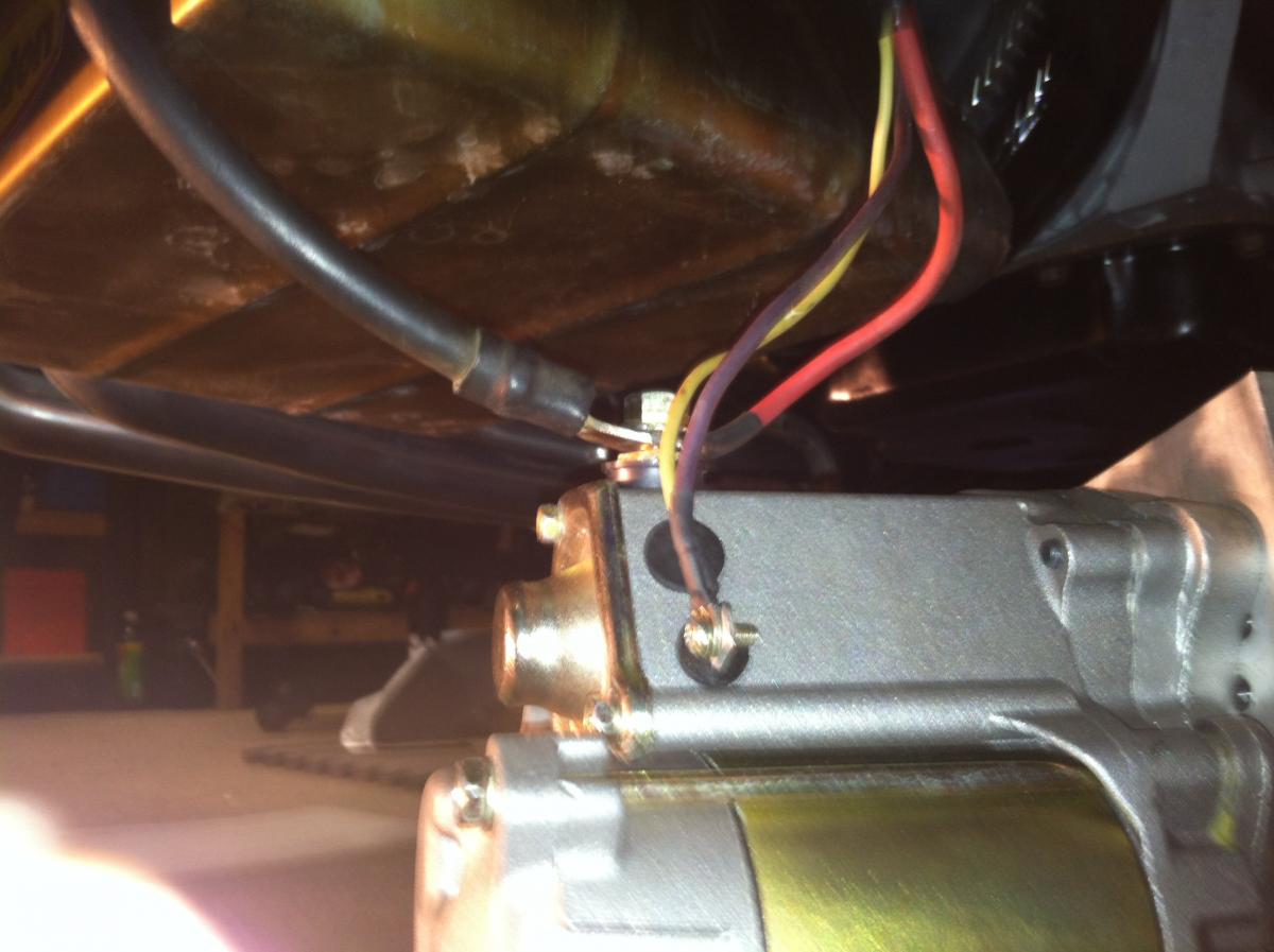

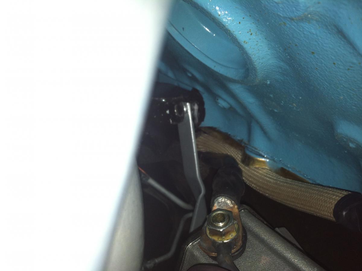

Not much of an update,spent all day yesterday trying to install the mini starter.wires too short,Shit broke another terminal LOL sooo i added some length (soldered in some off an old harness i had,get to keep the colors the same!) I can drop the starter,unhook the wires easily,reinstall etc.Not sure how much i added,maybe 8ish inches? But the important thing to me is i can likly do this on the side of the road IF i have to now.Headers and 7qt oil pan are no longer an issue! Thanks Frosty! Pics are with yellow wire,not needed..

Looks real good Joe. Glad I can help a brother out. Did you have to index the starter at all? Did you re-use the stock starter bolts or use the ones that came with the starter?
You know that Justa, notallthere, and I want to see this beast fired up pretty darn soon. Almost as much as you do.
The original starter bolts are too long,used the ones in the kit.And yes i did have to clock/index the mini starter differently than it came.

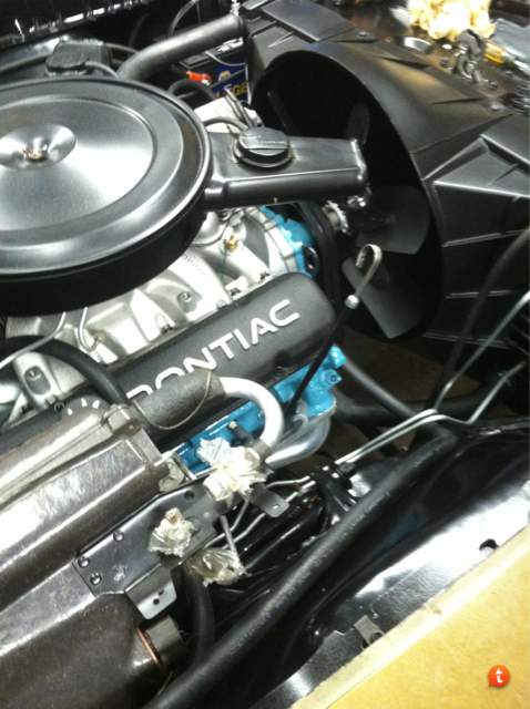

That sure is one fine lookin rad N shroud!!!! I can use the new spacer with my clutch fan...IF, i can find studs instead of bolts. Still haven't had time to start on the Sunbird (other than charge the battery) Bet your happy for the long weekend...geter done.

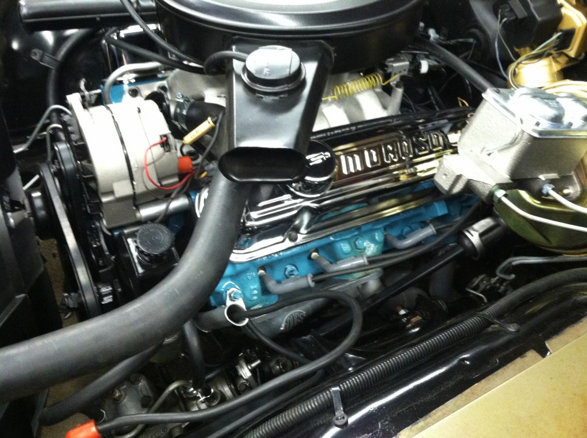

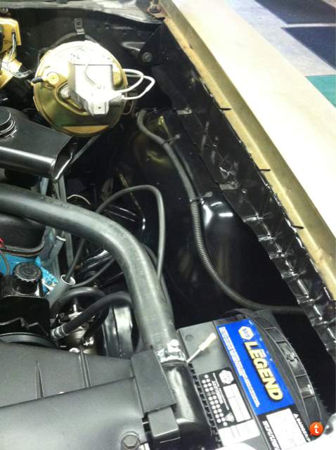

Well its time for an update..Had to get Baffled valve covers.leaked like a stuck pig outta the breathers like i knew it would..I bought the cheaper Moroso Chrome valve covers,baffled.Installed a pcv valve in the pass side breather and no more leaks.(oil anyways).Pisses me off i get to advertise for moroso without any cash from them.I will never understand people "advertiseing" for anyone without getting reimbursed.Today i had to change a leaky new Master cylinder...really? Pissed me off because brake fluid will ruin the gold plating on my new power booster..
post-1672-0-21807900-1402620638_thumb.jp
post-1672-0-60060100-1402620806_thumb.jp

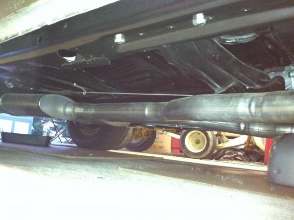

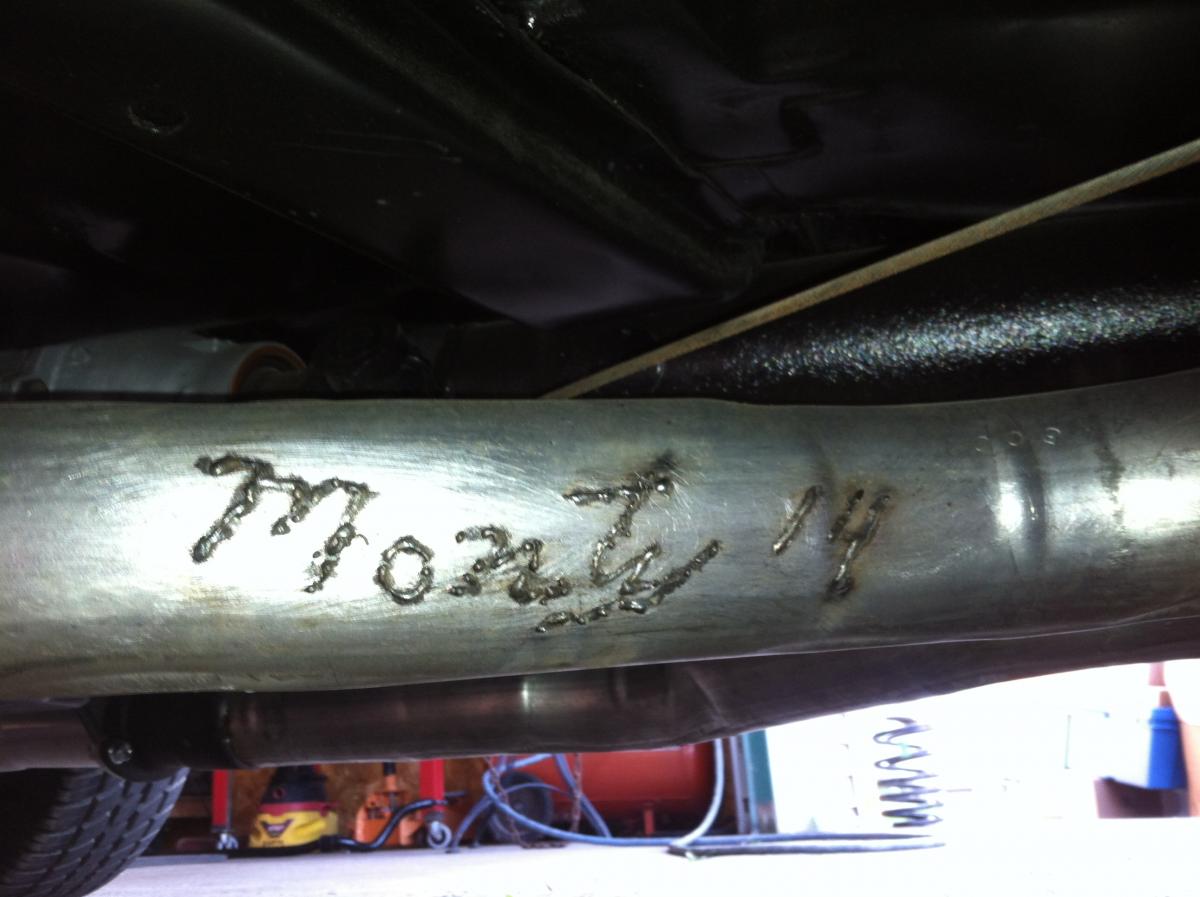

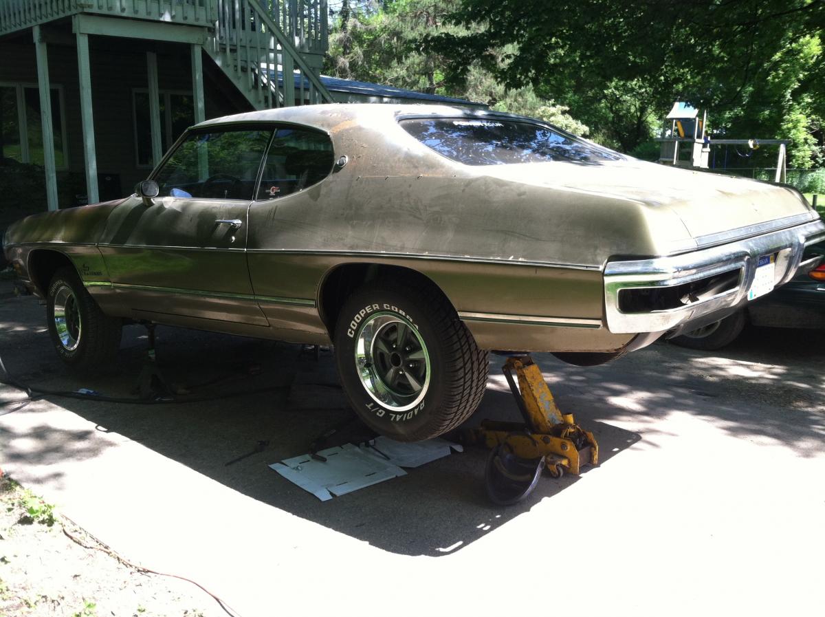

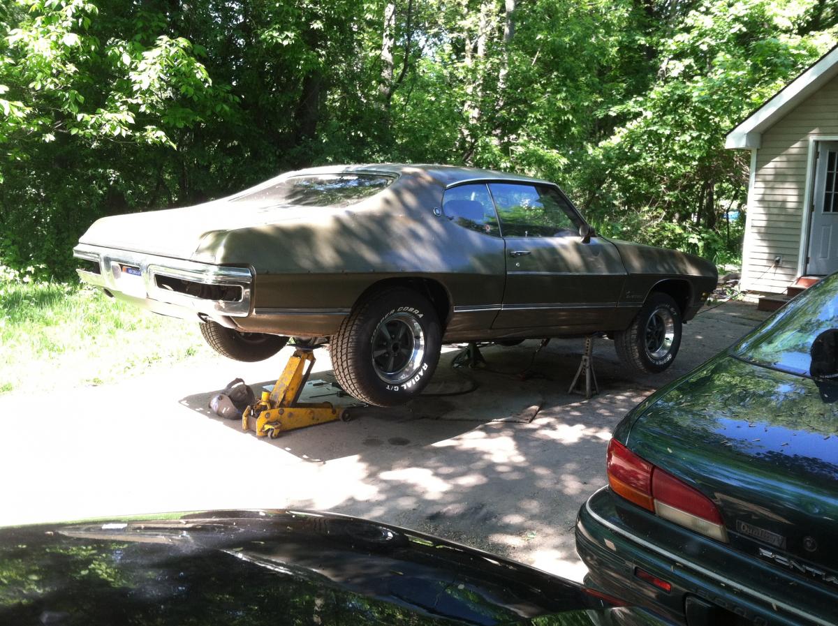

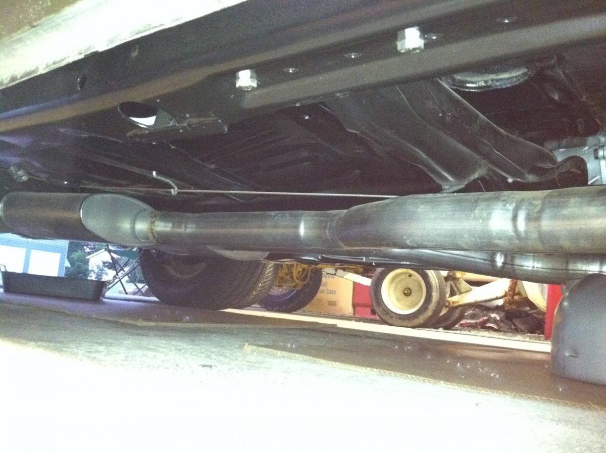

Monty did my exhaust last week..pics..Made me nervous to see him under the car and cheap ass old jackstands.
post-1672-0-04720000-1402621334_thumb.jp
post-1672-0-46890700-1402621369_thumb.jp
post-1672-0-87804900-1402621417_thumb.jp
post-1672-0-68218900-1402621467_thumb.jp

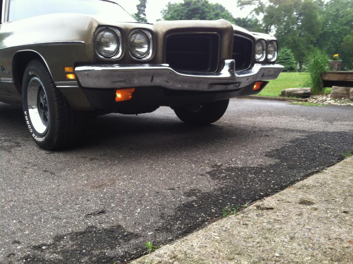

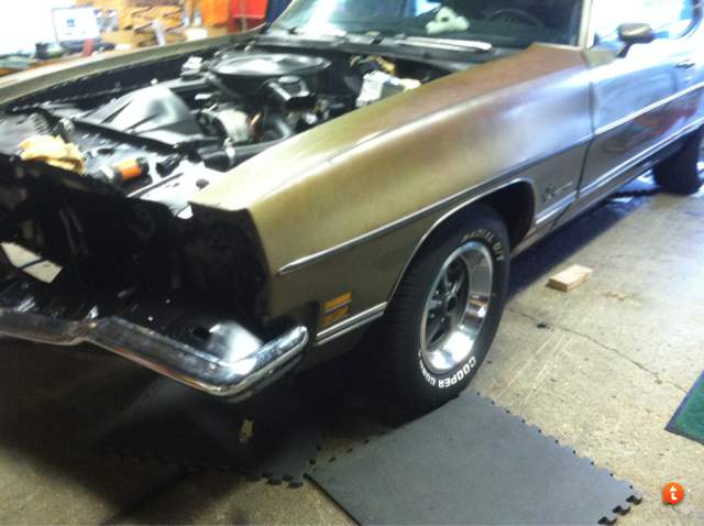

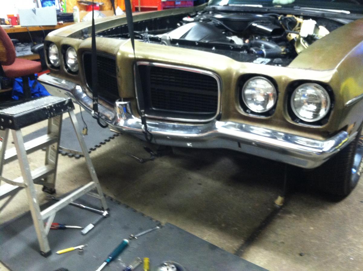

front end is all bolted on and aligned for now.Luxury Lemans got the front valance in chrome.Mine was in piss poor shape chrome flaking off etc..I SAND blasted this and spraybombed it black.Good enough for me.
post-1672-0-31251100-1402621661_thumb.jp
post-1672-0-42854200-1402621721_thumb.jp
Yes the jackstand pass side started to fail...we did get the car down in time so no damage.Think i aged 10yrs..
post-1672-0-49728900-1402621952_thumb.jp

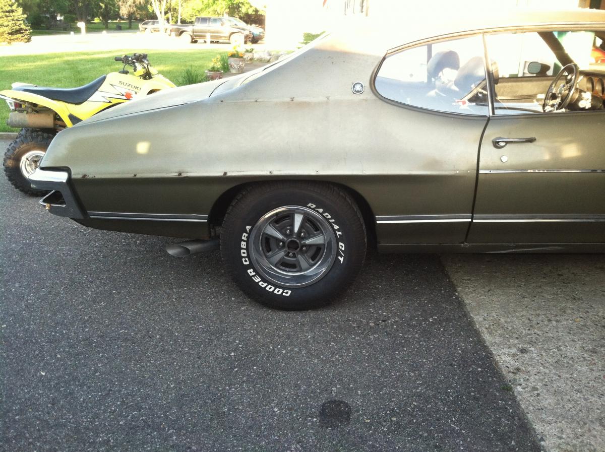

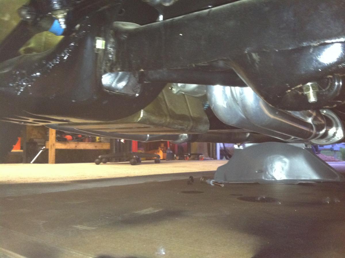

3 Inch exhaust front to back,barely notice it.Monty does great work.If i ever stick this car in a swamp,ditch.It can be winched out hooked up to the exhaust sytem no problem LOL The miloden 7qt oil pan is 1/2 inch above the front frame crossmember.hard to tell in pics.I went with "raptor" mufflers...first thing wife said was....Too quiet LOL i agree but its done.It does have that PONTIAC sound Note though.Electric cutouts are in the future sooooo,we can fix the quiet.
post-1672-0-61426700-1402622587_thumb.jp
post-1672-0-10975600-1402622985_thumb.jp
