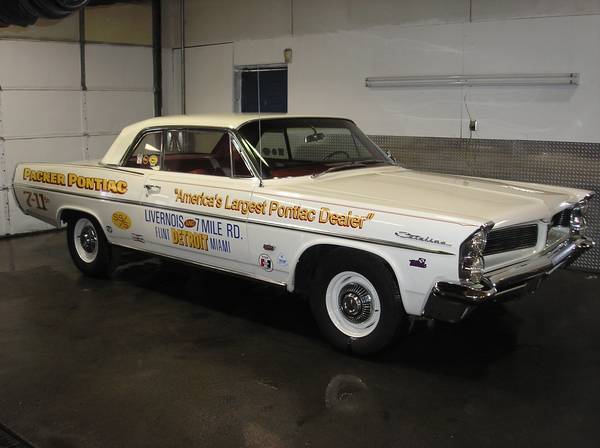

These will be going in next summer,or if i get really really bored possibly this summer.both are 6 way power reclining for the mrs.I want to have them done in the same material and pattern as the ones in the car now.Minus the GTO insignia.100 bucks for the full set front and back,if i get 50 for the rears i'm happy! Why can i not load pics all of a sudden? anyways they are 2004 GTO bucket seats.coming apart at the seams in a couple places but i couldnt pass them up for the price.
Lets see..
Sweet! Is it the real deal?

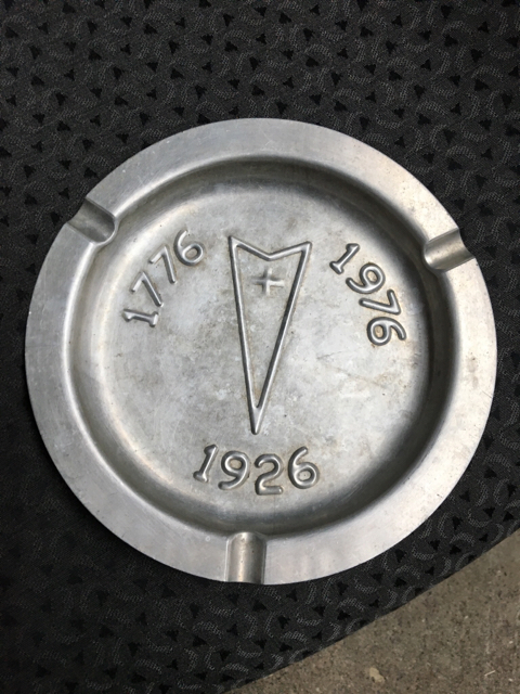

Didn't know where else to put this scored this on craigslist today for 10 bucks
