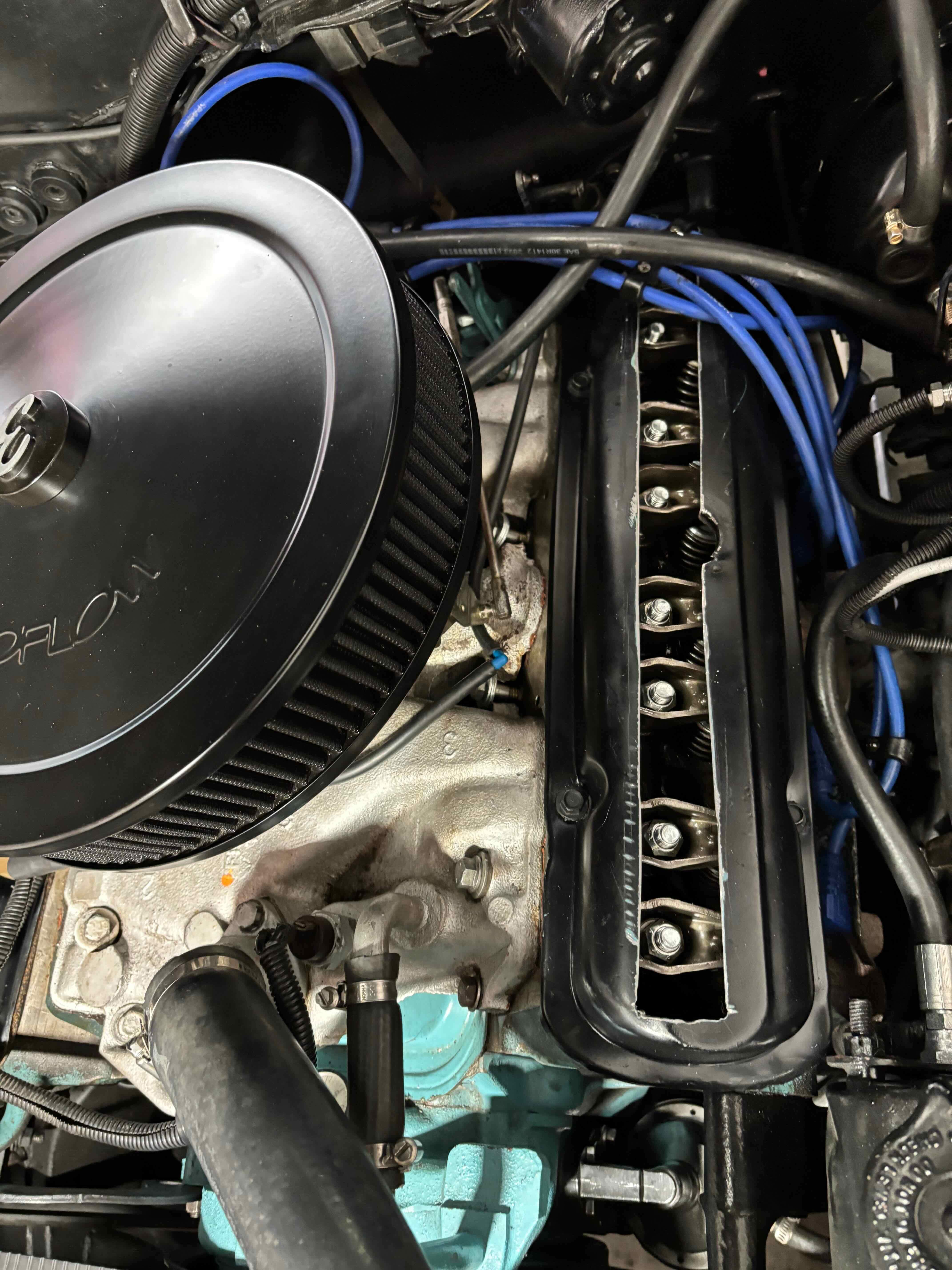

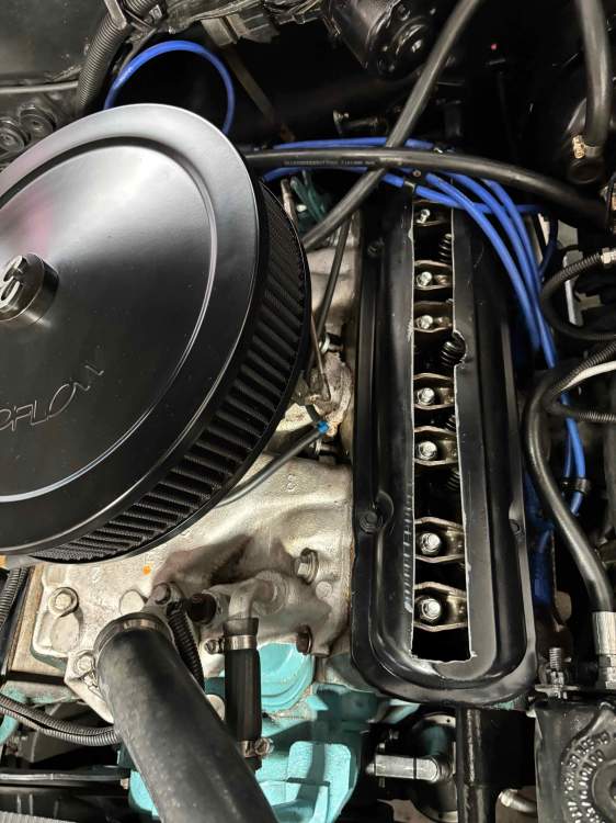

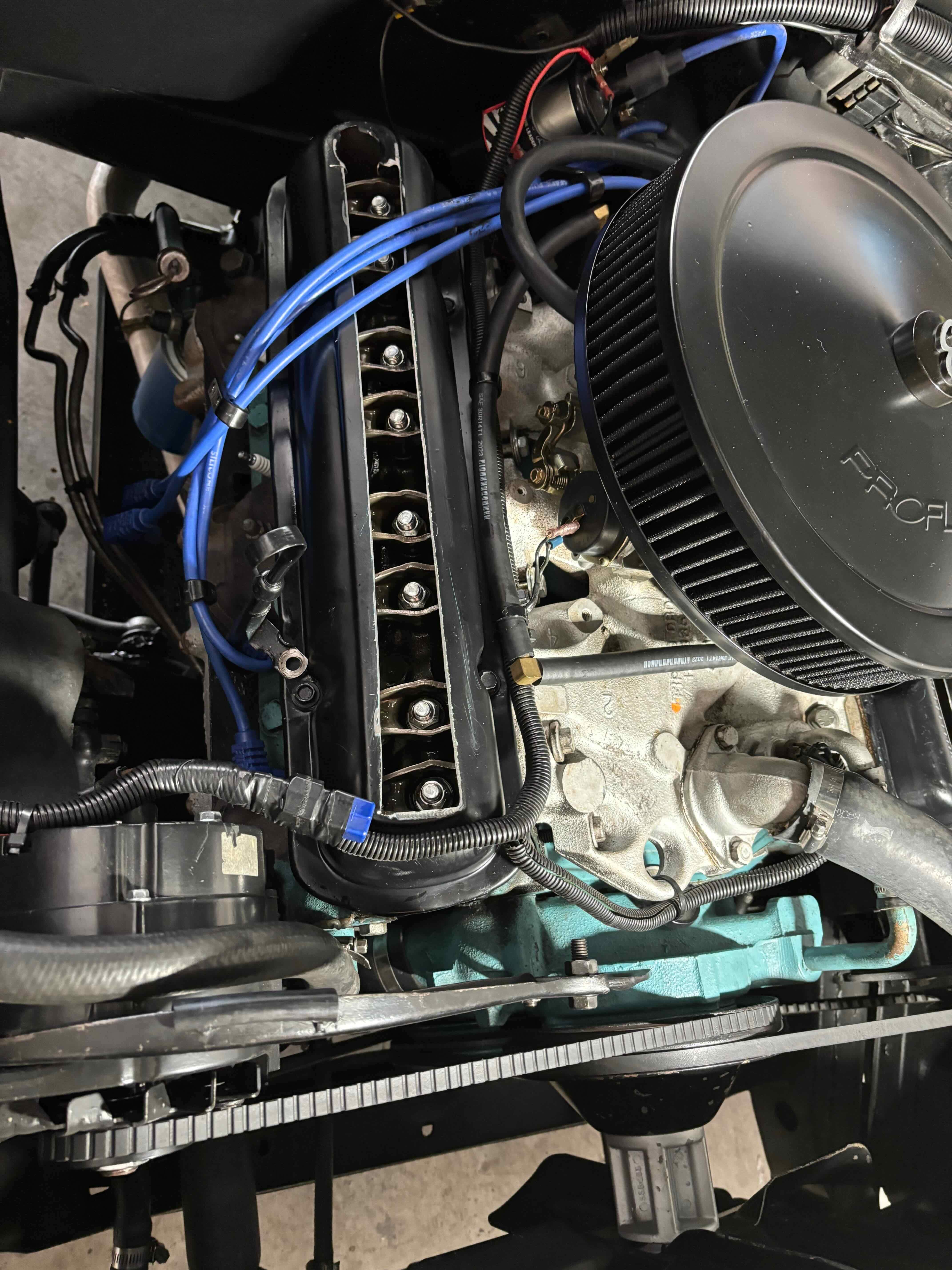

Well, well - after learning the hard way last time I did my valve lash adjustment the "correct" way (running of course), I decided I've met enough of the local Fire Service personnel already and wanted to reduce the smoke screen this process inevitably creates 🧑‍🚒
So, not having any better use for my original valve covers, I decided to get creative (in English, carve them up).
Did the job this morning, and the mess was significantly reduced. Still some oil that shot across the engine bay that wasn't caught by rags, but otherwise it became a relatively clean, simple job that was pretty easy to clean up.

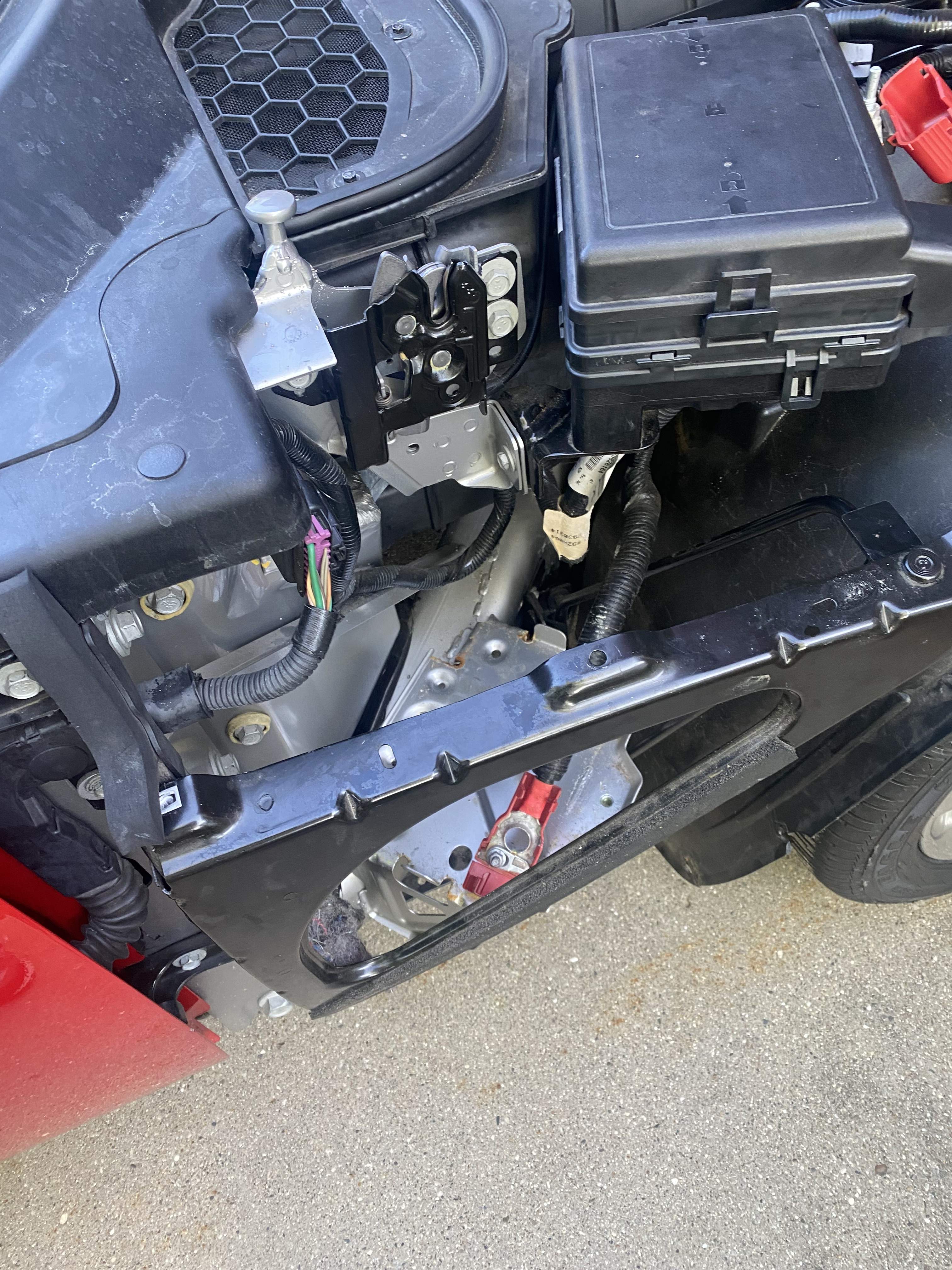

Last night I had the joy of removing the battery out of my mother and father-in-laws 2006 Solstice, with the help of my brother-in-law. Removing a Solstice battery is almost as bad as removing a Corvette battery. It’s located in the passenger side fender, near the door, next to the firewall.
First, the battery is dead, it won’t crank or start. We had to jump the battery enough to be able to shift the car into neutral (electronic shifter - it cannot be manually shifted into any gear without some power). We pushed the car out of the garage, set the parking brake, and blocked a rear tire.
Next we had to remove all the bolts that hold the partial right front fender on the car! One in the door well, three on top, two on the bottom, and three in the fender well. All are different socket sizes or so it seemed.
With the fender / cover off, we had to remove a retaining nut to a metal frame that acted like a small swinging gate. Now we could disconnect the battery cables, hold down bolt, and take the battery out!
We pushed the car back into the garage for now, I put the battery in my truck and I took it to the garage mahal to charge the battery. Later today I will take it to a parts store to load test it, once it’s fully charged.
What a chore, that battery!!
Rick

Bro-in-law and I got the new battery in the Solatice. The old battery was DOA. It’s madding because it isn’t even 3 years old. Only a 2 year warranty though. Shit. Mum isn’t happy, she thinks she got a 3-year warranty.
It took longer to reinstall the fender than it did to take off. Getting the bolts started through the door and bottom of the fender were hard since you had to do it by feel.

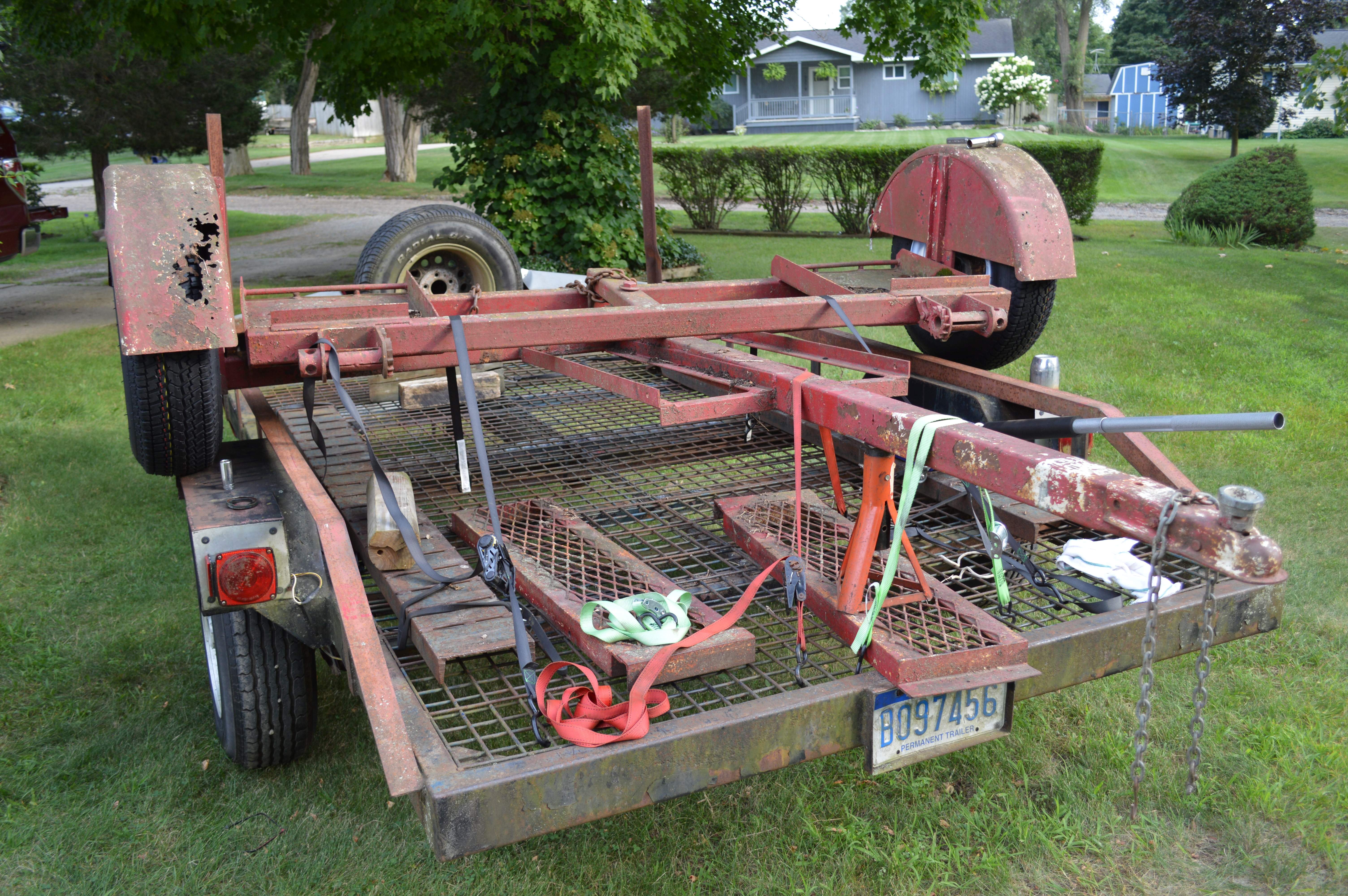

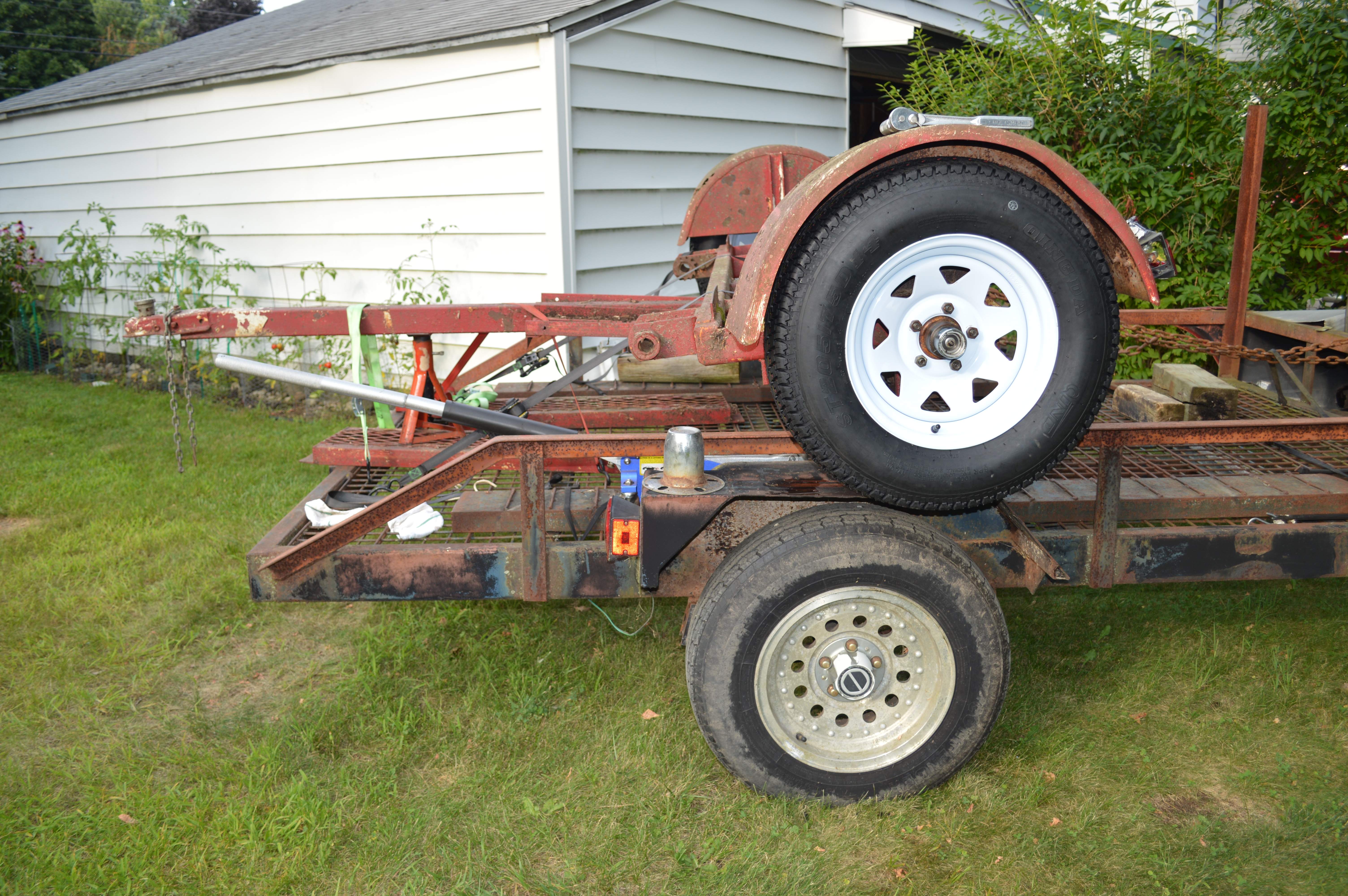

Have the Sunbird back together and have gone through every in of the wiring and can find no reason for the Pump to stop working. The car will not go onto a flatbed and can't be wrecker towed. So I've got myself into a much bigger mess. Was given a T trailer/ car dolly from a friend that hasn't used his in 25 yrs. Was in weeds/3/4in vines with pickers up to my armpits. I was a torn up mess by the time I got in there N hooked a chain on it. Pulled it out with the truck til I had to cut the rest out. Then realized there was no wheels on it. After digging, I found one wheel with blown tire. He couldn't find the basket tie downs. I used a come along to get it on my trailer and home. After a full day of trying to match the original rim/tire I came across 2rims/tires and got an awesome deal. Orig will be my spare. Will go through and inspect/repack bearings. Add some real safety chains, it will be hauling my baby. Ordered new basket tie downs that came in today. Will have to customize the wheel pockets so the car will sit higher and not destroy the front spoiler again. Will also need to be able to pull it out so I can haul the GTO if needed. Need to rewire with a new light kit. Make it functional so I can get the Sunbird home if I have probs. Maybe I'll even try to get the car out for the 1st time this year. Will have to buy new fenders and sand/paint before winter hits.

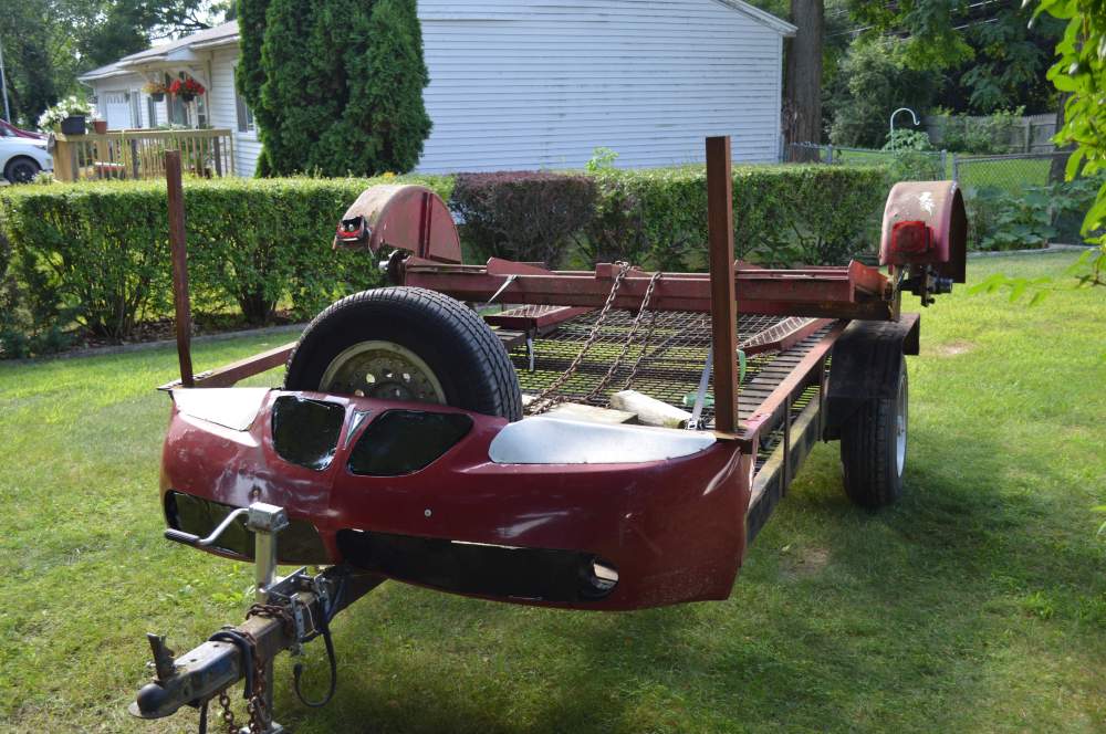

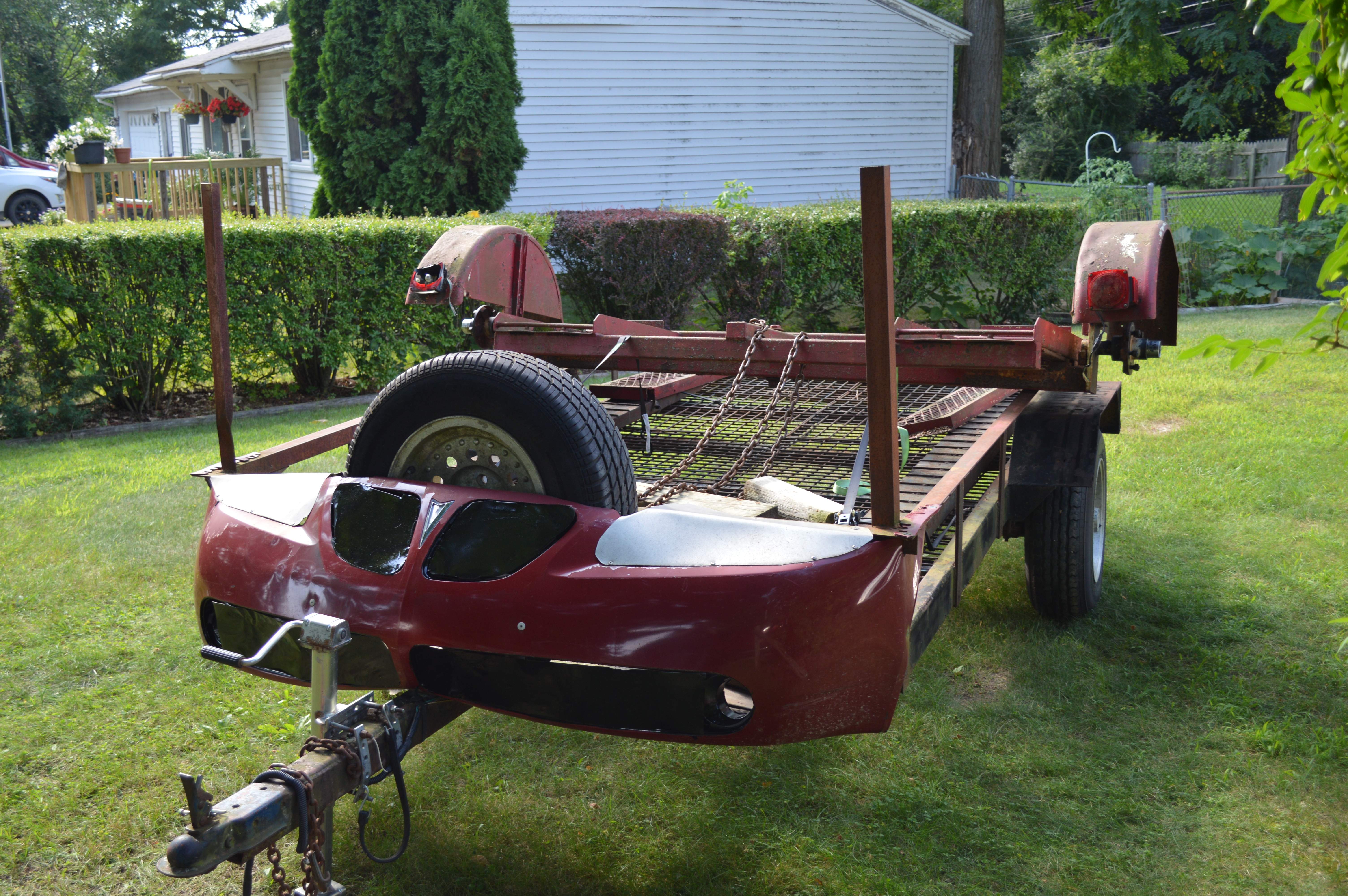

Bought all new bearings, seals, bearing buddies, rims/tires, basket hold downs for the tires. All installed today after the rims arrived. Have done a bunch of sanding and started painting tonight as well. This will be the only way to get the car home if needed. Was able to straighten out alot of the Sunbirds front air dam damage, but have spots in it where paint is cracked. Can't mess with it any further. All I can think of to do is add super glue to the cracks and hope it wont spread farther or loose chips all together. (I know) Here's a couple Pic's. Get to see my Pontiac utility trailer too.
Justa - I was expecting this thing to be painted as bad ass as the 'Bird based on how you were talking about it!
I suppose I should cut you some slack though. It's tough to hold a paint gun or can when one of the twins is barfing on you! rofl
