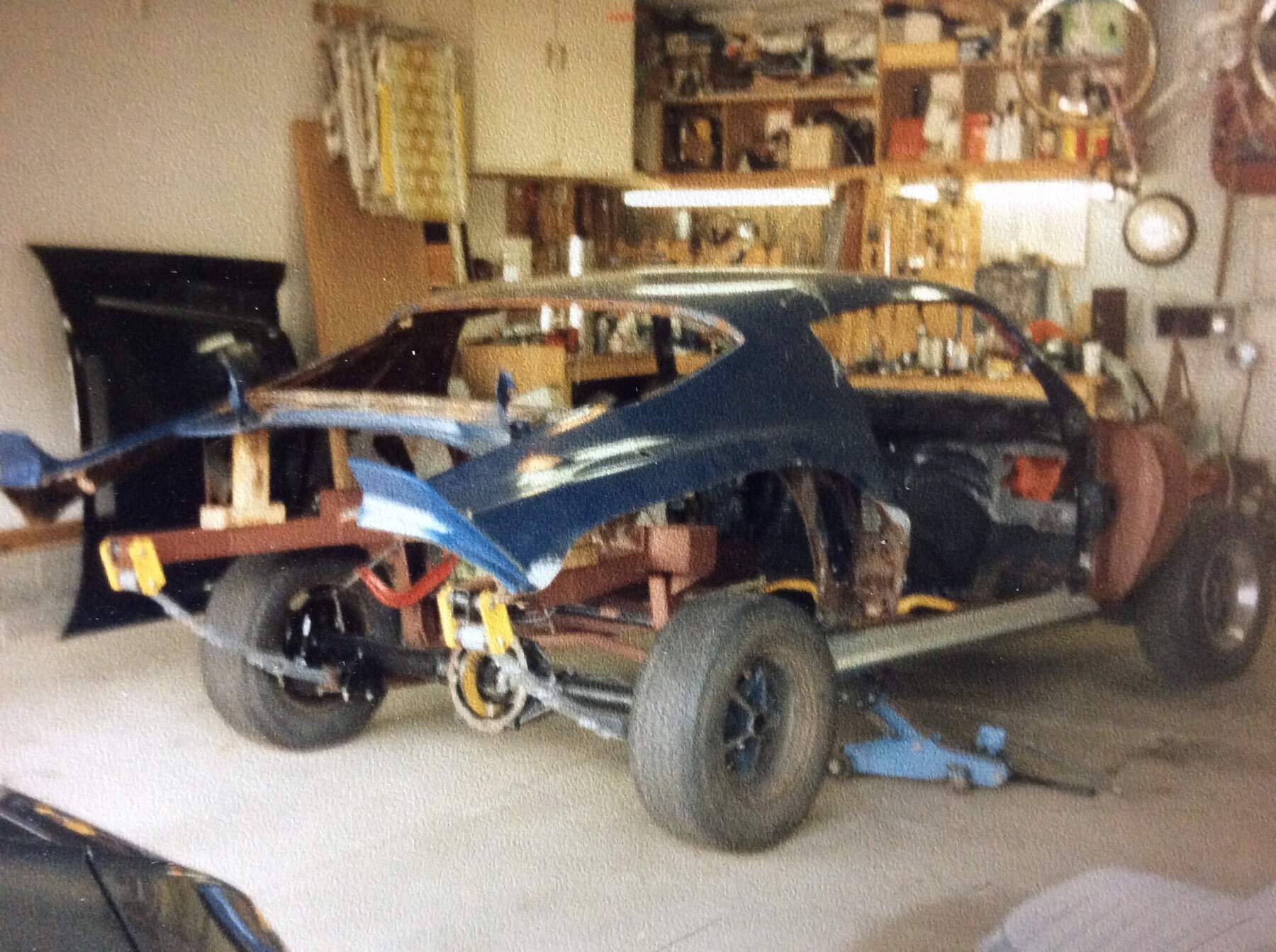

    Fitzy, you hit into the head! There are times I look back & say to myself, what was I thinking?! I did two complete builds of my Z on a stone driveway & one of my wife’s “74”! The original Z I

Ok, been awhile so I will update. Hood insulation was a no go. Fab'ed a metal cover for inside. Had to cut out for carbs, but almost completely covers the air cleaners. Sooo drilled my hood scoop inserts and made a foam rubber funnel around the carbs under my new metal, while I can't call it ram air. Its breathing throught the hood now.
Made the All Pontiac Dustoff in June for the 1st outing of the GTO with the rest of my TRIBE!
From carbs to steering gears and many other issues were sorted out this summer. 2nd car event it attended was the Woodward Dream Cruise.
Hit one last show in Milford Mi and the GTO took its 1st award. Even in WIP mode. (work in progress)

Carb issue seems to be the center(small) ventui's loosing up and allowing the spring/checkball to continue leaking gas even after the motor is shut off. Had it apart so many times, but was was looking for probs with the float. Tightening seemed to solve the prob, but after running they loosen back up. I made my own fan schroud and that helps alot keeping it right around 180. Breathing outside air through the hood also helped, but I still have the Chevy radiator in it.
A good chunk O da summer was steering issues. Ordered 6 different steering gears from 3 Parts suppliers before I finally found one that worked, but also had to change my knuckle. All that N very LIL difference from the one I replaced, still having 1/3 turn of play in the wheel. Finally contacted the supplier, who argued that all their products were tested before leaving the plant. So I took the car up to Advanced auto and pulled the manager out. They had very LIL info in the computer, but I came armed with the company phone and rep contact #. After a round about on the phone, the factory rep sent me a quick ratio steering gear and a new knuckle (like my old one) @ no extra charge. New parts arrived 2hours before the Bakers cruise N I dropped it in and made it over there. BIG difference. Still follows road lines with the 60 series tires on the front. Now I'm back to issues with the USED 350 trans. Its leaking like crazy (pan gasket) but I have a new factory Chrome replacement pan that will correct that prob. Car will lite em up N push ya back in the seat, but not like it should. With the B&M ratchet shifter, I finally pulled it back to 1st to run it throught the gears by hand. Ya better be holding onto something!!! Apparently its not downshifting all the way to 1st. Bringing up the next delema. I had purchased a 200R4 w/overdrive that with reworking will handle the power of the 421. Downside....1200.00 to upgrade, but overdrive will help with gas $$$. Didn't have the $$ and anxious to get er on the road, I bought the WORKIN 350 to get er on the road. So do I sink time/$$ into the 350?? or save up for the 200R4?? Like everyone else $$ R a prob and have to choose my battles wisely. The replacement radiator and correct fan schroud is almost 500.00 But like the trans, it's good enought to get me on the road for now. I have my Flowmasters and tips I want to make my exhaust, but have to buy pipe (and my buddies bender Justa kinks the bends and flattens the backside) or have someone do the exhaust for me. Still lookin @ another 500.00. This is a huge issue with the wife, exhaust under the car stinks bad (esp running rich) and need to drive with the windows down. Need a drivers seat (so I can get rid of the awful seat covers) again 400.00 for foam/covers and ??$$ to have it done. Would have hoped to have this all worked out this summer and be moving onto paint this winter. My cost in materials comes out around 2000.00. But will have to replace all rubber doorseals, window seals ect before re-assembly upping that cost as well. Too much thinkin and I've already wasted half the Bowhunting this month and haven't even been out yet. OHHHHH for the LOVE of PONTIAC......................

I'm assuming the vacume module is bad on the tranney and possably the kickdown cable. Was impressed the front and rear seals appeared to be new N clean before I installed it. Pan gasket didn't start leaking til after Woodward. Already have the replacement pan/gasket. The 200 will find its way HOME somewhere down the line.
Advanced Auto was the only one to have a semi-correct steering gear. After getting it home my knuckle/rag joint had a flat side on the shaft and Advanced didn't have a part #. I called the vendor and he stated that he just sent a shipment to them and they DID have correct part. Main warehouse is down South. Us Northern fingers don't have complete access to inventory. WHY???
He sent me the part# to order through Advanced. They thought I was nuts comming in an telling them (store manager) how to order what I need. Even more amazed when it worked!!! I walk in now and all the counter guys say...GTO Steve is in the house. :bowdown: So after discussing with the vendor the 2nd time and the store manager backing up my story on what parts he had available. The vendor then helped the SM order the correct part # for MY steering gear, upgrade @ no extra cost and also sent the NEW original knuckle/rag joint as well. Everything is new, but I still have a small amount of play.
Cooling setup works for now as well.
Exhaust is the next issue. Have 50 series Flowmasters 2 1/2in and bought the very expensive TA double chrome tips. These will be exiting before the rear tires. Simple bends, but my bud doesn't have the correct 2 1/2in die's. His bender is for tube chassi, not exhaust. I tried bending junk pieces before buying my new.
Seat covers embarrass me the most. Need the correct foam (thats half the cost) and a hog ring kit to do it myself. Barry (SONIC) has another seat and will take mine as a swap, but he wants 250.00. Question is how long would his old/new seat last before it tears up as opposed to 150 more for brand new cover??? Then again will the new cover match my old pass/seat? or do I need to do both, upping the cost to 1000.00. I could always put 2 NEW adjustable/reclining seats in for 500.00, but I've kept everything mostly stock so far. :pontiac: I'm also looking for Chrome "carrage" seat belts. Have 2 but using 2 - 70's black plastic (that have already broken beyond repair. :slap:
I purchased the front and rear seat covers from Legendary Auto Interiors all at once and then paid my upholstery guy to take them apart to add the blue piping. So my experience says replace everything at once so they match. So $500+ plus for front and back seat covers from Legendary. My uphosltery guy added more foam to my seats for me.
Have you talked to anyone at Midas, Tuffy or Muffler Man for mandrel bends or a custom exhaust? What about getting a 2 1/2 universal pip kit and making you own? It's a lot of hassle, but it might be a lot cheaper. I think Magnaflow and Dynomax both sell these kits.
