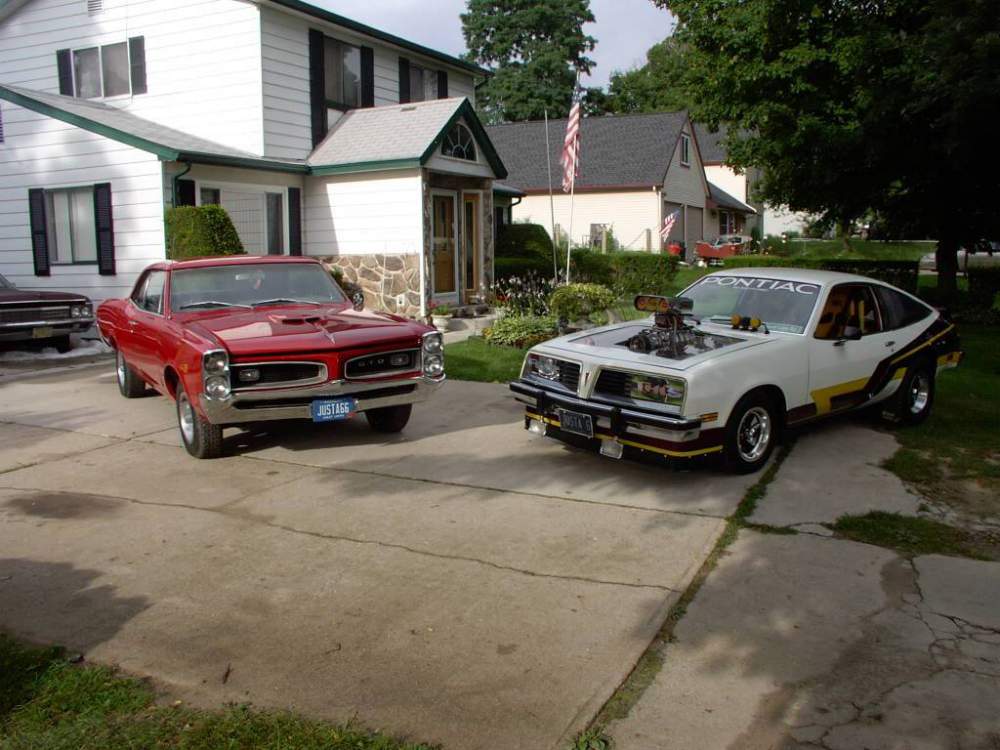

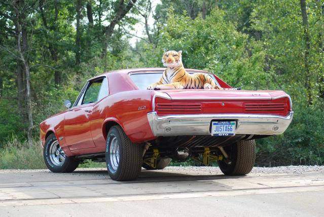

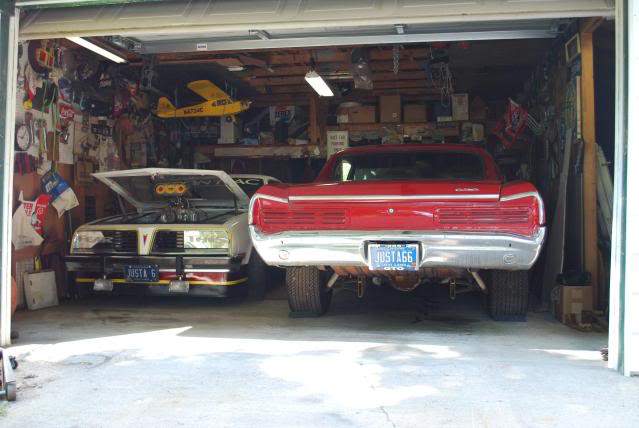

Purchased in 07. 66 GTO stripped to the bone racecar. THAT was my 1st mistake. Got er home plates ins. Pulled the Bird over to get a family shot. Justa6 N Justa66.

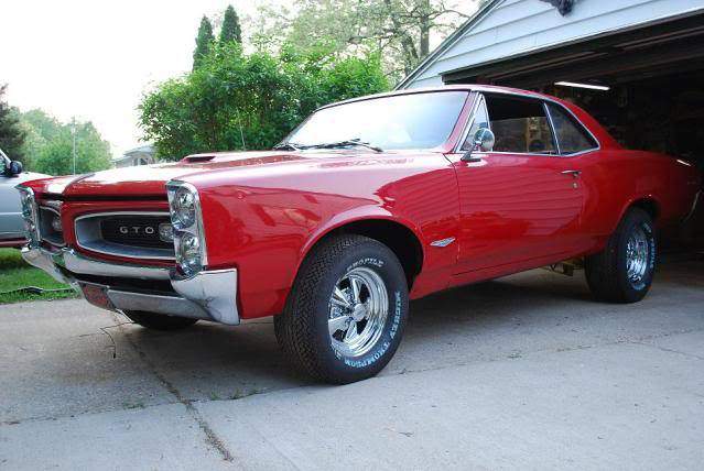

Thumpin 396 Chevy, No brakes, Entire frontend was sooo shot you could move the wheels back into the fenders. Front to rear missing rubber in bushings. Replace all...upgrade to disk. New Cragers N sticky Mickeys. Interior was completely torn out. Seat mounts welded to the floor for fiberglass race seat. So many holes in tunnel (for diff/shifters) All wiring ripped or cut out. Toggle hot, toggle start. Did find the dash pad in trunk. Did get some interior parts, org seats (destroyed), oddball chrome, couple shot doorpads N 2 armrest. LOL 1 was a backseat. Rust through on pass/floorboard N trunk was cheese.

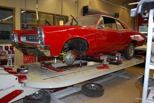

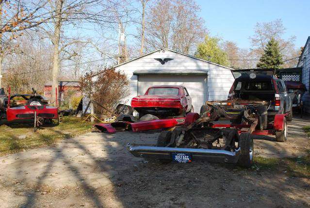

Frame shop confirmed. Frame is bent in sooo many places, straighten one bends another worse. Then they found front A arm mounts (pass/side)were cut off and rewelded to straighten out. GAME OVER. Floors, missing body mounts. What wasn't rusted off was used to bolt body directly to frame. Inner rockers were Justa plain missing and tranney was holding floors up. Junk it bro. I dont think so......... Worked for PMD 30 yrs, will spend the next 30 building my dream car if thats what it takes now. This was a Thurs. Shop owner told me to haul it outta there by Monday. = DEPRESSION. Made 1 phone call and found a frame. CATCH..its a complete car that needs to be stripped. Me and owner started @ 8am, 75 miles from my house and completely stripped this car right down to gauges, glass and window tracks. Fought with owner over the dash harness as it had all bulbs/sockets missing from my GTO. I won. Had it home by 1:30pm!

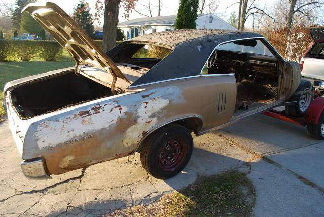

By myself claimed my new frame prize by 7:30 same day. Sanded, painted/cleared and had it up to shop Monday @ 8 am. Already on jig. They picked up my body and dropped it on new frame. Now haul this pile O parts home. He didn't charge me for any work. I tip my hat to you for takin on this project.

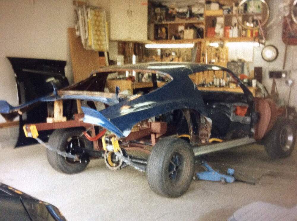

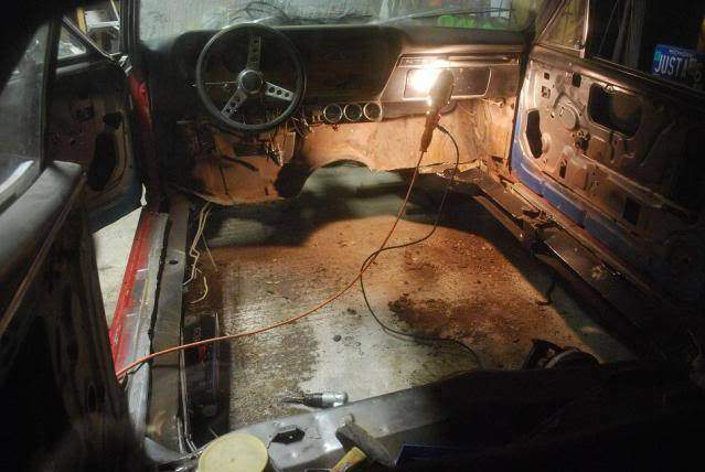

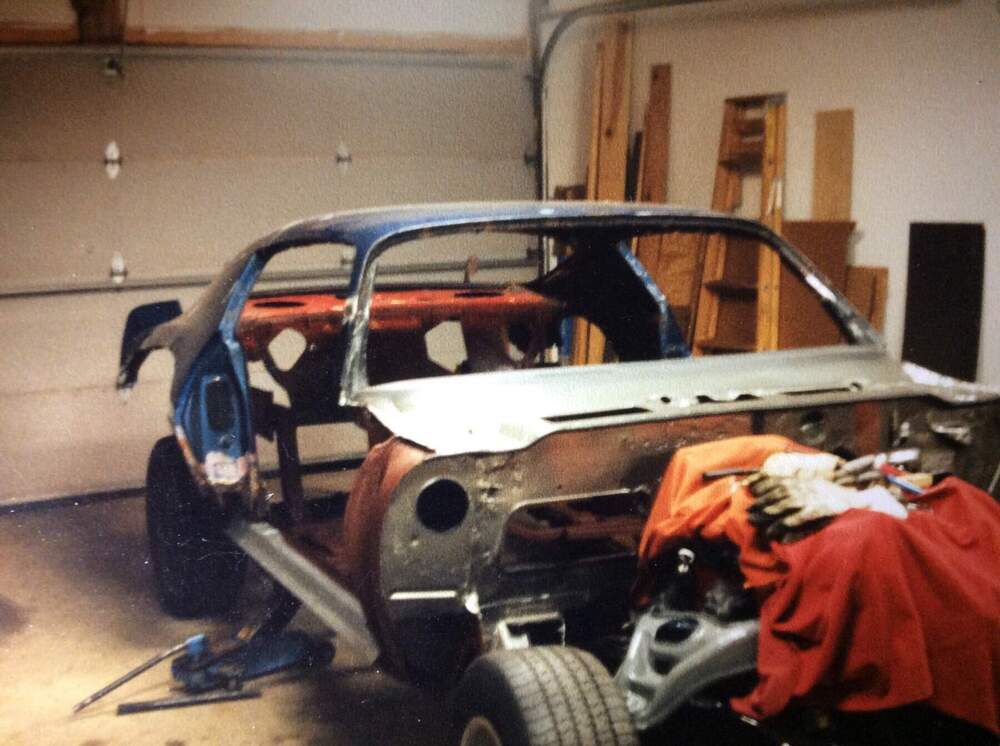

Back to SQUARE 1. Transfered all new suspension including the cleaned/painted A arms to new frame. Body up and major rebuilding begins as doorpost braces are also rusted away. Fabricated all new and inner rockers and kick pads with new air boxes. NEW floorpans/braces/body mounts front to trunk. Tore out shoulder tendons and rotator cuff lining up body mounts. (way to go might mouse)

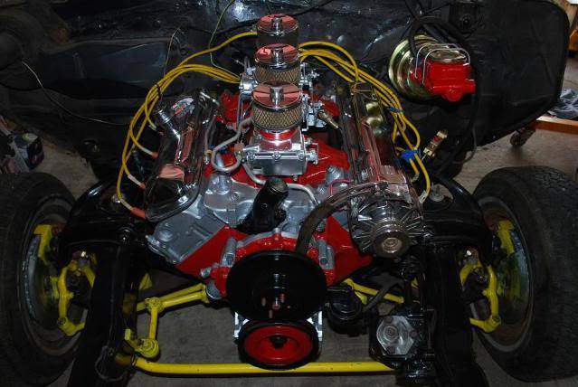

Rebuilt the 421 and dropped er into the framerails. Til rust do you part! All Pontiac with better warpaint!

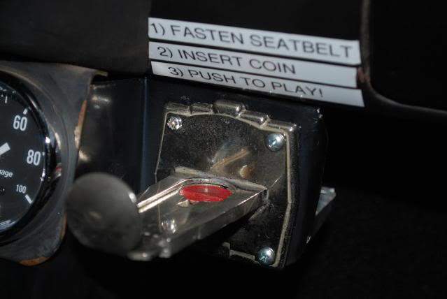

Interiour mods include console and the very rare pay to play option. Justa like the LIL car outside the grocery store. LMAO

good work Chaos. and the pics. :blink: awesome. i like the "pay to play" one. and well, the GTO too. :D

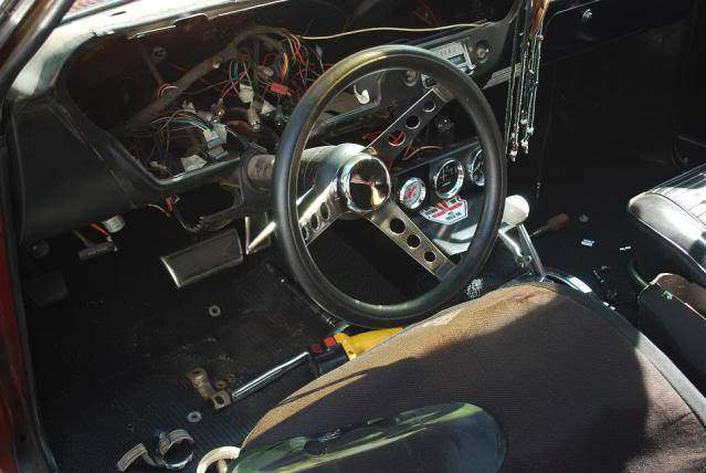

I could hardly read my GTO gauges even with the dash lights on. So I pulled it and found that when they gutted the car for racing. They pulled the dash pad, radio yanked or cut ALL wiring and spray bombed what was left black. overspray got in behind the lens and all over the gauges. Add about 2 lbs of dirt N bugs with the lights and idiot lights missing and open holes. I had no idea the gauge background was blue!!! Only the tach was true black.
Hours of cleaning, reassembling, reglued some edges of the wood vaneer, hand painted all silver trim, The AM radio I was screwed on, buying from EBAY, had the brackets missing from the ON/OFF switch leaving no way to properly mount the radio. Made new and installed. Then I could add the correct radio knobs (25.00) to match the rest of the dash. Radio was JUSTA plug to fill the dash, but was suppose to be working and also showed it came with the correct knobs. BIG FIGHT...I LOST all the way around. 65.00 total + work to even install it. Looks good all cleaned up. I can laugh now.
