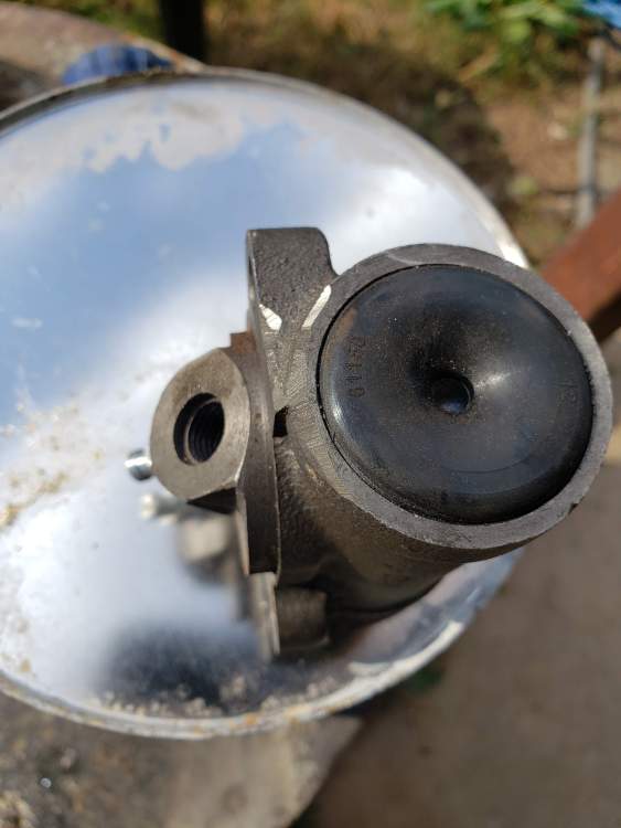

  Today was the day to finish the front brakes though it was tedious work that required me to study a good You Tube video quite a few times. The rear drums will need to be turned this week and their design is similar to the front  - they only add a "spreader bar" between the shoes.   This was using new shoes in ceramic friction material and I kept the original Timken tapered roller inner and outer wheel bearings.  As I previously mentioned, the original bearings felt heavier and smoother than the new bearings that I got from Ames.  New grease seals and new wheel cylinders and I used plenty of the heaviest possible high temperature grease.
  The passenger wheel cylinder required me to fire up my precision "Bridgeport milling machine" - aka my bench grinder.  This wheel cylinder needed some grinding to get it to fit squarely against the backing plate so that the bolts would line up.  New rubber flex hoses – braided steel is not available.  I tightened the lash out of the bearings and then backed off to smooth spinning with no binding and zero in/out play.  New cotter pins and axel caps.
  The driver's front was first and it took the longest, of course.  The passenger side with the slightly larger wheel cylinder slowed me down for about an hour for the small amounts of grinding but it still went faster than the driver's side.  I had to go slowly with the grinding to not nick the dust boot.
  I was worried that the drum metal lost to the brake lathe would have made adjusting the shoes outward enough impossible for best operation.  This was not a problem.  The new shoe friction material thickness solved that problem for me.

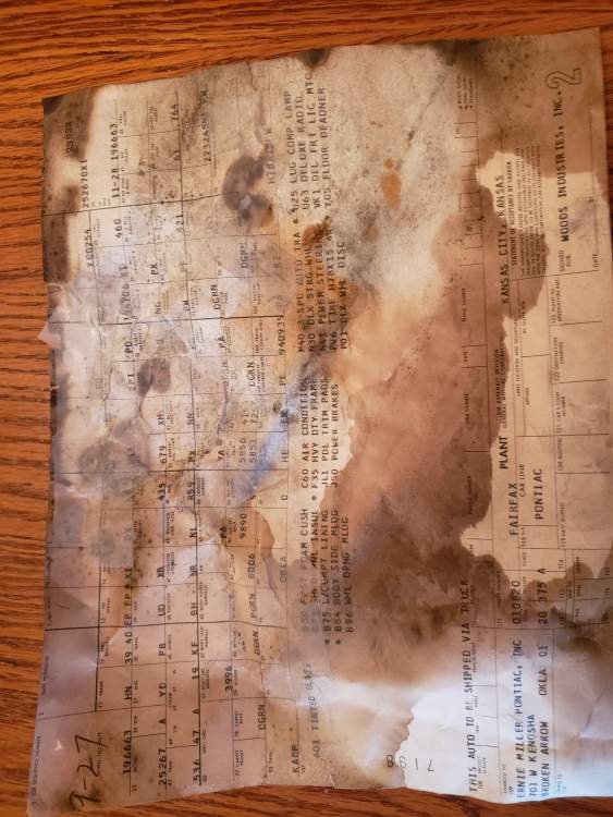

  I finally figured out how to remove the upper rear back seat a few hours ago. The reason I got motivated to remove this seat is that I'm looking for the relay that controls the convertible top motor - and I did not find it.  Maybe its behind the driver's left leg kick panel.  I never could get the upper seat cushion loose and I had read somewhere that the seat belt bolts had to be removed to remove this seat.  This is definitely not true.  So, a little stronger tugging in the upper direction got it popped loose and look below to see what turned up - two more build sheets. The sheet with the most discoloration and damage was in the seat cushion springs and got torn up a little in removing it.  The other sheet was laying flat behind a sound deadening separator board between the forward end of the trunk area and the back seat.
Rick
Congrats on finding the build sheet. There might be one more on top of the gas tank (if you haven’t pulled it yet). It could have also disintegrated over time with it being in the elements.
Next time you are at Selfridge, look us up! We live in the metro Detroit area. There is also the Pontiac Transportation Museum to check out too.
Yes, I found the gas tank build sheet when the original tank came down.  It was more of a papier mache mulch than actual paper and no letters were legible. Three usable build sheets have been found in this vehicle.

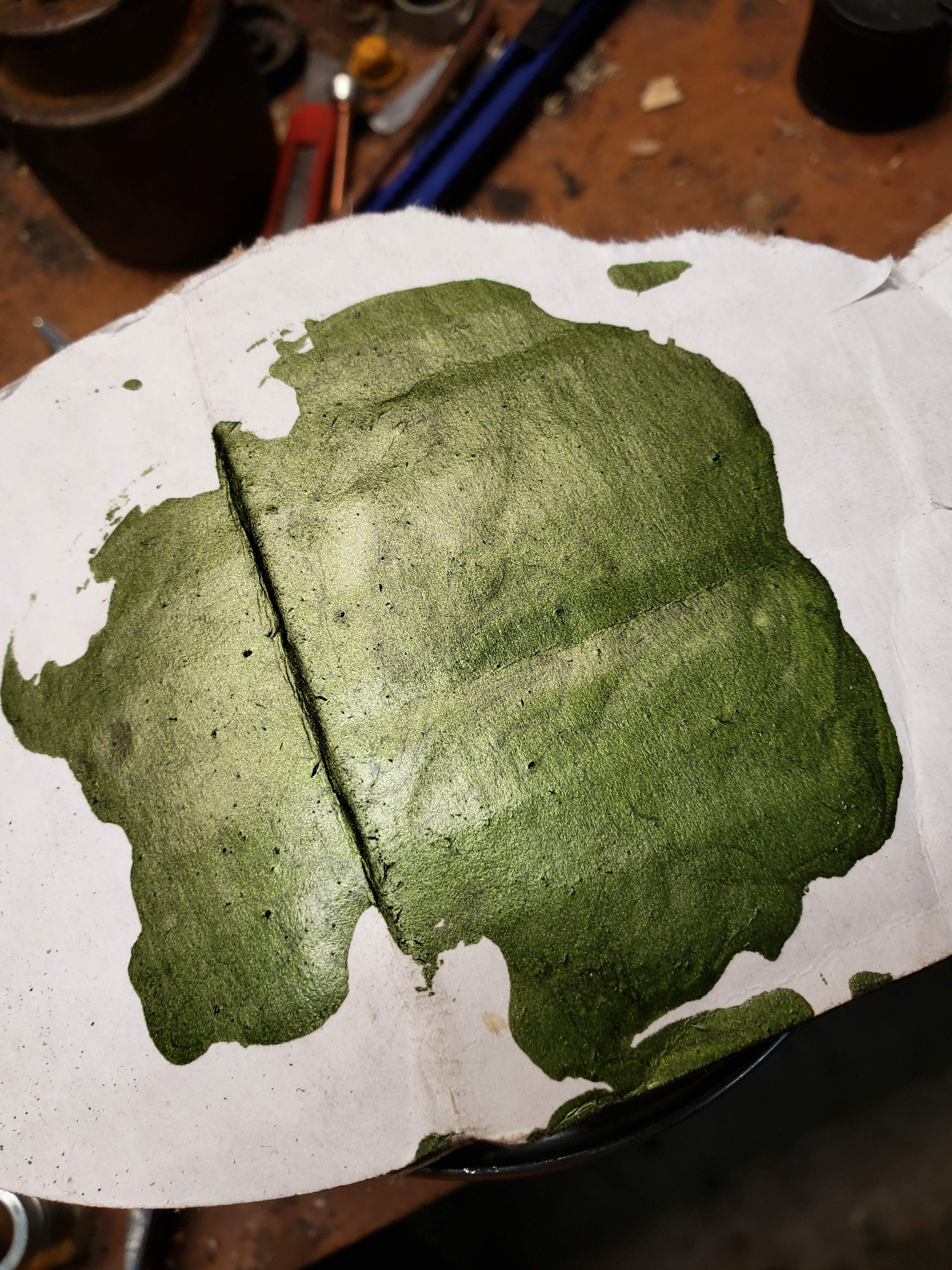

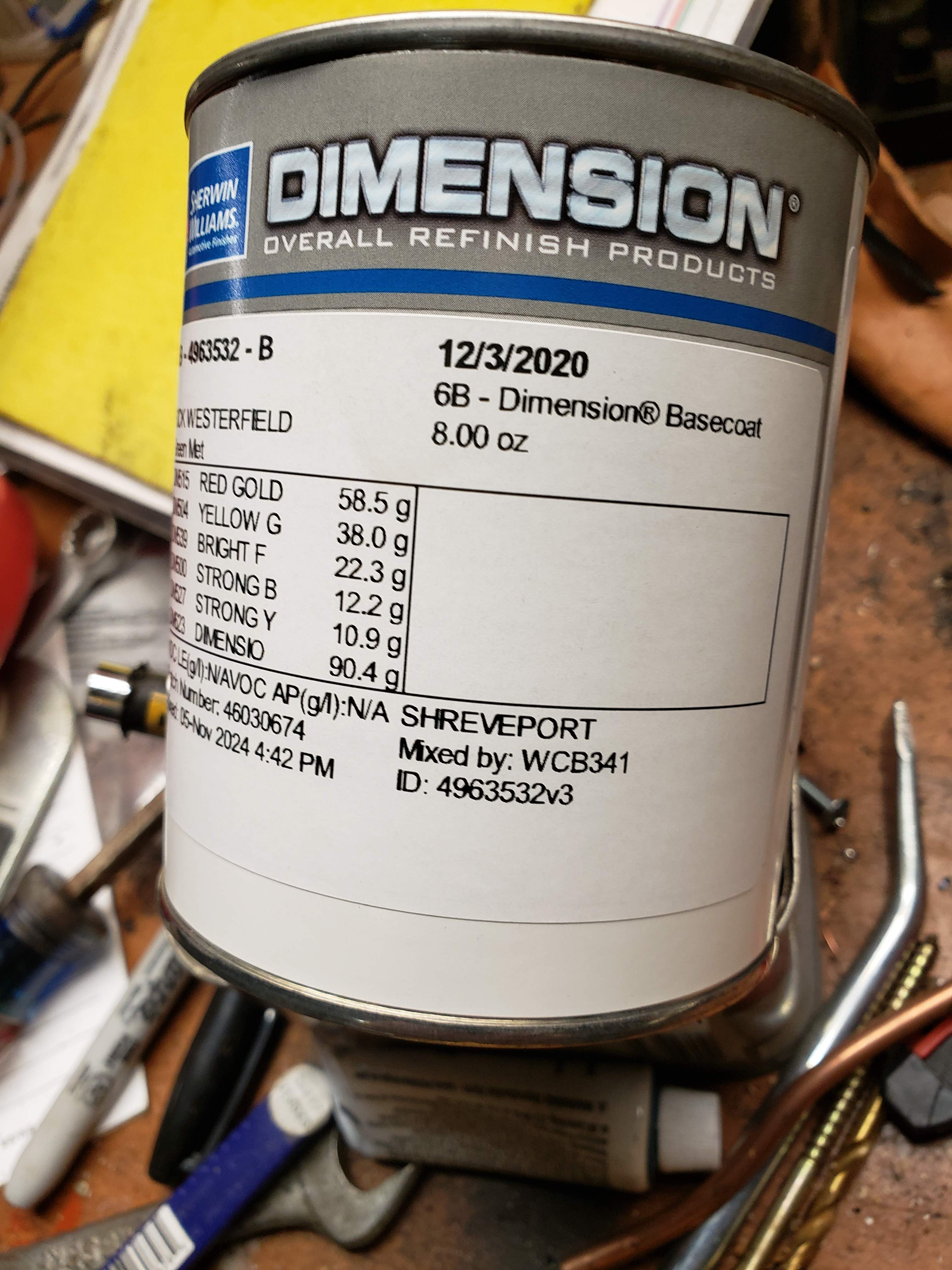

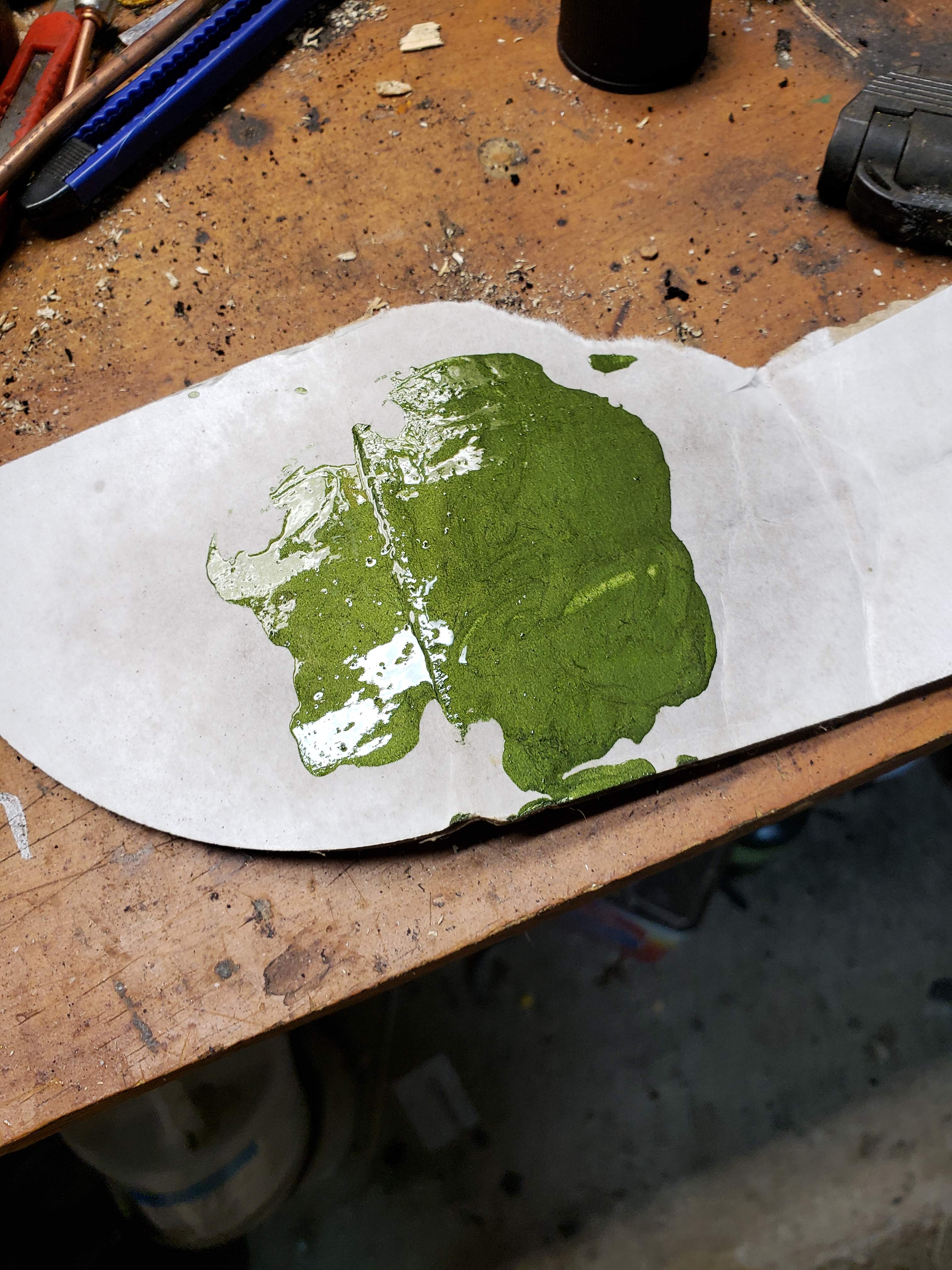

  Yesterday, I finally got around to using the build sheet and Fisher Body tag to find and study the Cat's Pontiac paint code - "47" or some say the later "73" is equivalent.  Also known as "Verdoro Green Poly" - also = PPG Ditzler 2095, GM manufacturing code WA3771 and Sherwin Williams “2612”.  I went to Sherwin Williams Automotive Paint today and had them mix me up a little.
  The paint on the carboard below lacks the thinner reducer and the liquid would lay flatter if it was reduced and on gray primered metal . My wife and I both like the color and it appears that the car might go in for paint a week from this Friday.   I wanted the small sample of paint to know, that I know and that I know that I want this as the repaint color.
If I had purchased enough of the paint, reducer, hardener and clear coat today to paint the whole car, I would have departed the store $1630.46 poorer.   And this was not their top of the line product variety.
One picture below is without the clear, the other with, of course.

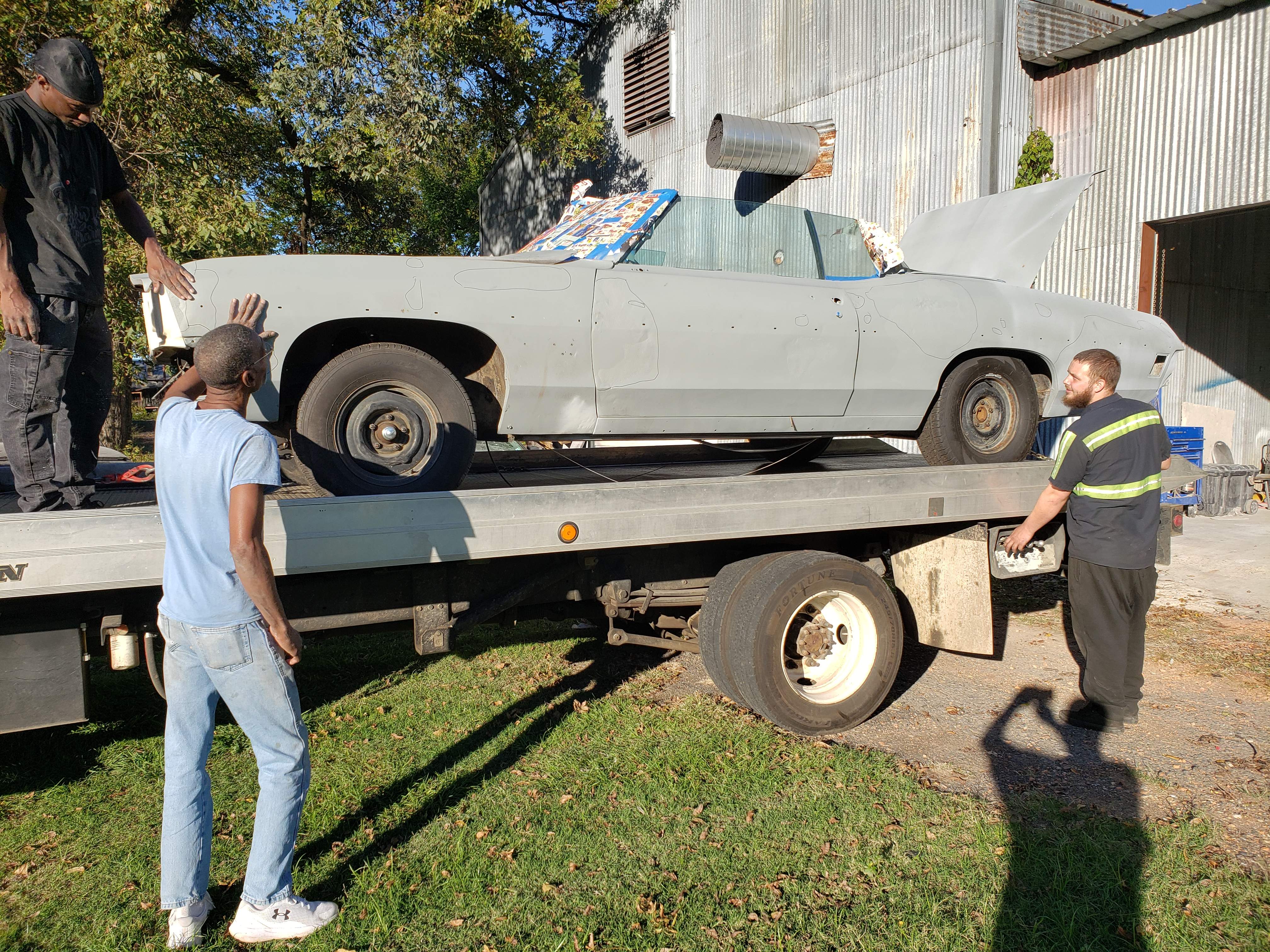

Hello,
  Well . . . its now in the hands of the painter.  For three months, at least.

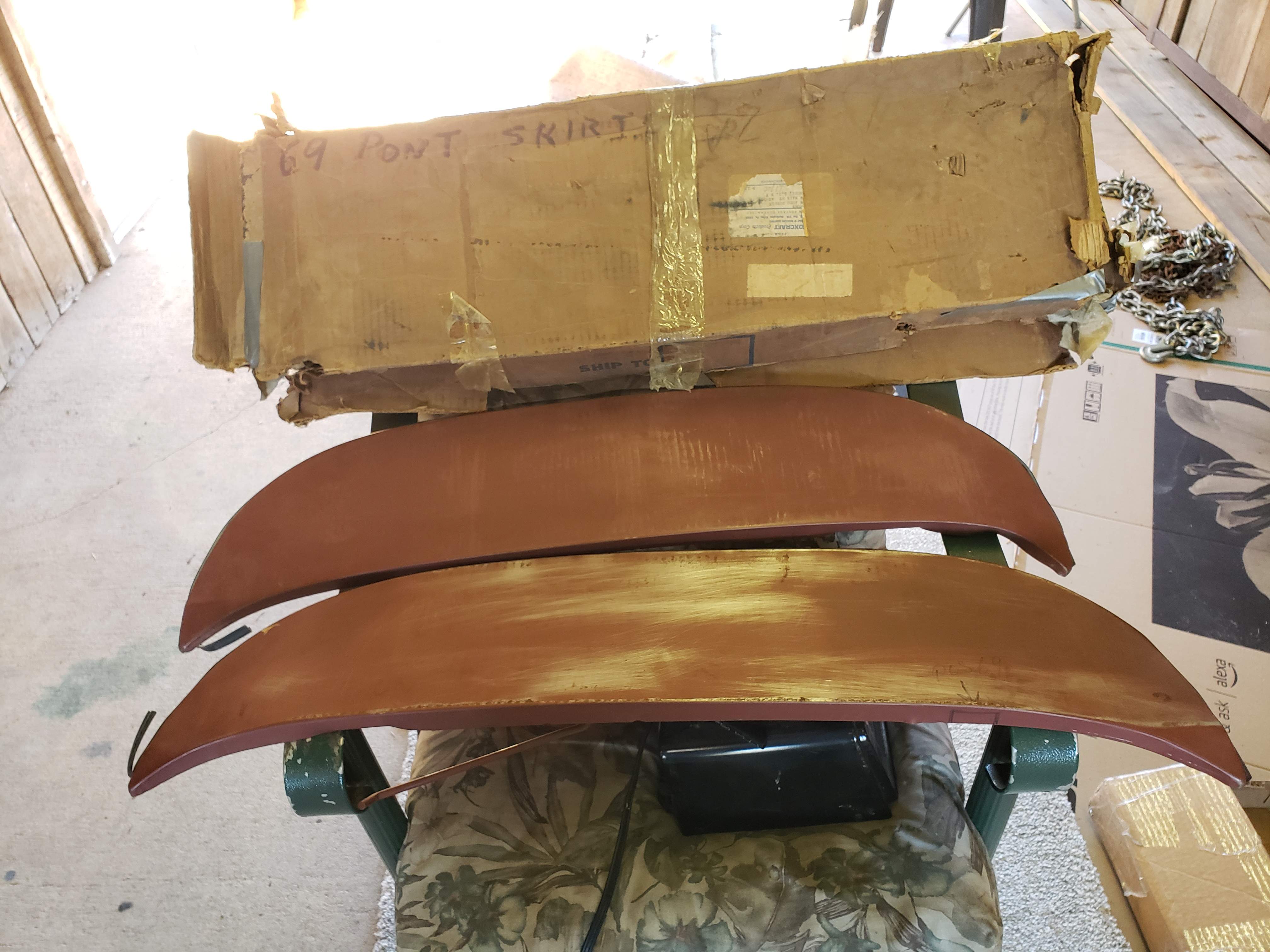

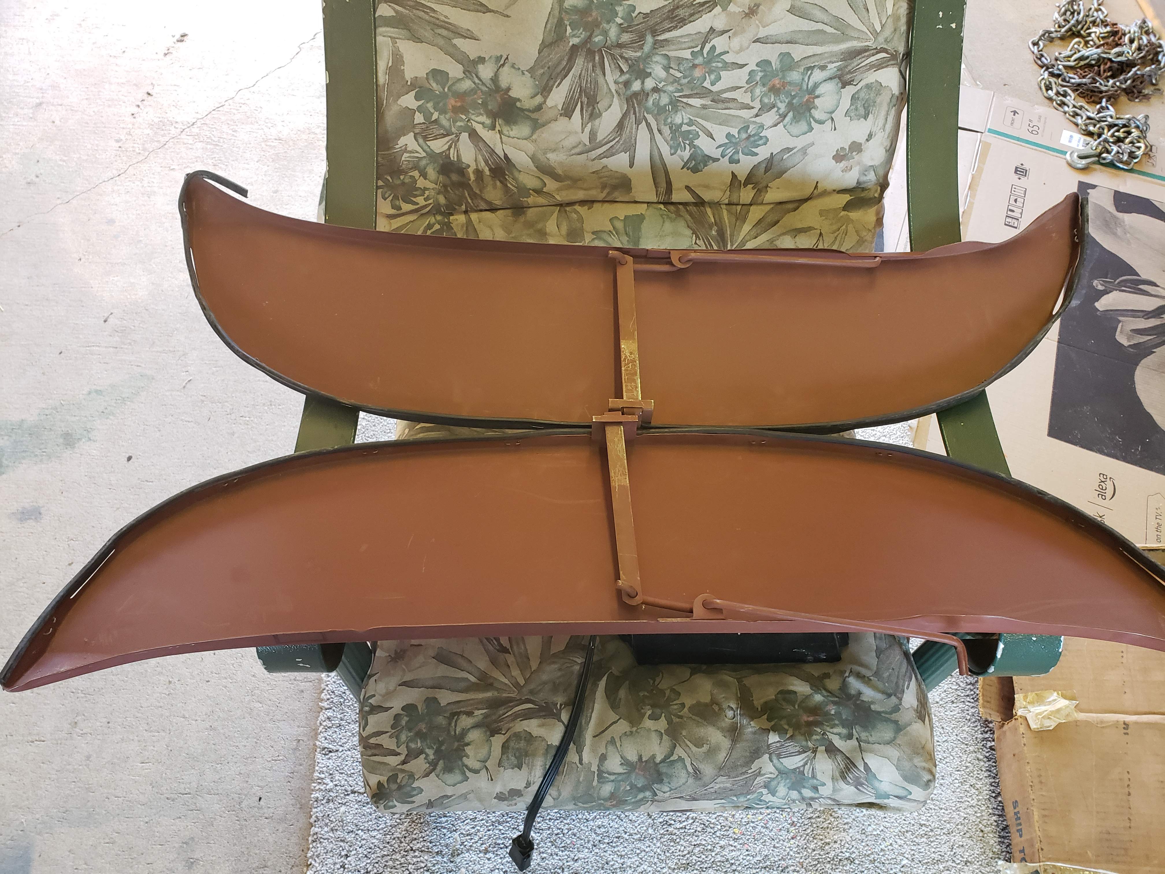

 I had been looking for a set of rear wheel skirts for a while and these NOS skirts showed up on Ebay a few weeks ago - arrived yesterday.  They were listed as for a 69 Catalina but they appear to also work for a 70.  I had no idea how the latching mechanism would work on these but its plain to see now that they are here.  These panels will go with me back to the paint place on Monday for a fit check to my Cat.
  Can anybody tell me if I wasted my money on this set of skirts?
