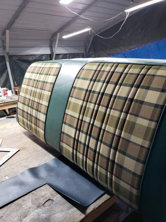

But the seats are under construction and I visited them today. Fingers crossed that I get them all back on Saturday.
Rick
Hello,

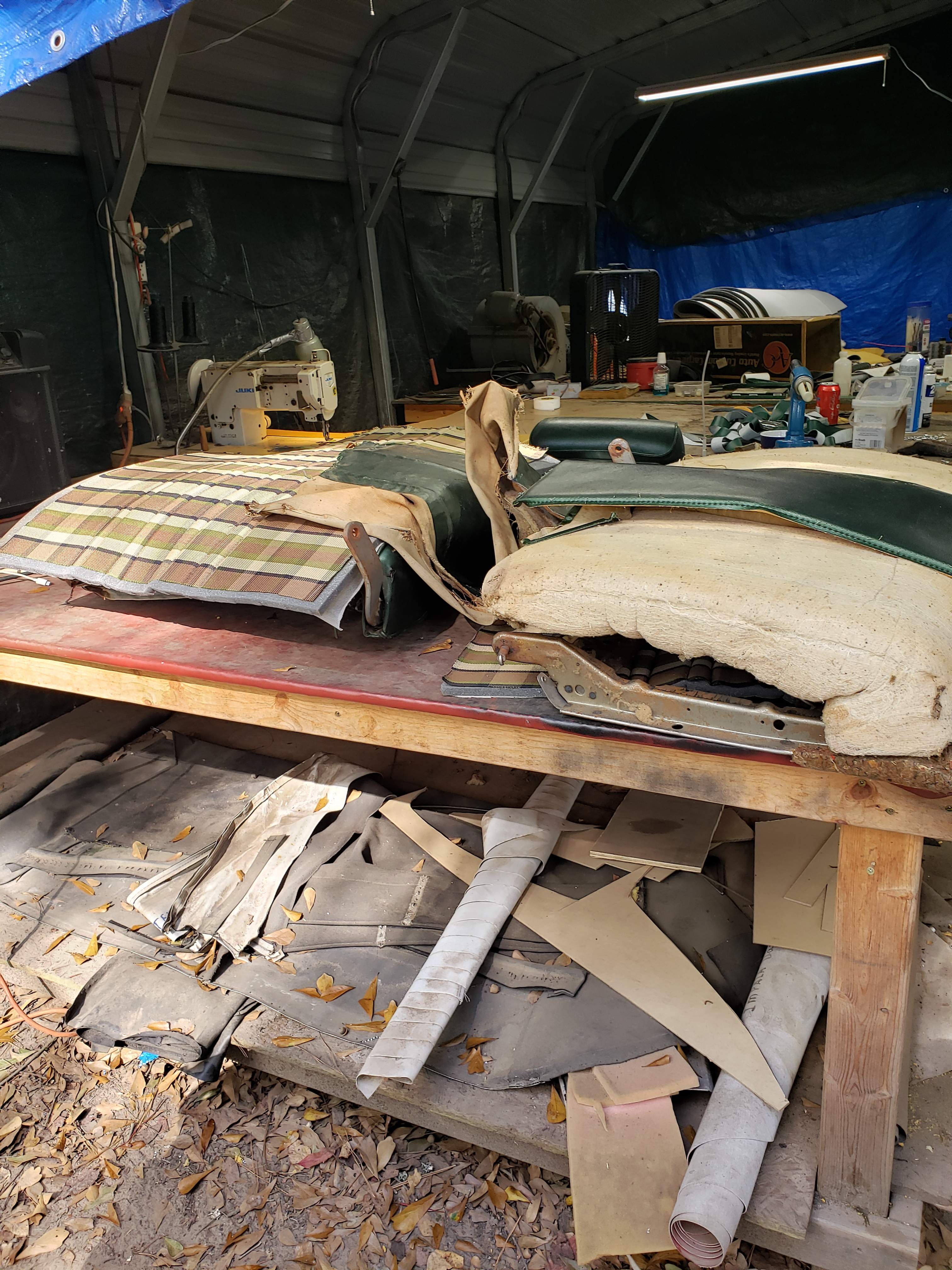

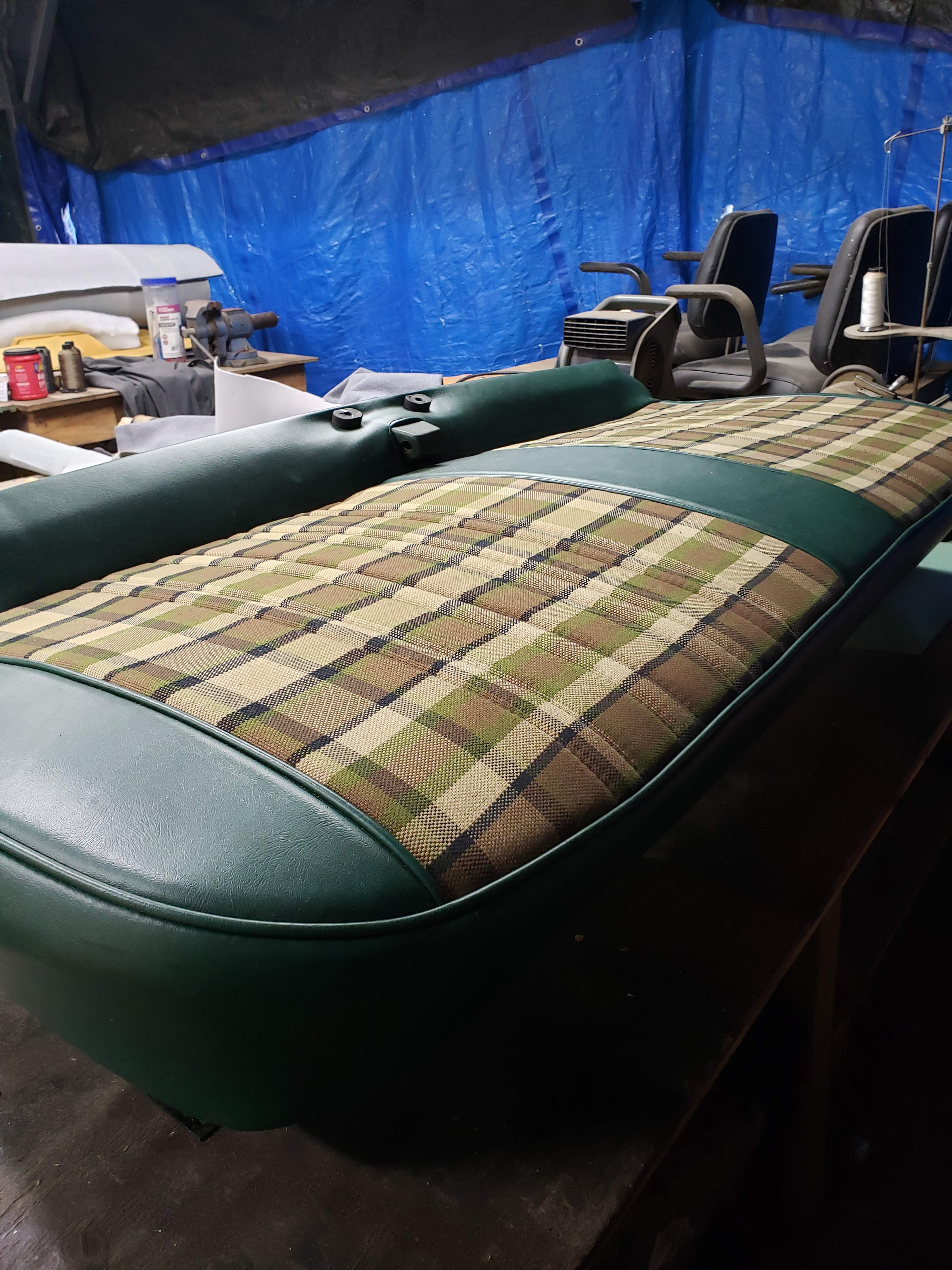

More seat pictures and I'm told that all will be ready by 4 PM tomorrow, Saturday. Cash money, only. No personal checks, no postal money orders, no aluminum cans or scrap iron for smelting.

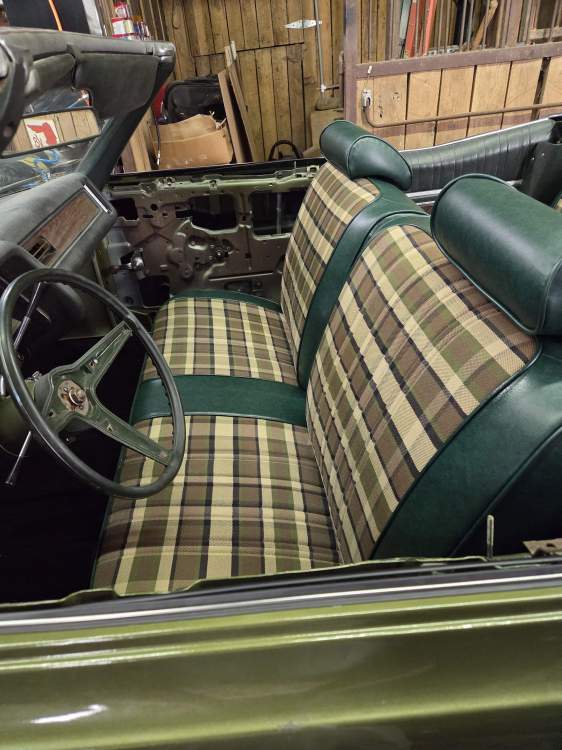

All of the seat pieces are home and look great. My wife says it must be a black carpet on the floor because more green would be too much. Black, it shall be.

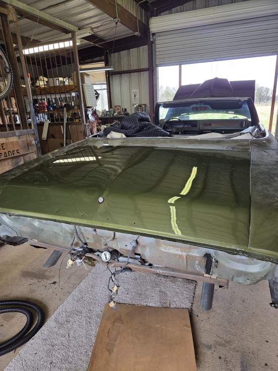

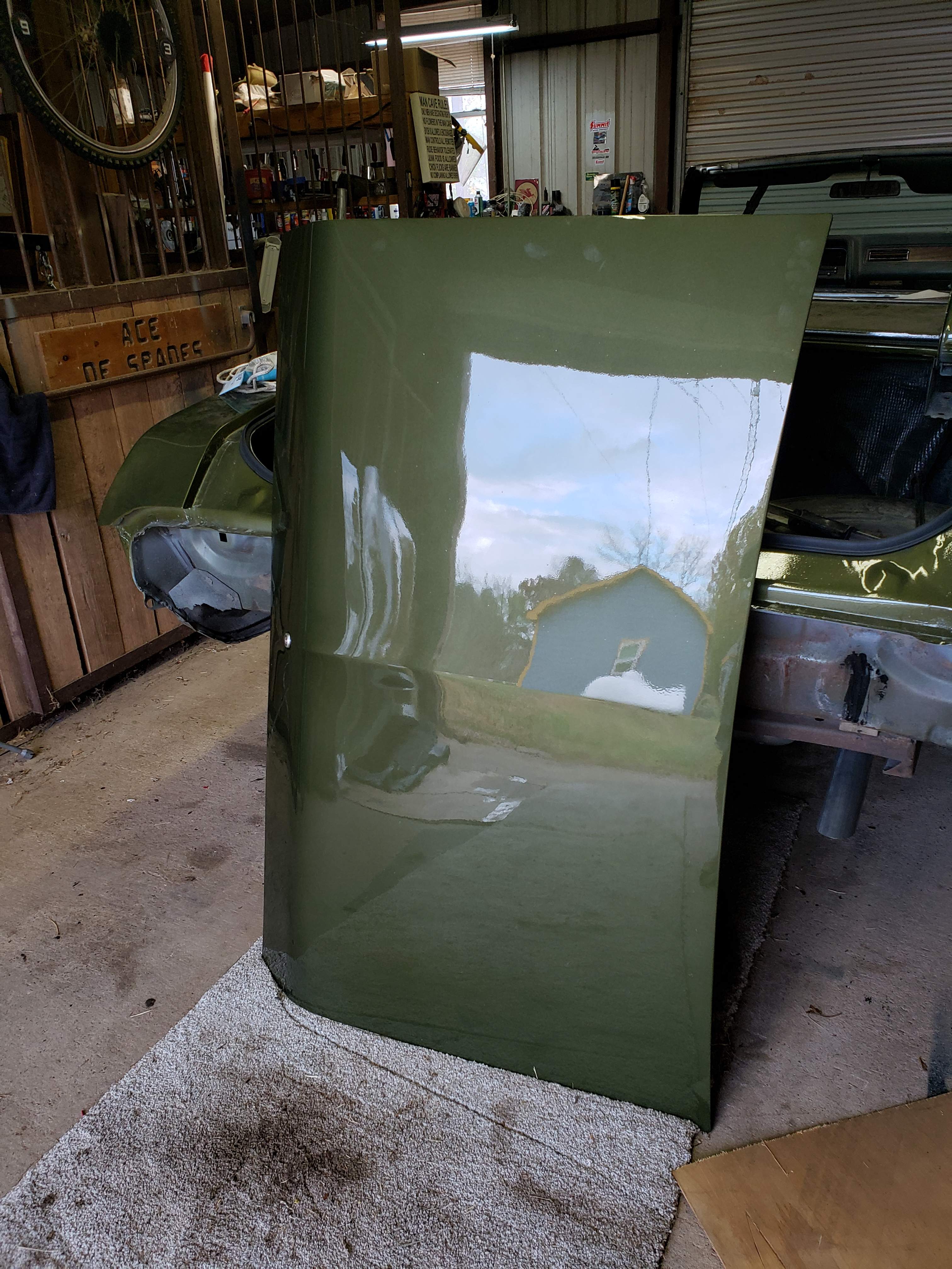

And my trunk lid and hood came home today. Looking good. It was too dark to take pictures but I will try to get a few maybe tomorrow or this weekend. Once again, the car is complete.
Rick
Hello,

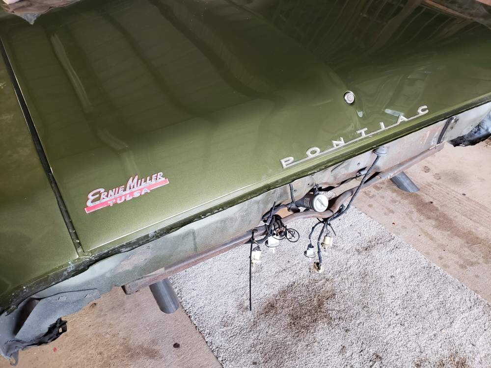

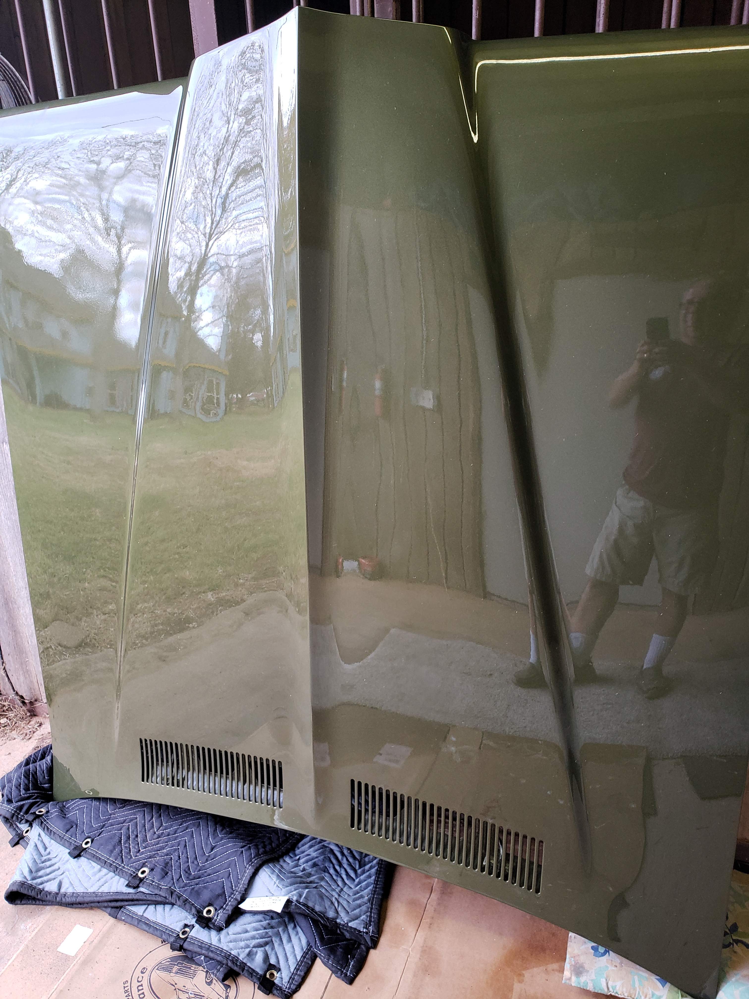

Hopefully, this is the last time you see these two large hunks of sheet metal off of this car. They look quite good, especially the hood. It had quite a lot of Oklahoma hail storm small dings . . . all gone now.

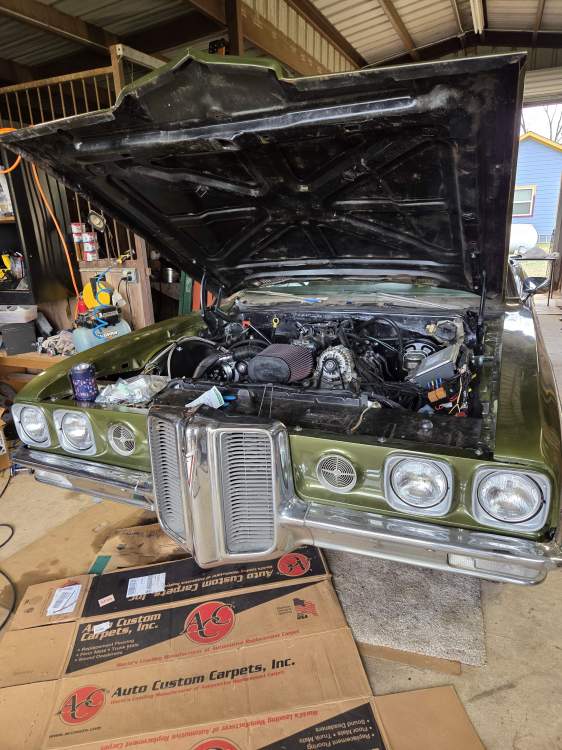

Hello,
I have been busy doing stuff but one big thing held me up for quite a while.
  For the longest time, I have had a persistent transmission fluid leak that I thought was coming from the vent tube on the top of the 4L60E transmission case.  Wrong.  There was a big crack in the 4L60E tail cone cover at the far back end of the transmission over the output shaft.  I initially thought the rebuilder might have over tightened the six bolts that hold the tail cone on but now I think the crossmember was giving just a little too much lift at the rear of the transmission – this piece is a casting, not a forging. My driveline angles to the differential are still acceptable but I have had to let the crossmember relax a little and allow for less upward strain on the cone.  The tail shaft cone is not expensive at $40.00 USD for a used part but add another $40.00 for a new bushing and seal at the back end and a new gasket up front. It is re-installed and the crossmember is back in.  And the leak has stopped.

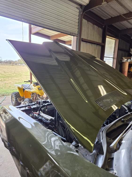

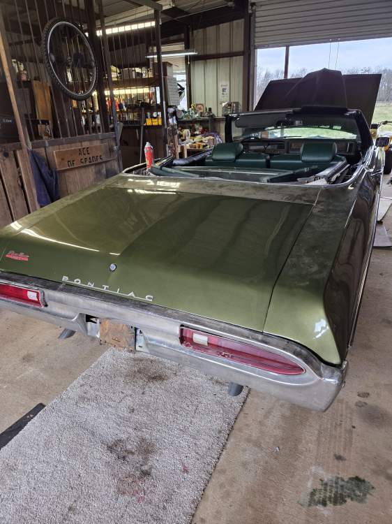

The hood and trunk lid are both re-installed.  Some of the people that we had over for Thanksgiving dinner helped me put them back on and get bolted in.  I guess you could say some of them had to work a little for their food.  The highlight of that day was when a five-year-old boy from this group got to operate the convertible top.  It was a real life “Transformer car” for him and he got to make it happen.

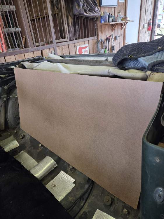

I started cutting a big piece of Masonite to fit today as a replacement for the original “separator board” that was behind the upper portion of the back seat and in front of the convertible top well.  The original Masonite board was in pieces and continued to fall apart as I removed it.  I found my best-looking Pontiac production build sheet behind this original board and I think the board is supposed to provide some sound deadening for the convertible top hydraulic motor and pump.  The piece in the picture still needs some trimming for best fit.

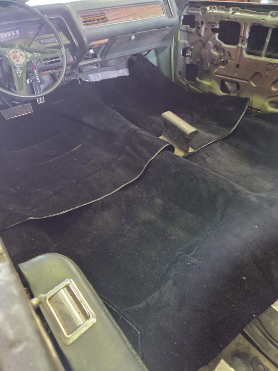

  And the carpet is out of the box and has been laid onto the floor pan – this is the “Essex” style of fuzzy carpet and not the original loop pile.  It’s a two-piece kit ordered from Ames Performance and at least initially, it looks good.  Today is its first day out of the box and it is going to need time and possibly a little heat to get it to relax – I may yet bring the front section into the house for that heat.  The drivers footwell pad is already laying in the correct spot and they provided a grommet to go over the high beam foot switch once I get it all settled into place. There is plenty of overlap between the front and back halves and plenty of extra material at the edges. Eventually and once it is in place, I will need to use a flaming red hot screwdriver poked upward through the front seat mounting bolt holes to melt a place for the seat bolts to pass through.

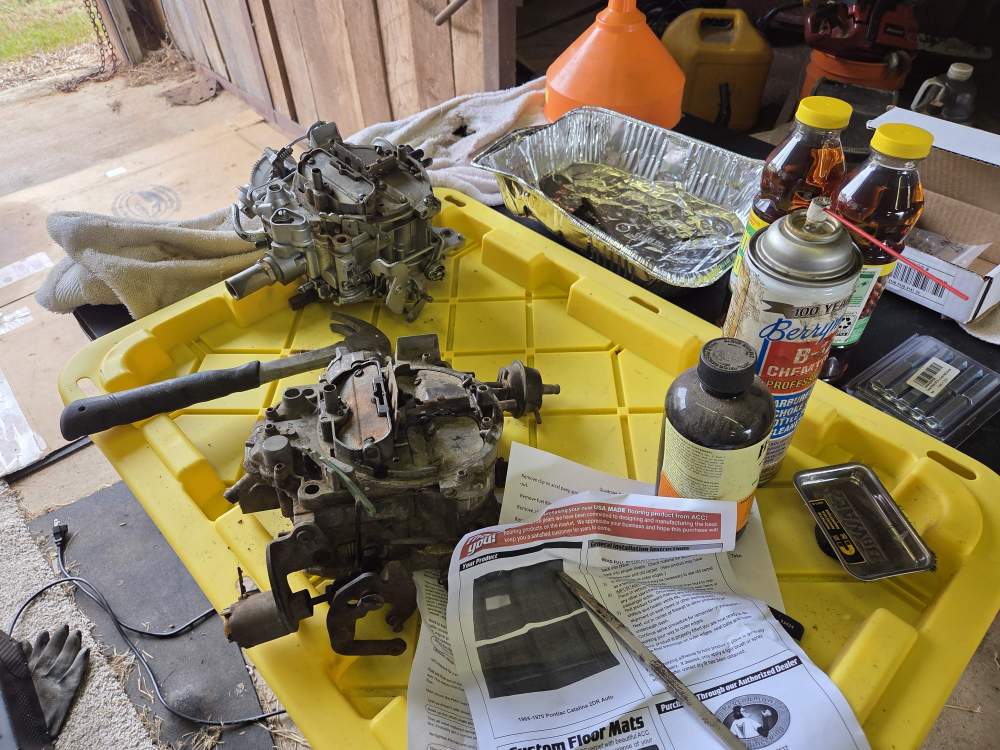

And finally, just in case that Chinese AVS2 carburetor needs to be replaced, I am about to start the rebuild on at least one old Rochester Quadrajet carburetor.  One of these carbs came with this truck and its stamped model number corresponds to a 1979 Chevy C-10 truck which was the donor of the chassis that is under this 1959 vehicle.  The other Quadrajet was a recent find from a 1982 Buick of some kind that I got for cheap ($37.00 USD) from a local yard.   Both of these carbs have likely been rebuilt before by somebody and neither of these suffer from the dreaded Rochester worn out primary throttle shaft bores that cause large vacuum leaks. My guess is that new shaft bushings have already been installed to prevent these leaks.  The rebuild kits are slightly different with each of these and not expensive at maybe $35.00 each.  But both will at least need new vacuum break assemblies because both leak internally – and these will likely cost more than the rebuild kits.
Those bottles on the back corner of the carb rebuild table are a cleaning product called "Pine Sol". At least one carb will get boiled in a 50-50 mix of Pine Sol and water for a thorough cleaning.

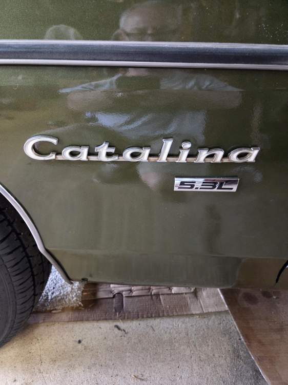

It is much quieter with an exhaust system and Flowmaster mufflers - also sounds great. It shifts well and accelerates nicely. The brakes are firm with a good pedal feel and stop well with no pull to either side.

Tomorrow, I tackle the rear section of carpet with a razor knife, some steam heat and carpet glue.

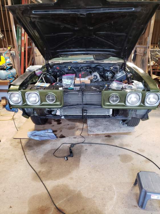

I have at least temporarily given this Catalina back its eyesight - the headlights, the front fascia and the bezels have been remounted. One of these bezels was missing when I got the car last year and I found it on an Arizona junk yard parts car. All of these bezels were quite pitted and with dull chrome plating but all got media blasted down to bare metal. Then the pits were filled with glazing putty, sanded smooth and leveled to the surrounding contours. Then on went a coating of Revell Chrome spray paint to put a silver appearance back onto each bezel with a top off of some "2K Spray Max Glamour" catalyzed clear coat for a little surface toughness. I mounted all of this to check the fit and make sure that I have all of the screws and bolts from the Zip Lok baggies. It is beginning to look like a car again.

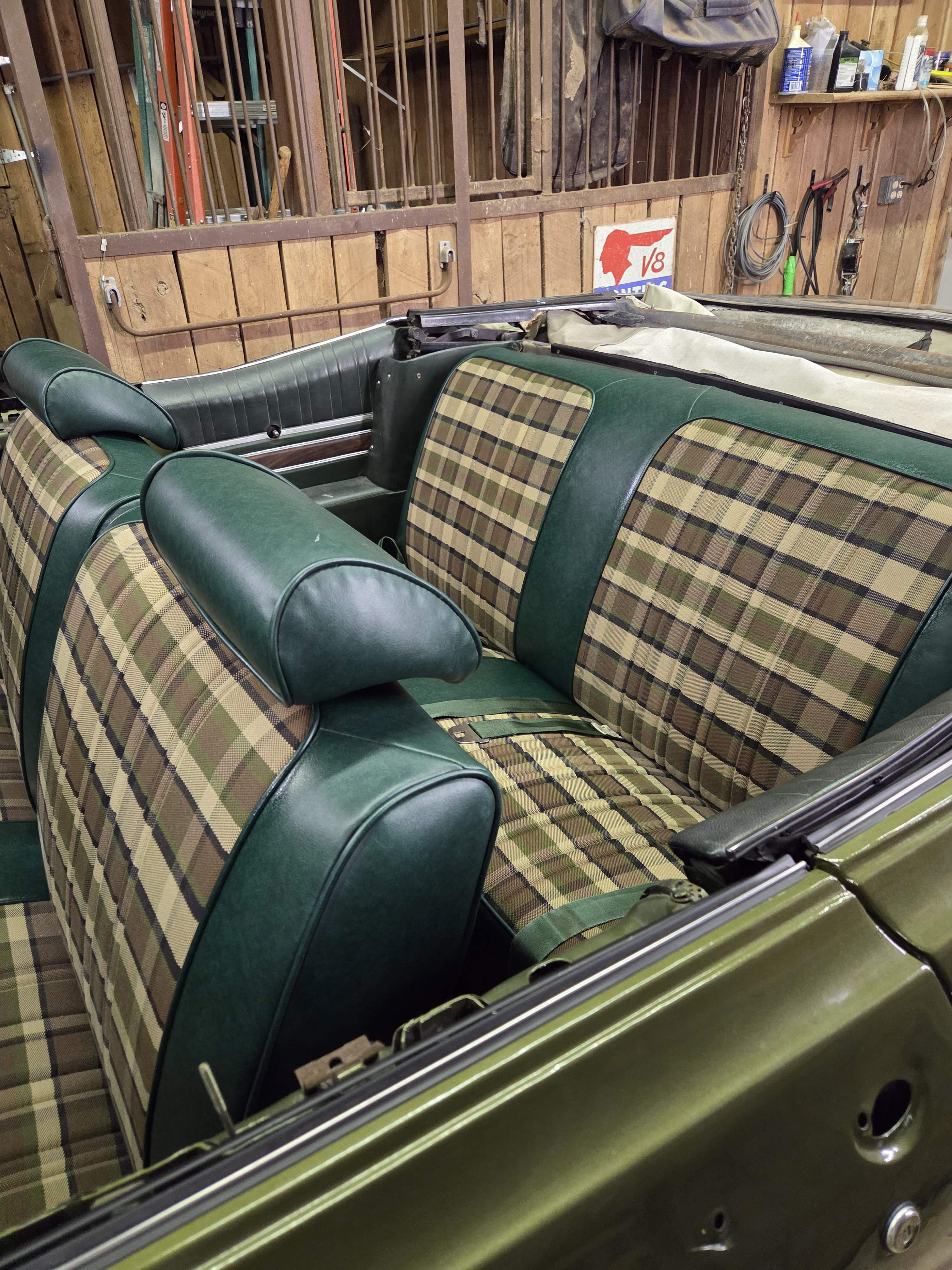

Major progress on the carpet and seats. All in, glued down and bolted down and I like this plaid pattern better than the all green color that was original - the plaid provides some contrast. It is quite a relief to have a real seat during test drives and my wife took her first trip with me around the neighborhood late this afternoon.

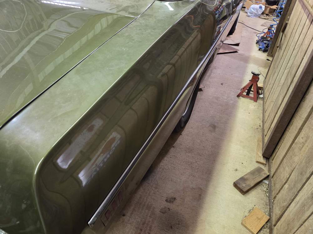

I have also managed to get the rear quarter panel trim "spear-shaped" pieces on earlier this week and I am working the corresponding door trim. Then the same for the front quarter panels. All four of the stainless wheel well pieces of trim got installed after some cleanup of a little road tar.

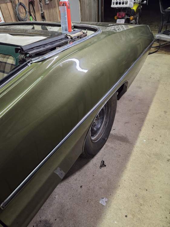

As of about an hour ago, I declared that the major and heavy reconstruction that I am going to do on this car is now complete. The front and rear bumpers are on and bolted - a whole lotta' work. The front and rear door panels are installed and I'm waiting on new interior door handles and window cranks to arrive in a shipment that appears to be stuck on a loading dock in California. I will put the armrests on when the new handles get here.
The waist high spear trim is installed all around the car. And as I write this, I realize that the rocker trim needs to go on but it is located at a different spot in the shop and I forgot about it until now.

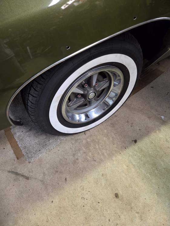

All four of the Coker narrow whitewall tires are on and every wheel has a center cap. There is a spare tire and the original jack with its lug wrench is in the trunk. But that original jack is a widow maker that I will never use - some other jack will be in the trunk for actual use. Both of the exterior door handles and new mirrors have been installed.
