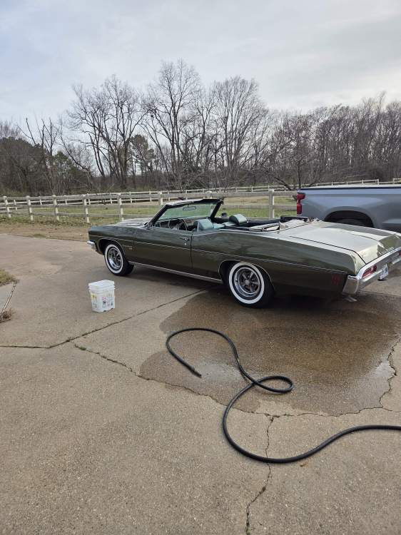

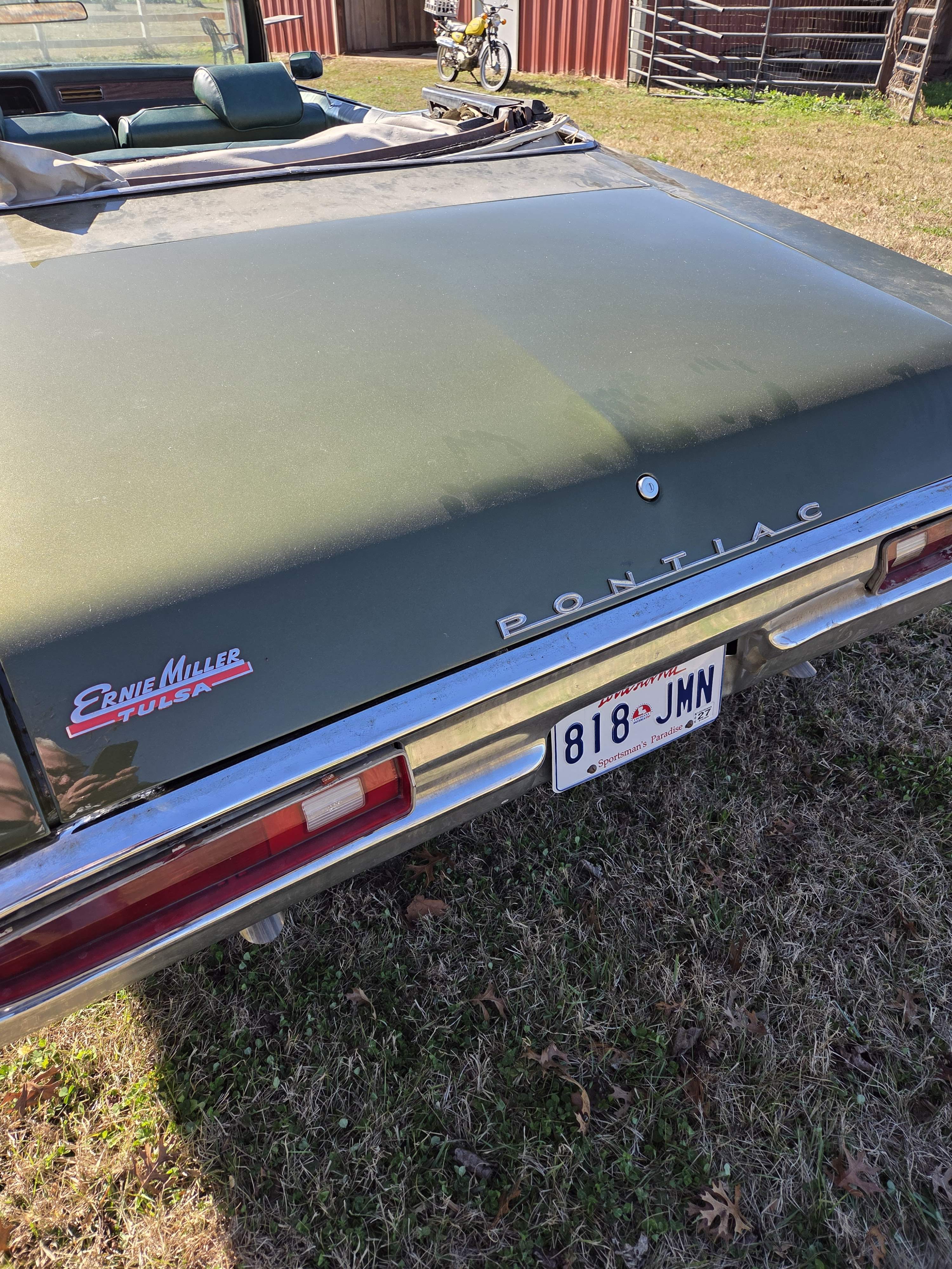

Hello Again,
Today was bath day for the car. Its first since at least 1993. With no radiator, a quick move of maybe 45 seconds is about as far as I can go.
Rick

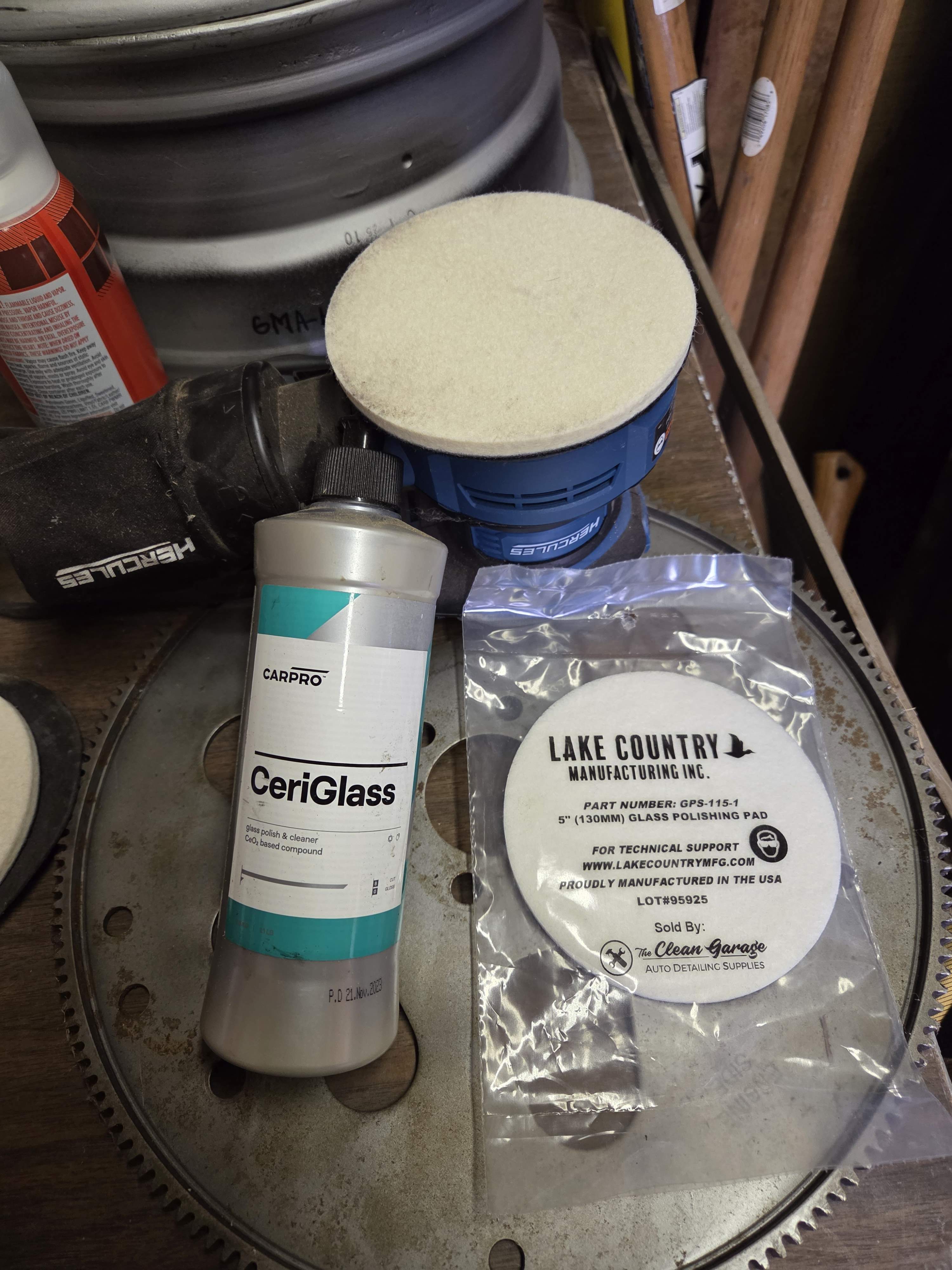

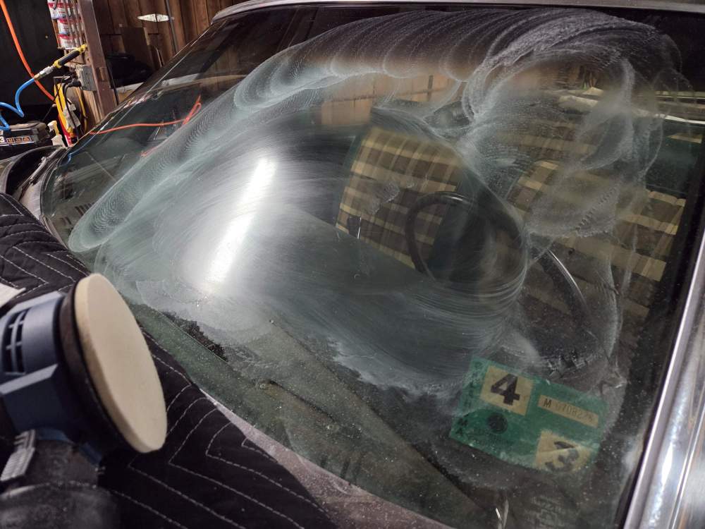

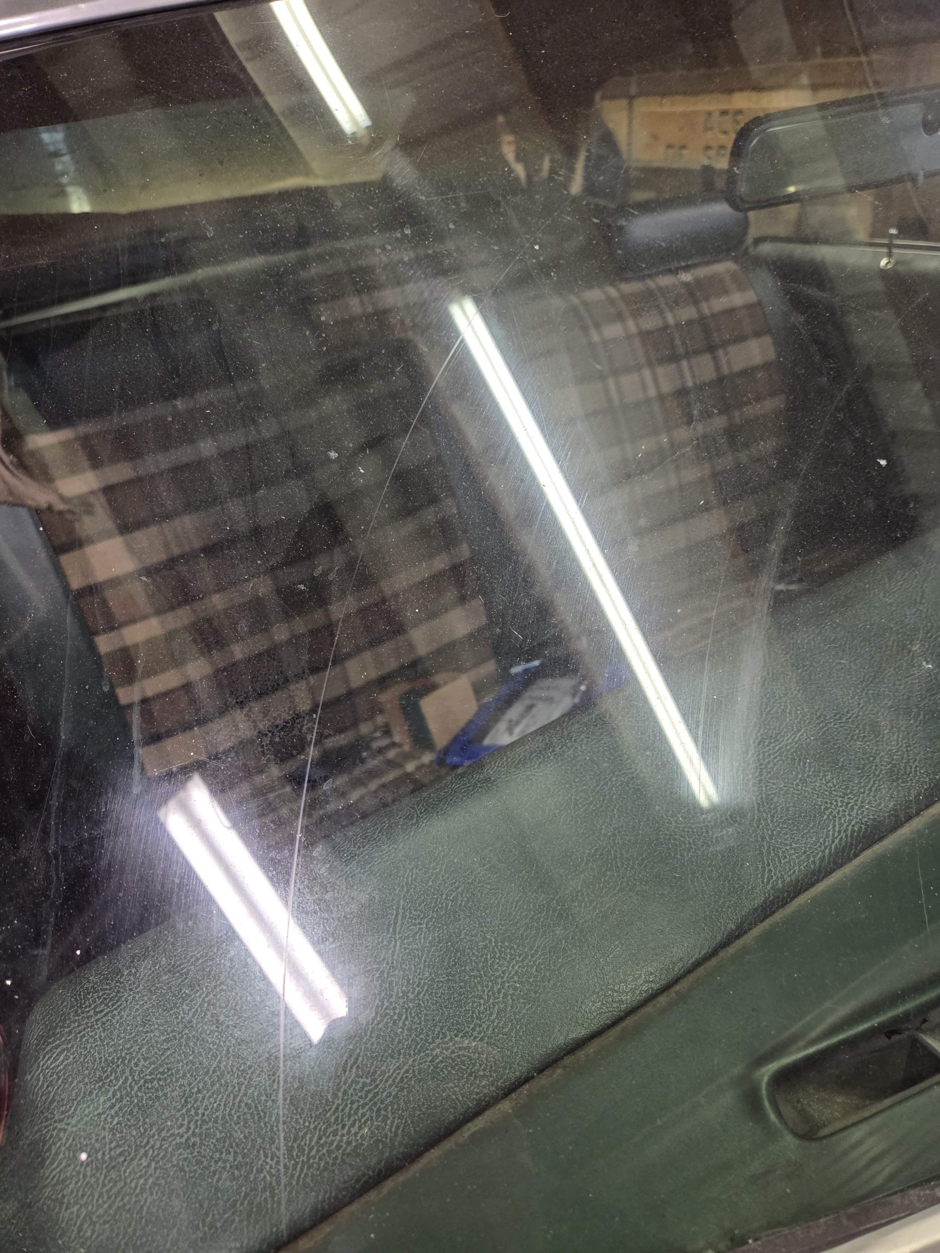

Now I can turn my attention to the glass, especially the front windshield. It has some rather nasty windshield wiper rash in the glass and a lot of paint overspray from where this car was stored since 1993 until last year. The now deceased previous owner was a house and commercial painting contractor and some overspray is still on the various pieces of glass in the car. This car was stored in the same building that he operated his painting business out of.
I have watched a few You Tube videos and I have acquired the tools and the concoction to begin polishing out these scratches. I already had a good hook & pile pad double-action sander and I have now bought some hooked rayon pads and some cerium oxide glass polishing compound.
Heat is the enemy of modern automotive safety glass and I shall avoid keeping my D-A polishing pad too long in one place - to prevent distortion in the glass. Patience will be a virtue here and these kinds of scratches will take time to remove but at least my fingernail does not catch anywhere on the glass. My prediction is that I will need to buy more rayon pads and more of the cerium stuff before this is finished. I don't really have a choice because finding a replacement windshield in new glass does not appear to be possible.

Then I attacked the wiper rash on the windshield with the cerium oxide and a D-A sander. But first, the collective You Tube wisdom recommended that a clay bar be used on the glass to deeply clean it of debris so that the D-A could not make things worse. And wow, I had never used a clay bar for anything and it really removed a lot of things that I could not see. I also used it on the inside of the glass and I can already see through the glass a lot better.
I was warned about heating up the glass too much with the D-A but that did not happen. I felt no warmth in the glass at all after two sessions of five minutes each mostly on the wiper rash area. The D-A was pressed as hard into the glass as I could manage and the videos mentioned that the force used on glass would be much higher than anybody would use if they were buffing out a clear coat painted surface on a car.
The videos also mentioned that a wiper rash could take an hour or more to polish out and even then it could still be slightly visible. I will attack this side of the glass a little at a time and I will eventually get these scratches out.

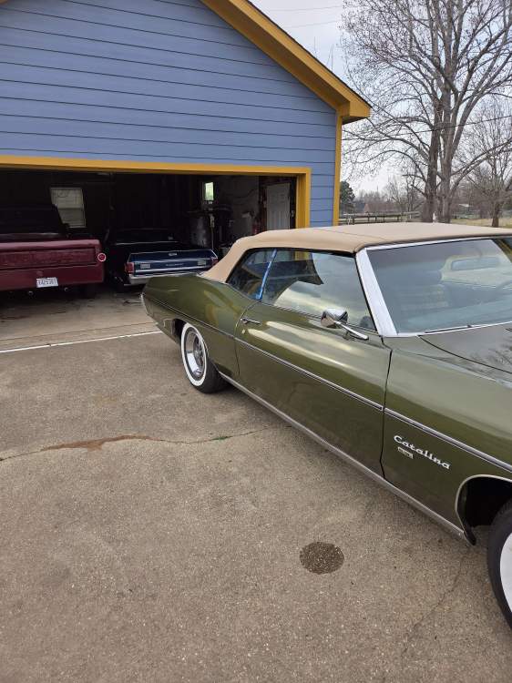

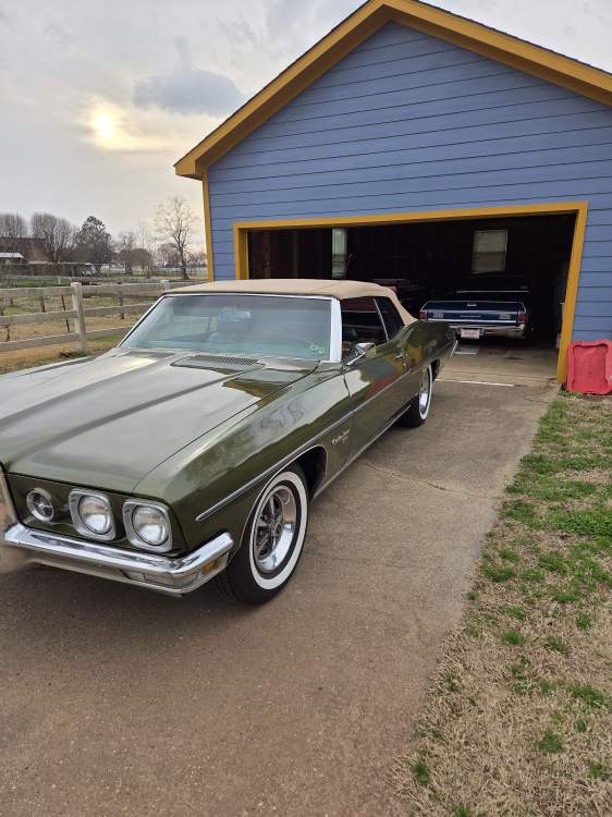

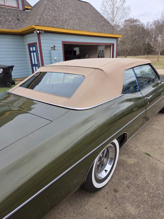

Today is the big day. The Catalina goes in for the installation of its convertible top - the kit from North Carolina finally arrived. This is supposed to be a three day job but I'm predicting a Monday or possibly Tuesday finish.
Short test drives have continued with the car and it has accumulated maybe twenty miles or so from eight or nine trips. I checked the front wheel bearings last Sunday and they were a little loose but not anymore. As I mentioned before, I do short test drives to detect problems because I don't want to walk, push a vehicle, or get towed home. This philosophy of laziness will dictate that this car will leave here on a flat bed tow truck today to get its top installed. However, because there won't be a time crunch after the top is installed, I might, maybe, possibly drive it home whenever that job is complete - probably a fifteen mile trip. These trips will get much longer very soon.
I am dealing with a small coolant leak at the LS engine steam vent line that will need a dab of pipe thread sealant. The horns don't yet work because of a loss of ground inside the guts of the steering wheel hub - very fixable. My new replacement neutral safety switch from about a year ago is now wonky and the engine won't start in Park but will in Neutral - also very fixable.
I am also waiting on reactivating the speedometer and odometer. I need to buy a digital to mechanical speedometer cable conversion module from the Dakota Digital company - their ECD-200BT-1 module. I would have done so already but I have been struggling with how to route the original mechanical cable to the new electronic conversion module location in the engine compartment. If I knew then what I know now, I would have modified the hole in the firewall where the speedo cable passes through BEFORE installing the engine. As it routes today, there is a bendy kink at the firewall that I need to solve. I can still open up the hole to eliminate the kink but this will need to be done from the passenger side of the firewall and the front seat bench will need to come out to give me work room. Quite frankly, I enjoy driving the car too much to yank out the front seat.
And the OBD2, Bank 1 Knock Sensor Low Input problem that I mentioned above has not returned. I did nothing at all to solve this problem and it is not even a PCM OBD2 stored, future or pending Check Engine Light problem. It is as if the problem never happened.

Hello,
The Cat made it home from the top shop today with no trouble along the thirteen mile route. Purred like a kitten the whole way and no need for a tow truck. This was its longest trip so far and was quite a confidence builder that it had no trouble. It has a grand total now of about 35 miles on it since 1993.
I really wanted to put the top down for this drive because it was a warm day and . . . just because. But the installer said it needs to stay up for at least four days because the material is tight and needs to stretch a little.
Now onward to the next little project with this car. De-rattling and continuing to check for leaks, etc. The next big project is to get air conditioning and heat going before my preferred shop gets too swamped with work for the car show season.
I will certainly need the AC for the trip to the end of the Hot Rod Power Tour this summer. The last stop is Tulsa, Oklahoma which is where this car was originally sold back in 1970 and that dealership is still there but in a different address. They want to see this car and its build sheet. The widow lady that I bought this car from is also about 25 miles west of Tulsa and she would like to see it in its resto-modded glory. My wife is also making the trip with me and we will spend three days there with Tour activities, the dealership, and some Route 66 cruising.
Rick

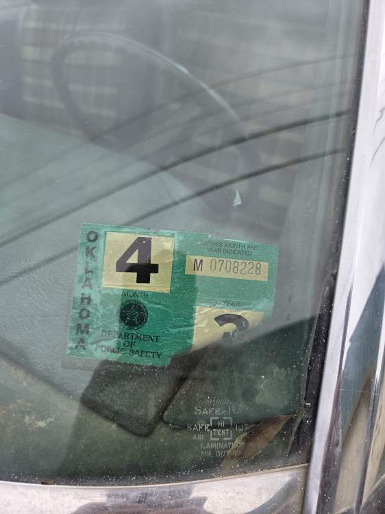

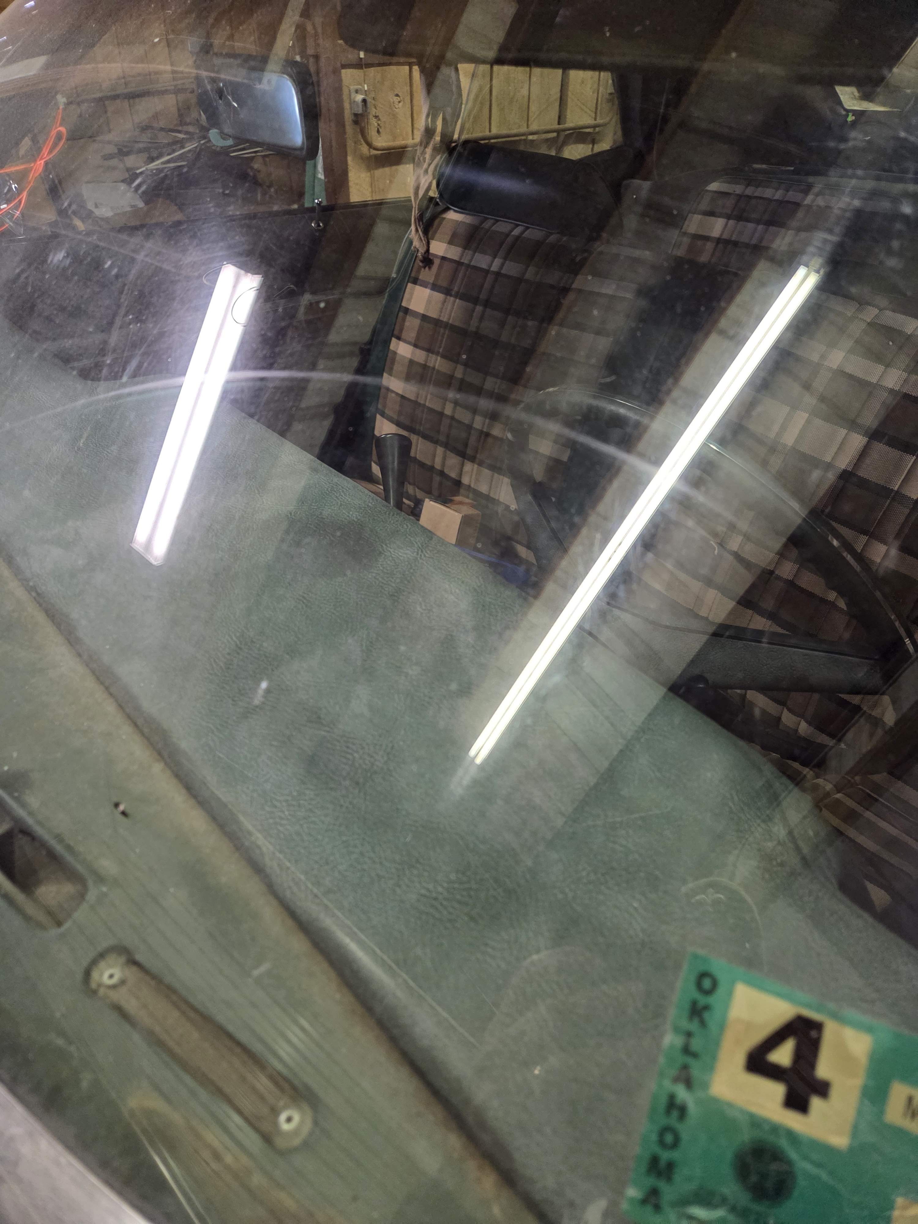

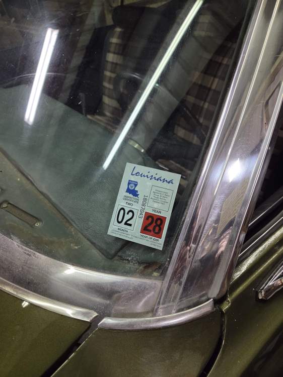

Today was inspection day for the Catalina and I'm good to go for two years - kind of a joke, this inspection. However, this fifty six year old vehicle is in far better mechanical, electrical and emissions control condition than many around here and the car drew a small crowd of three people today at the inspection station.
This was its first official state inspection since April of 1993 up in Oklahoma. After today's round trip, it has accumulated about forty five miles since bringing it back from the dead.
Tomorrow, the REAL inspection happens - again. The car goes back up on jacks for a look at the all new steering components, brake lines, wheel bearings, tire pressure, fuel lines, drive shaft bolts and transmission fluid cooler lines. I'm really feeling the need for a new set of shocks at all four corners but that won't be this weekend.

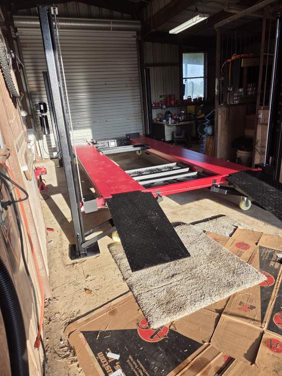

Things just got easier in my workshop after this weekend's World of Wheels Car show here in Shreveport. That is a new DMS Equipment FP-8K four post car lift (8000 pound capacity) with a bridge jack up front.
The very good price offered to attendees at the car show and a few You Tube videos regarding this lift convinced me that I no longer need to squirm around on a hard garage floor ever again. This lift is movable if the landing gear legs are attached, down and locked.

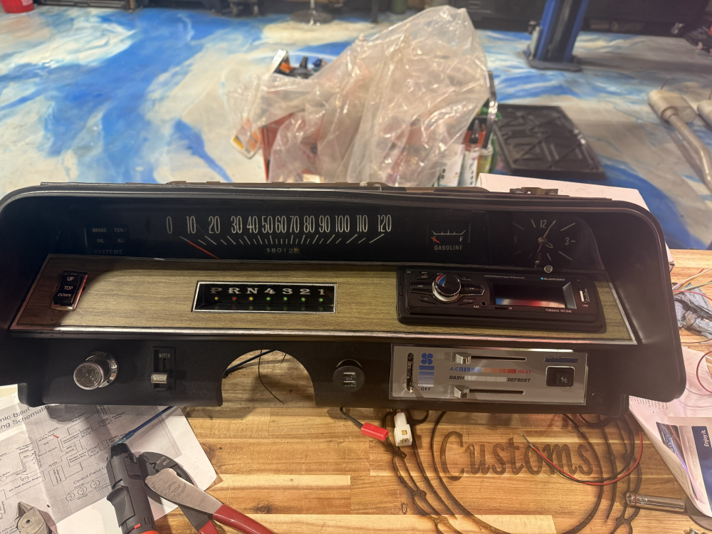

The Cat is still getting things done and they might finish up the heat / AC / ventilation tomorrow. The dashboard with a new radio and the controls for heat and AC have also been a central focus.
The frontal picture of the dashboard has a good view of the new 4L60E transmission PRN4321 shift indicator done in LED lights. The old indicator just wasn't gonna' cut it for me and Dakota Digital helped out here.
The new dash also has an original Pontiac analog clock that it did not have before . . . but . . . it is not accurate. It gains maybe two minutes every 4-5 hours and only its lamps will be powered - there is no rate adjustment in these clocks at the hairspring. Maybe someday I will put a better clock in. The Dakota Digital box that converts the PCM speed output to a spinning cable input to the original Catalina speedometer is also installed. The new Lokar ACA-1804 shifter linkage is also connected.
The genius of the two people that are doing this work on my car became apparent to me earlier this week. The new heater and AC control panel was larger than the original Pontiac set of controls and the new control would not fit in that hole. So, they put the new larger control in the spot for the radio and put the radio in the spot for the heat / ventilation controls. Modern AM / FM radios have gotten smaller and don't need as much space and the new arrangement can be seen in the picture below.
