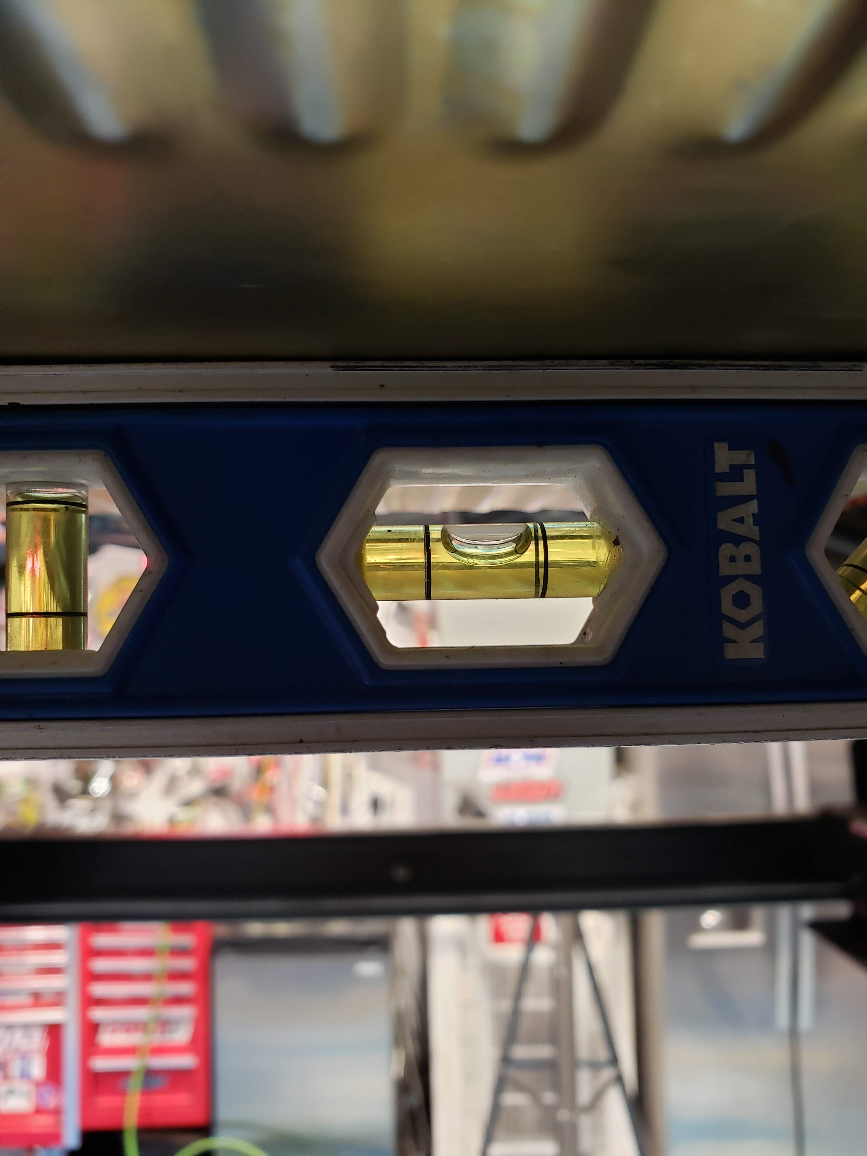

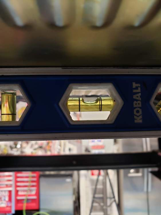

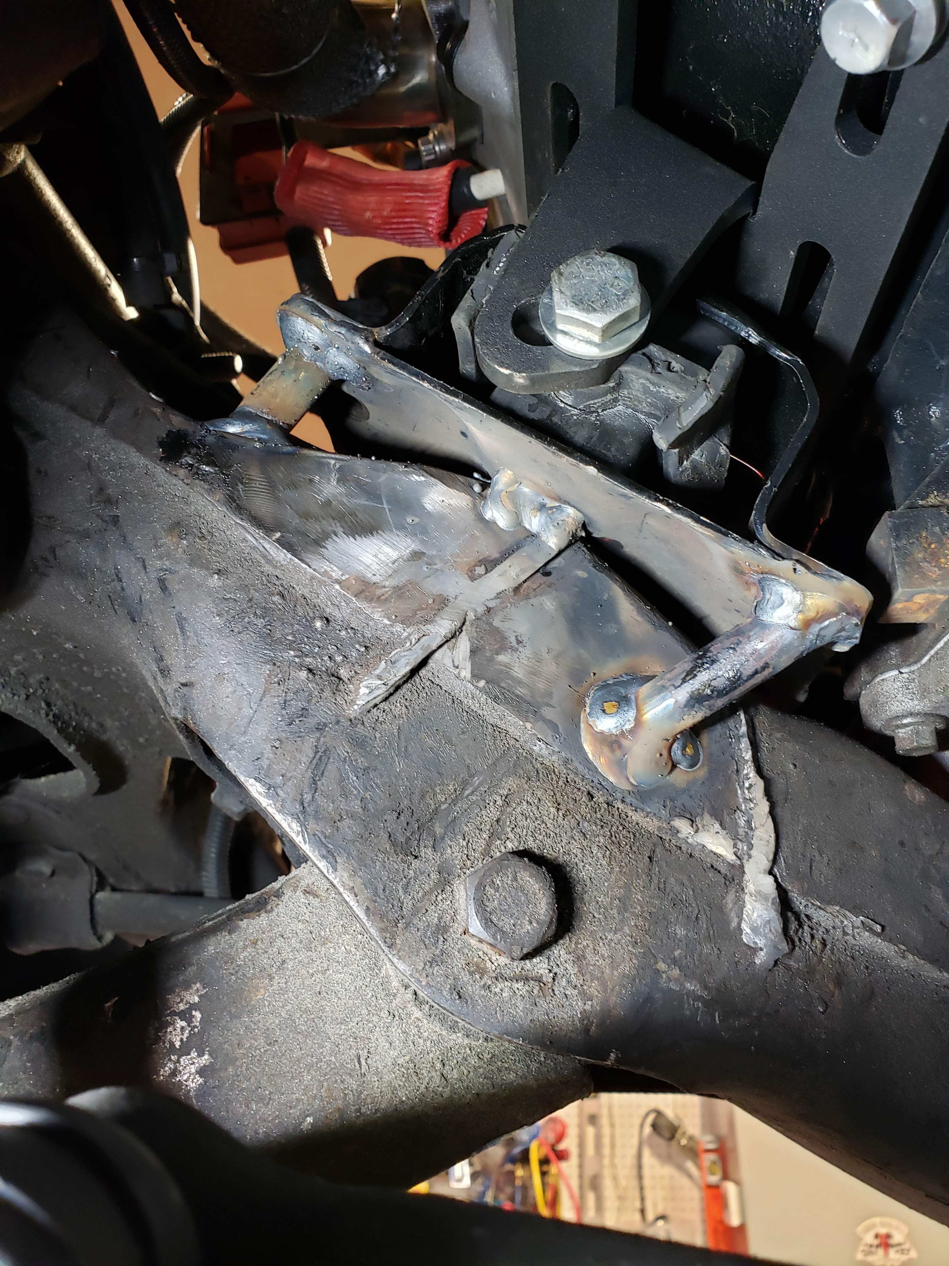

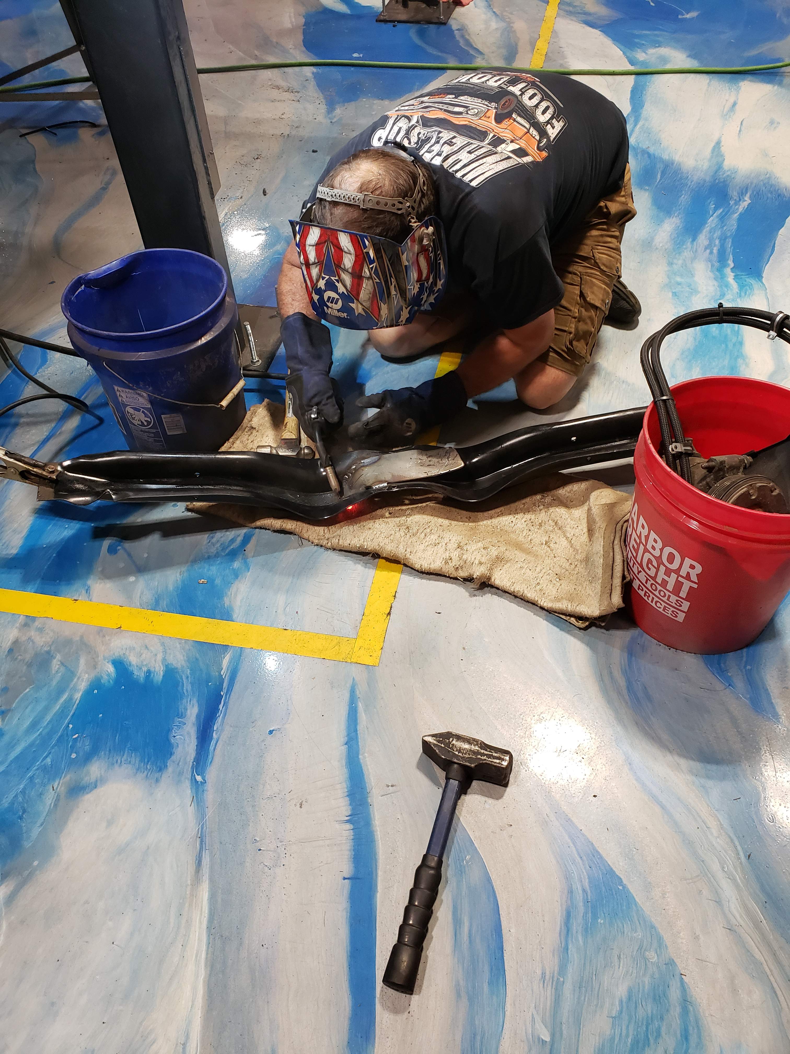

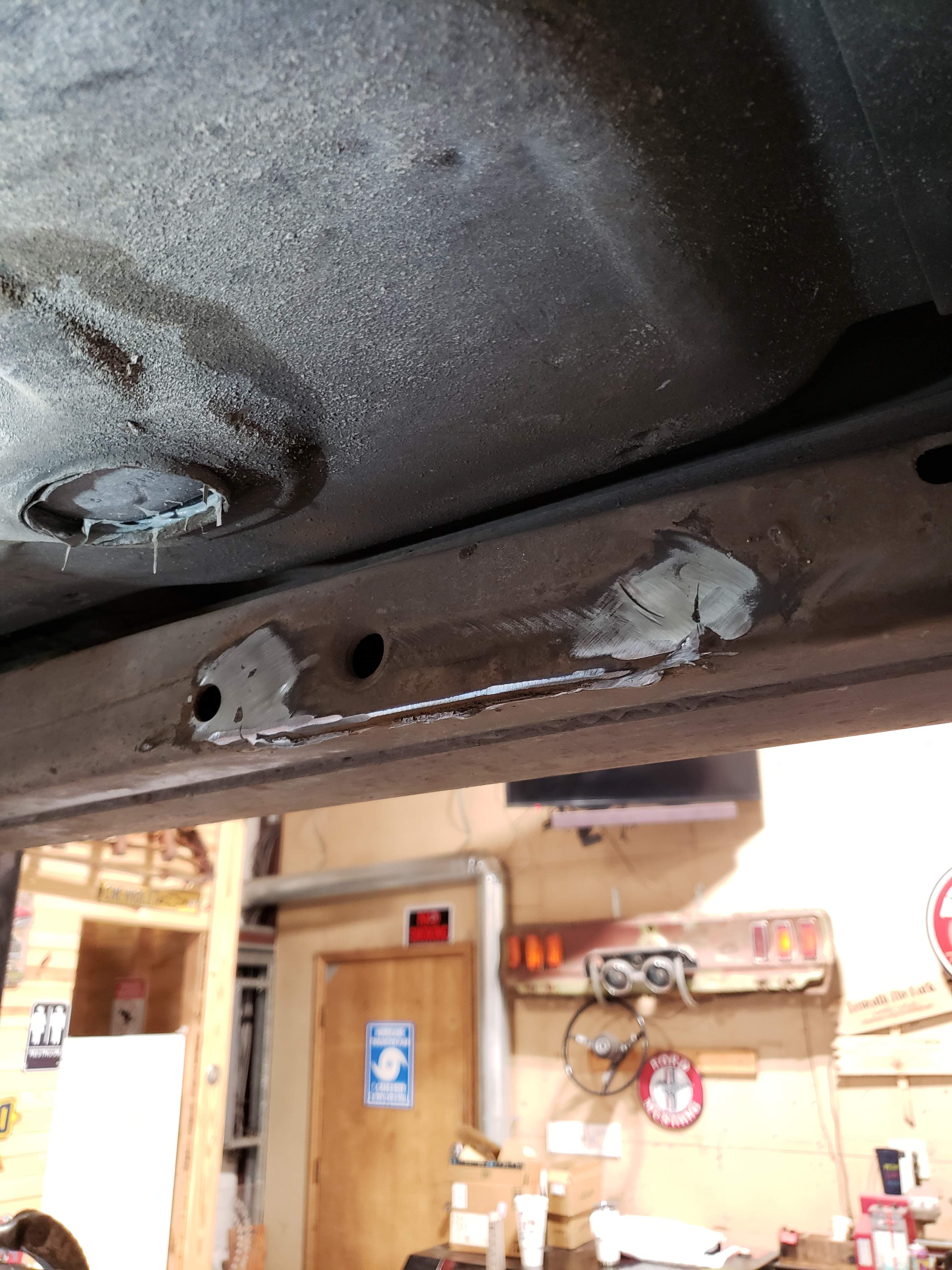

OK, pictures of progress. Some of my ideas about engine mounts and transmission mounts did not survive contact with the experts but we did find solutions today. The measurements and angles left, right, forward and back, up and down are all good now and will be locked in tomorrow morning if not already tonight.
I will also be spending more money than I planned but that is usually the case with me and these cars. But it'll all be done correctly and solidly. I didn't think it would be necessary but the transmission crossmember mount perches at the frame rails had to be moved and re-fabricated a little and the middle of the crossmember needed work.
Edit: My transmission tunnel new metal work was all suitable and OK. No large hammers, torches, new metal or welding was required today to get the 4L60E to fit.

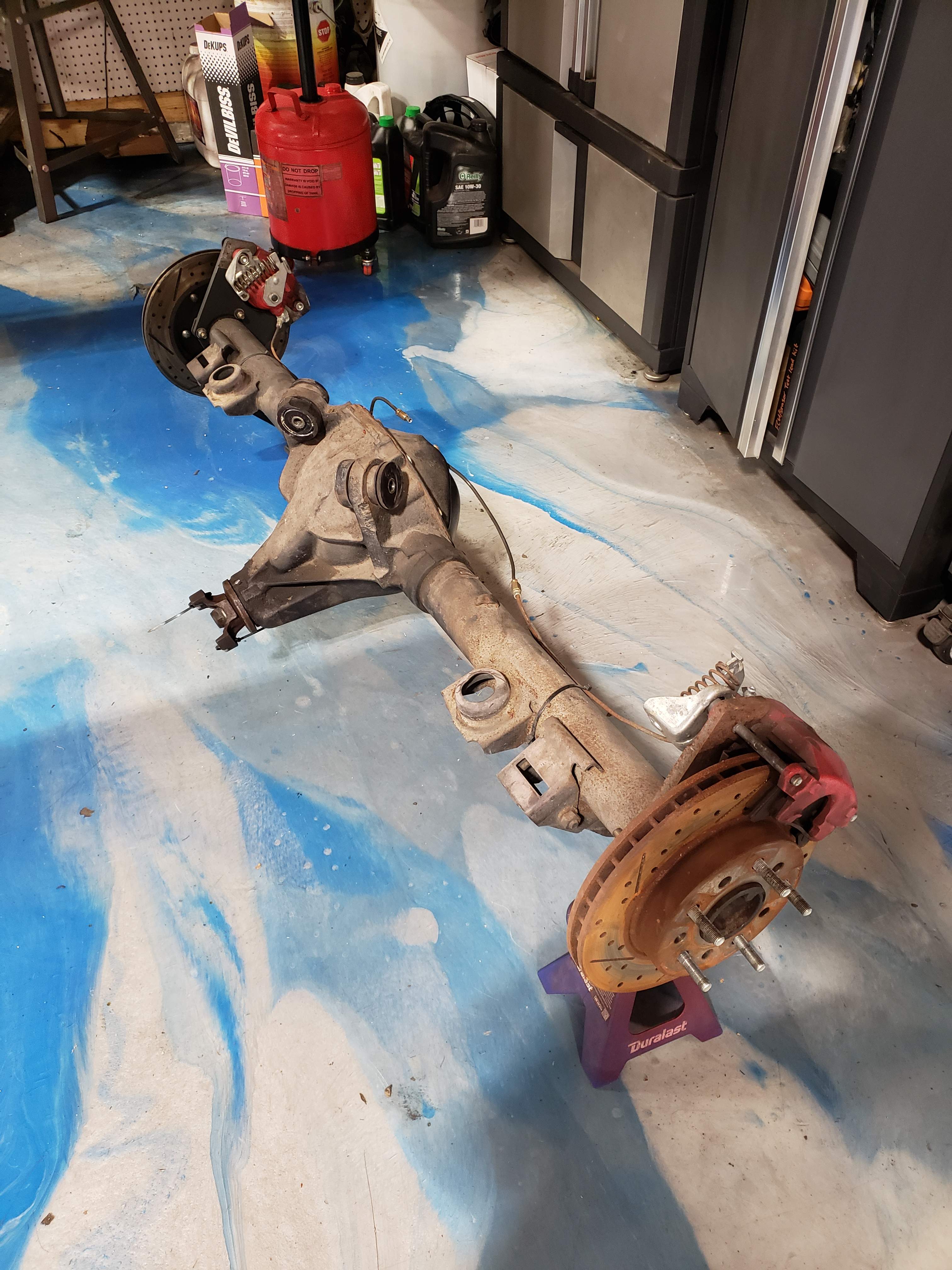

It also did not help today when I could not resist buying a ten bolt, A-body Positraction rear end with complete and nearly new disk brakes on both ends. This will be for my 70 El Camino that has a non-Posi rear end, drum brakes and 2.73 gears. This new rear end has 3.42 gears in it which will be a better match for the 4L60E overdrive transmission in my EC. Cost? $400.00 and it includes an all new emergency brake cable kit for these nearly new calipers. I'm also still running the original 1970 upper and lower rear control arms and bushings and this will prompt me to change those out when this Posi rear goes in.

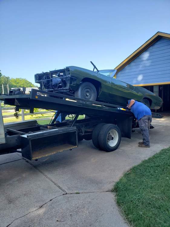

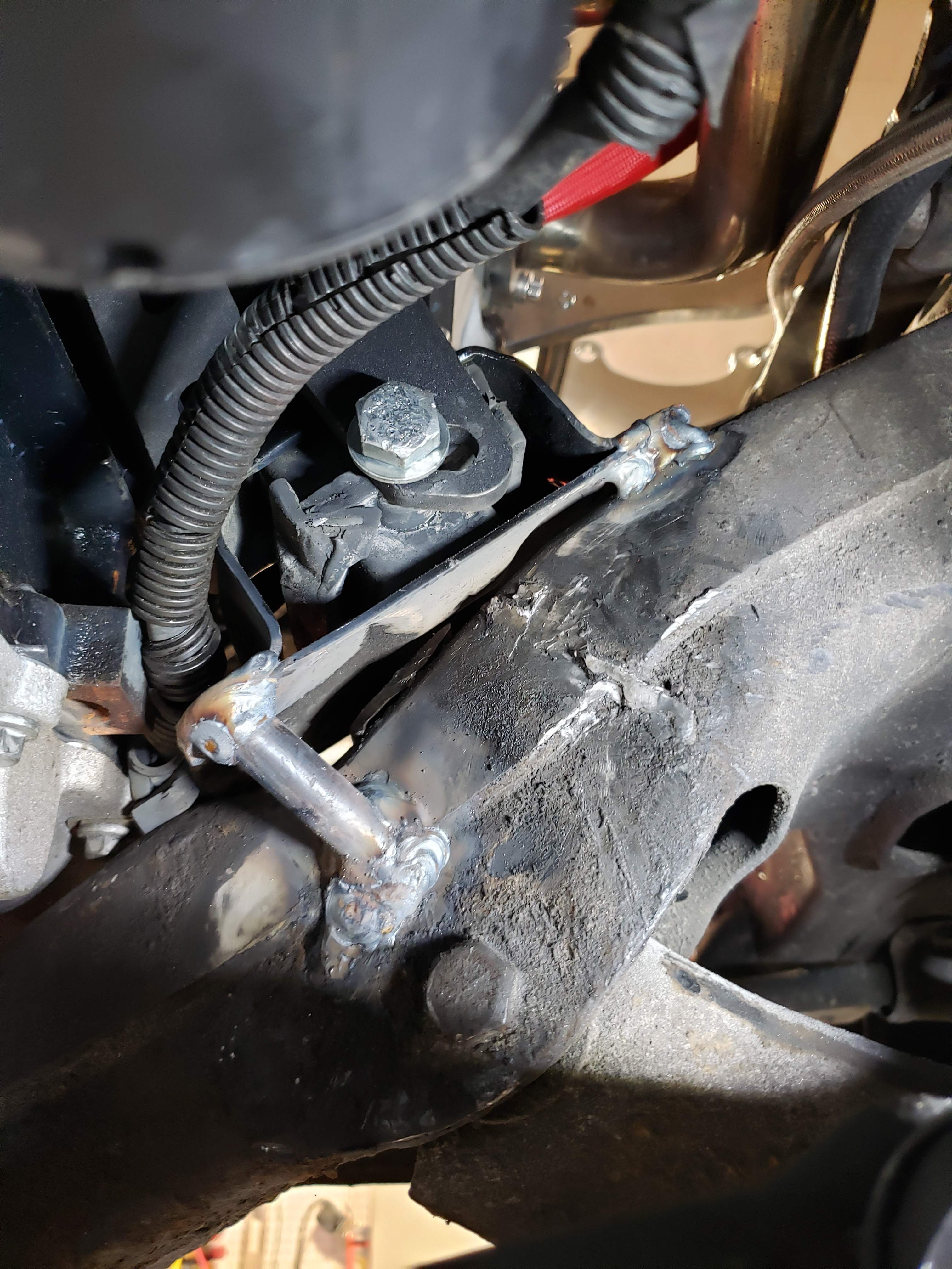

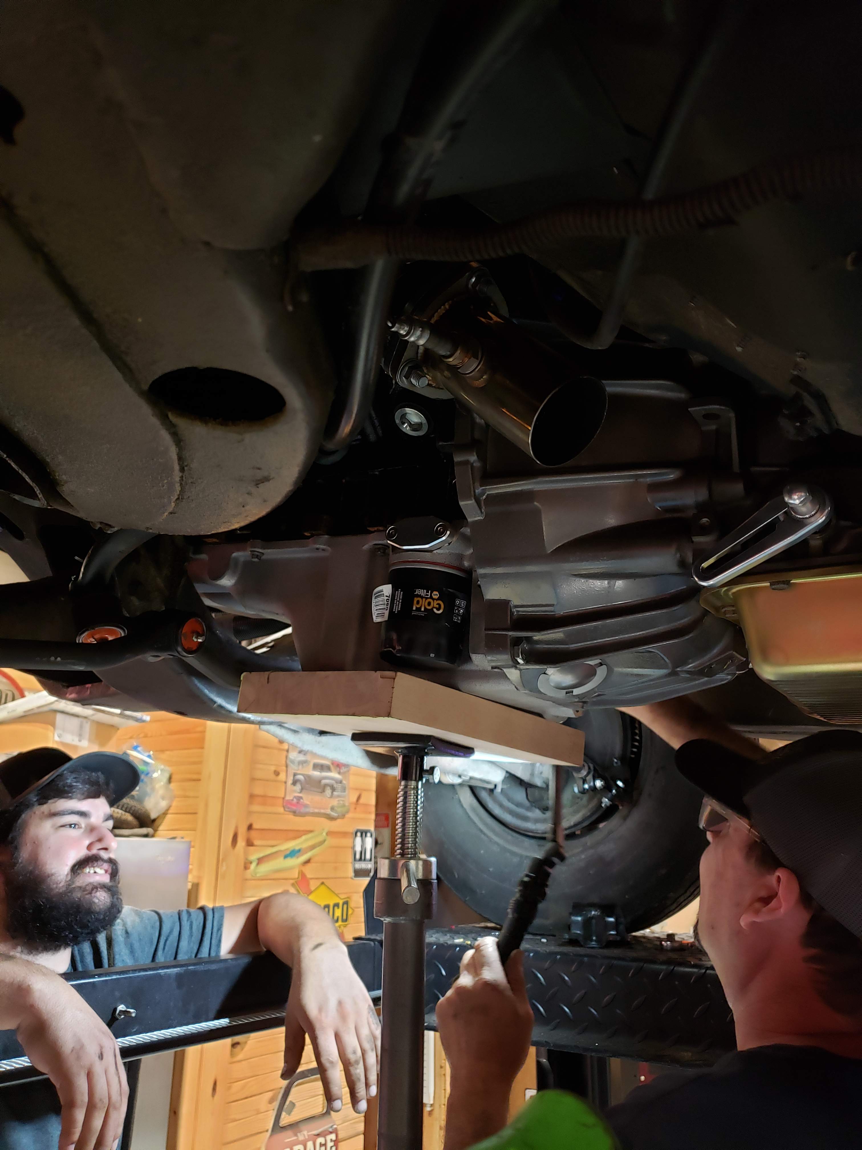

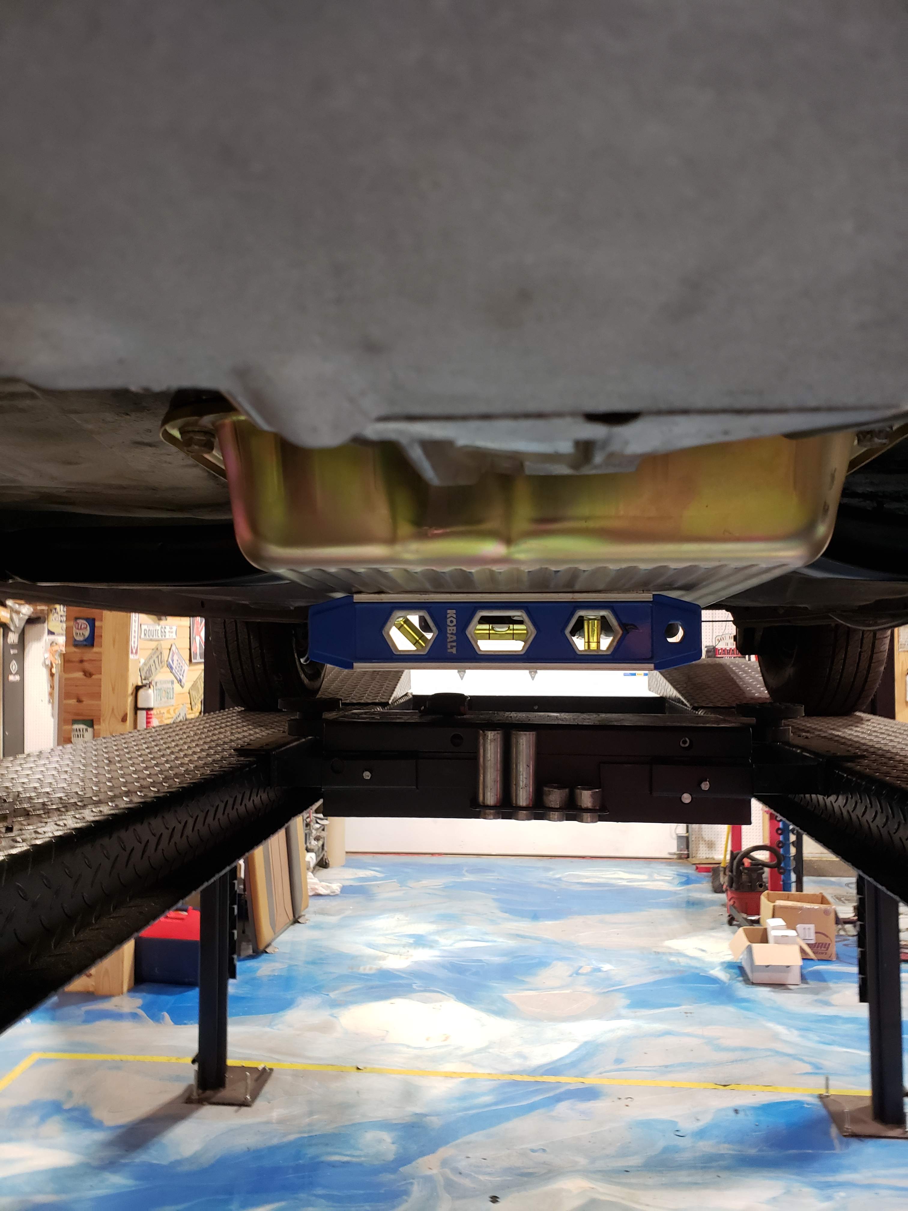

Hello Again,
More pictures and the work is finished. The car will return home tomorrow morning. This was 16.5 labor hours at $150.00 USD per hour. Plus tax. The engine mounts are very solidly in and we decided to abandon the original Pontiac transmission crossmember and moved to an all new and fabricated crossmember. We just couldn't get the original crossmember stiff enough as it needed to be.

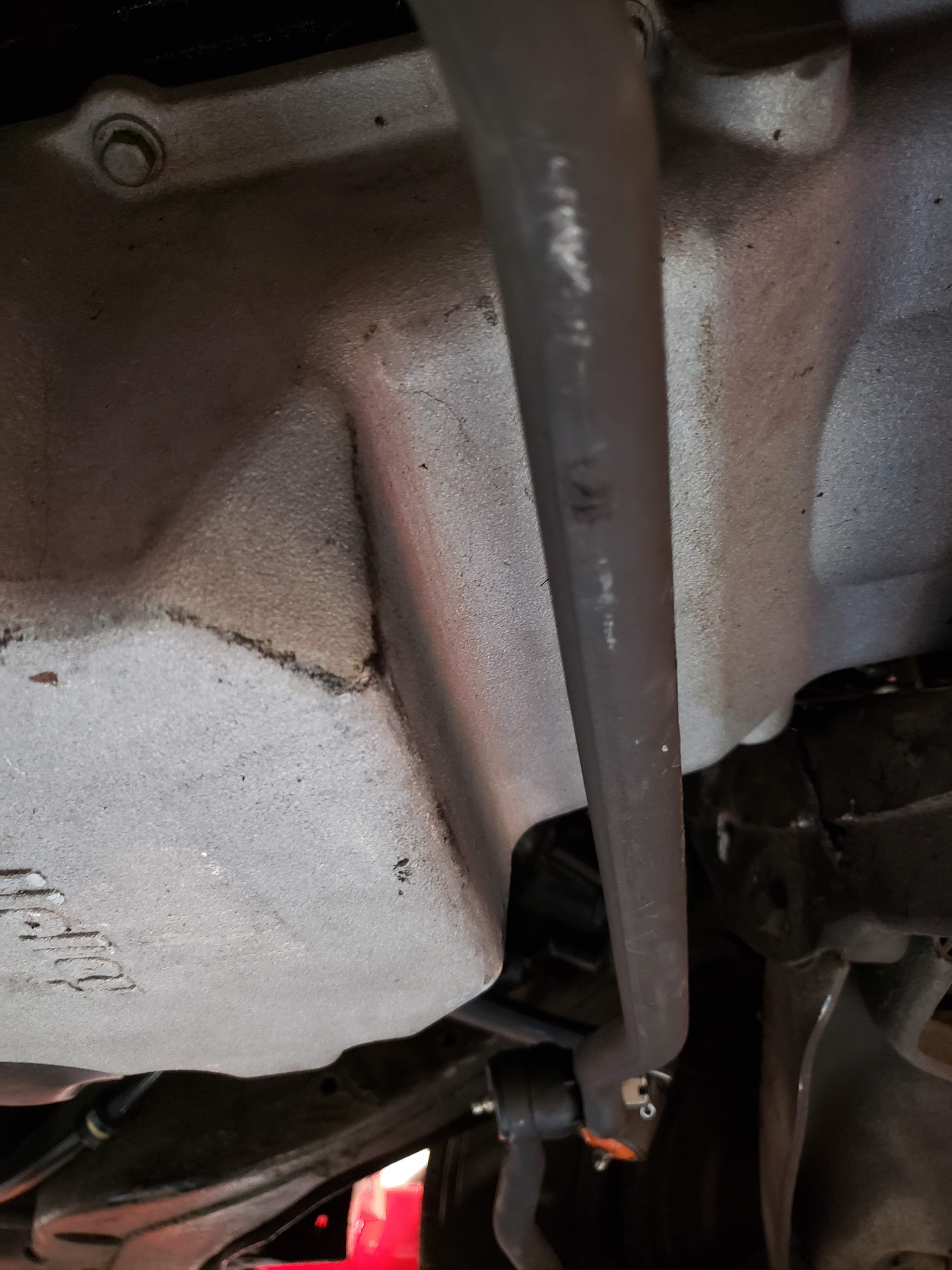

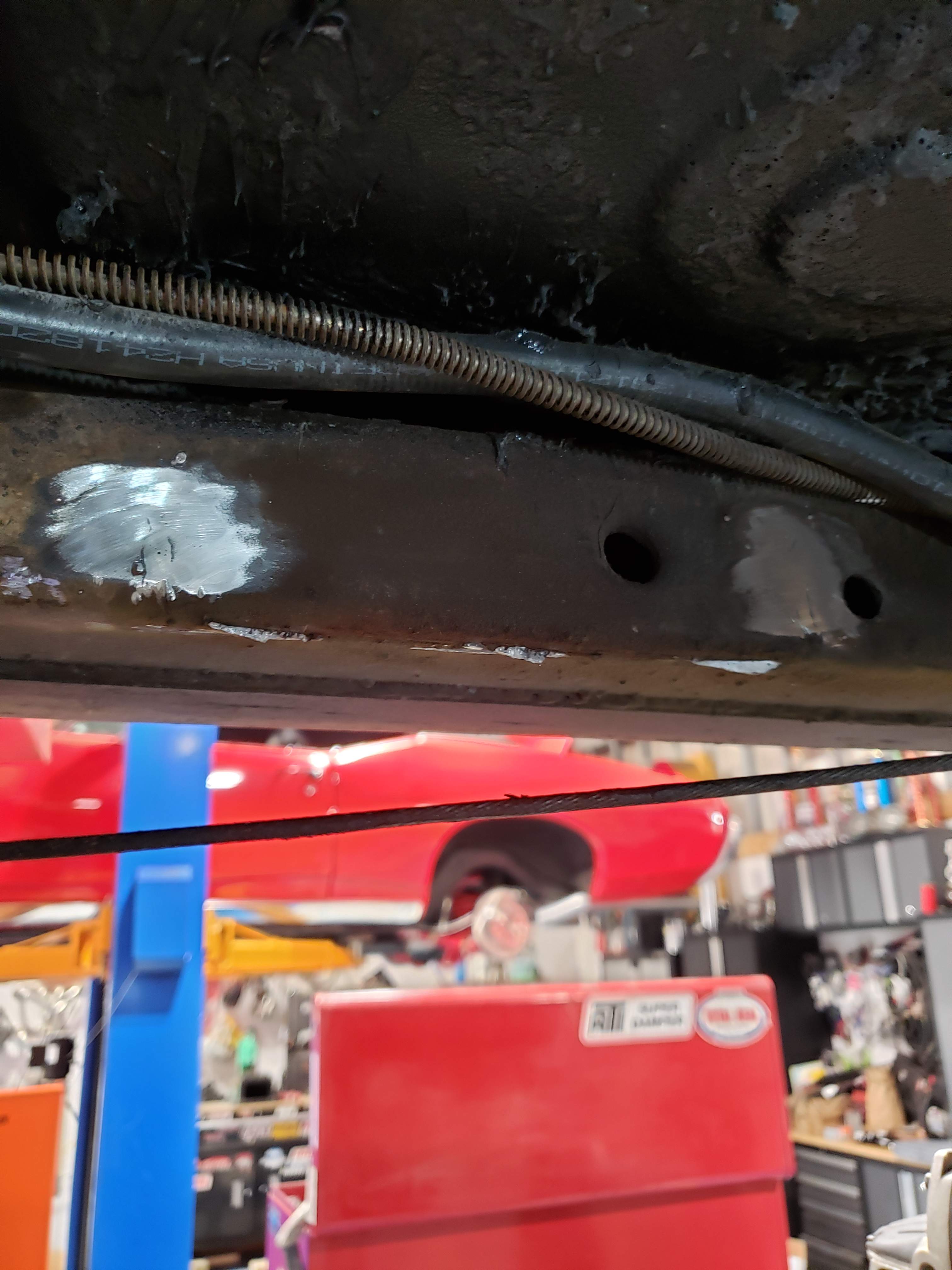

For the engine mounts, I have plenty of clearance from the steering center link at the oil pan. The angle towards the rear end pinion / u-joint is about one degree down at the output shaft of the 4L60E. My only slight worry is the engine now sits slightly higher than when the car sat on the shop floor here at home and I'm worried that the LS truck intake manifold won't have room under the hood. LS truck engine intakes are taller than a Camaro LS3 intake but we will soon know if I have a problem.
The original frame crossmember perches and their rubber vibration isolators were retained but the perches needed to be moved along the frame rail a little to best lash up with the back end of the 4L60E.
The door latches now operate perfectly and I will no longer worry about the doors being stuck closed.

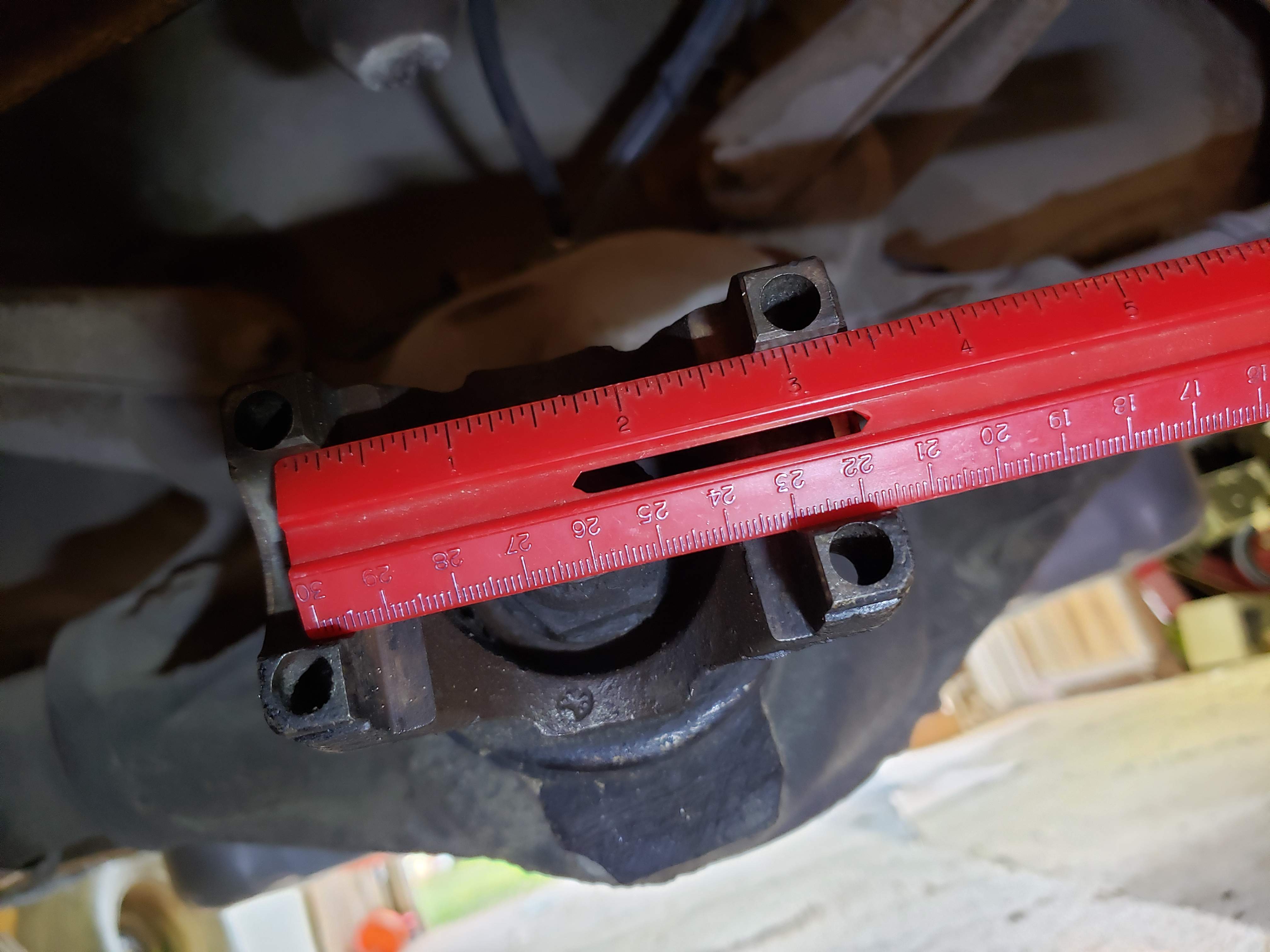

And we forgot to do it but we will get a measurement tomorrow morning for the length of the new drive shaft that still needs to be built.
The new to me A-body Posi rear end with disk brakes for my El Camino will also come home with me tomorrow.
Rick

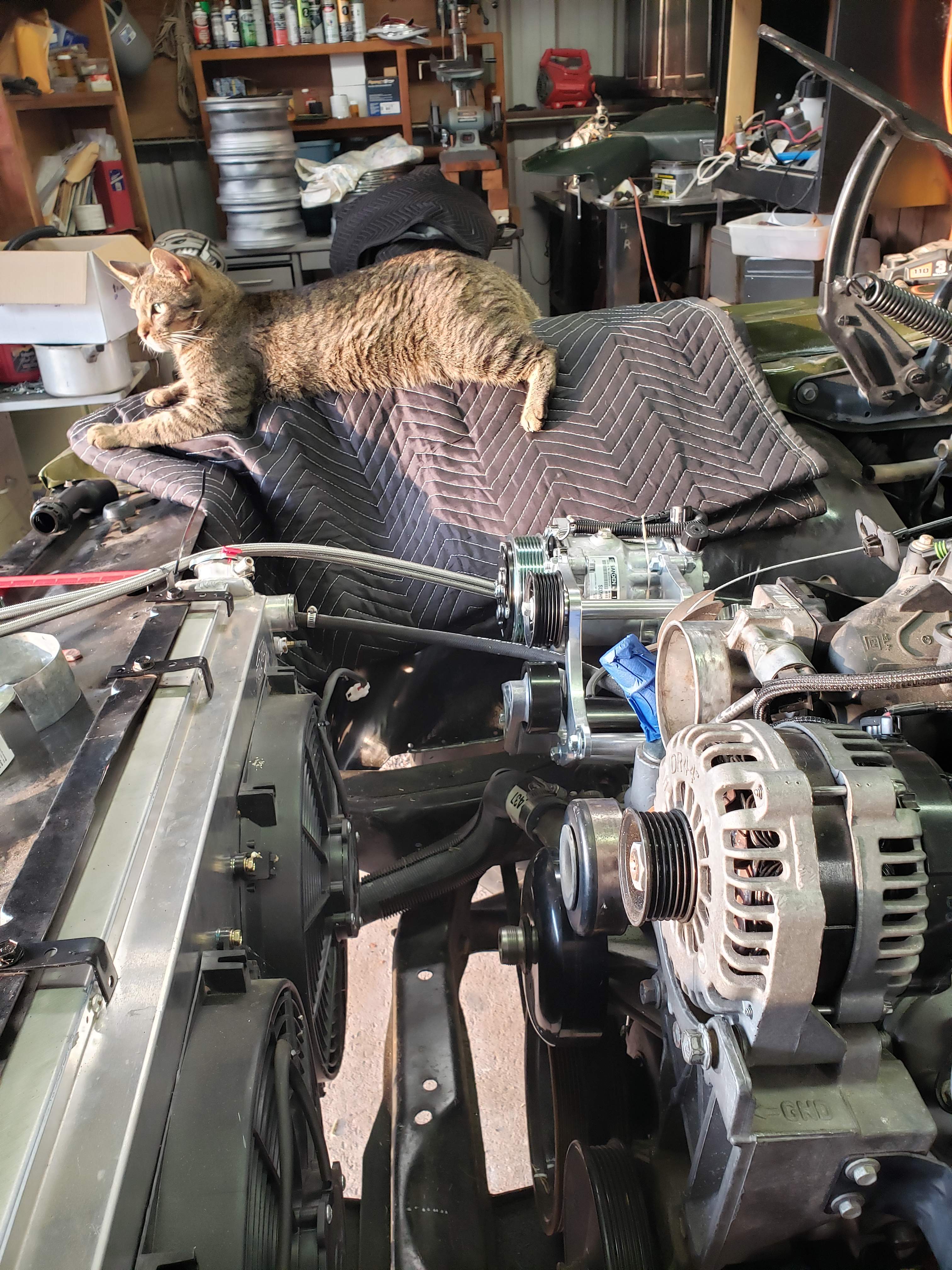

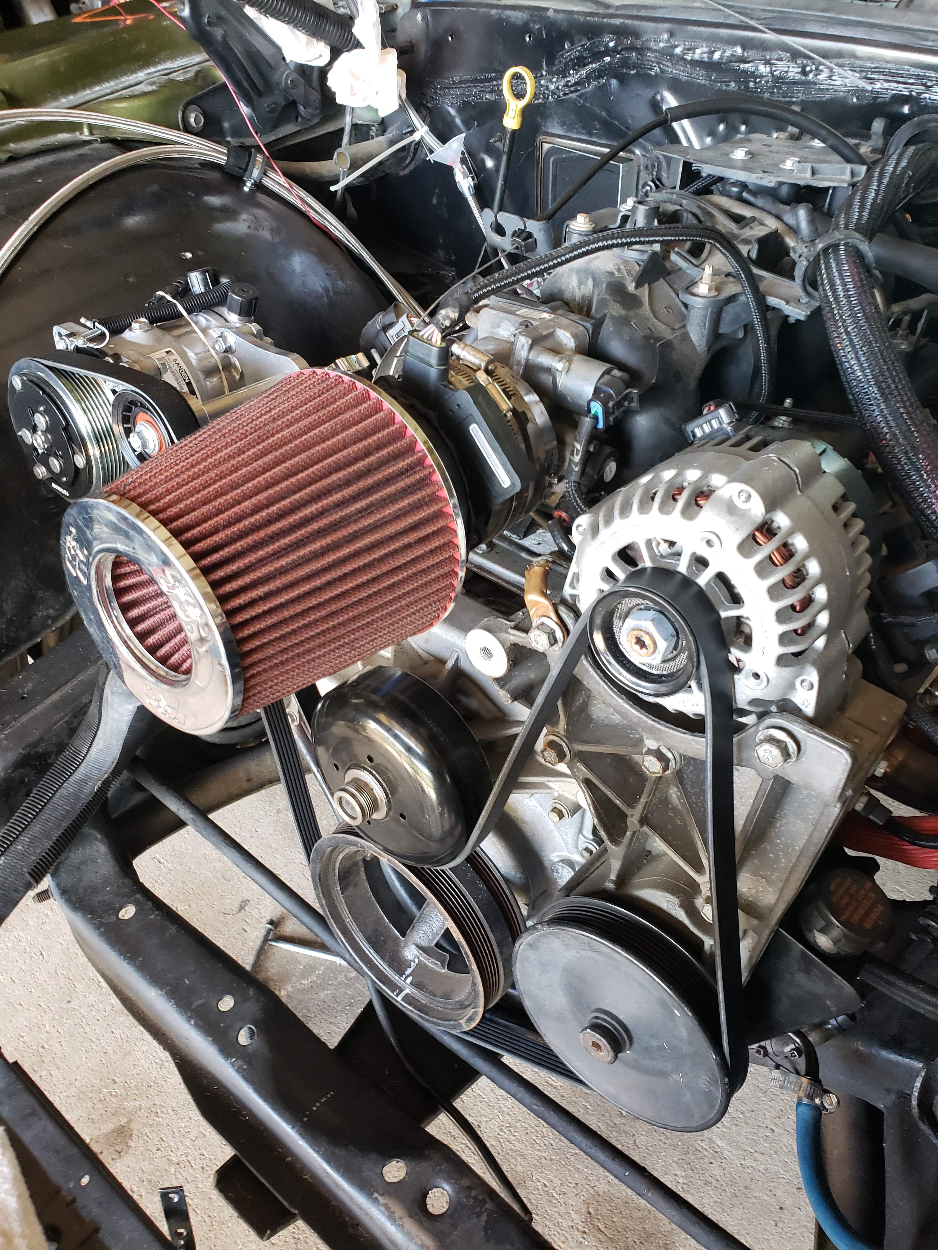

Hello,

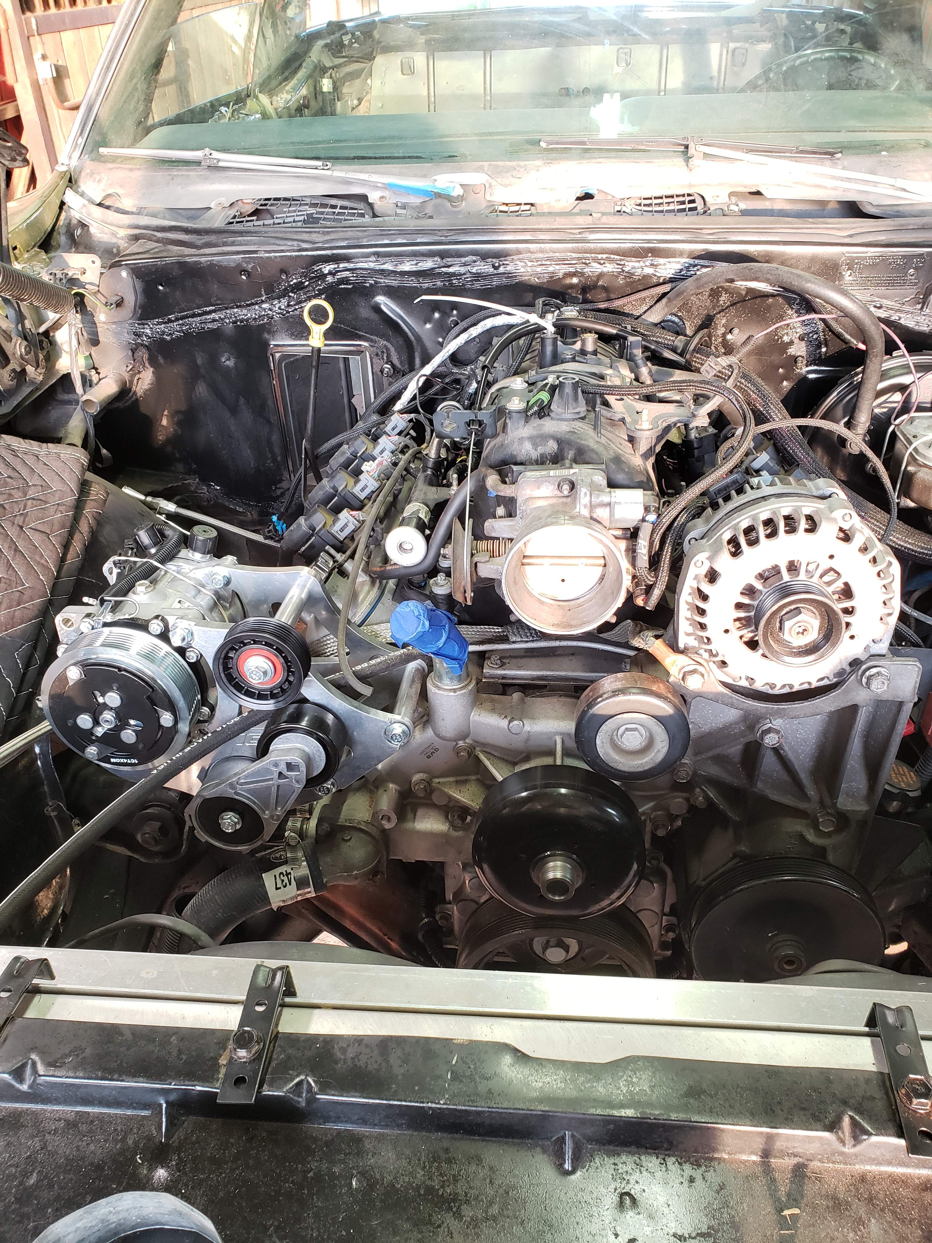

Some progress. The intake manifold is laid in and wiring connections are being made. The mass airflow sensor still needs to be connected with my air cleaner on the front - a fabricated bracket will be required.
The 130 amp alternator is also mounted but may sit too high for proper hood clearance. I have a smaller 105 amp alternator that would still be sufficient for the car's needs and I will swap to this smaller bodied alternator if needed. I have a few more wiring connections to make underneath the car at the transmission and the oxygen sensors.
My new Sanden AC compressor is also mounted into the ICT Billet bracket and the compressor appears to be plenty low enough to clear the hood when it goes on. The radiator is also laid in and there's plenty of clearance with the radiator fans and the K&N air cleaner. I will need to lengthen and re-route the hose from the steam vent line to the steam vent input port on the radiator.

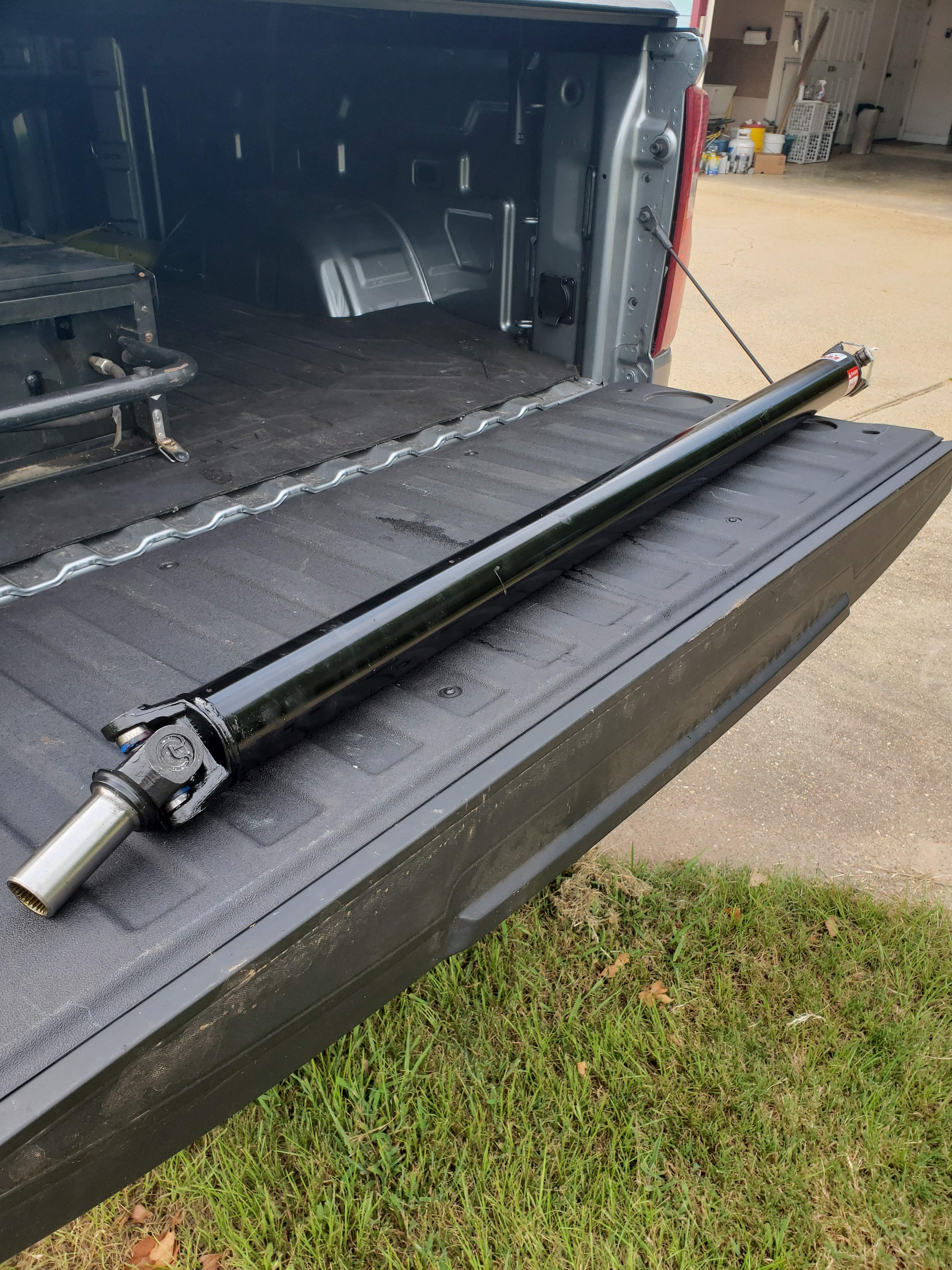

And lastly, the new driveshaft will go into production, hopefully on Monday. It'll be 58.5 inches long and use a 1310 yoke at the back of the 4L60E transmission. Balanced at a 3000 RPM shaft spin speed. This is a picture of the pinion with a ruler to provide additional measurements.
It is very hot here and I wish I could make faster progress. I get up early to work because most evenings, its still too hot.
The actual feline cat being sitting on the fender of my Cat is the strong silent type offering little to no relevant, useful assistance.
Rick

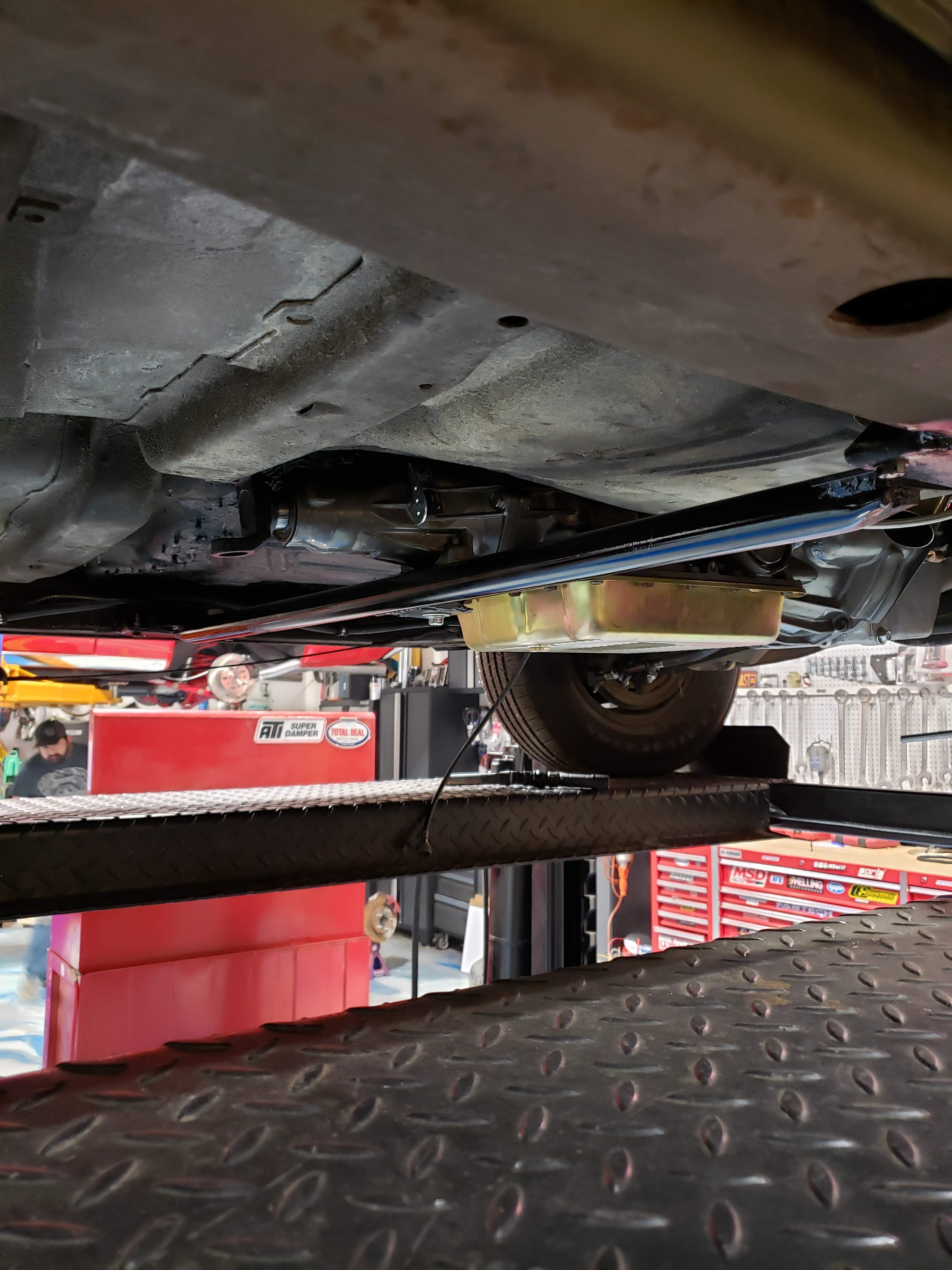

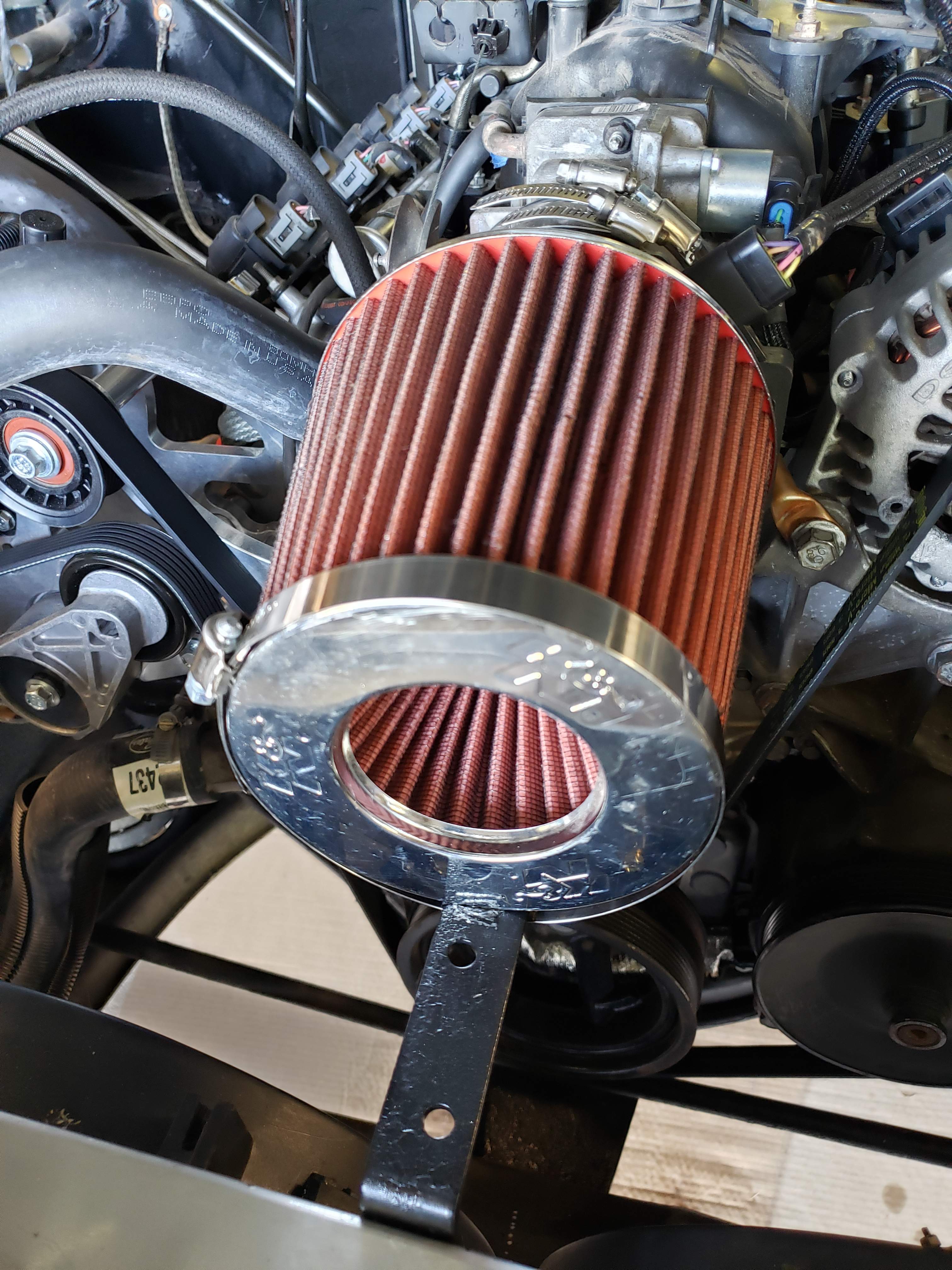

Hello Again,
Work continues. The driveshaft finally got installed this morning but it was a struggle. The original driveshaft for this car was loose from the differential when I bought it and I had no way to know if it used U-bolts on that end or straps. Fifty-fifty shot and I guessed wrong. They don't make drive shaft U-bolts long enough to reach all the way through the pinion for nuts to go on. So late this past week, I switched to looking for straps and found a set locally but I still had to chase down long enough Grade 8 bolts to poke through the pinion holes with enough length for lock nuts. This job is now complete.
Finding a correct length six rib serpentine belt has also been challenging. I switched to the smaller bodied, 105 amp alternator before starting this chase and eventually wound up with a 97.5 inch circumference belt after initially trying a 98 inch belt.
The transmission has its initial fill of four quarts of fluid in the pan - the fluid pan is full and no more will fit for now. The power steering pump also has its initial fill of fluid. Both of these will need additional fluid very shortly after the engine starts up.
I noticed that the main battery cable to the starter got a little pinched and damaged during the engine mount operation. I can't simply buy another LS truck 5.3 liter replacement battery harness because the new route for this cable is a little longer and a stock harness cable will be too short. Thusly, I need to make a new wire assembly out of welding cable.
Yesterday, I noticed that the LS engine steam vent tube at the front and top area of the motor has cracked. This was probably due to too much abuse taking the motor in and out here trying to do my own motor mounts. A quick trip to the junk yard this morning before it got too hot let me find an undamaged replacement for cheap. Its only held on by two easily reachable 10 millimeter bolts.
I have also gotten the K&N air filter well attached to the throttle body but I will still make a bracket for it for best support. I'm confident that the Mass Airflow Sensor is also dependably attached.
I will soon set a battery into the car. My wire heat protection from Summit Racing arrived earlier today which will allow me to build that heavy starter wire and things are getting very close for this engine to make its first start inside the engine compartment. After that, I need to bend into shape and trim the Lokar Universal Shifter linkage to reach the 4L60E transmission.
And then, the she-Cat will move under her own power.
Rick

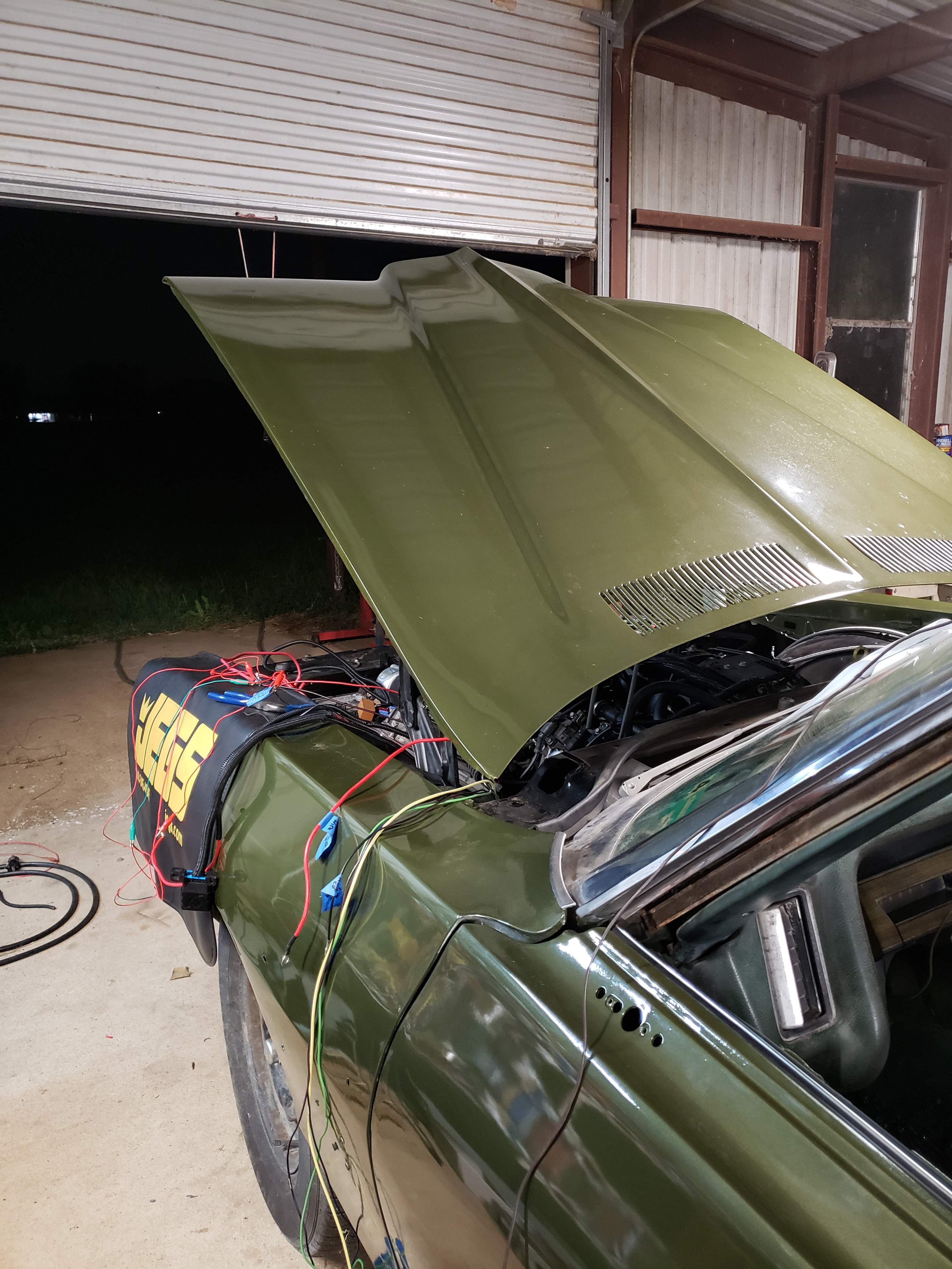

Hello,
And a very vigorous drum roll please . . . the engine has started inside the Catalina engine compartment for the first time. The PCM and starter wiring are sprawled out all over the place and there is no radiator so I could only run the motor for about thirty seconds. This will be my wife's show car and she was there when it cranked up for the first time. With only short, twelve inch long pieces of metal tubing stuck onto the ends of the header pipes, she very quickly noted how loud this engine is.
This is the first time the motor has ran since last November and it quickly settled into that programmed 675 idle RPM. This engine operation is essentially no different than when it ran last November except the motor is off the shop floor and its wheeled engine stands that I used back then. It had an ugly but functional wiring setup back then on the shop floor and it is still an ugly but functional setup now inside the engine compartment and on the driver's side fender. But it runs and the lifters pumped up quickly with no looseness sounds or rod knock. I suppose this also means that I bolted the flex plate and the torque converter together correctly - no oddball sounds there. It'll be interesting to see if the fluid level in the transmission pan has lowered.
I need to set in a radiator and finish up the wiring more into its final position. And I will eventually do a quick You Tube video when the wiring and PCM are tucked away. But all in all, this is a very happy day for me.
Rick

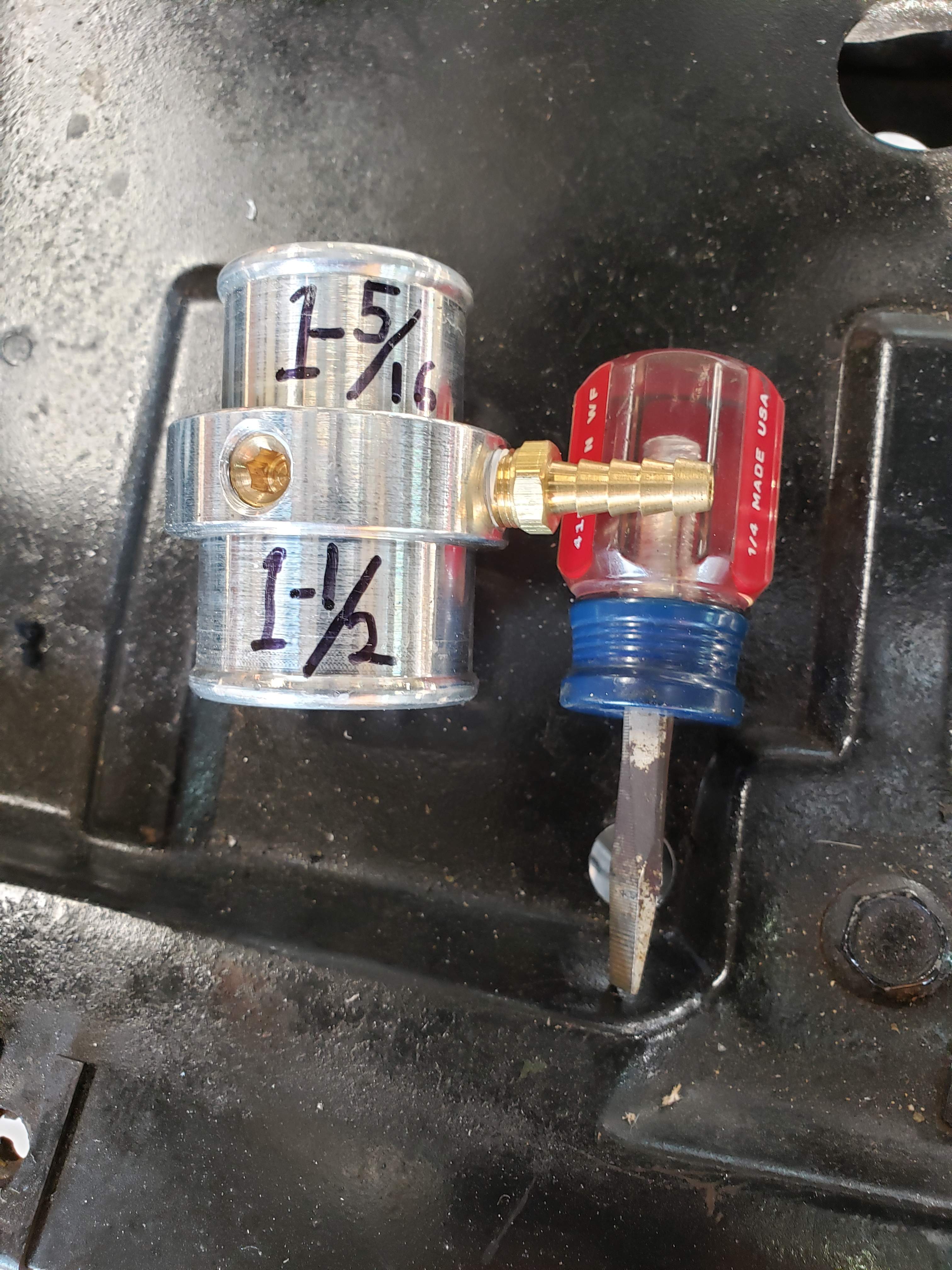

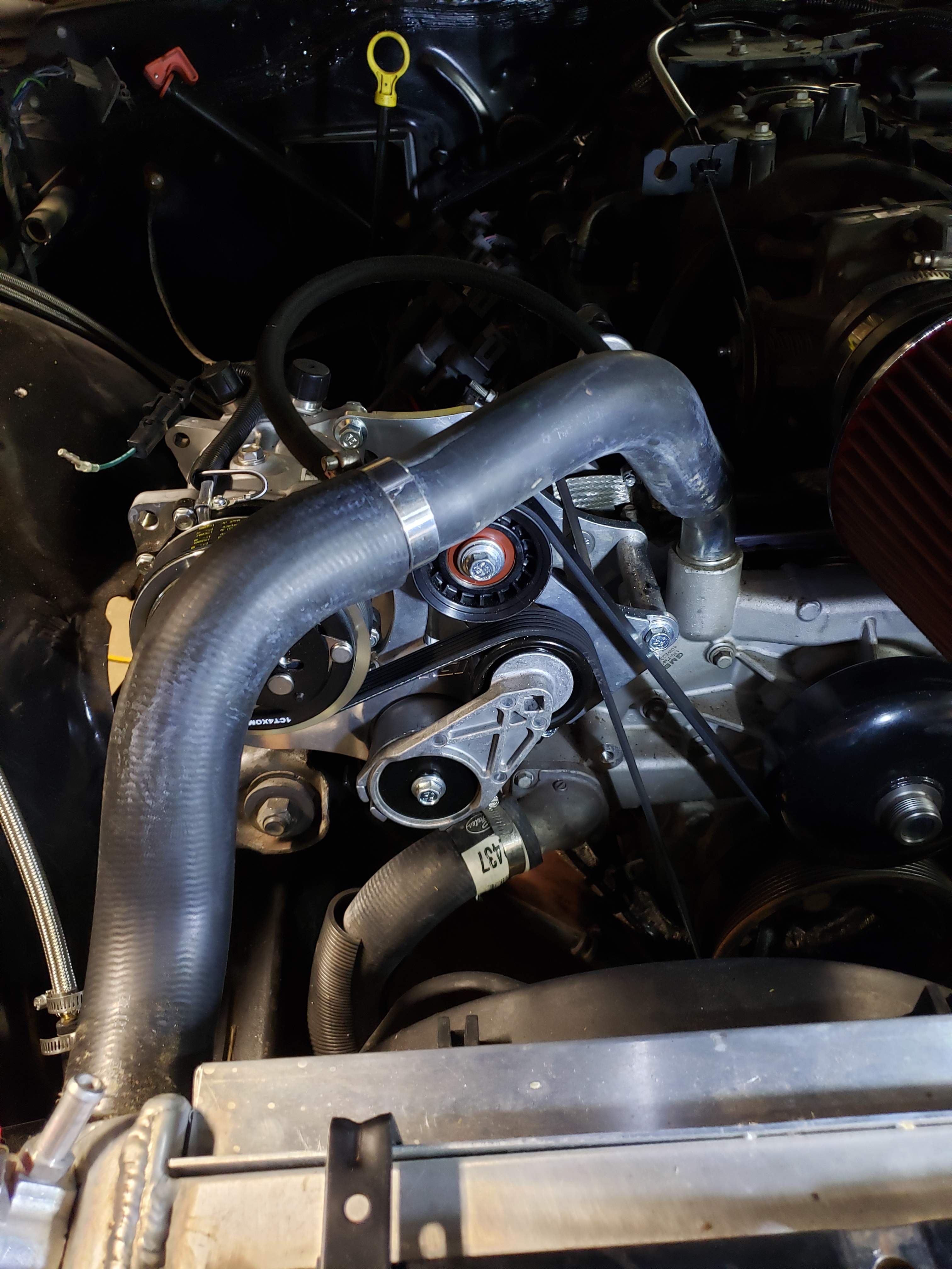

I have determined that my best course of action for a top radiator hose is to cut two different hoses in half using a band saw and then use a splicer to join them. The water pump upper pipe is 1.25 inches outside diameter and the top radiator inlet pipe is 1 and 5/16ths of an inch - one hose simply can't be found. Cutting up two different hoses and then joining them solves the pipe size problem while also solving a hose twist / clocking problem. I will order the splicer tomorrow from the people at the "Jags That Run" web site and they have a very wide variety of LS swap problem solving items. This particular splicer will also have a barbed, brass, 1/4 inch pipe for use with my engine's steam venting outlet. The bottom hose for the radiator is exactly the same hose type that I use on my LS swapped El Camino.

My radiator hose splicer arrived while I was out of town and the pictures are below. I have trimmed down two completely different Gates hoses with a band saw for best overall fit for height, no kinking and no oddball twisting of the hose. The splicer from "Jags That Run" was absolutely crucial in making this happen and I still need to add hose clamps and shorten the steam vent hose.

Hello,
A car show last weekend, a whole lotta’ yard work this week and me being laid up a little sick today on the couch has slowed Catalina work down.   But it has not stopped it.
The air cleaner bracket has been bolted to the radiator fan shroud and the air cleaner is now bound to the bracket with a large hose clamp. Got the radiator filled and all hoses clamped tightly.  Started the engine and got it to closed loop in a little over a minute and there were no DTC trouble codes.  The car then sprouted three different leaks – the low-pressure power steering return line at the steering gear box, the passenger side steam vent line at the top front of the motor and probably at the transmission cooler lines exit. At least this my thinking about the transmission leaks at the time.

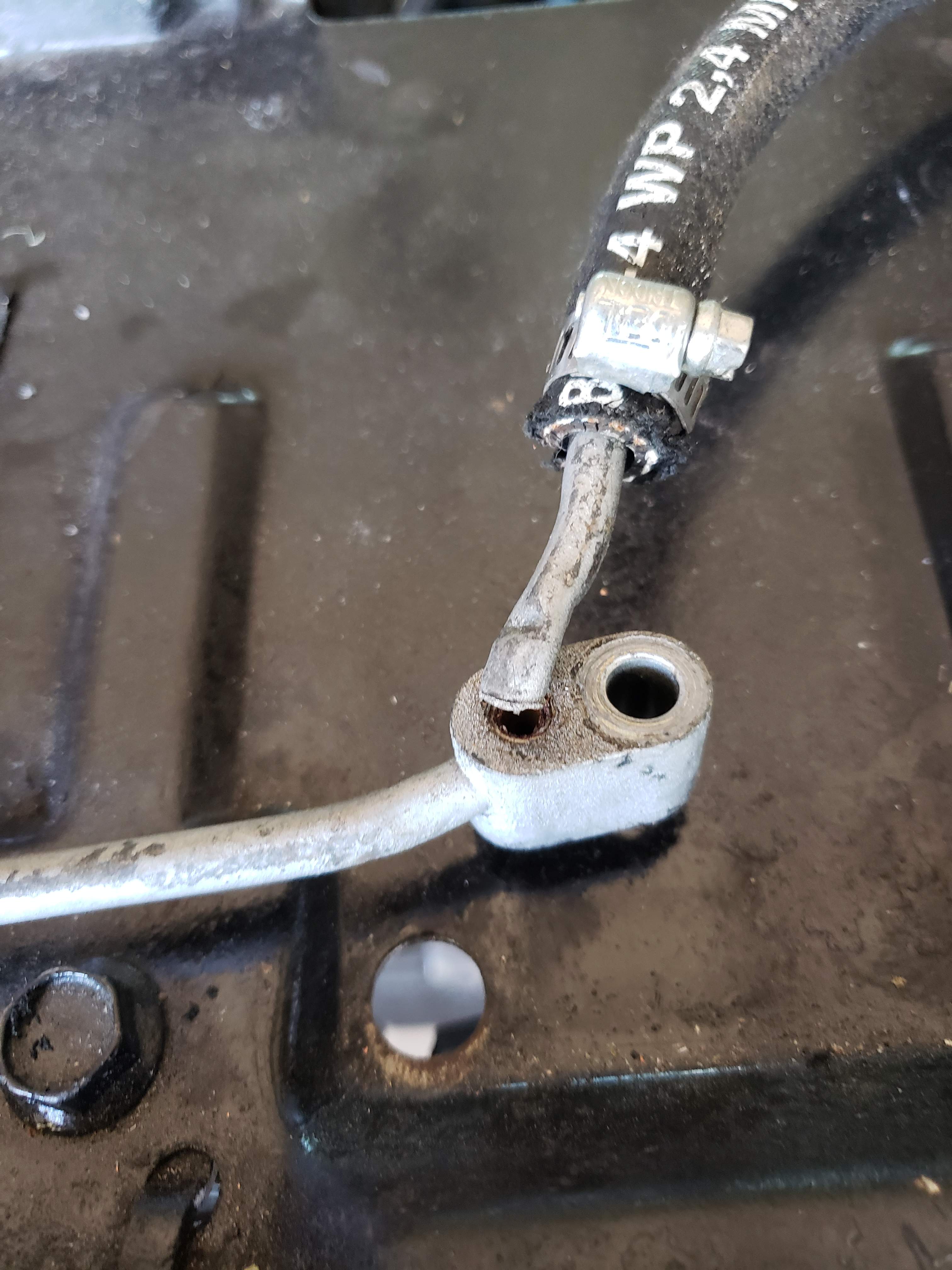

The leak at the steering gear box hose fitting was a leaky connector that simply could not tighten to stop the leak. I went to my favorite local junk yard and got a used low pressure power steering gear box return hose from a 1997 Jeep Grand Cherokee (JGC) because no new hoses were available anywhere locally.  Cost? $6.00. I could have ordered a new hose locally for up to fifty bucks and a few days wait but the junk yard was easier, much less expensive, and simply, now.  I put a new O-ring onto the JGC hose connector, removed the old rubber hose and added a new, longer pressure hose and installed the ends onto the steering gear box and the power steering pump. The only portion of this JGC hose that I needed was the “S-shaped” metal tubing piece and it will never fail – its original 1997 JGC rubber hose was only attached with a hose clamp, no crimps. And I knew it would work because the Cat has a JGC steering gear box in it already – for a much more modern steering road feel.
Then I focused on the steam vent line leak. When I installed the steam vent line, I had left off the two small oval metal seals and I had to go back to the junk yard the other day and grab a few more.  The hardest part of fixing this problem is removing the alternator to get to the driver’s side port which was also missing its seal – not very hard at all.  A little Form-A-Gasket slow drying sealant is applied to these oval seals and a ten-millimeter bolt tightens it all down.

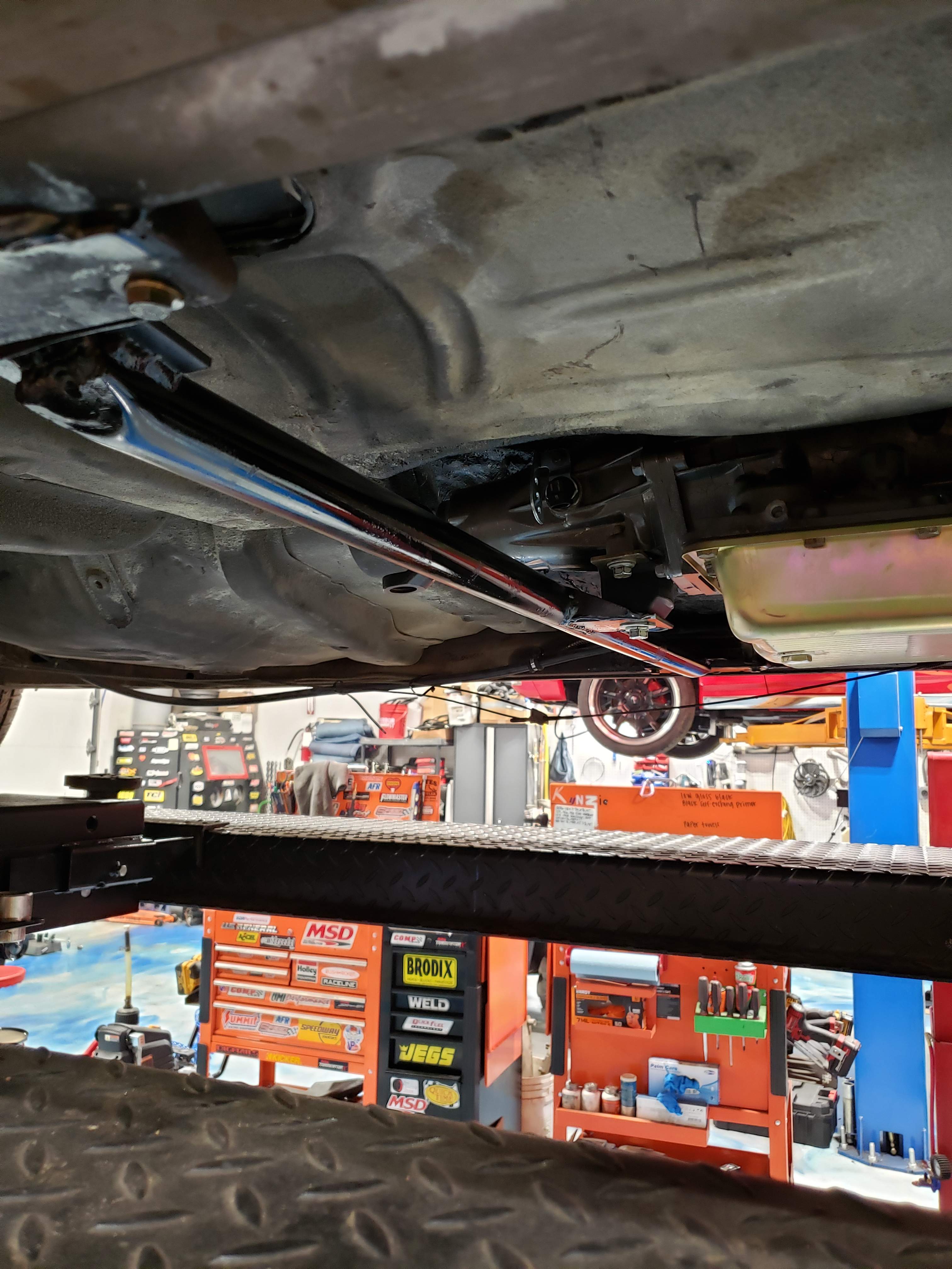

  After making a small transmission fluid mess on the shop floor with a few more engine runs, that leaky flow of fluid dropped off significantly but not completely. At this point, I accidentally started the engine with the 4L60E in a gear.  The neutral safety switch was in the Park position but I had left the shifter shaft at the side of the transmission in a forward drive gear. This was not an electrical problem but a stupidity problem on my part.  The car was and still is up on jack stands and nothing got hurt, including me.  I was lucky but the driver’s side rear wheel did spin and nothing in the car made any oddball sounds. I have had an OBD2 code reader running for all of these recent engine starts and this inadvertent use of the 4L60E and there have been zero Check Engine Light illuminations, zero DTC trouble codes of any kind.
 A crawl under the car revealed no leaks at the side of the transmission near either of the transmission cooler lines and the leak was much further to the back.   I have now concluded that even with me only pouring in ten and a half quarts of transmission fluid, I have somehow over-serviced it with fluid and the excess fluid is coming out of the vent tube on the top of the transmission case.  Or possibly, that excess pan fluid did not get adequately pumped around the transmission because I was unable to run the 4L60E through any drive gear until that accidental gear change and rear wheel spin. A look at the trans dipstick now reveals plenty of fluid and plenty all through this leak odyssey.
I am also in the process of methodically cutting down the length of the Lokar universal shifter rod.  Cutting this rod too short must be avoided or the column shifter won’t go into some of the lower gears.  Leaving it too long won’t let the transmission go into Park.  I have made quite a few trips under the car mounting and demounting the rod after using the Death Wheel to cut off short lengths.  The correct rod length must be “sneaked up” on to get it right and I’m almost there but there is some Heim joint mechanical adjustability at each end.  Getting the bends in the rod to correctly follow the curvature of the firewall down and towards the 4L60E shifter shaft is also important.
Rick

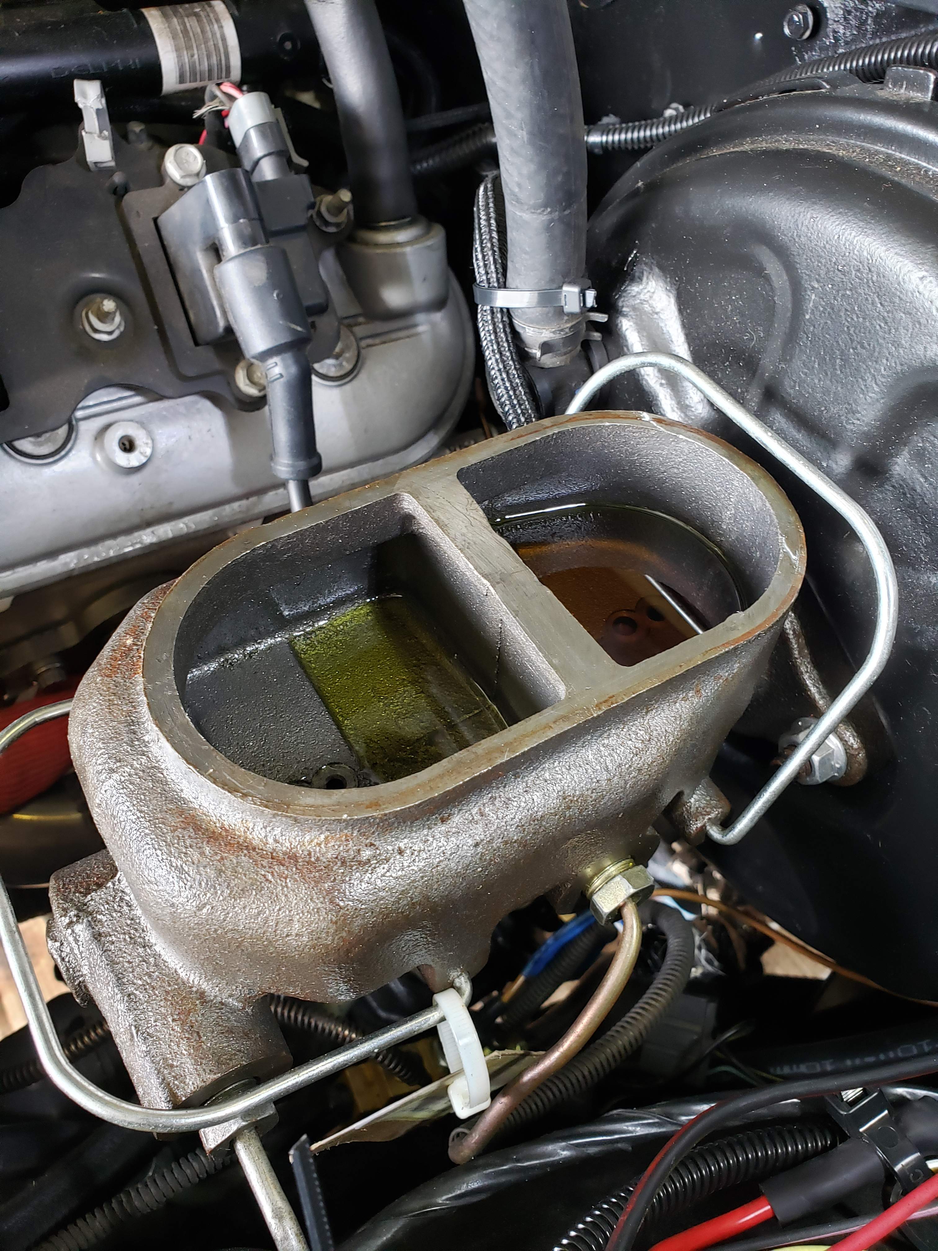

And now this with the brake master cylinder - the pedal went to the floor yesterday during engine and transmission testing on jack stands. The front cup is virtually empty and this dictates that the master cylinder will need to be removed for another bench bleeding. There is not a drop of brake fluid on the shop floor or any overtly damp areas on the front two brake backing plates. I have not looked at the back wheel brakes but that fluid went somewhere. I have bought more fluid and the investigation continues.

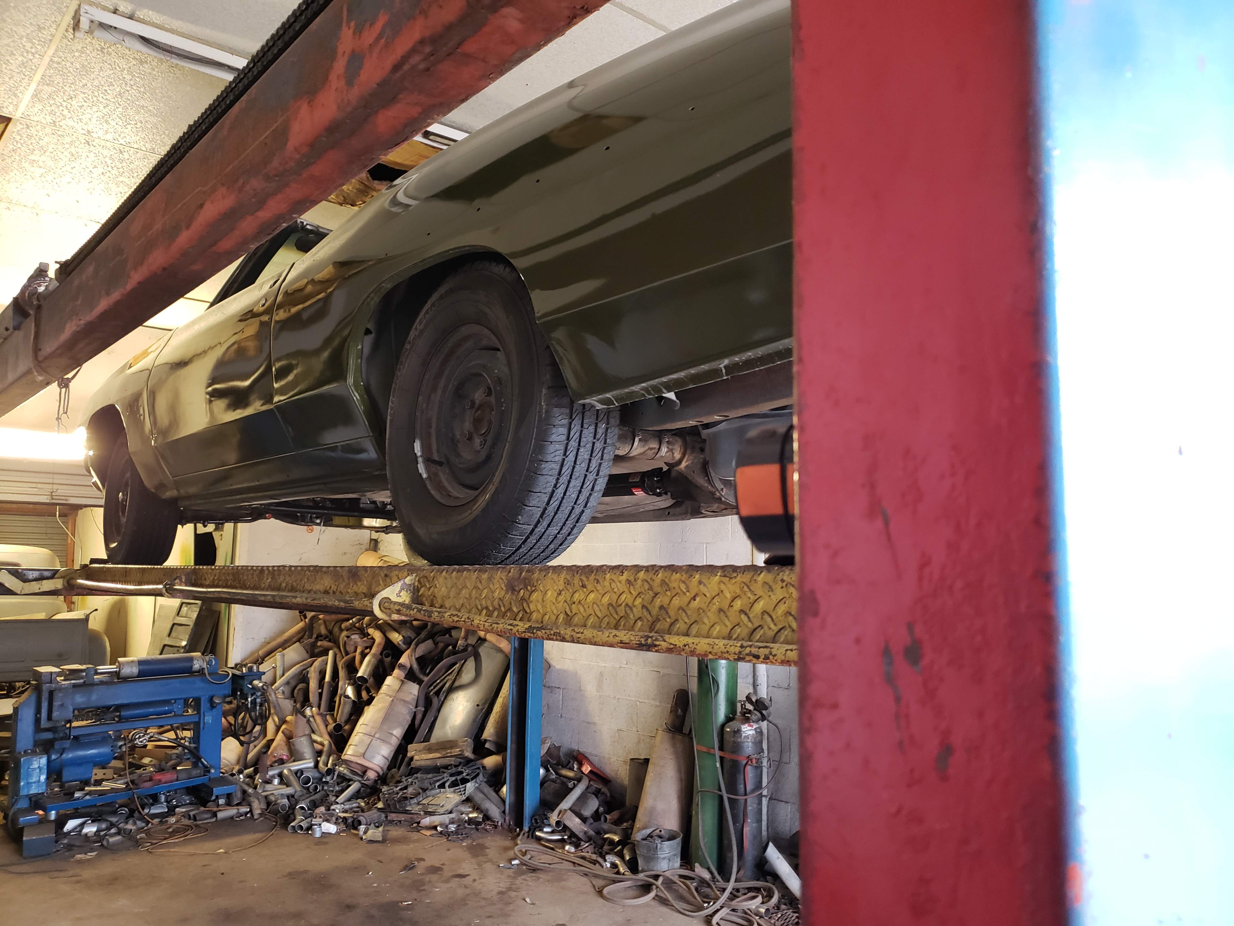

Hello,

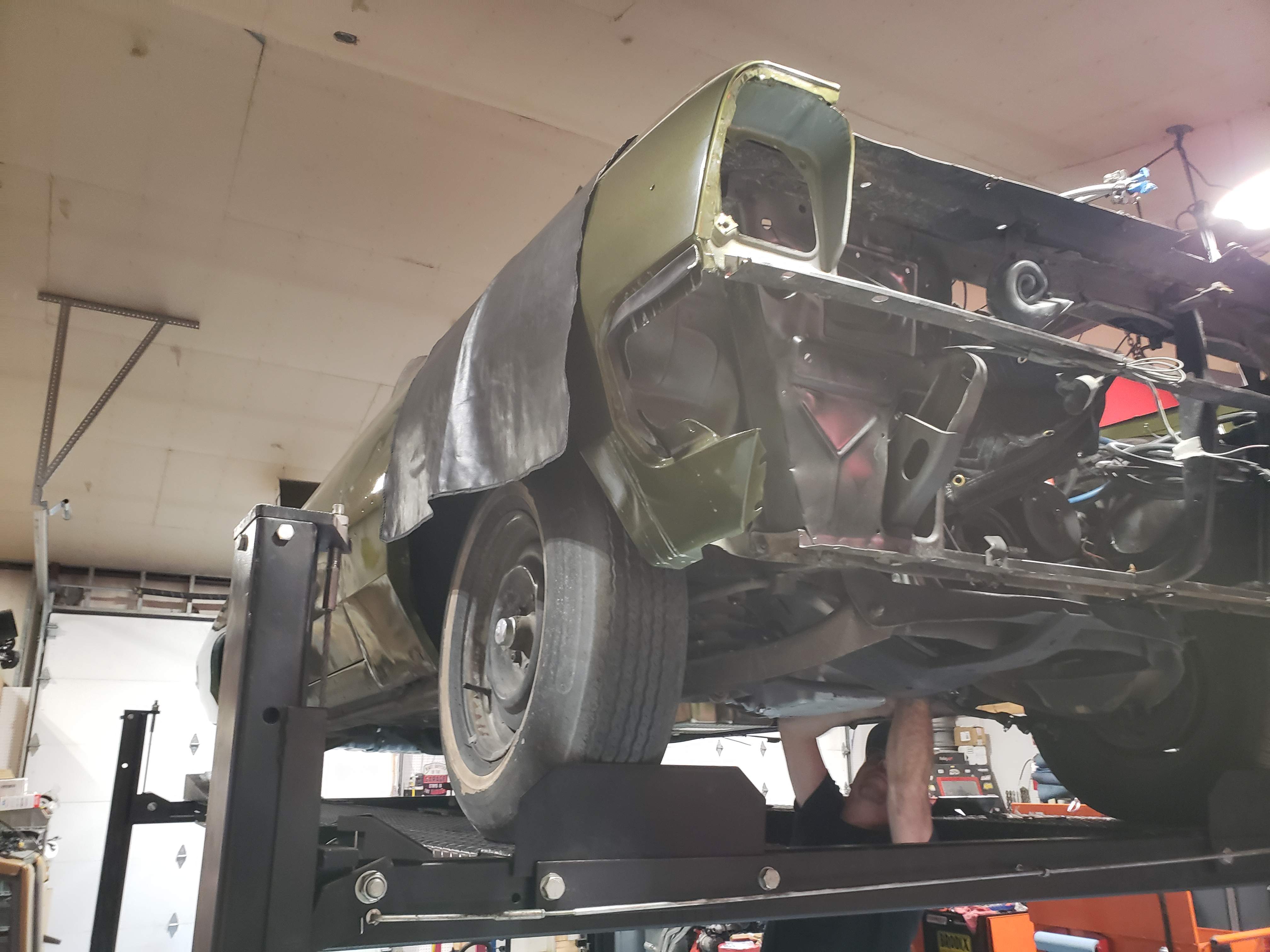

Some parts of this resto continue to go well. The car is now up on the rack getting a dual exhaust set of 2.5 inch pipes to dual Magnaflow mufflers and the car should be finished by tomorrow. Jason, the proprietor, is a great guy and will get it all done for $700.00 USD plus a generous tip from me. My stainless, eBay-acquired, Chevy S-10 LS-swap engine headers that I used here on the Catalina are already flanged at the collectors and with bungs for the oxygen sensors and Jason will not need to supply any of that. Saved me a hundred bucks. At less than eighty bucks with free shipping, I am over-the-top happy with these eBay headers - please see below. A steel . . . steal, I think.
eBay
No image preview
for LS Swap S10 Conversion Headers fit Chevy LS1 LS2 LS3...
CNC machine flanges with TIG and MIG welded construction. With bolt-on design easy to replace the original headers. These exhaust headers feature a lightweight design. Two exhaust headers with gaskets
My original paint place is right next door and will have space to store the Catalina until Monday when the painter gets going on a few paint correction places on the car. Hopefully, by next Wednesday, it'll be back here and I can start putting the car back together. Finally!!
No news from my upholstery guy. Still incommunicado.
Rick
