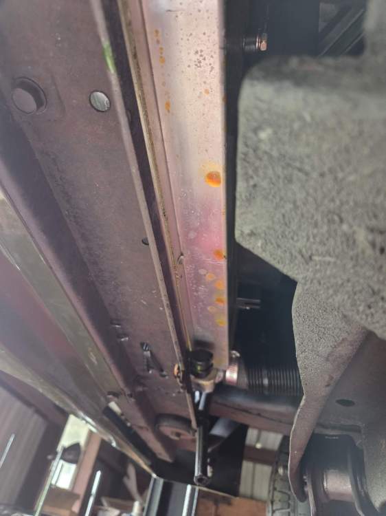

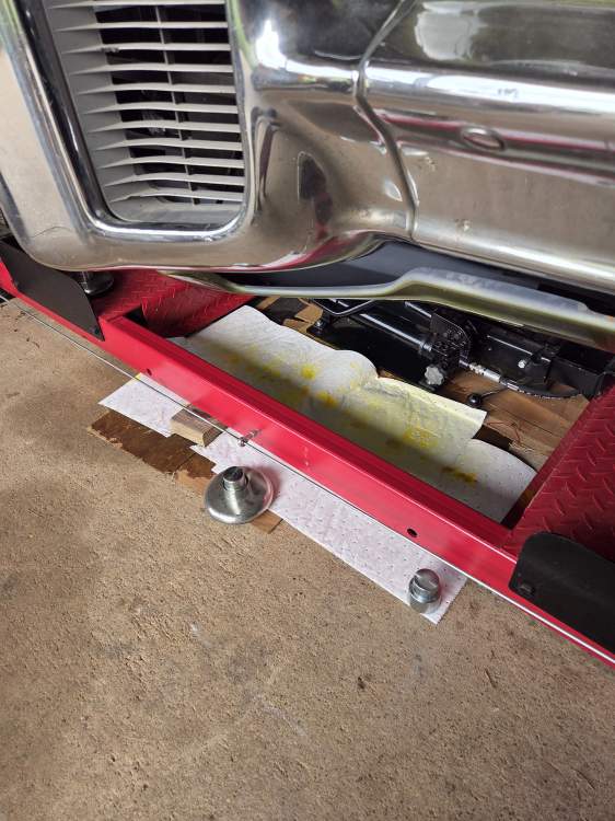

Hello,
A little late but as promised, pictures of my radiator that leaks like a sieve, especially once it warms up. I should have known to not buy the least expensive radiator but it bit me twice buying this one twice. Dumb, yes, I know. "Buy once and cry once" as they say around here and I shoulda' listened. The Dexcool coolant has some radiator dye in it that I added that causes the color change to yellow on the absorbent mat.
I will soon be a thousand bucks plus tax and shipping poorer buying hopefully a better radiator.
Rick

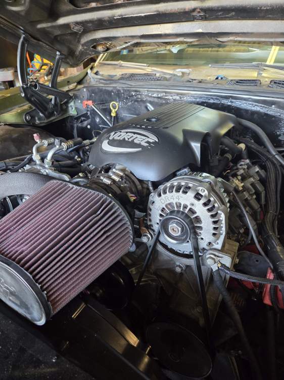

I finally got around to putting the engine cover onto the 2002 model year GM truck LS engine. The intake manifold had lost its M6 x 1.0 nut that could hold the engine cover down and a little JB Weld on a new metric nut solved that problem.
