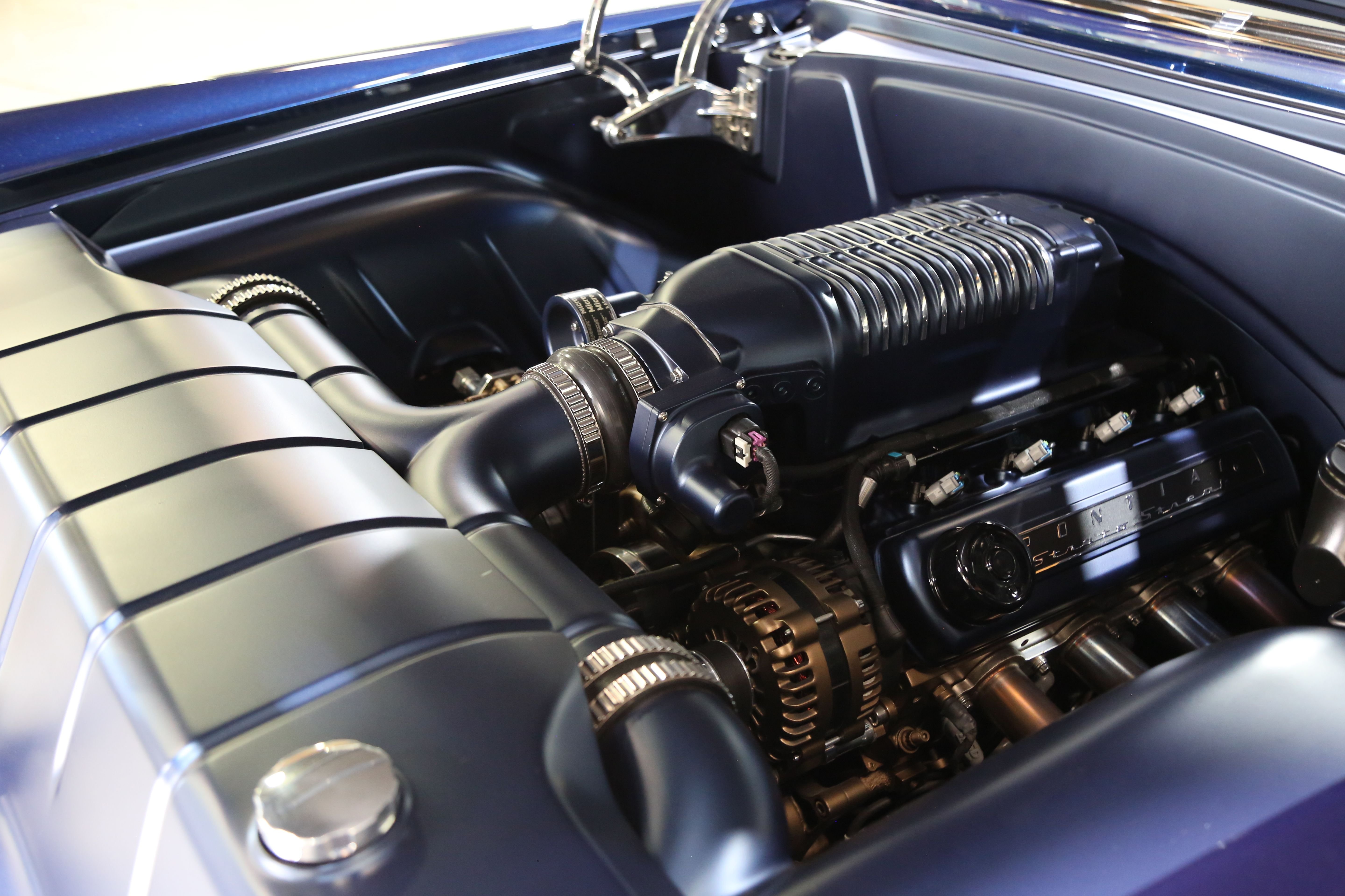

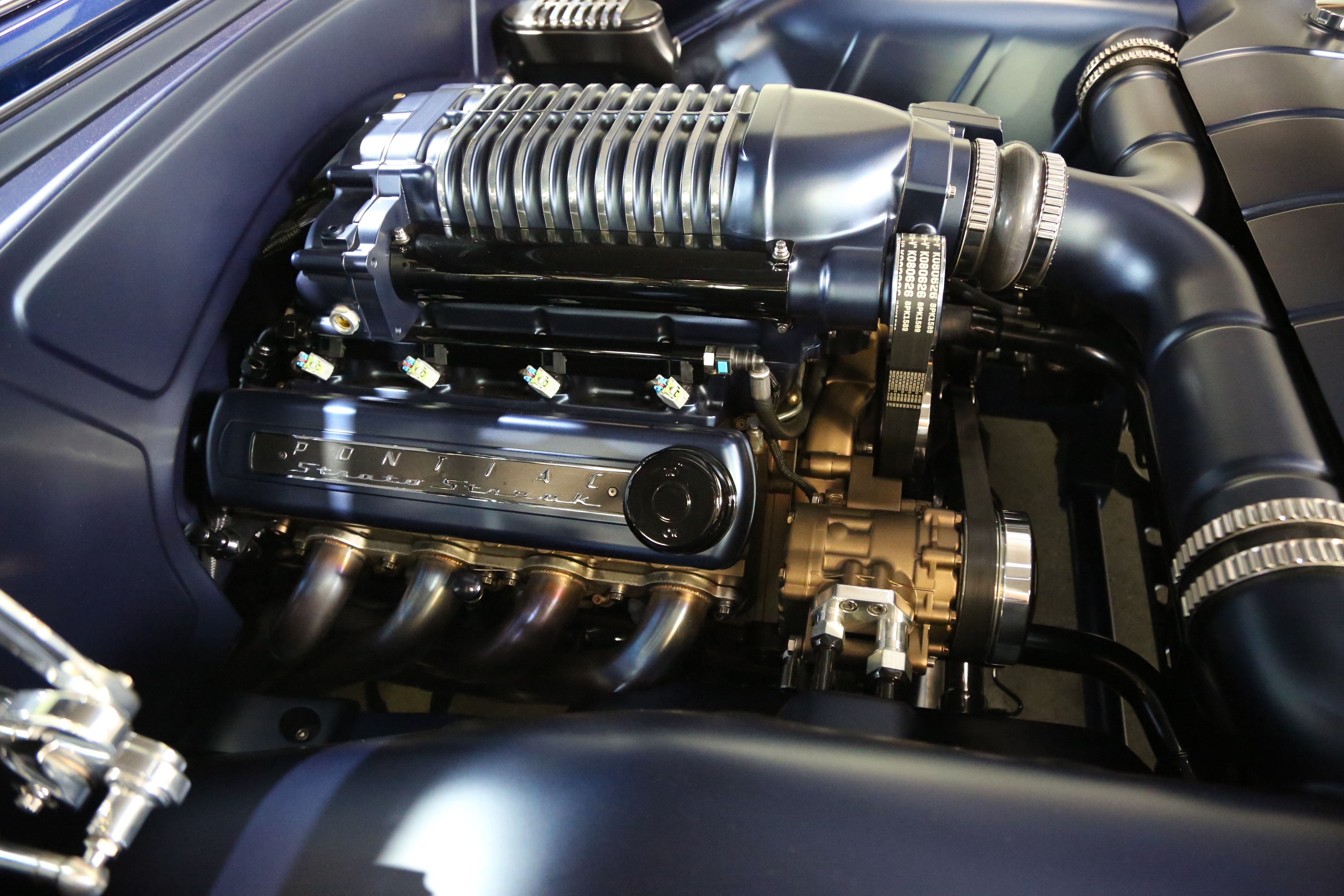

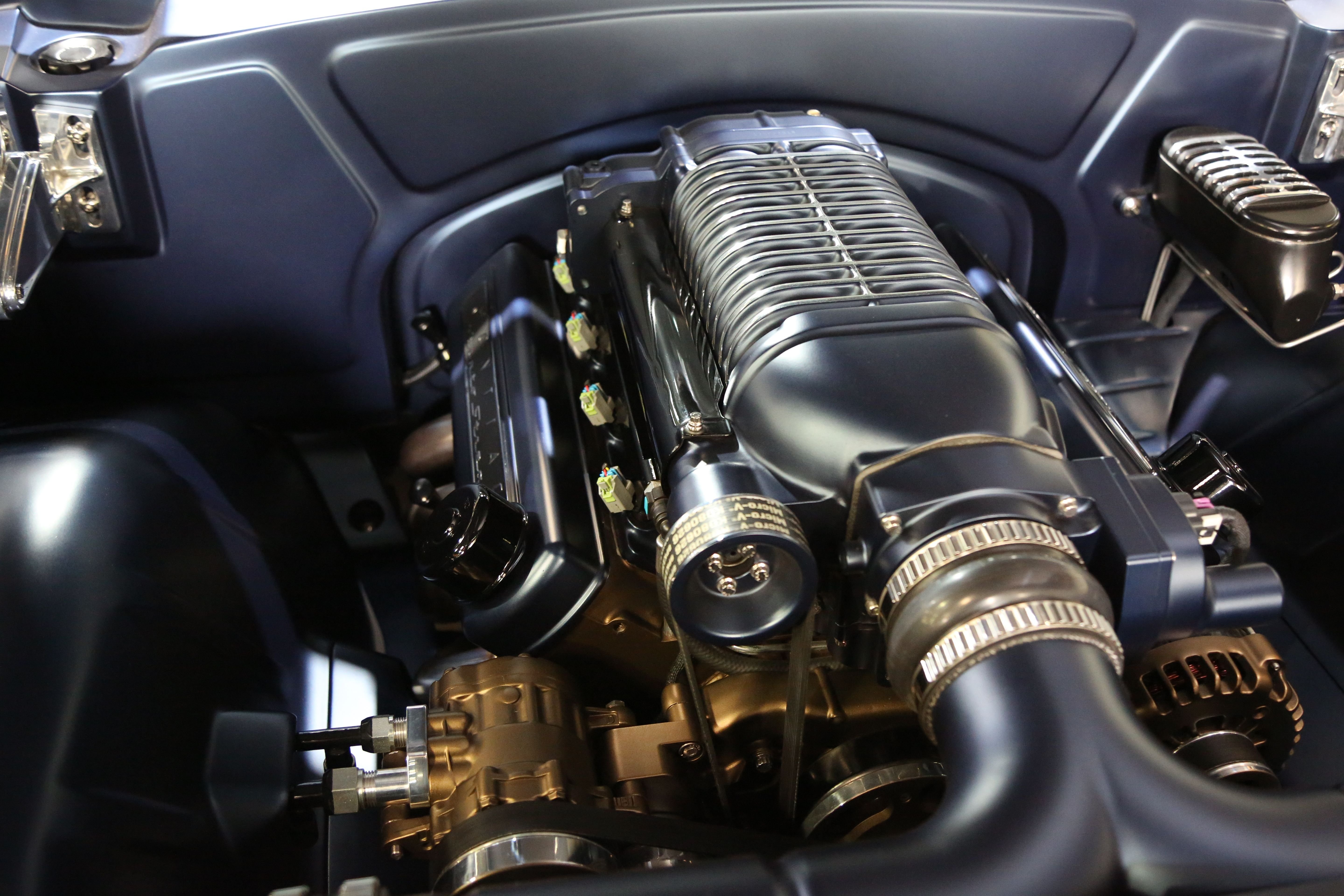

This is a 1956 Star Chief! What you want Is tucked nicely under the hood!
https://www.fusionmotorco.com/vehicles/839/1956-pontiac-star-chief-convertible-resto-mod
Oh! By the way, it’s 900hp!

1 hour ago, Last Indian said:
Kiwi, look at this a little at a time! I don’t want you to mess yourself :rofl:!

It is, it’s a LSX crate engine. Still not that much of a leap to get to the 389.

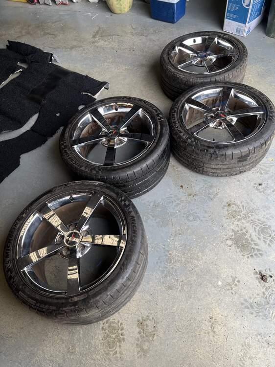

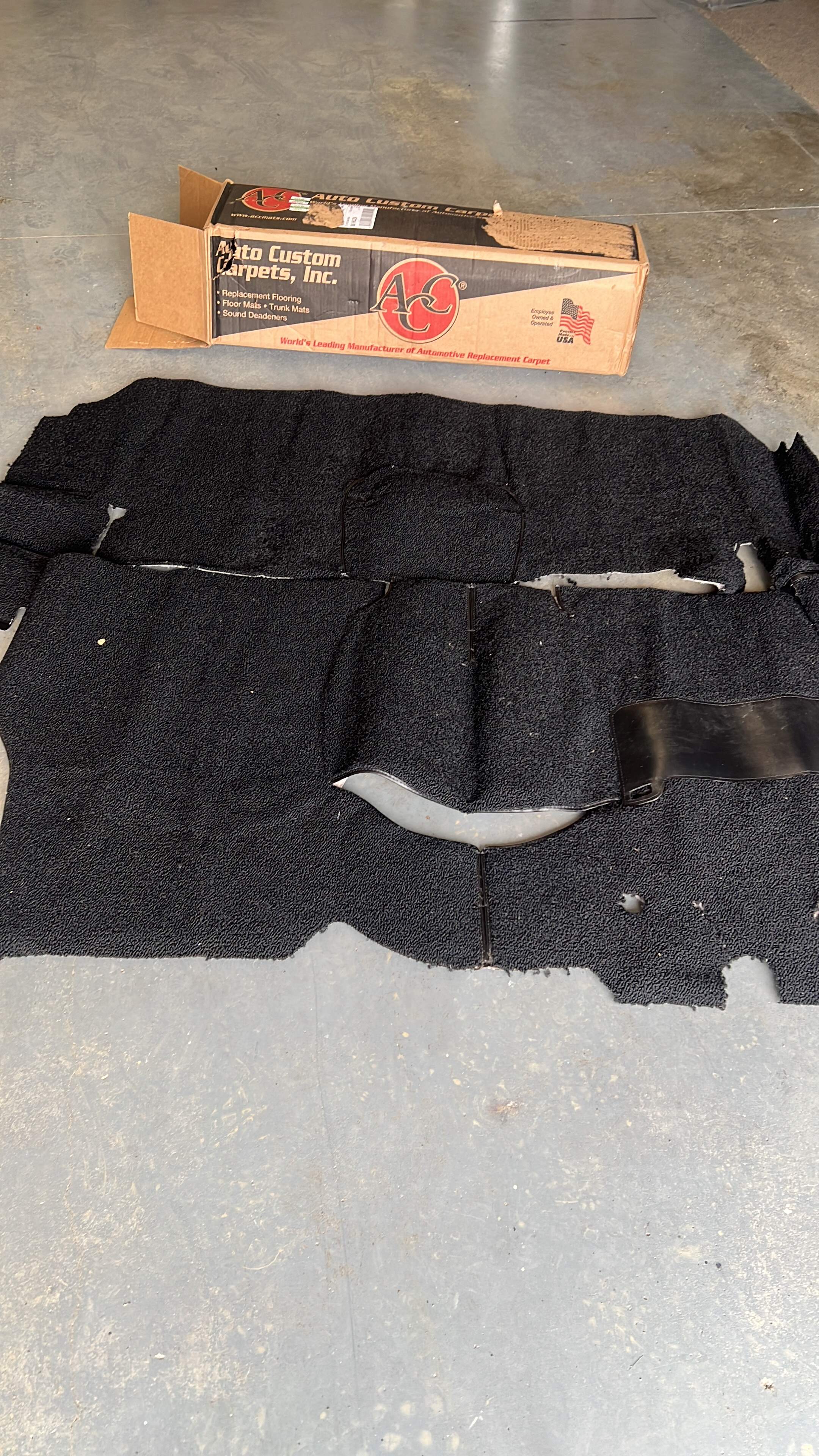

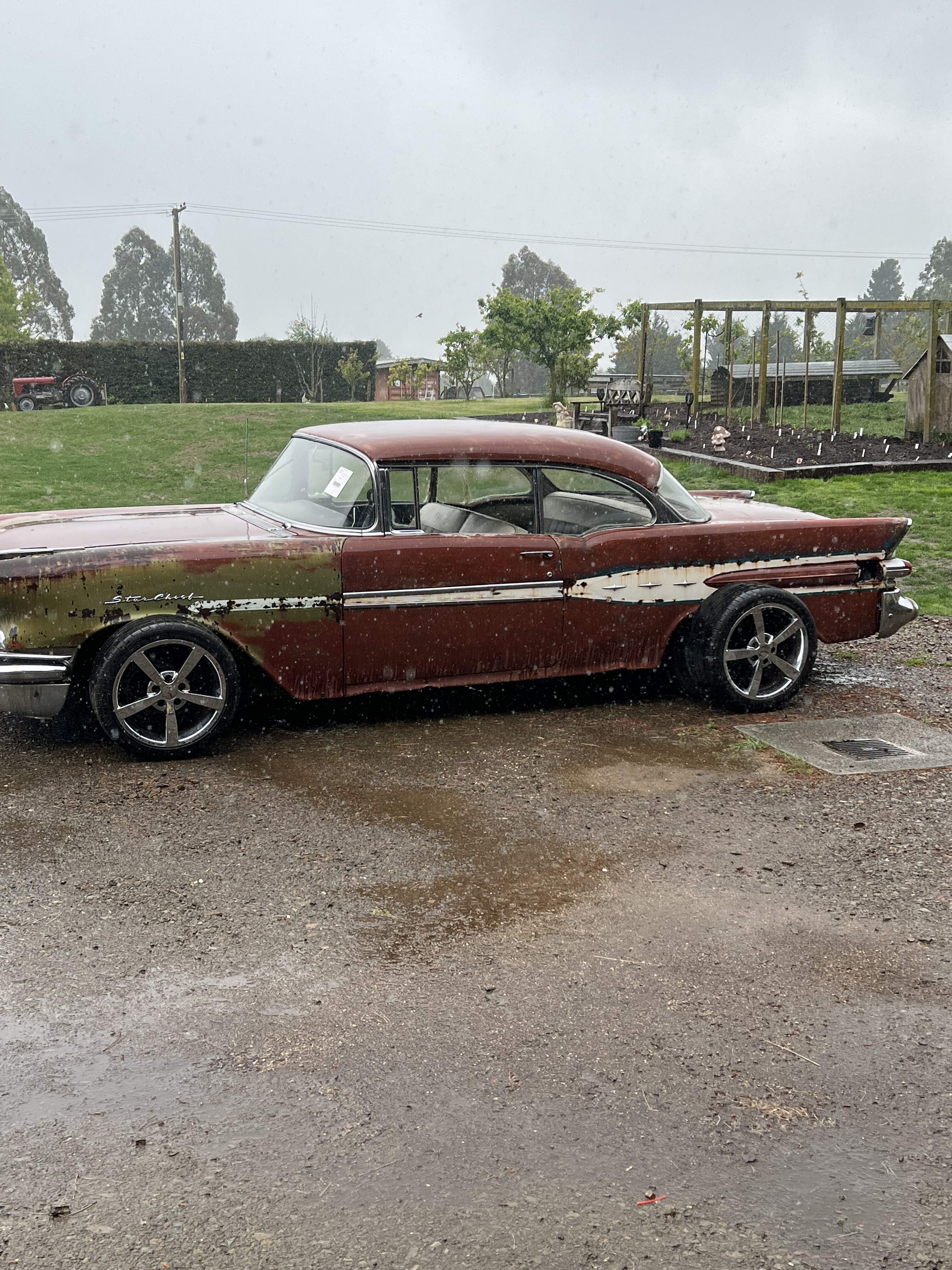

Scored some c6 wheels today along with a carpet set…. Not that I am any where near finish/details stuff but the price was right . As the guy bought them from rock auto and miss ordered … he needed 2 door sedan carpets and ordered 2 door hard top ones … his lost my gain 👍
The C6 wheels have the correct offset for my c4 suspension i will be using under the 57.
rears are 19x 11 and fronts are 18x9:cheers:
and should fill the fender openings well !

last Indian,, this is certainly impressive ! i really like the colour too!!
 i know its early days but.. i am a blue guy! more so than what the boss wants, which is red.
Things i note.... the custom fire wall looks very clean, and the super charger induction, even wayy more cool plumbing. i can make that !! but that pan in front of the induction over the top of the radiator !! now that with its negative detail beading... i am thinking how the heck did they do that !.. yeah ok a bead roller but with a radious bend in it too !!! wow !

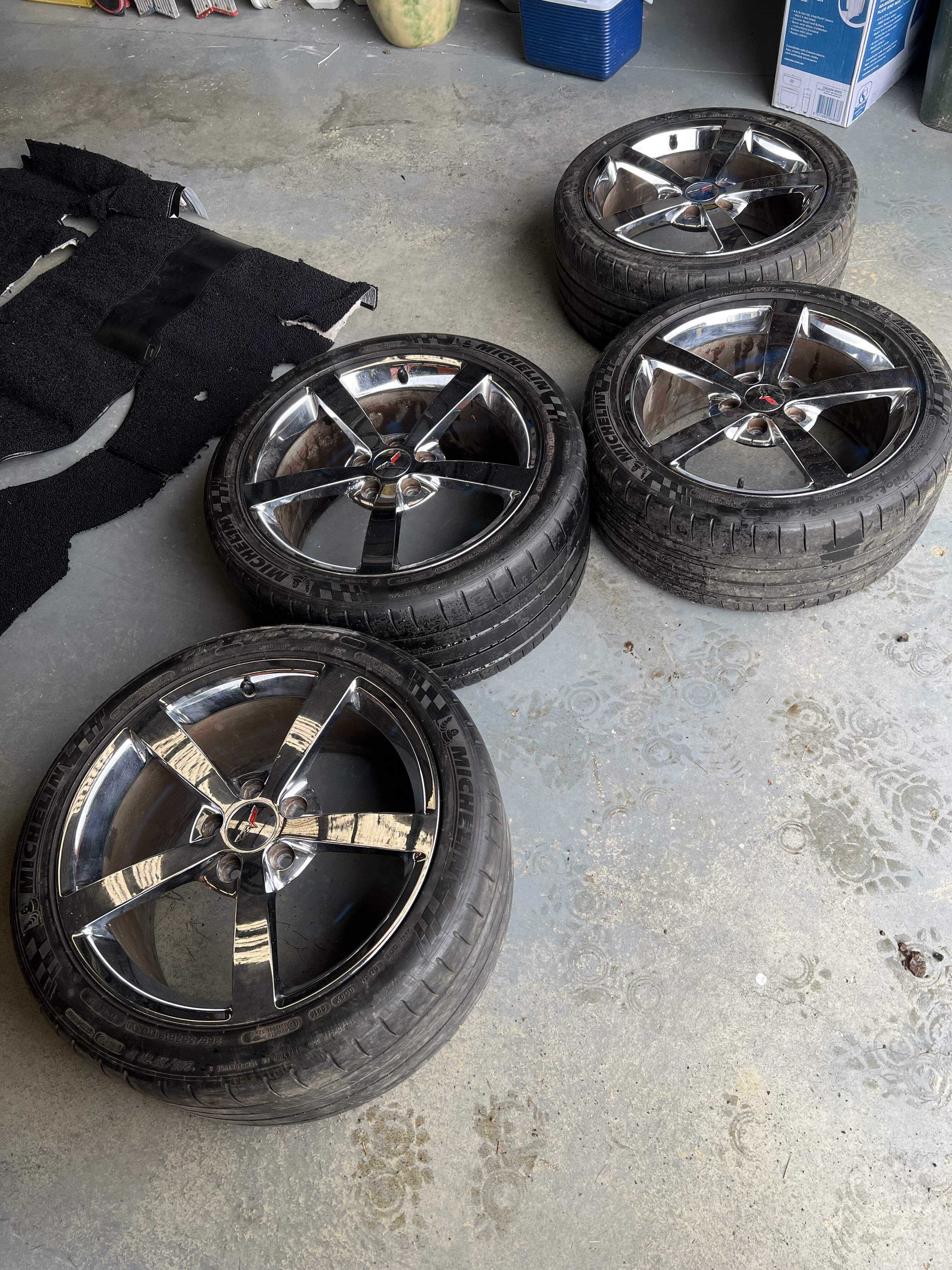

Grab stuff when you can, esp if it's a great deal.  Gonna need it sometime.
Wheels look cool! Now why don't I find stuff like that, as I could do with a new set of carpets.
