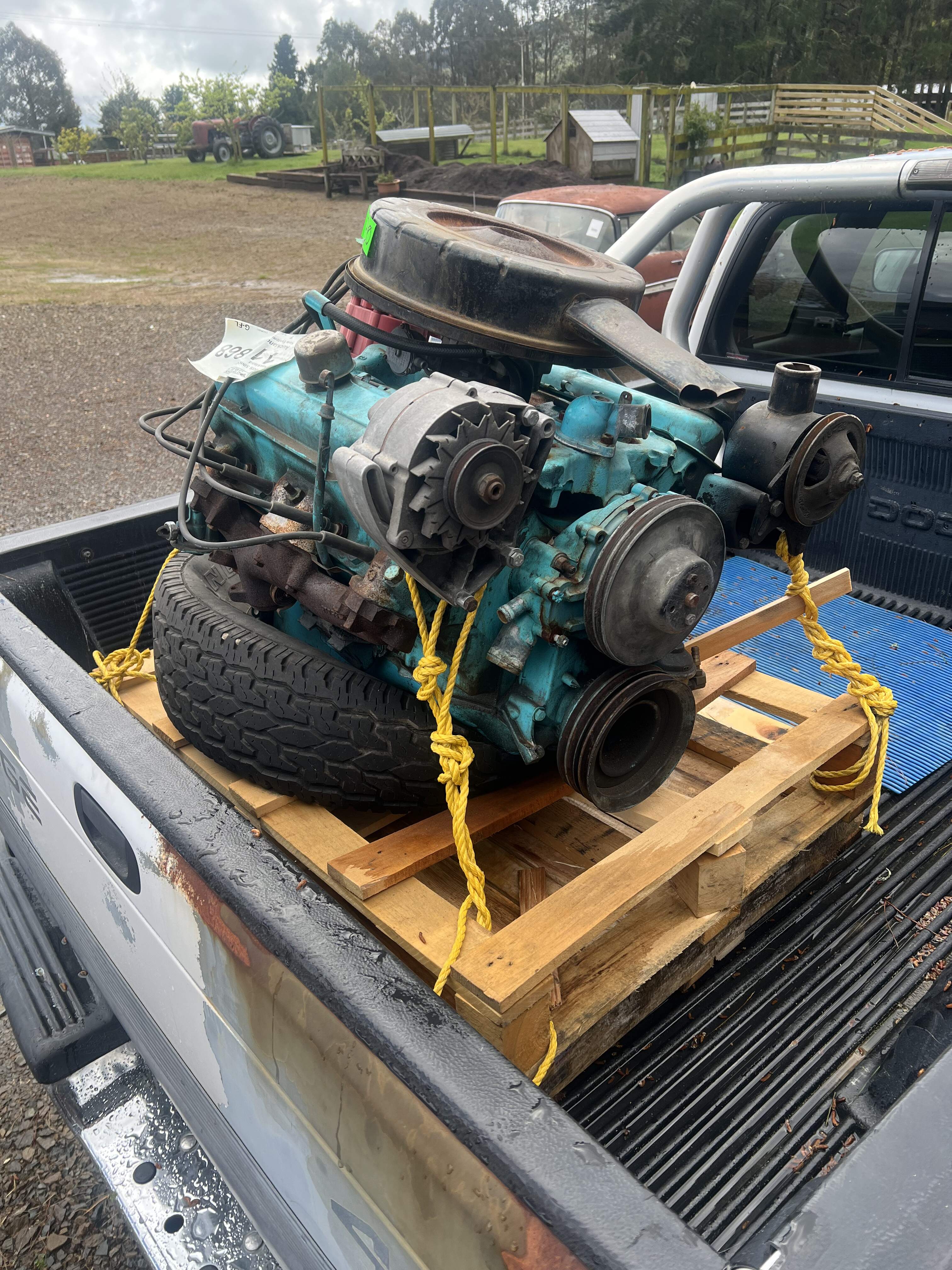

5 hours ago, Frosty said:
509395 should be the casting code but I can't validate it in the list of valid Pontiac blocks. It may also be the last digits of the VIN for the car it was installed in.
15H indicates that this is a 1963 389 267 HP engine installed a full size Pontiac with an automatic transmission and 2-barrel carb.
Great info Frosty ! that engine number doesnt match up with Dwights vin, but the year does ! :dancingpontiac:

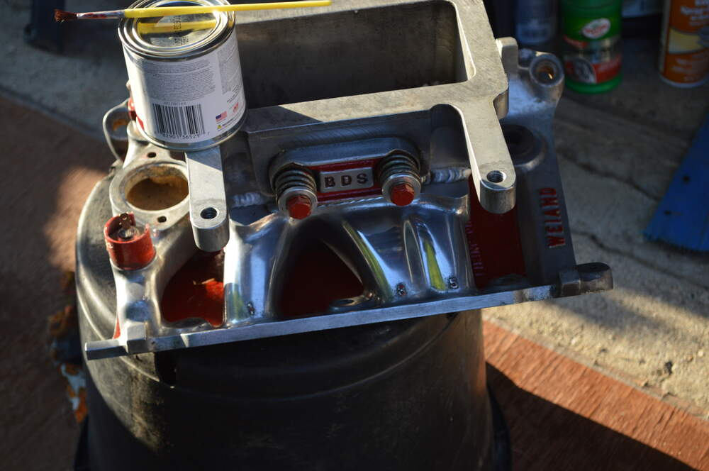

These are my boys right here!!!   BDS   They cut down and welded on a blower plate to my intake to make it happen.  Then worked out vbelt and blower pully's N spacers.  Contact them, as I can't find anything for a 389.

You can see where BDS cut the top off my intake and welded on the blower mount. Notice the spring loaded blowby plate in case of backfires you don't have the spectacular launch of the blower  AKA NHRA....:driving:  Maybe you can contact some of these other supercharger manufactures about doing the same for you.  B&M sells a kit for Chev small block maybe you could cut that one and weld it on a Pontiac aluminum intake.  We can all keep an eye out for solutions, it's gonna be a long time before you finish the body, chassi, interior and start worrying about your engine upgrades.  :dancingpontiac:

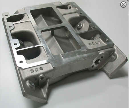

Perhaps you can adapt one of these BDS Pontiac intake manifolds to a Whipple or Easton supercharger by building some sort of adaptor plate.
https://www.blowerdriveservice.com/BM-7007-400-455-PONTIAC-V8-671-871-UNPOLISHED-INTAKE-SATIN_p_281.html
https://www.blowerdriveservice.com/BM-7007P-400-455-PONTIAC-V8-671-871-POLISHED-INTAKE_p_609.html

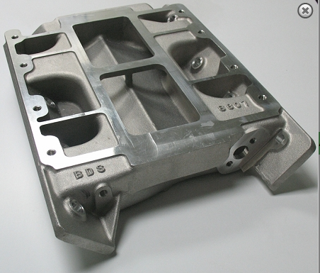

Exactly what I'm talkin about.  The base for the B&M could be welded right to this or ANY manufactures aluminum intake.  Watch the swap meets.
Wow that could work !!!
and it looks like I could drill each port and weld in a sleeve for each injector too !!

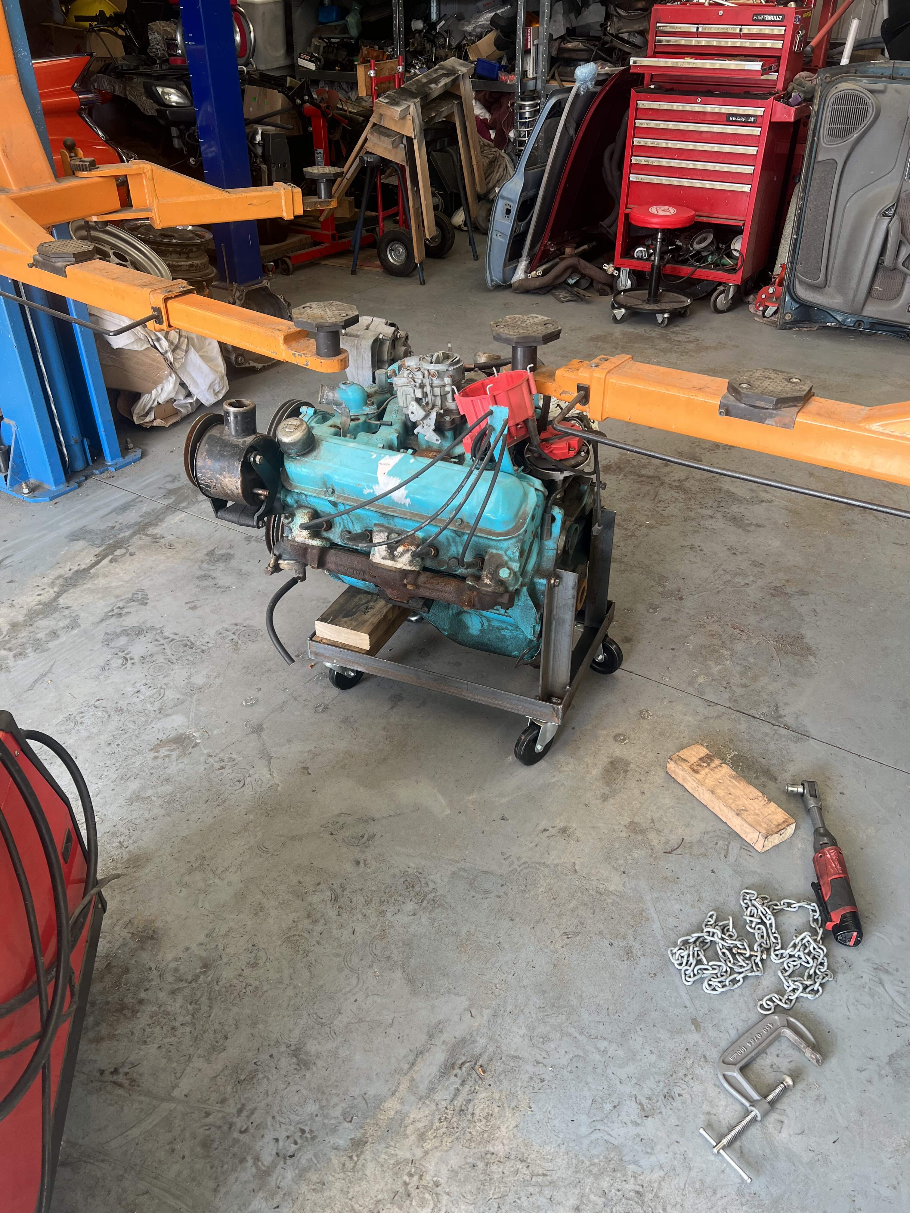

I have spent the weekend working from the beach
and got home Sunday afternoon
and had just enough time to lift the 389 off the Ram , build a roller frame to move it around the workshop … note to frosty !!
another use of a 2 poster mate !! Lifting stuff !!! :cheers:
