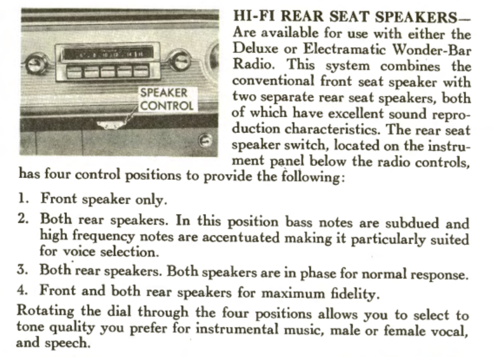

Chris, I had to go out and take a look at my dash to see what the wheel is for, but it is not on mine, and has a blanking plate instead.
2130223179_Speakercontrolblank(Medium).thumb.jpeg.a96b8242926316d8e02369ebf1b70b0e.jpeg
It intrigued me so much that I had to track down what it is, and found this in the owners manual.
Learn something new every day.

That controls the hamster in the wheel. In the absence of electronics and turbos, Pontiac fitted an auxiliary 'Power Hamster' next to the engine to provide an additional burst of acceleration when required. The hamster's output was governed by that wheel. Your hamster is long gone, but Ames sells new larger ones that are full of hormones. Ol' Chieffy is gonna fly.
What do you mean I've had too much coffee???
Haha love it fitzy !!! Hamster aye !!! :rofl:
Thanks to Russel we have the answer as to what it is !!!:cheers:

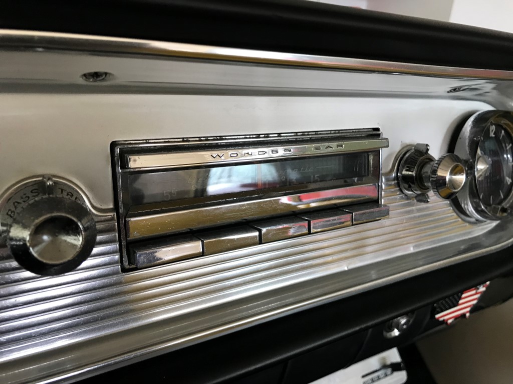

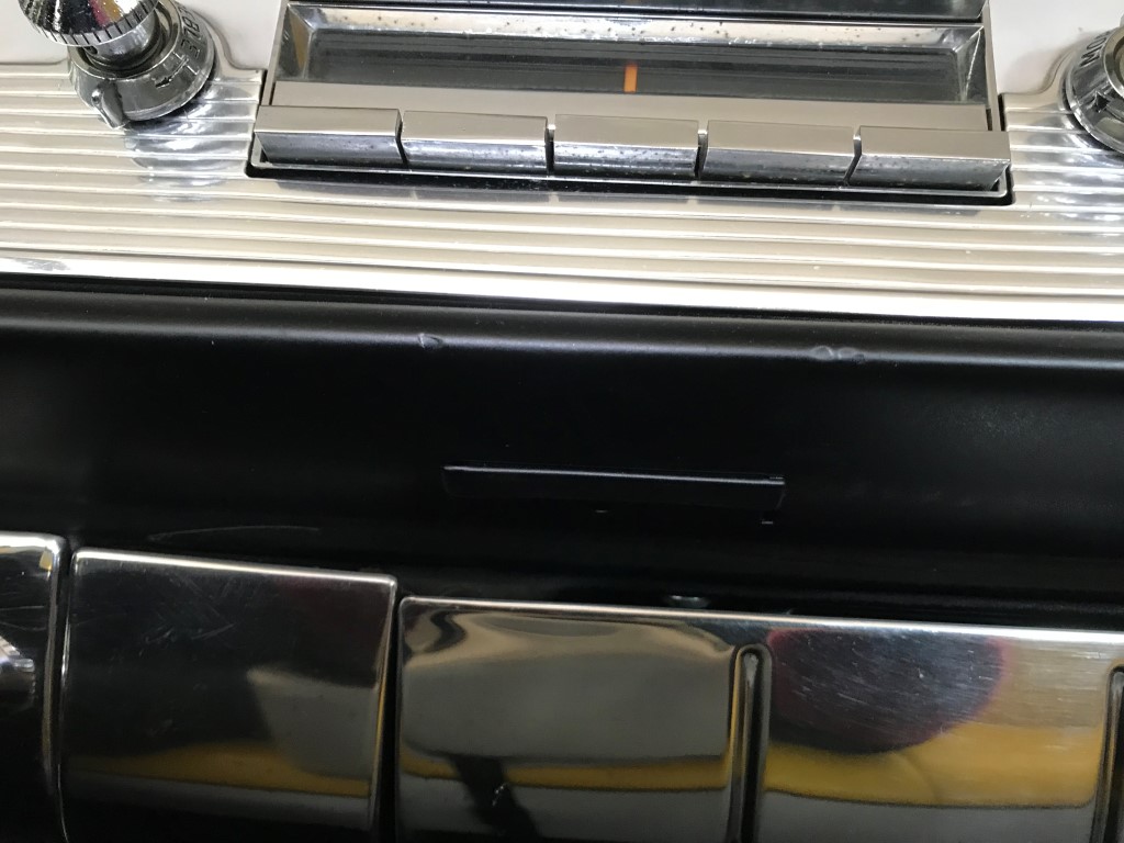

Russel, can you show me a better picture of your radio ?
i see your car has the chrome glove box/ ash tray area too ! i have seen some that are justA painted ! not sure why ...option wise yours should be top shelf ? mine not so ?
That's interesting. My Grand Prix came with a speaker switch (Verbra Phonic I think) and it changes sound characteristics of the single rear seat speaker. I pulled that switch out when I removed the dash and marvelled at the ancient electronics that made it work: turns of copper wire, magnets and all manner of doodads. Needless to say, it was rooted along with everything else inside the car.
For our American viewers, 'rooted' means f@#&ed.
Chris, the radio is a Wonderbar, which was the top option in radios for both Pontiac and Chevy. It has a flip down front where you can preset the station, so when you push one of the five buttons it goes straight to that station rather than turning the knob. In saying that, mine was toast when I got it, so I stripped the back off it just to keep the cool looking façade, and have a stereo in the glovebox.

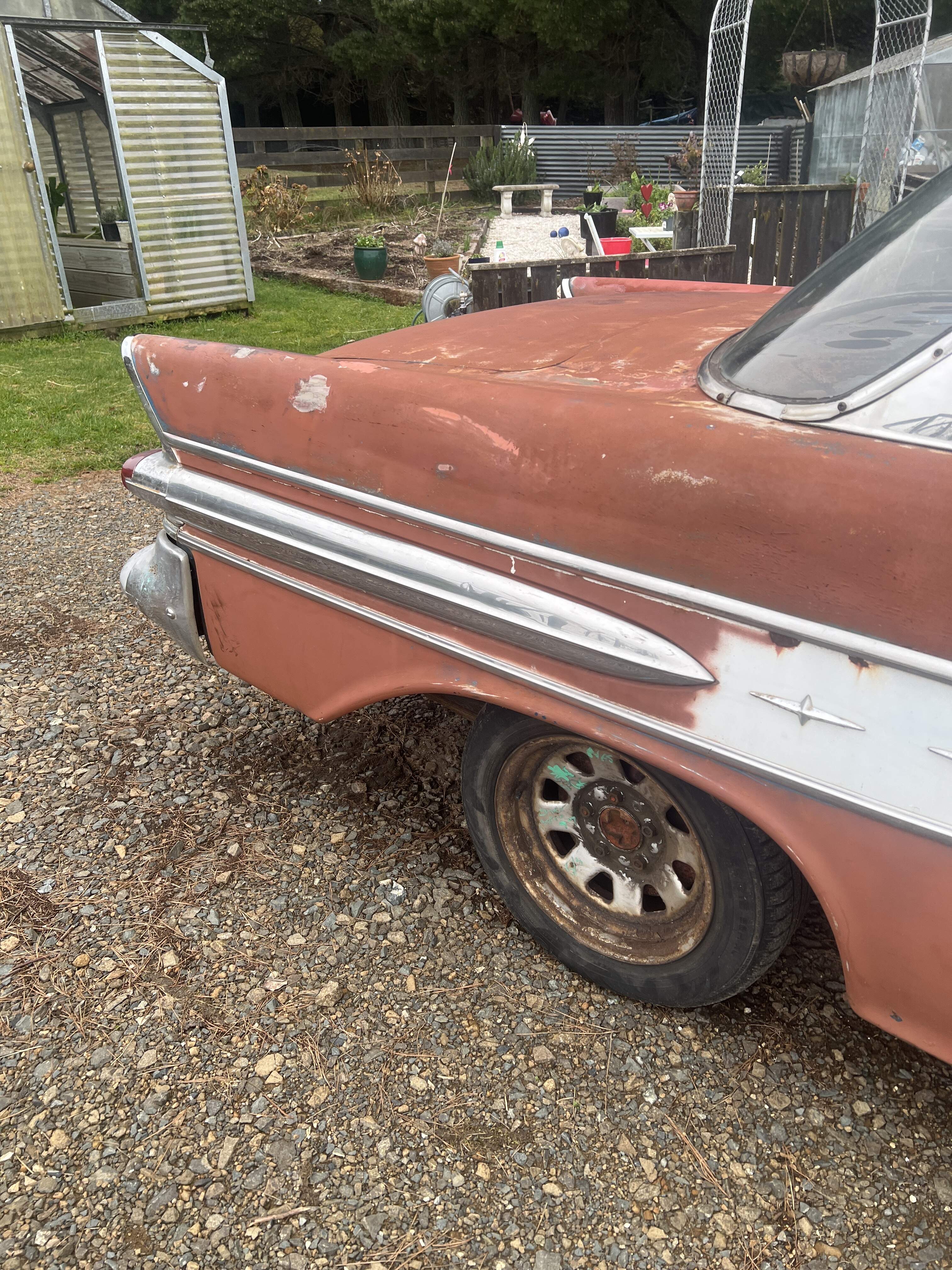

oh good spotting Russel!! i thought it must have been a option along with that speaker dial.... but what about the rear fender trim!!!
my chieftain has chrome bullets behind the 3 stars ????? justA like your star chef ??

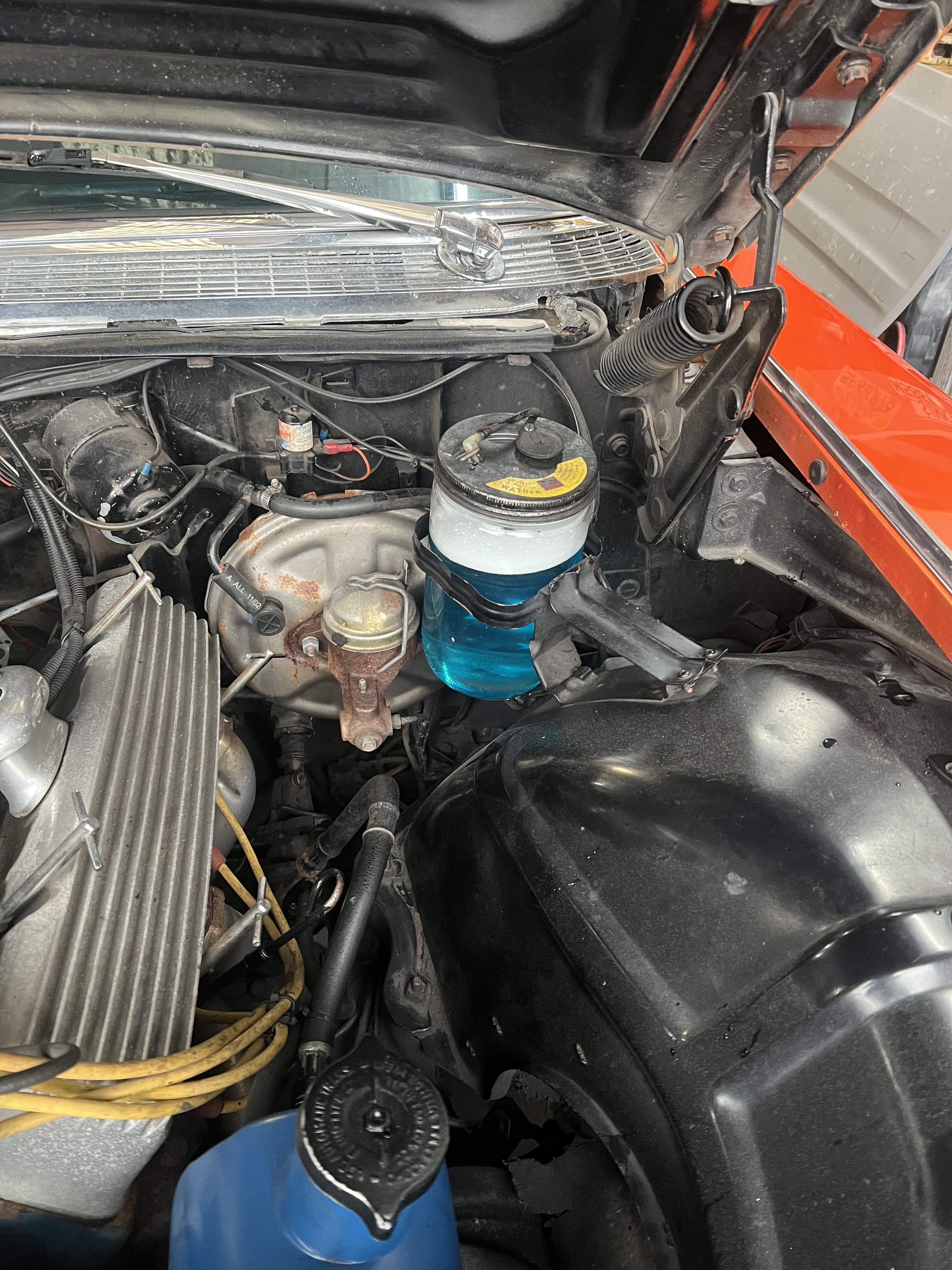

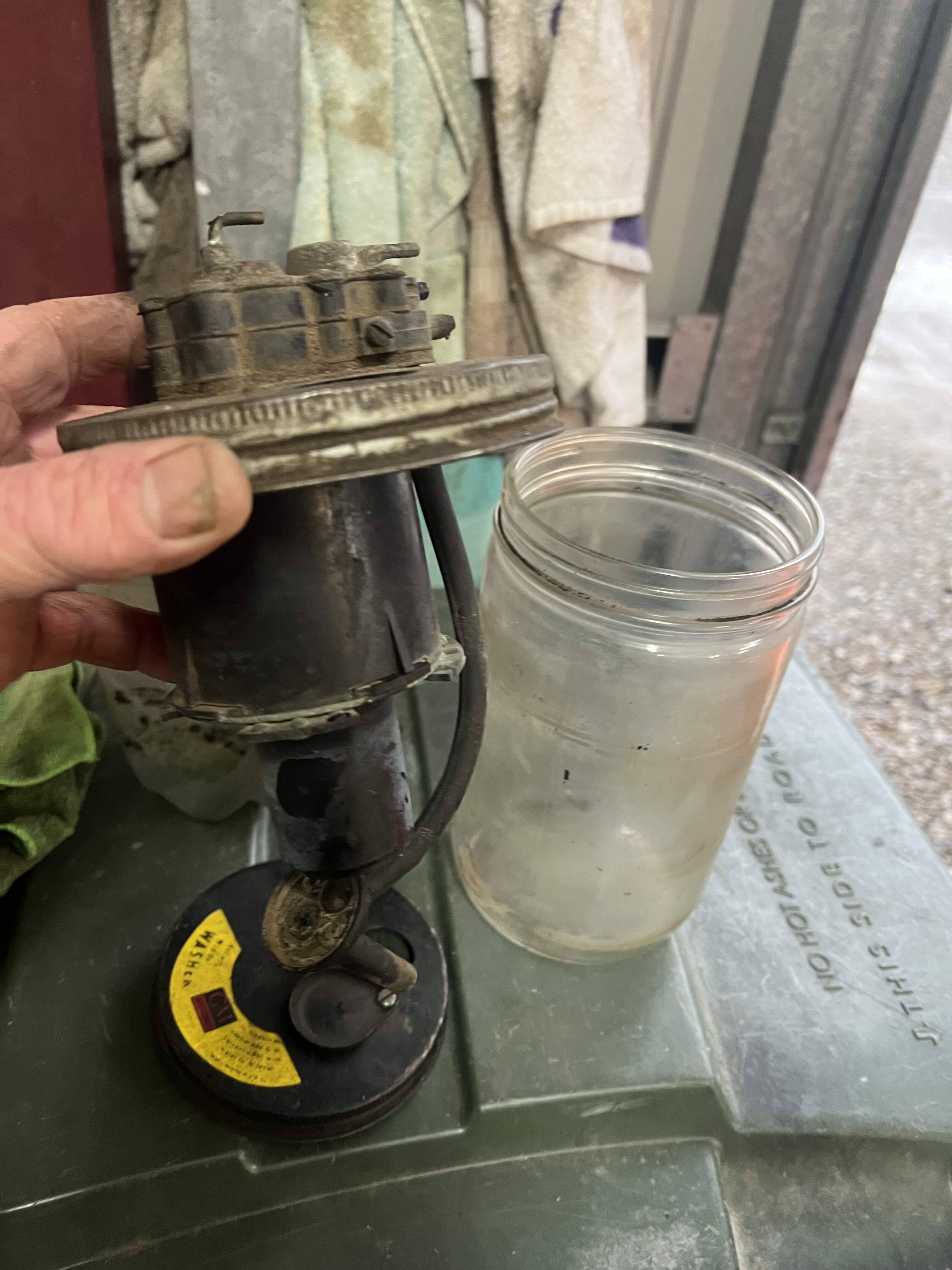

Guys check out this glass window washer bottle I found in the 57
does anyone know if it is a Pontiac item ?
Why I ask is I am missing the bottle in my 59 caddy
and it looked so similar to the lid that I have in the caddy … it justA had a plastic fizz bottle under it
so I Tried the caddy lid on the glass bottle and it fits !!
so guess where it lives now !!!  :rofl:
i am getting the 59 ready for a warrent of fittness as we have snow run this friday ! and i did need the washers to work to comply!

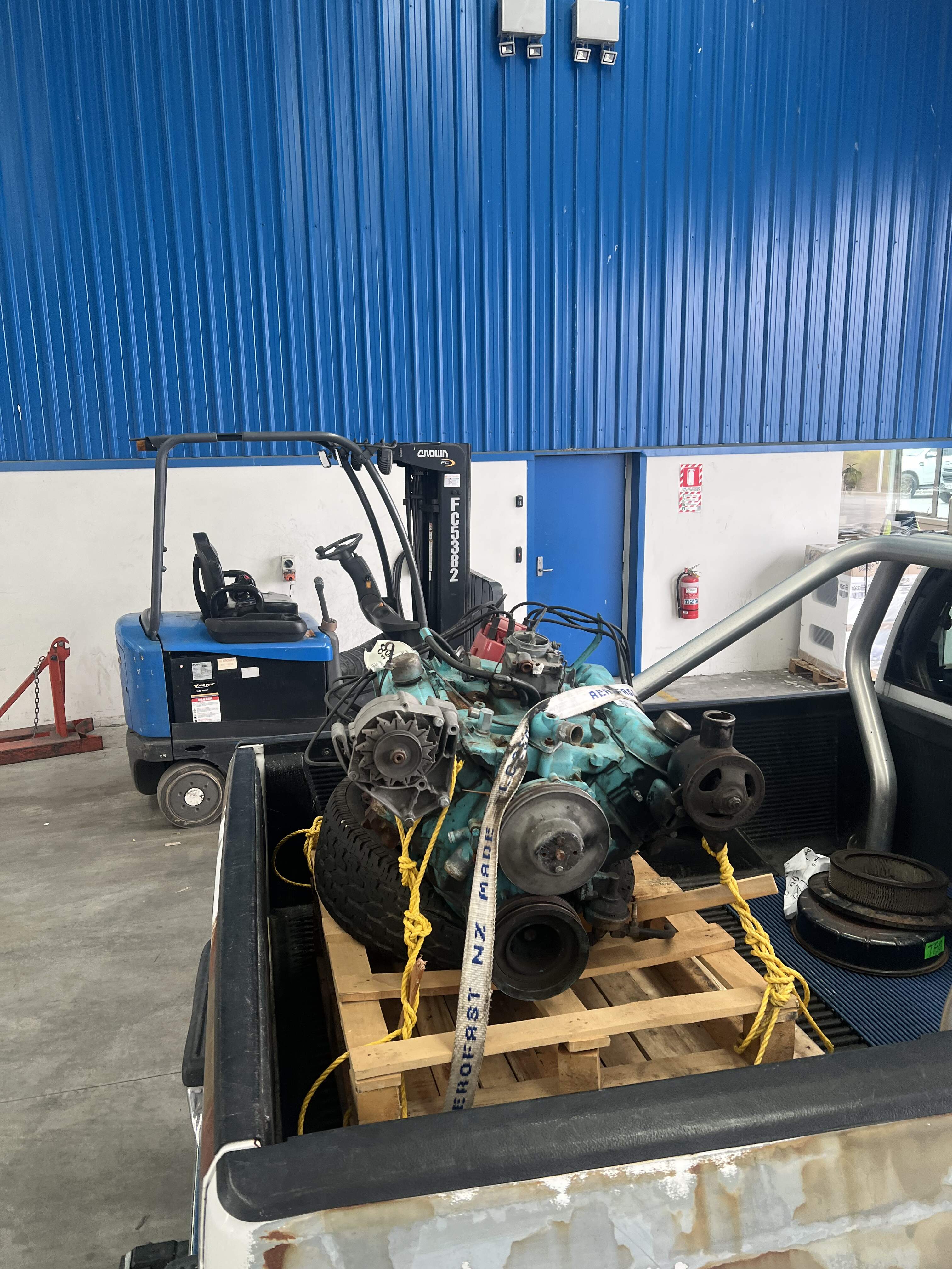

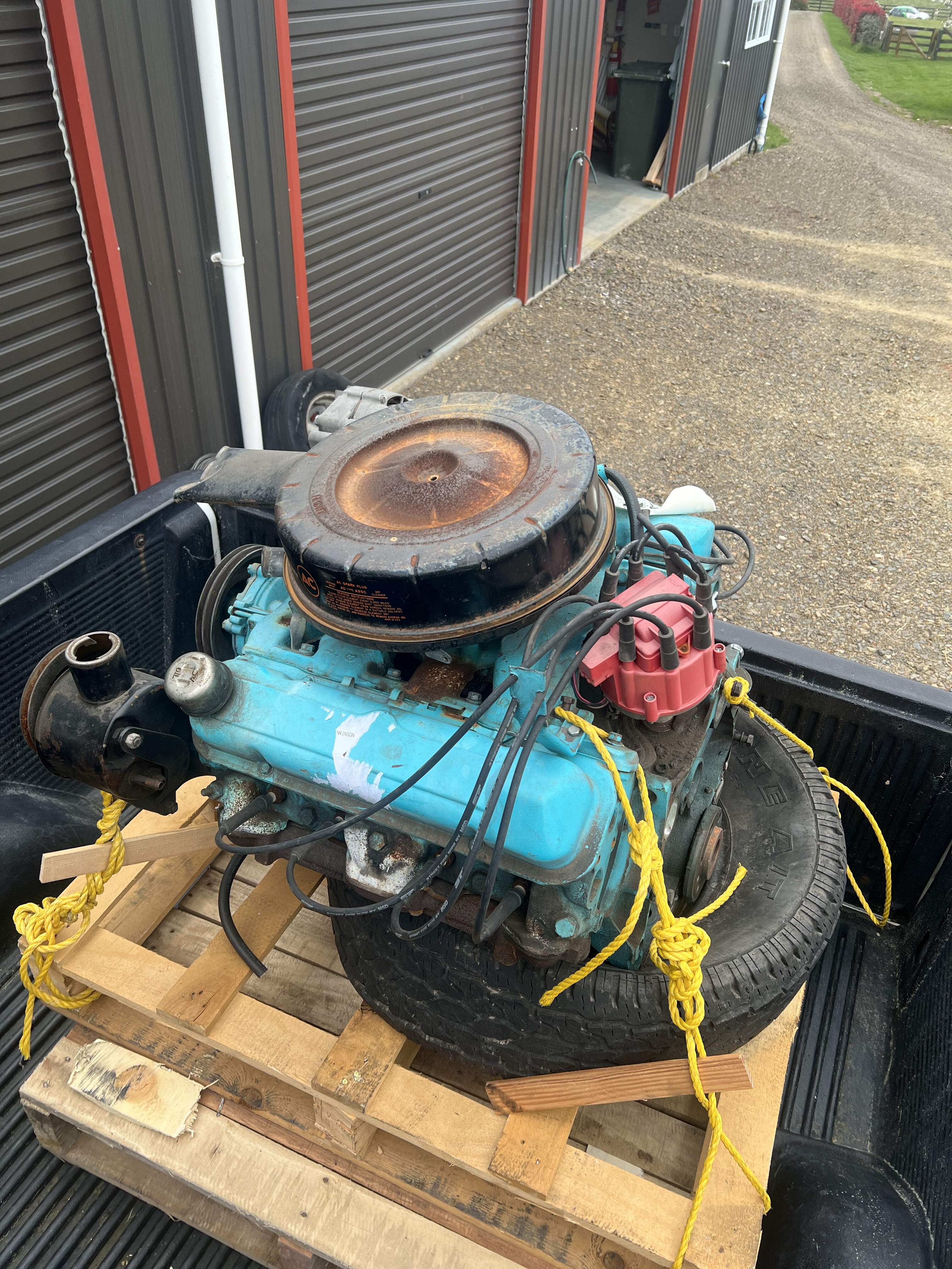

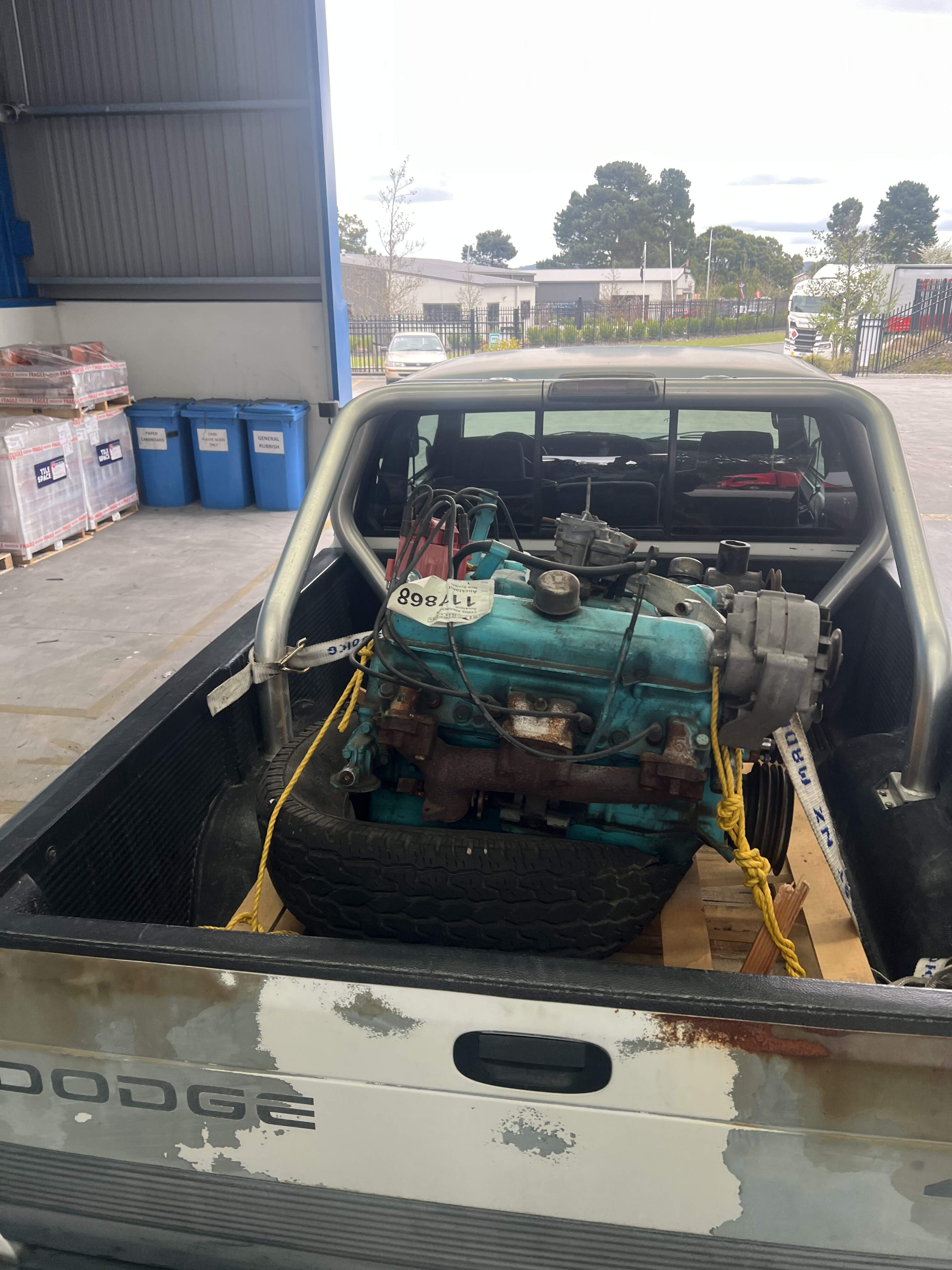

Check it out guys!! this is the next part of my jigsaw puzzle, and it was kindly supplied by Oldguy 44 !!!!
Thank you so very much Dwight!!!:cheers:
So long story short Dwight had pulled this motor from his 63 convertable and i asked if i could have it for the 57 project!! :dancingpontiac:
Now the plan.... its the base for my stroker motor, it will be fuel injected and i am really keen to add blower. so all new internals and i need to do my research on where i will get my stroker kit, roller cam, roller rockers, blower and efi from... i do have some ideas but i would really appeicate any of you out there that have built a engine like this, too give me your thoughts.

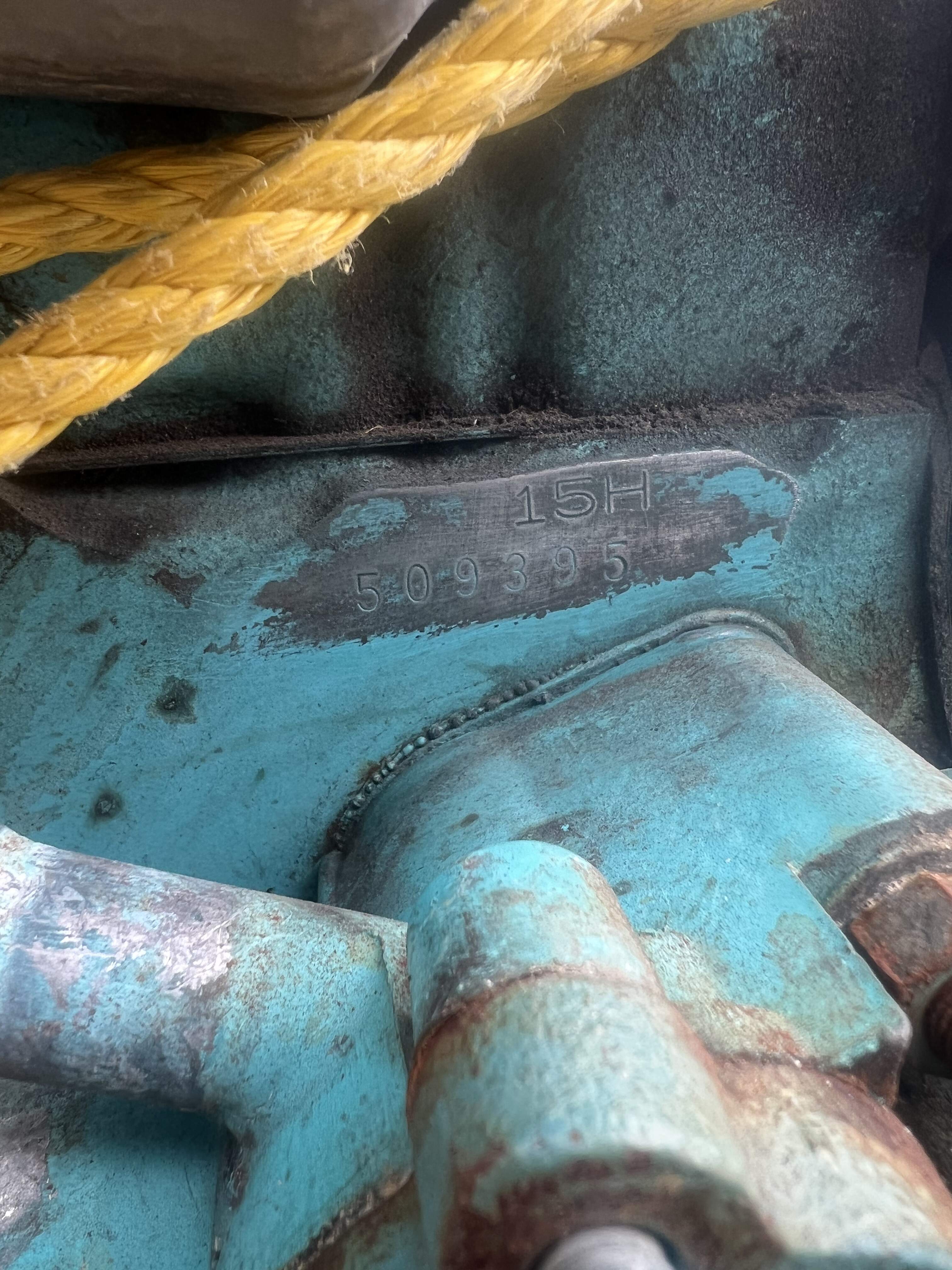

here is my engine number, does some one have the decoding for it ?68EBA885-3272-4A7C-836C-A19EC7C1AAD2.jpeg
So funny to think it traveled all that way tied to a pallet.  Very cool.  :pontiac: Then again, your starting car season and we are into fall.
509395 should be the casting code but I can't validate it in the list of valid Pontiac blocks. It may also be the last digits of the VIN for the car it was installed in.
15H indicates that this is a 1963 389 267 HP engine installed a full size Pontiac with an automatic transmission and 2-barrel carb.
There are numbers also by the distributor hold down bolt on the intake.  Forget what they are for.  May not be correct as the intake could have been replaced at some point.
