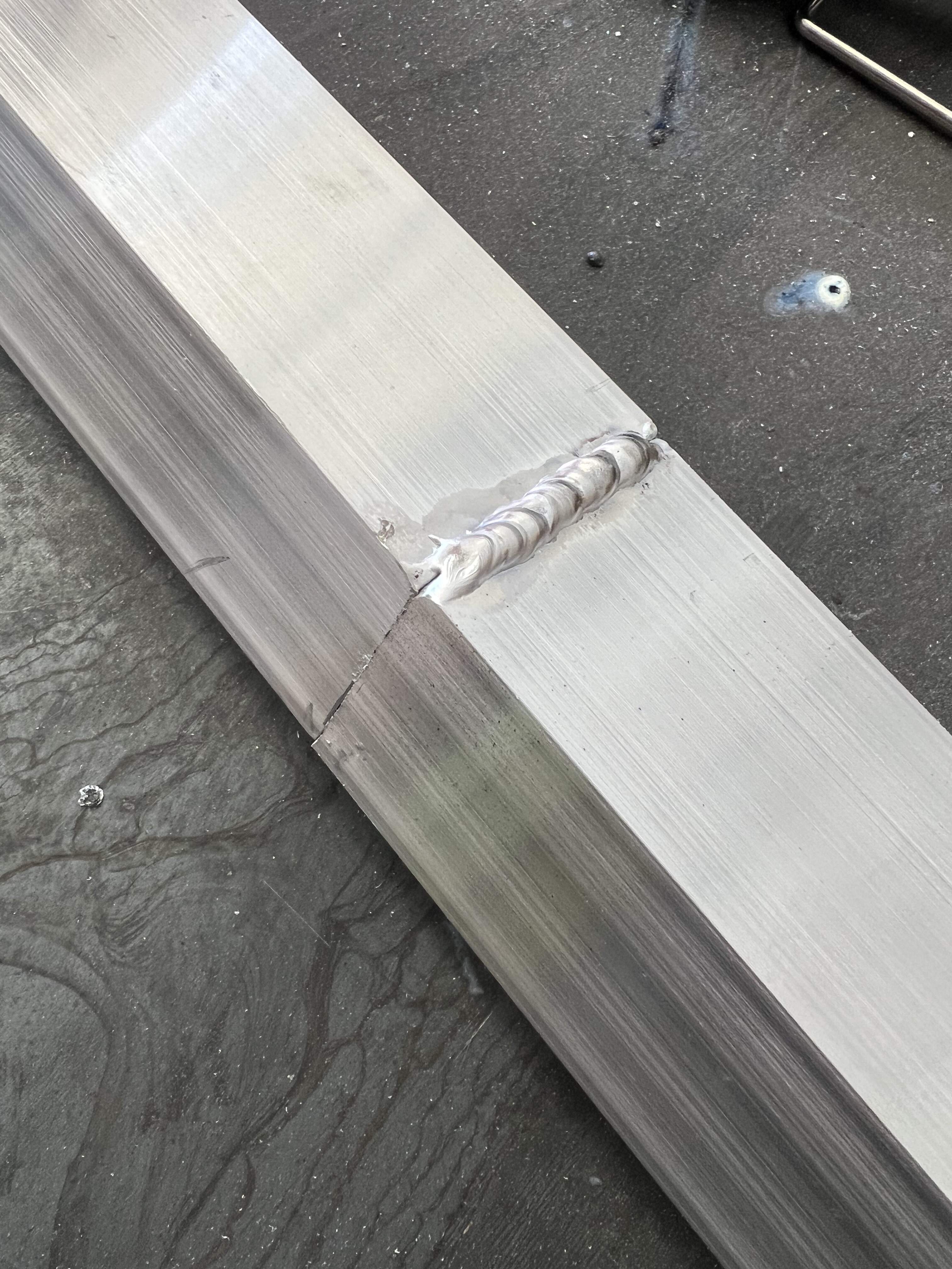

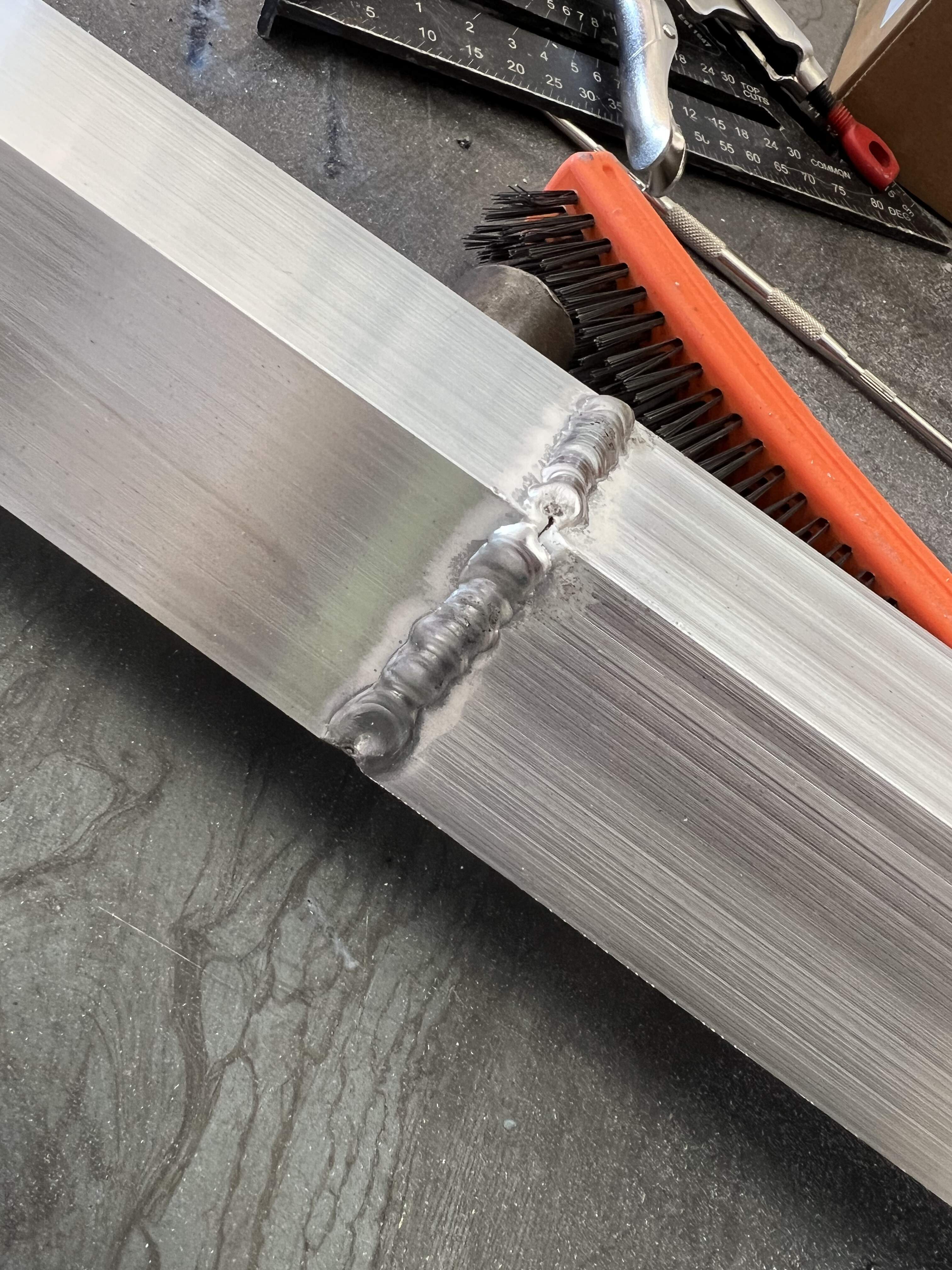

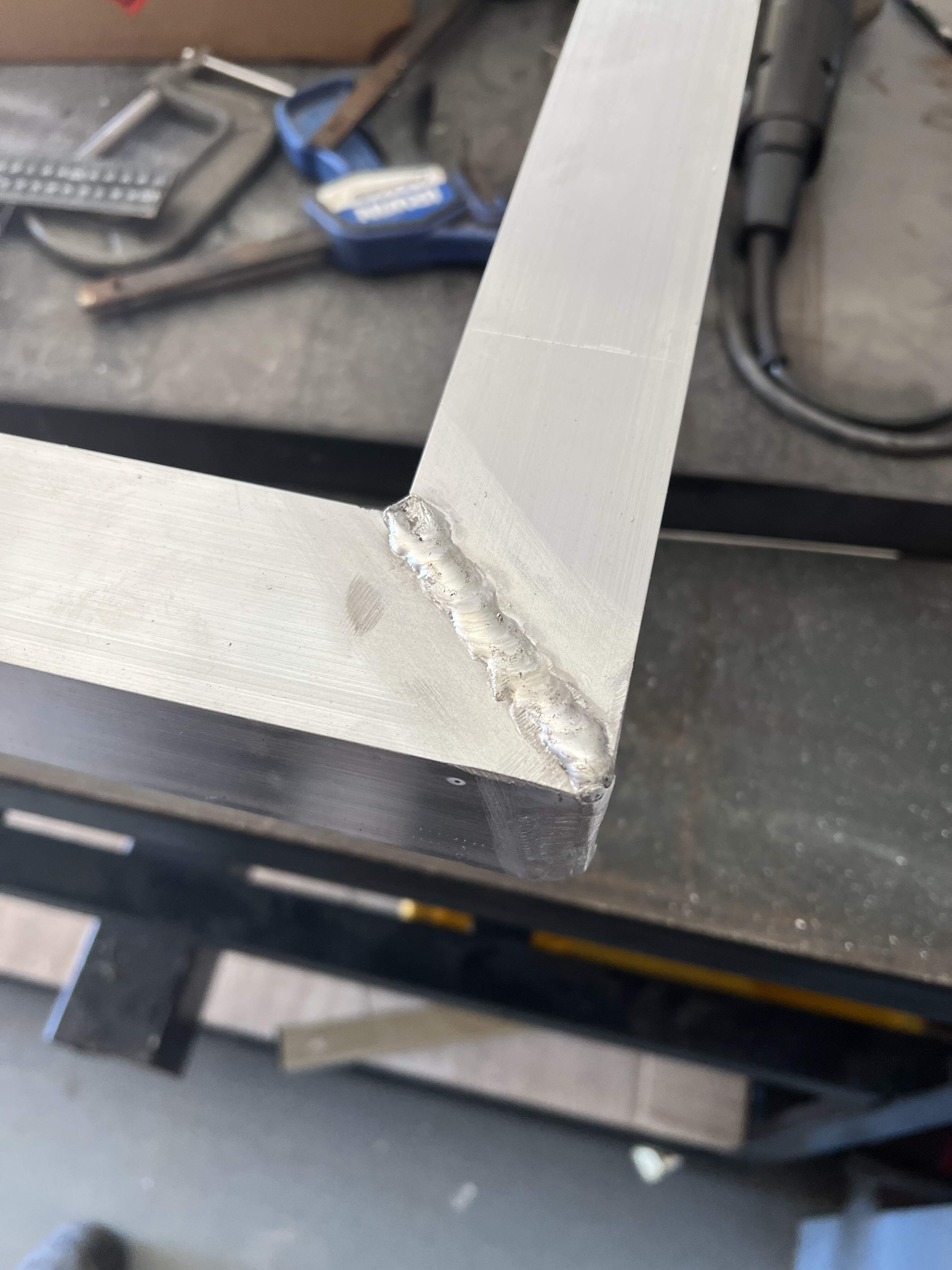

I have been working in my tunnel house and building frames to support my hydroponic channels .. so I am teaching myself how to weld aluminium .. here is my  first attempts

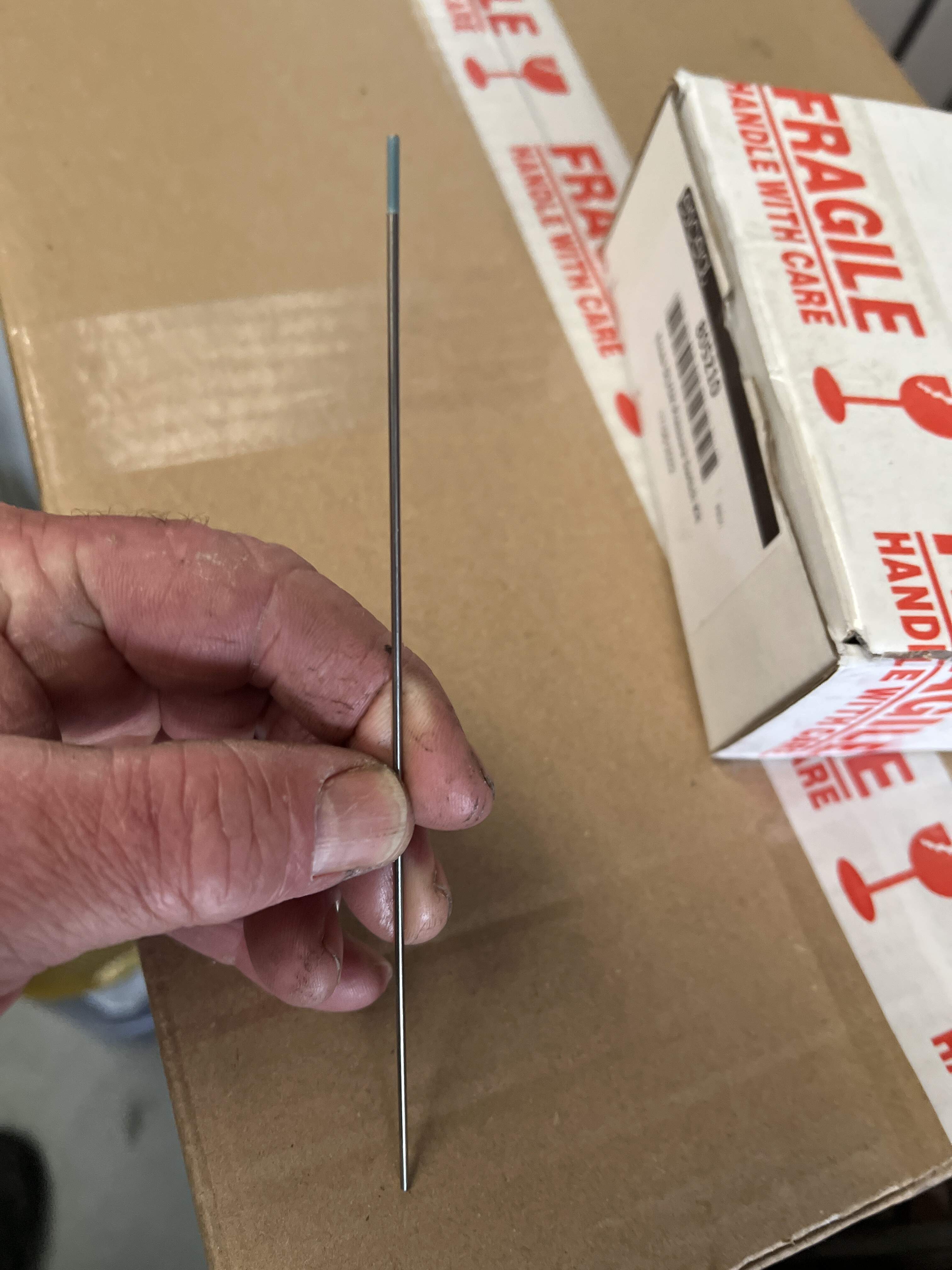

i am eating up tungsten, which i have read up is because i have my balance set way towards postive and need to turn it to negetive on my tig welder settings... clearly i have lots to learn
any ali welders out there that could give me some advise :cheers:
For justa learning bro that's really not bad. Play with your setting and see what happens, keep practicing and you'll be welding up old beer cans in no time! :cheers:

all that i have to do is get my setting right ... clean material and breath !!! and be patient.
heck its justA hot pool and add filler rod !!! sounds sooo easy !:stars:

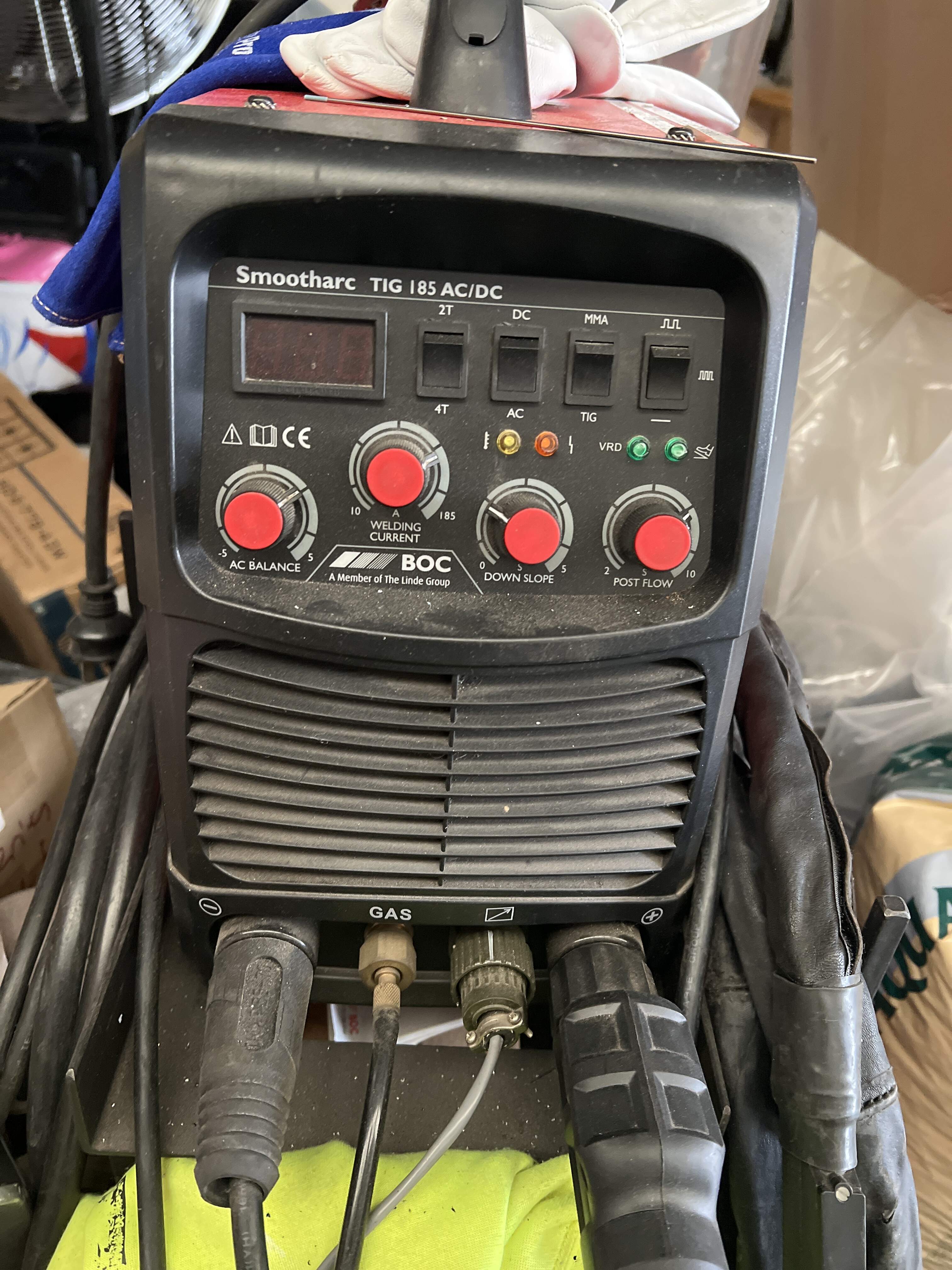

This is my tig welder
super basic unit
You can see I have the balance set way towards ac positive … I  think that’s why I am melting my tungsten
I am using what they call light blue
which is a aluminium specific tungsten..
And am grinding the tip to a ball shape
When grinding the tungsten you have the rod facing the stone . Not at 90degress to the grinding wheel . To create the ball shape
and using a stainless steel wire brush to clean my metal , not a steel wire brush.. that a big no no :)
It all SOUNDS easy ol buddy, doesn't mean it is. But your beads honestly look better than a lot of people that I've seen try to aluminum weld. You said you learned how to lead back in the day? Thats something that I wanted to try my hand at. I've read a lot about it justa never had the chance to put hands on and try it. Besides, with all the other stuff we've seen you make and fabricate, I have no doubt you'll be an ace in no time!

I am learning tig myself. there are a lot of things on the internet about tig welding if you take the time to ferret them out.
I have a friend that can weld aluminum radiators and am trying to get together with him for some one on one but we seem to have mutually exclusive schedules. I have been welding steel and cast since my teens, was certified in arc and mig and when I started with tig it added the temp pedal which I have a real problem controlling the temp with. As for the ball on the end of the tungsten first thing right after sharpening it, touch it to a piece of clean scrap steel and it will form a perfect ball on the end.
Definitely get strong into negative polarity. Contrary to popular belief current flows from negative to positive and with tig welding you don't want the electrons flowing into your tungsten.
As has already been observed your welds look  great for a newbie.

I will turn my balance down into the negative.. and I had to go buy another tungsten!  I burnt the whole rod up !!!
