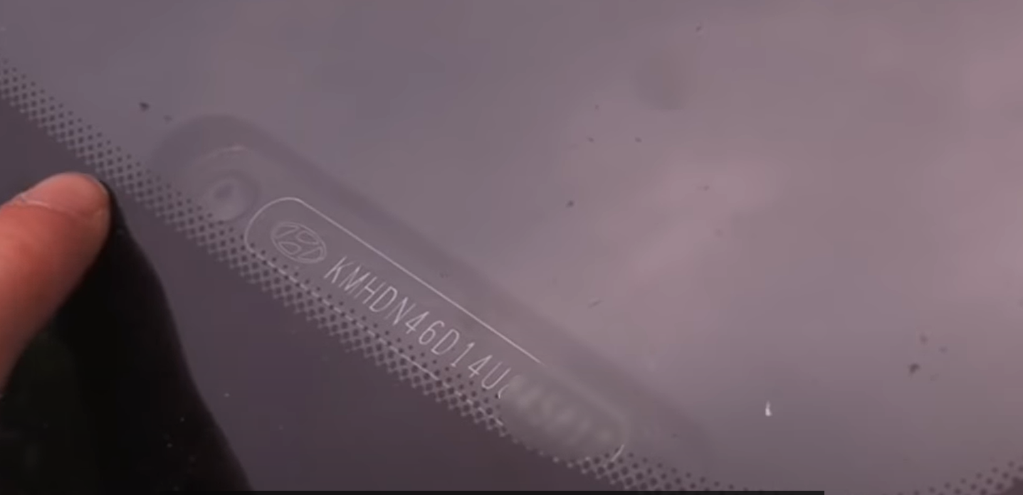

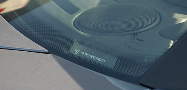

Your VIN will look similar to this example. It should be literally visible from the outside thru the driver side windshield, closest the firewall. Your VIN should start with the letters 2N (2-Pontiac, N-Bonneville series)
image.thumb.png.30f0ee8942e45df0f8dc43a5eb0ee093.pngimage.png.ca97361f62bad0a7d199c12a9921916c.png

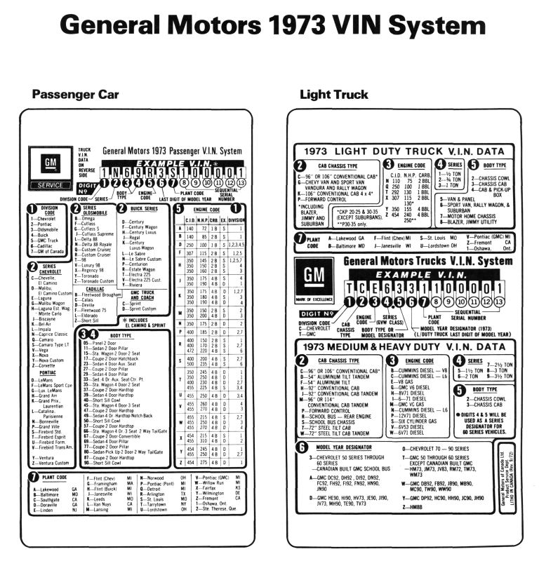

Here is how to decode your VIN number once you've found it.

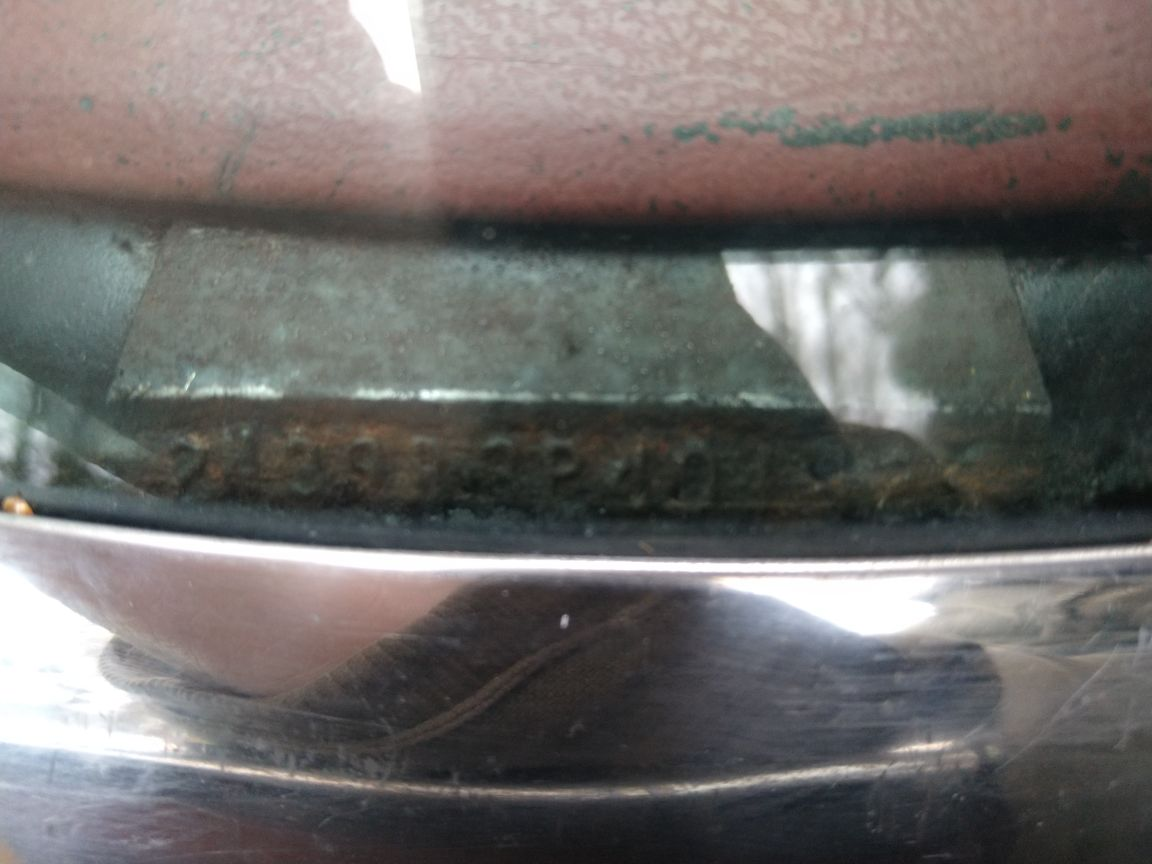

I got the vin. it was really dirty and the sealant that holds the windshield had crept up. had to push it back and pick at it and clean it as best I could. Now it's getting the carburetor done. my friend is gonna help me find a kit and if a friend of ours agrees we're putting it in an ultrasonic cleaner to be sure it's as close to 100%  clean as possible. Then rebuild and reassemble. And hope that once back together it lives. I do think it is also an ignition issue as well as when I had someone help. The strength varied. Might try doing the hot lead trick to the coil to make sure it's running good. if it is then runs like ass when the hot lead is gone. That should tell me that it's a harness issue

I mean. My friend owns and ultrasonic cleaner. So that makes life easier. I've hit most of the passages already with a can of carb clean, but it's more to get anything I missed as well as degrime the exterior of the carburetor body. I am close. Decoded my VIN after getting the numbers cleared. 2N39R3P494825. and I am gonna see if next time I have a chance to talk to local law enforcement if it's fully legal to get the VIN Plate Remade as mine is nearly corroded away. it was a good chunk of time scraping and scrubbing to get to that VS what I shared the other day. but at least it's visible now. But once the carb is on I can try to start it back up

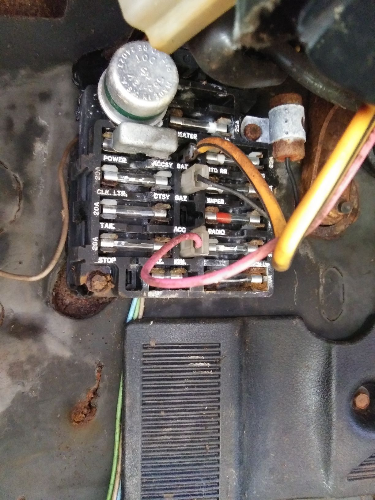

I do think my idle is a little high even when warmed up. Though it is good. Sadly. I think my gas gauge stopped working, it says E when I had an 1/8th tank. Could also be a fuse or something. what fuse is it?

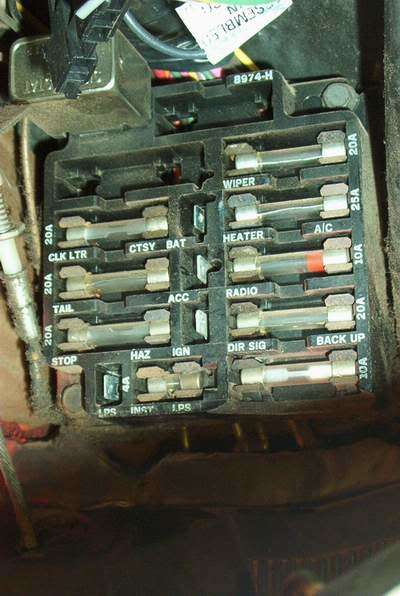

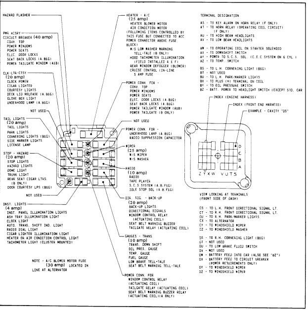

Looking at your fuse block I think you are missing a fuse. Here is the diagram of the fuse block from my '72 manual (a year should not be a significant difference). At the top left is the power accessory 40A circuit breaker/fuse is missing.
It looks like this:
circuit-breaker-power-accessory-1972-78-
This is available from OPGI for $16.00. You might also be able to get it through your local parts stores too. Take the photo with you to be sure.

bottom right is fuel fuse.
Frosty that top left holder is missing the clips ! i suspect Gaetan's car has no power accessories ie power widows/ power seats, power hood etc.
Gaetan, remove the bottom right fuse, sand the contacts and check continuity from each side of the fuse cradle.
then climb under the car and find the earth strap off the fuel sender unit on the car and ensure it is earthed to the body of the car .. it must be 100% or the gauge wont read correctly👍
a quick test is to remove the feed wire to the fuel sender, turn on the key and earth out that wire, your gauge should go straight to full. this will prove your wiring is sound and that the fuel Gauge is working... then it comes down to earth of the sender in the tank or faulty sender unit itself:cheers:

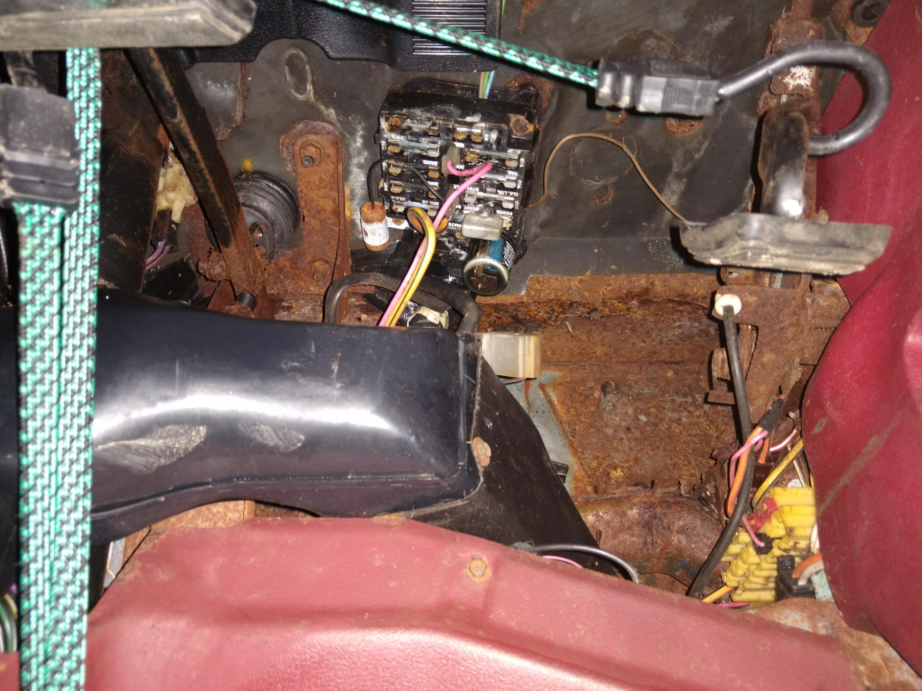

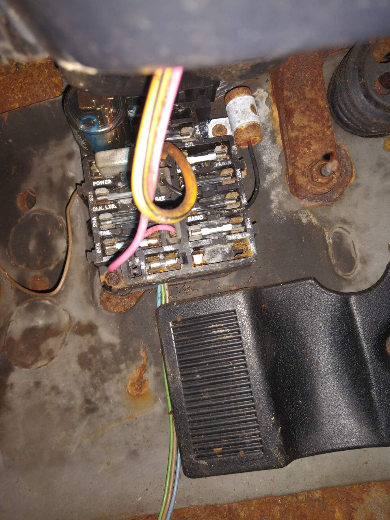

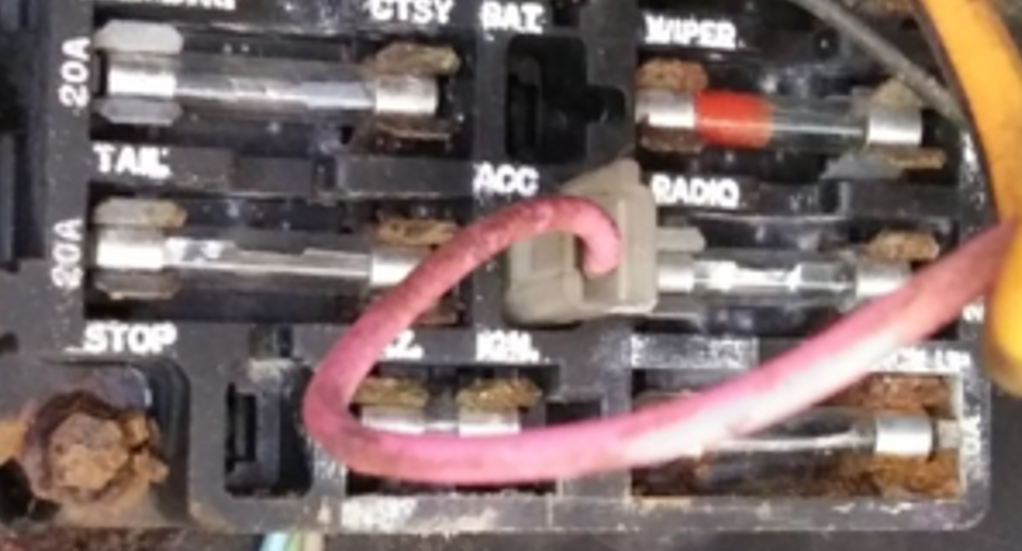

that's not my one, this is. That was a reference. I know that one of the fuses needs a new end clip as it rusted off.
This should be better
After downloading and enlarging your picture, I see quite a bit of rust on the contacts for the fuses. I think you should take some time to clean up when you get a spare moment. See what I mean when I enlarge a portion of your photo?
So your radio, turn signals, gages, and instrument cluster lighting are all impacted. This is not to say these things aren't working, but this can cause problems for sure. Also I would inspect some of the fuses and consider replacing them with new ones. Some look like they are a little shaky and perhaps on the verge of giving up, especially the one with the red color in it. The one with white in it, to the right of the 40A circuit breaker is another one I would inspect/replace.

Judging by all the corrosion that I see in the photos...My guess is that the whole electrical system is full of bad grounds...Would start by cleaning the bolt connection lower left corner of the fuse block...Then maybe go to all the light sockets including the License plate light and make that they all are clean and crap free and that they are grounded properly to the chassis..The light sockets themselves are grounded individually to the body when they were pushed in and twisted into the mounting holes instead of having separate ground wires from the sockets to the body...Had a rusty mid 70s Oldsmobile cutlass that had lots of electrical gremlins (Came from upstate New York) ...99% of which wound up being corroded grounds all thru the car..The reason I single out the License plate light is because the light and fuel gauge/sending unit were on a common ground...
Basically every ground connection strap/bolt..etc.. inside and out or that you may suspect is a ground that you can find should be cleaned and retightened...
Edited by TWO LANE BLACK TOP
wow! i justA down loaded that picture as Frosty did! your gona need to spend some time cleaning ALL those fuse clips up AND i agree with two lane, you justA have to go through every earth too!!
 especially all light bulb sockets!
