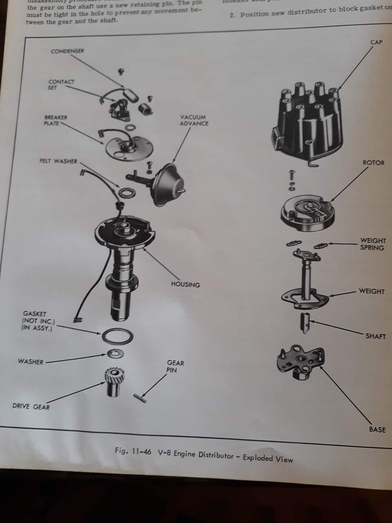

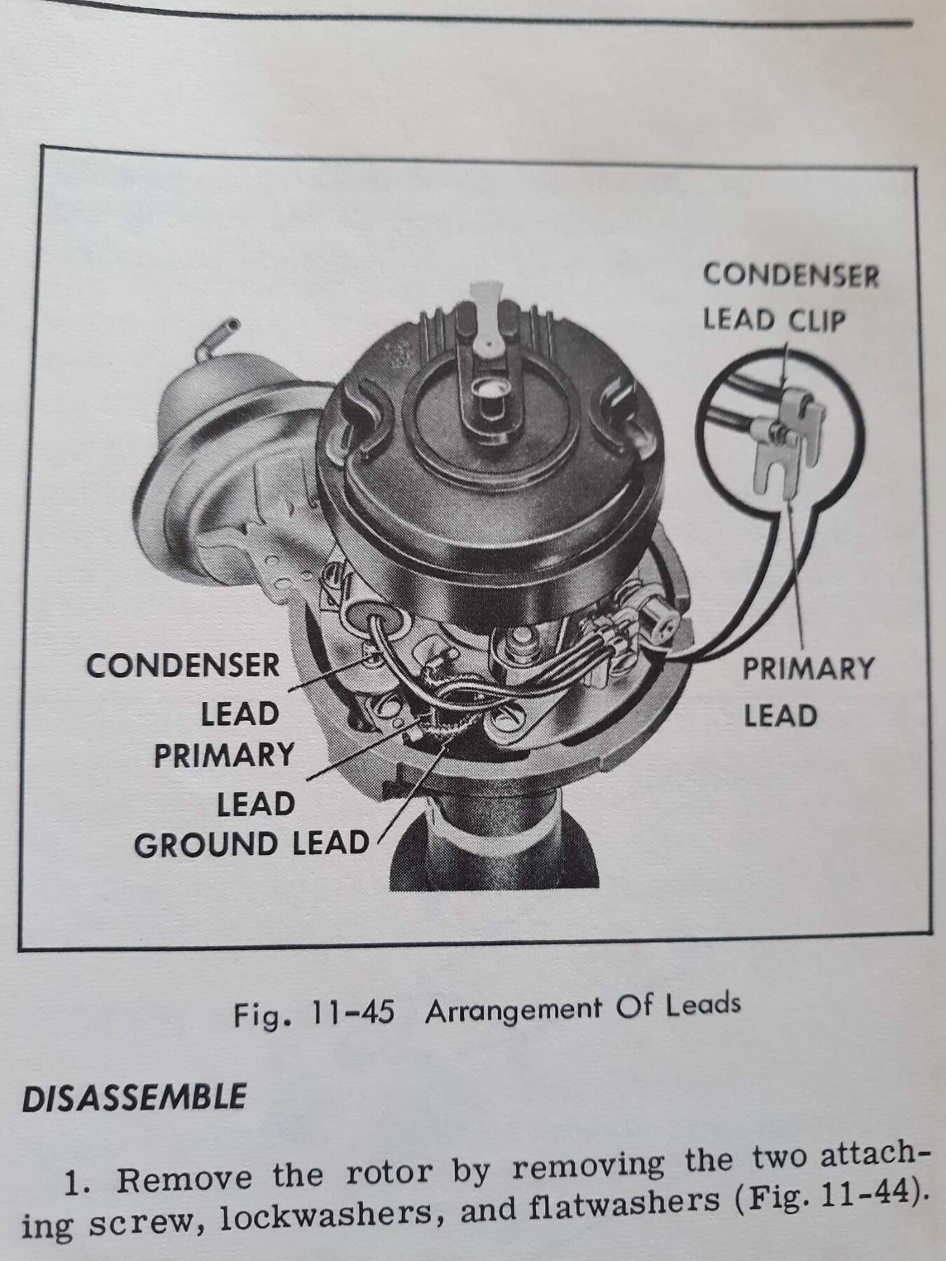

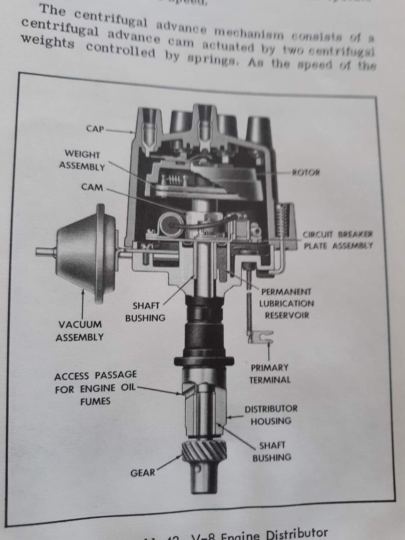

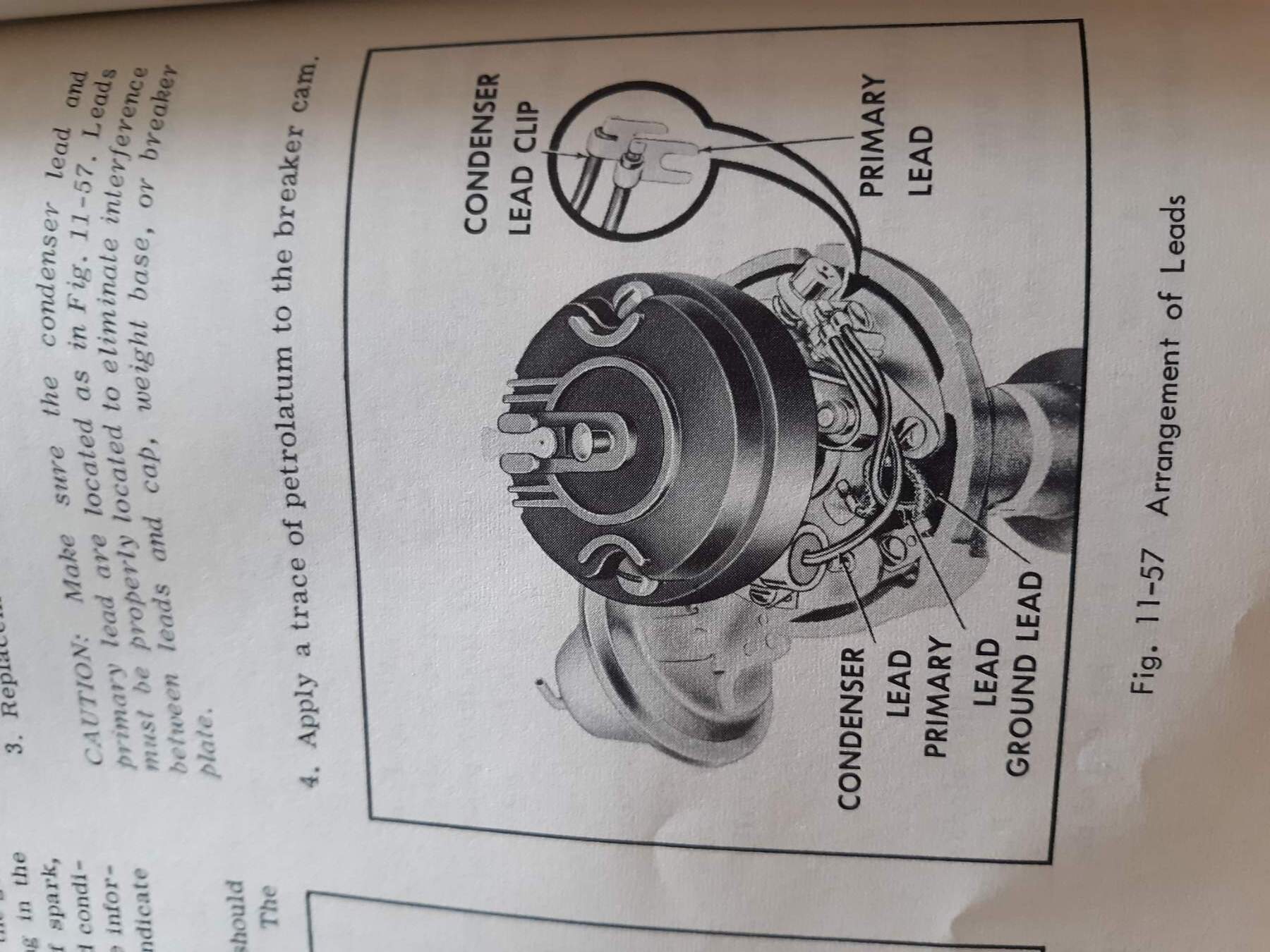

do these dissy have a earth strap between the turn table where the points are and the dissy housing ???

Yes..There is a ground strap between them...

ah good picture for Gaetan to check the lay out in his dissy👍
