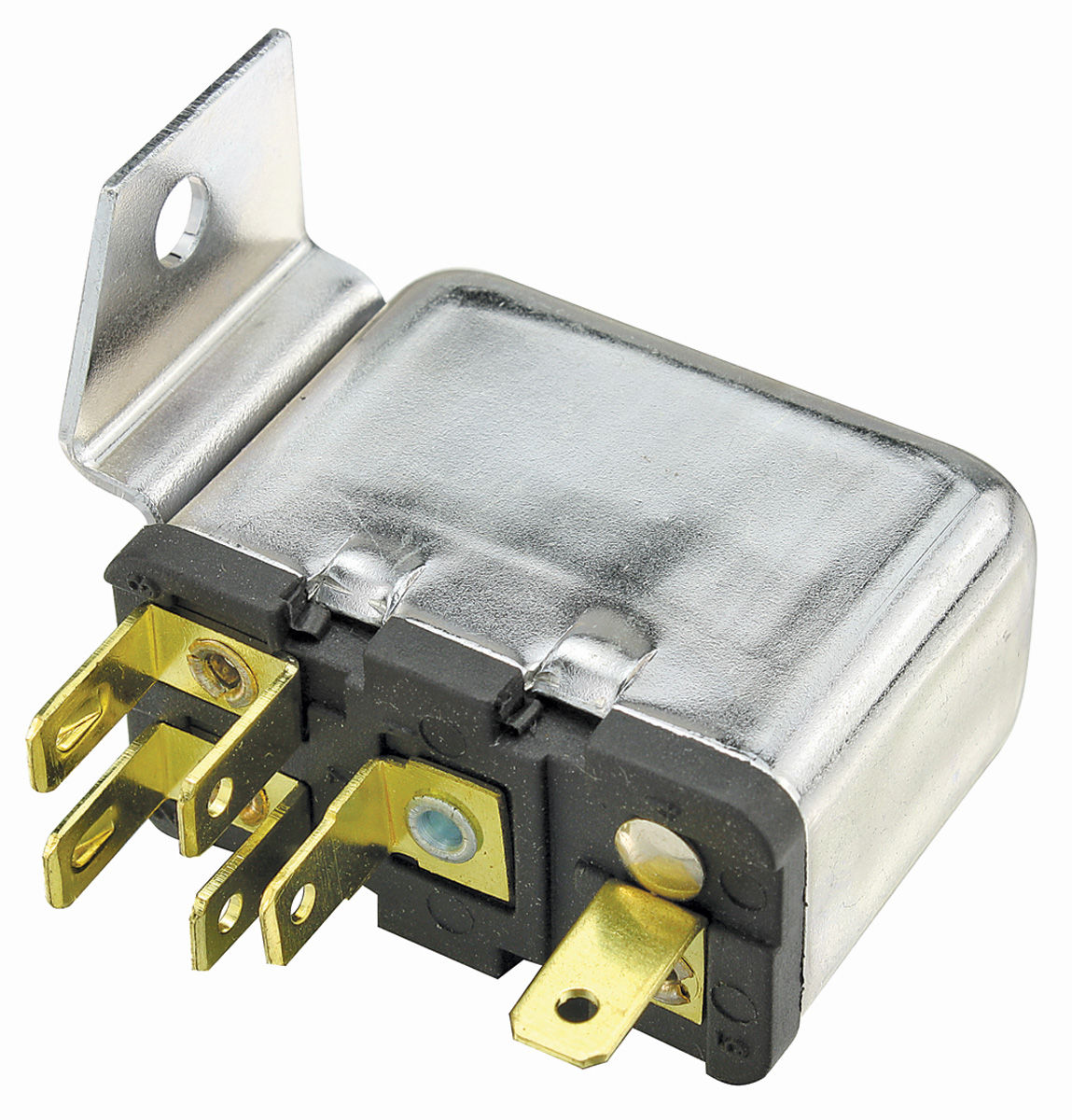

Update. It's moving stopping and running. Need to get the carburetor work done at some point, got a new relay for the power windows. If I can beat the storm tomorrow I will try to see if it's that 40 amp fuse. As I shoot it and wasn't sure if I could hear anything due to rain hitting the tarp. But it is a handful moving around. I need to look into replacing shocks as it's really bouncy and all that. Am really surprised how far I can see with the stock headlights that are as old as they are. Need to go through my fuse panel, anyone know how it comes off the firewall?

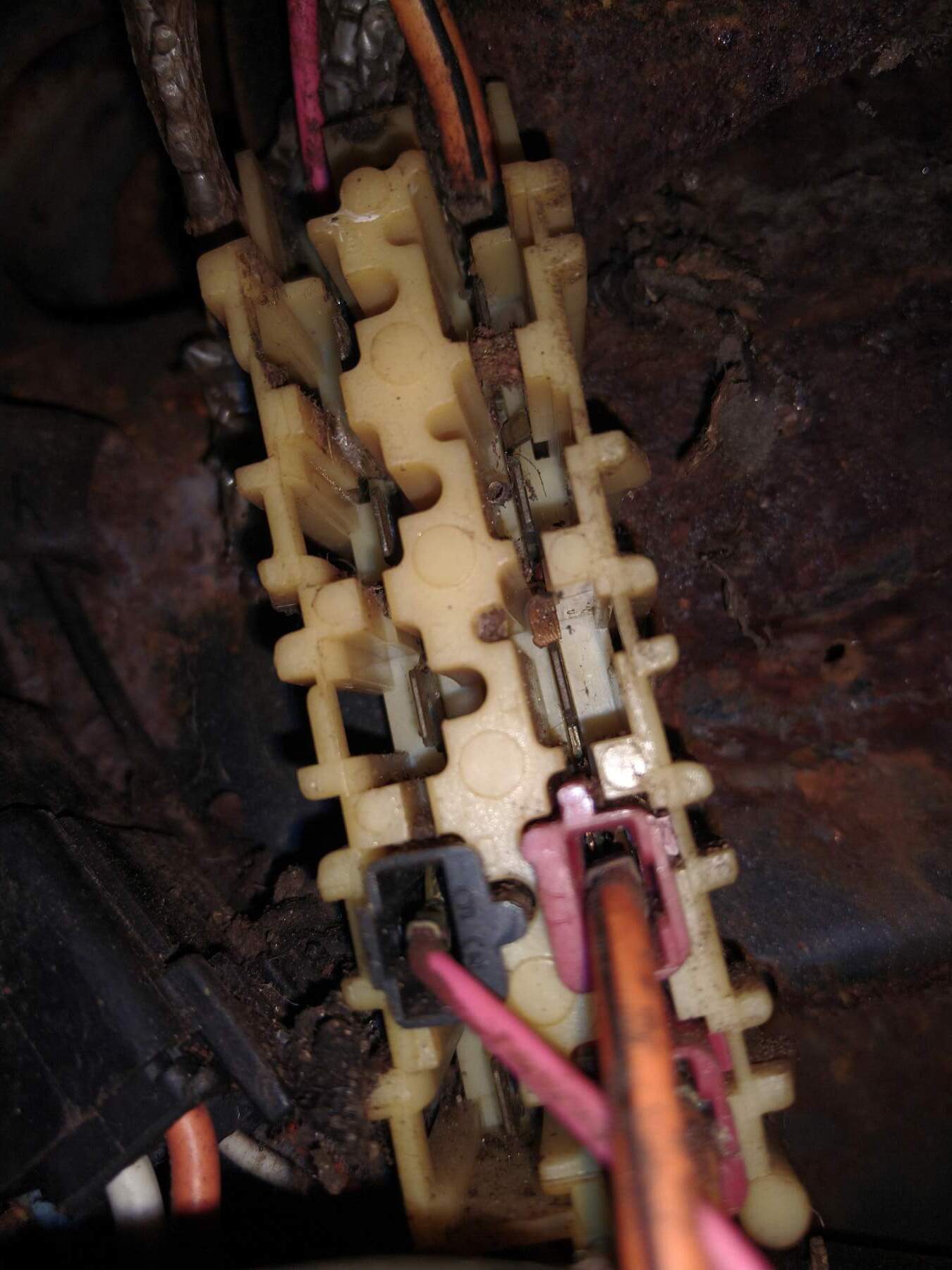

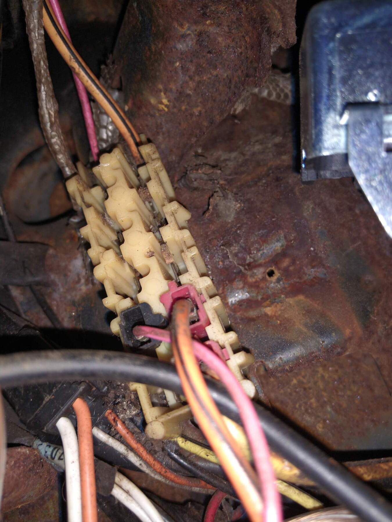

Ok. Am trying to figure out why I don't seem to have power to the relay. I'm thinking the wires go to a power block is not working. Or the power block is junk.
Bad fuse? Some of your fuses looked to be in poor condition. Also, what did you determine regarding your 40A accessory fuse / circuit breaker (top left below the flasher).? In your photo it appeared to be missing. Is it there and in good condition?
I took it out to see if it was junk, don't hear anything rattling. I put for testing a 30amp. And have found that power isn't getting to the relay. There's this power block thing that could be junk as well. Also my dash light circuit has a short somewhere as the fuse pops. I tried with 5 amp as that's all I had and it went pop immediately.
Max - where on the car is this bus panel? Under the dash?
Above the the kick panel. Like a few inches up from the hood release, tucked just out of view
