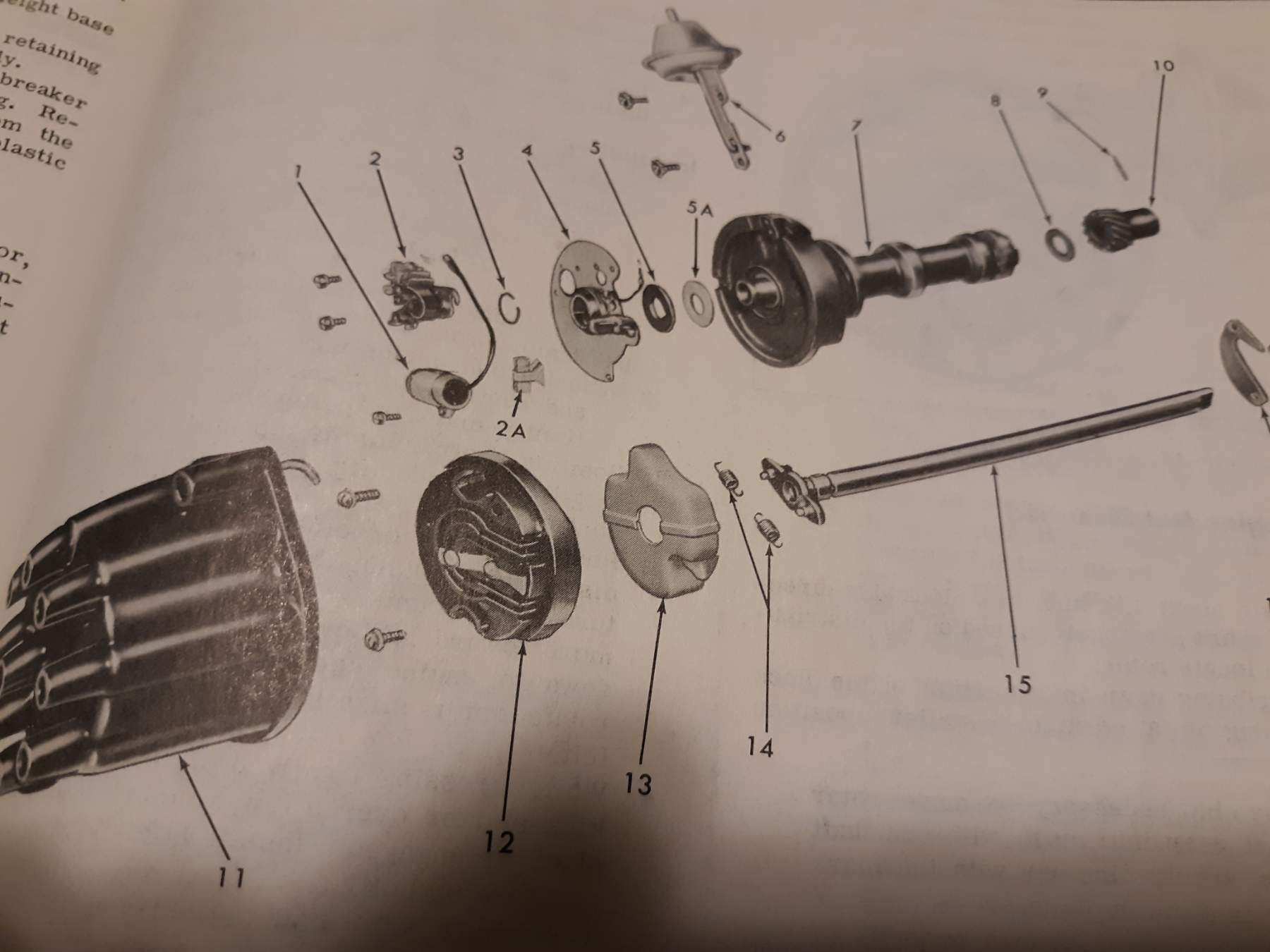

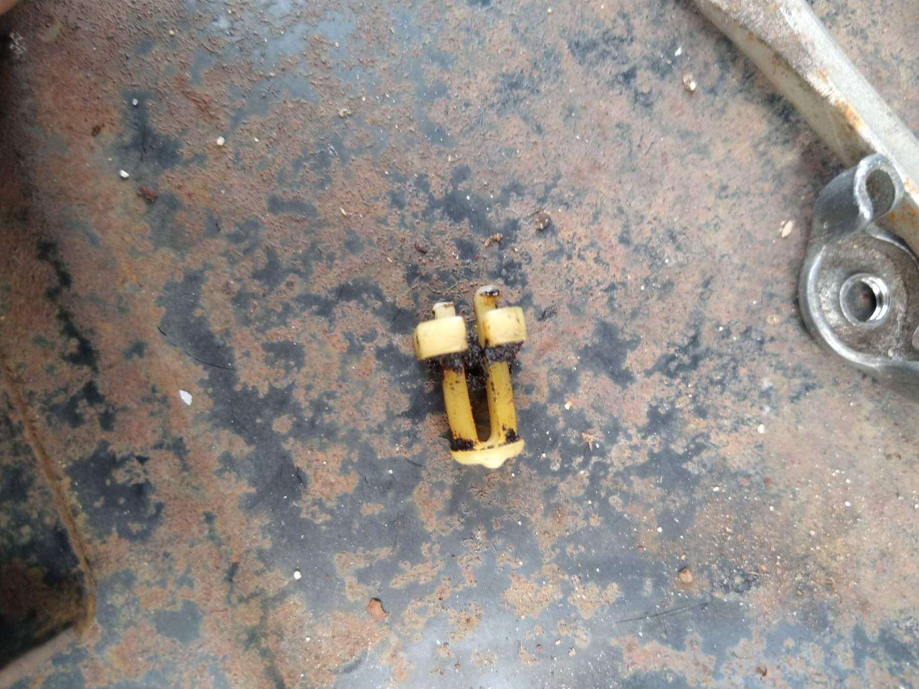

so.. poking around, that ground tether is in place and tight, put a proper connector on the clip, and put some heat shrink over it to keep it from shorting out. it's really trying, it seems to get spark, get spark and sputter, sputter, then nothing. I also found this weird thing towards the firewall side of the distributor, I gently touched it and it came off

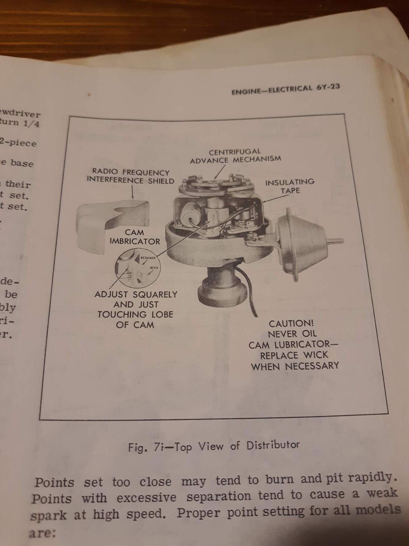

so uhhh. Upon further looking I decided to go back to the video where it last ran nice and then died. and uhh. I found something that doesn't sound good but it is weird. my engine when cranking sounds even and healthy on compression. if I have to I can test my valvetrain but uhh. This doesn't sound great
The plastic piece from the distributor is the Cam lubricator assembly...(part 2A) It is a wick that contains a lubricant that Oils  the cam in the distributor that the Breaker Points ride against....
Edited by TWO LANE BLACK TOP
then someone was in there before me as it didn't have a wick in it. and now it's dead
Has been awhile since I've replaced points...But If I remember correctly there is a packet of lube that comes with the new points...That you smear on the lobe between and the surface where the points contact the cam lobe...and takes the place of the wick...

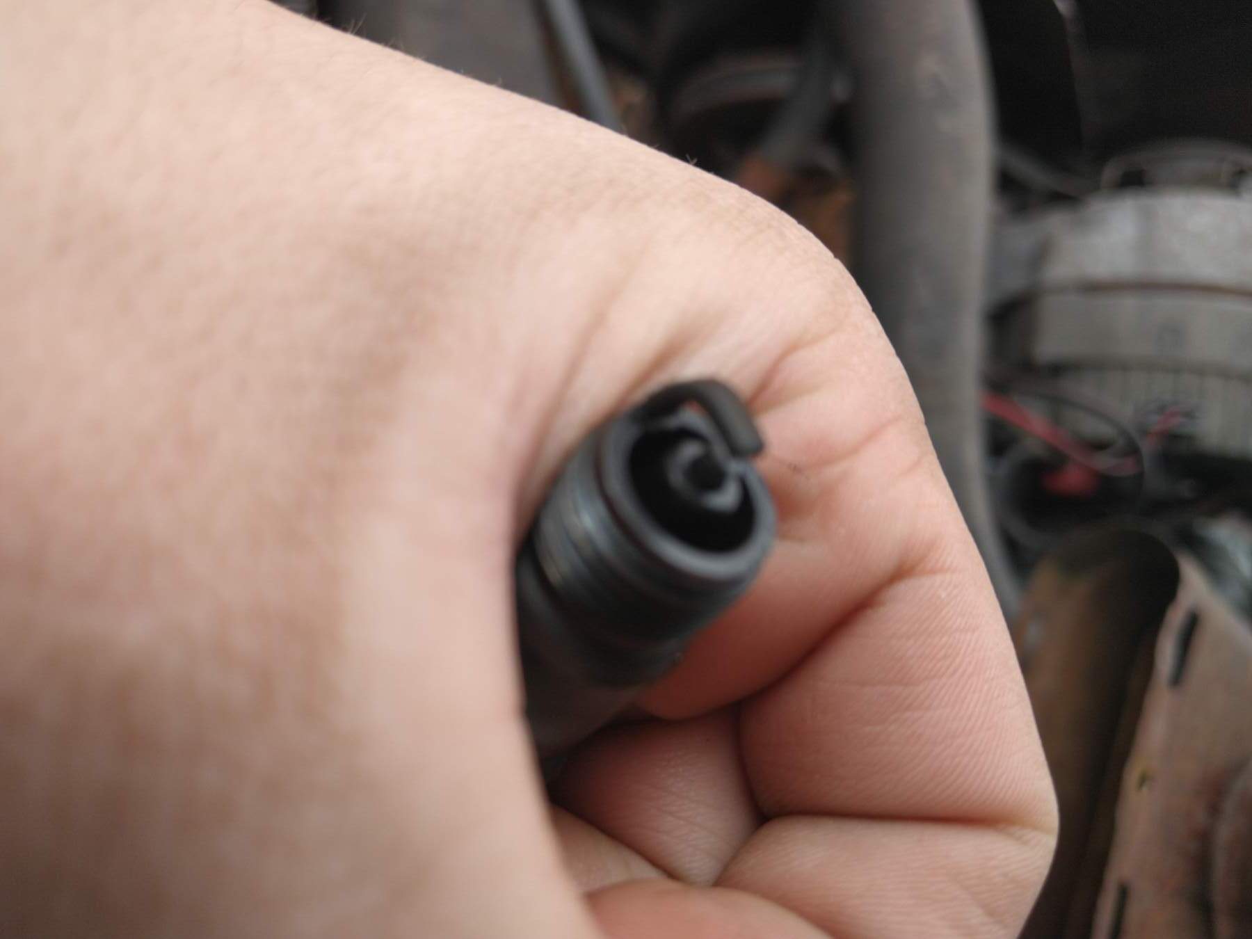

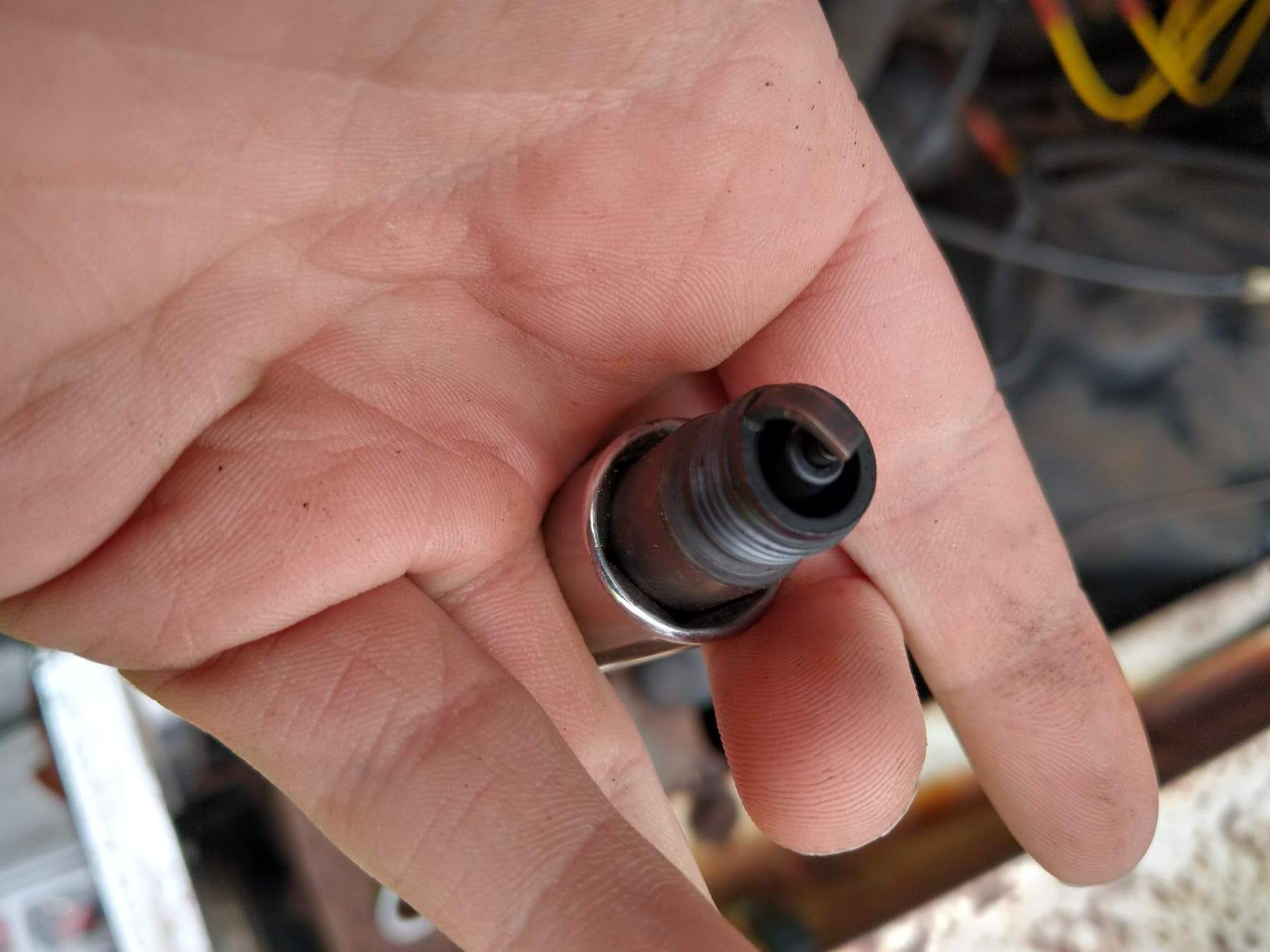

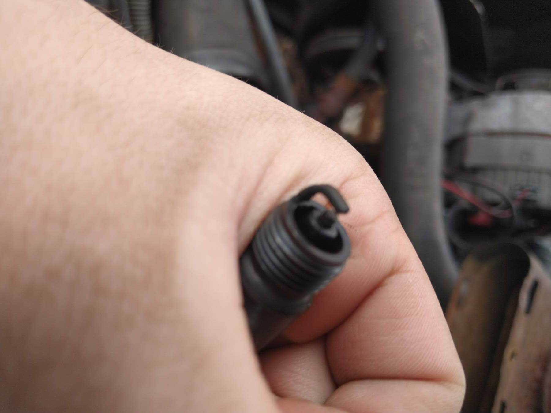

image.png.4be5324c6c655b8d9b3c4bcc79ed4b3d.pngGaetan that plug is dry, it is a fuel issue, wedge open the choke butterfly,     trigger the throttle and watch for a squirt of fuel from the accelerator pump.. is it squirting fuel down the primary throats????? bet you it isnt or you would have a wet plug.
4 hours ago, Maxwell said:
I mean, it doesn't changed if I pump the hell out of it. As the accelerator pump does work.
if you pumped the shit out of the gas pedal while cranking you would fill the bore with fuel and it would show on the plug you pulled..... its not !!! so its fuel. you need to check that you have fuel at the carb... do you ???

I forgot to mention there was soot on the plug. my overtired head had touched the end of the plug. I'll go pull another one then get a pic without touching it. Not pulling them all atm as it's cold and the passenger side is a pain with the AC bracket and all the stuff for ac in the way. People on the facebook group have said that the carb weeping could be an issue with fueling. if that's the case then why did it die randomly when running fantastically?
That’s because of fuel issue! It’s sucked up some shit from the tank
that plug is dry , your going to have to go through the fuel system , clean everything

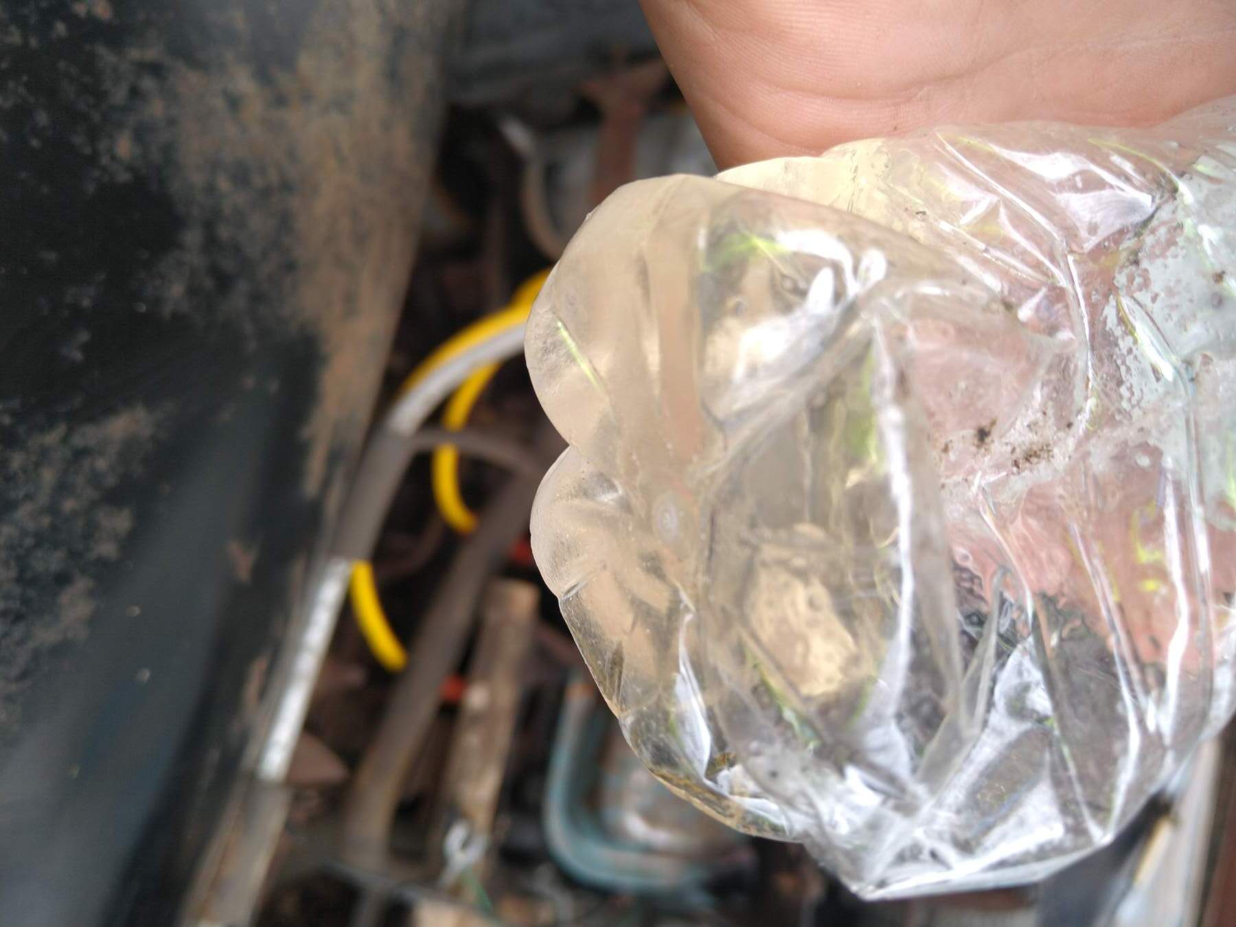

Should I crank it and get a fuel pump test video? see the condition of the fluids coming out?
fuel is clear, any water in that is residual from the bottle as I didn't want to anger my father going in and out as it's cold out. But the gas is clean, no particles, no nastiness. Battery needs a good charge

Are you 100% positively without a doubt sure that there is no water or some other contaminants in the gas tank...??
Would highly suggest that you isolate tank like I explained earlier...Then go from there...
I can garuntee that there is no water in the tank. I've pumped gas out the line with an empty dry bottle, nothing seperates. And I can't really keep cranking on the car without a charged battery
