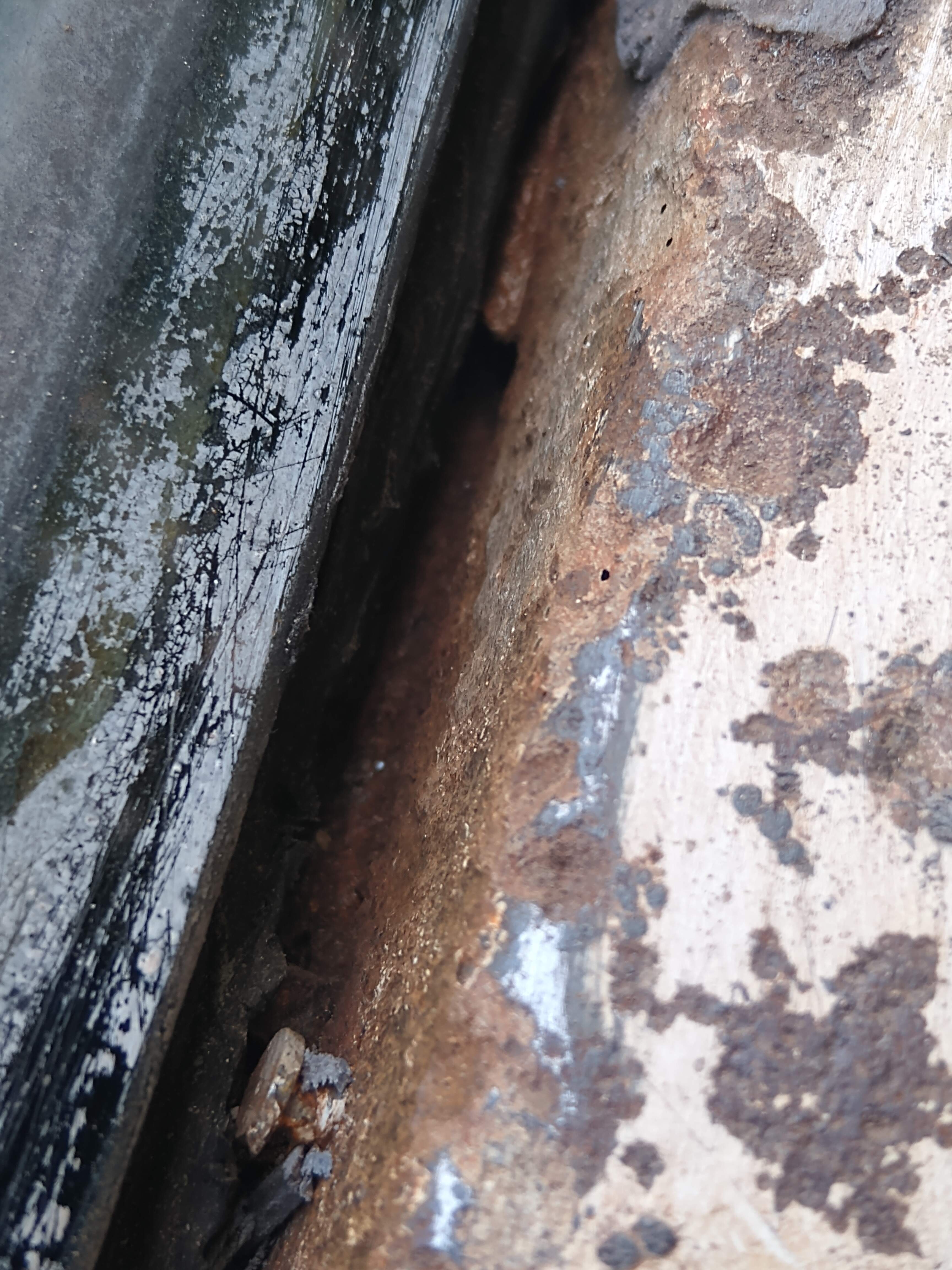

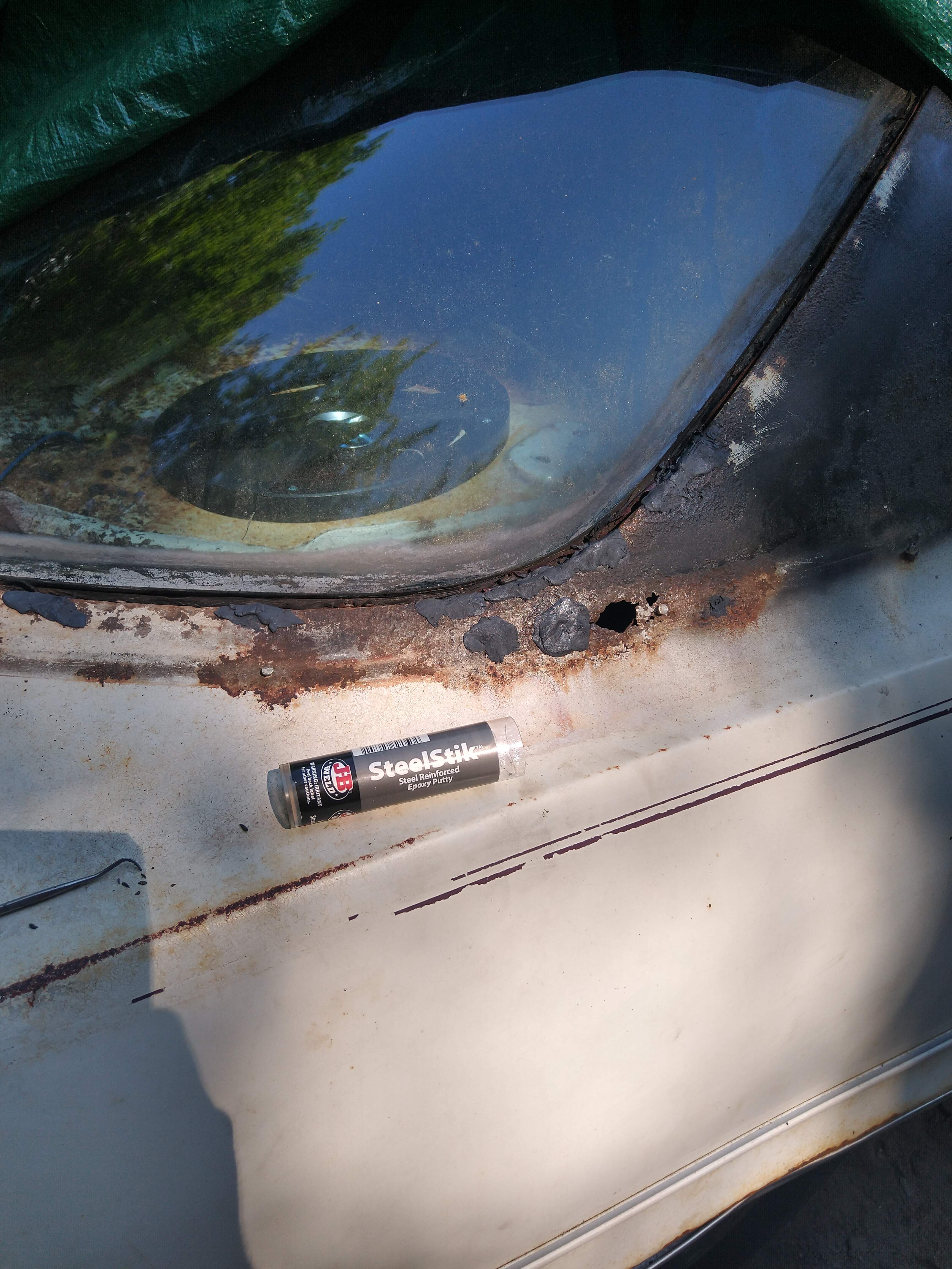

Ok. So I'm having to do ghetto methods because I can't patch it properly. I'm using the little bit of steel stick jb weld for some holes cause I have had some success. What y'all think I should use cause I really can't get the window out myself and have no money or way to afford a shop. And I don't know anyone willing to come help me yank a window and do proper bodywork.
I hate doing this to a classic car but I have no money or materials to fix it properly right now. And I doubt anyone on the forums would go "let me come help so it's done properly." And I'm not asking anyone to. Everything has been slow. Can't get the exhaust done, got to deal with holes and repairs. I've not had anyone donate to the GoFundMe for the car other than my one friend that did.

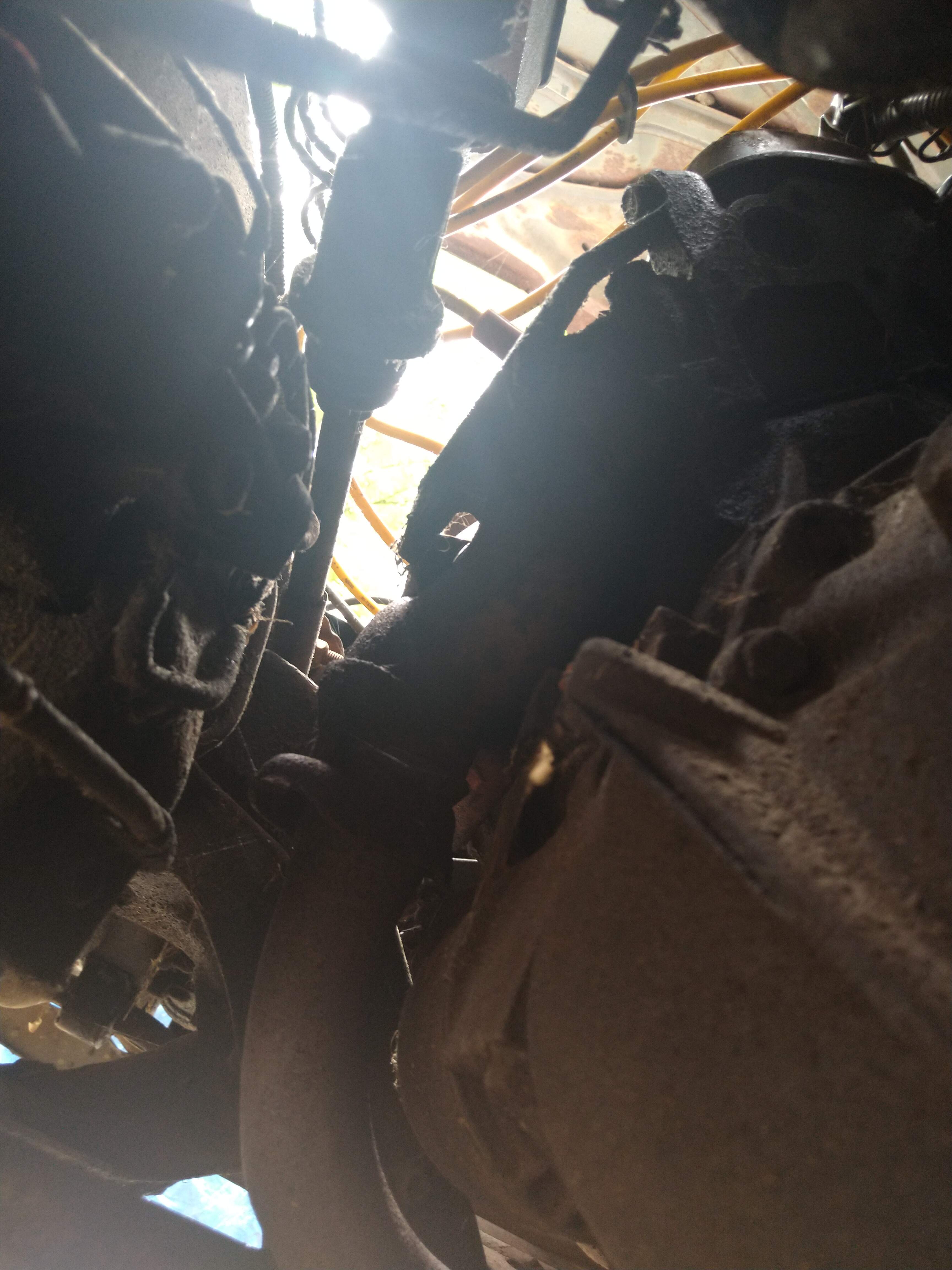

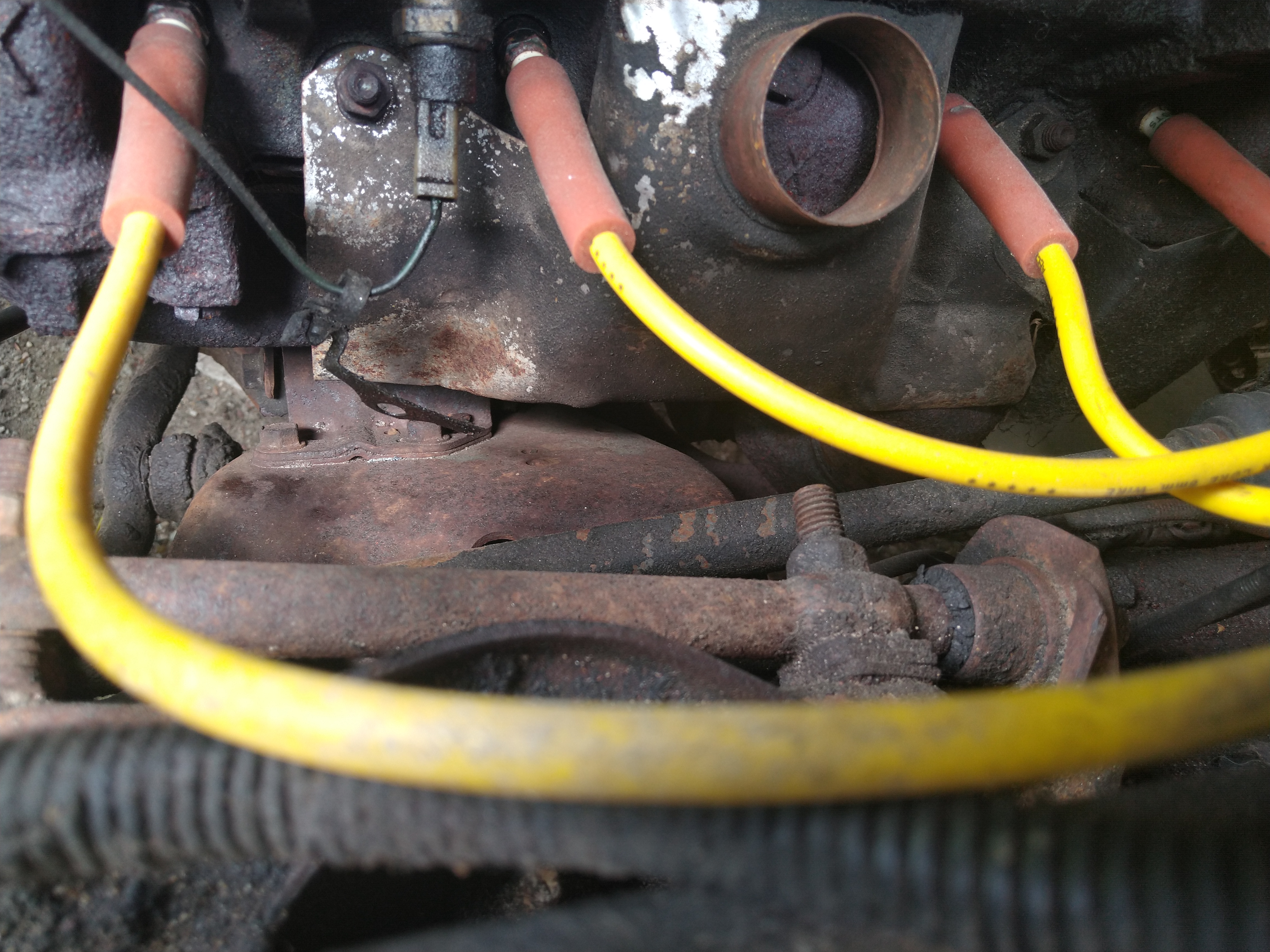

I'm being given some funds to fix the entire exhaust issue. Anyone know where I could get some headers, decent ish mufflers that have a good sound but aren't droning. And something to clear the axle

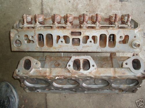

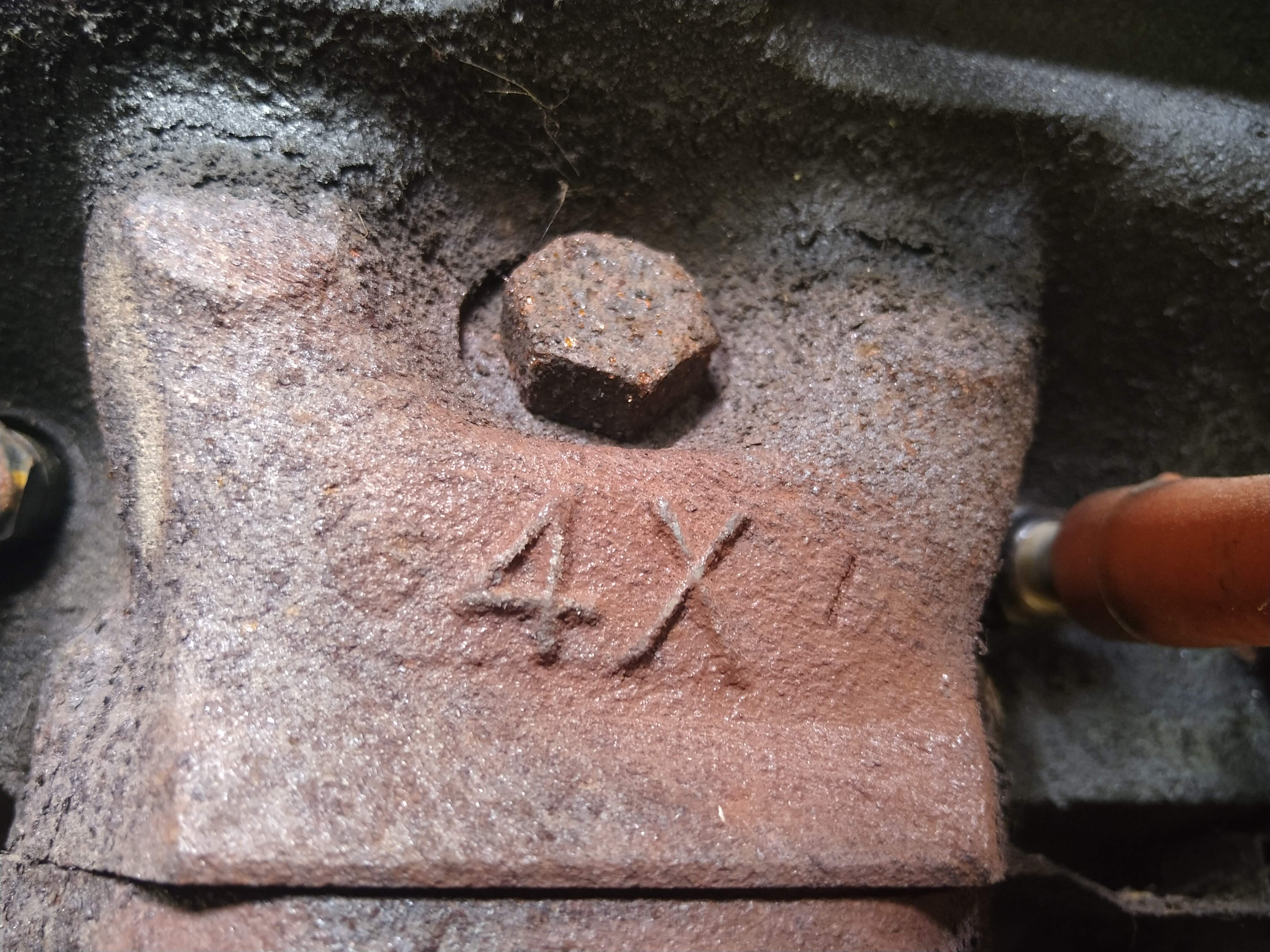

Question. From factory would I have round port or d port heads? Am looking at headers.

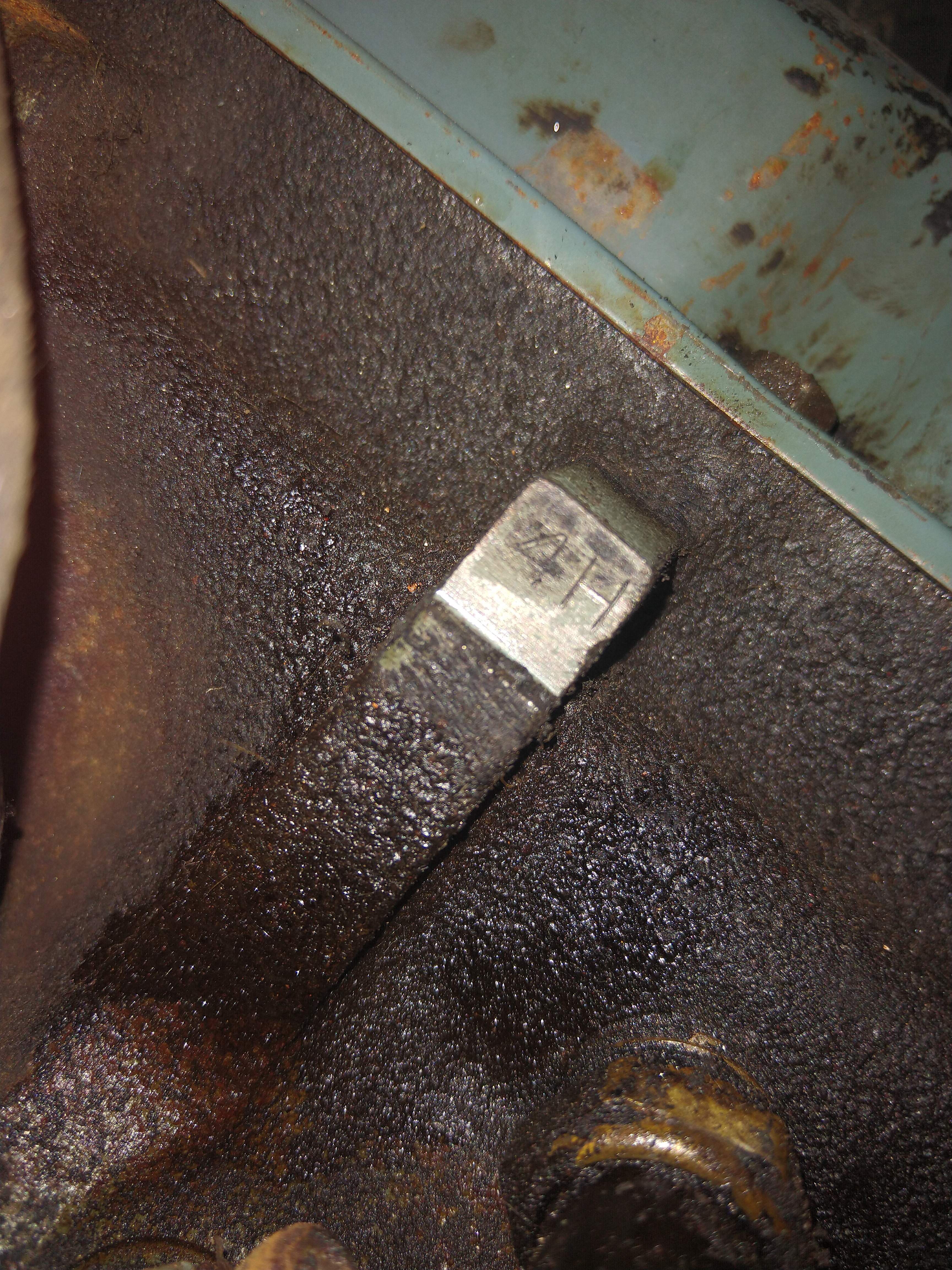

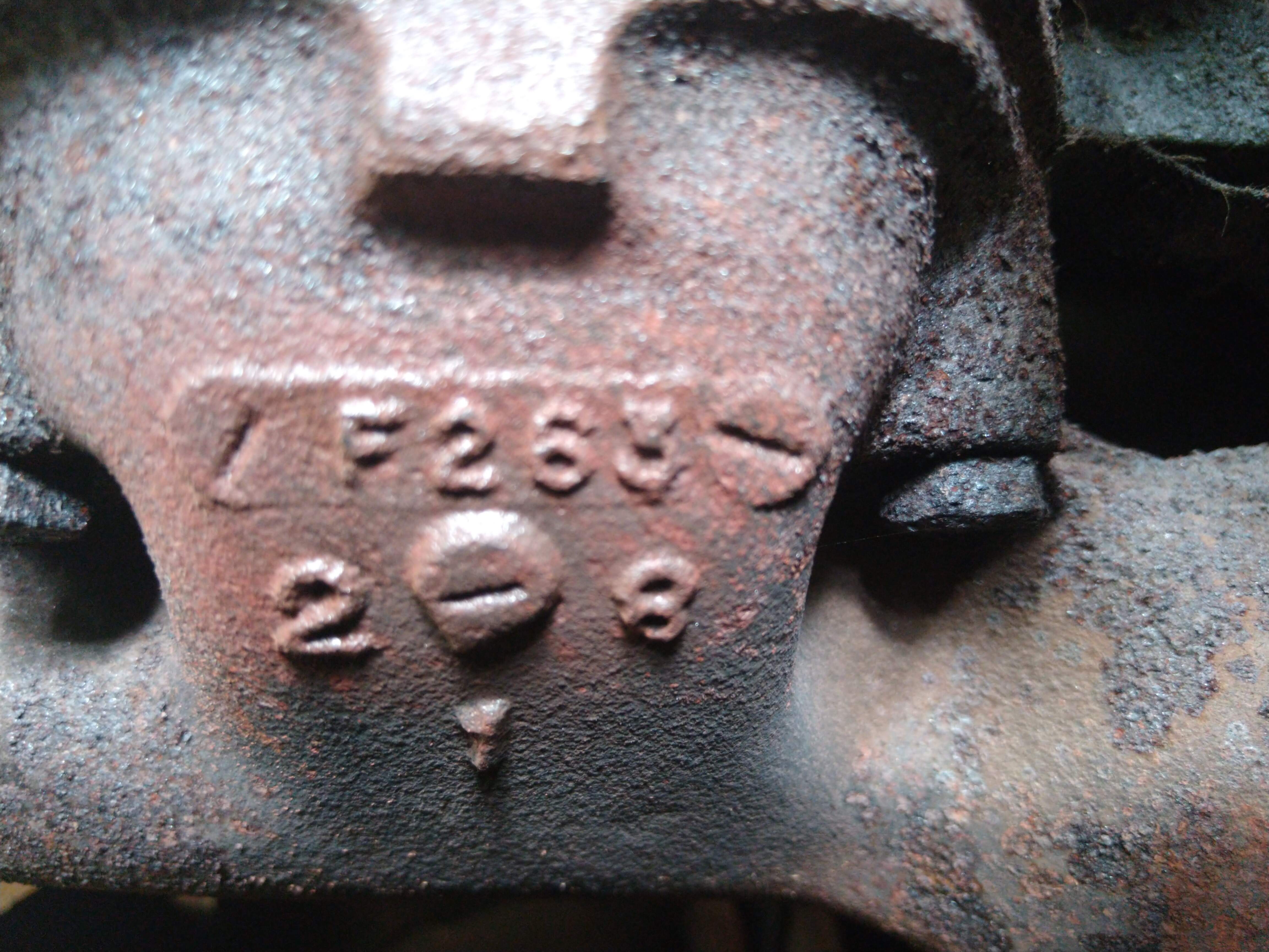

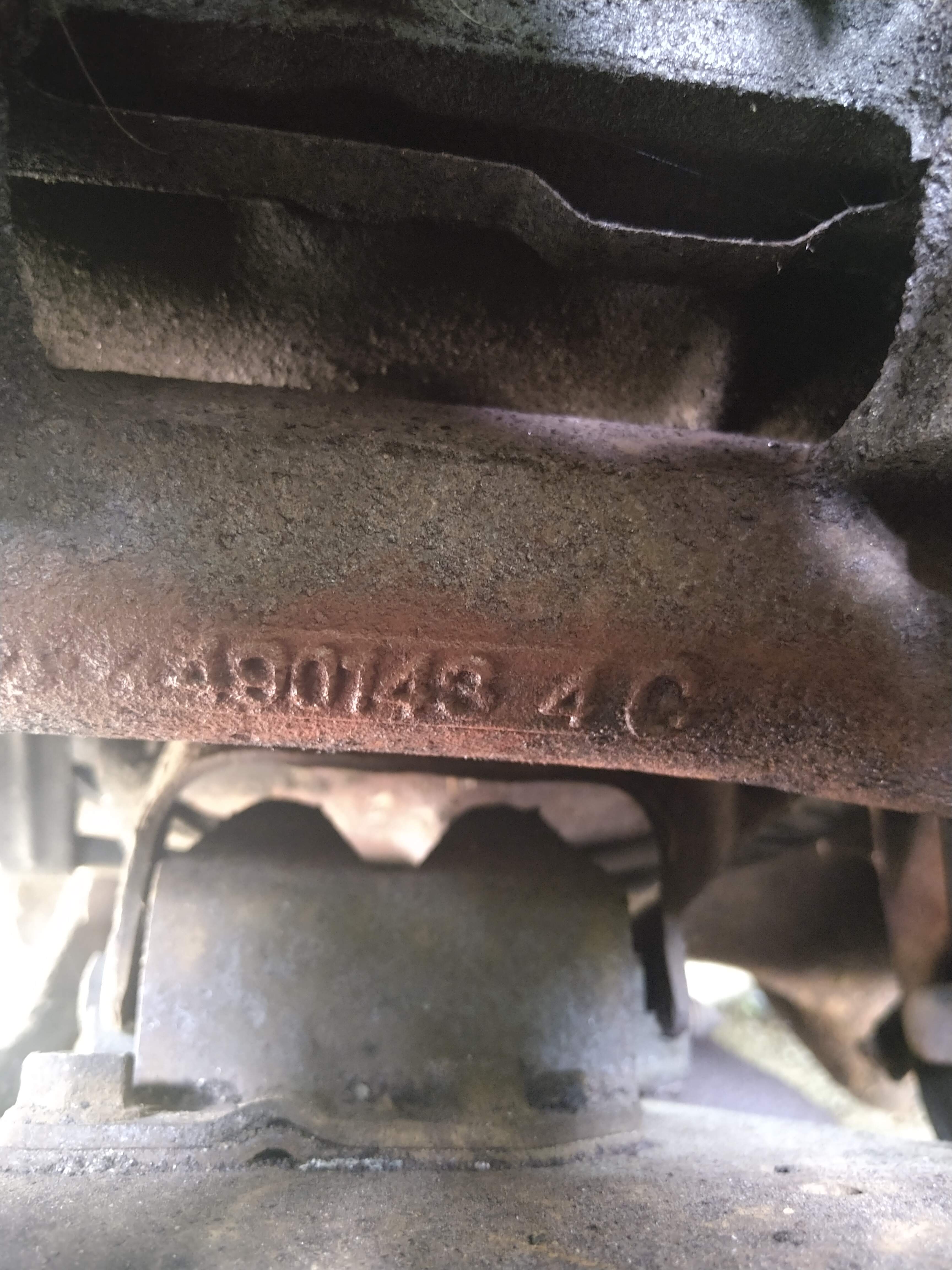

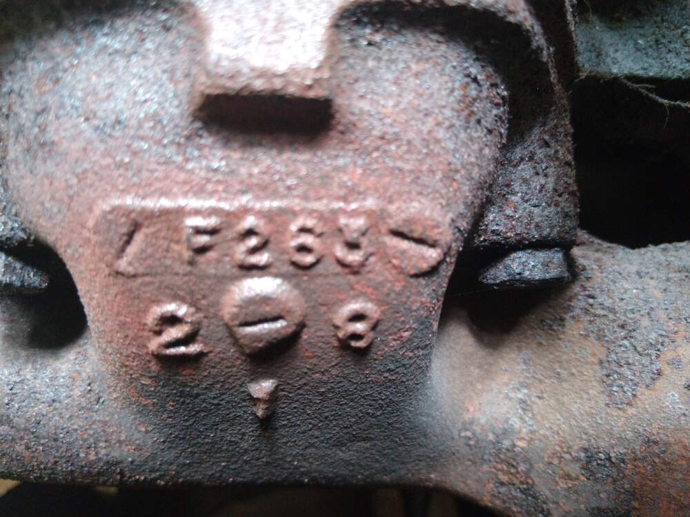

Can someone decipher these?
Max, you have 4X heads....you can Google image the intake and exhaust ports yourself with that information.

As for headers, I think you may be a tad out of luck. A lot of the header manufacturers have discontinued header production for the full size cars. A-body and F-body demand is about all they produce these days for Pontiacs, sad to say. That said, the Ram Air Restoration reproduction exhaust manifolds are the closest thing to a factory header and flow very well. I have a set on Lucy. They are better than any log style manifold you may have. These are expensive as a good set of headers, so budget accordingly.

After climbing in the dark as I just peeked here. I've got 4x 4h d port heads. Not sure what exhaust options I've got. May just throw the factory one on just for now just to have it back on the ground.
Factory exhaust that is.
You might be able to use/ get "Shorty" style headers for a Pontiac engine...As long as where they Dump out..Is close to the same area as the stock/factory exhaust manifolds dump location...They wouldn't have near the inherent fitment/clearance issues as long tube headers would...And with little modification...You could run the head pipes probably really close to the factory location...No real power gain... But would sound good with what ever mufflers you decide too use...
One other thing...Would also highly suggest that you don't go overboard with the exhaust pipe diameter....Too large an exhaust pipe/Header tube diameter can/will Kill the low end torque Output...

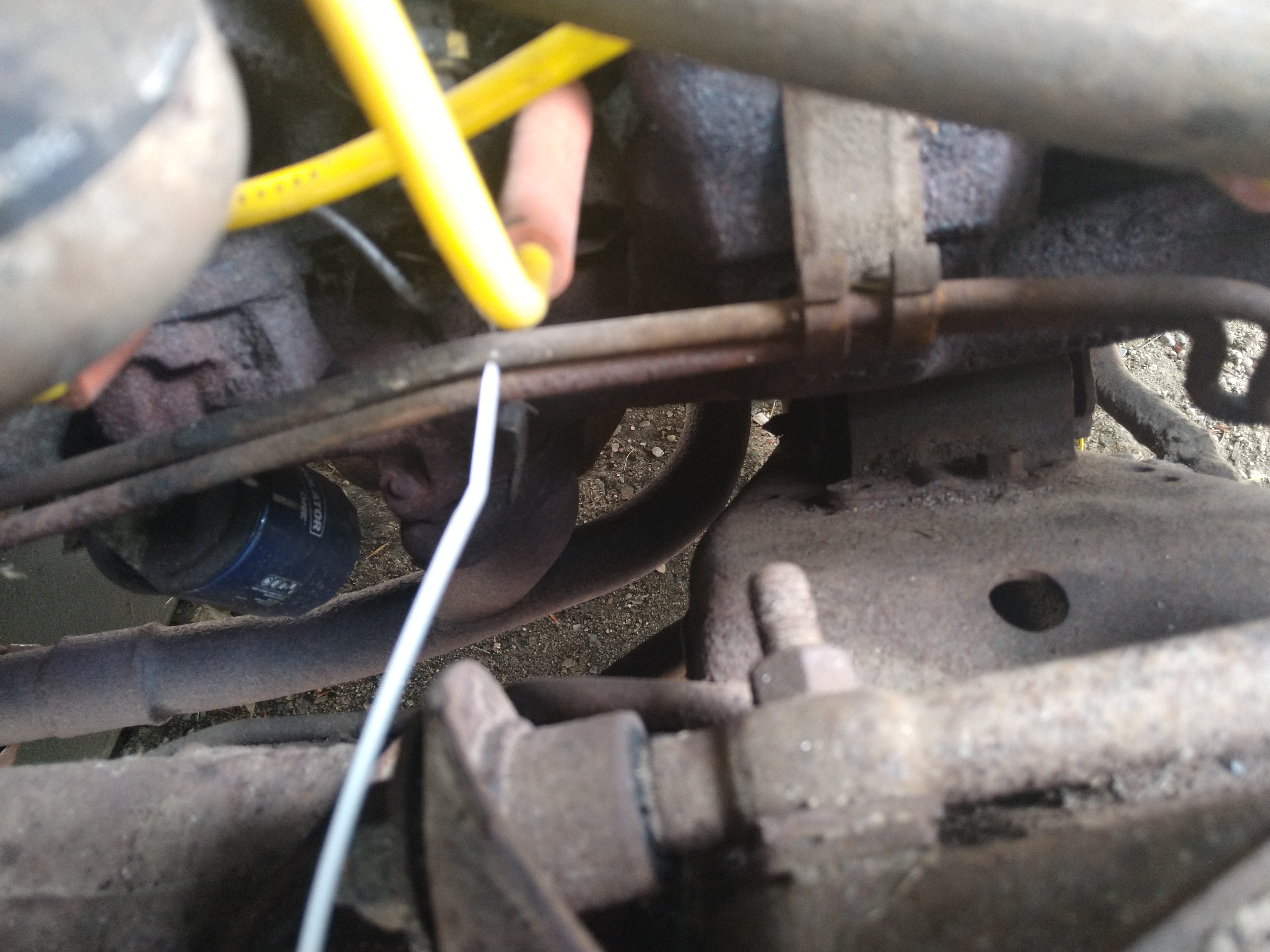

I'm after a 2.5 in preferred exhaust diameter. Max 3 but the mufflers I have liked are 2.5in. also what would you recommend for a set of shorty headers. If there's no long tubes that'd fit

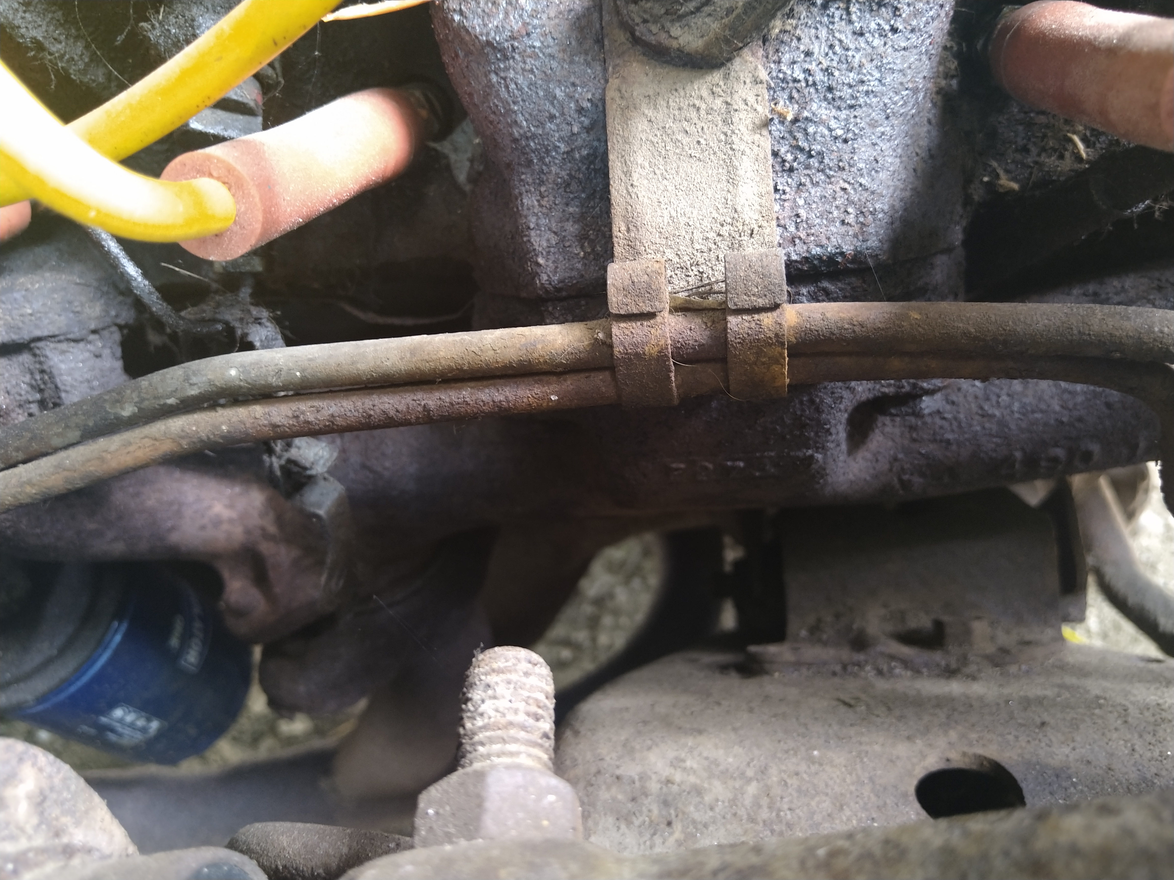

I did notice that it may be a bit of a fun time finding something that fits with the oil filter right there.

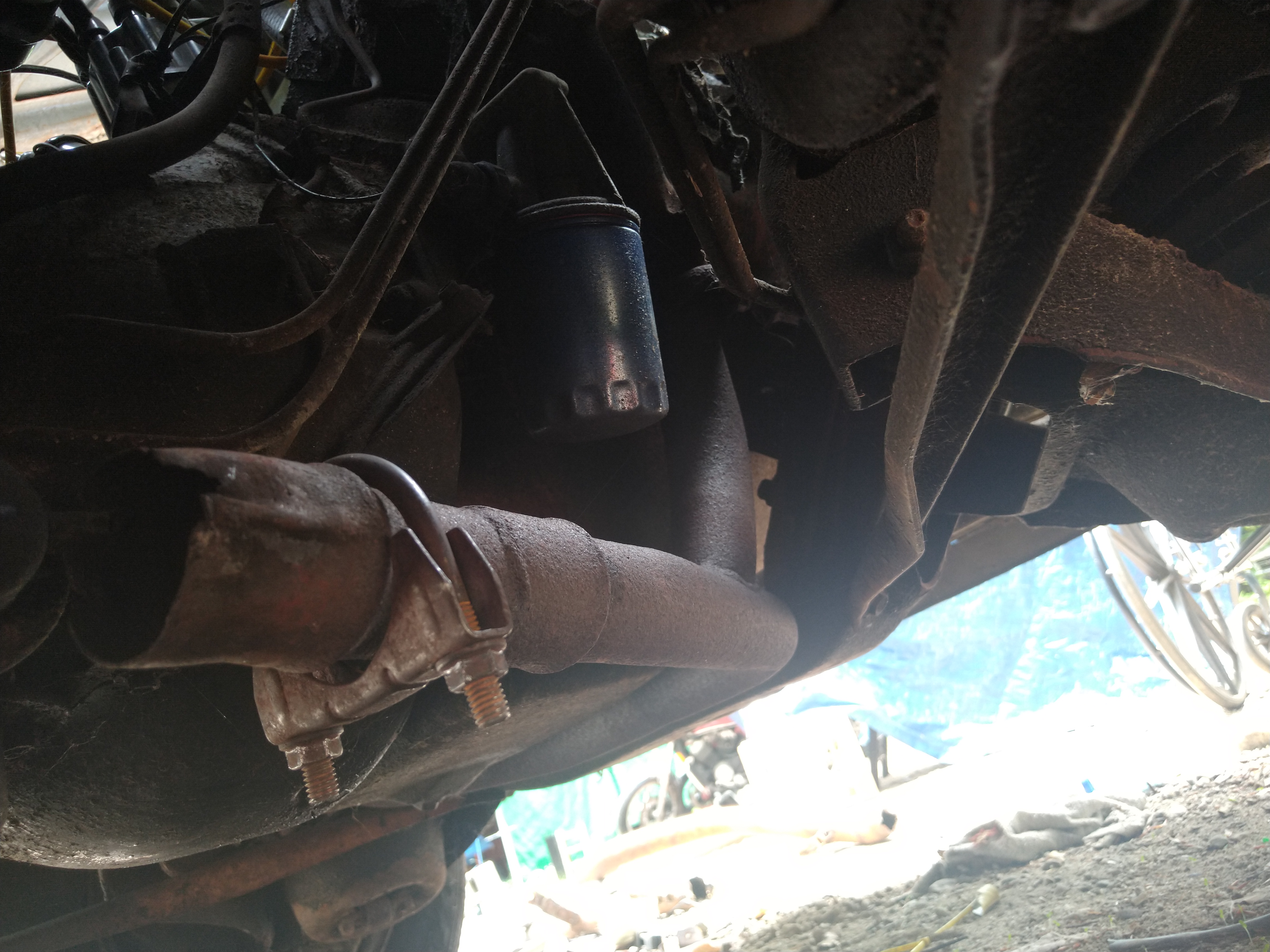

Most of those logs go out the very back at an angle. I'd use them if it wasn't for the fact that that dump angle.... Points right at my oil filter.

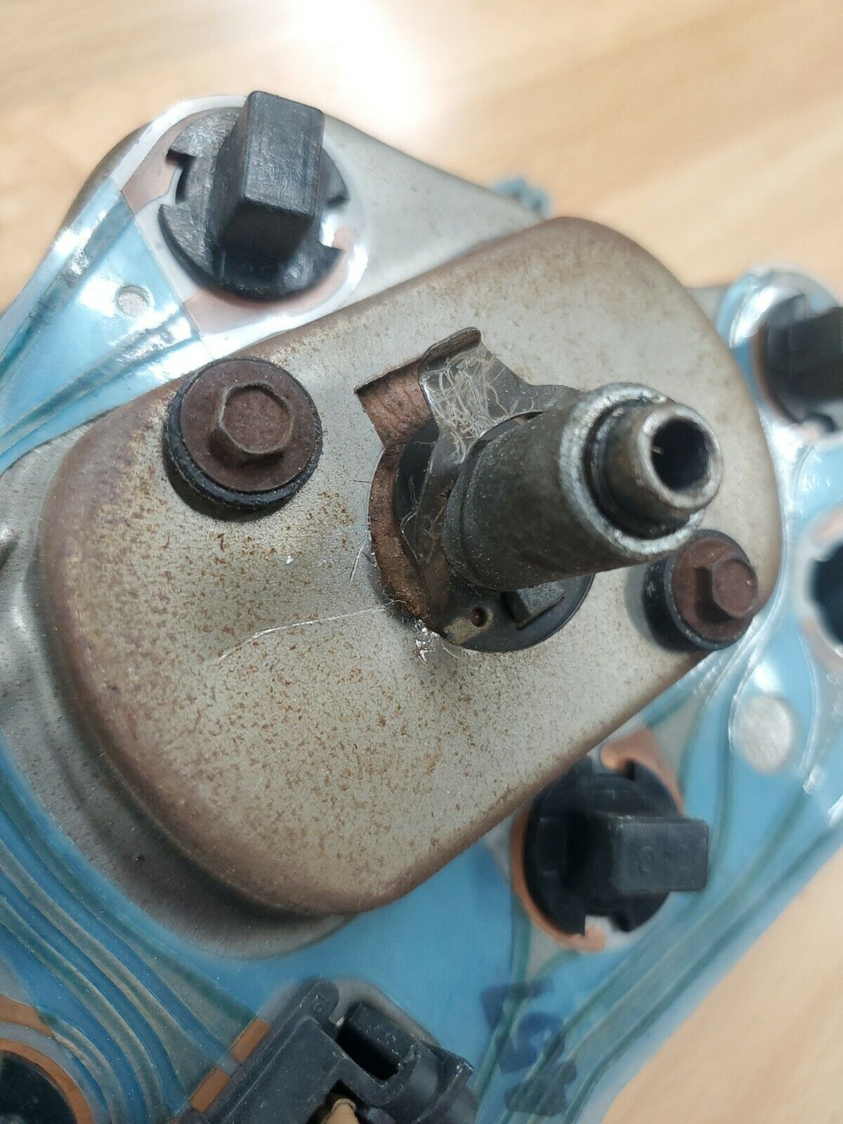

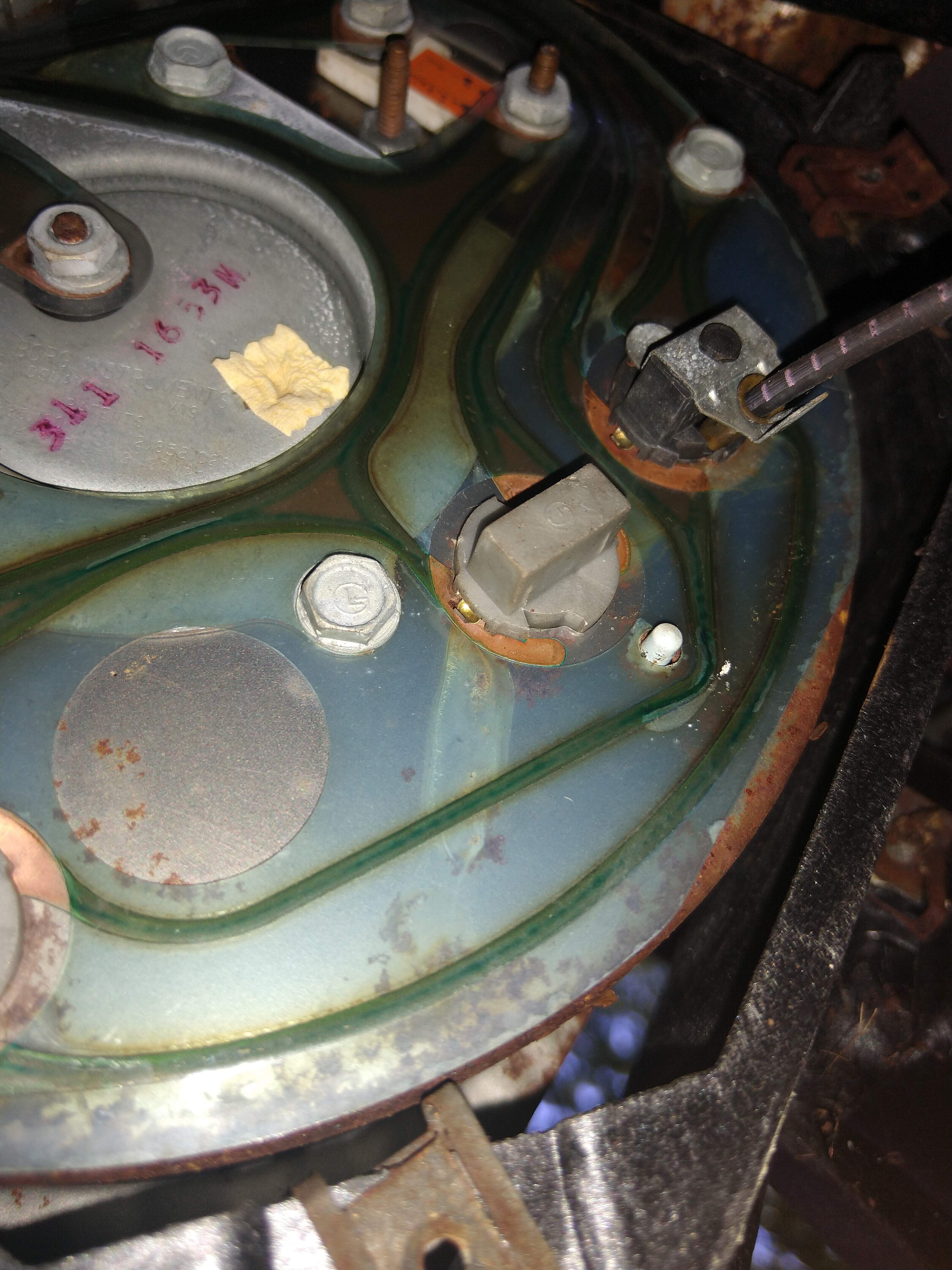

I fixed the factory exhaust for now. Was tired of dealing with it. I'll get some more welding on it when I can get it higher up in the air. Am turning towards getting dash lights and stuff working. Found my issue and the replacement part. Couldn't get the speedometer cable off and didn't wanna break it. How does it come off. I did get some LED bulbs but they didn't work for some reason.
The speedo cable has a release tab on the gauge/cluster. The picture below is from a GTO but it highlights what you are looking for. You will probably have to do this by feel. The speedometer cable plugs into the back of the speedometer. The cable is held in place by this semi-circular tab. You need to push that tab forward (towards the driver) and pull the cable towards the firewall at this same time and it will release. It's a pain in the butt job lying on your back with your hand up in the dash, ask me how I know....
