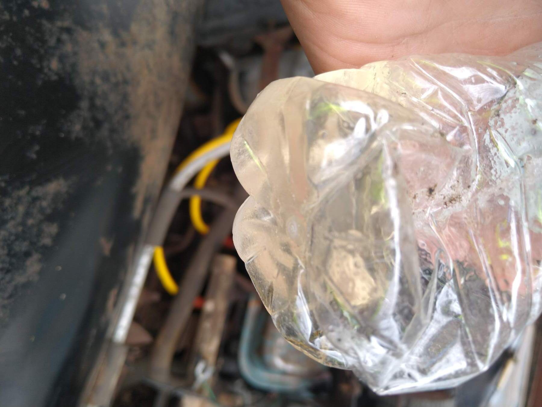

DId you blow on it or through it to make sure it is clear? If you  put your lips to the end of fuel filter and you can't blow air through it, then it is clogged and needs to be replaced?
I know, I know - you might get some gasoline on your lips. Hazard of the job I'm afraid. Bleek - no one likes the taste of gasoline!
However, these filters are designed to allow fuel flow under 15 PSI, so using compressed shop air is not a good idea. It can damage them if you apply too much pressure.

how do I put my lips to this
Put your lips to the end you have showing, take a breath and blow. If you feel it restricting your air or you can't push any air through it at all, it's blocked or high restricted. A new, unused or unrestricted one should allow your breath to go through with almost no or very little resistance.

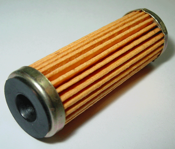

Same idea for a paper cartridge filter. Blow on this end.
It's not clogged, Can breathe through it
it has almost no particulate in it. Which is leading me to believe it's carb that needs some TLC. I just need to get me some carb clean

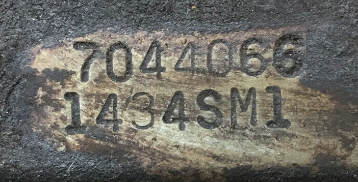

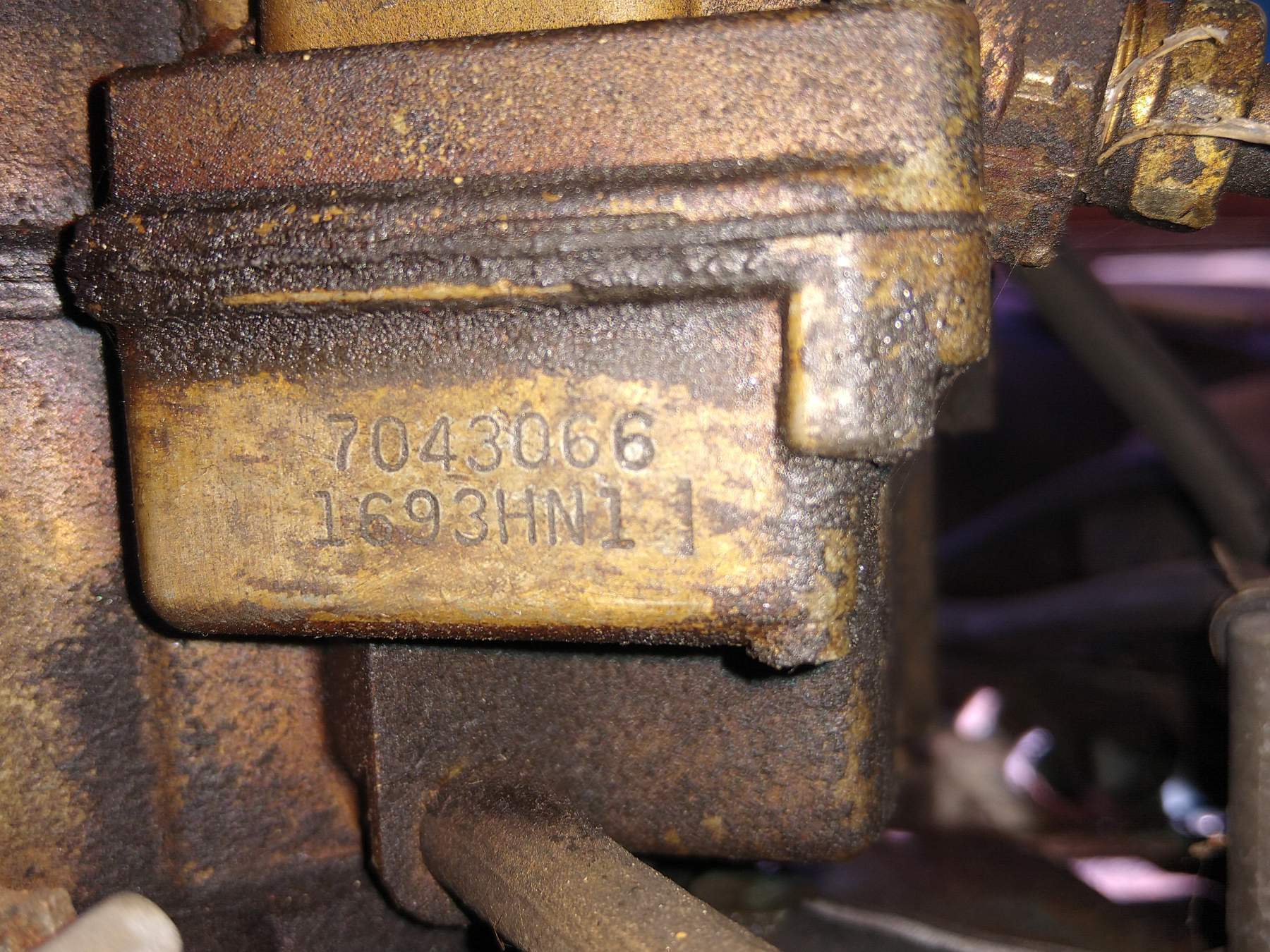

I have the number from the carburetor. What kit should I look at?

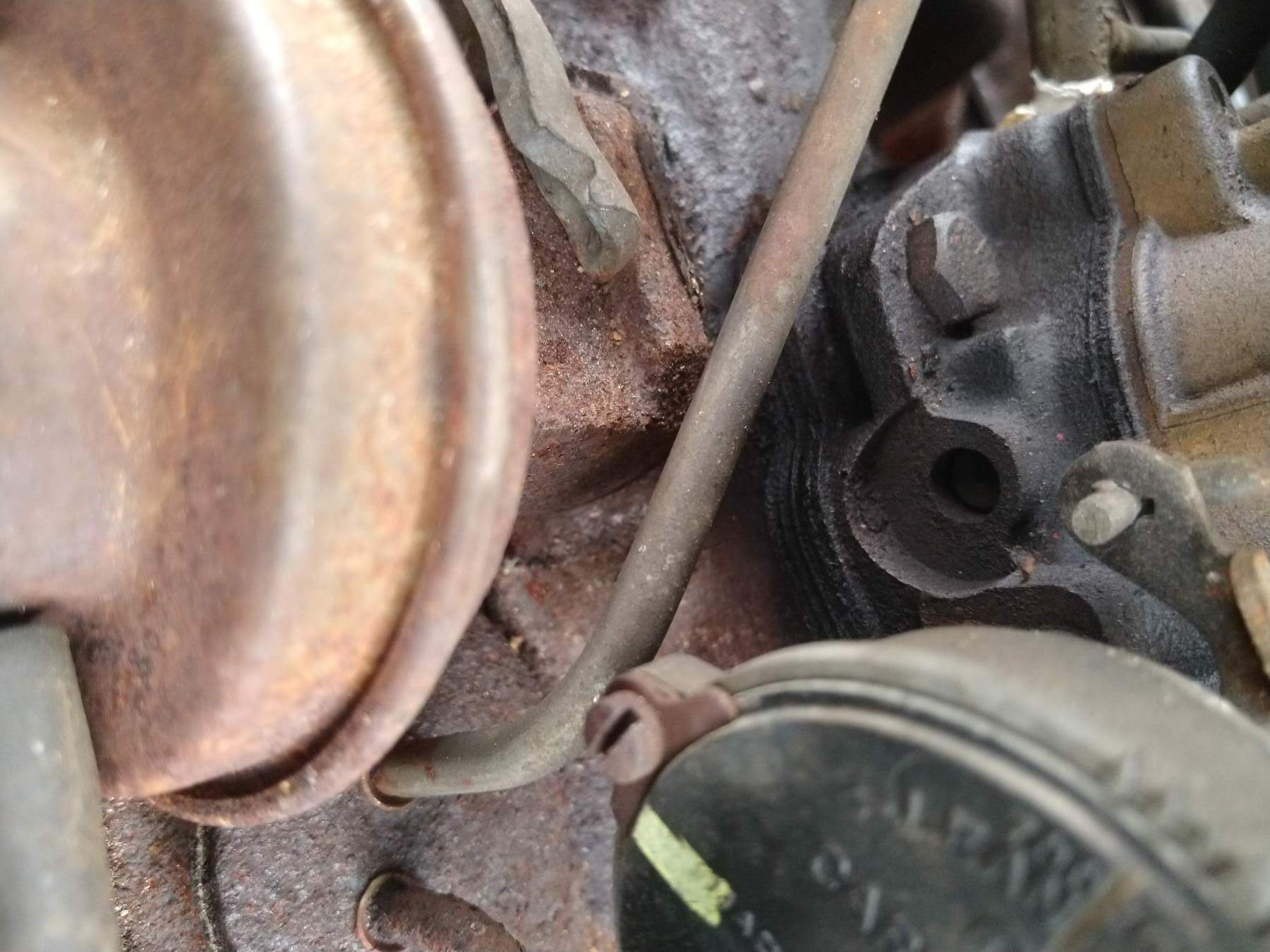

is that normal or how bad is that carburetor on my car?
The Carburetor appears to a Rochester 2GV...With a Divorced Choke (hot air)
Yes that is Bad should Not be leaking gas out of it anywhere...It will never run right if at all in that condition...
Cold hard reality is to either rebuild/replace the carburetor...Anything else would be a waste of time/effort...
The 7043066  number you need when acquiring a rebuild kit...
Rebuild kits cost around the $50.00 range...Some kits are better than others as some of the cheaper ones may not have every part that you need...
One other thing Rochester 2GV carbs are two different sizes...Either 1 1/4 or 1 1/2 inch venturie sizes...If you get good used carb   from a different car Measure the throats (venturies) first to make sure they the same size as the carburetor on your car...

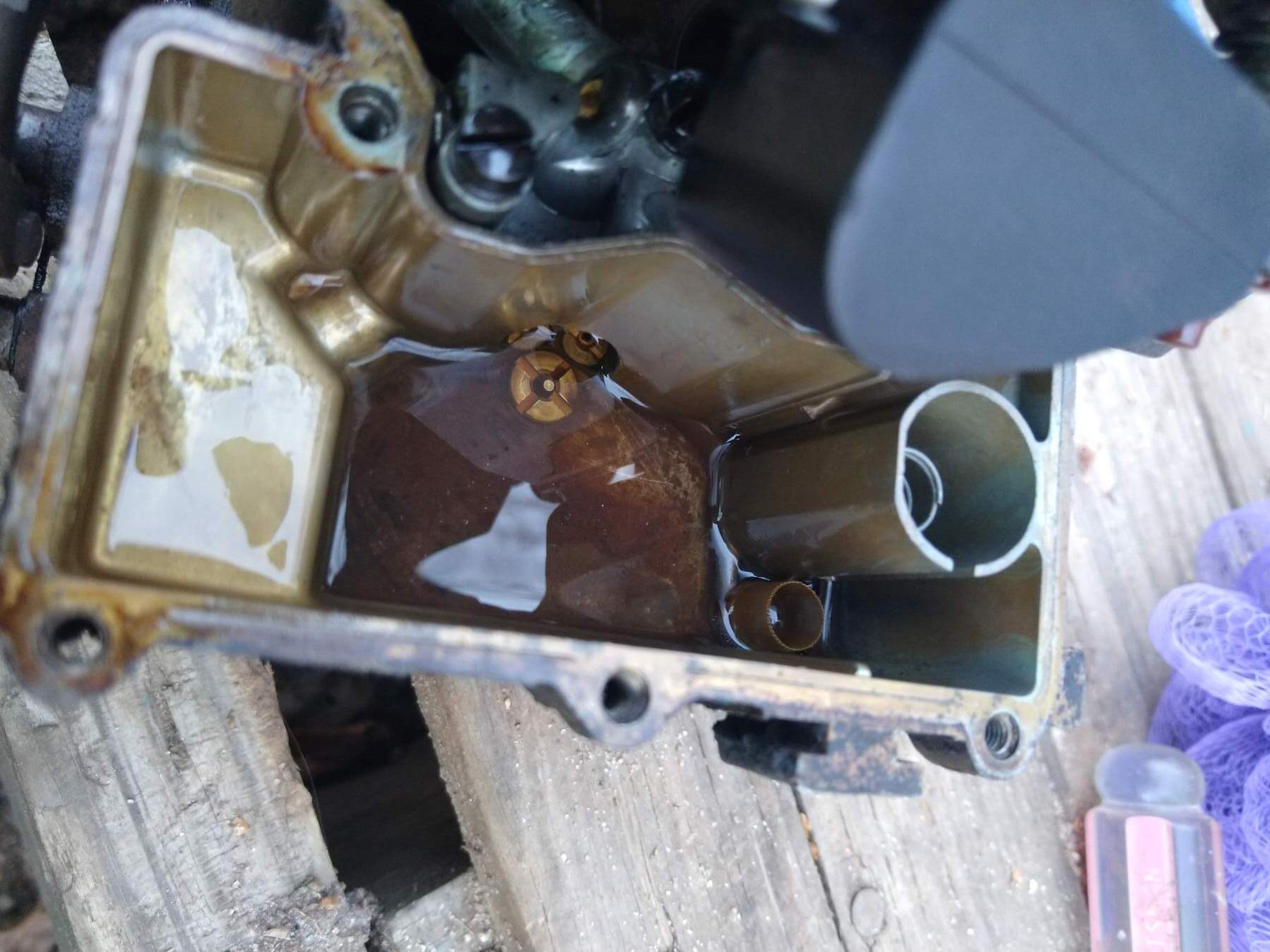

thanks. Much appreciated, someone on fb had messaged me saying they have carburetors, if they get back to me I'll share the numbers to see if they would work for my car, I have a slight suspiscion that the brass float on one side has failed as well, as that is one cause that can make the carburetor leak from their
I took the carburetor apart, did make sure to take many pics of it, though wrestling the linkages isn't easy. it was gunky on the bottom but nothing looked wrong with it, nothing leaked when I put carb cleaner to it so the seal is really confusing on what exactly is leaking. Just heard from the guy with the carbs, gonna get some pictures. will share with here to see if any will work.
