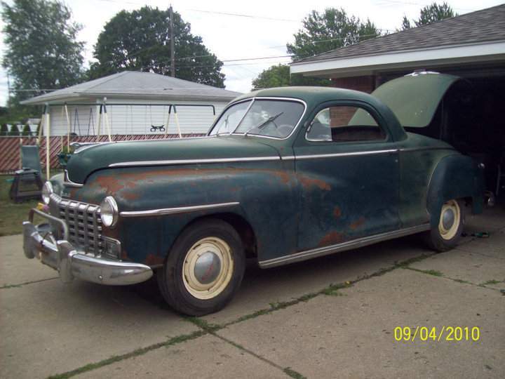

My coupe.

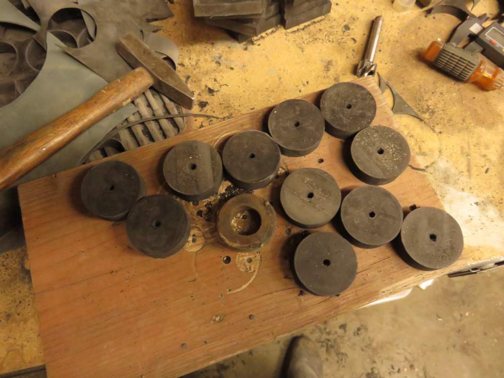

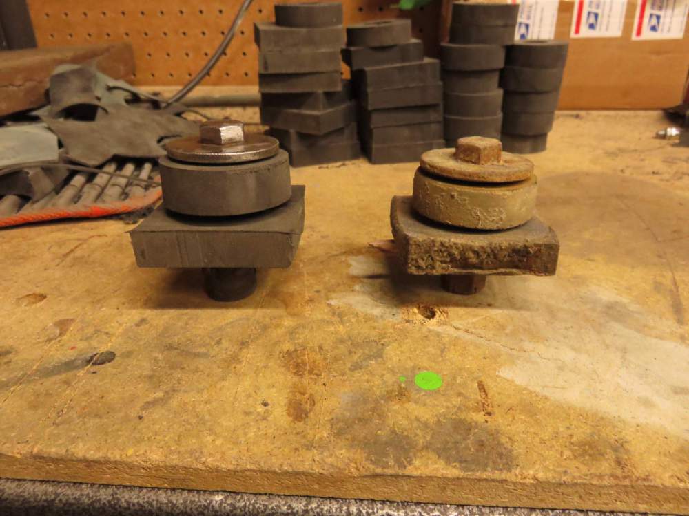

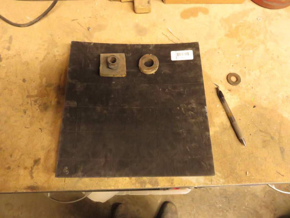

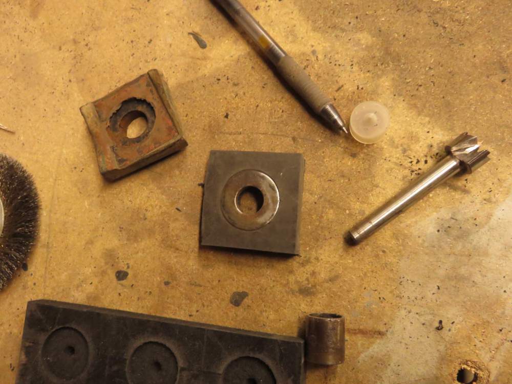

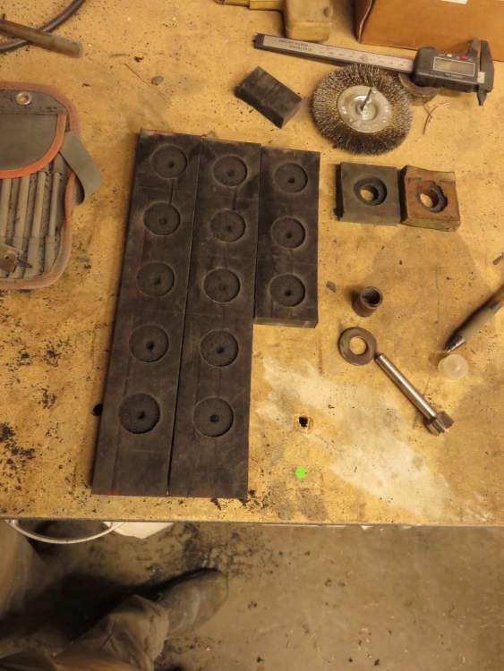

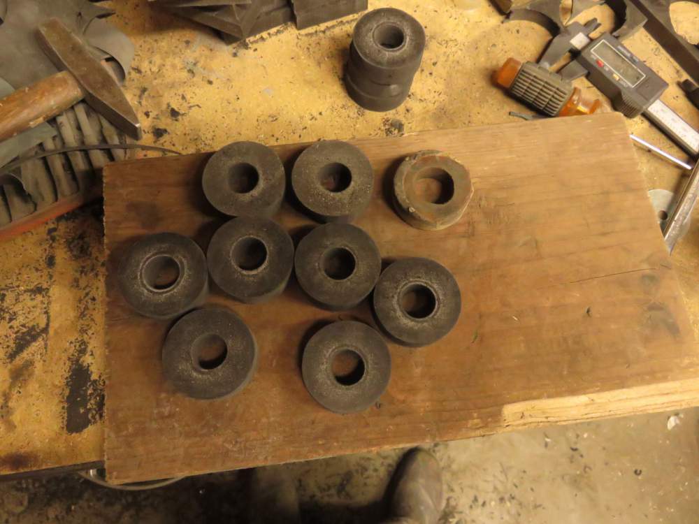

I've been searching for the rubber body mounts for the 55.  Cheapest that I can find is $175 for 28 pieces of rubber.  I decided to make my own.
1.  I bought a sheet of 1/2" and a  sheet of 5/8" thick rubber.
2.  cut out the 14 2 1/8" x 1/2" square pieces.
3.  used a spade bit 1 1/4" to make the inset for the steel washer in the bottom.
4.  next I drilled the 3/4" hole through the middle using the hole that the point of the spade bit made when it exited on the other side to center the 3/4" arbor bit.
That finished the square parts.
5.  the round parts I cut out using a 1 3/8" hole saw
6.  I then used the same 3/4" arbor bit for the center hole.
Total cost $35.

Mike, a really nice job on the rubber pieces!
A little something you might care about or not! The rubber you used looks to be fairly hard in durometer? So the tooling you used worked well clearly, but if you ever need to cut a bit softer durometer you need to make or use a coring type cutter for both the O.D & I.D. and use glycerin as a cutting lube. Also I don’t know whether you have a lathe or a mill, but if you do you could make the bolt you speak of. Taking or making the proper bolt size & length, than machining round stock to the diameter & thickness you want for a washer. Put a hole in the washer that makes it a press fit to the shank of the bolt.
Just so food for thought!
