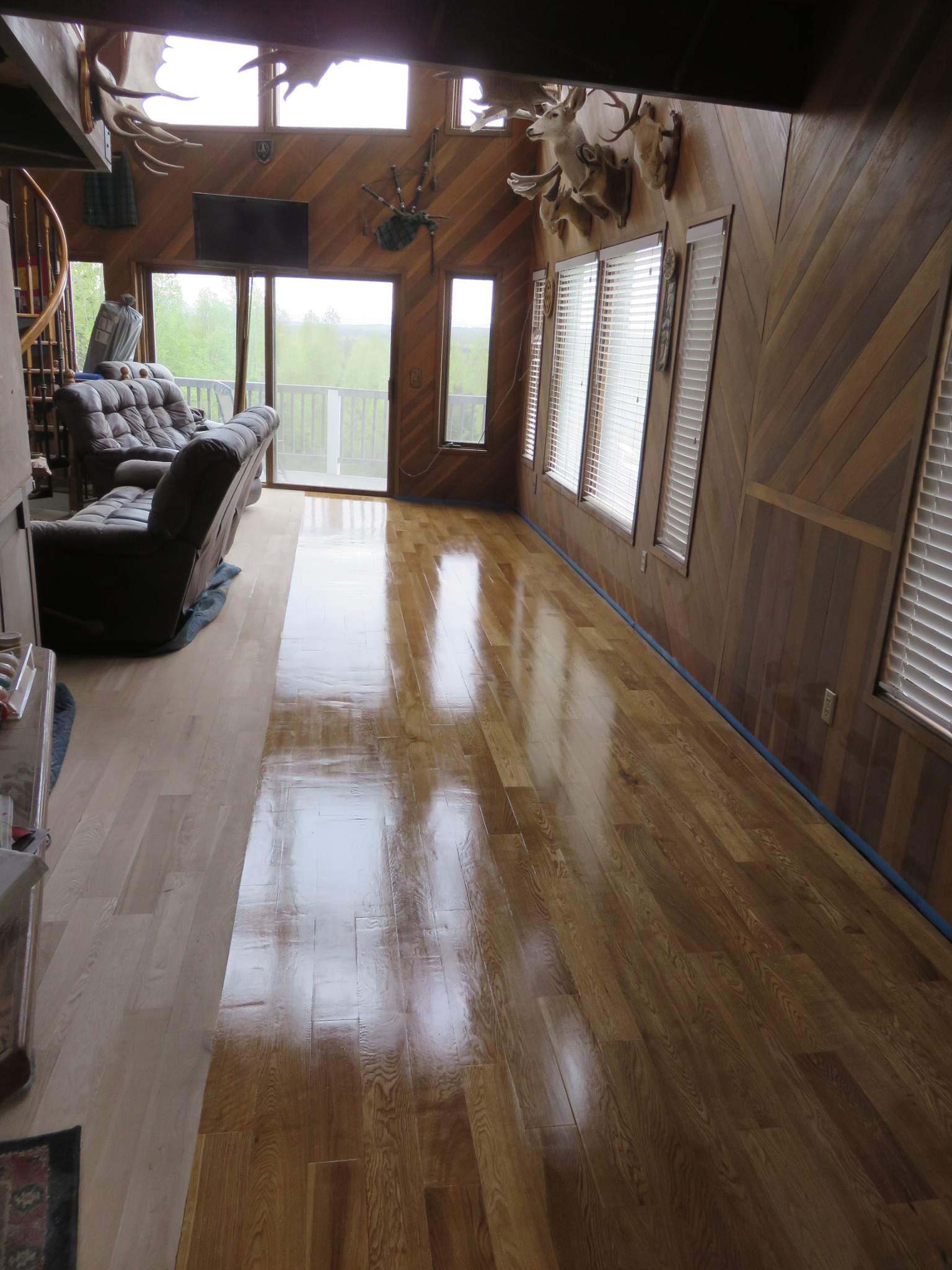

Haven't been working on the 55 in a while.  Had to go down to my son's and spent 4 weeks finishing his basement.  1800 square feet.  Still have to go back on 2 June to finish.  I've also been getting next winters firewood done and have pulled up my oak flooring, planed the old finish off, relayed to get rid of the shrinkage cracks, sanded and am finally putting finish on.  Just wanted to let everyone know I'll be back on it around the end of June.

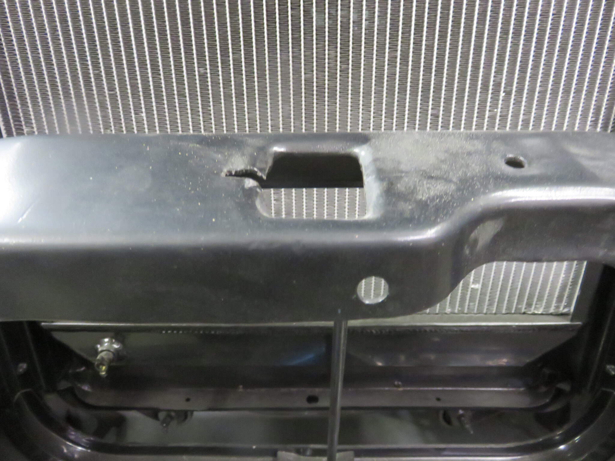

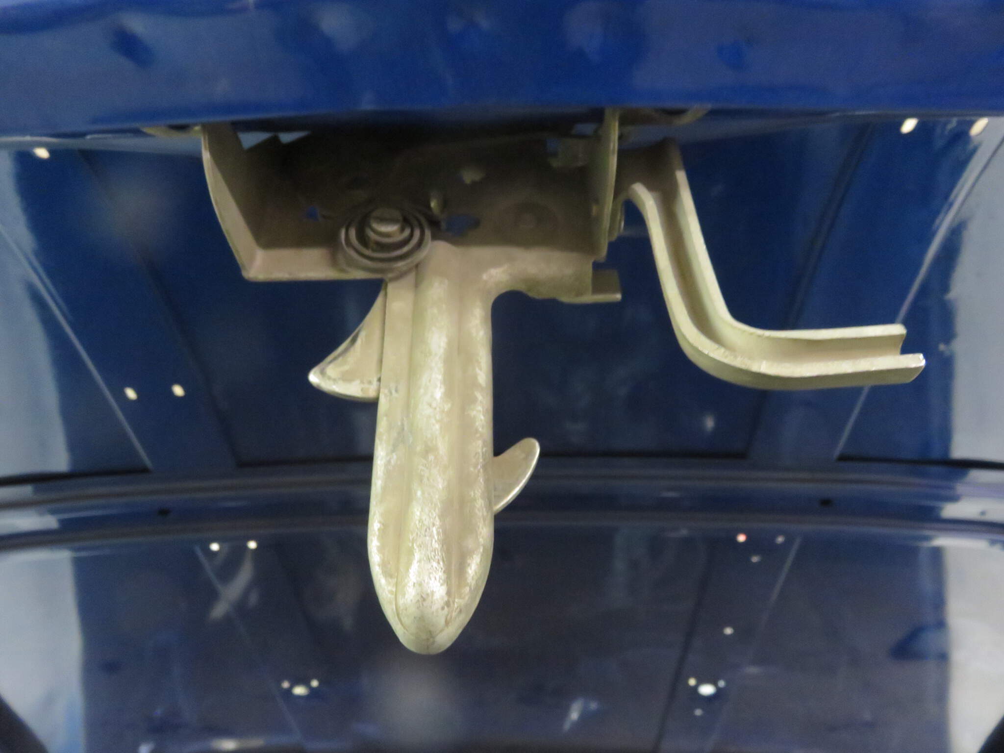

I'm reinstalling the front sheet metal getting ready to paint. Have to align the hood but am having problems with the hood latch. It goes into the hole/slot perfectly and the latch and safety catch function well. The problem is when shut and I lift on the hood only it will raise in front 1.5" until the safety catch catches. What keeps the hood down snug? A couple of photos.

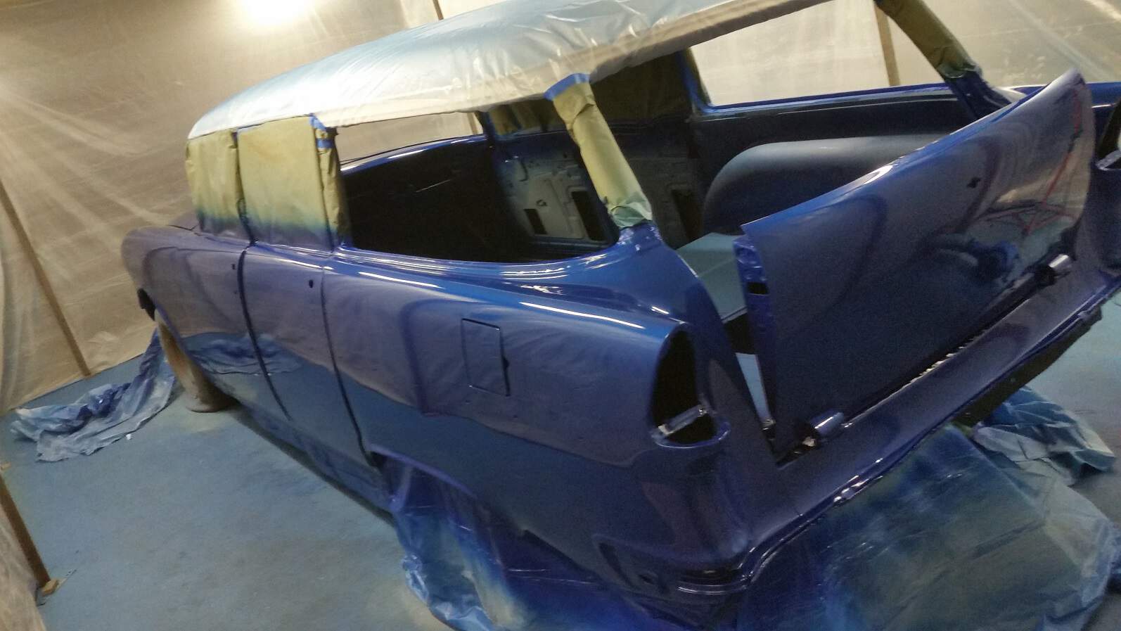

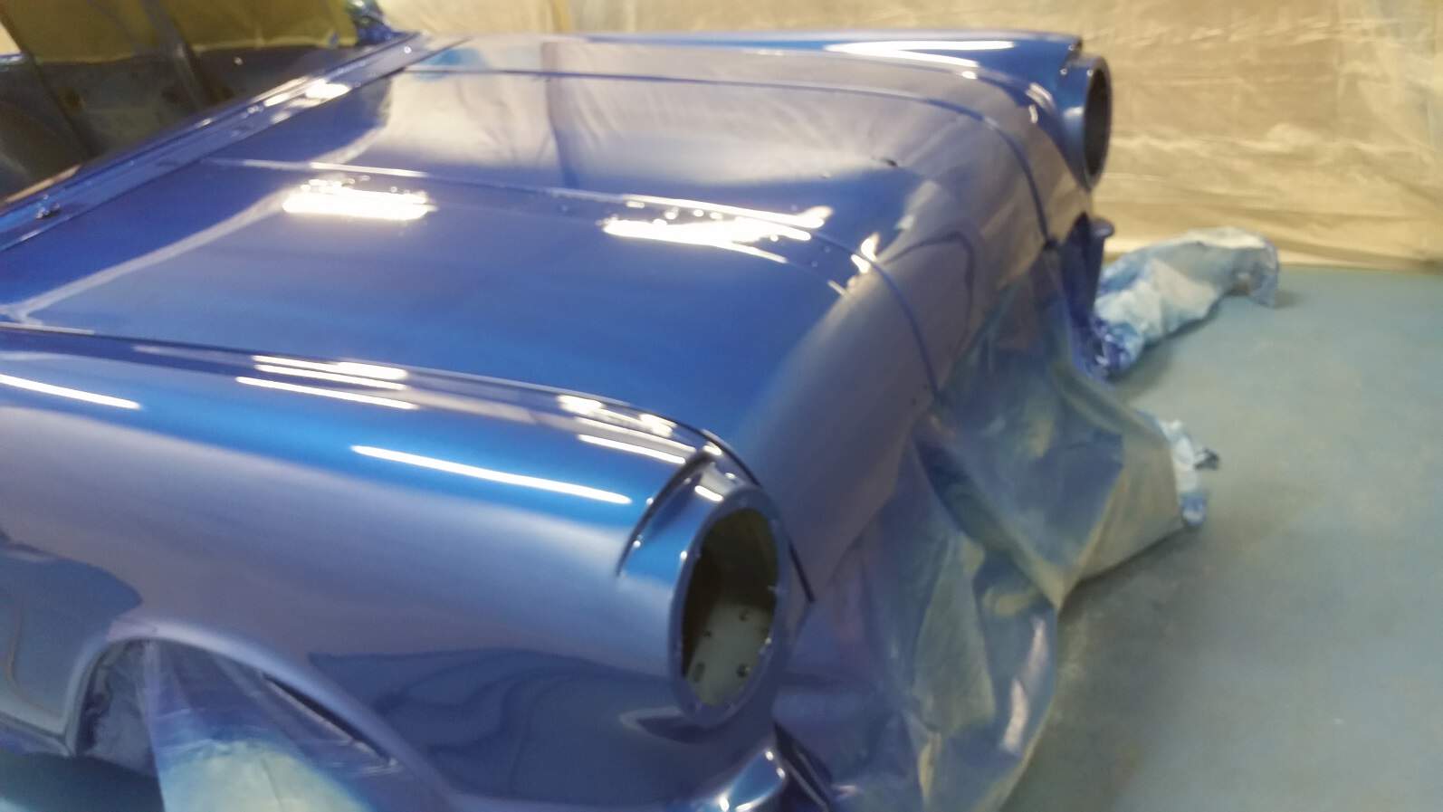

Just finished putting 4 coats on.
