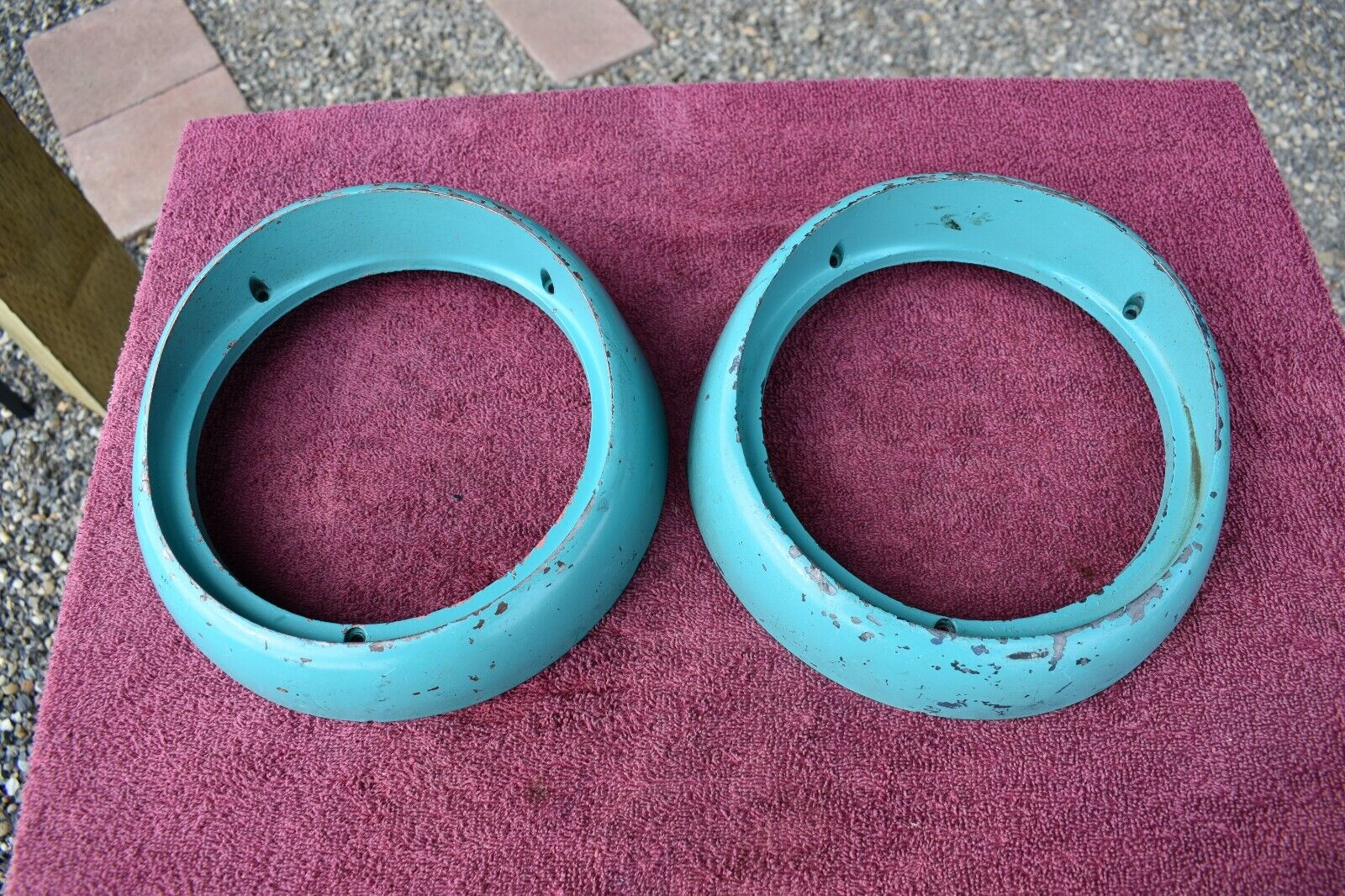

23 hours ago, 64 kiwi boni said:
top one is justA the chrome ring
second one i couldnt open
third one is a complete unit but the chrome ring is toast
fourth is broken and they are made of pot metal, so no fun trying to fix it
Didn't think that would be made of pot metal.  #4 Broken one could be repaired with my Ol buddy JB WELD. Not like it's load bearing piece.  Oh well.
true true, but looking close at the picture the chrome ring is also cracked

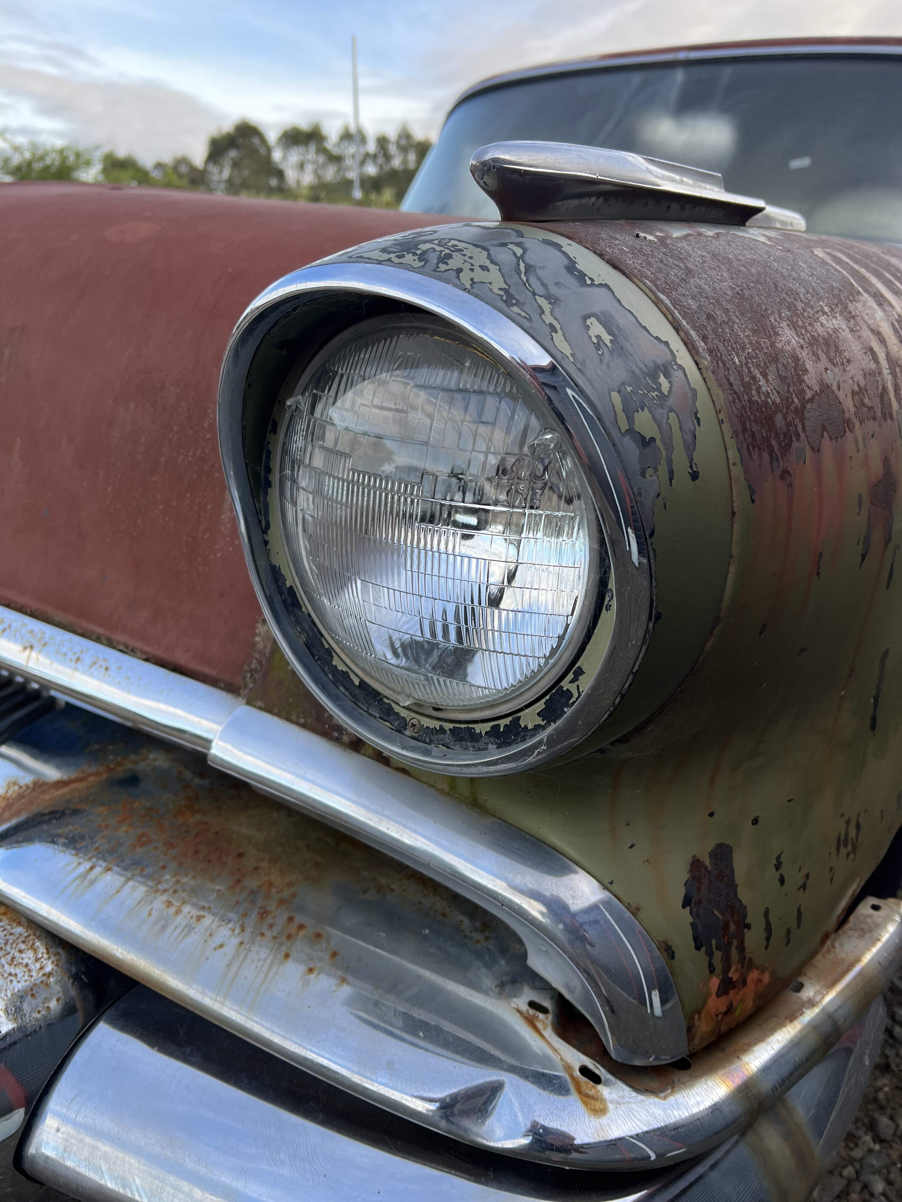

I am seriously thinking about cleaning up the paint work and keeping her original !!! And where the paint has been sanded down to metal . Do a resto patch paint job , including the section I have to do rust repairs on , like that passenger door lower section then match the oringinal paint ..
Looks great just like that. Patina is in atm and as far as I'm concerned,  it's always in. It's very satisfying scrubbing old paint clean and seeing the result.

You know what … I am not painting the 57 now . I am going to sand all that brown primer off . I will fix. The rust . And have the new sections  paint matched to the rest of the old paint work … why , because a car only has its original paint once ! :dancingpontiac:
