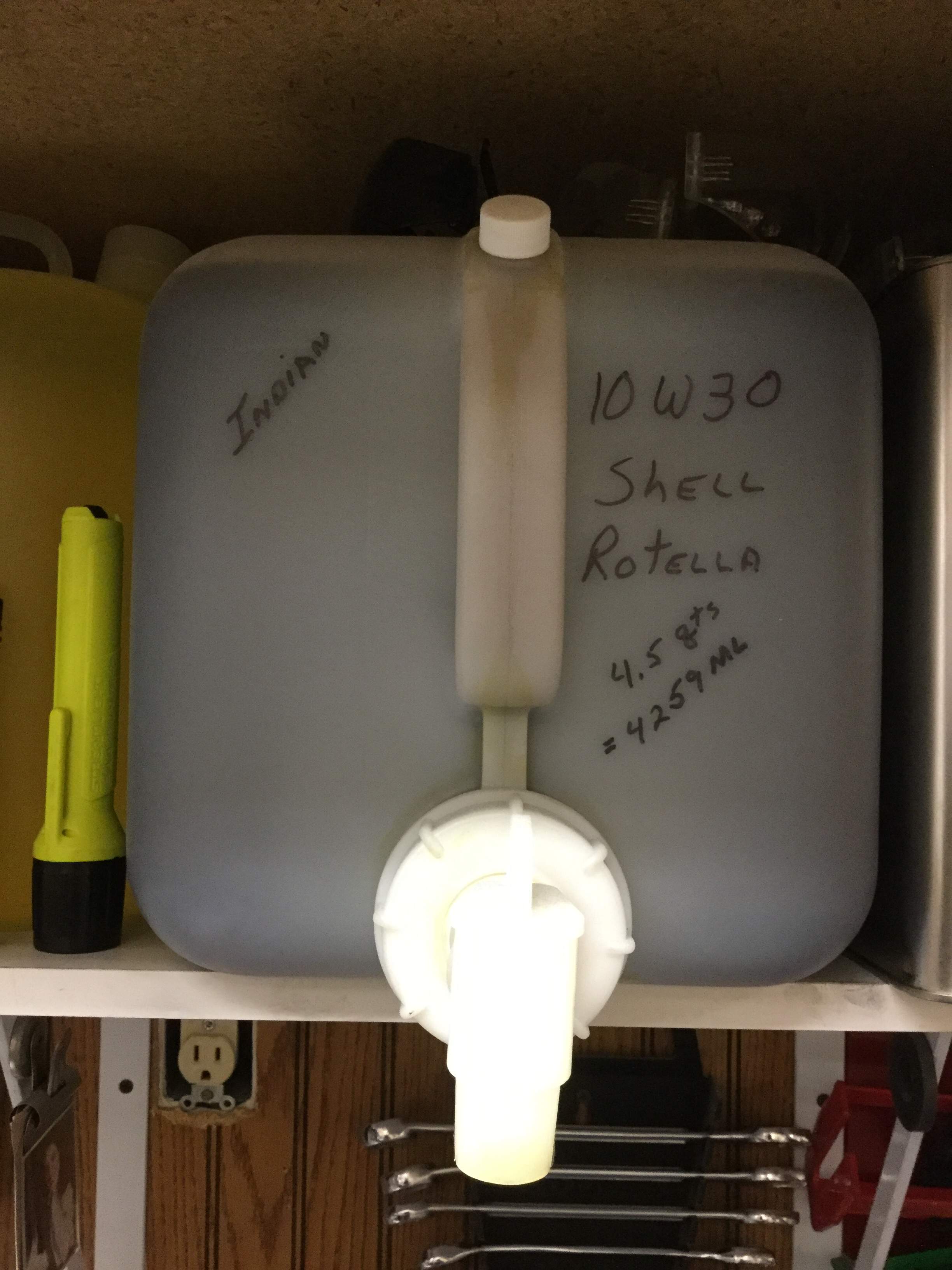

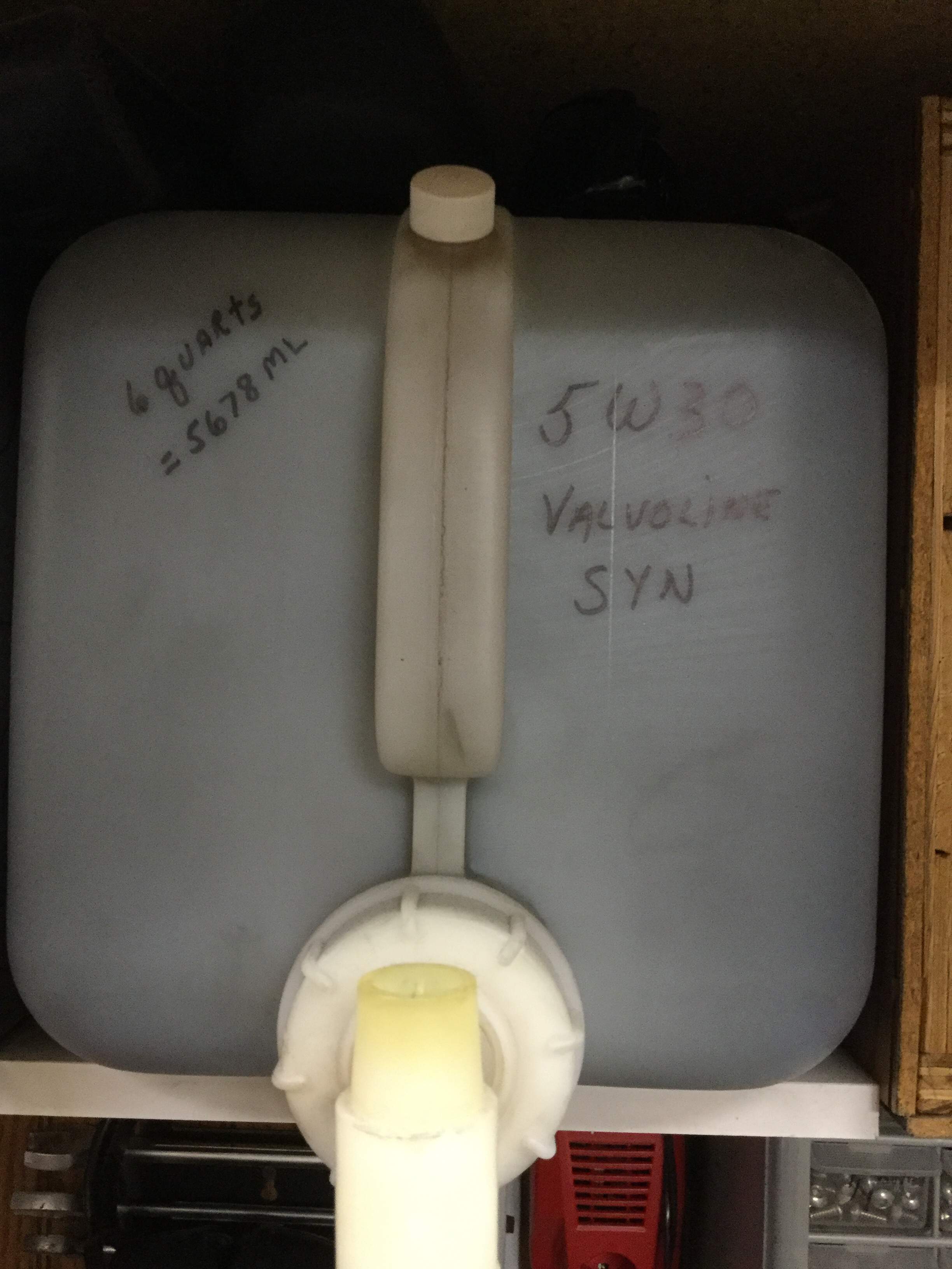

Kiwi, I’m not paying anything😁! Did I ever mention I worked for one of the largest specialty chemical additive companies in the world! One of the perks of running experimental testing! I think my reserve stock will take me well past my oil changing days!🤞
Checking online it appears you can get a gallon of T4, here for around $15.
It looks like the Valvoline syn runs about $20 a gallon. So again you see my point! The T4 is conventional oil, the Valvoline is syn oil, I would run both 3000 to 3500 miles for an oil change, but the T4, which I run in the Indian I Change every other year, which is usually between 1000 & 1500 miles. The point is the T4 has the full additive package that was always in both oils till they cut the pass car additive package in half. But the T4 is cheaper than the Valvoline! Really!!
