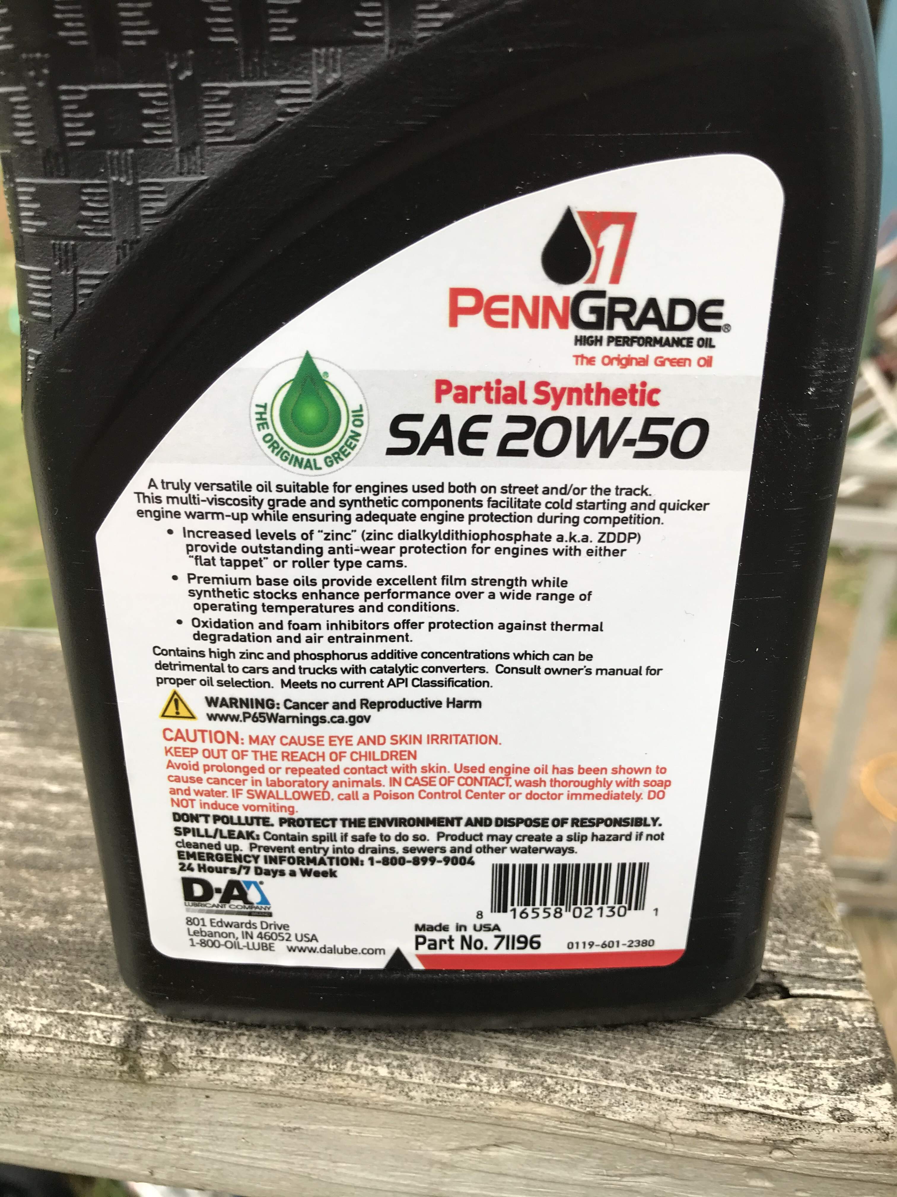

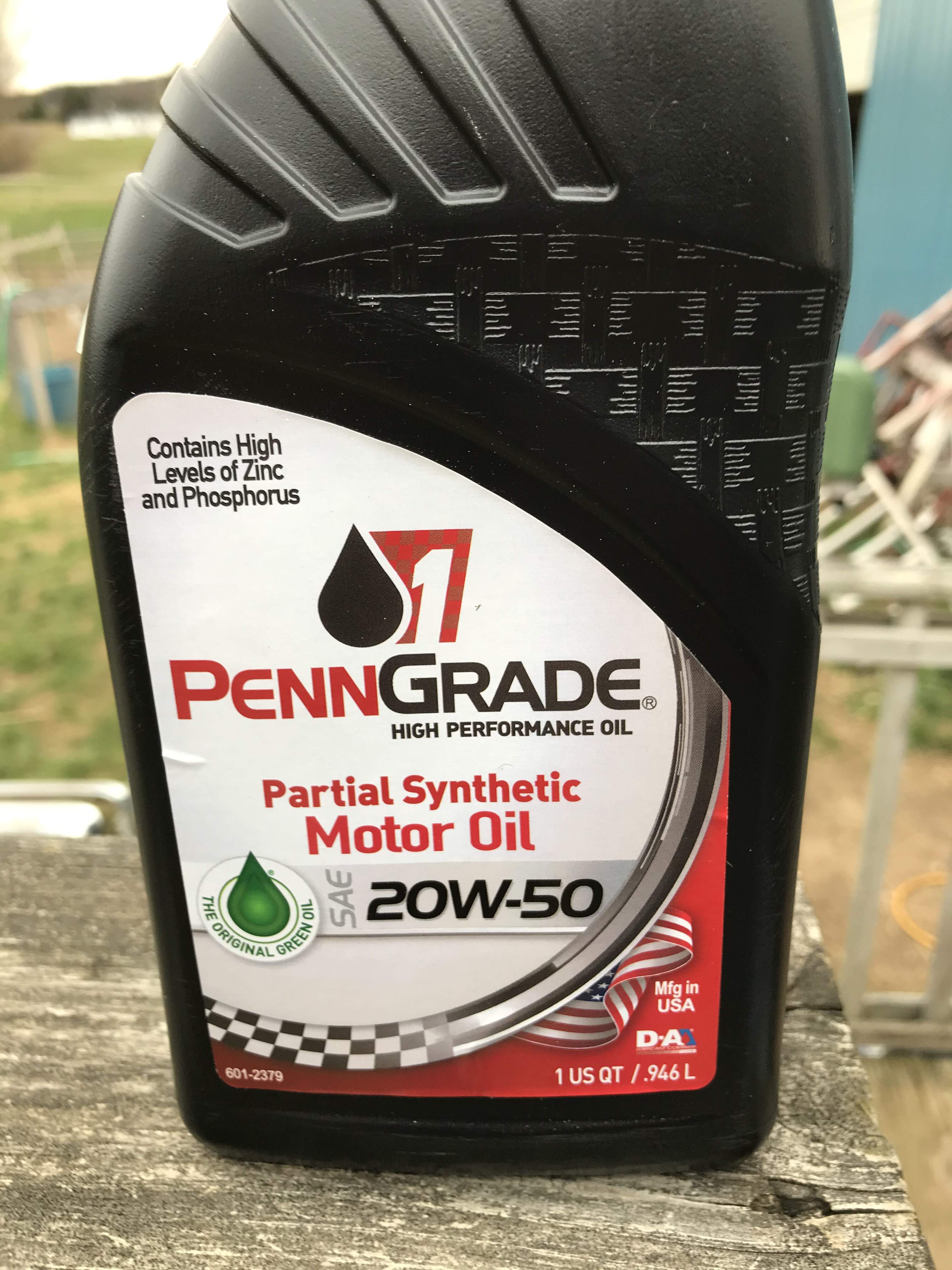

Oil roll call. What do you run, and maybe why?
So my machine shop highly recommended Brad Penn/Penngrade oil. This is the first time I’ve used it. I do not have a problem spending the extra money on good oil. I just thought this would make for a nice topic. I’m sure there are a lot of opinions on this. Stay healthy and let’s hear the stories guys!!!
1 hour ago, JUSTA6 said:
I've always liked the Castrol 20w-50.
Yes, folks all have their own opinions on what oil to use, what’s best and so on, but at the end of the day most folks don’t really have the knowledge about what makes a good oil or why! That would include your machine shop! As I doubt any of them are chemist or know what the technical numbers mean! So I will try to explain again just from a purely factual point.
Most of the expense in buying an oil is in the additive package, which for the most part really makes or breaks an oil. Than would come the grade of the crude they use, which has its own impact. Than the blending of the two together can really make or break the final product. Obviously the best oils use top tier crude as well as top tier additives, but different companies tailor their additives packages and this is what sets the best apart. So that might seem simple, but there is one more element, the consumer! He as much as the additive package makes or breaks the final results of the oil!
An example is if I asked what is the most important element to an engine oil what would most people say? Most of the time, viscosity! That would be wrong! While viscosity is very important it has been documented that an engine can run on 0 viscosity! No I’m not promoting that. I’m just saying it’s not #1. TBN is the number one element in an oil, period! Without the proper TBN your engine would have a very short life. Yet if you run a lower TBN number oil and understand when to change it, that’s acceptable.
So while the PennGrade oil has good specs relatively speaking the ZDDP numbers are quite concerning 1500ppm is to much! Especially when you use it over and over! To much ZDDP cause corrosive wear in all the places you are trying to protect. Anything above 850ppm starts to get iffy. This also why this oil is not approved by the API!
Where as JustA is using Castrol, this has a lower TBN than the PennGrade but uses sulphated ash as the wear additive, which is actually a better, more controllable additive for this process. It’s also harder to over additize this way and Castrol is using it in the proper dosage. I’m also sure JustA changes his oil at the proper time before TBN vs TAN crossover.
There is a lot more than this to an oil. This just touches on a very small element of an oils makeup and function. Who knew!
