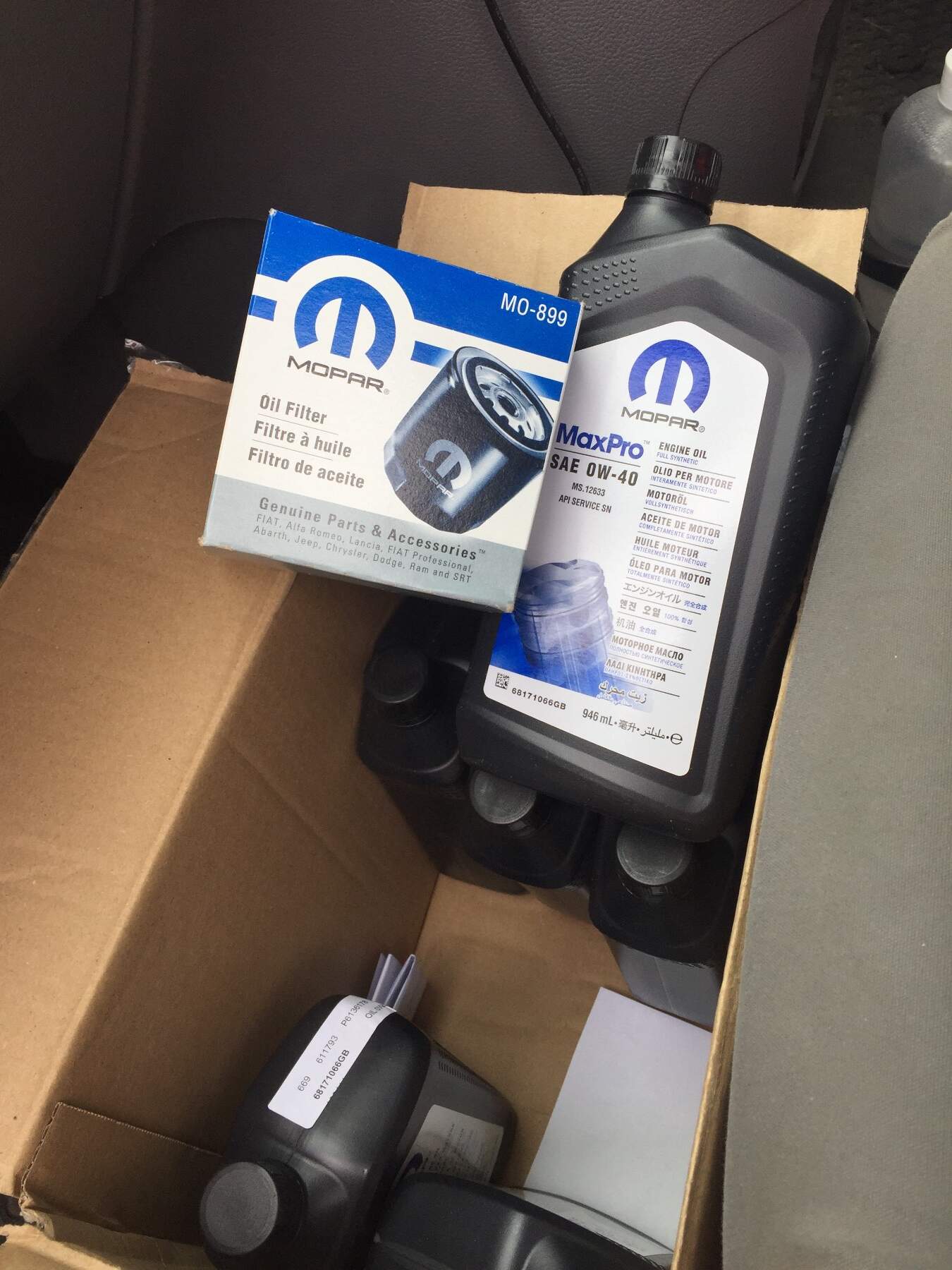

I know this isn’t Ponti-yak but
with my hellcat I have found a dodge dealer here in Nz that can supply me the correct oil and filter for my mopar (hellcat)
 which makes me very happy as i dont need a supercharged hemi getting anything less than what it needs !!
