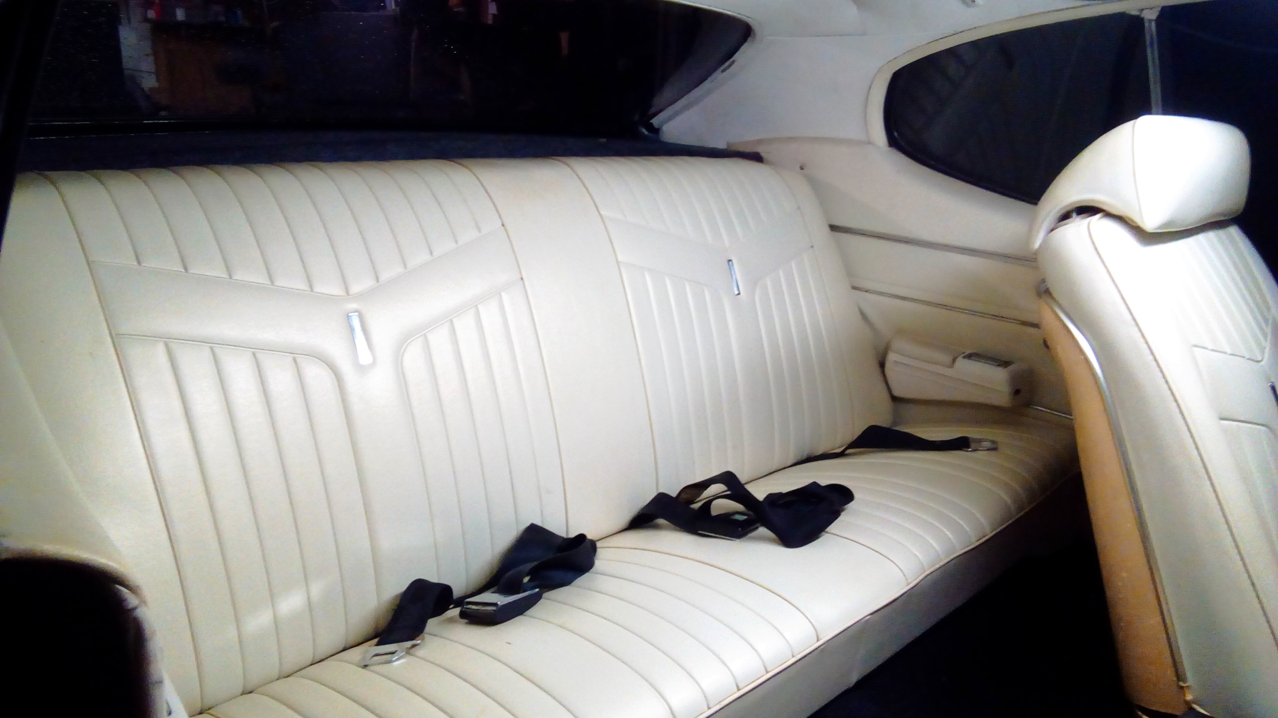

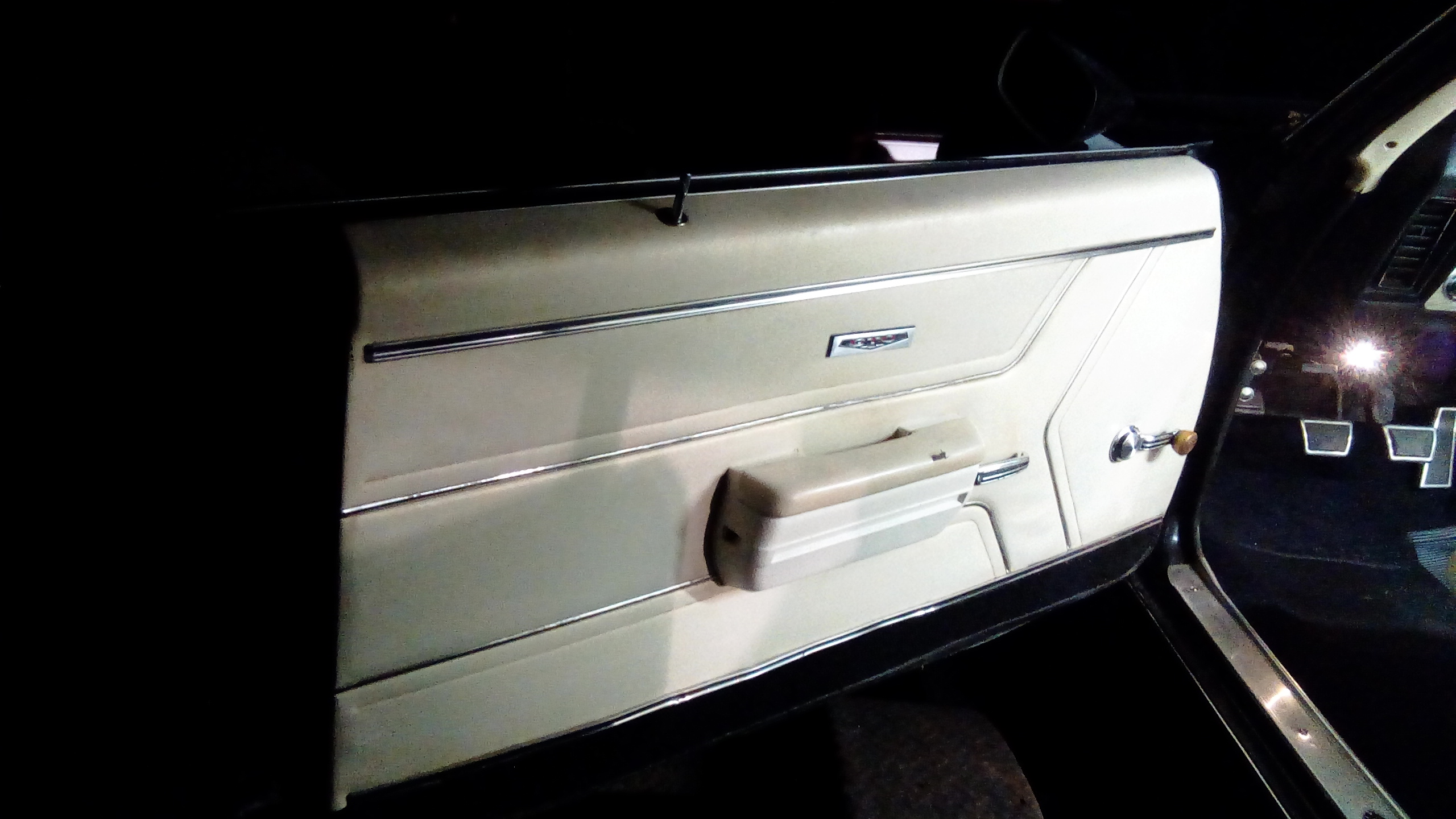

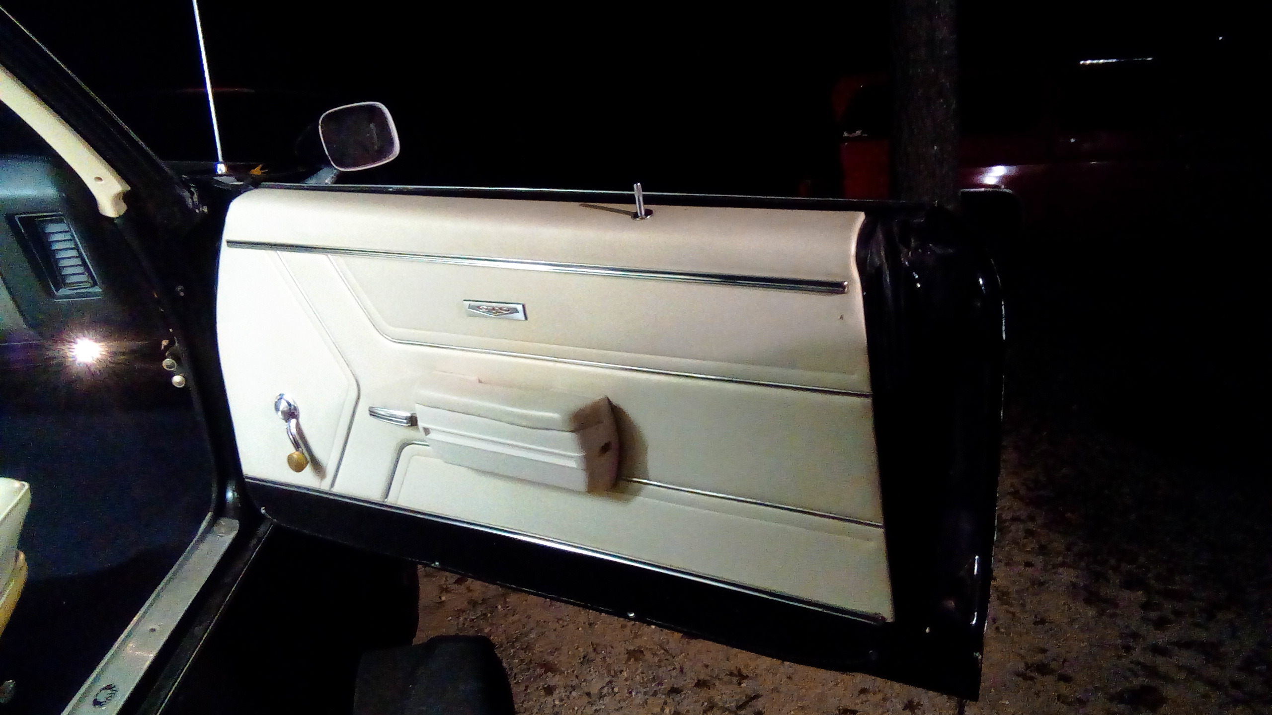

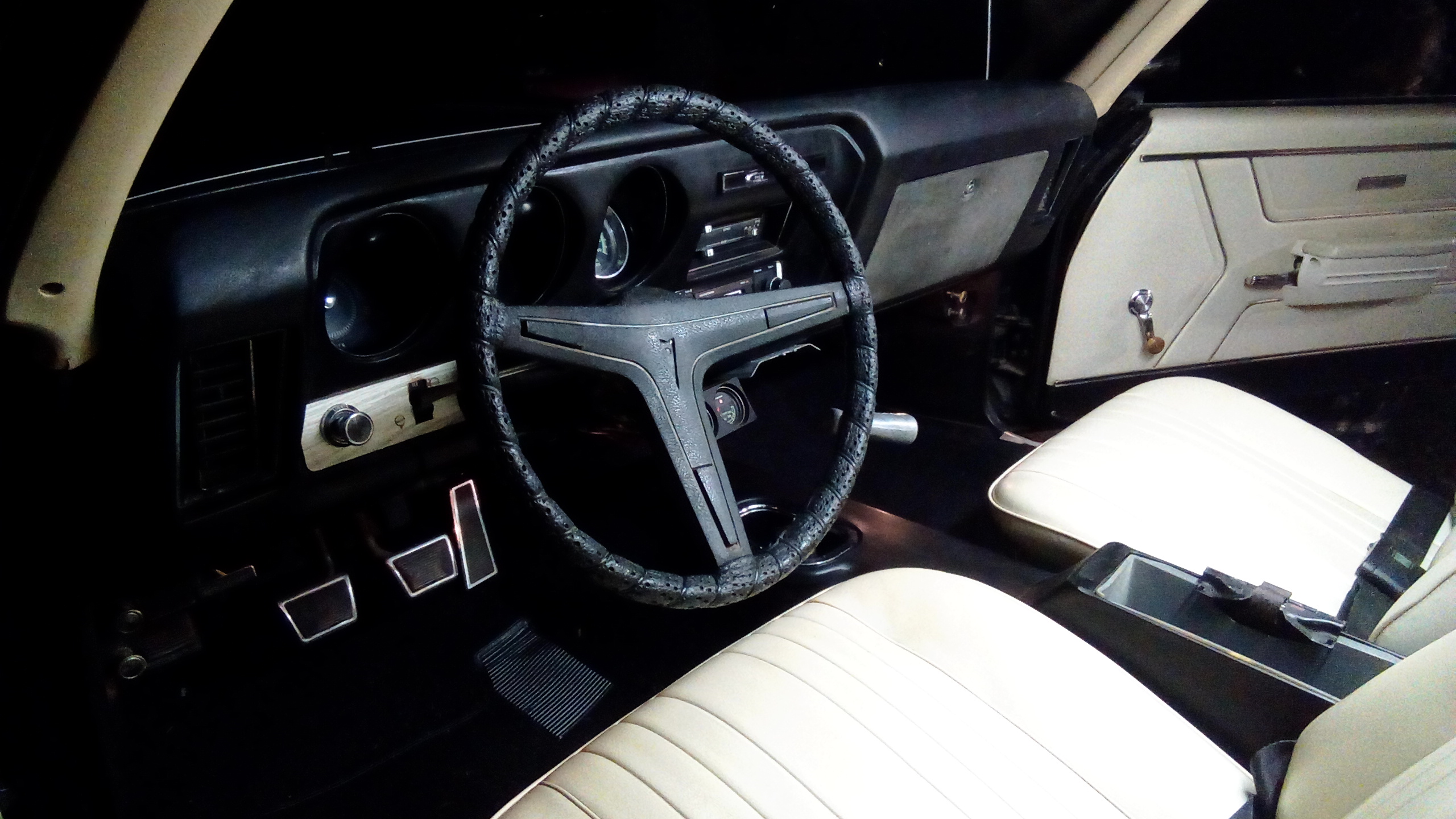

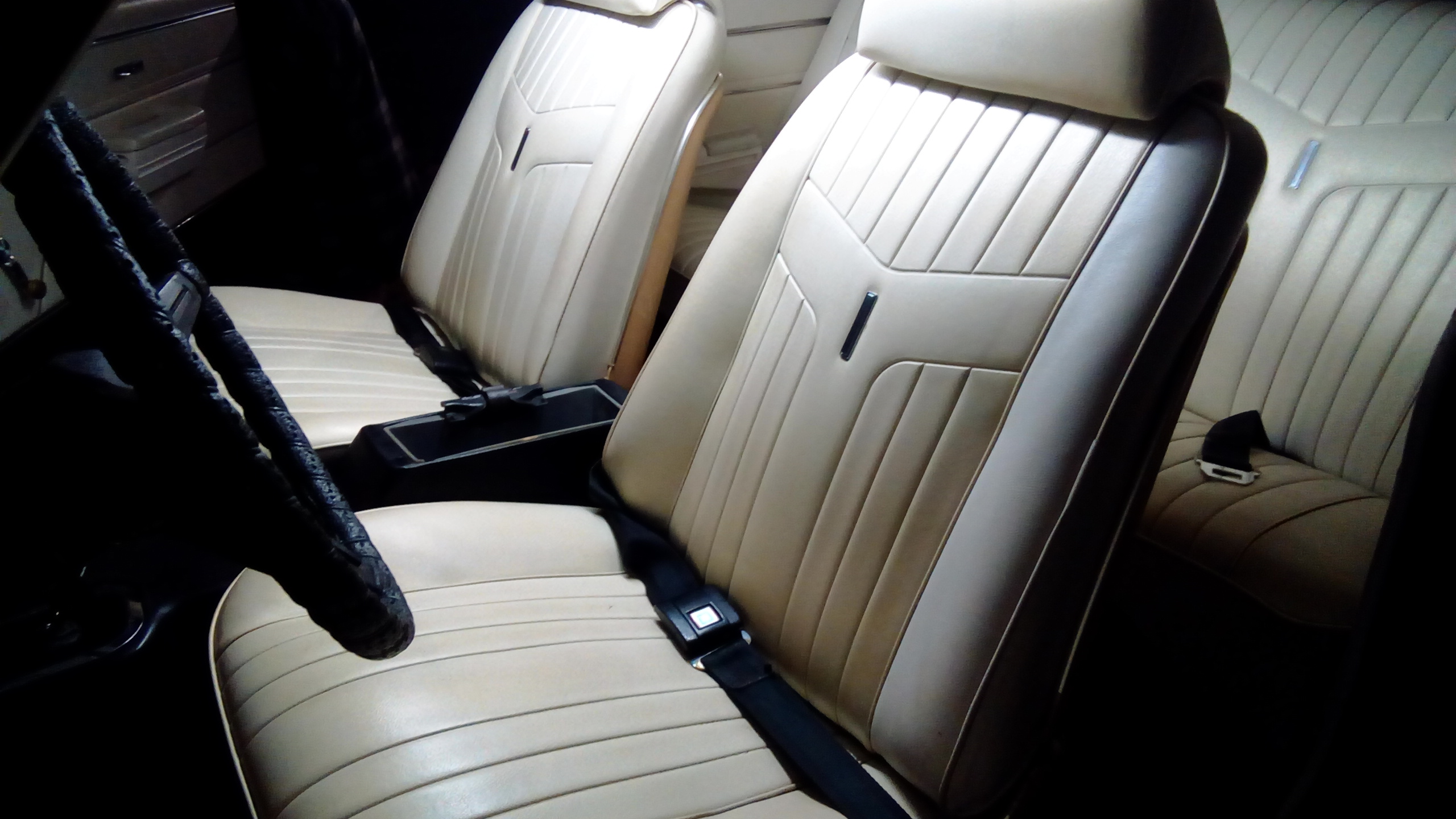

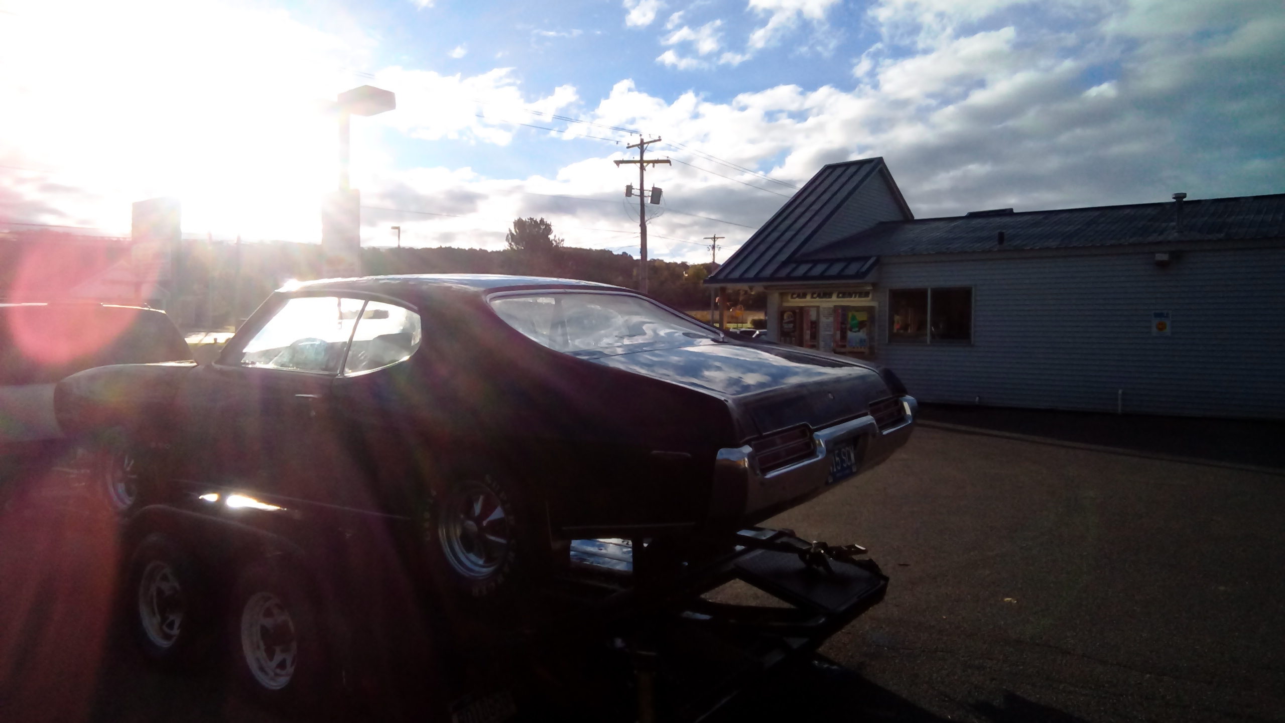

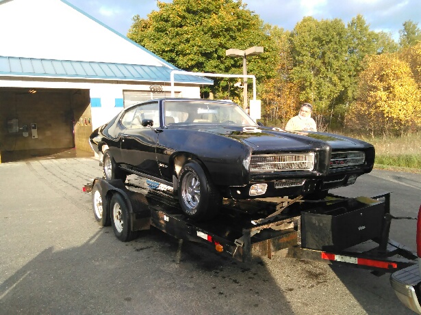

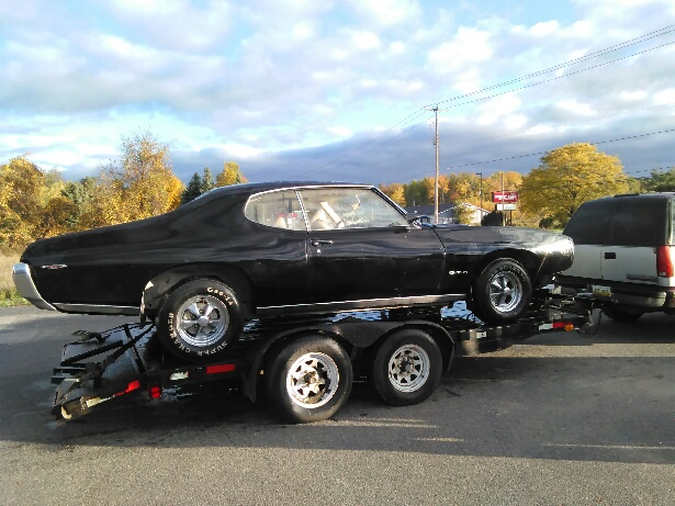

This is my find of a lifetime. 1969 gto 400 with 4 speed number matching. Been in a garage on blocks since 1986. Question was asked do you think it's worth 7 grand. Yes it is

Thanks everybody I spent last weekend cleaning it up this weekend I am hoping to get some fresh oil in it  and see if it fires up. The guy said he drove it in the garage where she sat since 86. The owners before him kept a hand written journal in the glove box documenting mileage and repairs since 79 every time they got gas.
