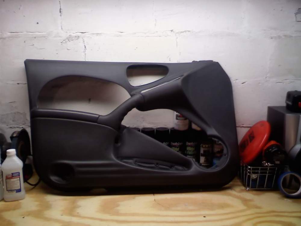

What I started with
After Sanding

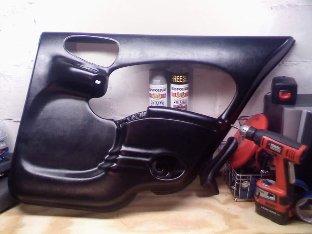

First Panel finished
First panel with dyed insert completed and glued in

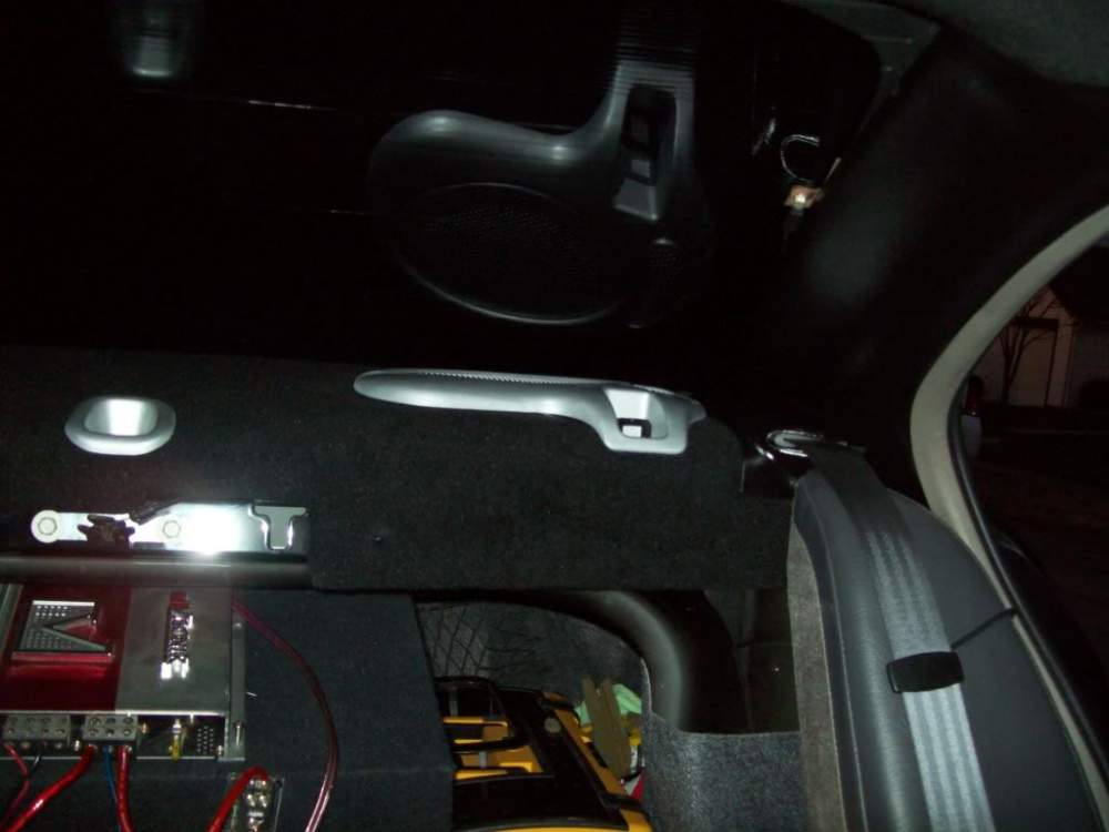

I also have the trim pieces and the window switches panel painted. Also Nightshaded the switches so they are black and glow red at night..Pics of that up later..headliner also is darker in person..lemme know what you think

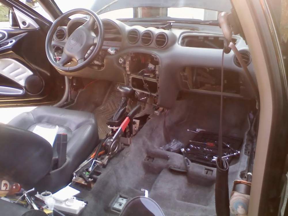

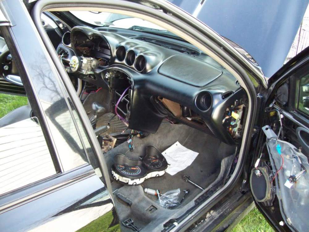

Well, got an update! Ripped out the dash and looks horrible in there now lol...First pic kinda show's the door trim bezel's and the tweeter. I'll get better pics of the door's with a digi tomorrow..
Halfway
Completely out
whooaaa...
HOLY COW ON THE DASH REMOVAL! :lol2:
As for the black and silver, looks great man! keep at it!
Holy dash removal Batman! ... I don't imagine that was a ton of fun.
It actually wasn't bad. Other than the airbag in the steering wheel and actually removing the wheel with no puller. Putting it back in should be more fun..lol right

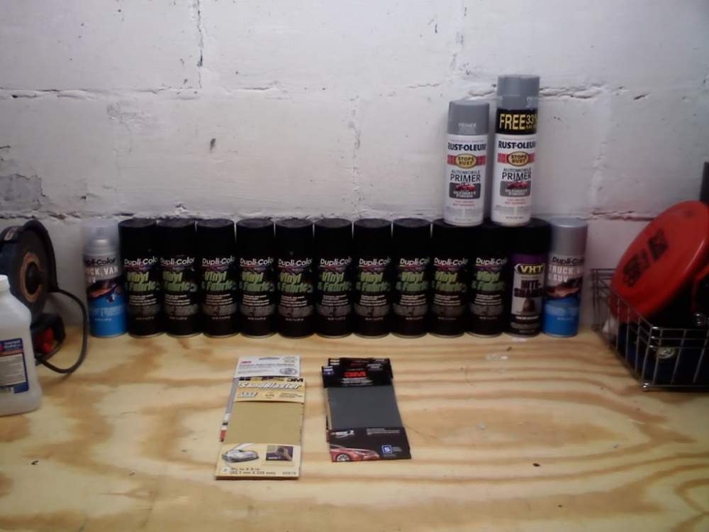

hey, i want to do the same to my interior since its not all the same black or dark charcoal...whatever the color is. did you jus spray the dye on the dash and door panels and thats it? and since its been a few days dry already, does it look glossy like paint? or like OEM black? cuz i want mine black but look stock. and how is it on cloth materials like the headliner? or that fuzzy stuff at the back surrounding the rear speakers?
I sanded it with 400grit and then wiped with rubbing alcohol. I didn't clear, would be blinding. Looks just like an oem panel and everything..the fabric didn't turn out as perfect as I wanted, but it will do...
so you sanded the door panel? isnt it jus clean and spray? i cant sand mine, its textured.
mine is textured as well, it's just to get imperfections and any oil or grease off the plastic. I didn't sand till smooth, just a quick scuff, wipe, spray, done..
