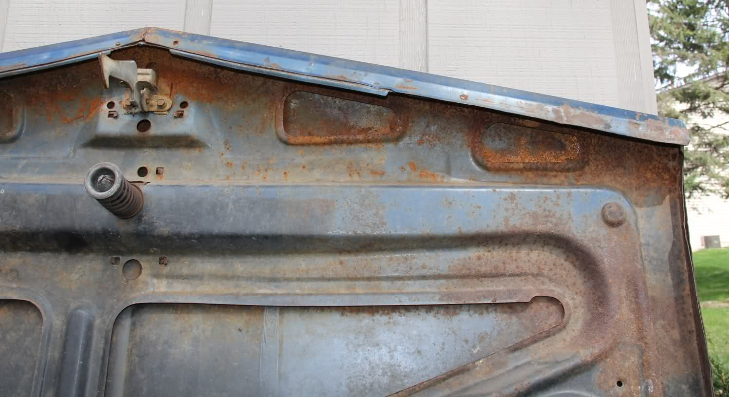

Just curious if anyone knows what color paint was used on the underside of the hood for a 67 GTO? Mine is currently the color of the car, but needs to be redone so I want to make sure I refinish it in the factory correct color, either body color or possibly black. Any comments are appreciated.
To my knowledge most GM cars the underside of the hood was painted body colour.  There are some that got damaged at the assembly site and a quick fix was to paint it black (rumour that I heard not necessarily true.)

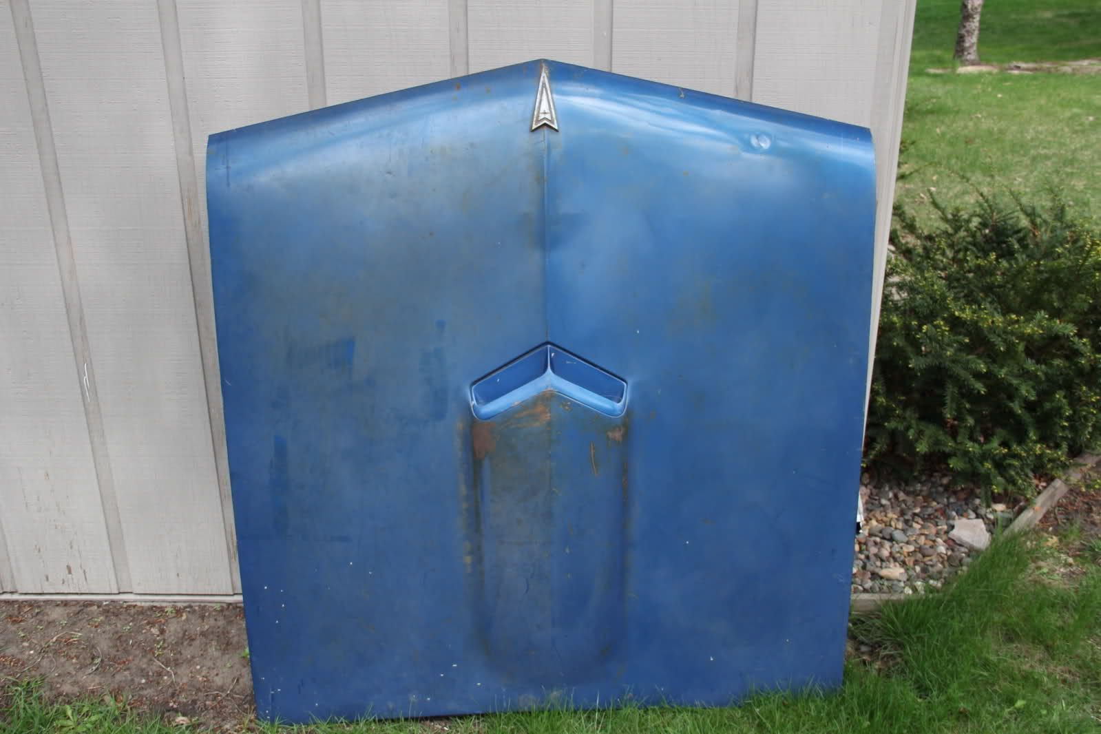

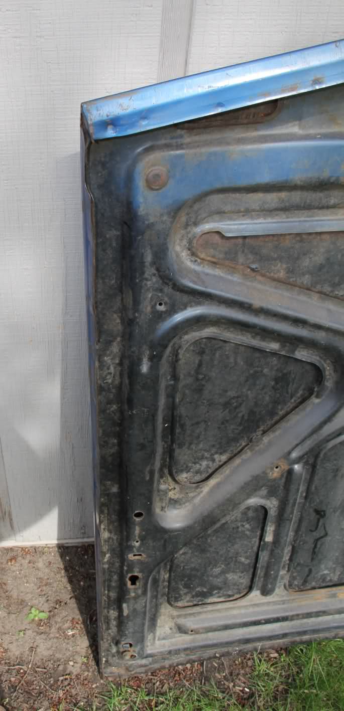

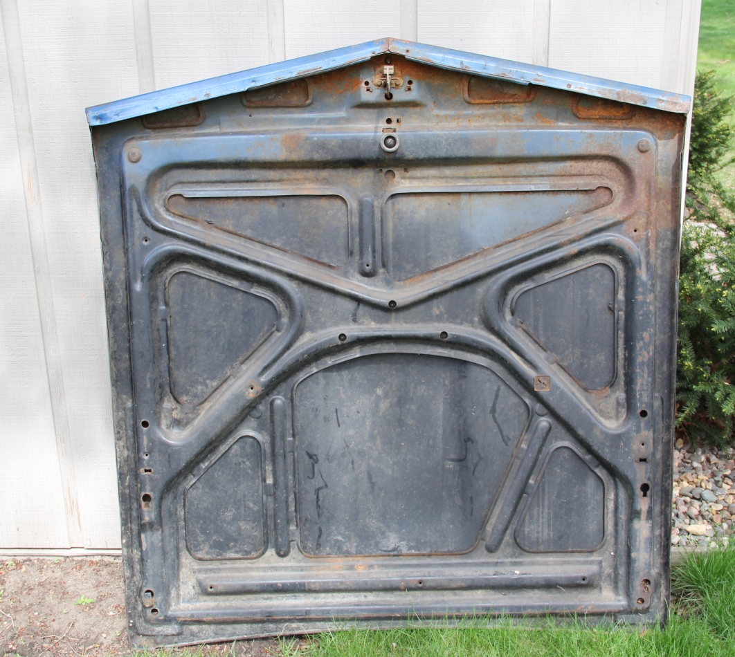

Here's some pictures of an original '66 hood from another forum that shows the overspray on the underhood black primer. I too prefer SPRINT 6's cleaner look.
Thanks Pat for the additional information. I'm with you on the cleaner look like SPRINT6's example. I always struggle with being true to original which in some cases is not always perfect.

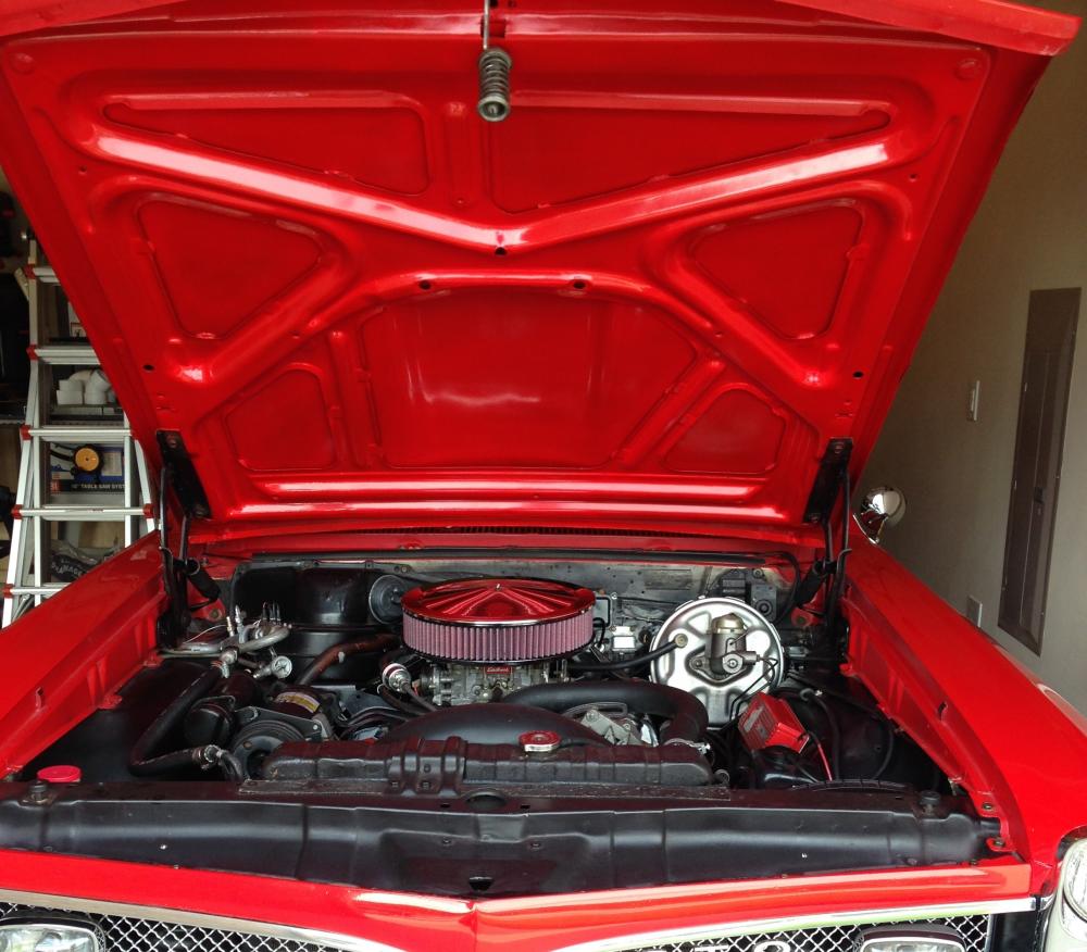

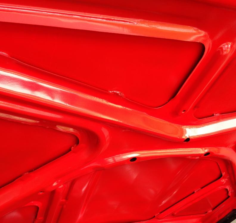

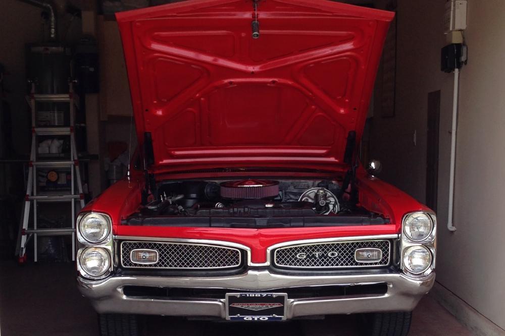

Well, it's been a while, but I finally decided to work on my hood. Thanks for all the input. I painted it body color after taking longer to wrap the entire car and engine compartment prior to painting it. It would have been easier to remove and do all of this, but I was concerned about getting the alignment correct and possibly doing some damage to my fenders so opted to paint it in place. I wanted to paint the entire underside even though I'm going to get an insulation pad for it, most likely a molded one. Let me know if you have any suggestions for a source. I looked at Ames and their site doesn't have pictures of the product.
Edited by rickmpontiac
Sorry for the rotated pictures. Decided the site doens't like portrat mode photos.
Looks terrific Rick! :dancingpontiac:
Thanks Pat!
Looks great! What paint did you end up going with?
Thanks Jim, I used Duplicolor Perfect Match Torch Red. My car is not an original Pontiac color for 67. I wish it was, but it makes touch up paint easier to find. Took about 3 1/2 cans over a red primer base.
